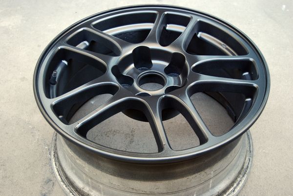

17FEB2012 - Fresh Set of Evo IX Enkei Wheels​
I liked my bronze Enkei CP1's but with the recent change to the Evo Brembo brakes I had to run a spacer to clear the wheel. The spacer seemed shady to DD on at best because it wasn't hub centric and I got a deal from a local on a set of Evo IX wheels so I pulled out the old rattle can and got high. :cool:

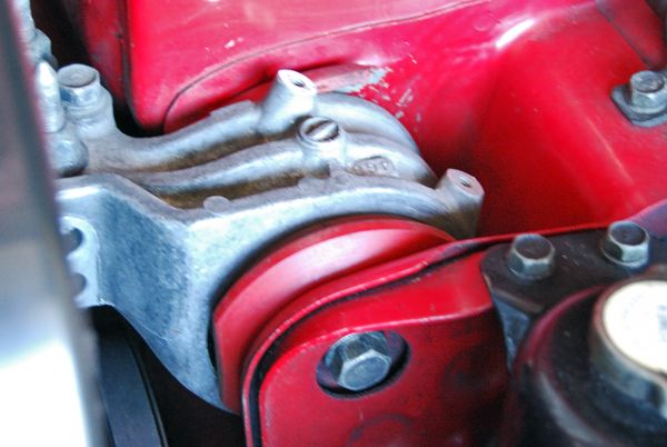

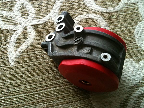

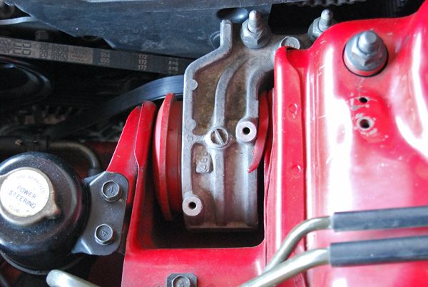

22FEB2012 - Fixing My Prothane Motor Mount
When I installed my Prothane motor mounts something never seemed right about that driverside and after a few thousand miles and trips to the track it was clear, something wasn't right. I took a picture or two and contacted Prothane's sales dept and customer service was great. They said to send them the mount and the insert and they'd fix it free of charge. To good to be true, I was thinking I wouldn't get that mount back for weeks but it only took a week! Wow. :thumb:
Thanks Prothane! Turns out the kit I bought came with two transmission inserts so it never fit correctly, I should have caught it during the install but I guess I didn't know any better. Good thing nothing serious happened with the wrong one in there.
Onto the pics.
Here's what it looked like installed before I contacted Prothane.

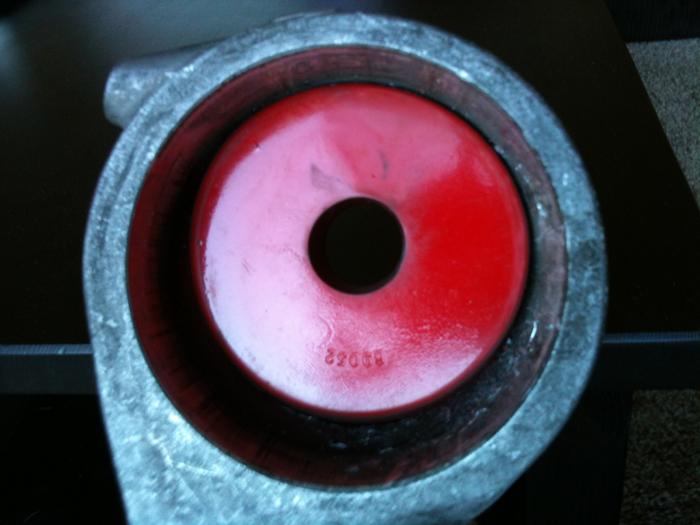

Once I pulled it of the car it was pretty clear it wasn't the correct insert, to this day I'm still not sure what I was thinking the first time I installed it.
The new and CORRECT Prothane insert after I got it back from them.

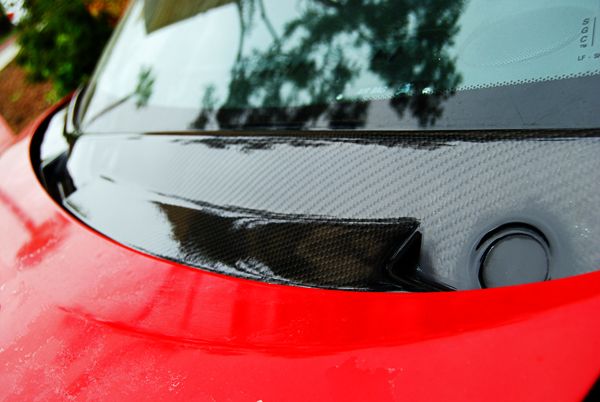

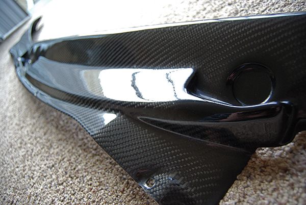

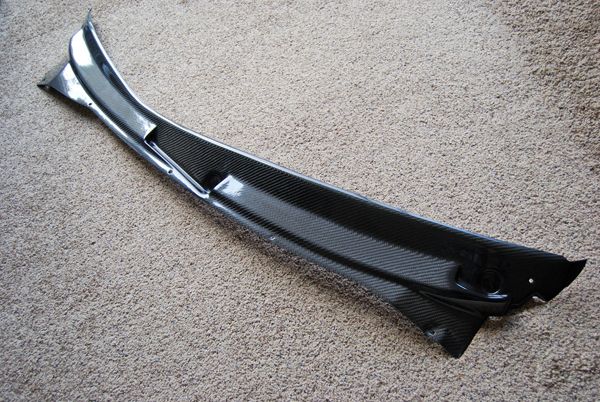

24FEB2012 - Carbon Fiber Wiper Cowl
I had pulled my windshield wiper assembly over a year ago and the stock cowl looked weird with those open holes in it for the wiper arms. I found a vendor that was localto San Diego that fabricated made to order CF windshield wiper cowls for 2g's and told them not to cut out the holes for the wipers. I got a phone call that the piece was ready to get picked up and I couldn't have been happier with the way it turned out.
I know CF is supposed to be functional to save weight, this didn't cut any weight from the car but it definitely cleaned things up and kept water out of the wiper trough.

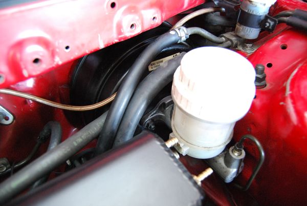

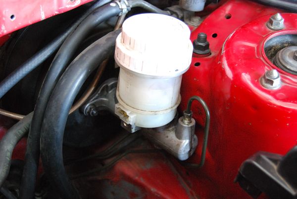

07MAR2012 - 3g Eclipse Brake Booster and Brake Master Cylinder Install​
After installing my Evo Brembo's, believe it or not, my braking performance went out the window. It was almost scary to drive in traffic, I'd have to tail the car in front of me by twice the distance and anticipate them stopping all the time. I was tired of it and desperate for a solution so I started doing some research on the Evo's brake system, not just the calipers/rotors. After a bit of research, digging through the forums and FSM's, I soon found out that the Evo brake booster and brake master cylinder were considerably larger than even a stock AWD DSM's brake setup.
To make a long story short the Evo's utilize a 17/16" brake master cylinder and a 8+9" brake booster where as the 2g DSM has a 15/16" brake master cylinder (FWD) or 1" (AWD) and a 7+8" brake booster. So, after some research I found that the 3g Eclipse had a 8+9" brake booster and 17/16" brake master cylinder just like the Evo. I found both used on a 3g Eclipse forum and thought I'd experiment, luckily everything just fell into place.
I don't want to turn this into a huge tech thread so here are the links to my findings I've posted around the forum if you're interested.
** Please ask technical questions, if you have any, in the respective thread I've linked to above. **
3G Eclipse 17/16" brake master cylinder (BMC) on the stock 2g brake booster
3G Brake Booster and Brake Master Cylinder Installed
