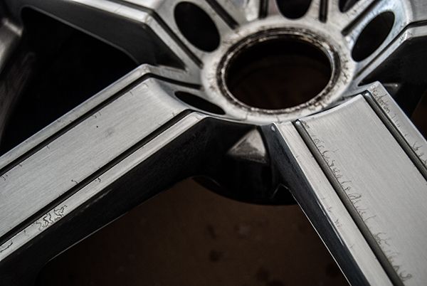

After I installed my Evo IX Enkei's in 2009 I put my Enkei CP1's up in my bedroom and used them for a tv stand for awhile. Once I moved to a place with a garage they sat in a corner and collected dust for awhile so, to say the least, they needed some attention so I pulled them out and got to work.
(The reason I wanted to DD with my old wheels was because I wanted a set of Hoosier DR's on my Evo wheels)

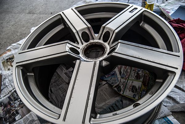

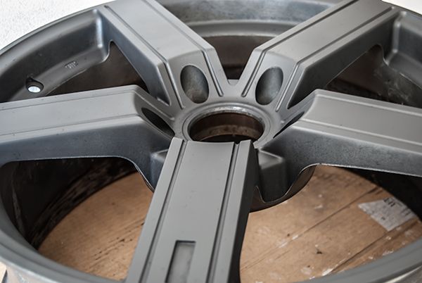

Here's a shot of the condition of one before I wet sanded/primed/painted it. They had 50k+ miles on them and spent a few winters on Colorado roads.
After wet sanding it using 1000 grit paper.
One coat of primer here in this photo, I ended up giving it a second for better coverage though.
After 4 coats of rattle can wheel paint it was looking like I wanted it to, only three more wheels to go. :coy:

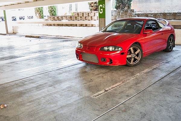

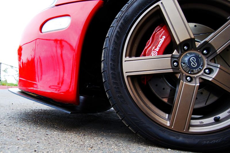

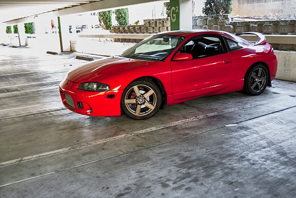

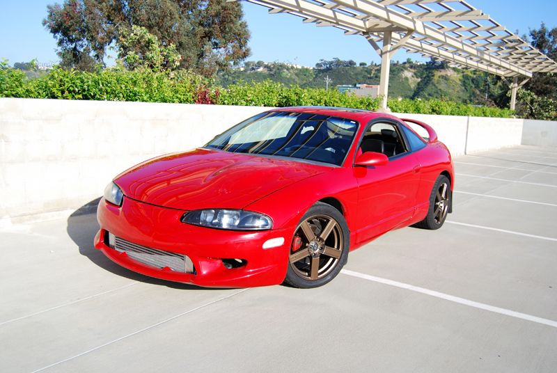

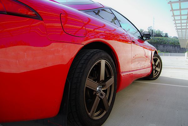

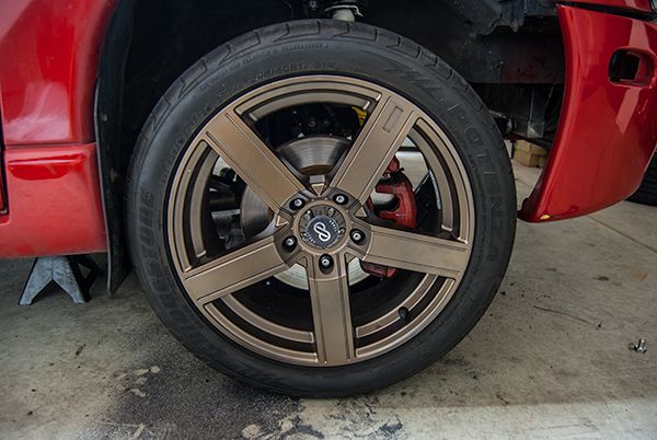

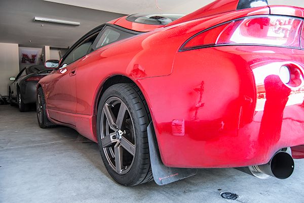

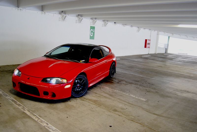

02FEB2011 - Refurbed Enkei CP1's Installed

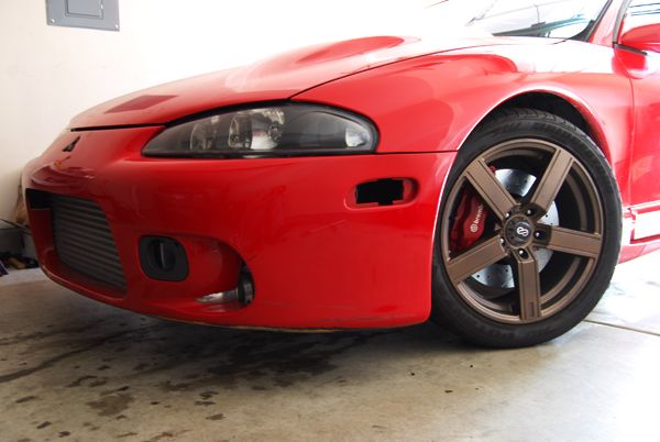

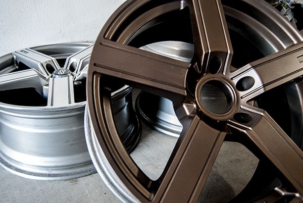

I finally finished refurbishing my 17x7.5 +38, taking them from brushed aluminum to a dark bronze color with a few cans of spray paint and lots of prep! The tires I had mounted on them were the same Bridgestone's I had mounted on my Evo IX rims, 245/45/17's.

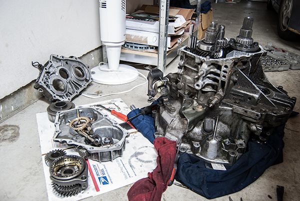

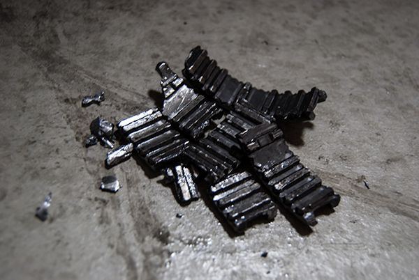

After I left the parking garage, when I took the photos of the refurbished Enkei's, I headed to into work for the evening. That night San Diego DSM was having a car meet, which is why I was pumped to get the "new" wheels under it. After I got off of work I was adjusting my NLTS RPM and when I shifted into 3rd I heard something that sounded like $3,500.00 leaving my checking account. :aha:
Luckily, I was able to exit the interstate and make it to a DSM buddies house that was just a few blocks away. I still had 1,2,5, & R so it was drive-able, still I wasn't happy to say the least. There was nothing we could do with it at 9:00pm and it was driveable so I was going to swing by the DSM meet and then home, since the meet was on my way anyhow. But, things went from bad to worse because the second I left my buddies neighborhood I left a stop sign and couldn't shift out of 1st gear. My 10 minute drive turned into 1.5 hours taking side roads going 12mph keeping it at a cool 3k in 1st. :toobad:

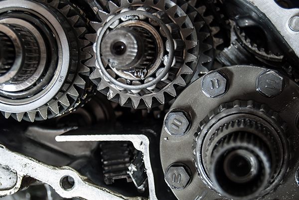

I made it to the meet and then onto my house, then I pulled the transmission the next day and pulled it apart to see the carnage. That's when I picked up the phone and got in touch with John.

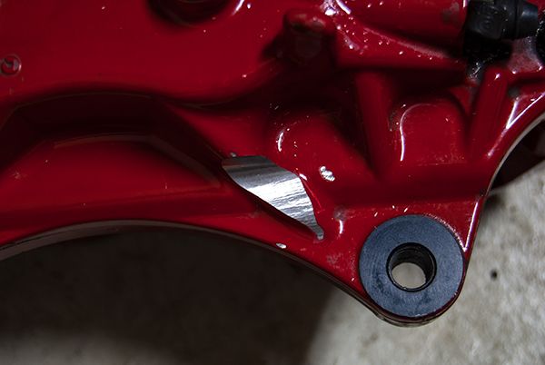

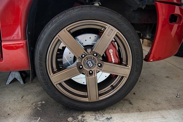

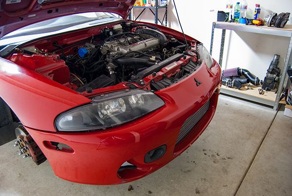

12FEB2011 - Front Evo Brembo Test Fit
From bad comes good, kind of. I had a set of Evo Brembos collecting dust in my garage because I didn't want to down my car to install them but, now that the car is a month out from a rebuilt transmission, no better time than the present!

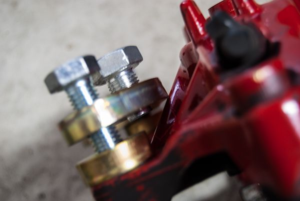

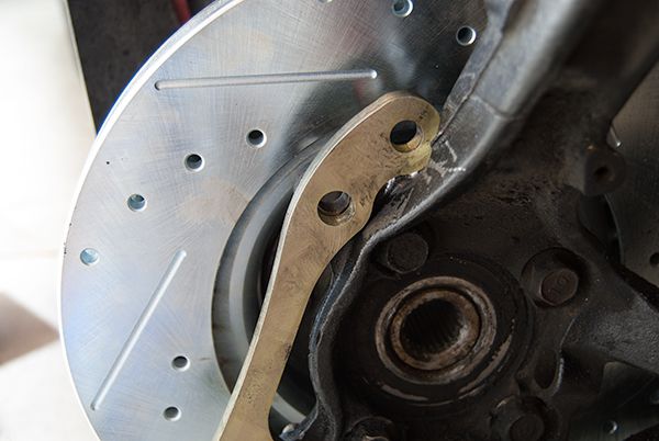

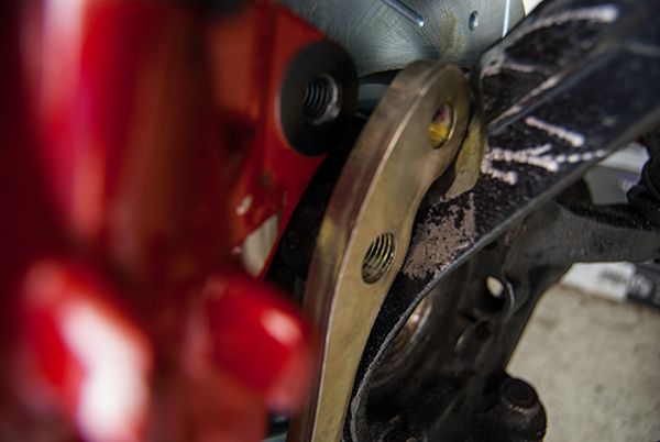

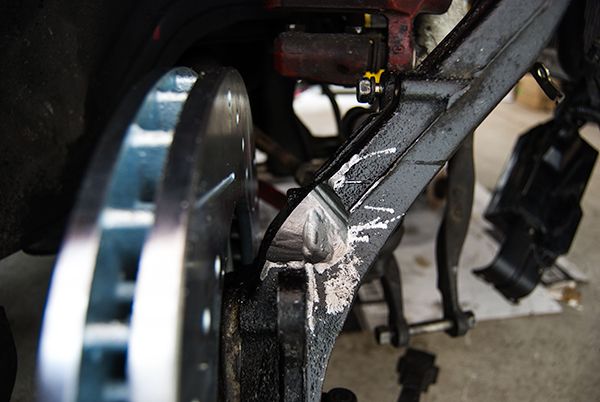

You can see the amount of grinding required on the front knuckle to use the kmv bracket and canter the caliper up. I HIGHLY recommend gloves, unless, of course, you like picking metal splinters out of your skin for days?

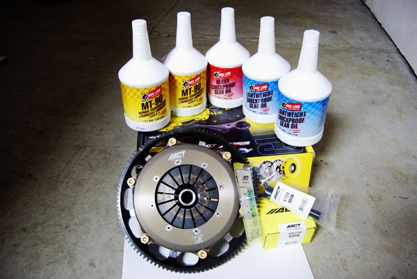

15APR2011 - Shep 4 and ACT Twin Disk... finally.​

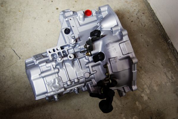

My transmission destroyed itself Feb. 3rd and rather than getting it back on the road with a used M/T for cheap I decided to have Shep rebuild mine. I put in the order for a Shep stage 4 with all the goodies!
  • Evo III 1st gear and input shaft
  • LSD
  • REM ISF process
  • 4 spider center diff
...and 3 weeks, and $3,500 later, I found a 140lb. box on my doorstep. I also had Shep send some solid shifter bracket bushings to stiffen up things on the shifter end, things looked great!
After I got the transmission I decided that my ACT 2600/street disk combo was hating its life seeing 400 ft/lbs tq at the track. That, and the clutch had been on the car since May '08 and I didn't want to be dropping the trans again. I knew I wanted a twin disk so I could pre-load everything at the tree, that way I didn't break shit with my Hoosiers under the car. Anyway, after shopping around I decided I'd stay faithful to ACT and get one of their new twin disk's that is capable of holding 750 ft/lbs tq so basically this clutch is going to think my cars a big ####y. LOL
Got the parts together, now it was time to find the time to install everything!
:dsm:

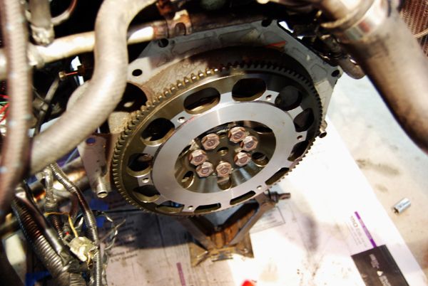

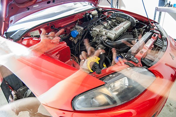

23APR2011 - Shep 4 and ACT Twin Disk... finally... installed!
A few friends (banishedmunk and VergeTSI) tag teamed this project and helped me knock it out in just a few hours, we even had time to put back three medium pizza's too.
On to the few pictures I took while we installed everything, hopefully I won't have to pull another transmission off this car for awhile now.

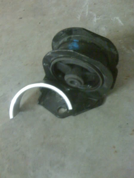

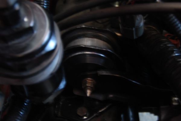

26JUN2011 - Knocked Out the Stock Front & Rear Motor Mounts​

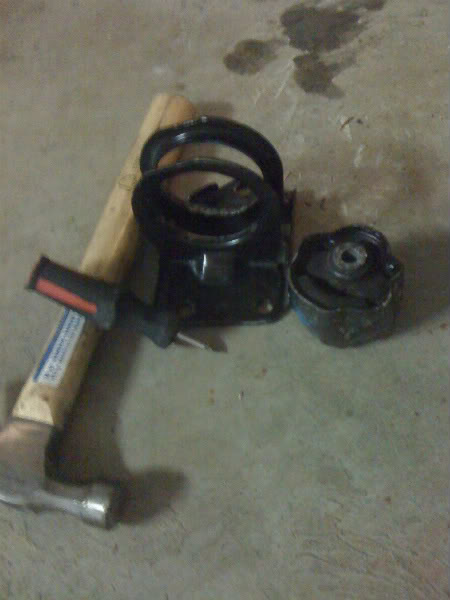

A DSMTuners Freelancer started a group buy on solid roll stops for a 2g and I jumped on them, I had the poly inserts and they were garbage. I remembered how much of a PITA it was to install the poly side motor mounts but the results were worth it so I pulled out my hammer and flat head and started banging away.

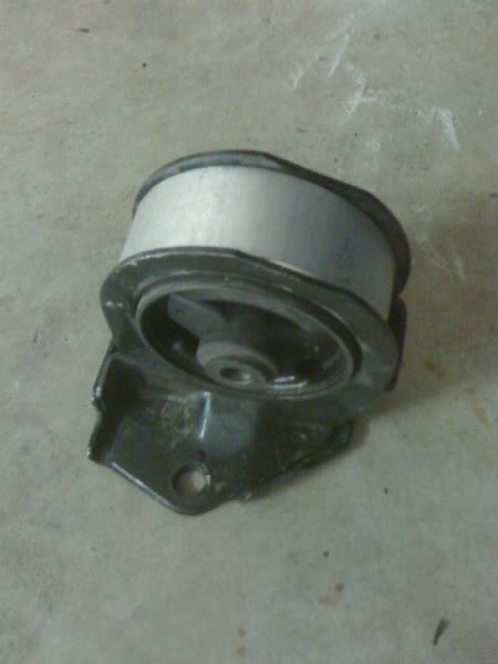

The front one was just like the sides, I just had to punch out the metal sleeve and the roll stop slipped right in. The rear, however, not so easy because it's nothing like the other 3 motor mounts. Something's always got to be difficult...
:dsm:
27JUN2011 - Rear Roll Stop Pressed In​
I spent hours trying to tap in the rear motor mount sleeve before I gave up, I just really hate paying a shop to do something I can do myself. Eventually though, I swallowed my pride and called the local suspension shop that had a press and fortunately I was charged a 6-pack of Coke for the job. ROFL
Now I've got the front and rear solid poly roll stops pressed in, I just had to find time to down the car and install them! They looked great...
For more information on where to get these contact Adam Porto (black_gst). 2G DSM Polyurethane roll stops - DSM Classifieds
:dsm:

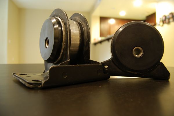

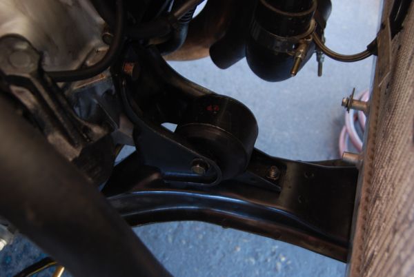

01JUL2011 - Front & Rear Poly Roll Stops & Front Brembos Installed

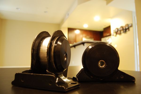

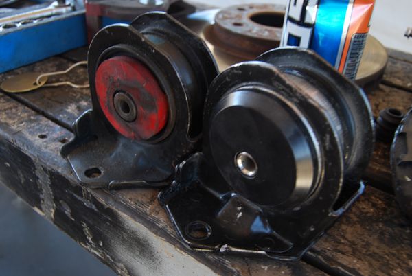

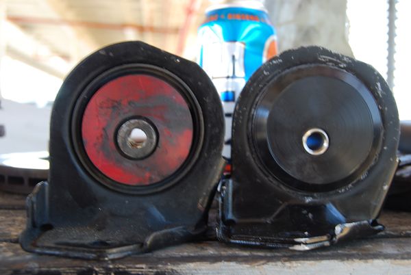

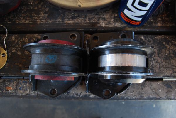

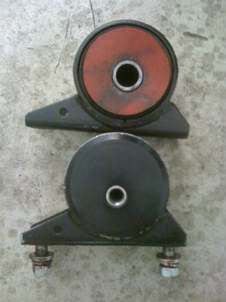

I got the front rear roll stop installed today and as much as I was dreading putting them in, it wasn't too bad. I want to say that these things fit PERFECT in the OE brackets that bolt to the transmission, it seems that one (mm) too big or small and it just wouldn't work. Just cover the outside of the poly mount with WD40 and slip it into the bracket.
Here are a few photos of the rear roll stop compared to the prothane insert.

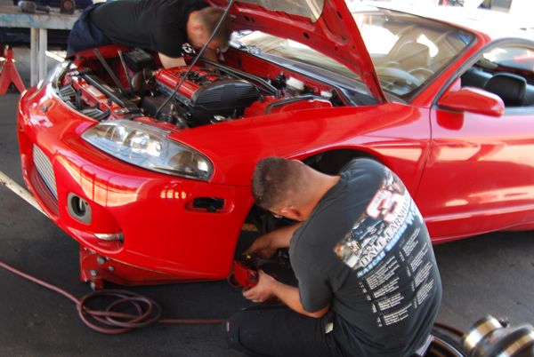

While I was installing the roll stops my buddy Kris (banishedmunk) was grinding up that front driver side knuckle to get the kmv bracket bolted up. Up to this point I had done the passenger side knuckle but was still running the stock AWD brakes until I could get the driver side done, Kris did it for me! Here's a shot of us hard at work and then another of the car with the new brakes...

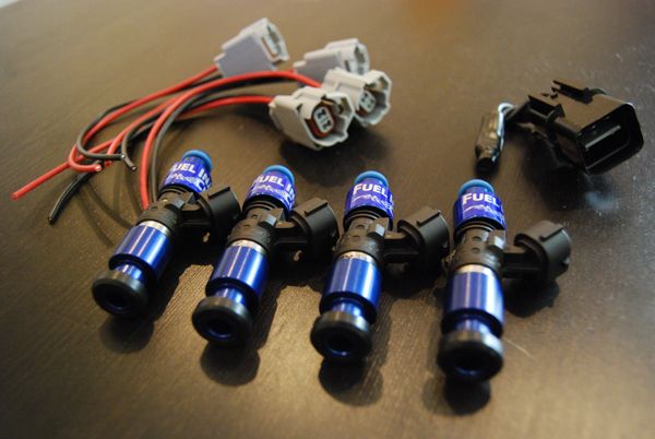

30JUL2011 - FIC 2150's​
My current fuel injectors are 950's and were maxed out squirting E85 trying to support 47lbs/min of airflow. Because of this base fuel pressure was set at 50psi (over 43.5psi) to stretch them so my IDC's weren't over 100%, something I still wasn't comfortable with. I was tired up continuously upgrading injectors so I broke down and bought a set of FIC 2150's and don't plan on EVER upgrading injectors again.
Of course they do no good sitting on a coffee table, they look nice though, but I didn't get around to installing them.
