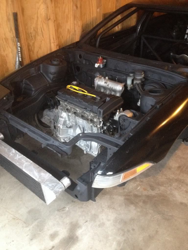

stock block b18s with a turbo can get 500hp with ease on e85 up here... i have a built block with forged pistons all all that yada yada. will be running FIC 2000cc injectors and a decent sized turbo. i should hit 500whp with hopefully around 20psi only. the block is bored out to 85.5mm to get alittle more displacement. as for the front end DSS will be making my custom axles once i get the measurments over to them so ill run all the DSM suspension stuff and wheels (which i like LOL) and the car came with all the drivetrain and such already pulled so it was the perfect shell for this
and for the 11s one of my buddys has an eg hatch with only 450hp and he runs 10s all day in that thing. i know its light but i should be able to snag 11s

Will you be removing the AWD rear end to save weight? And I'll be amazed if you hit 400 tq @ 500hp on a Honda motor. I've never seen it. I guess you could do a long runner SMIM to help.
the rear end is out correct... and the b18 comes stock with an 81mm bore. my sleeved block has been pushed out to an 85.5mm so it should up the tq so we will see what it put out. ive never had a block this big before to compare to. and you would be surprised on the tq of turbo civics. stock they suck yes
sleeved b18a
golden eagle sleeved to 85.5mm
weisco 9:1 pistons
eagle h beam rods
arp rod bolts
arp head studs
arp main studs
moroso oil pan
acl race bearings
itr oil pump
itr water pump
exedy twin disc clutch
ls trans for the longer gears
gsr head
supertech valvetrain
some mild cams
victor intake manifold
bdl 70mm tb
full blown fuel rail
stock ignition
aeromotive FPR
aeromotive a1000 fuel pump
10 gallon fuel cell with -8 feed -6 return
aeromotive fuel filter
aluminum civic half radiator with slim fan
custom front facing turbo manifold
yet to be determined borg warner turbo
old school bushur racing street fmic
p28 ecu with hondata s300 and boost by gear setup
drive shaft shop custom axles
all new suspension/brakes/braided lines/bushings
avid billit motor mounts
I think that covers most of it.... im sure ive forgotten some stuff but it gives you guys a better idea

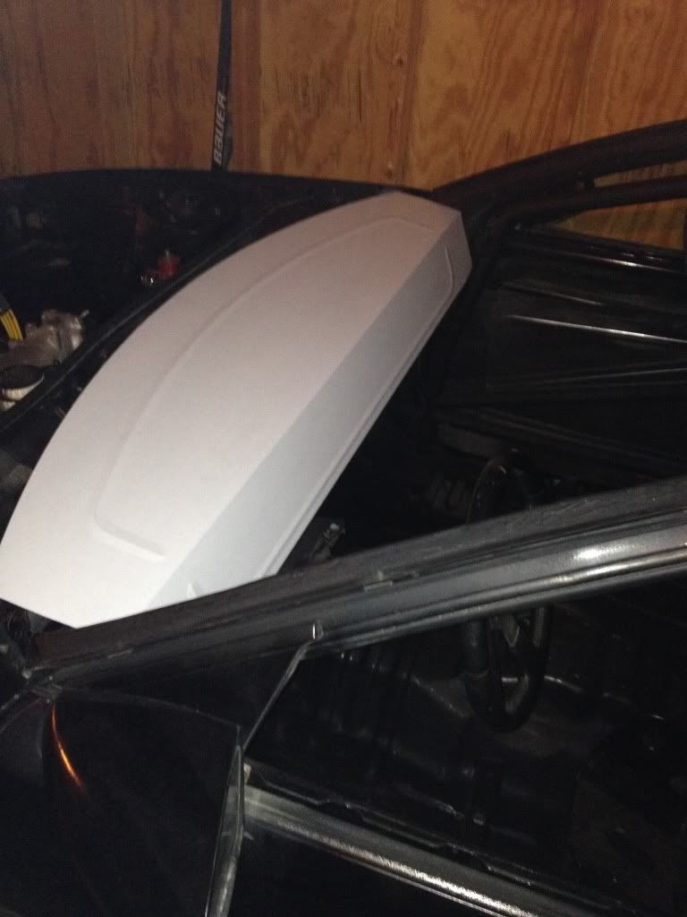

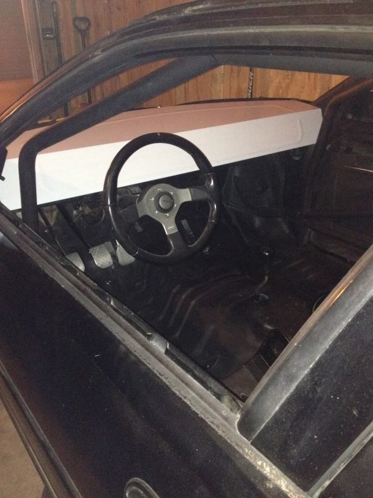

started on the dash tonight... things will start to slow down soon as many of you know that winter in Fargo, ND = everyone is in hibernation until March. Oh how I wish I had a heated shop
