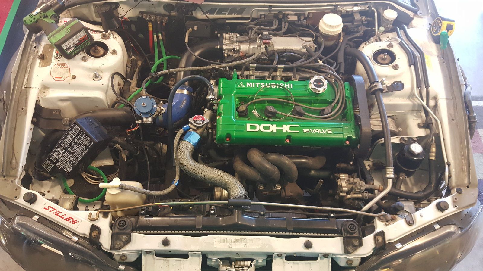

I have a 1997 eclipse gsx. Pretty stock for now. Has exhaust, walbro 255 rewired, small intercooler, and a cold air intake.. I've been running this setup for a couple years now and I'm wanting to do a small build.

Sounds like a fun gameplan.I tend to see a lot of top-mount manifolds for sale so I'm sure you can hold out to get one. Also, if you are going gt35r the exhaust hotside could be important in achieving your goal of 500hp on 93. Good-looking car.
I would like to advice against any manifold that robs you of room, for your cooling, fans, rad, ect.....
If you do, there will be allot of work to keep temps down. Shrouds, ducting, heat blanket, tape ect......
Just something to consider, I envy those with the oem style manifold, nice and compact...
