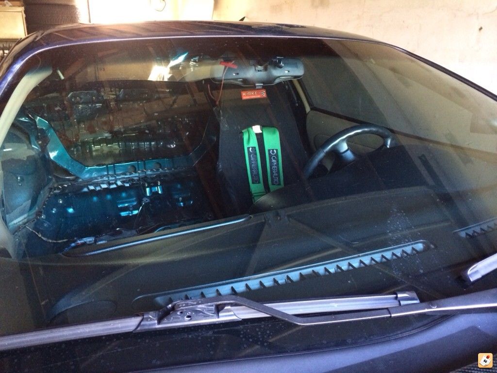

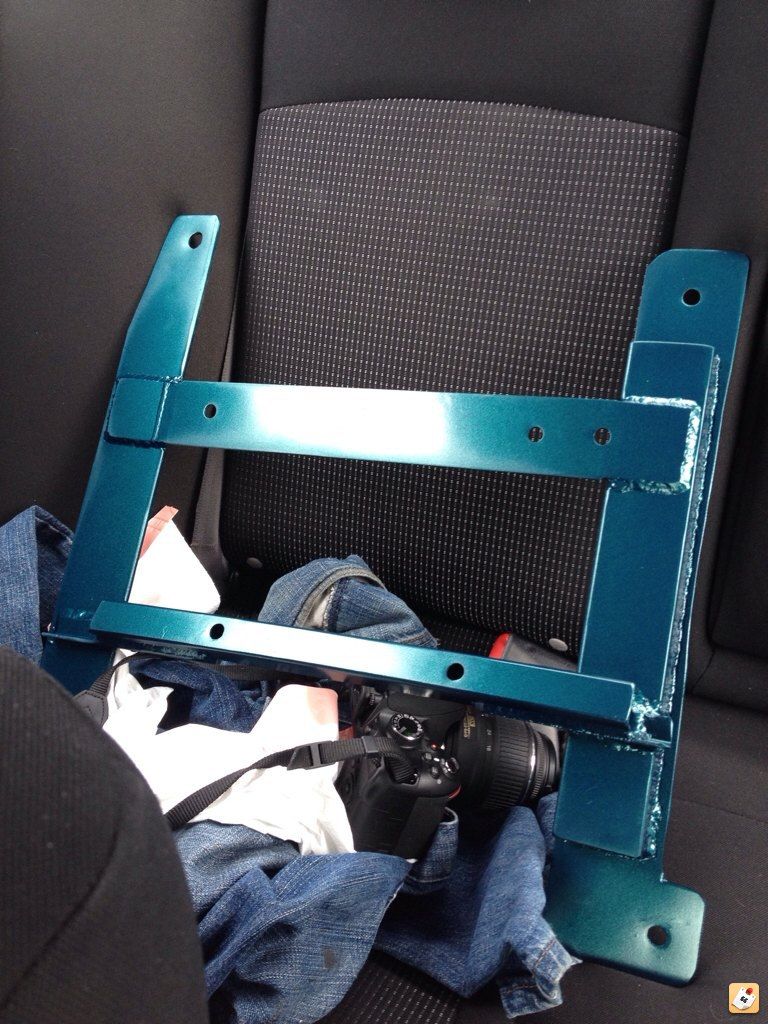

next on the agenda is to fab up a seat mount for my kirkey. ill have to brush up on my cage requirements for spacing between the helmet and cage

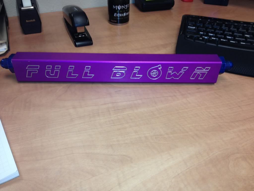

FULL BLOWNS "XL" FUEL RAIL.. I LOVE HAVING A LOCAL COMPANY THAT PRODUCES BAD ASS PARTS

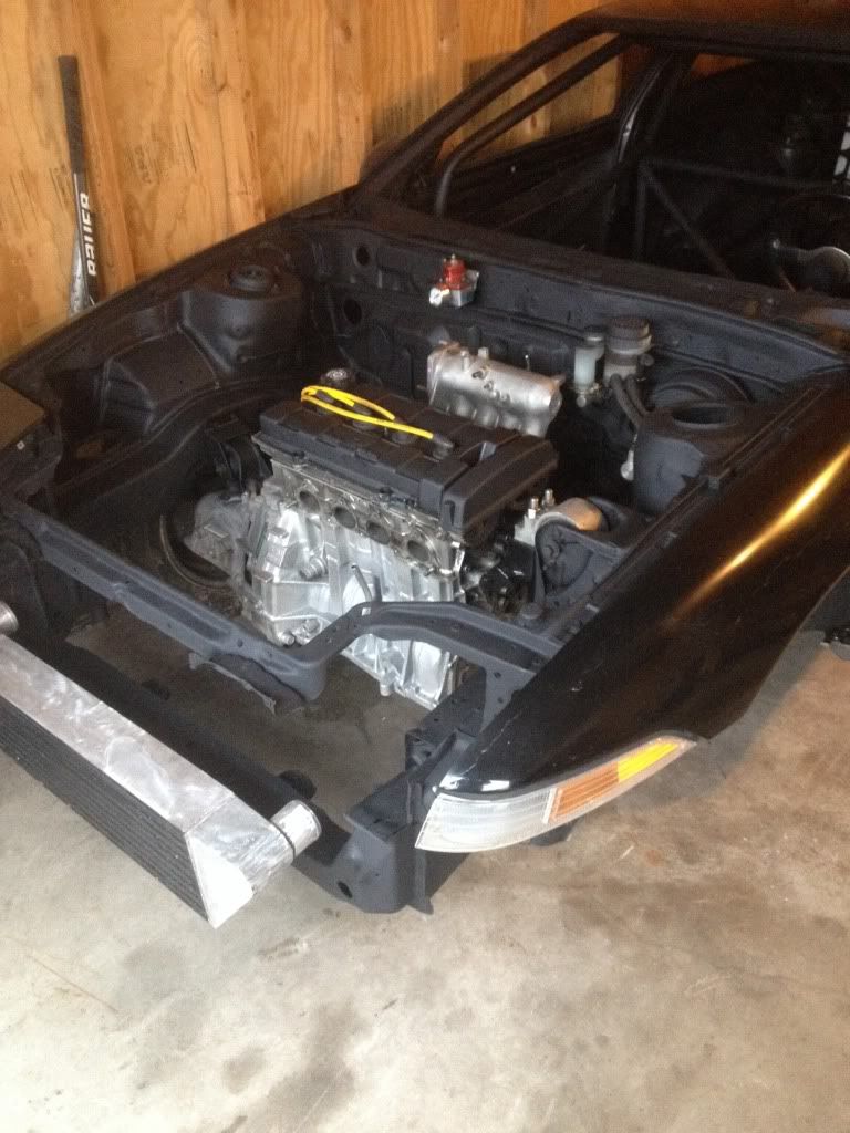

You can get away with using some evo coil-overs with little modification. That opens up a lot more doors for coils-overs. The 1g dsm front spindle is thinner where it bolts up the the strut so all it needs is some shims. The rears will have to have a dsm lower mount from an old strut welded to the evo strut, not sure if that makes sense to you ill try and get a link up when I get home.
This is how i did my kirkey bracket.

anyone have an idea on replacing the whole front hub setup? can you get them a complete set? i have the knuckle out and want to replace everything and add in some extended arp lug studs

Not sure if this was already discussed since I only skimmed over the previous posts, but my question is regards to your axel setup.
Are the fwd axels you plan to use for your honda drivetrain the same length and shape as on a 1g dsm. Will the hub splines match up with the 1g hubs, or are you using honda hubs somehow, or making custom axels??
Reason why I ask is because for my build, I am swapping my 420a engine for an awd evo 8 2.4LR and to do this I need to make a custom axel, because the tranny spline count and dsm spline count differ.

I think he said It's an LS vtec, 1.8 non vtec block from an Acura LS and a vtec head from an Acura GSR

im just getting all the measurements and having Drive Shaft Shop make some level 3.9 axles for it. Hefty price but its worth it for that name haha
Is it an h22?
heck no.. those bastard honda engines need to stay in preludes LOL
correct sir!
