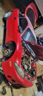

Ok so I have a 99 Eclipse RS currently as my daily until I build my GSX. About a year ago I removed the motor because of a terrible oil leak that I just couldn't figure out so I ended up changing every gasket on the car just to make sure it wouldn't come back.
Now when I put the motor back in and started it up it started to idle fine but as soon as the motor warmed up it started to idle like a cammed out V8. I figured it was a vacuum leak so I check every vacuum line there is and none of them have a hole or tear or anything that would cause a leak.
So I took it to autozone to hook the computer up to it to see if any codes were thrown and it said my EGR and TPS were bad. Well I assumed the TPS sensor would be the problem, but after replacing it, the car still idles like a bridge ported rotary engine. I wouldn't imagine the EGR would affect the idle but maybe one of you guys can prove me wrong.
I was fine with ignoring it for a while but now it is just plain annoying since it sometimes even wants to die if I tap the gas on a hill or with the air conditioner on. I would love it if it were cammed out but its not and would love to figure out the problem. Thanks in advance.
Oh and one more thing, I did do some porting with a dremel to the intake manifold only, not the head, and I have my dad telling me that the porting is whats causing my idle problem. I think he's wrong but i don't know its a thought. What do you guys think?
