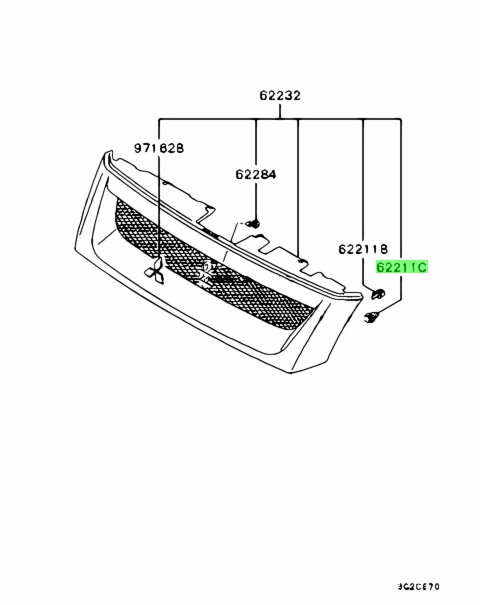

This is what the parts catalog shows. Perhaps it helps.
Based on the post above mine, MB567798 looks like the actual part number needed.
Would you happen to know if that #9 MR311006 part number crosses to something else? I cant seem to find anything that would work for it.
I do not. Matter of fact, MR311006 does not appear in any of Mitsubishi’s parts programs. There’s likely a suitable replacement out there somewhere but without one of those physically to compare to, I am of no further help.
