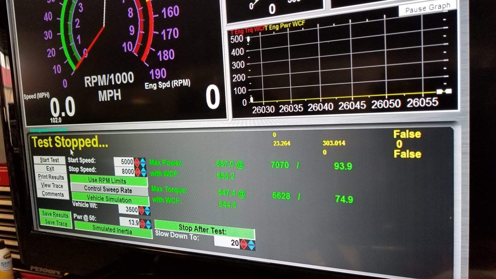

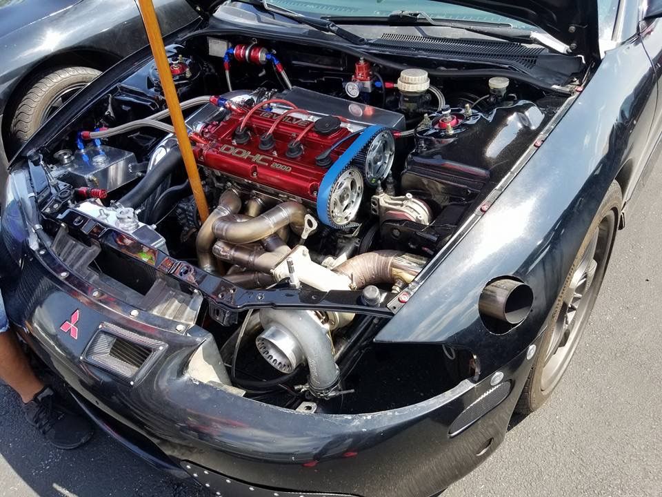

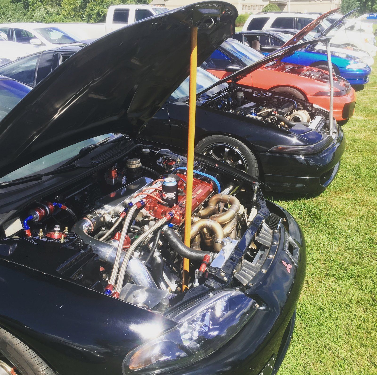

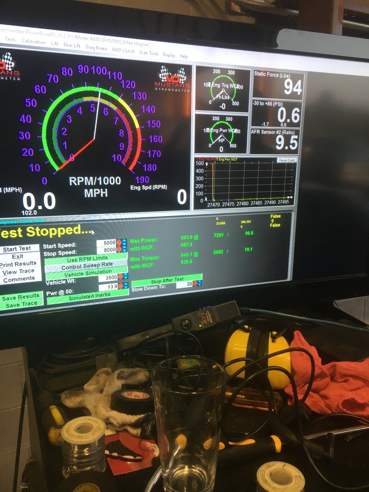

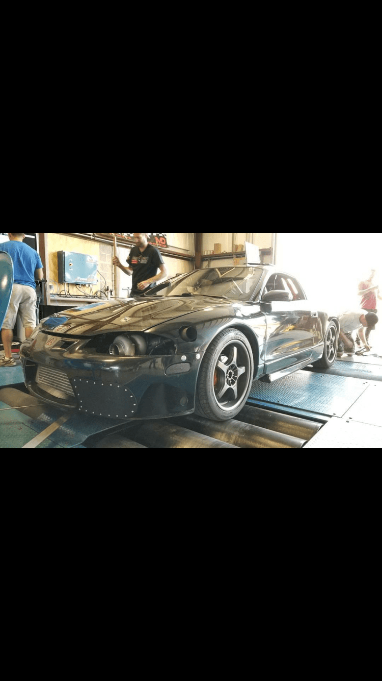

Last Friday we strapped the car down on the dyno finally! This is still on my tune at 38 psi on the 6466. Maxed out the injectors that are in the car, could have switched to the 2150's and made a lot more power but decided against it being that I am happy with what it put down. So here are the results:

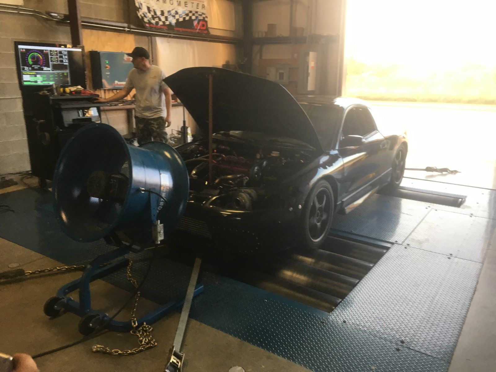

After driving the car to the dyno strapped the car down

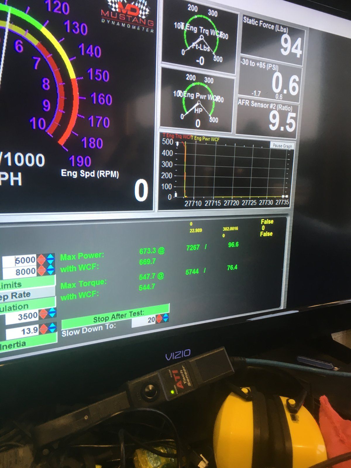

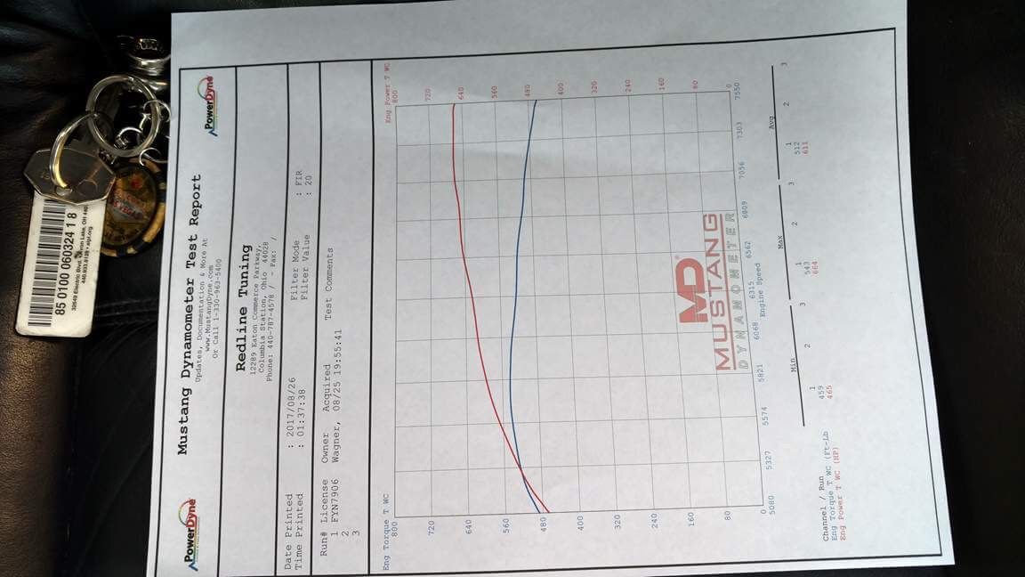

On regular 93 pump gas made 657 awhp and 547 tq on a Mustang dyno!

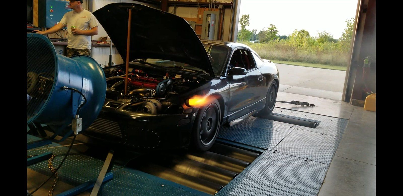

Filled her up with some Cam2 110 racegas and added 1 degree of timing at the top end on the same 38psi
and the final number we left off with was 673 awp and 547 tq!

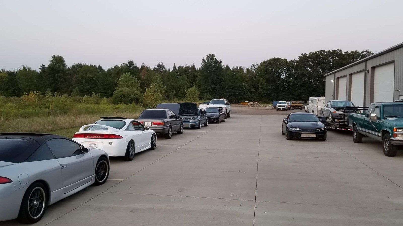

Had a decent turn out for the dyno too! This was a last minute dyno day
I am very happy with the results, feels good to have self built something in my garage, self tuned it on the street and put down some gnarly numbers on a mustang dyno like this.

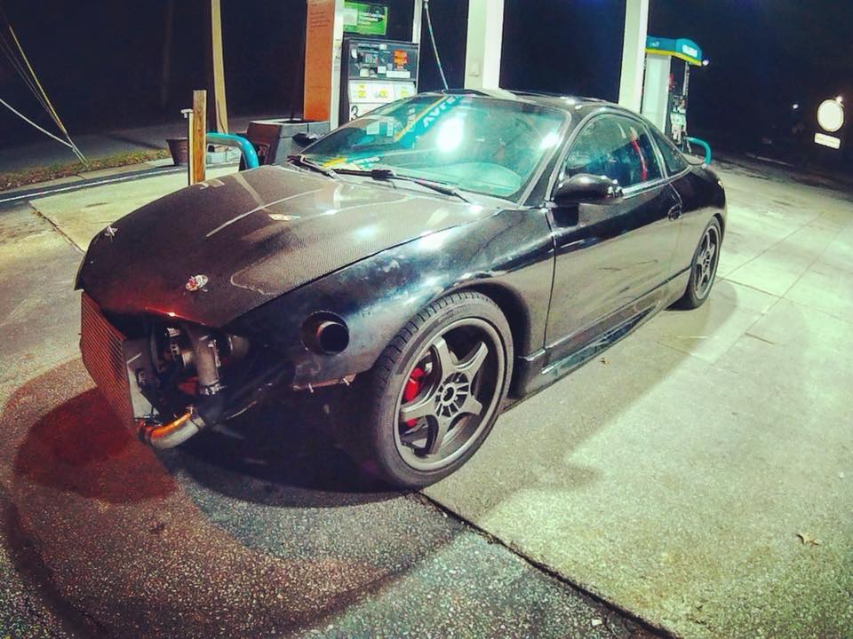

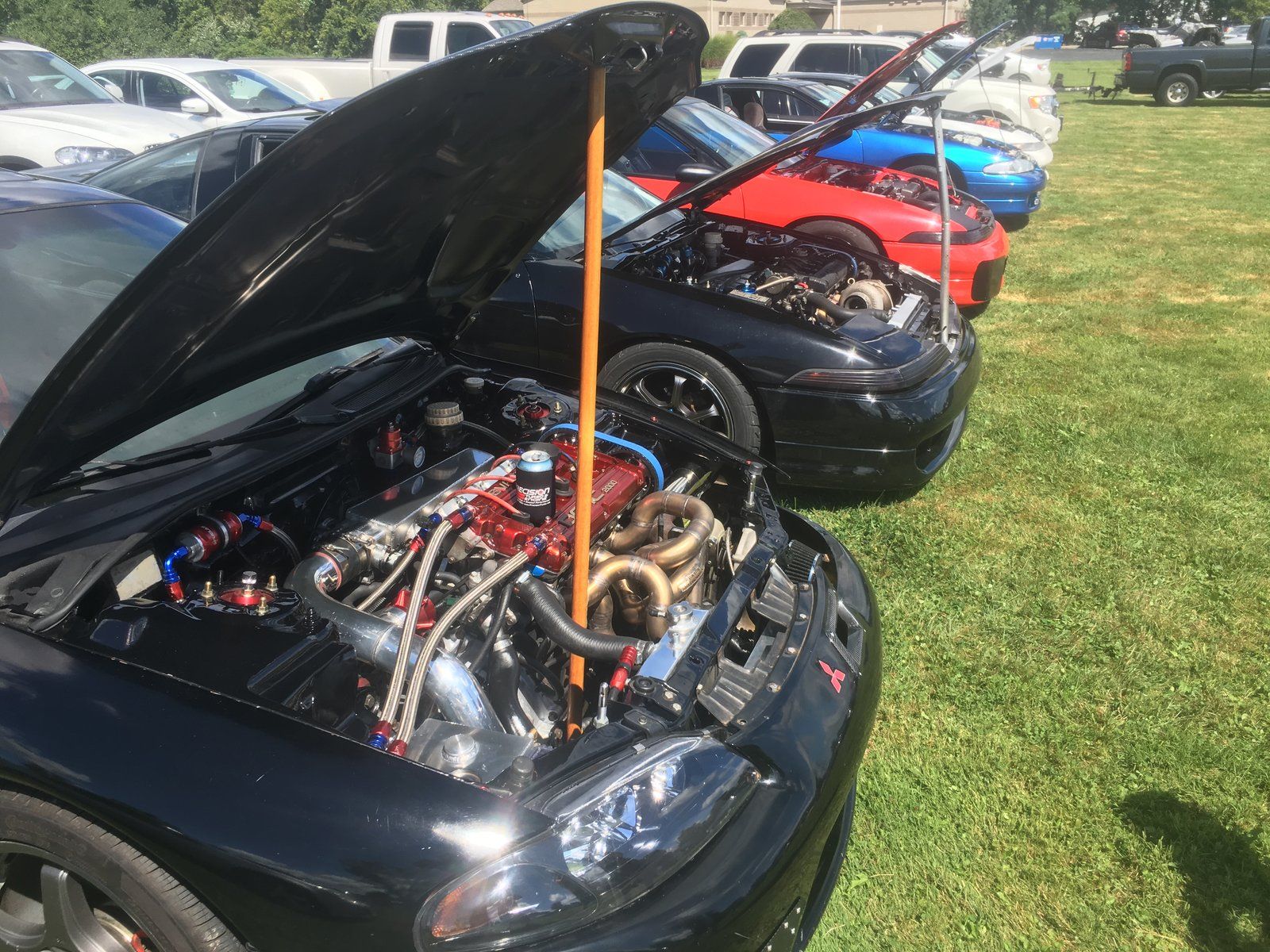

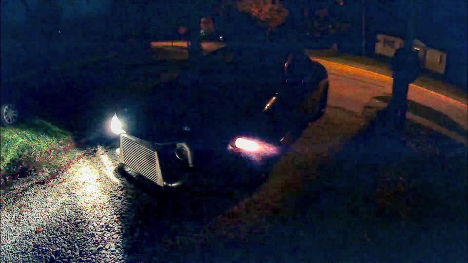

This was my house leaving out Friday morning with our dsm parade
Nope! Still the same old 2.3L I built in 2008. Last winter I had planned on swapping over to a 2.0 but never did, probably will this year before this thing grenades and damages the head
That's why I call this the pump gas hero! haha, Towards the end of the season we are doing another dyno day at that same shop and thats when I will throw the 2150's in and probably E85and crank up the boost until the ignition systems cuts out
Or the transmission say **** you LOL. Great numbers man, impressive for sure especially on a MD!

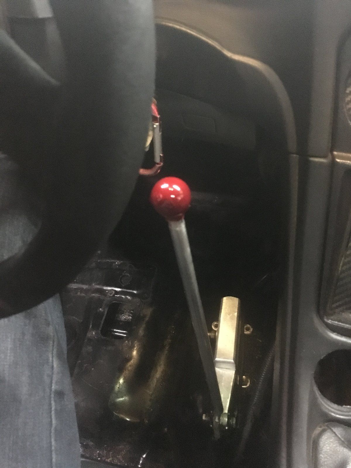

Only small update I have is I finally got my hands on a staging brake. It was originally tied to a factory e-brake handle so the old owner cut the handle off of it so I had to make my own. Turned out pretty sweet!
I still need to shim the left side of the staging brake to bring the handle more to the right and run the brake lines yet.

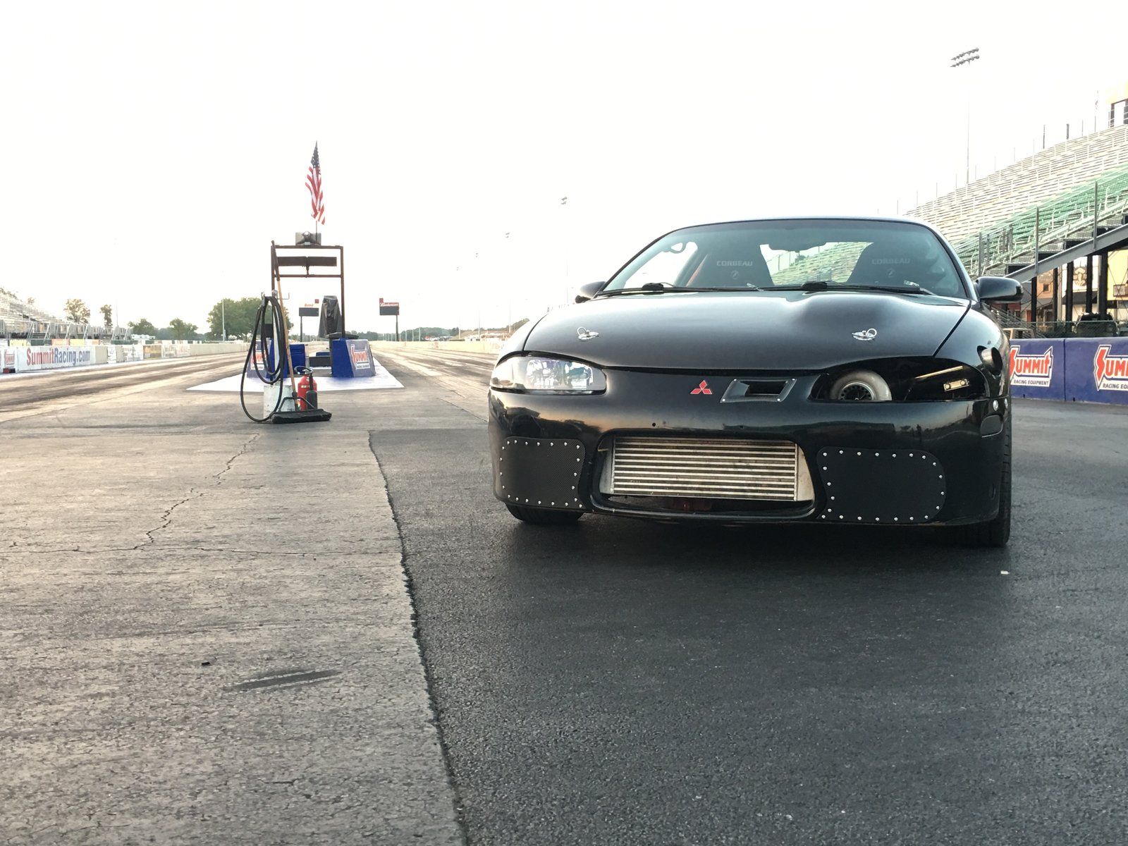

This Friday I took a vacation day to go racing. Dragway 42 is doing a full prep event for 50 bucks a racer. COUNT ME IN! I'll be there from 10-4 9/22 in West Salem, OH. Really hoping to get my goal of that pump gas street tire 9!
**UPDATE 10/02/17**
09/29/17 went to Dragway 42 for the track rental from 10-4. Still having to baby shift the car due to the trans issues. Got there about 11:00 and the first pass of the day letting off a little passed the 1000' mark something just didn't feel right.. Coasted to an 11.0 at 134.
Next pass of the day the car started to misfire in 4th gear.. I swapped out plugs, different gaps, different plug wires, different kind of plus and nothing was helping. The breaking up was only happening in 4th gear. The only thing I didn't try was turning the boost down a few. The best pass of the day was a 10.5 at 142 while breaking up bad in 4th, this pass had my best 60' 1.7 and was looking solid for a personal best for me unfortunately ran into the issues again.. Until next time.
Here is the 10.5 at 142, I only stayed in it because I was upset and I was back half-ing the hell out of the other car and wanted to win the race haha
I managed to get 7 runs in and at least I was able to really dial in the launch and the 1/8 mile

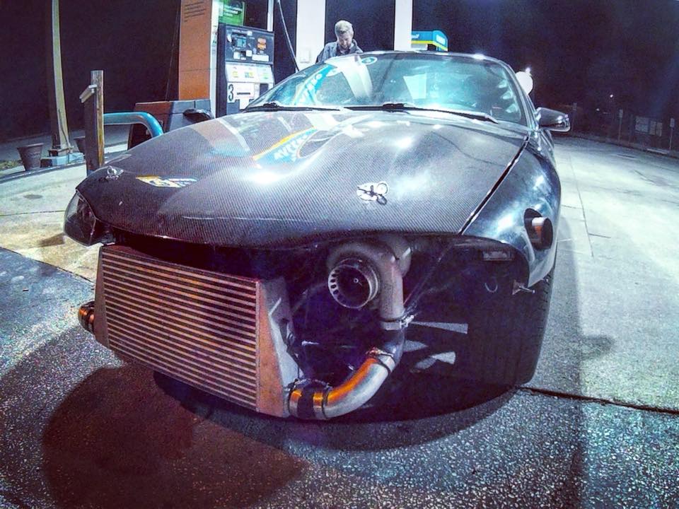

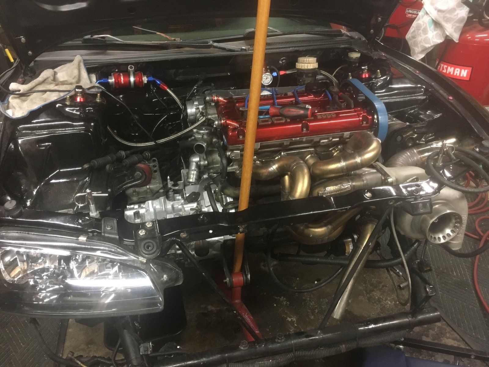

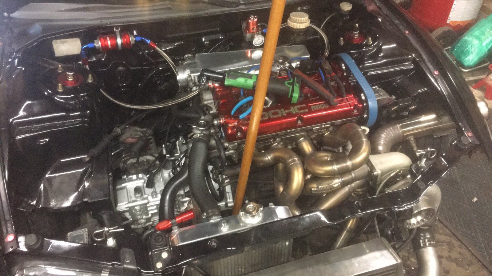

Dare I say that I actually liked the car more with the previous setup? The car is still amazing but I loved the old wheels. BTW, what was the reason for the new FF turbo setup?
I agree, these wheels aren't staying. The only reason I got them was because a buddy had them and I traded a wideband for them haha. Next season will be another wheel swap so something that will actually hook up :) There were 2 reasons for the new FF setup 1.) I didn't like how much of an angle the STM manifold set the turbo on 2.) I won the Eaton Motor Works manifold on a raffle. GRANTED... This manifold is not what we agreed on so I'm stuck with it for now. We agreed on a much cleaner looking manifold. In my opinion running #1 is lost and doesn't know where to go so he looped it around. I'm still indifferent about it. Lack of communication ..........................................................(not on my part)

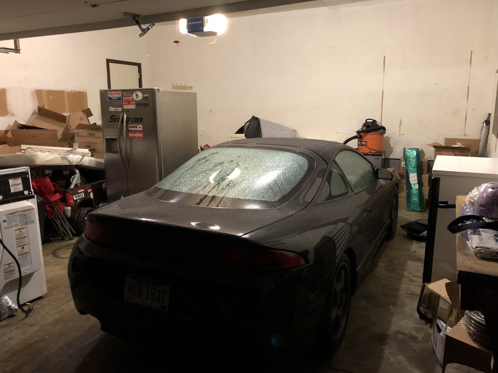

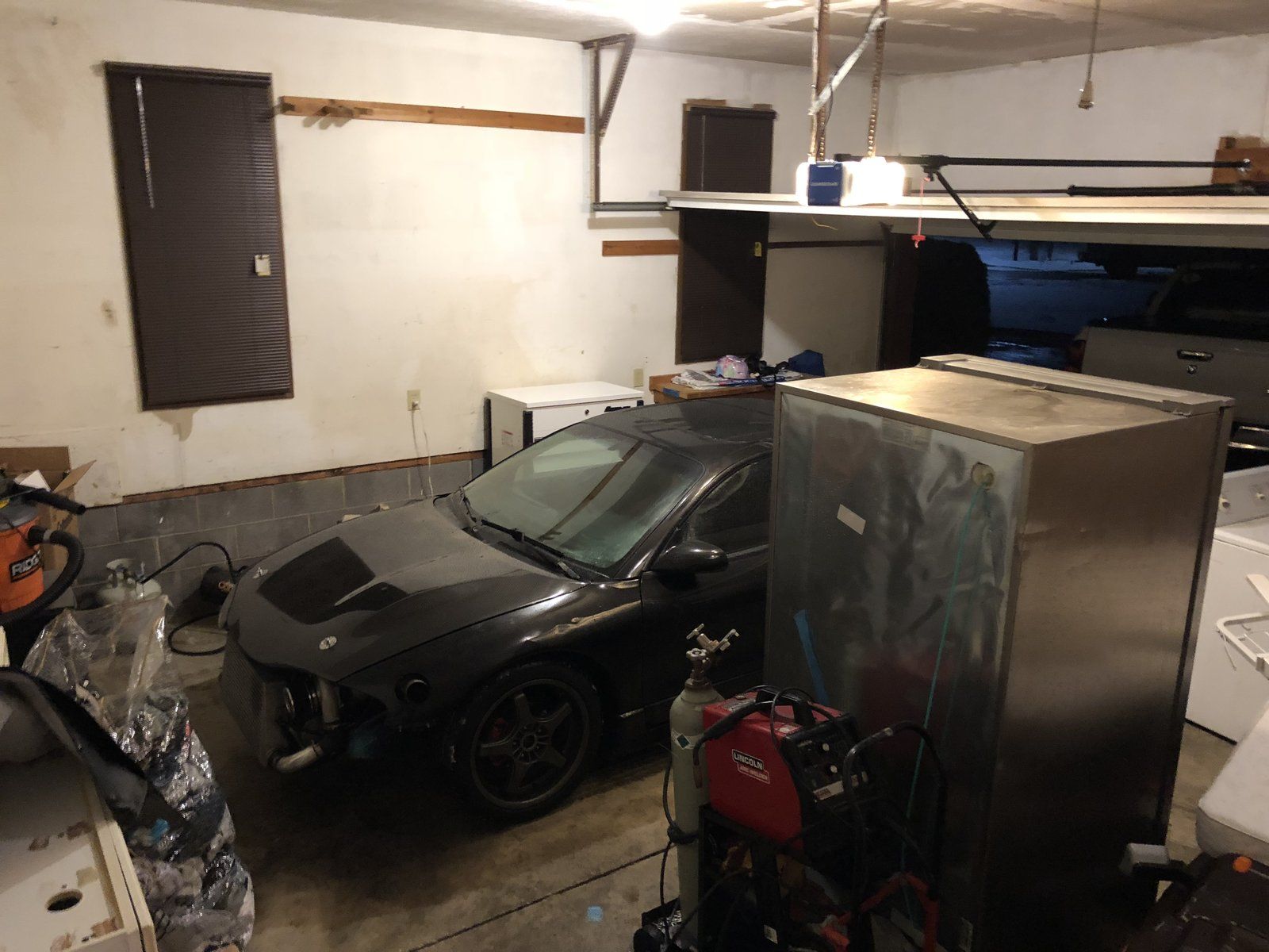

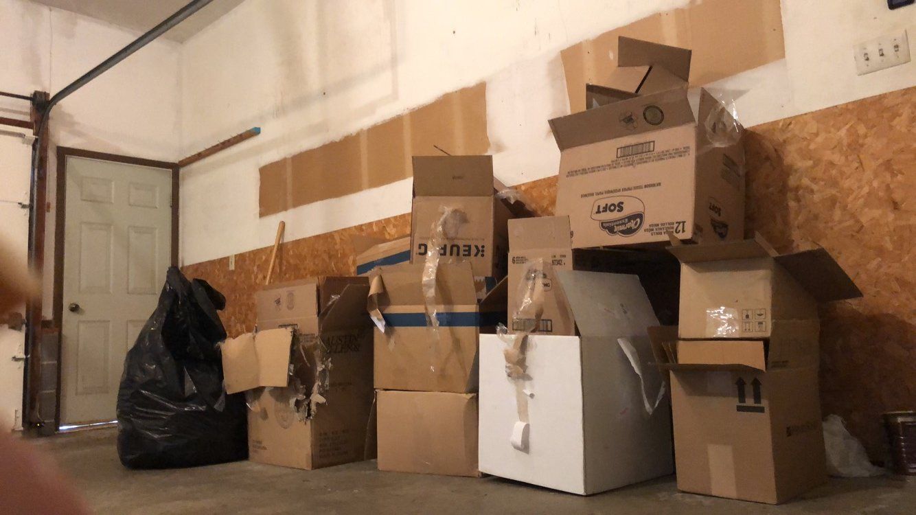

We moved into our new house over the weekend and I brought the 2g over yesterday. It was rainy, cold and crappy out but I managed to drive the car to its new home! All of this clutter is really bothering me in the garage but it will all get organized soon! feels so good to finally be out of that 1 car garage! We already started painting the interior of the house and I can't wait until spring so I can do some quick drywall work and paint the garage! Hopefully by next weekend I will have all my new garage cabinets up and start CLEANING!
BOXES EVERYWHERE, this is like maybe half of them haha
