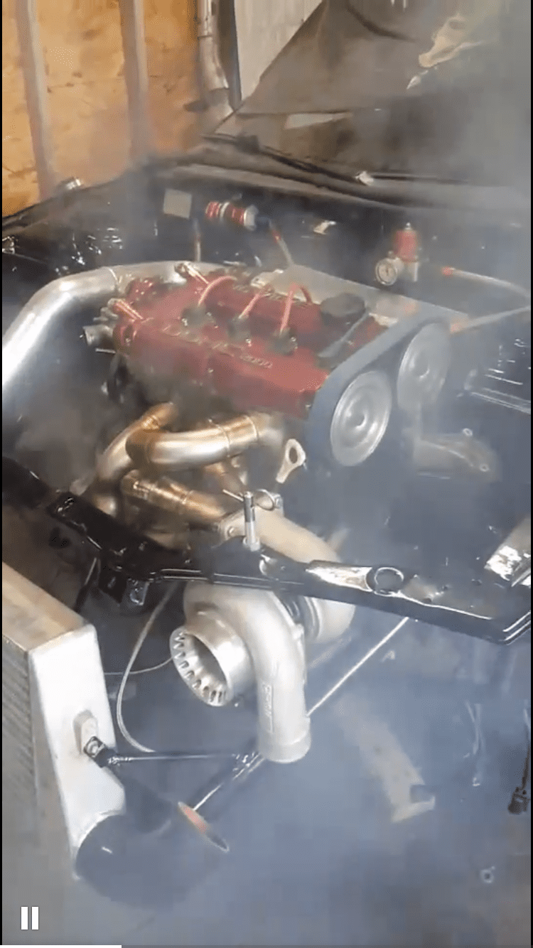

First of all WTFFF!? Got everything hooked up and ready to go, primed the fuel and oil systems, cranked the car over after 2 cranks it fired right up! HOWEVER IT IS STILL SMOKING.. New head from last year, new valve seals, new rings, new everything basically.. Somebody throw some ideas my way

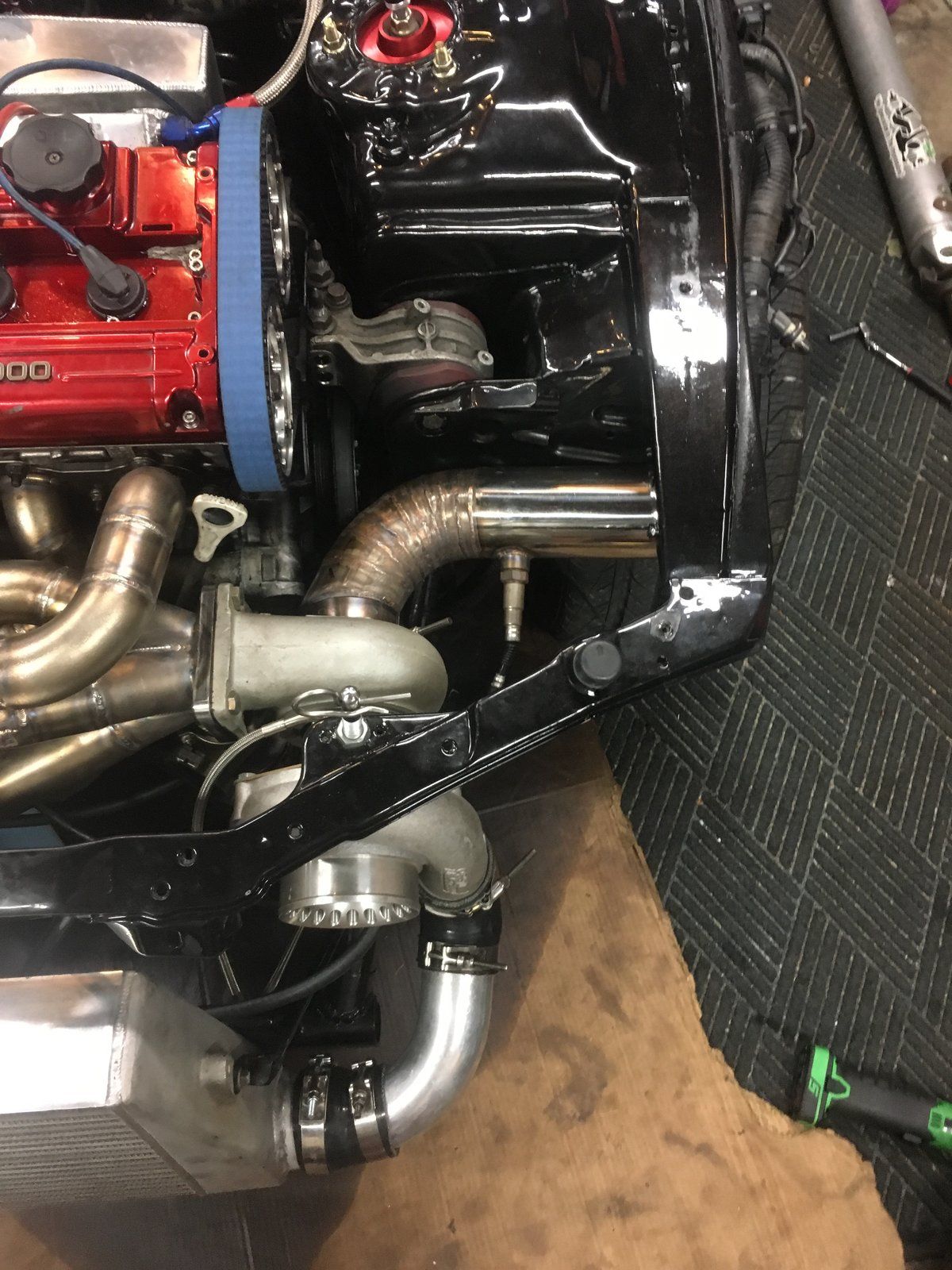

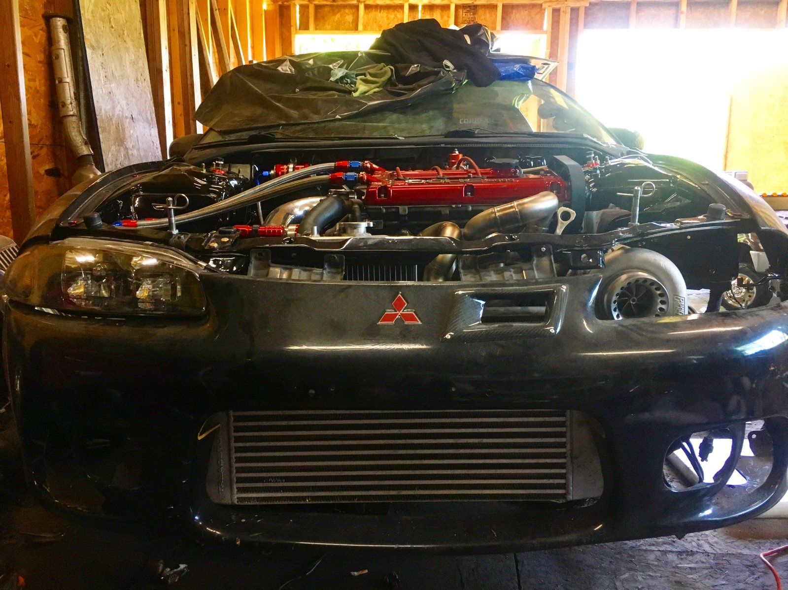

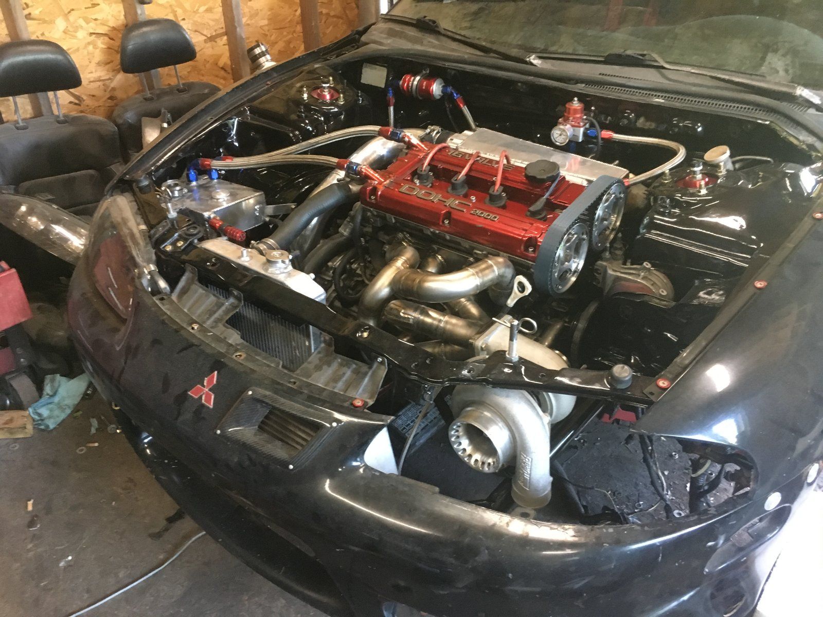

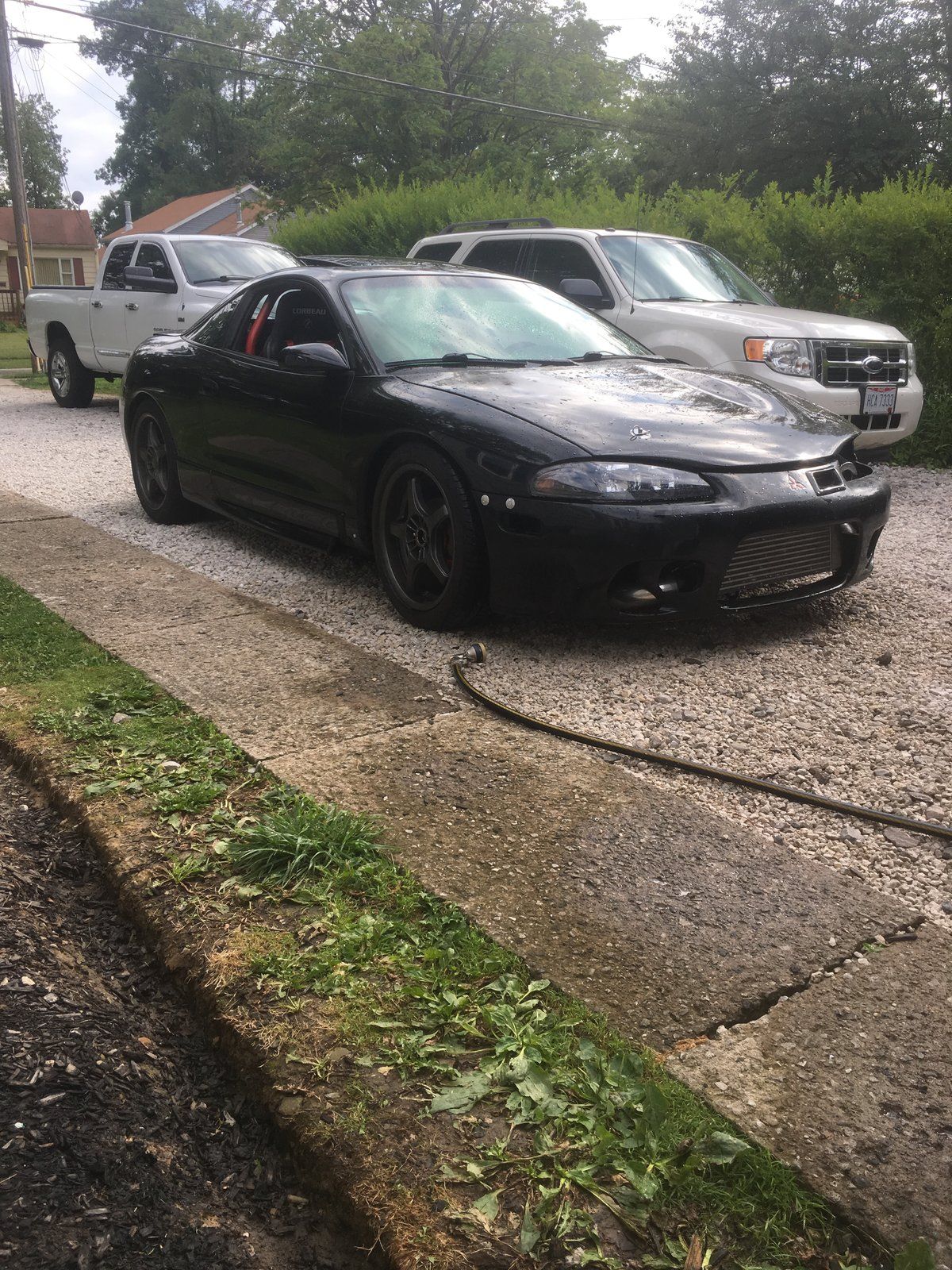

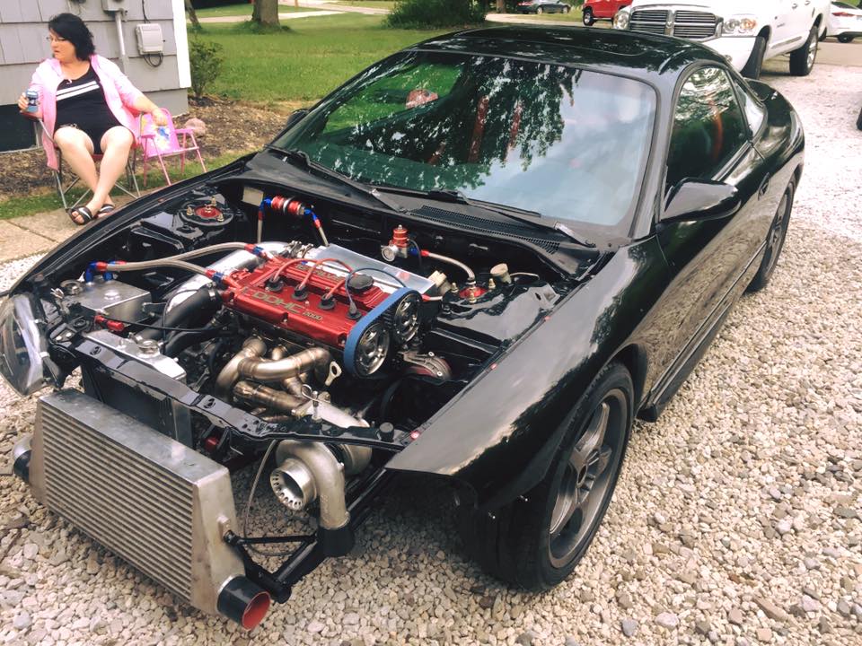

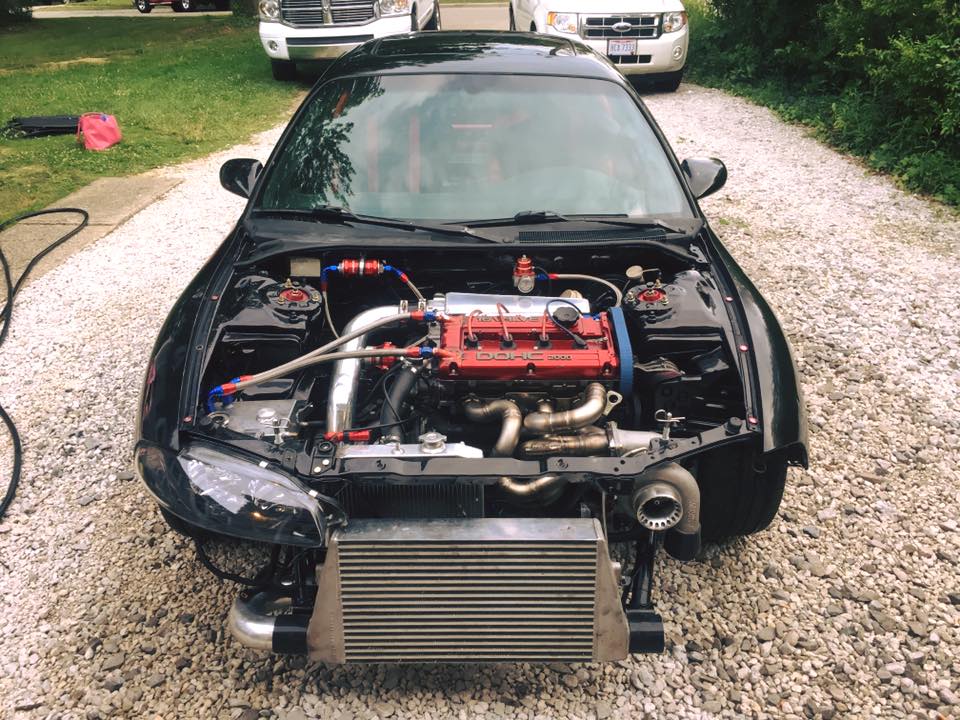

Started mocking up the bumper and headlights to see how much I have to hack the left side headlight and there wont be much headlight left! Obviously, the bumper is not fully secured yet

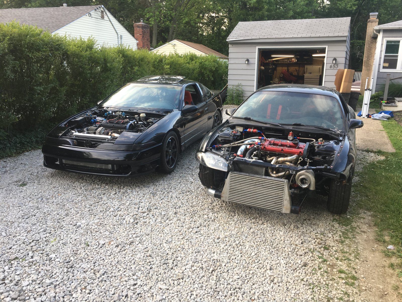

Got the car out of the winter storage shed/garage! Drove the car for the first time, with my handsome co pilot, up to the front to meet back up with Brandons 1g that stays at my house. First time these cars have both been running together in over a year! Well the glory last all of about an our then it was time to tear it back down.

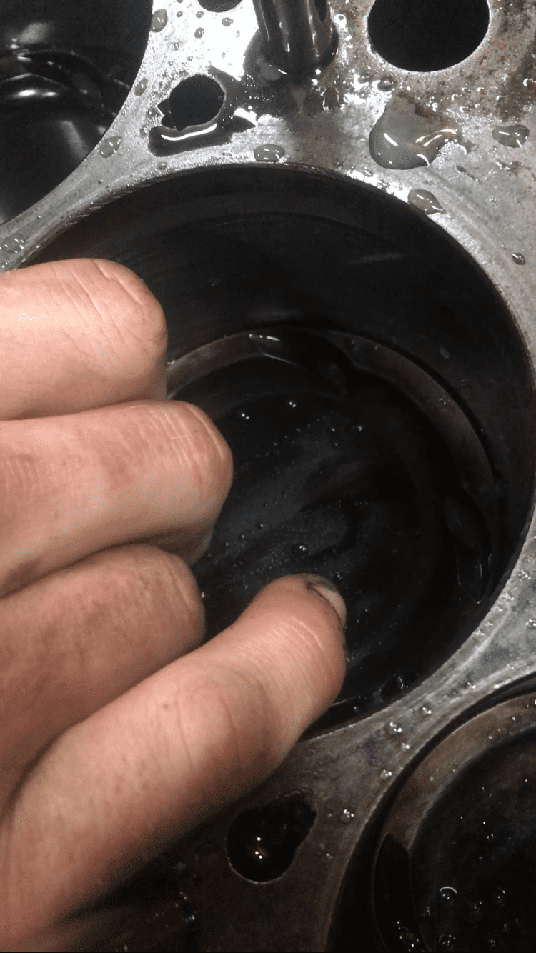

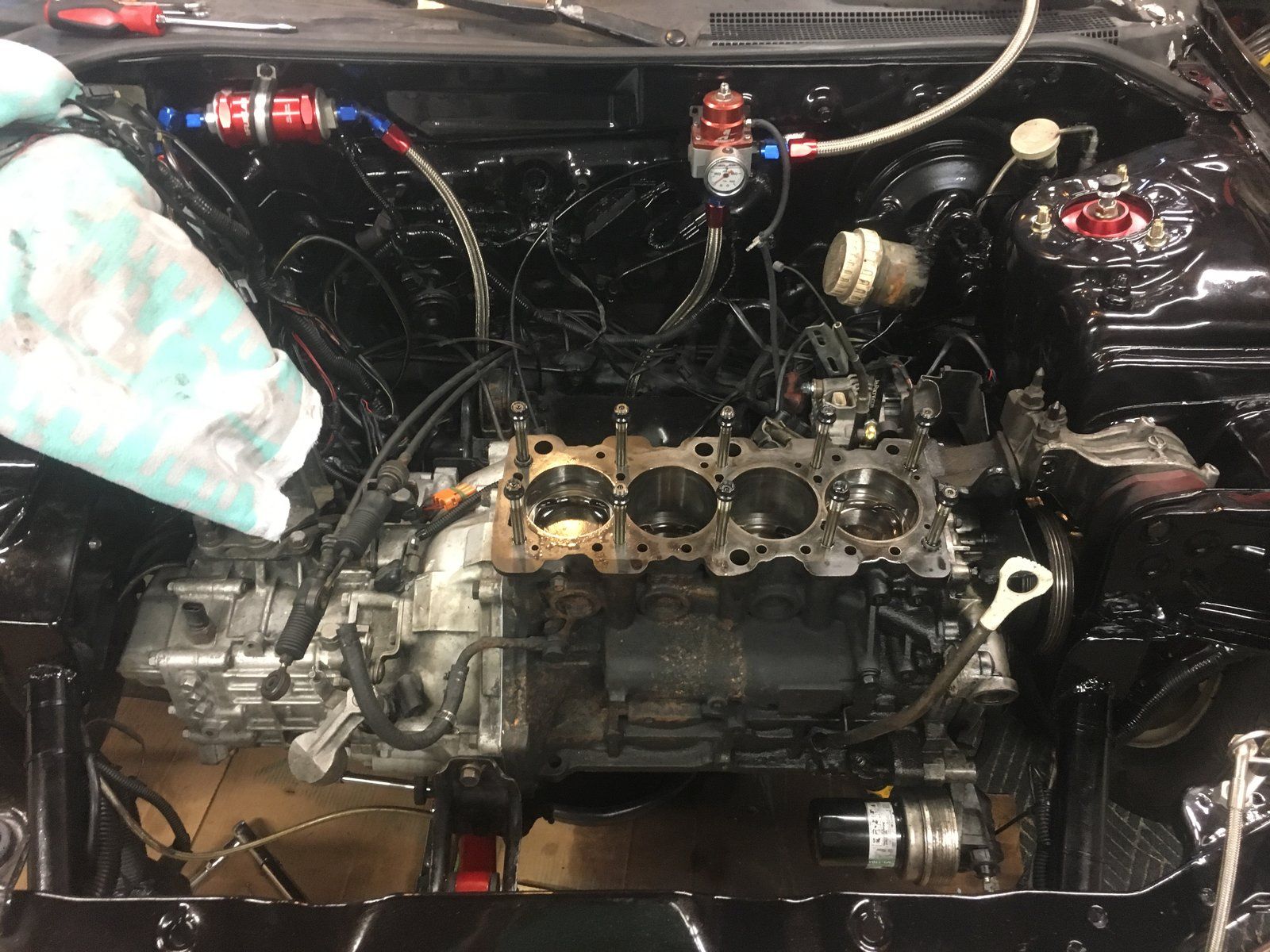

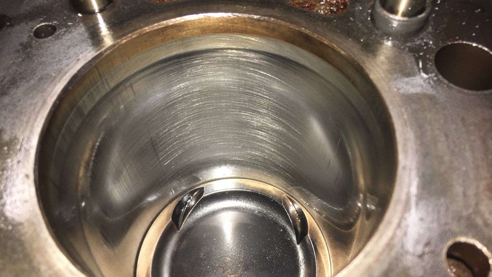

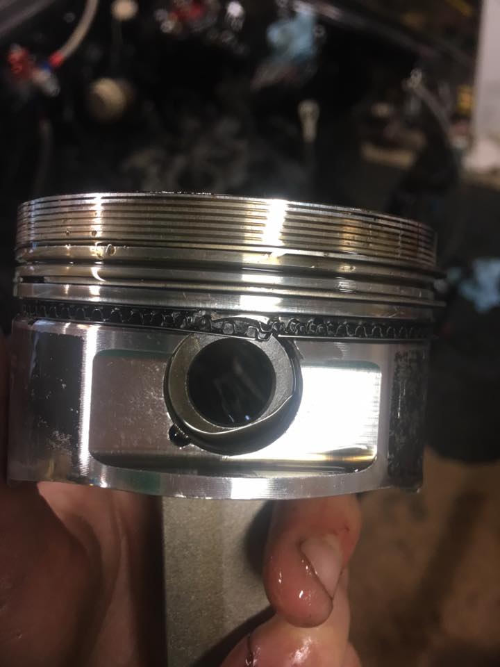

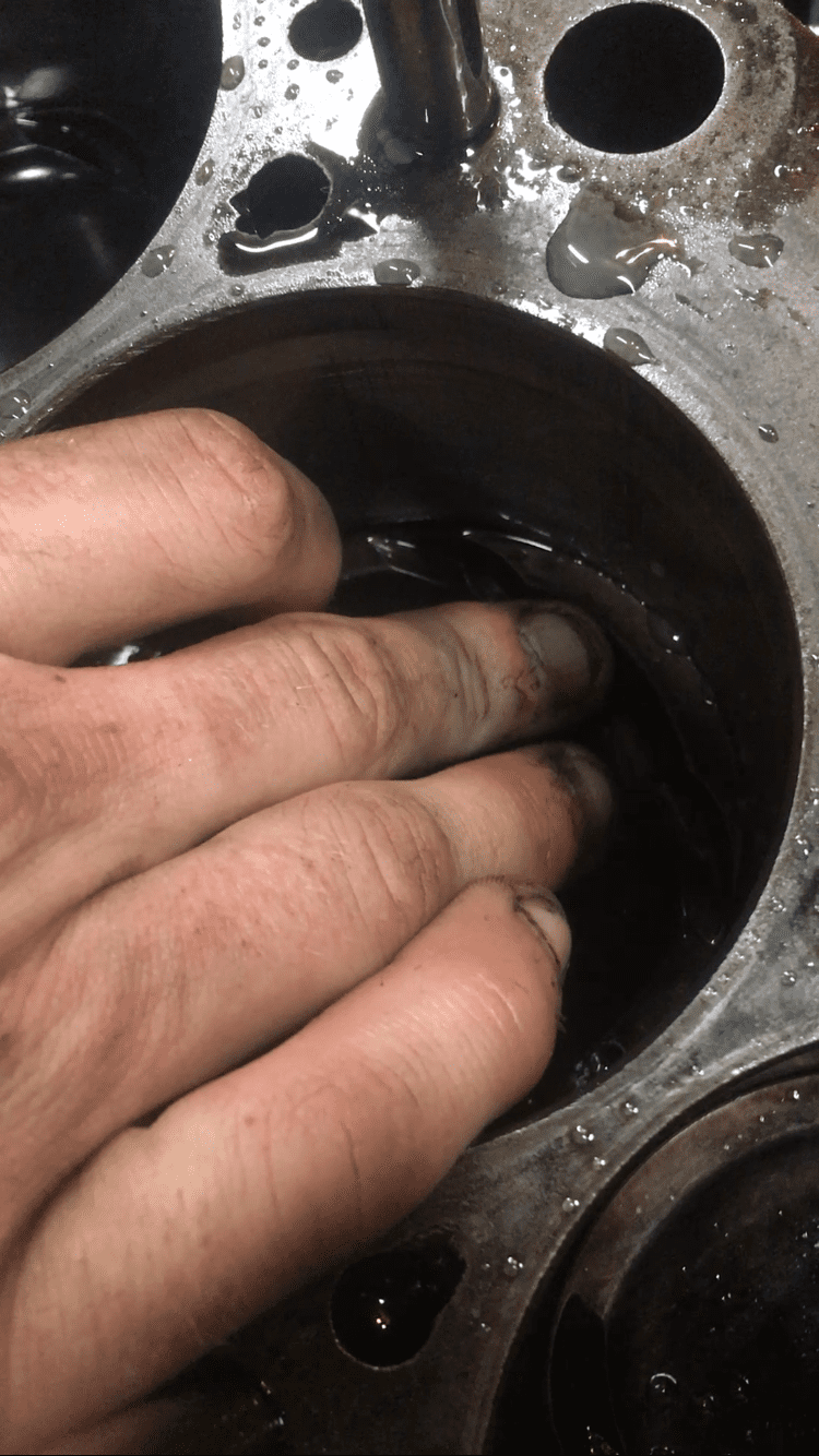

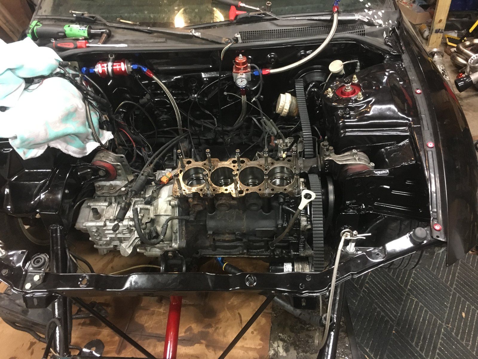

Ok, that was fun driving it, time to get serious. T-minus 2 or 3 hours later it was torn down and I found the culprit to the 2 year chase of my smoking issue. Since I cannot upload a video on here and dont feel like going through youtube.. I have screen shots from my video showing the PTW clearance that is extremely excessive. New rings will be here friday so HOPEFULLY by next week this car will be back on the road!!
Cylinder walls still look good at least!
**UPDATE 6/20/2017**
Tore the bottom end down and found some interesting things.. Cyl #2 which I knew was the problem child was in fact the culprit. New rings are installed, bearings lubed up and its back together again! hopefully......IT WONT BURN OIL NOW!
back together waiting on a head gasket
Man,you guys have some good taste in cars. However, I don't like the way that kids looking at me. Tell him to back off or we can race for pinks. Anyways, hopefully this thing will be running soon.

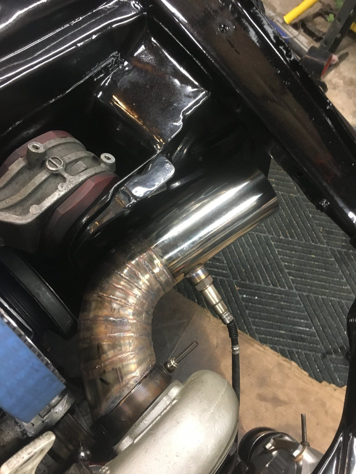

Took it out for the first car wash and a fun street cruise to make sure everything is going as it should. Found a small oil leak to address other than that everything is working as it should and its RIPPING(lower intercooler pipe was installed after the pictures haha)

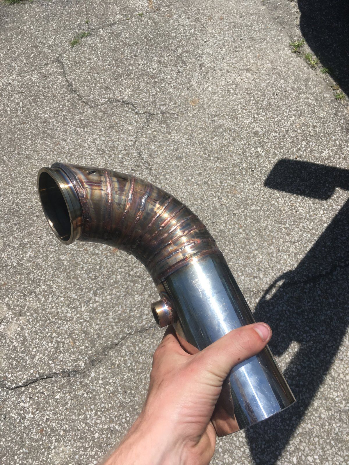

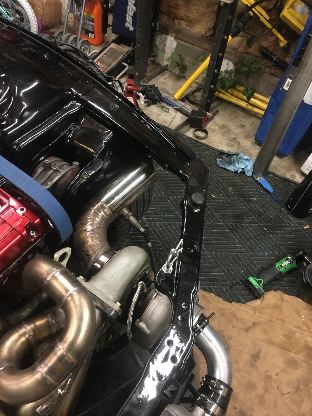

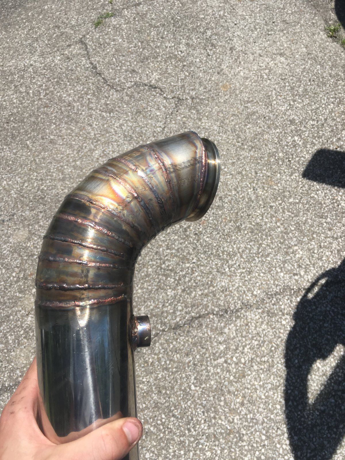

Got the exhaust finished up too!
Thanks man! The DP is currently exiting out of the fender. I am contemplating on keeping it that way and doing a teardrop cut out of the fender or making some more bends and make it dump out of the bumper. I forgot to take a picture with the DP installed, Ill get one tonight

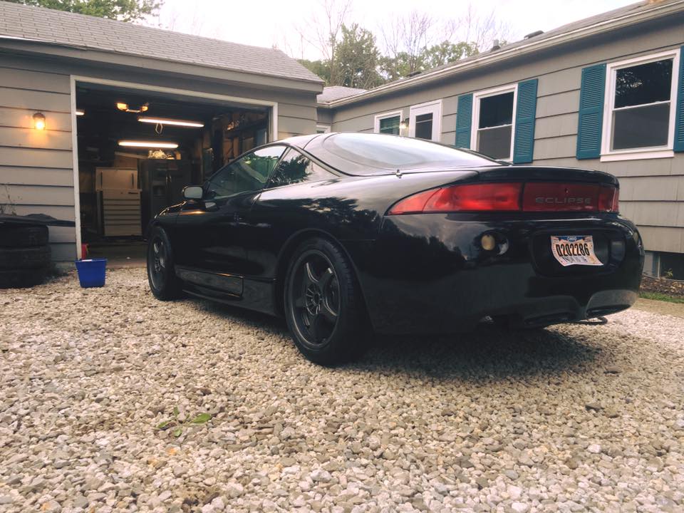

Took the car out for some cruising and dialing in the tune. Shes running strong and KEEPING COOL!!! Ran out to Dragway 42 over the weekend for the Slowmotion track day(didn't race) which is a 25-30 min drive and temps stayed 180-190 the whole way there any back in the 80+ degree heat! The goal is to test and tune at this track this Friday, STAY TUNED!! got my bumper(center bracket needs bent up to close the gap between hood and bumper) and fender on too!!

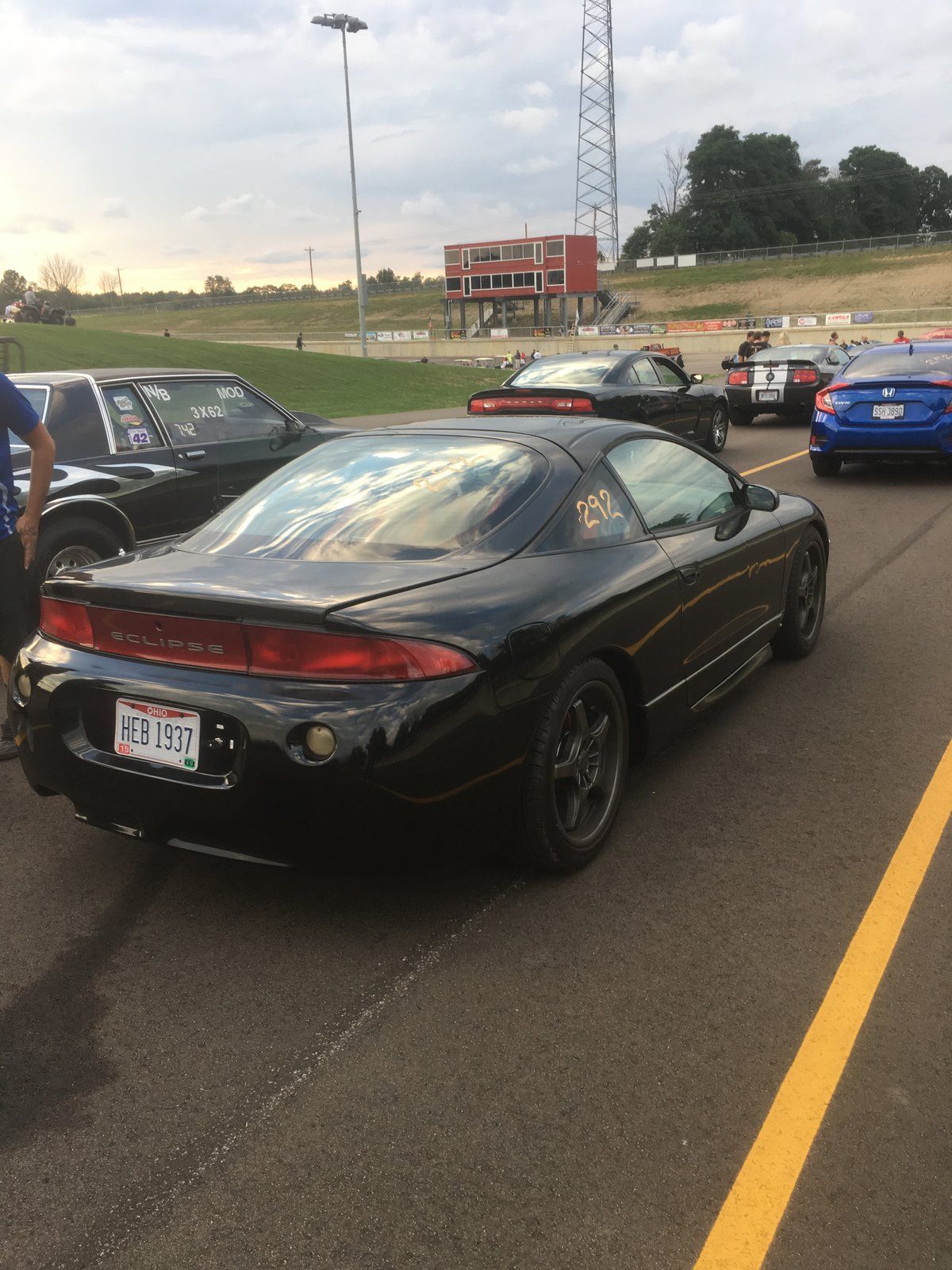

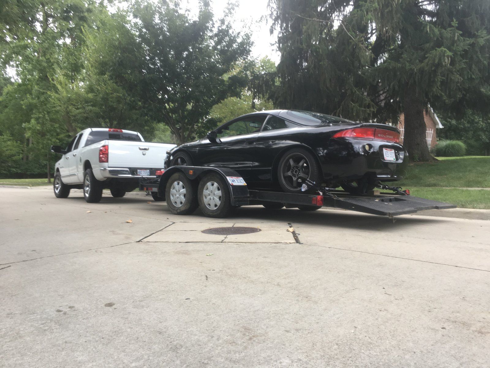

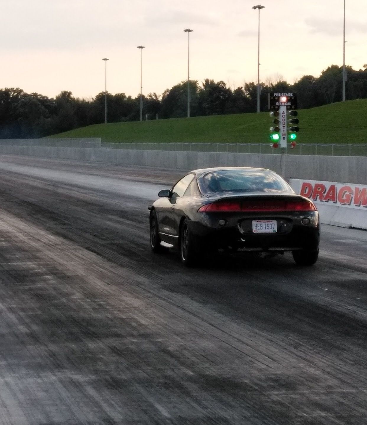

Got everything buttoned up, and loaded her up on the trailer to go racing last Friday and it was a huge success! This is on pump gas 93, 18" street tires and 32 psi fyi!
So the last time this car went down the track this car was basically 100% stock back in 2008 or 2009. It went 14 something at 99 mph.

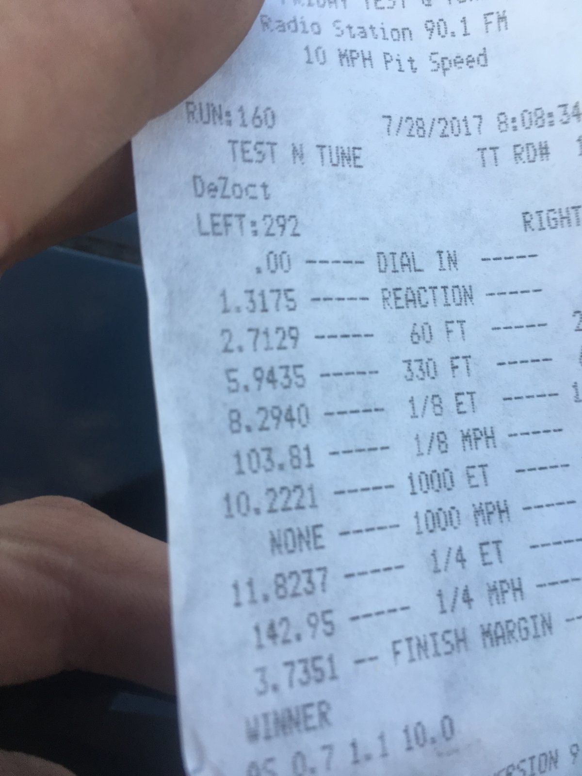

So the first pass I rolled out very slow just testing the car out grabbed a 2.7 60ft, 11.82 at 142.95! Was NOT expecting that!

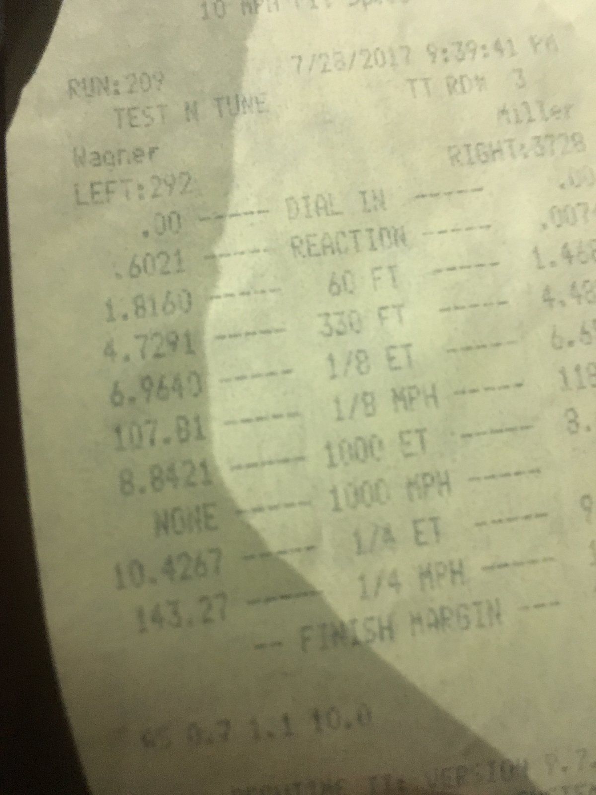

After some issues with the track I was able to only get one more run in before the night was up, this time around I launched it to a 1.81 60ft, 10.42 at 143.27! Second pass ever in the car and I brought it deep into the 10's! Bogged the launch then spun in first, grabbed second and it blew the tires off again, once I hit third gear and slapped fourth she was ripping!
Was very pumped after this being that the 10's came that easy! Time to dial this launch in and get that 9!! Loaded the car up for the night and nothing was broken! At least until the next day haha

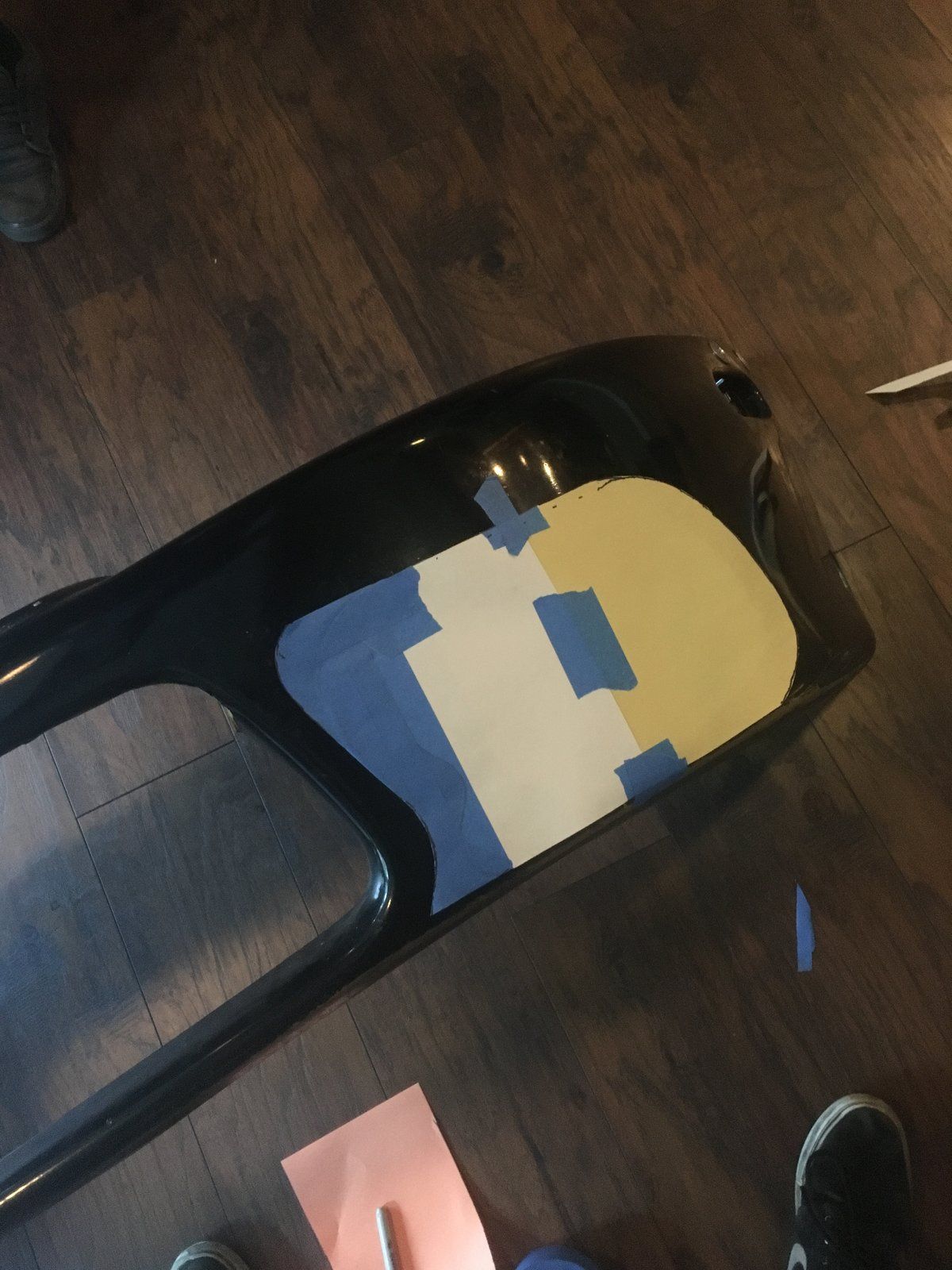

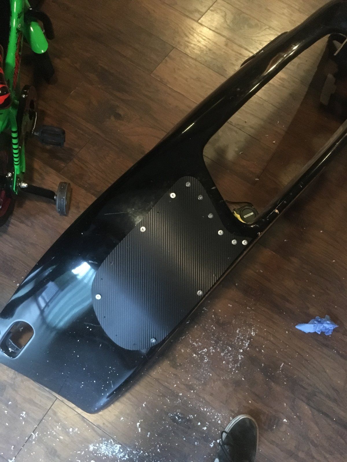

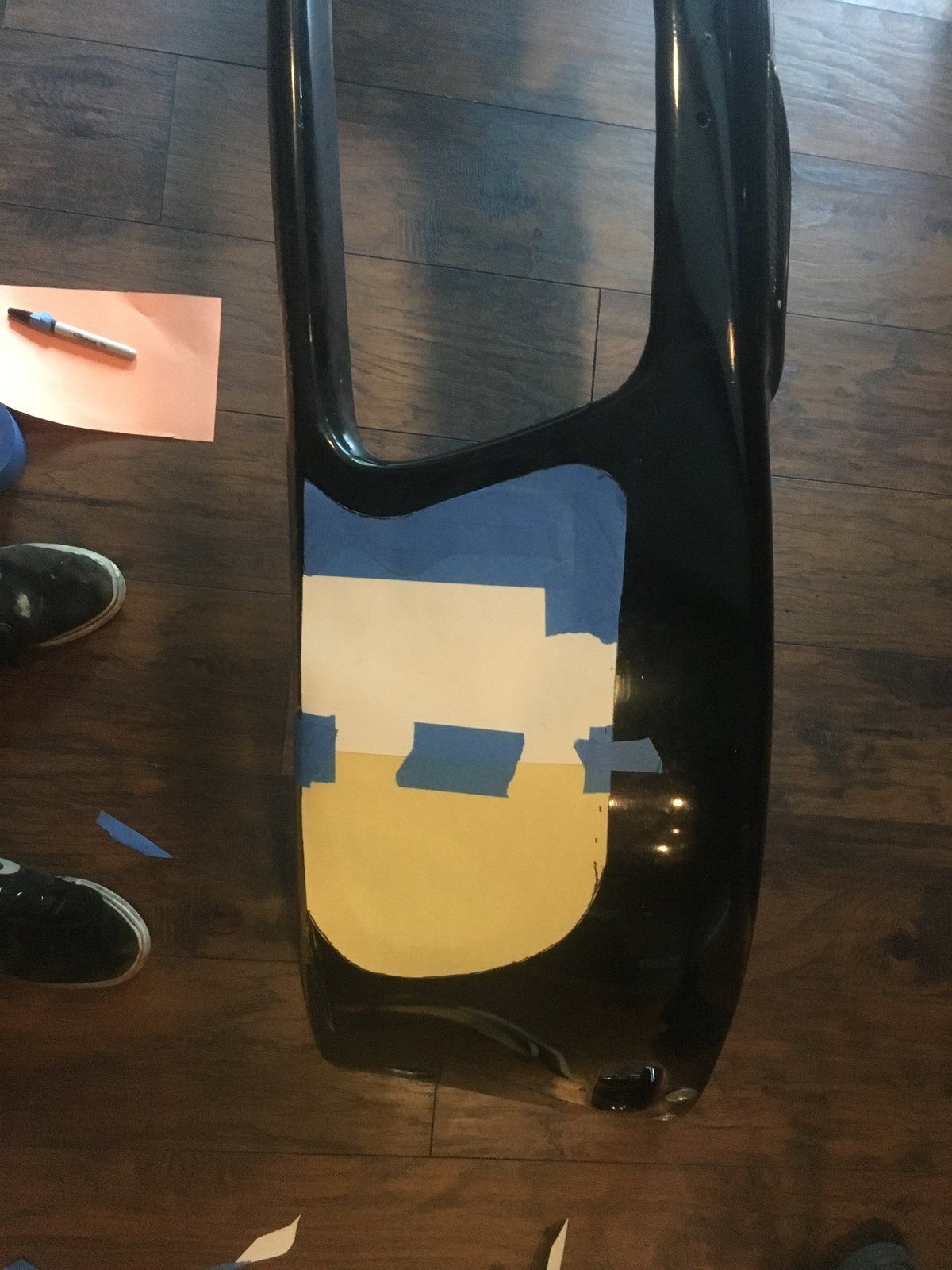

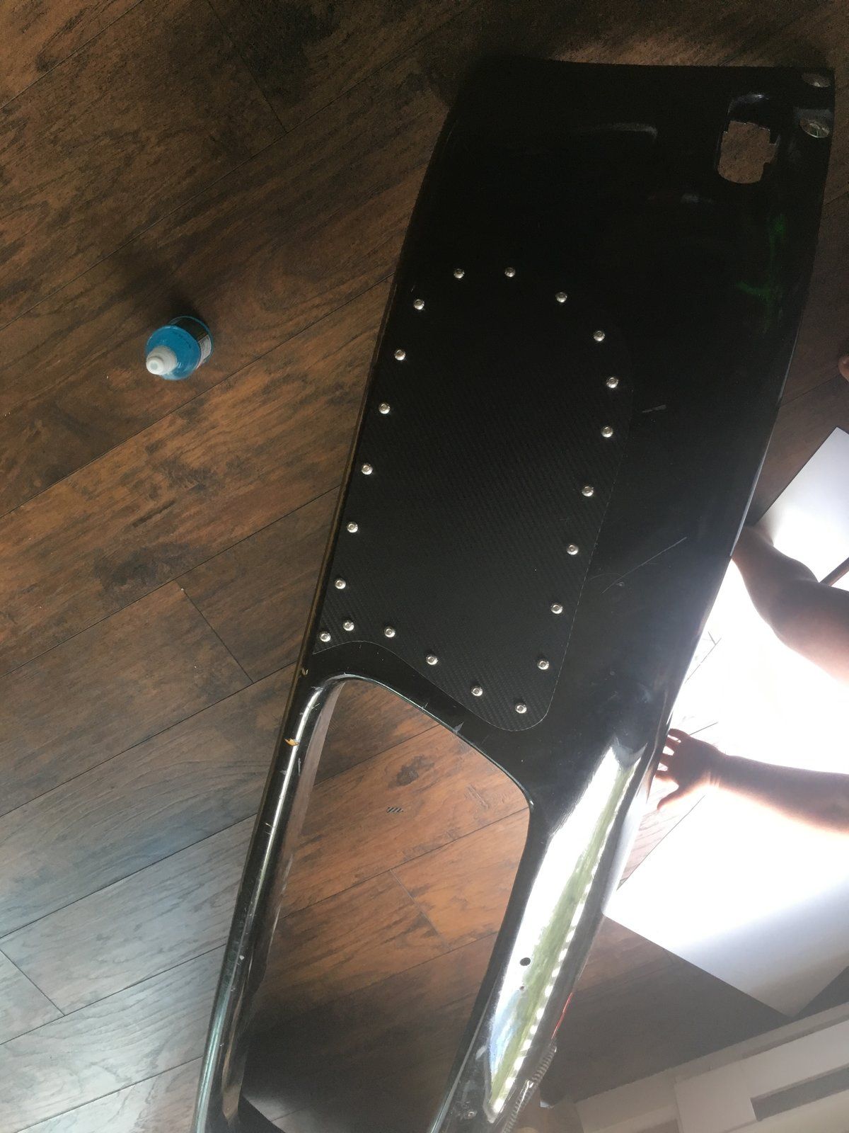

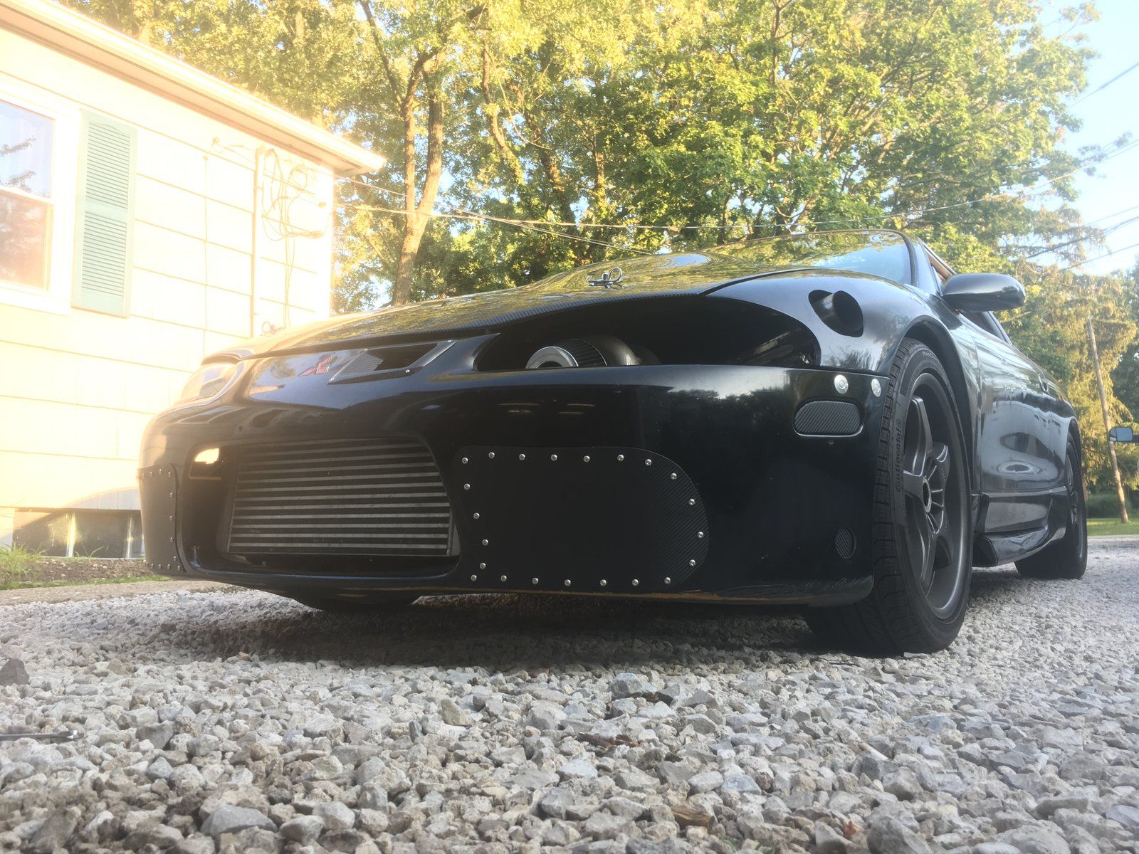

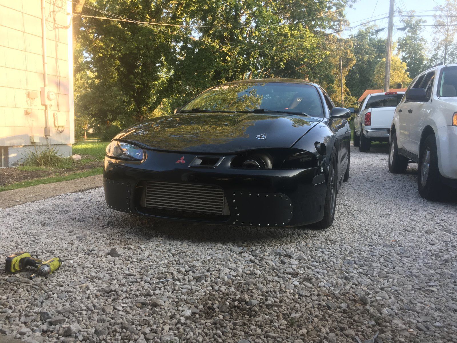

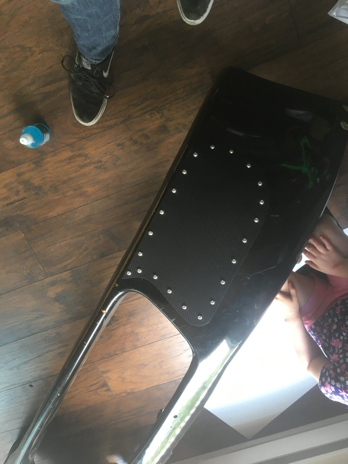

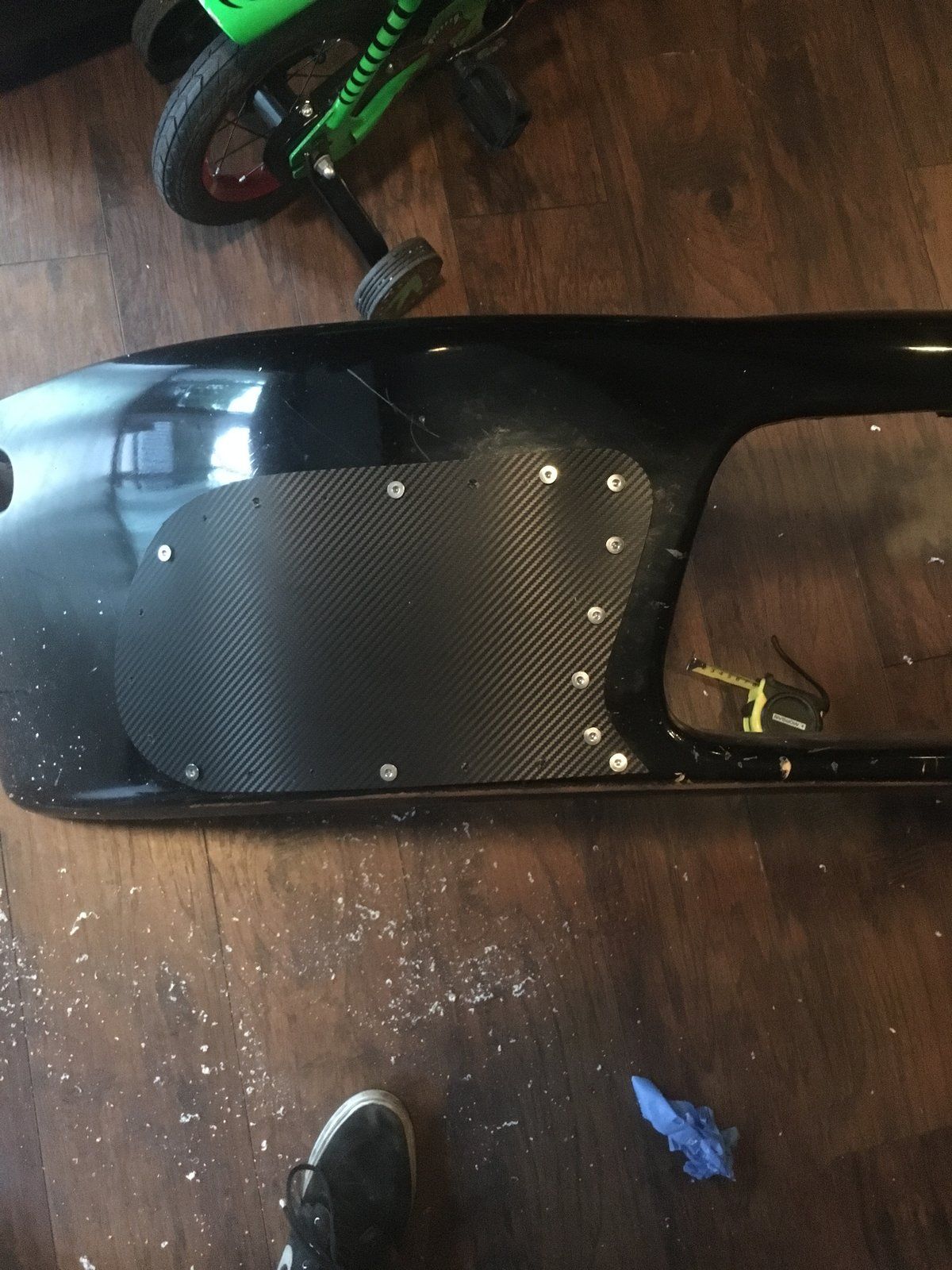

Finally started the project I've been wanting to do, BUMPER SHUTTERS! SO here is my DIY..
- 4'x2' ABS plastic sheet that is 1/16" thick - $22.00
- Carbon vinyl wrap - $10.00
- Pan head allen bolts - free laying in garage
(FYI the bolts in the picture are not the bolts that I will be using)

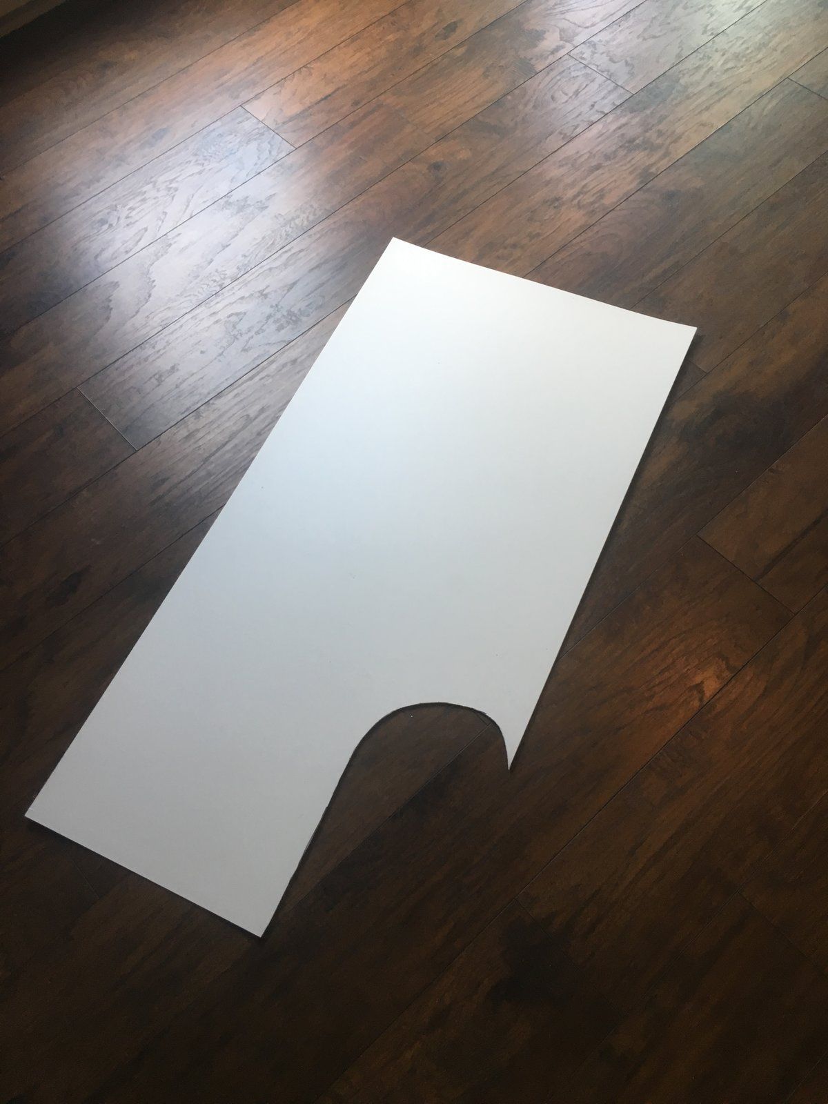

All and all I had $30 invested and I like the look of mine better than the angry aero ones even, pretty satisfied!
First I cut out a template using paper and masking tape, lay it out on the plastic and trace it. You can actually cut the plastic sheet with scissors so that made it 100 times easier. Tape the new plastic piece to the bumper and pucker your b hole to start drilling 22 holes! Lay the first plastic shutter on the sheet of plastic, cut out another one but reverse do the same process, wrap them and bolt em down!
Can't wait to get the new bolts on it and finish these!

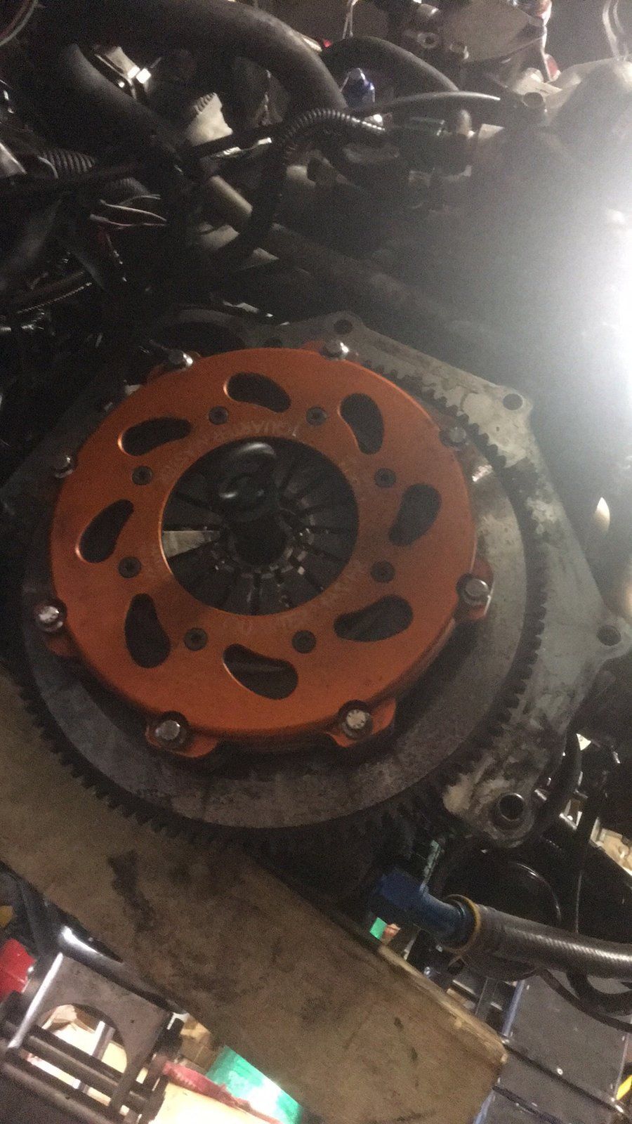

Had a very stressful weekend with the car. I know that I shouldn't have went racing Friday but the inner me that wants 9 seconds overtook the obvious thing to do. So...recap

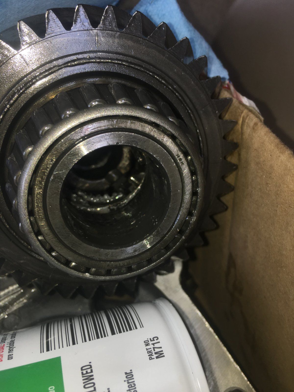

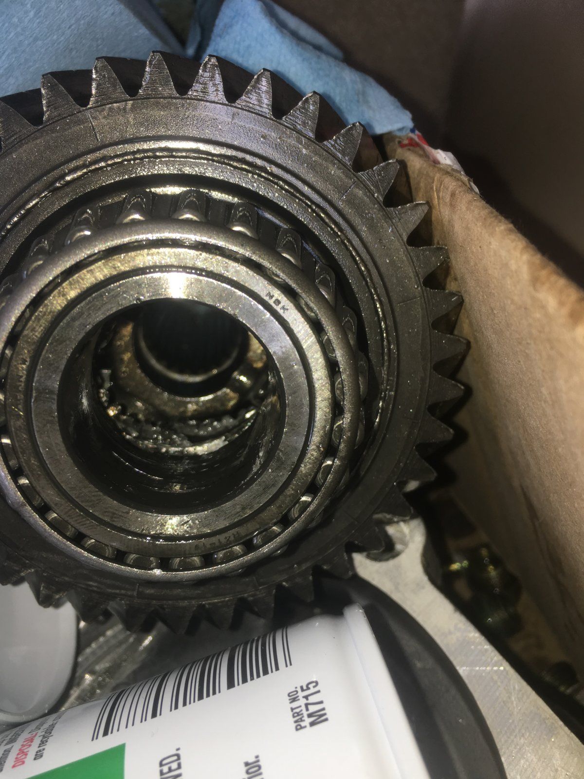

Friday- Went racing on the first launch I broke something I thought the tires were spinning so I stayed in it and potentially did more damage, once I realized something was wrong I let out and coasted to a 15 something at 70 some mph. New slow record haha. Seemed like the clutch was slipping..bad. So I get home and start ripping it apart got the trans and clutch off and it seemed like the clutch was smoked. By now its about 2am.

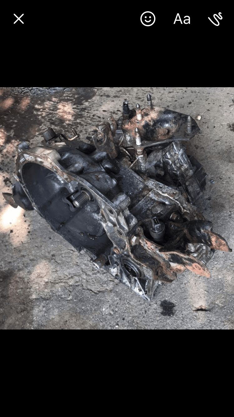

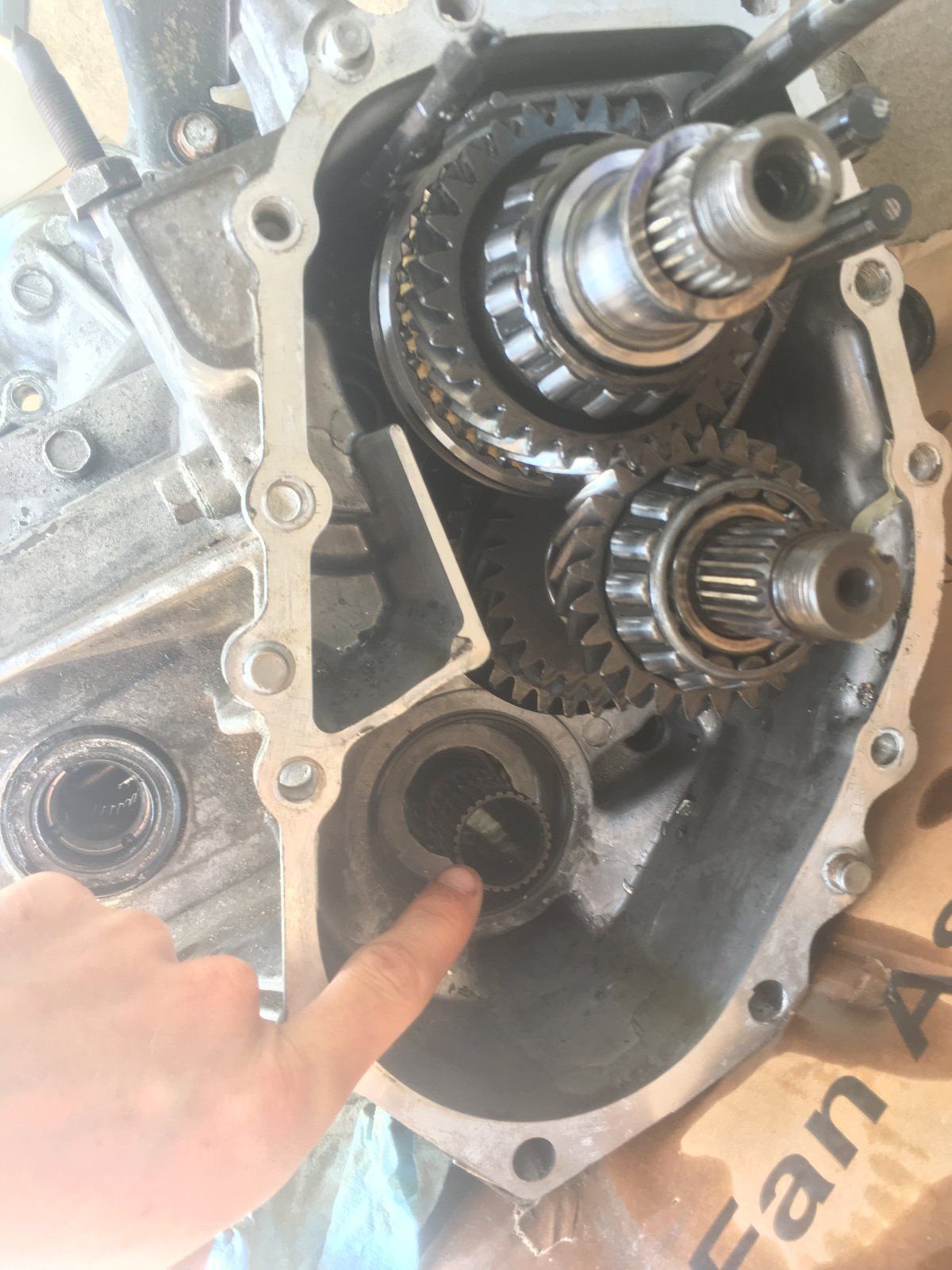

Saturday- Put my old 2600 ACT clutch in just so I can make it to the dyno event on Sunday. By the time I got the new clutch in it was about 1pm or so. Go to take it out for a test drive and its doing the same exact thing. Boom, figured it HAD to be internal on the trans. Pull it back into the garage and within an hour the trans was back out and I was headed 45 minutes away to a buddies house who is great with these transmissions and was going to weld the center diff. Mind you this trans was 100% stock with an open diff. Get to his place by 7pm or so we start tearing the trans apart to find this. Center diff was exploded, output gear was destroyed and chunks of metal were throughout my entire trans. So now the hunt was on for a new one just to make life easier. BOOM, found one in Akron(50 min away from me)
Sunday- Make the drive out to Akron, get there around noon(I am scheduled to be on the dyno at 4:30) Get to the guy selling me a trans only to realize the trans was junk.. So at this point I gave up trying to get my car on the dyno.

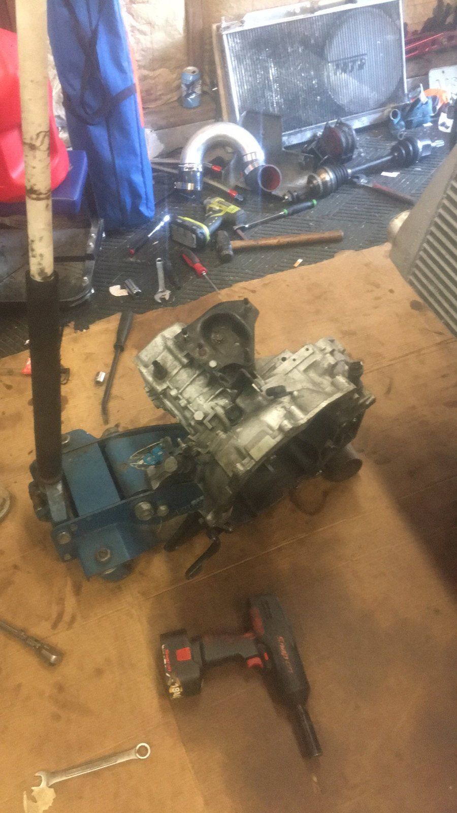

Monday- Sourced another trans about an hour away from me
Tuesday- Picked up the trans, cleaned it, put my quarter master 8 leg twin back on, put the new trans in and VOILA it shits doesn't slip anymore and shifts clean through all 5 gears.

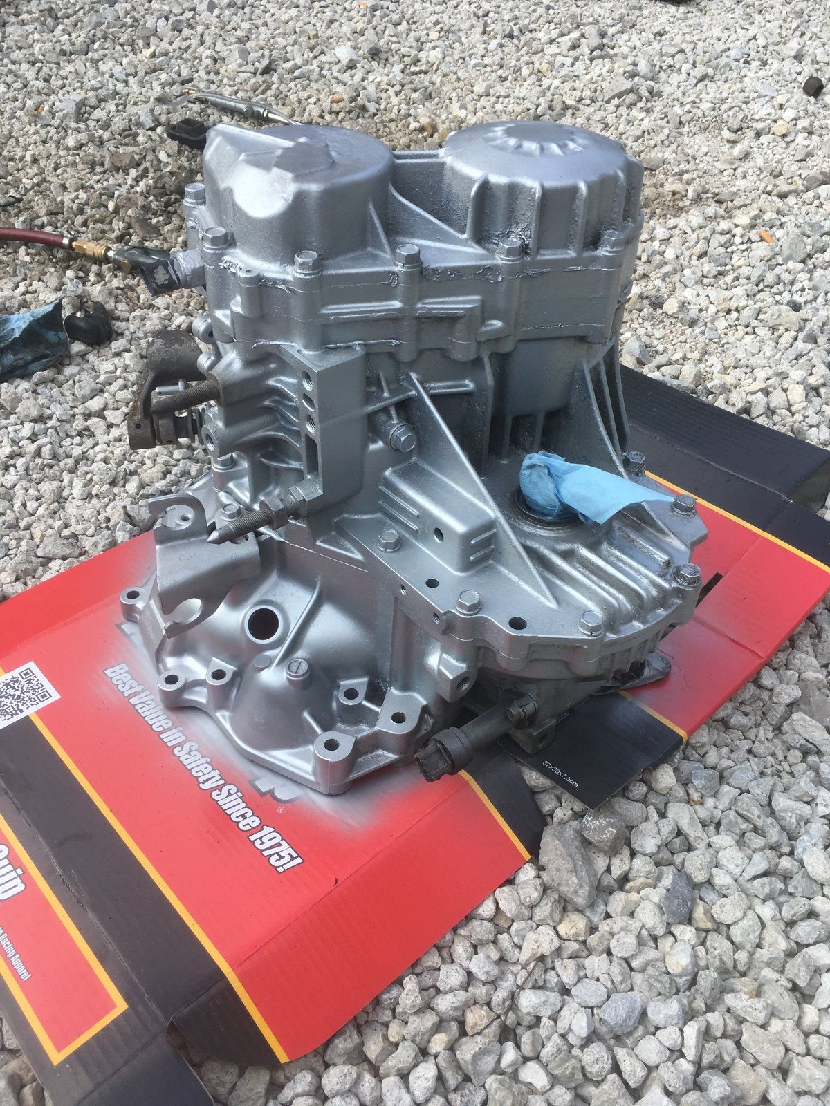

Old blown trans
New grimy trans
Lot of elbow grease and some fancy spray painting goes a long way
Mounted the twin back up
Back in the car Tuesday evening and good as new
