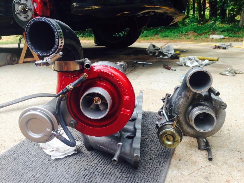

As of 6/7/14 my dad and I did a complete auto-to-manual swap on it, and also installed a new TD05H 20G from JusMX141. So far its running very well with no issues at all from the turbo, and only a few remaining issues from the trans swap- it's been slipping out of reverse on an incline, and it is having a tough time starting because the stock flywheel I got from the junk yard had a lot of teeth worn down that had to be re-shaped. As a result, it takes a minute for the starter to get a nice hold of the flywheel. All issues will be fixed eventually.

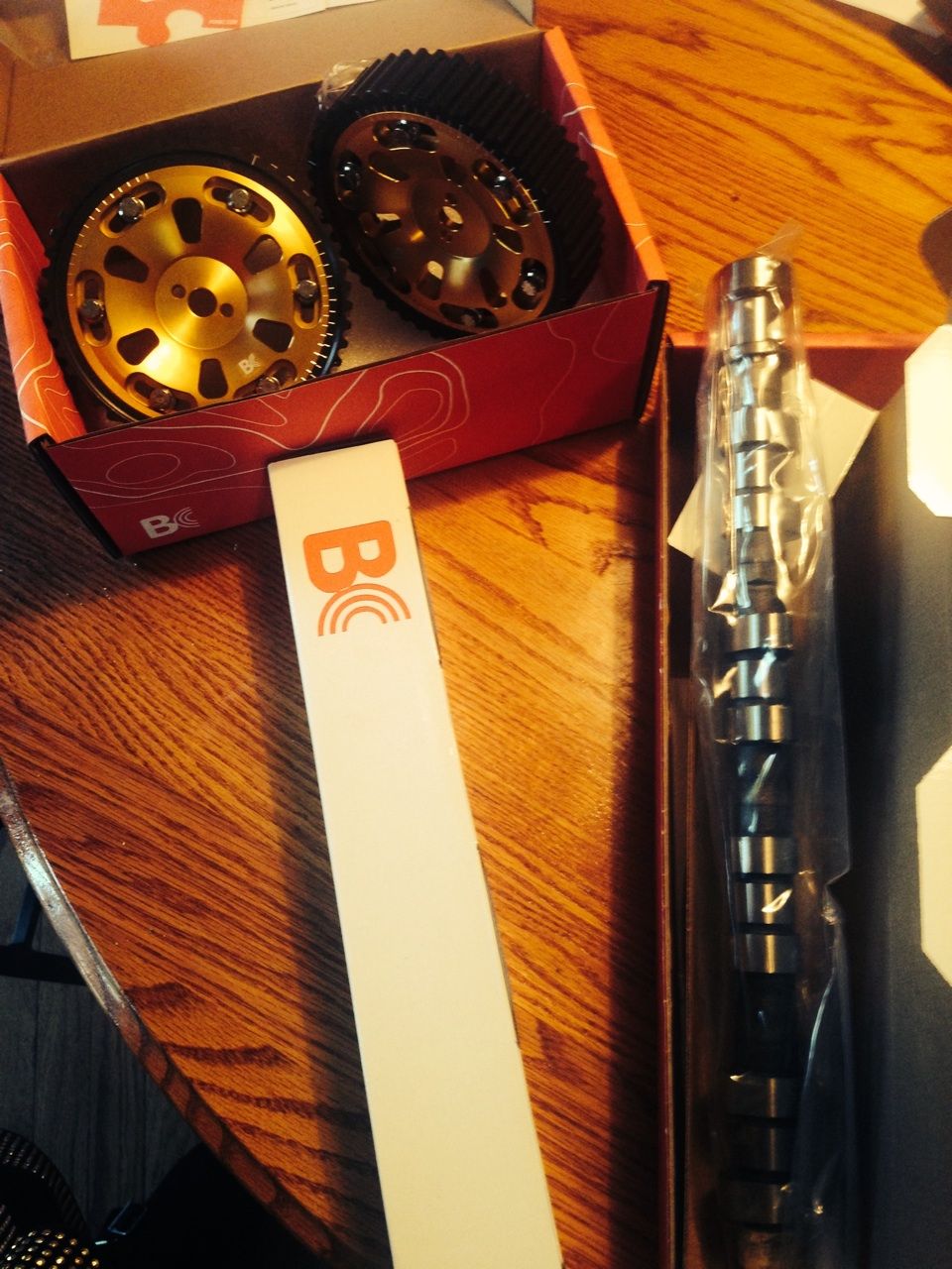

My new Brian Crower 4g63 cam gears and stage 2 BC272s came in today!!! I am so very excited to install and review them! Special thanks to Brian Crower himself for sending these parts my way to help me on my tuning journey, and also a special thanks to KelTalon for making it all possible! I am so grateful that there are people like them that will lend a hand to help someone when they are starting out. The words "Thank you" seem so inadequate. I am so humbled and thankful!

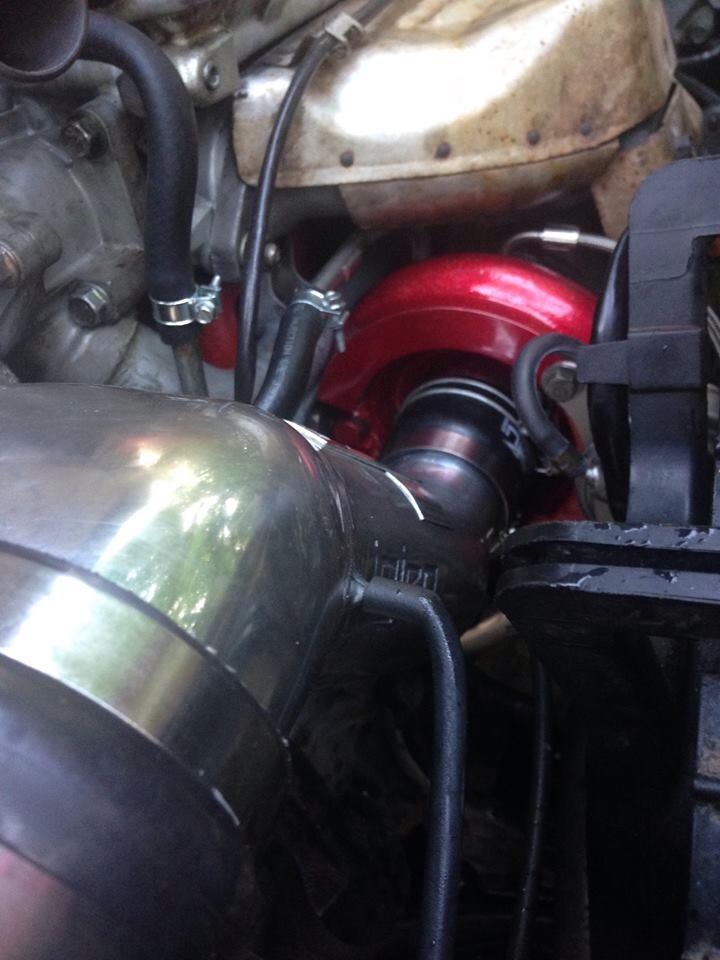

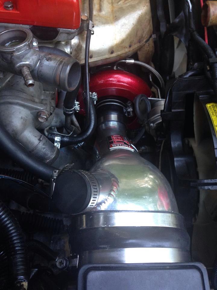

Just recently figured out how to post on here (newbie). JusMX141 kindly custom built me an awesome 20G turbo to help me out on my tuning journey, and I must say, it is a HUGE improvement from the T25 I was running! It spools up very quickly and I couldn't be more pleased with it. :) Thank you so much Jus!!!

Turbo looks awesome on the car! I was hoping that elbow coupler would clear the front roll stop mount on the trans so you could get it hooked up to the stock sidemount *temporarily* to get the car mobile until you find a FMIC you like.
Well congrats on some major upgrades! I am looking forward to seeing how you like the cams and if I can be of assistance don't hesitate to let me know! By the way car looks amazing:applause:

Are these cam gears and shafts safe to put in ASAP? And if not, what do you suggest I do first? :)
Looks awesome on the car! I was hoping that elbow coupler would clear the front roll stop mount on the trans so you could get it hooked up to the stock sidemount *temporarily* to get the car mobile until you find a FMIC you like.
