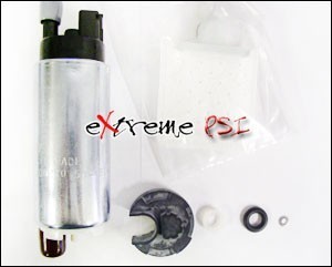

Oh i see, I'm definitely gonna type that in, I've actually been looking at this one
It's says it's pretty much plug and play and it says i don't need any other aftermarket parts, i'll be doing some more research before i purchase
You shouldn't need anything aftermarket for that 190 other than the rewire I talked about earlier.
A 190 doesn't pump enough fuel to burst the stock fuel pressure regulator diaphragm on your fuel rail, so you shouldn't need an AFPR.
Oh ok i see, the only thing is i don't see is the wiring kit, it doesn't seem included but it is included in the 90-94 kit . Also, do you have any experience with this website? Is it trustworthy? It seem legit
