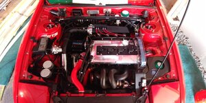

On my forge recirculating bov, the measurement for the outlet is a little over 1". On my injen intake pipe the recirculation hose is slightly bigger than 1.25". Recommendations such as a 1 1/4" peice of radiator flex hose won't work because it's too big to go over the bov. Is the stock peice 2 different sized ends as well?
