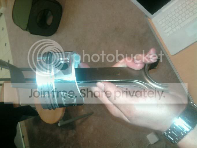

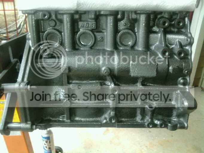

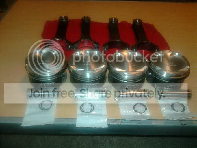

So its been a while since my last post. I have just been waiting on machining and all the little loose ends to come together. I started building everything this week and I am pull the old motor out tomorrow. I have only had one problem so far :pray: so I hope it stays that way. The wrist pin bushing eagle sent me were for 6 bolts so I had to get the new bushing honed out for 7 bolt (22mm) wrist pins. My buddy at street and strip in otsego did it over night for me. Thanks man.
Sooo lots of pics of what has been going on since last time..

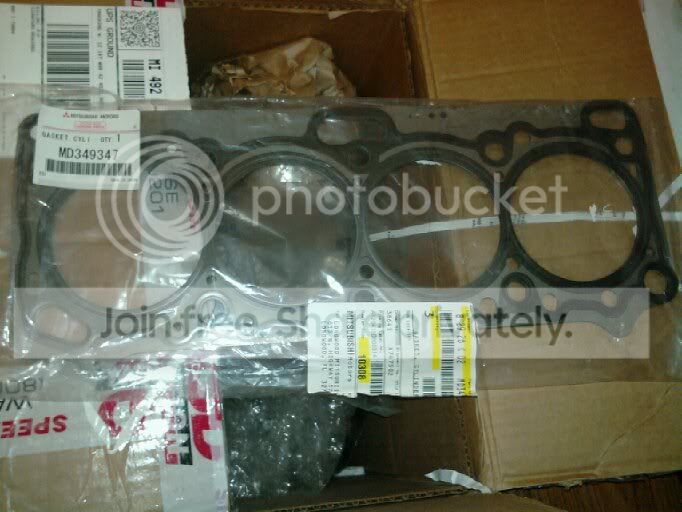

My mitsu MLS
Prothanes

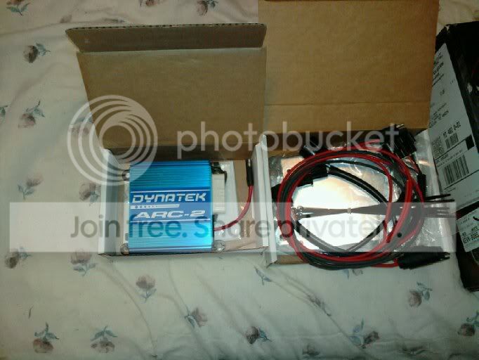

Dynatek CDI ARC 2

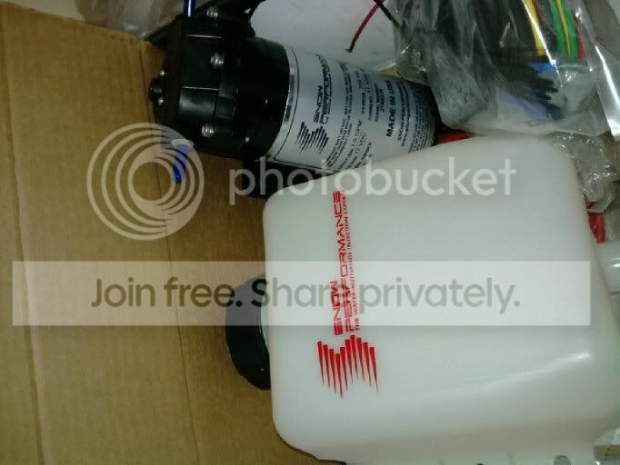

SNP Meth stage 2 kit

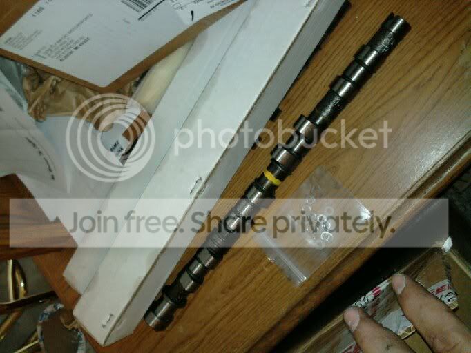

strictlyimportmotorsports.com SIM 275 grind cams

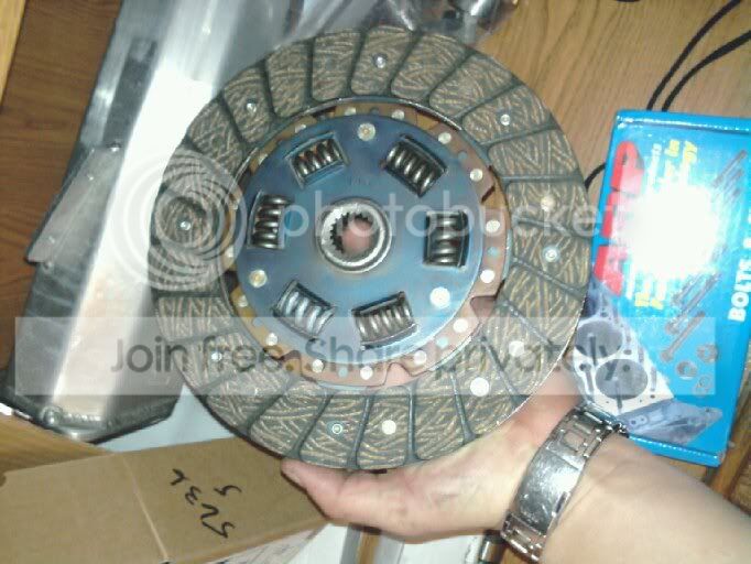

South bend clutch OFE disk going in with the act 2600

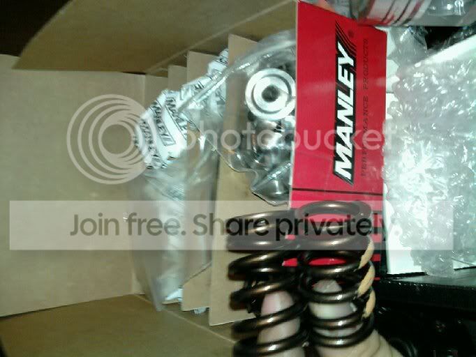

Manley titanium springs and retainers

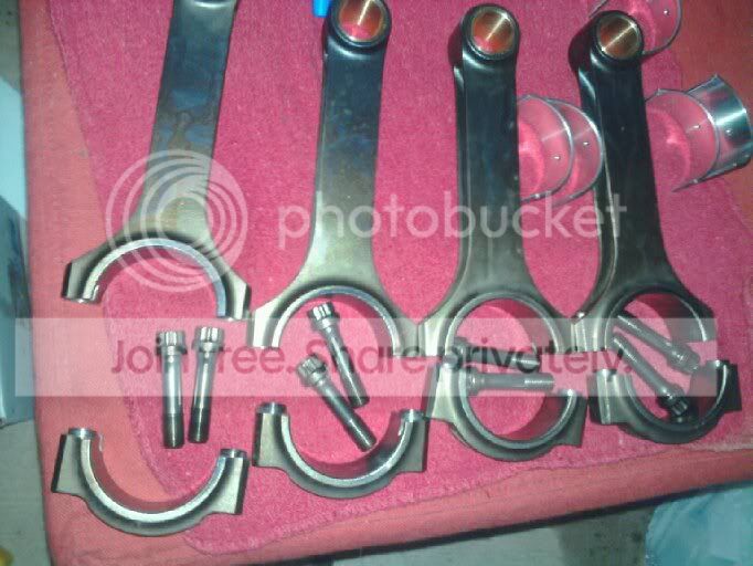

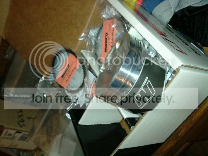

My wisecos

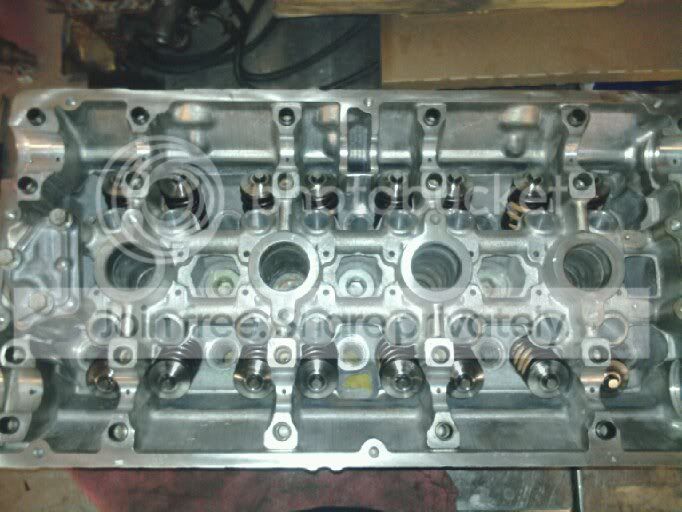

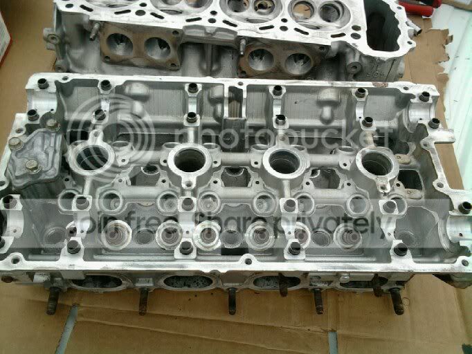

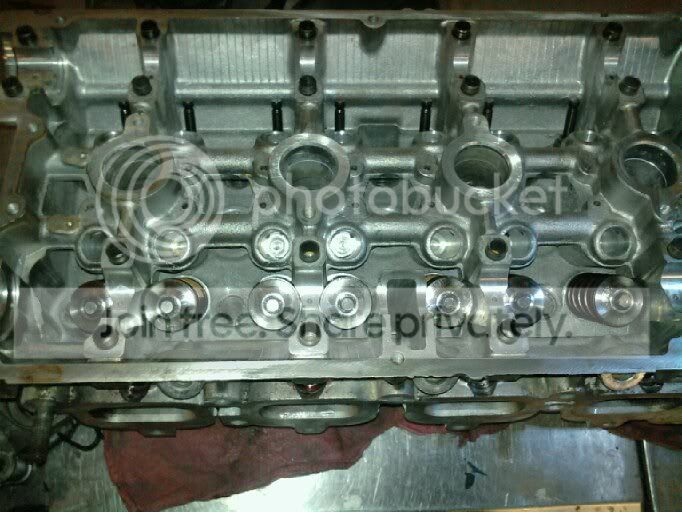

Machined head with new valve stems seals, blasted valves
Installing springs
Springs done

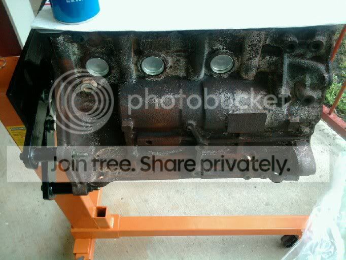

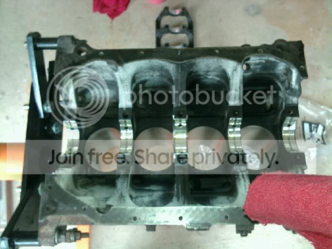

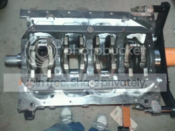

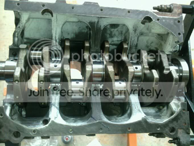

Block preping and plasti-gauging..

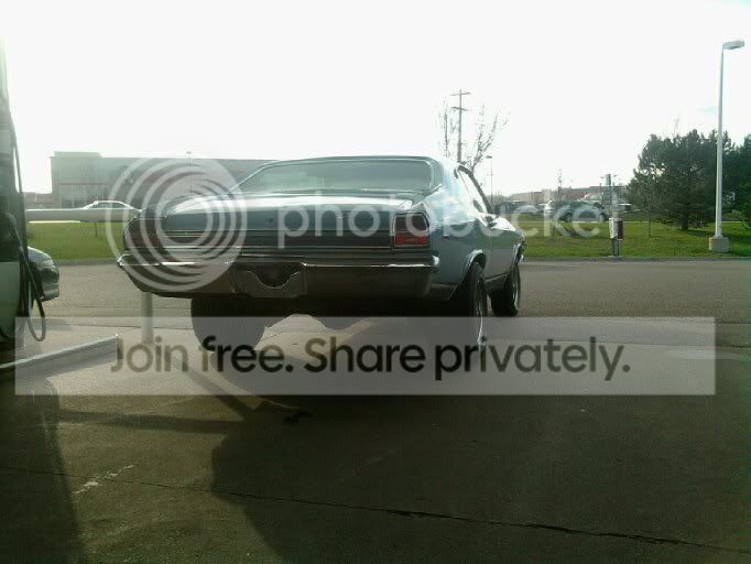

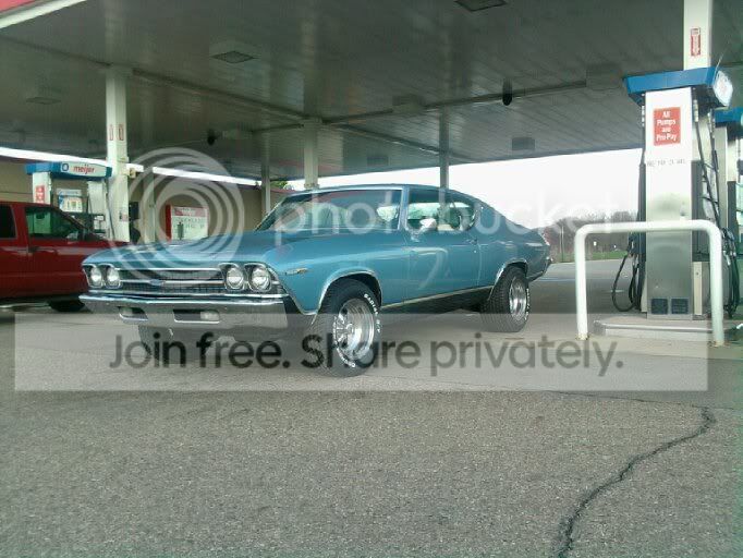

O then theres my chevelle. I just got it legal and driving down the road last weekend..
nice chevelle man, what made you go with the SIM 275? Been thinking of going with regrinds my self.
Well anyone want to by the pistons.. comes to find out I have a 64 crank so im going to stroke it..
A lot of ppl have been going with regrinds. 1st off you cant argue with the price and they make the same amount of power that the expensive billet cams do.
But are they reliable? Have they been tested on 800+whp dsms?
Im sure they have a breaking limit just like most parts do. Do I know what that limit is no. but Delta might. I do know These SIM 275's are in a couple 600HP dsm's so far with no problems. And if you look at the Average DSM its a e316g with around 300+hp and they work great.
