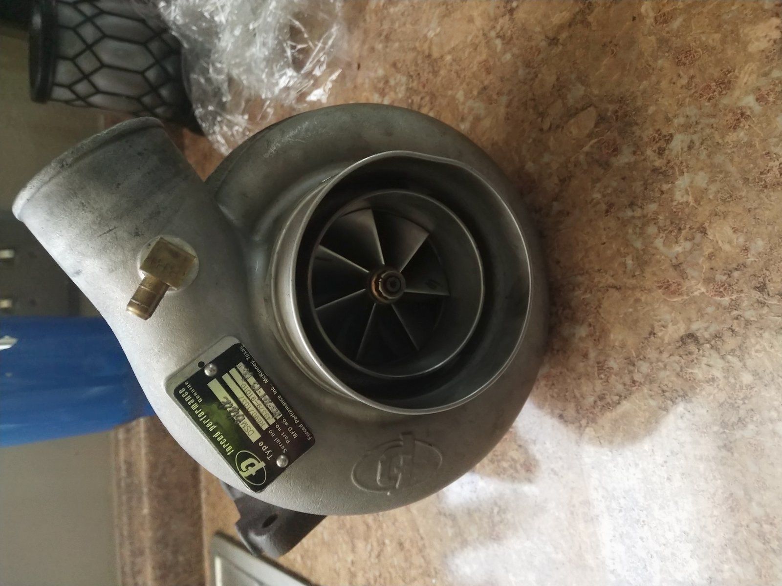

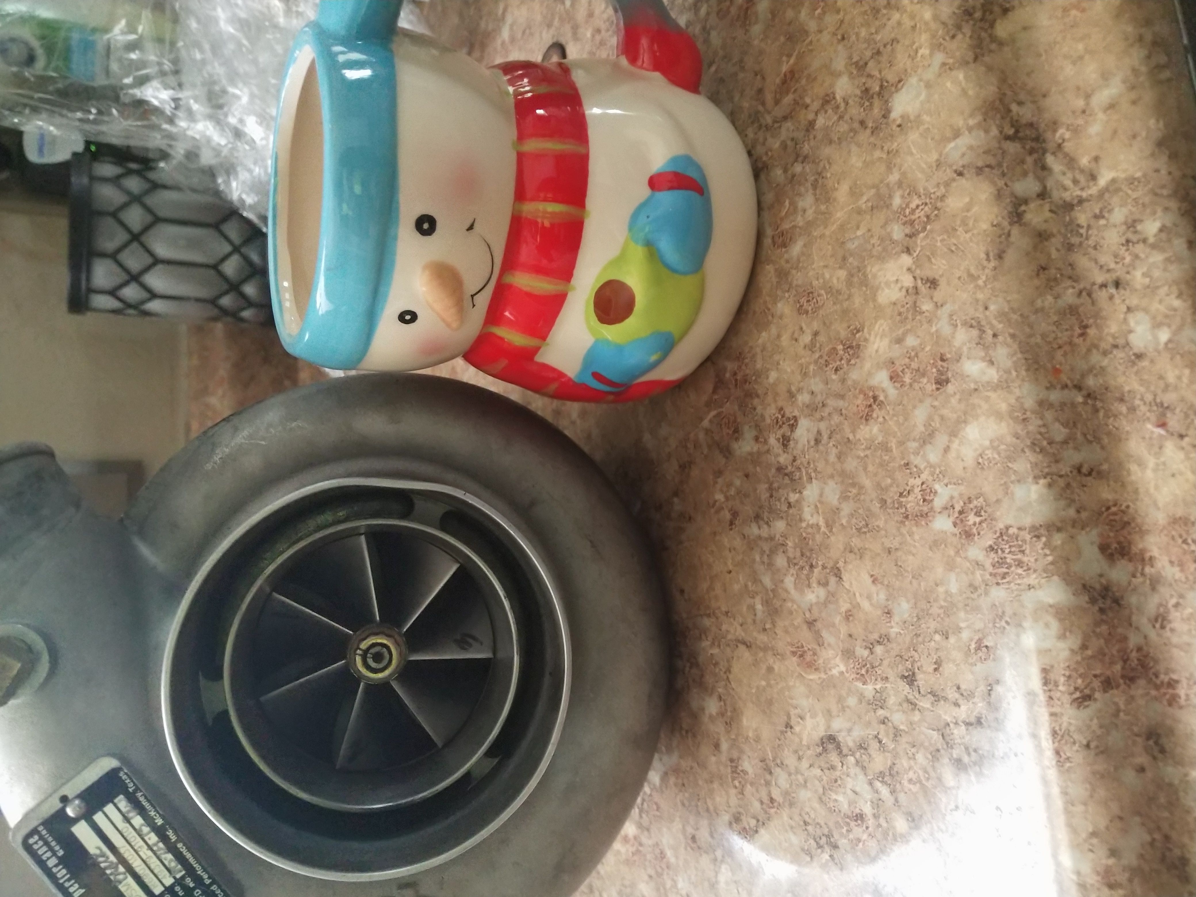

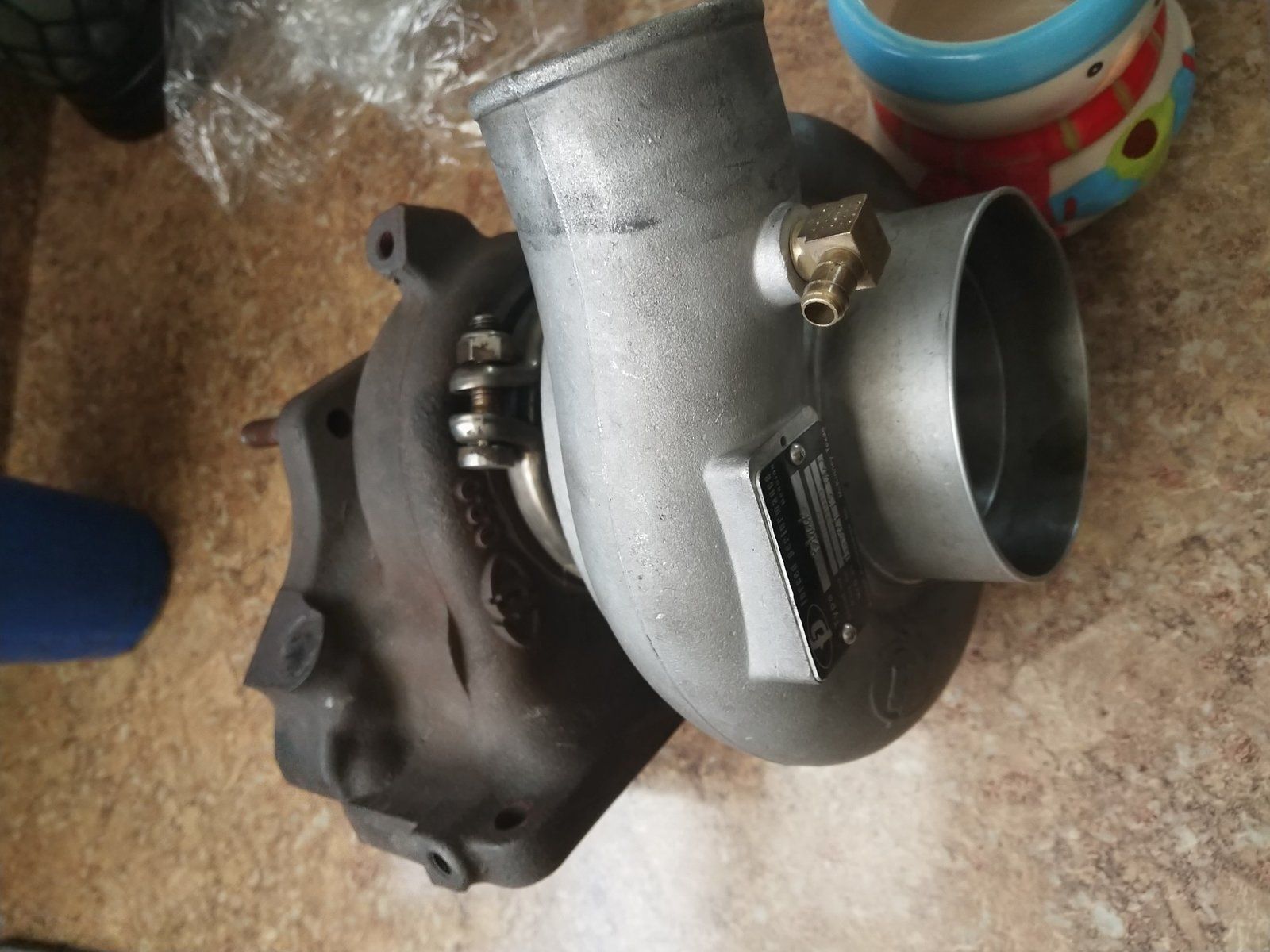

Here are some pictures of the FP black I picked up, got high hopes that this will be fun!!
