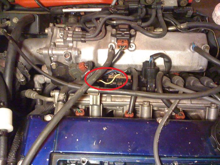

Hope this helps.
What you're thinking of is the Power Transistor Unit (PTU), which is probably the OP's problem. But what you've indicated in this photo is the fuel injector resistor pack, it is what allows our car's to run low impedance injectors and doesn't effect the spark.
The PTU is a wide plug located on the intake manifold right next to the coil pack.

i put the car back in time and went to turn it over and it back fired... the cams are lined up the crank is lined up the oil sprocket is line up could this back fire still mean it out of time?? of just burning flooded gas out the cylinders????
I had a the exact same problem with a 97 GS-T i was working on, it ended up being a loose power wire to one of the coils, which are usually covered by a small plastic piece so you dont see them. So we re-attactched the wire and relocated it to the side of the strut tower and it ran like a champ. Since 2 and 3 share the same coil that is most likely your problem!
