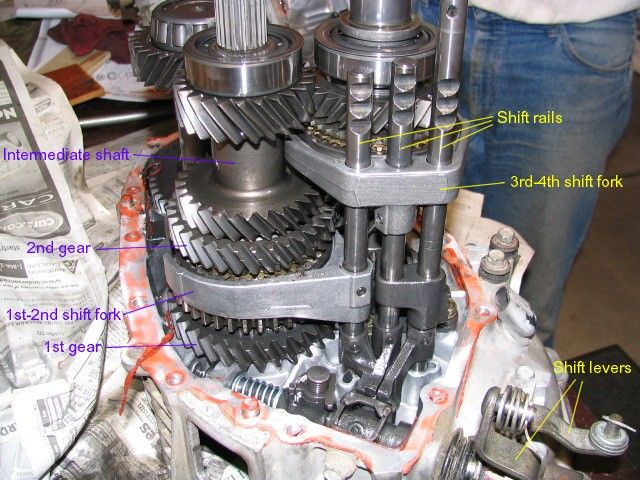

Popping out is usually shaved down forks (https://www.dsmtuners.com/threads/popping-out-of-4th-gear.290238/#post-151566175), or incorrect bearing preloads/endplay allowing input/intermediate shafts to move longitudinally, or 36mm nuts not tight - none of which require the stacks to be disassembled. However if you're planning on keeping the car many years sending the stacks out to a professional tranny rebuilder might be wise because he'll tear them down to replace any worn needle bearings, hubs/sliders, main bearings, syncros. Then you won't have to buy a press or bearing separator kit. You will still have to do the bearing preload/endplay thing.
You're going to need a torque wrench for the 109 ft-lbs 36mm nuts. I put the tranny in 2 gears at once to hold the shafts rock solid (don't use a penny or rag - see my tips in post 9). Here's some pics of what you're getting into although these are from my 1999 FWD turbo tranny:
- https://www.dsmtuners.com/attachments/inside-fwd-tranny4-jpg.151917/
- https://www.dsmtuners.com/attachments/inside-fwd-tranny2-jpg.132369/
- https://www.dsmtuners.com/threads/p...go-into-5th-or-reverse.405484/#post-153772736
- https://www.dsmtuners.com/attachments/5th-gear-jpg.605451/
- https://www.dsmtuners.com/attachments/intermediate-shaft-input-shaft-both-in-neutral-jpg.99045/
- https://www.dsmtuners.com/threads/5th-gear-shift-inside-tranny.480233/#post-153435439
- https://www.dsmtuners.com/threads/2...d-second-gear-problems.406668/#post-152697045
Popping out is usually shaved down forks (https://www.dsmtuners.com/threads/popping-out-of-4th-gear.290238/#post-151566175) or bad bearing preloads/endplay or 36mm nuts not tight - none of which require the stacks to be disassembled. However if you're planning on keeping the car many years sending the stacks out to a professional tranny rebuilder might be wise because he'll tear them down to replace any worn needle bearings, hubs/sliders, main bearings, syncros. Then you won't have to buy a press or bearing separator kit. You will still have to do the bearing preload/endplay thing.
