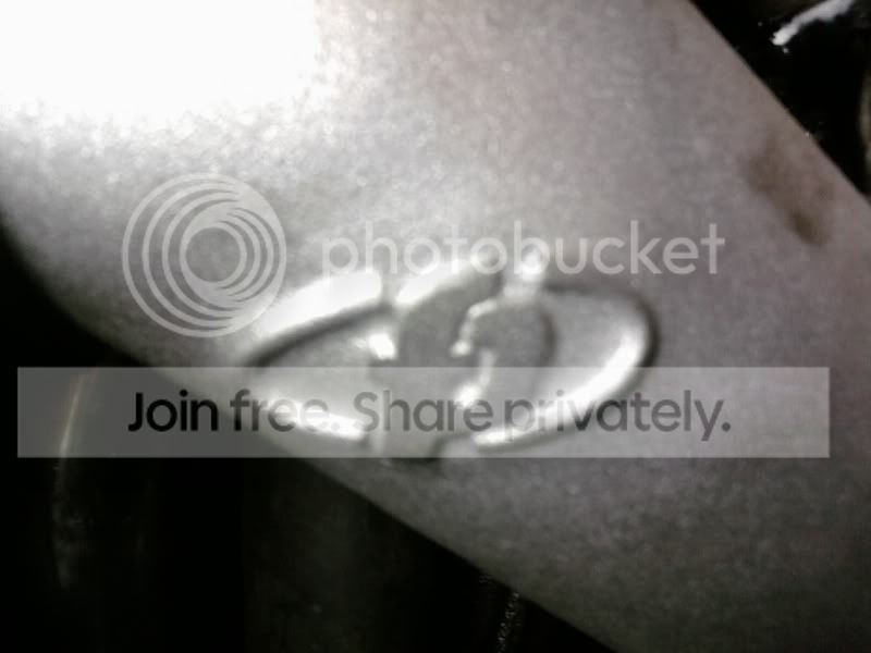

anyways, if you get another bumper, can you sell me the Talon emblem of yours?
Have a nice one
The 2ga one? Yea you can have it. I have a 2gb eclipse bumper I'm going to be rolling around with.

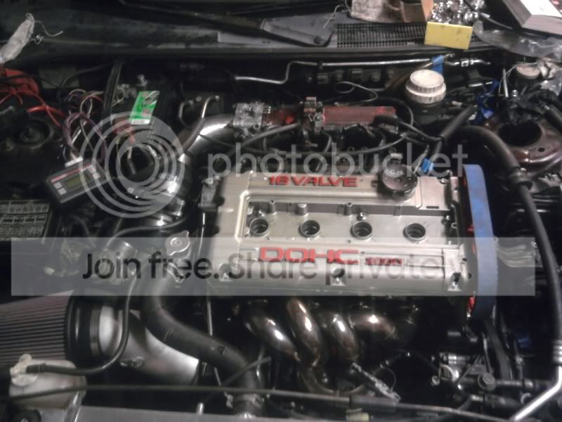

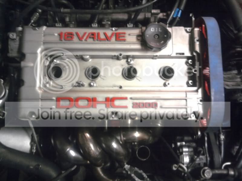

ALRIGHT... She's got a powerplant, just a few odds n ends and I'll be starting her up :thumb:

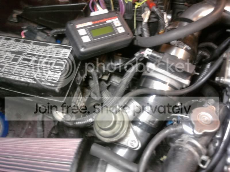

GM maf fits in there nice and snug :p

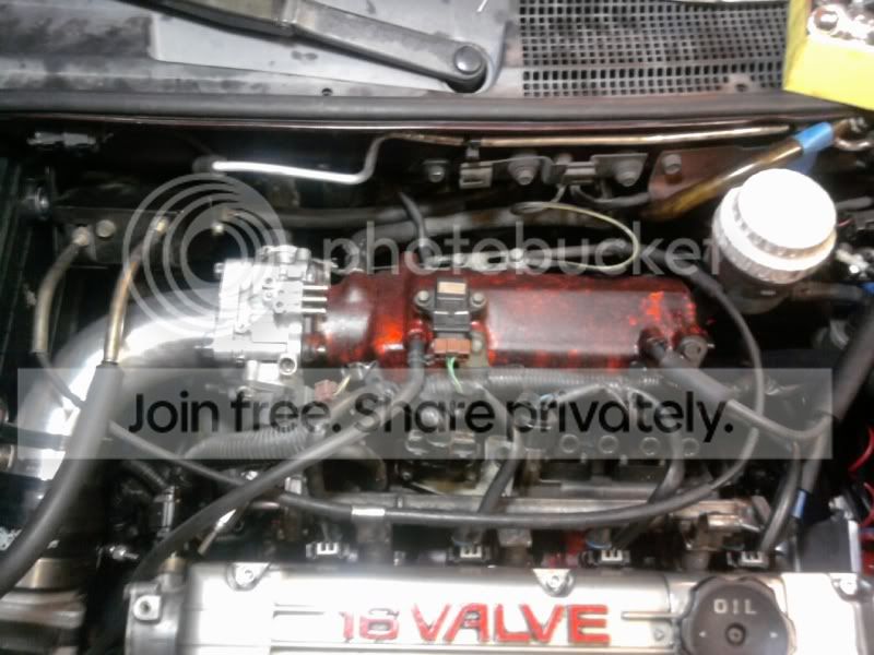

Painted by --> TSITurbo95<-- not the look I was originally going for, but I actually like it :thumb: :hellyeah:
Thumbs up for FP intake :thumb::thumb::thumb::thumb:

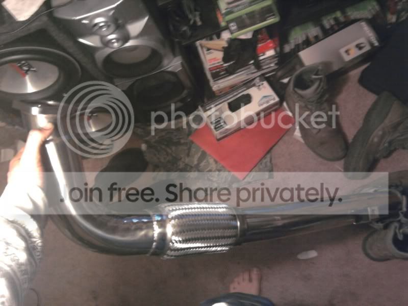

I'll snap some more pics as I got, as it sits, I need to refill the trans and tcase, tighten up my suspension stuff, reconnect the driveshaft, cap some vacuum lines, weld a bung on my new downpipe (since someone stole my whole exhaust!!) Rims/tires back on, bleed the brakes/clutch line. And SHABangaBAang! FINALLY!!! LOL
I was patching things up to start it up for the first time and coolant is leaking like a sob and the thermo housing/waterpipe. I've replaced the o-ring a couple times to no avail, I'll have to go the auto parts store and get thicker ones. :(
The downpipe is the sechs yes LOL.
