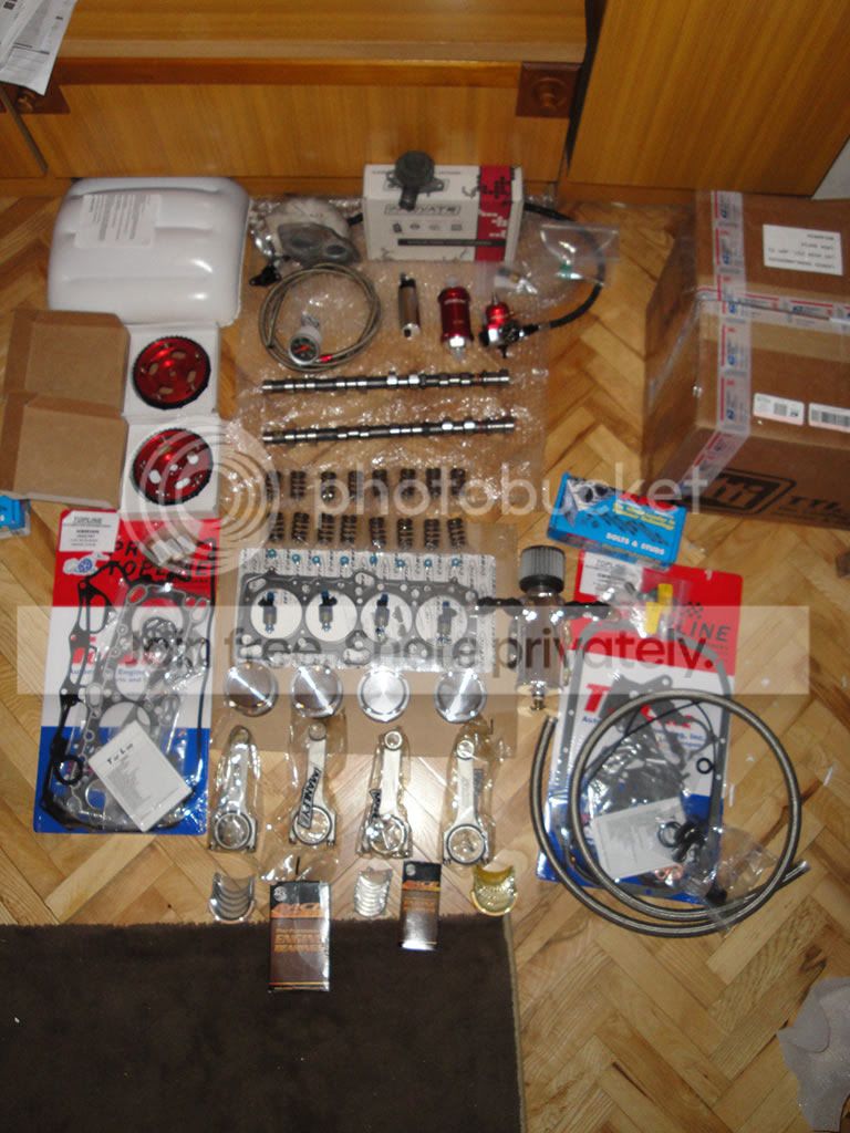

Here are the main ingredients for my build:
- Manley rod/piston combo 8.5:1
- ACL Race main/rod bearings
- ARP Main studs
- ARP Head studs
- ARP rod bolts
- Cometic 1.6mm MLS head gasket
- Kiggly springs
- ITM Revised lifters
- Delta K272 cams
- Fidanza adjustable cam gears
- '90 oil cooler
Fuel system:
- Walbro 255HP fuel pump
- Fuel pump rewire kit
- STM -6AN tank to rail kit with Fuelab filter
- FIC 1050cc injectors
- Fuelab AFPR w/ liquid gauge
Exhaust & turbo:
- FP Race manifold
- FP 68HTA turbo
- Punishment 2.5" o2 housing
- 3" turbo back exhaust
Intake system:
- CX Racing 29x9x3" FMIC
- 2.5" IC piping all the way
- 1G BOV with Dodge garage mod
- 1G NT throttle body (I will try boring it to 63mm)
- 1G Intake manifold (bored to 63mm)
Engine management:
- Jackal/Werewolf speed density setup
- MSD Ignition IAT
- Freescale 4 bar MAP sensor
- Innovate XD-16 kit
And here's one of those poser pictures :D
