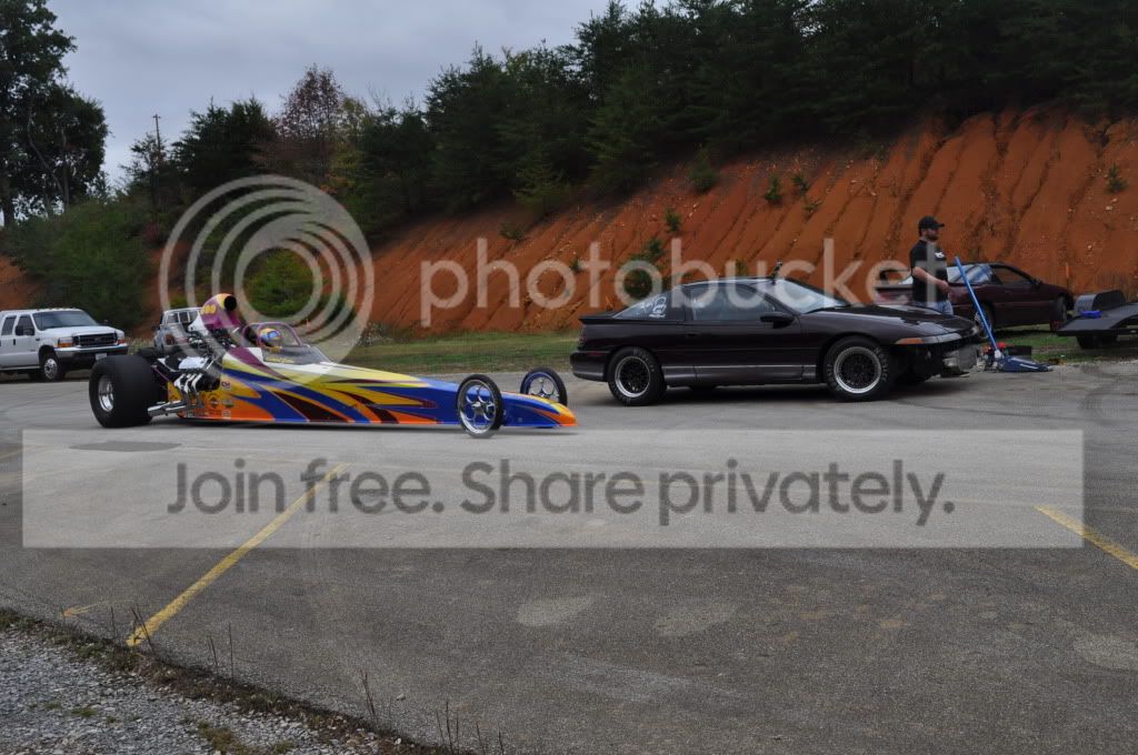

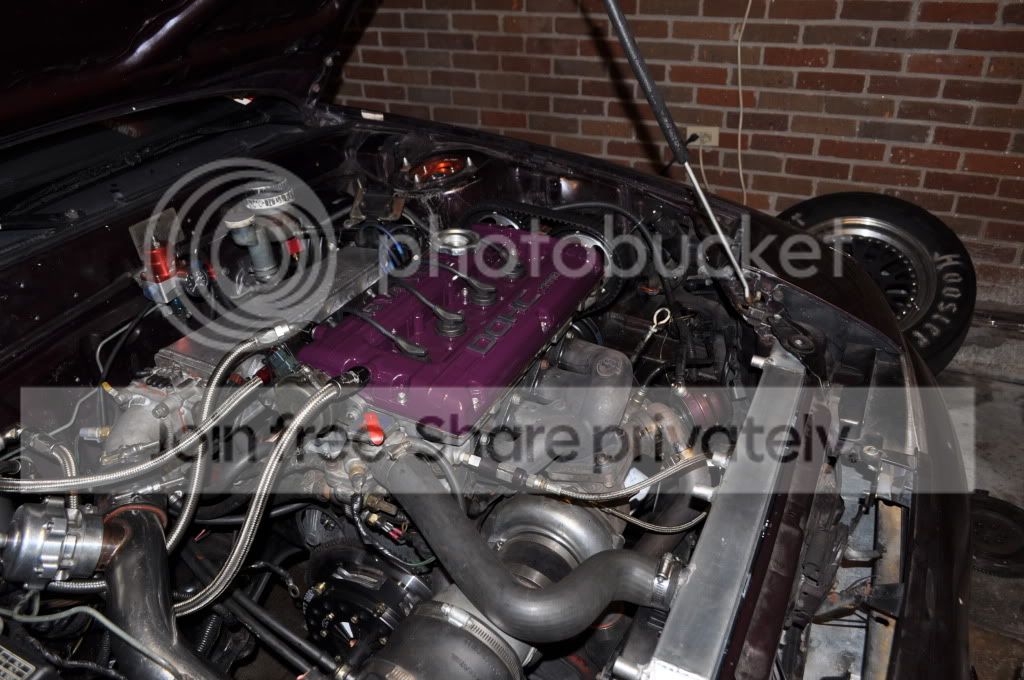

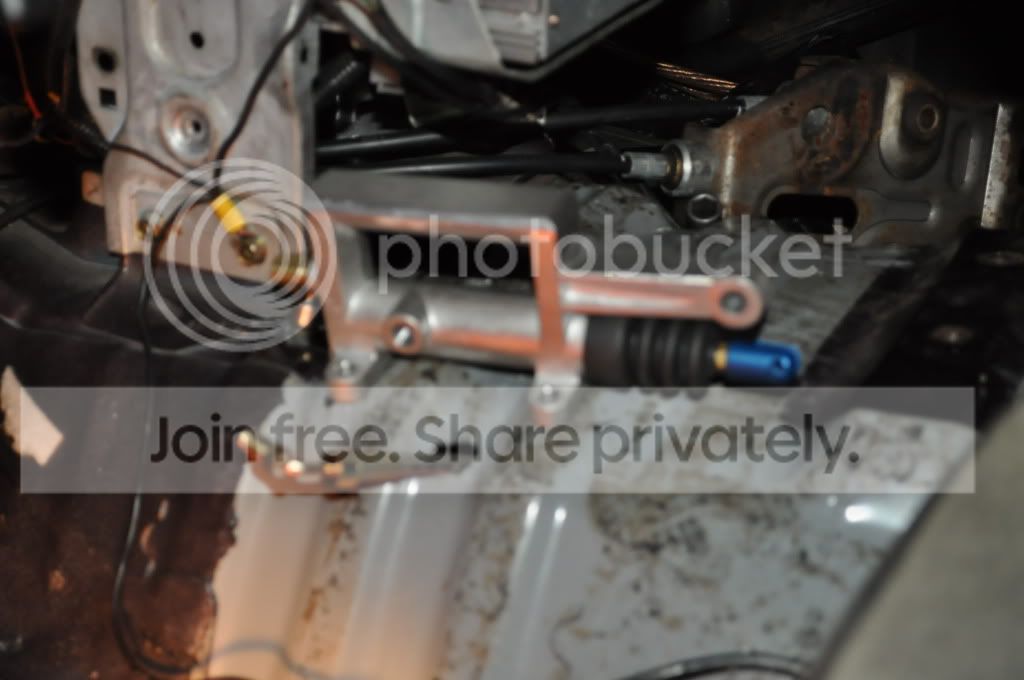

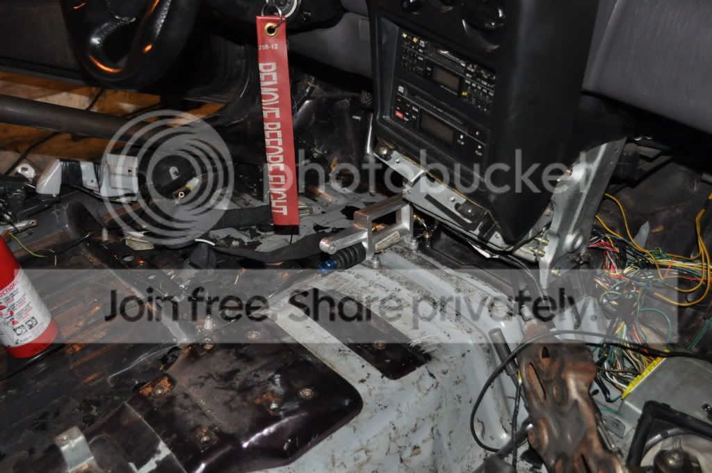

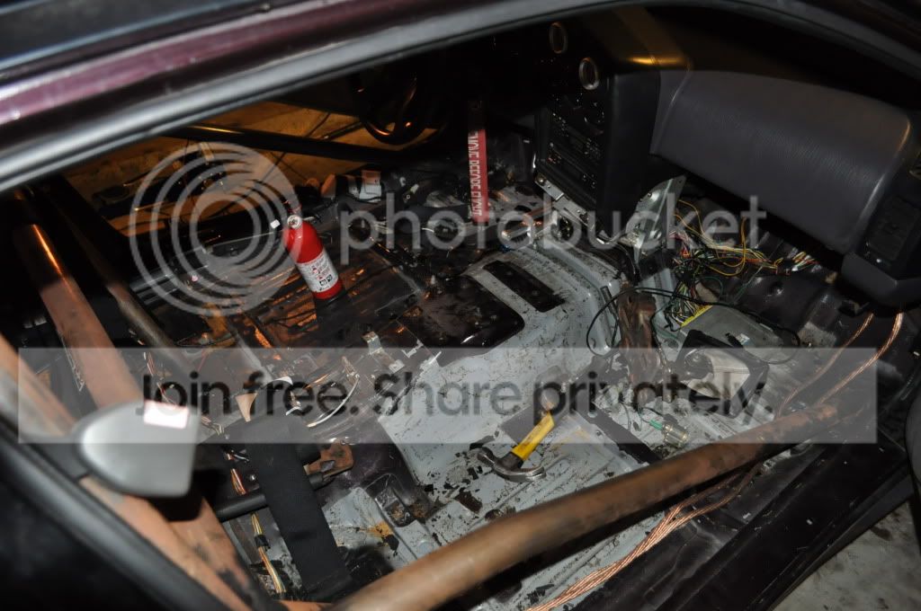

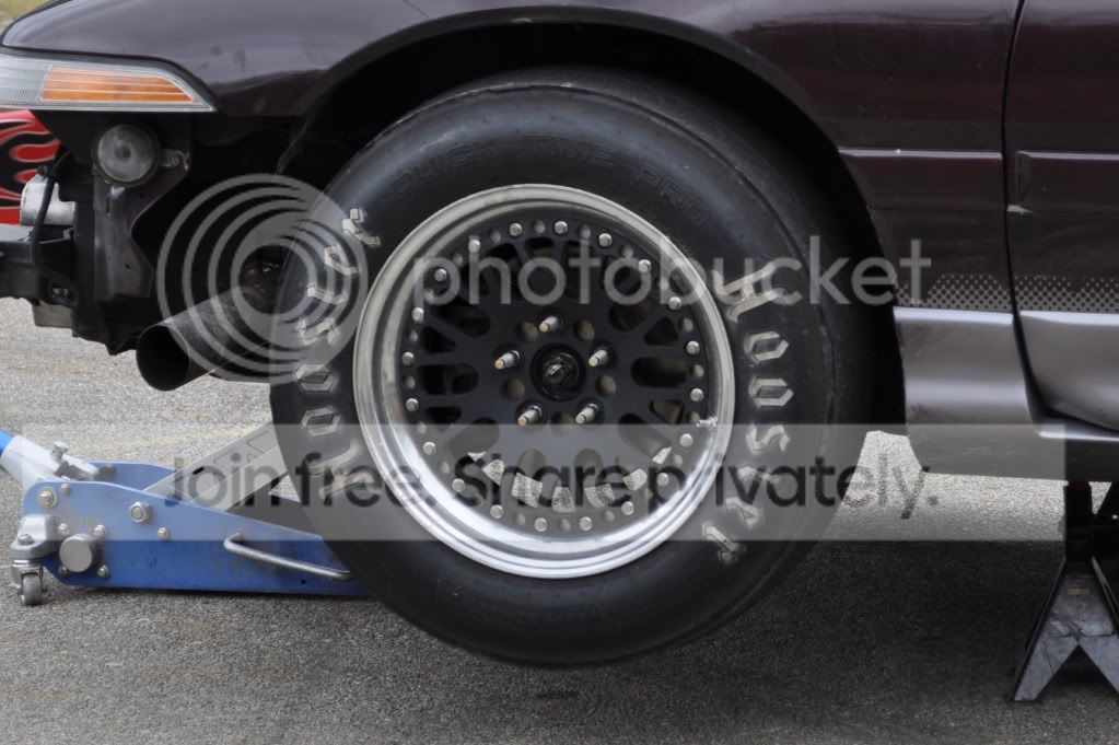

Here are some more recent photos of the car!
