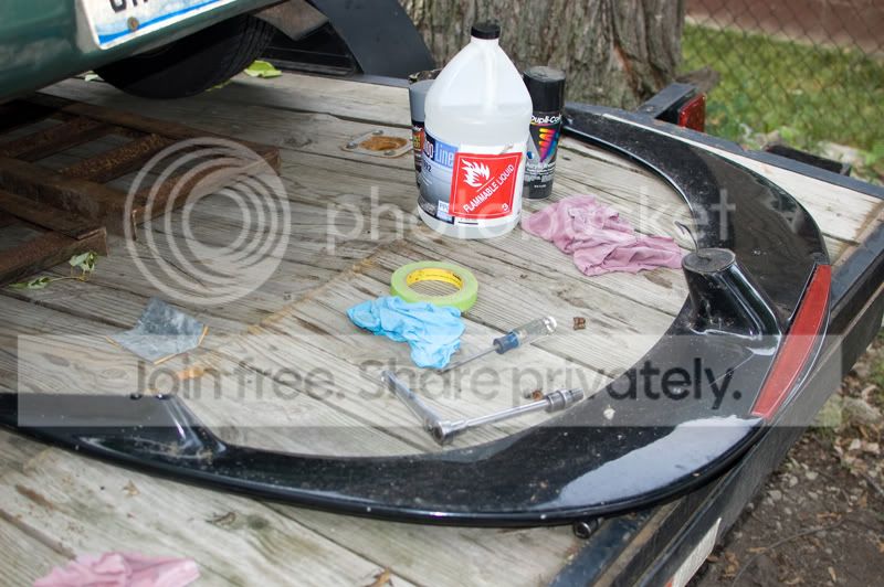

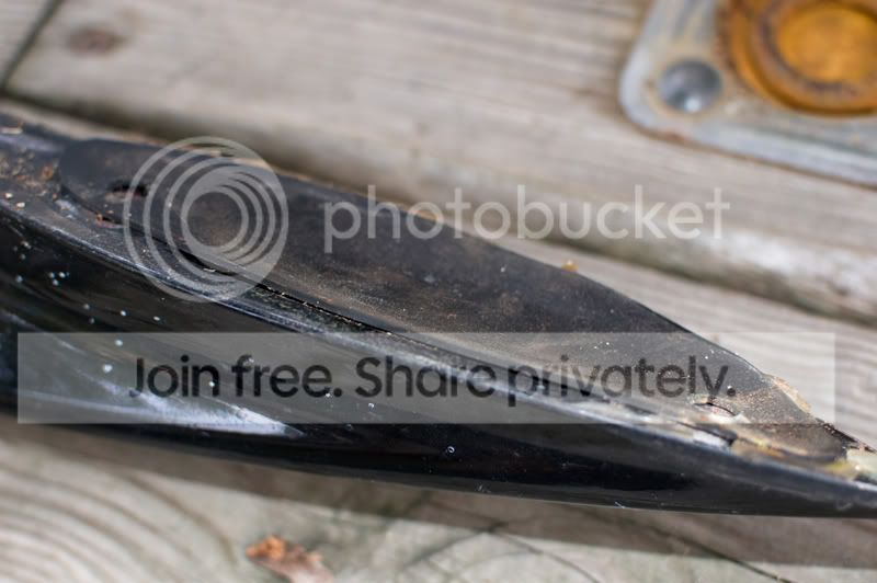

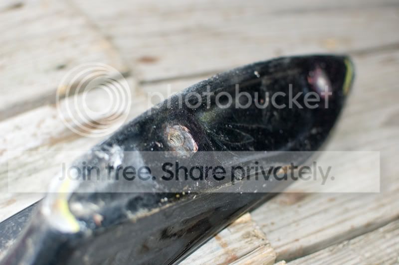

In exhibit A and B and C, we have an OE 2gb Talon spoiler.
Notice the really odd looking mounting point. This would prove to be problem. It is very hard to drill a square-ish shaped hole on an angle.
Yeah, needless to say.. that didn't work out very well. So time to look for another decklid.

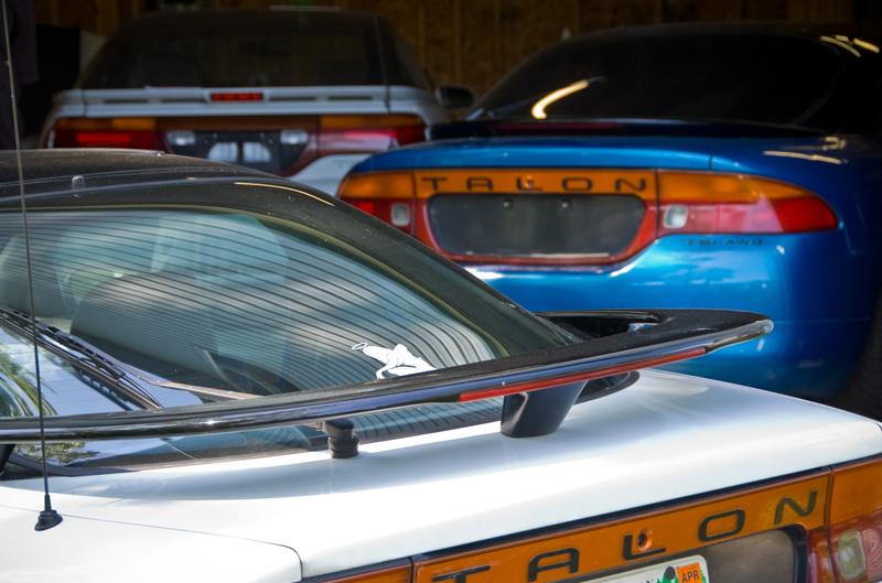

Finally. The 2gb conversion is complete!
Postscript
Just thought I'd share these pics and story with everyone in case you wanted to add this spoiler to your car. It is just easier to find the decklid in this case. Of course if you are skilled with a drill and body work, then maybe you would have better luck that I did. Attached are some pics showing the OE mounting holes on the decklid for reference.
