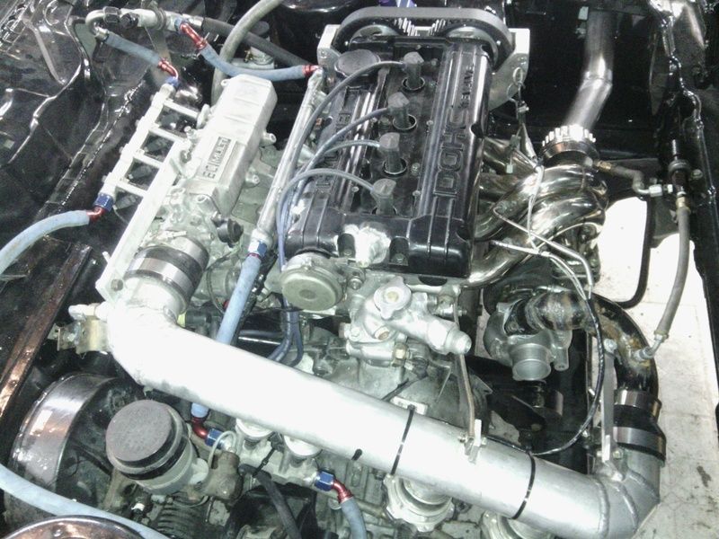

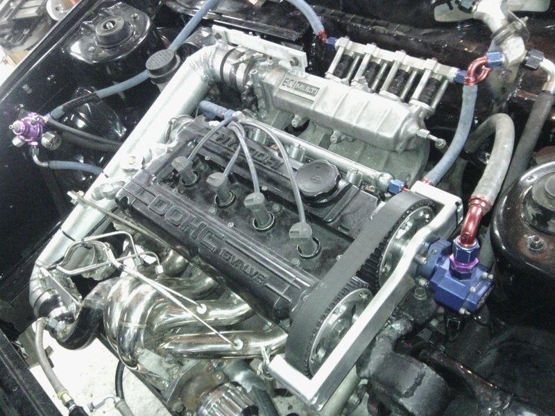

Here is the same setup in the last chassis with an hx52. This was on pump E85.

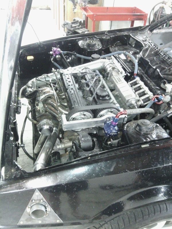

It runs. I have to repair a broken ground to the ecu, finish taping up the wiring harness and figure out if a plug died or the injector is bad as number three is not firing. I bead blasted the plug and it did not make a difference. It does have spark so I am leaning towards the injector. It is just some old stock 450 I had laying around until I get my new wideband so I can pour methanol in. Thank goodness for individual egt's. Makes it easy to diagnose.

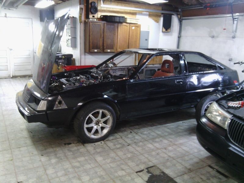

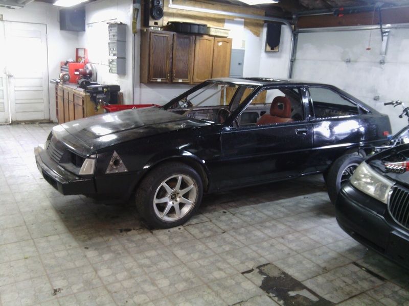

I will get pictures after I clean things up. It still needs a shifter, shifter cables, shifter arms, a radiator setup, camber plates and an alignment and a wideband before I can take it to the dyno. I will have it tuned long before it is ready for the track. Probably not this year but, I can at least have the tune ready to go while I finish the chassis.
This is how the car is going to look while I continue the 14b quest for now. I have more to do obviously but, other projects and lack of funding are going to hold the car back for now. Hopefully this fall I will be on the dyno with it. The harness is almost complete. I had an EGT sensor die so I need to replace it, if not another one before I complete the harness. The drivetrain and wiring are pretty much complete though.
