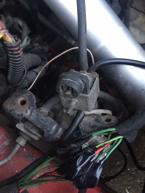

I am still struggling with my dsm:) I had TPS and maf problems i fixed it and there is no error i have checked it via diagnostic port but still i did not like the engine :( idle is not very well sometimes it runs roughly sometimes engine stops i really hate it..I can not start the engine without press the gas pedal:( I controlled the TPS ohms and it does not look problem:) I couldn t fix vacuum lines because i could not find the purge control valve maybe its removed or not please can you help on this pictures...and i can not engage to 5th and reverse also but i can engage reverse gear sometimes:)
by the my car is talon 1990 AWD manual and swapped to 91..TB,TPS,ISC has changed..
It appears to be an aftermarket boost control solenoid.
I meant to say biss before, autocorrect got the best of me.
Also, you have to make sure you have zero air leaks between the maf and intake valve.
A boost leak test, along with properly terminating boost piping ends, and who knows what other electrical Gremlins you will face. Soldering and heat shrink are your best bets to join wires. Lose the electrical tape.
