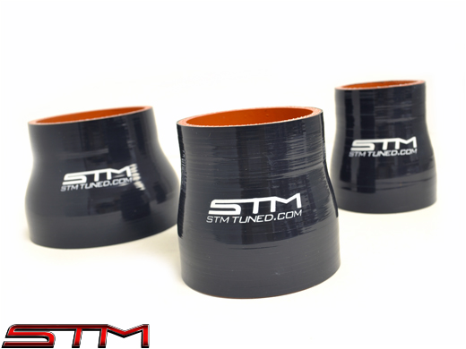

Ok just to make sure I know what you're talking about, when you say Chinese couplers you mean the round piece of silicone that goes between 2 pipes and you clamp it on to the pipe? If yes, don't worry about buying those. Not ALL chinese stuff is garbage. You can buy those couplers worry free. They will be fine, everyone uses those.
Just do it on the compressor inlet. That's how it's always been done. There's not much that can leak on the intake pipe. Just tighten the clamps down tight and you will be fine. Its a BOOST leak test. All the boost is after the compressor.
The knock sensor can be falsely triggered. It's a common issue for these cars. It's called phantom knock. I'm not sure abut the 420a, but the 4G63 sensors are susceptible to phantom knock. Do some reading on that.
This is what I mean by couplers:
http://www.streettunedmotorsports.com/parts/b/stm_silicone_reducer_couplers.jpg
or
http://www.stinger-performance.com/...KHXj0Av0Q_AUIBygC&dpr=1#imgrc=f7Fv4bKSmOk7KM:

I'm going to slowly raise my hand, every part I have is from ebay. They technically aren't performance parts. My intercooler pipes were really mushy under the mesh pieces so I needed some replacements. I weighed my options, it was either piece together piping from random radiator hoses or get what is really a great designed ebay kit
So anyways
Cx racing intercooler piping kit, $119 shipped great fitment
Fake greddy type S blow off valve $19 shipped (holds stock t25 boost no problem)
Ebay intake, $89 shipped
Hks clear timing cover $19 shipped from Hong Kong
Ebay 9 piece silicon radiator hose kit $54 shipped
My car had been sitting for 3 years and needed these parts, while it was stored in a garage during that time most rubber pieces in the engine bay and suspension were very decayed. Basically after fixing the clutch my radiator neck broke and other rubber parts just fell apart as I took them off
No regrets, extremely happy with my cx racing upper and lower intercooler piping
From what I can tell with hks parts, they manufactured them in china. After the factory filled the initial order quantity given by hks they kept making them as branded "knock offs". Atleast that's all I can guess, a new hks bov in box on ebay is $50 shipped and my real hks branded timing cover was $20
For a real deal type s greddy blow off valve, I had a car with the name brand one back in the day and the adjustment screw popped out of the top of the blow off valve. There is actually one used on ebay right now with a round headed screw on top which is exactly what I had to do on my real $250 greddy whistle
Ok I made a mess with that question about the silicon hoses kit. Actually they are for water lines, not for air lines. Sorry about that, I just saw 11 hoses and didn't think there were so many just for the radiator, thought they were for both systems. The stock ones look to be made by rubber too. Anyways, if you guys have any experience with those, are they worry free too?
