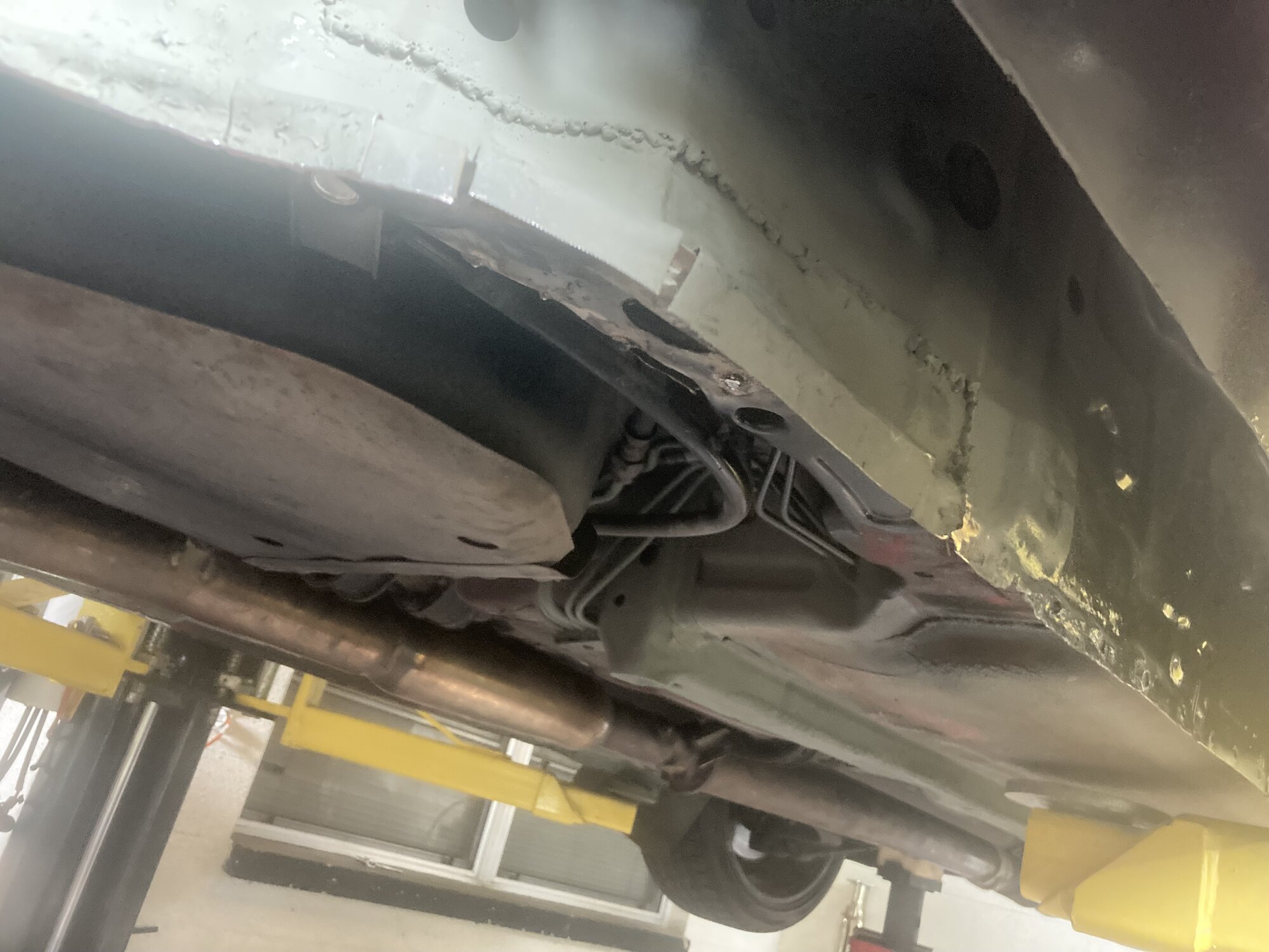

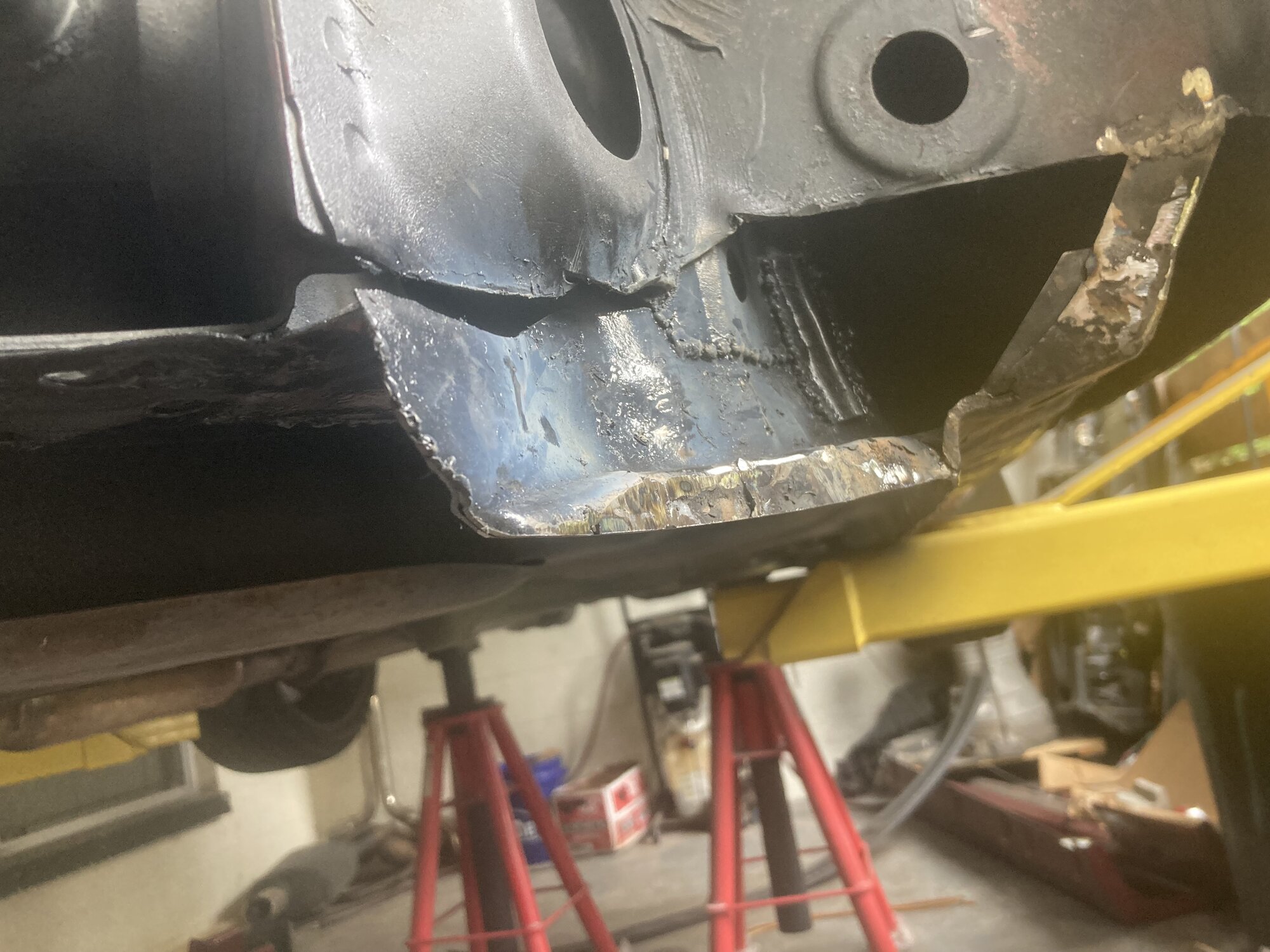

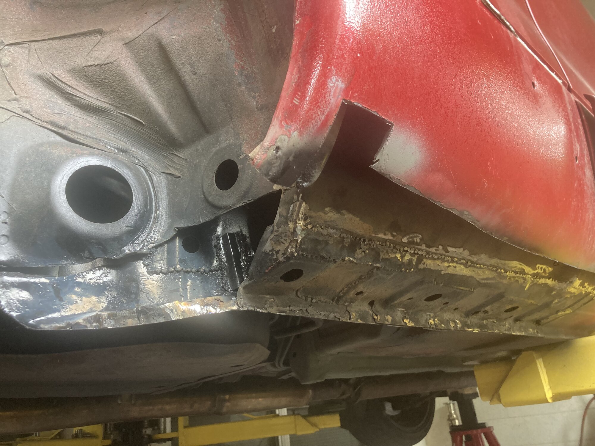

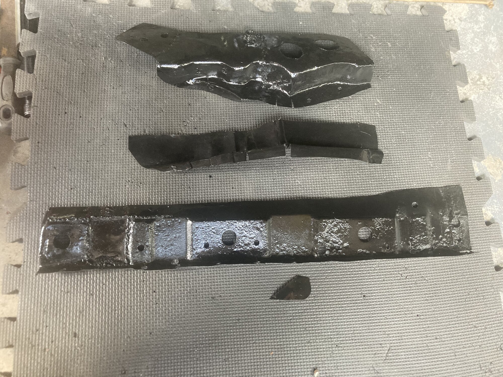

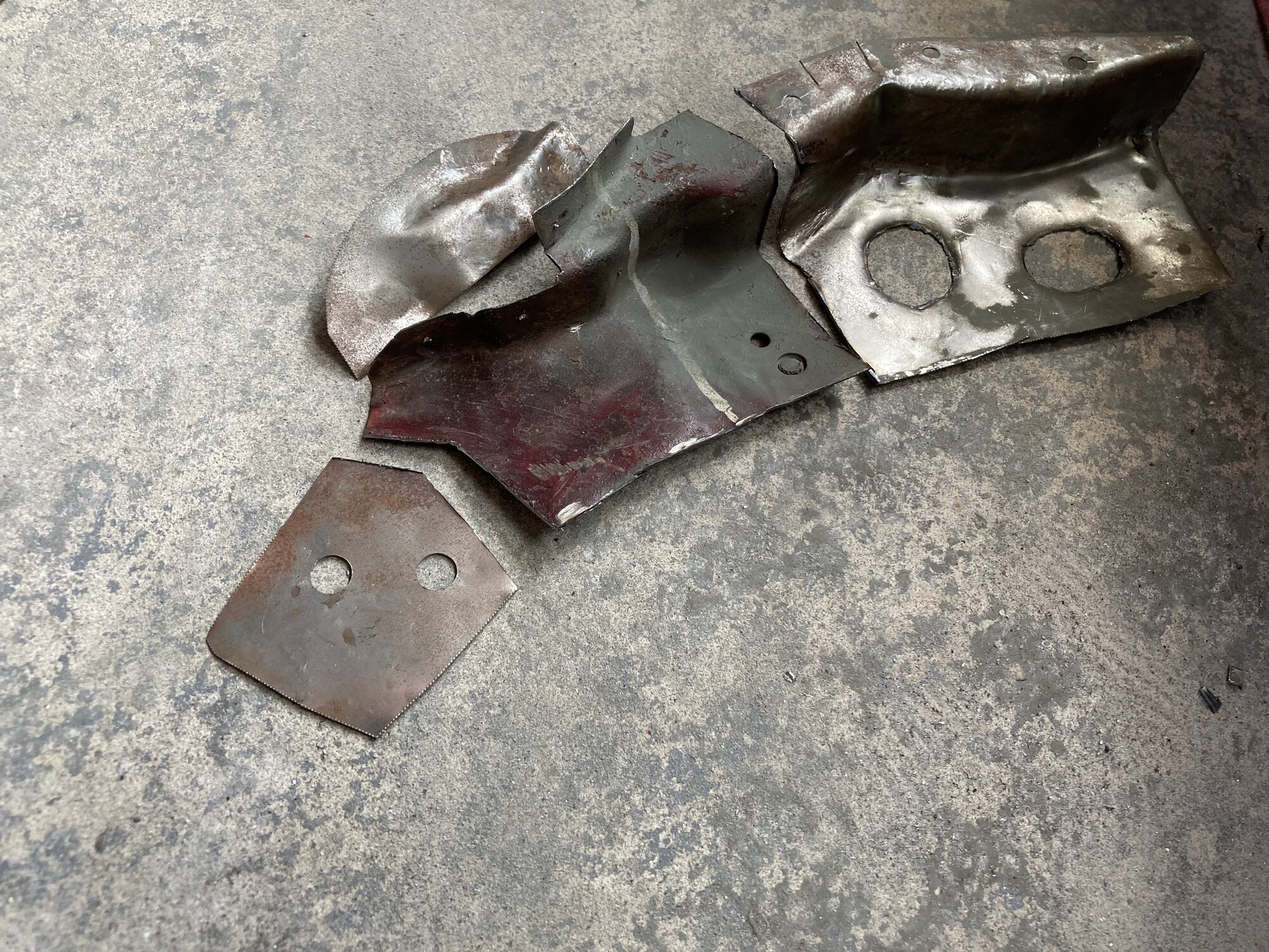

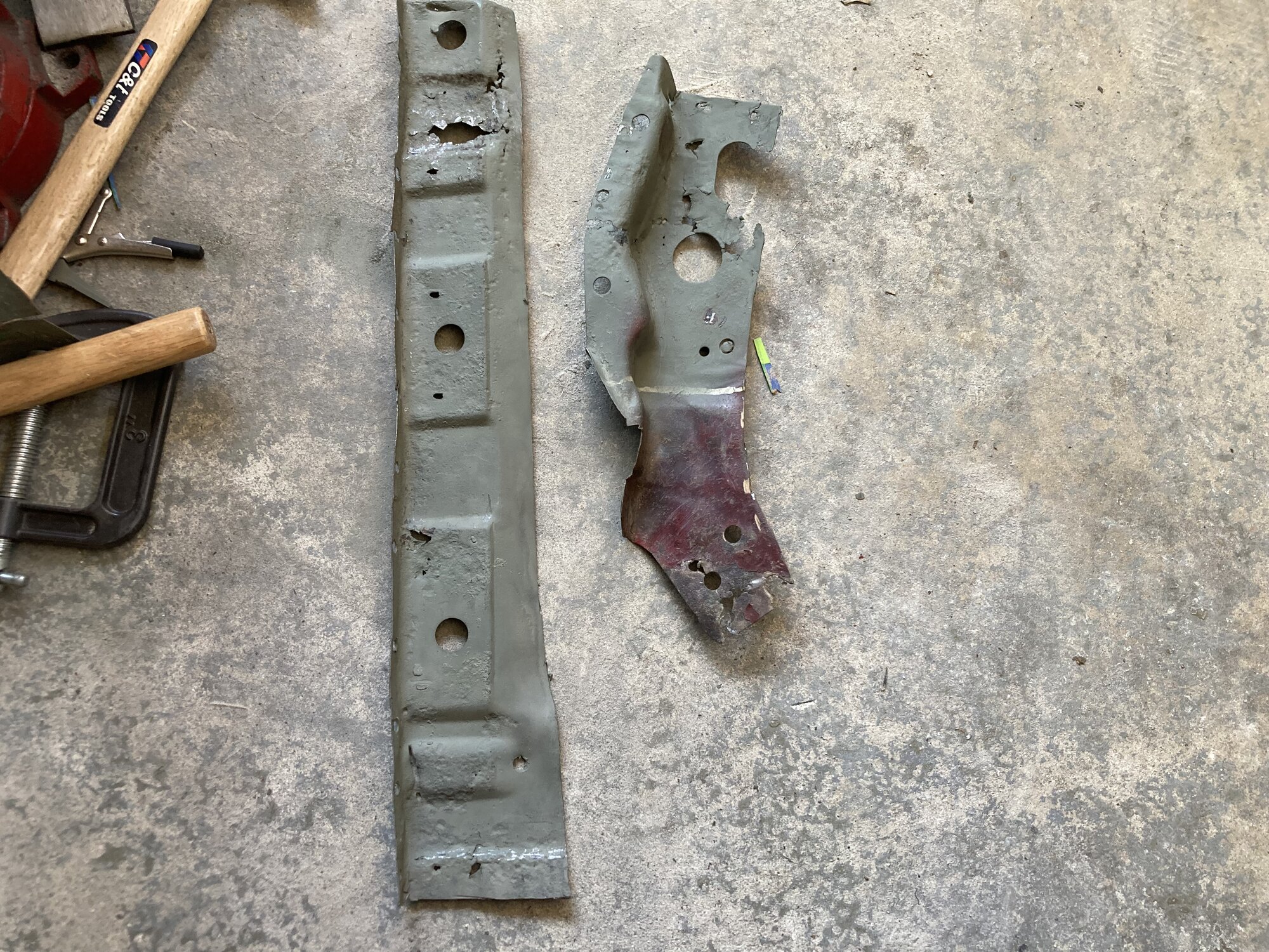

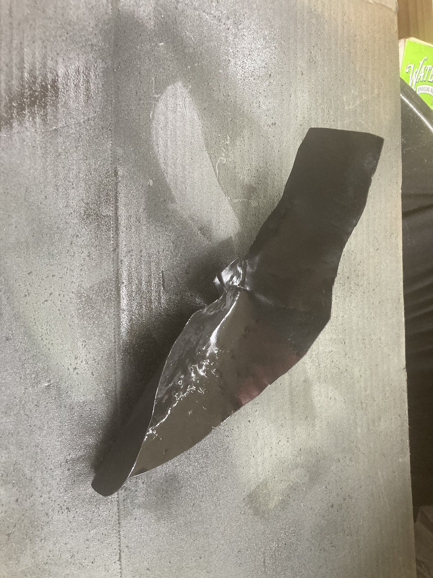

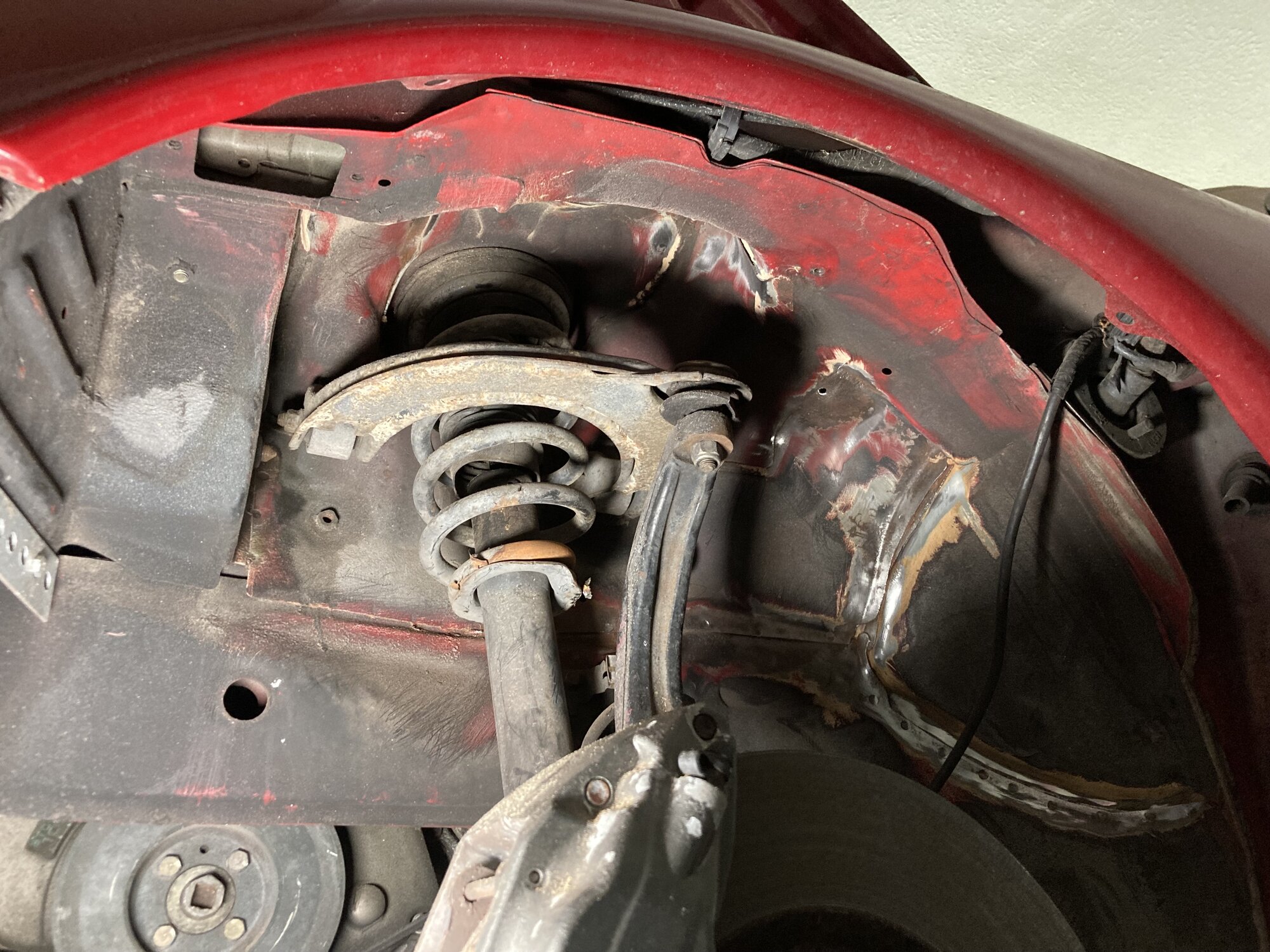

Some of the sections removed needed some patch work, or complete reconstruction, 1st time using shaping hammers 🔨 .

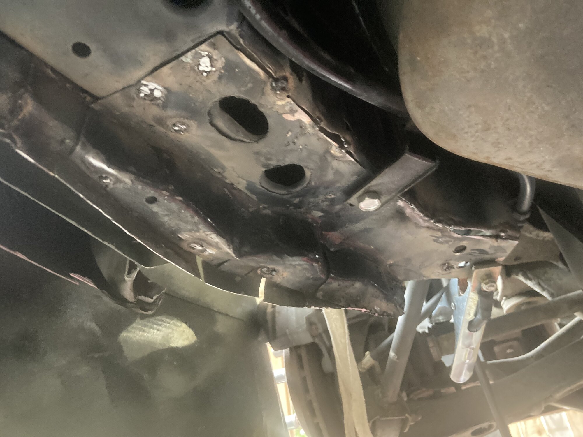

Made some small lill support vertical brackets hard to see in pics (below)
Really helps when lifting car I no longer see any flexing on that side.
All the rust is removed 🥳
And I restore my destroyed pinch weld seem , finally after 15 yrs I was able to care take of this.

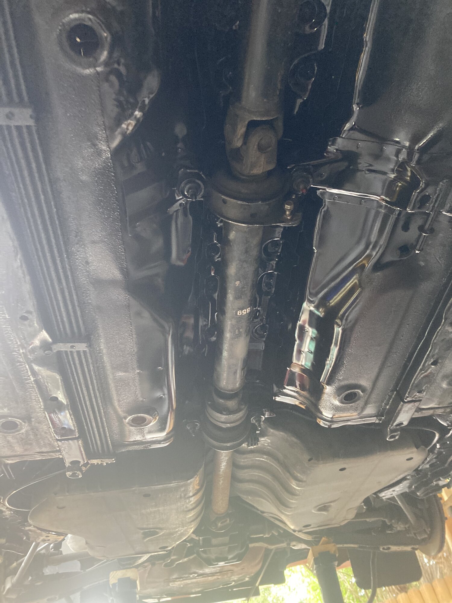

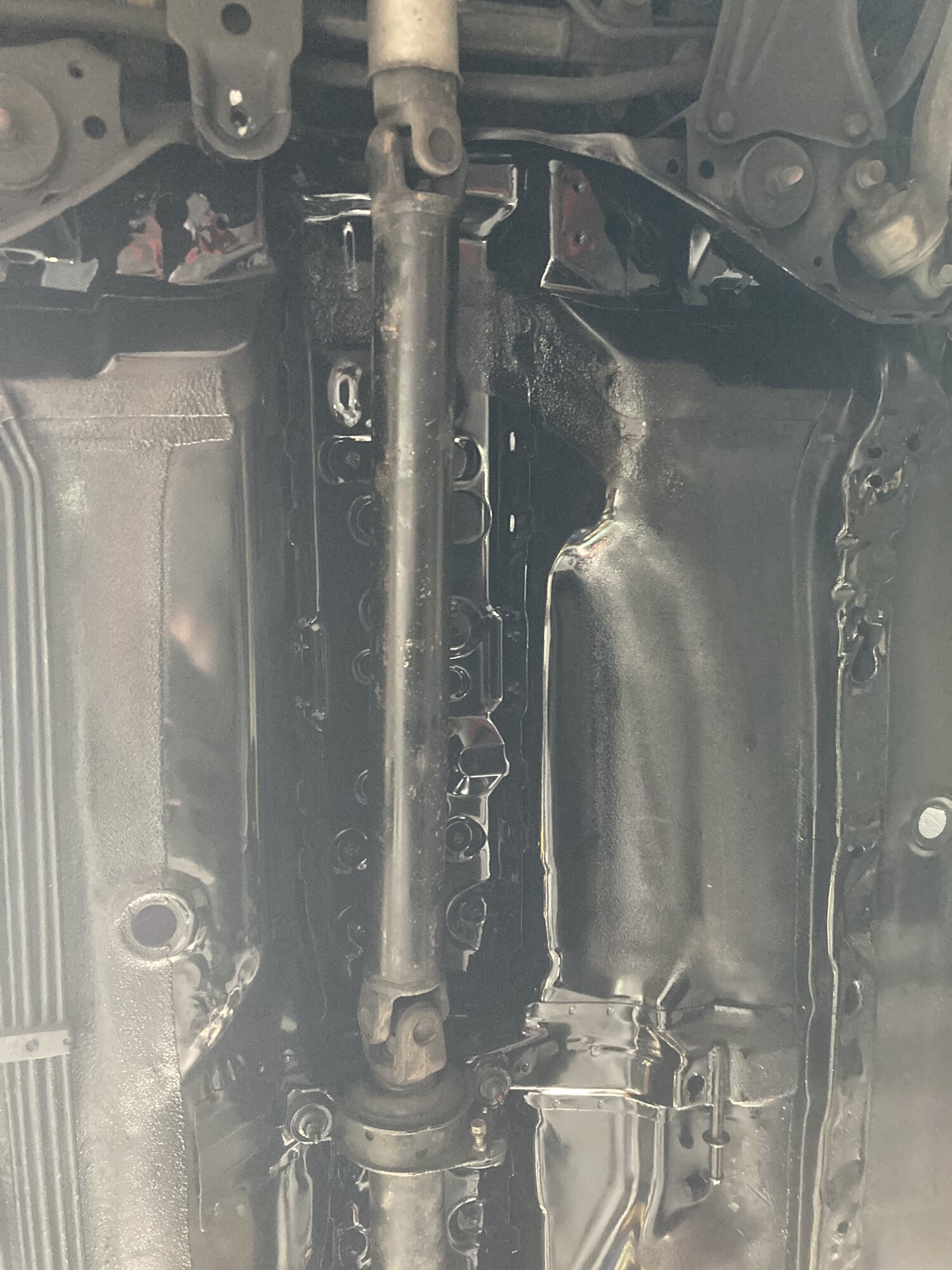

Scrubbed / scuffed the belly - factory red came off easy leaving a clean 🧼 primer’d
surface.
Painted

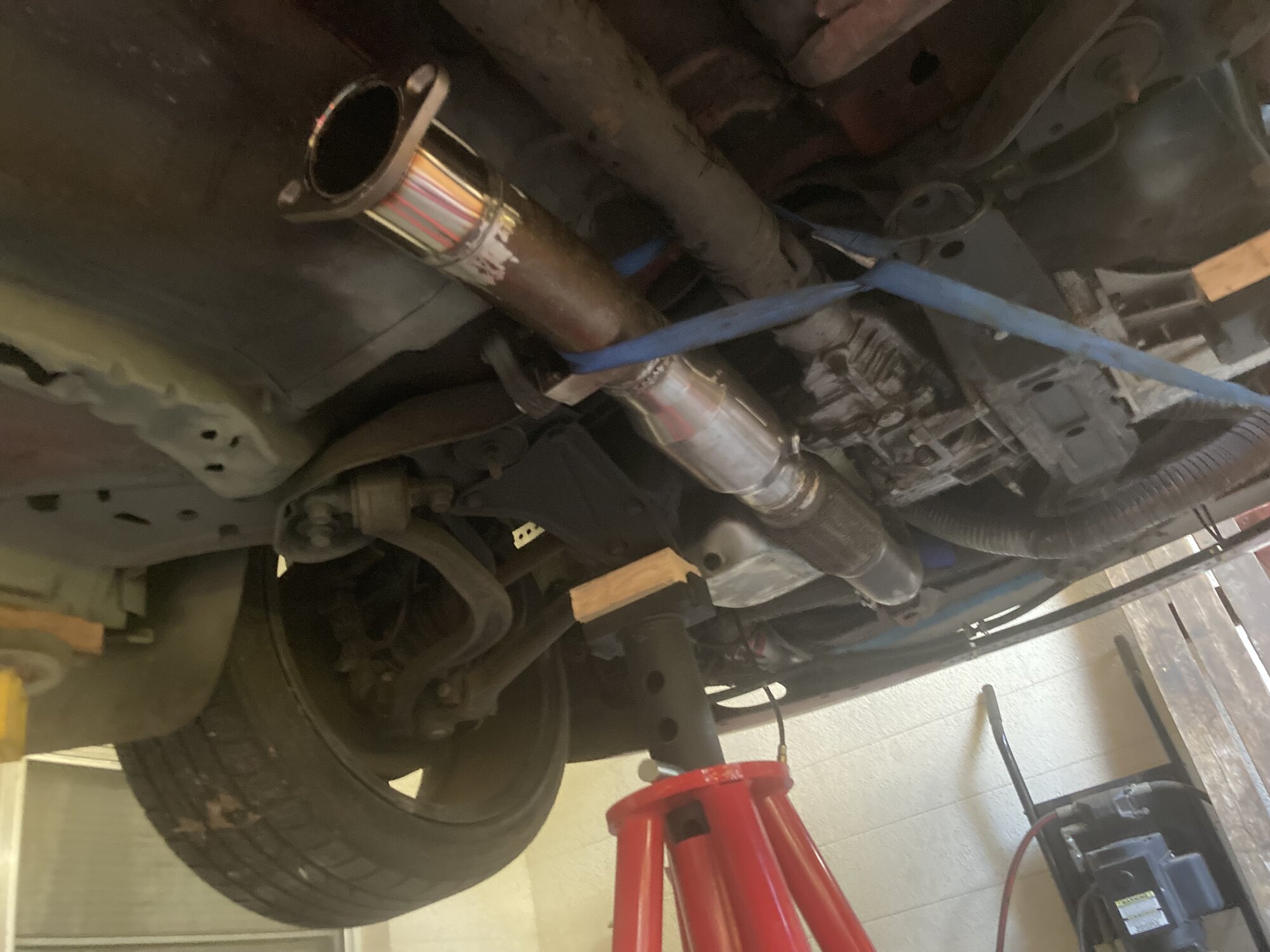

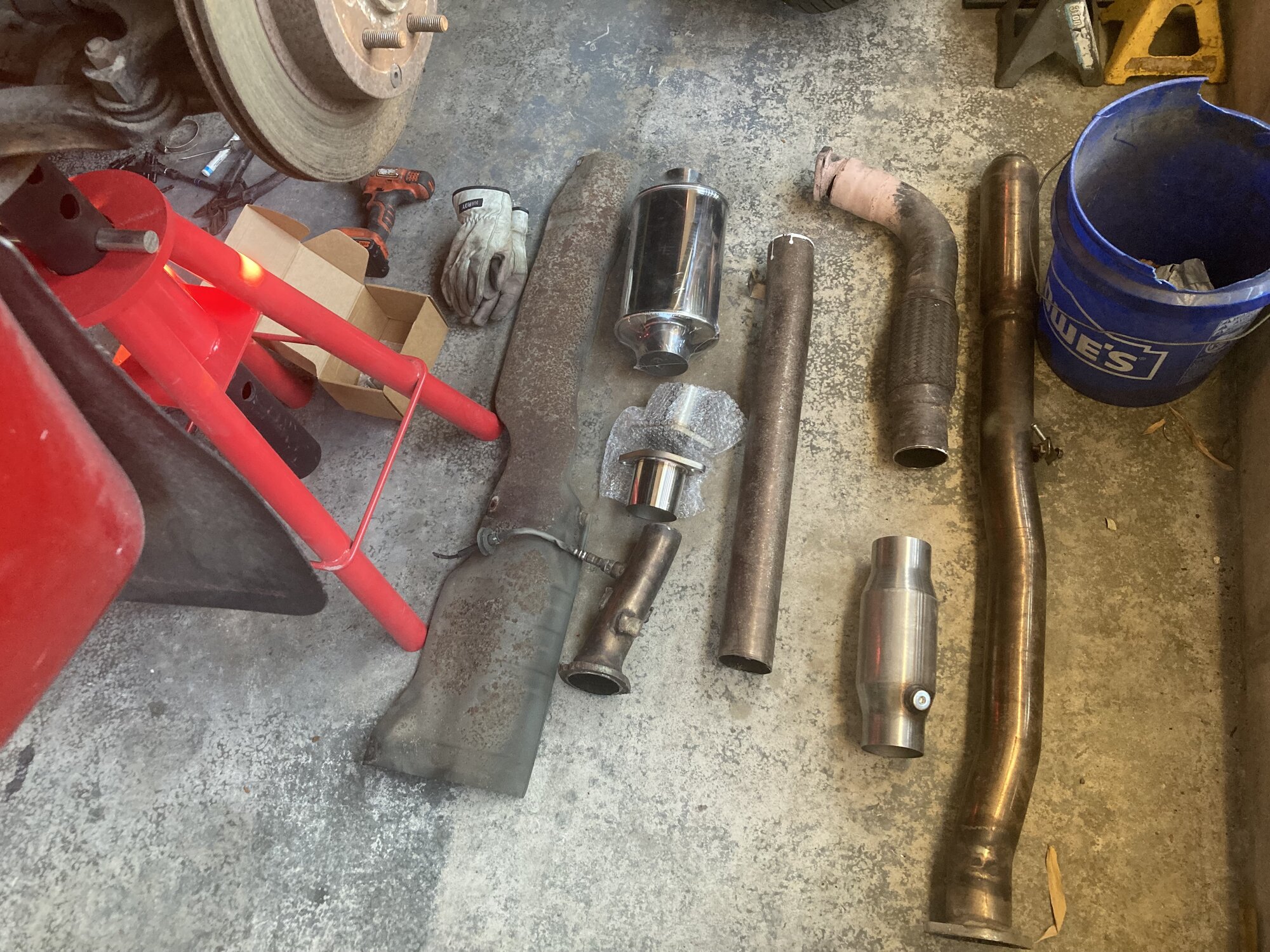

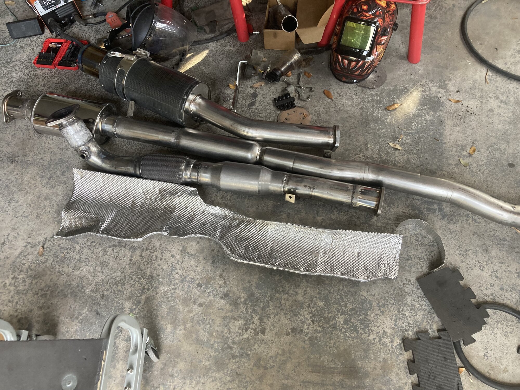

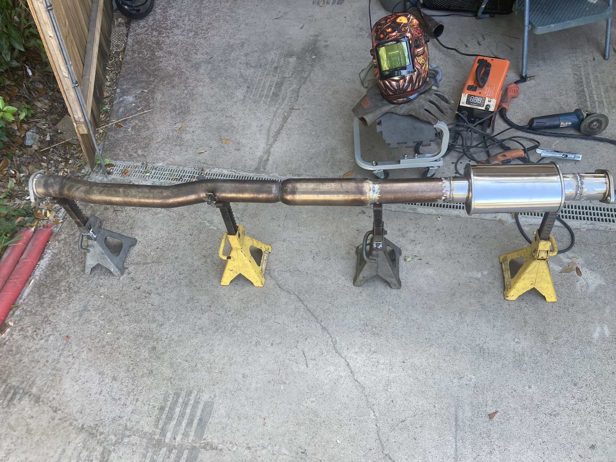

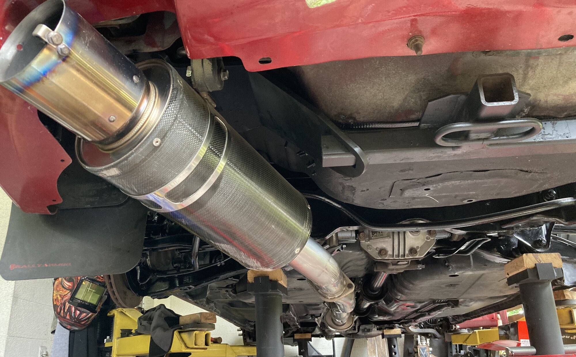

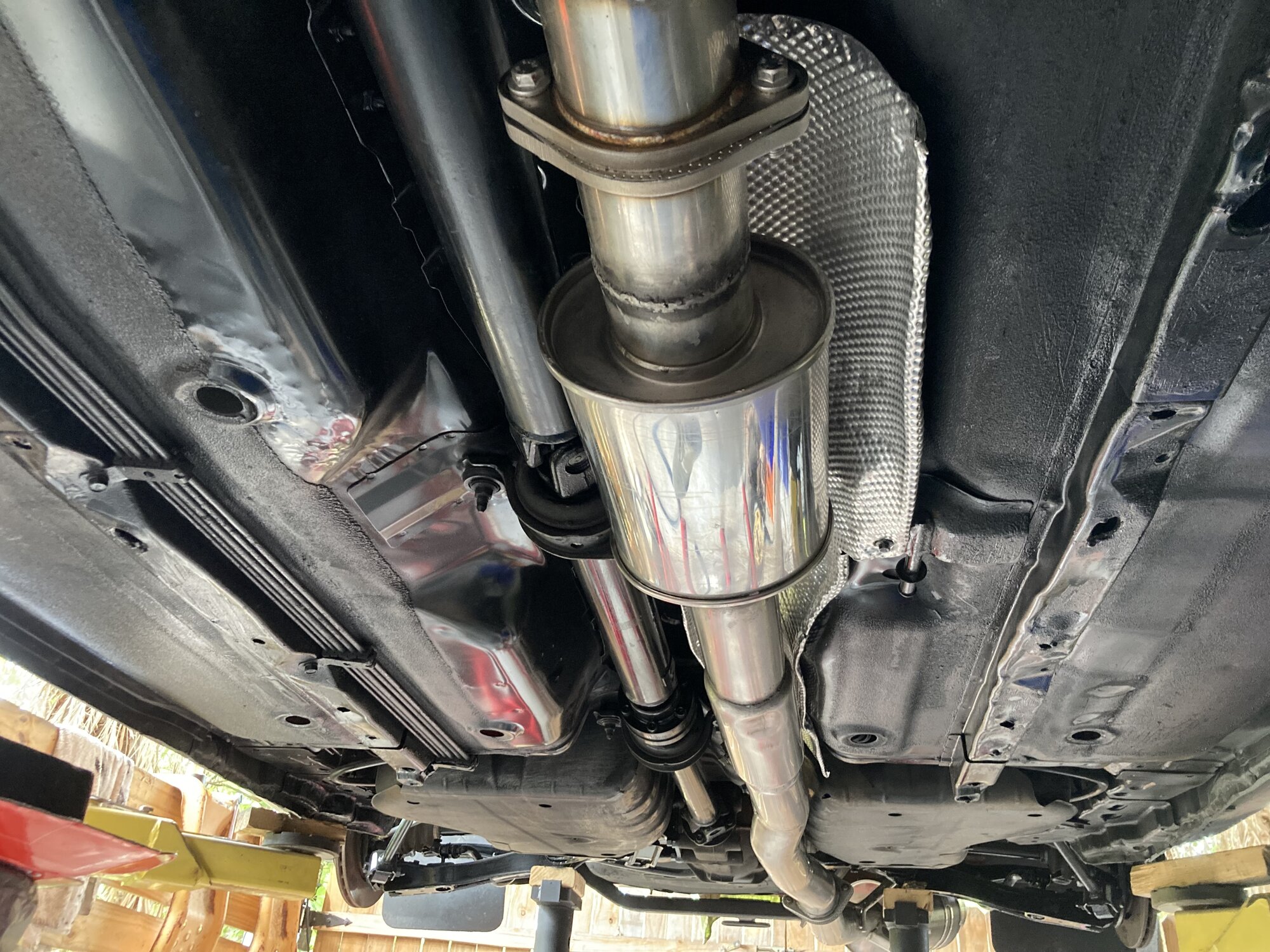

Sanded the exhaust system clean, added a high flow kitty 🐱 and a ultra- quiet resonator, and gave the exhaust shield a new look.

I used this stuff it’s great 👍 did the rear frame, drive shaft and axels. It’s not satin at all but w/e, I also sprayed this in the cavities that I sand blasted
I’m still working on shaping the last outer layer of skin on the rockers

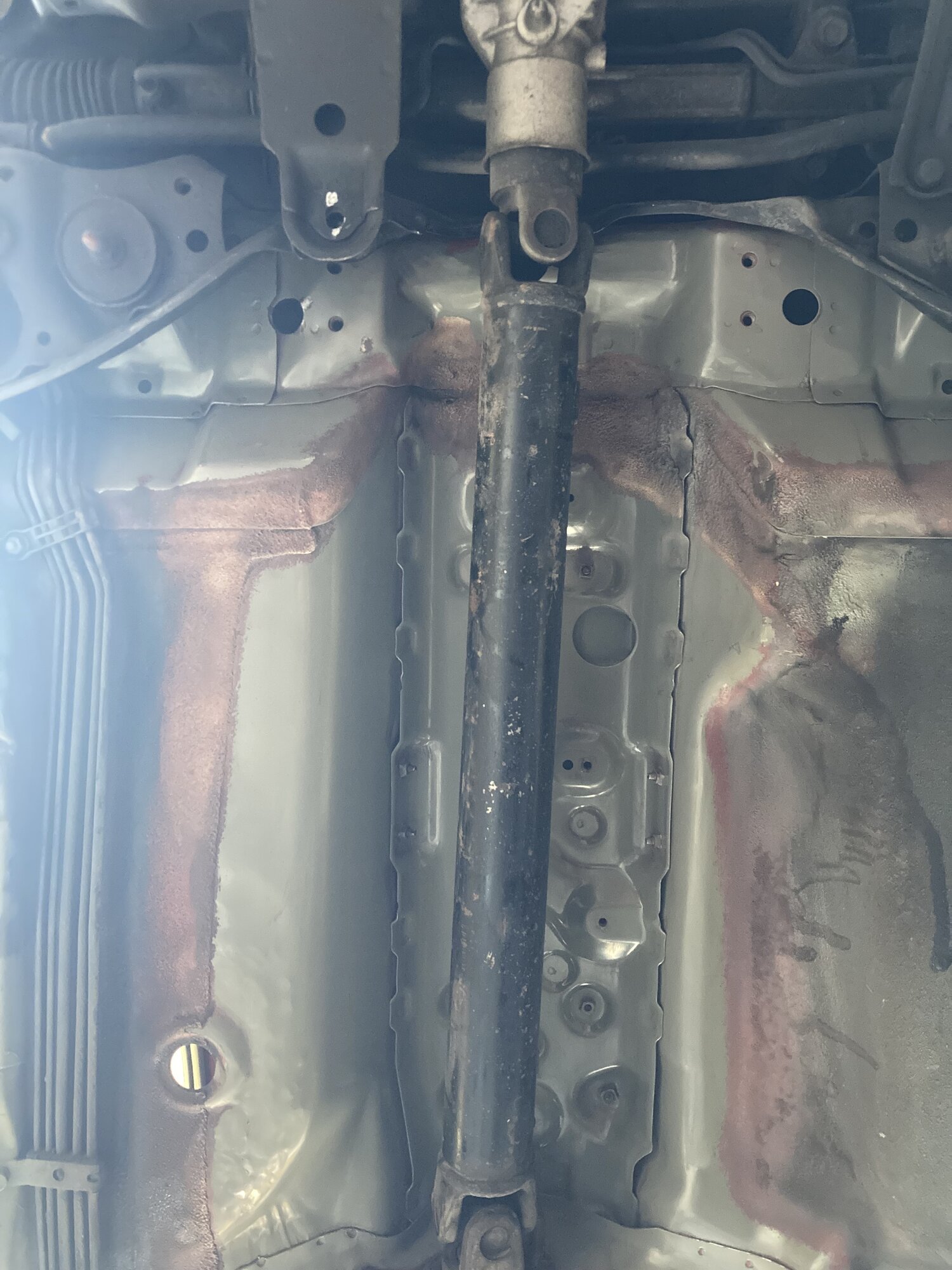

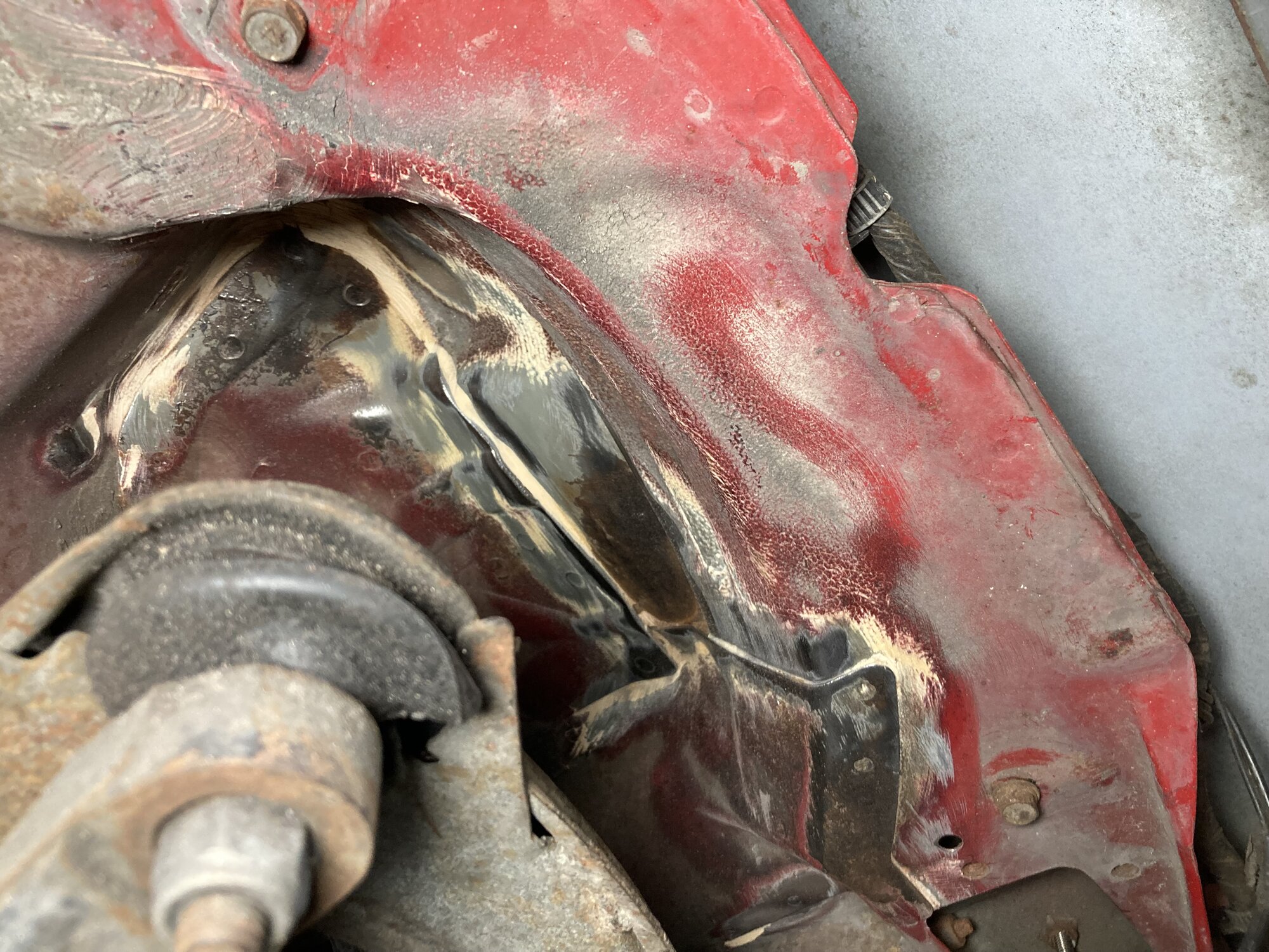

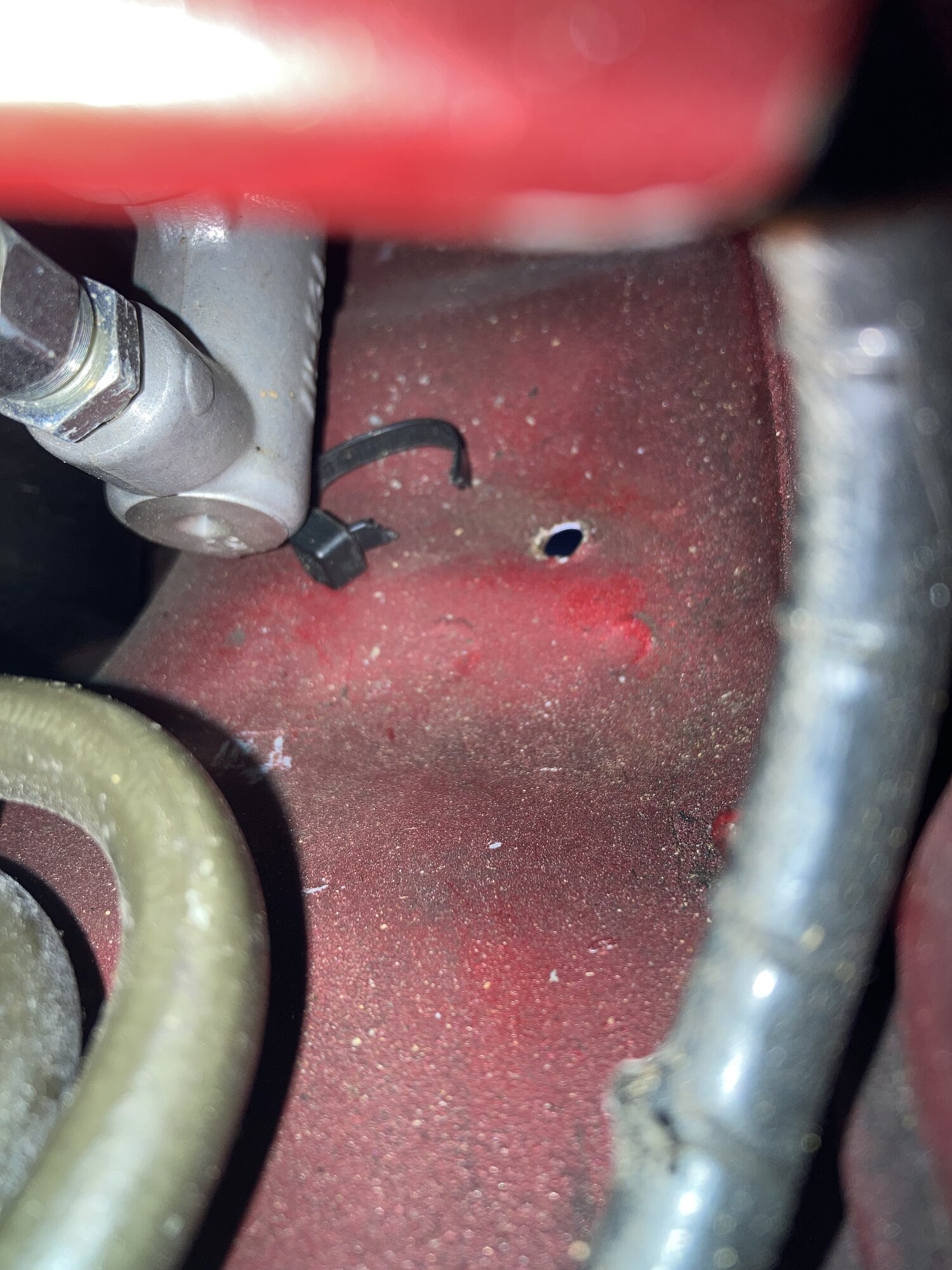

I found some surface rust UNDER the factory rubber coating on the wheel wells, so it’s looking like she is gonna stay on stands a lill longer …………all of this just so I can go back to slaving on the interior/exterior once she comes back down.

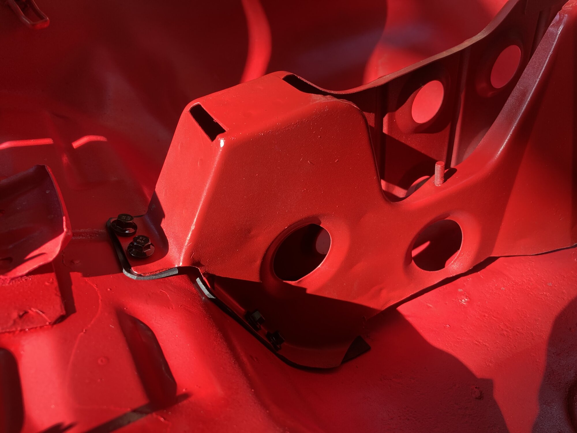

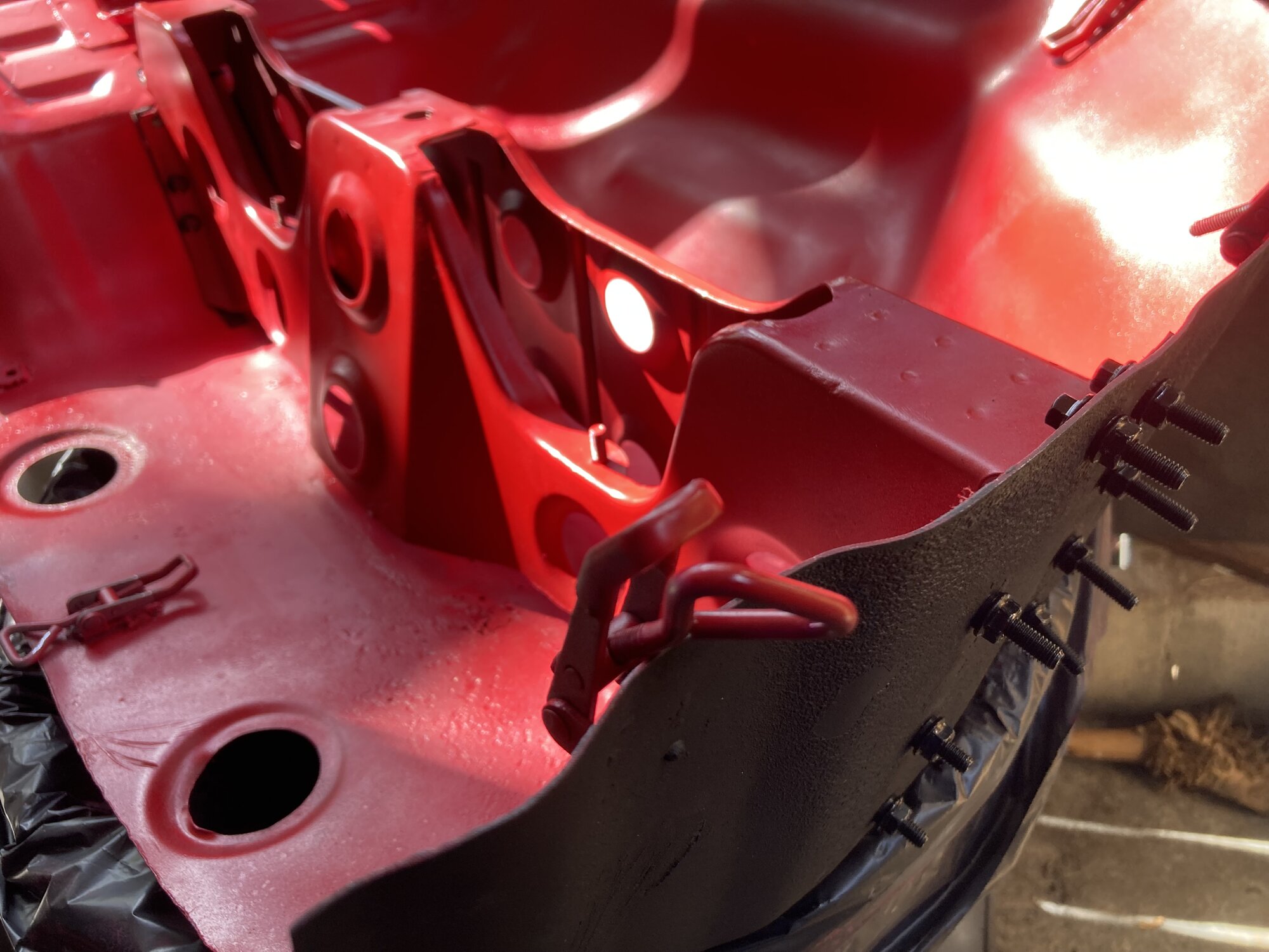

Circled back to the removeable trunk added more latches and tried to match the interior paint with duplicolor ……….. terrible idea, I decided to use bolts and gaskets vs re -welding the center brace / windshield wiper tank mount also added some rubber coating to aid with sound proofing under neath the trunk rustoleum also disappointed ☹️ as it seems to remain wet and sticky days after even with several light coats .

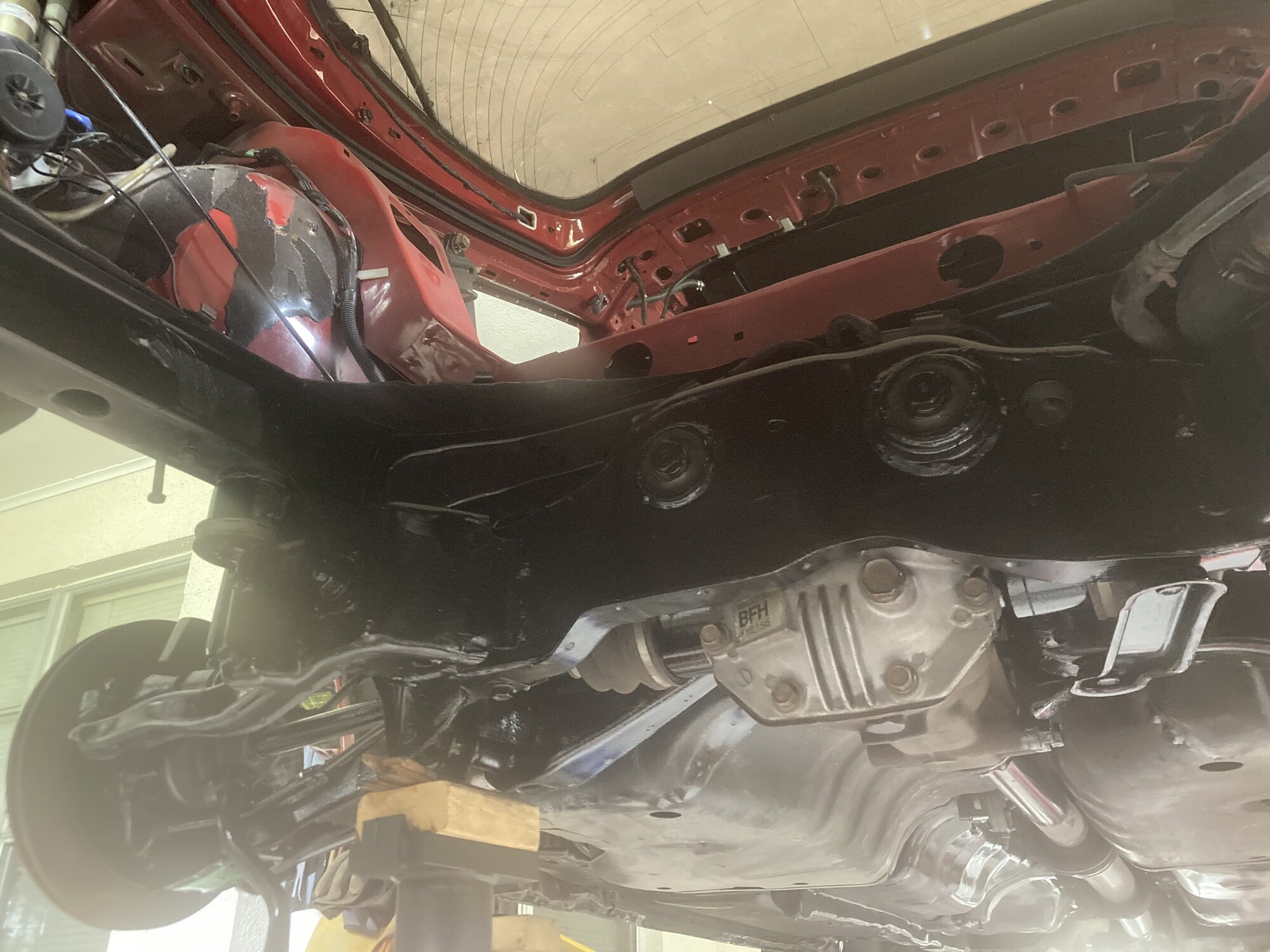

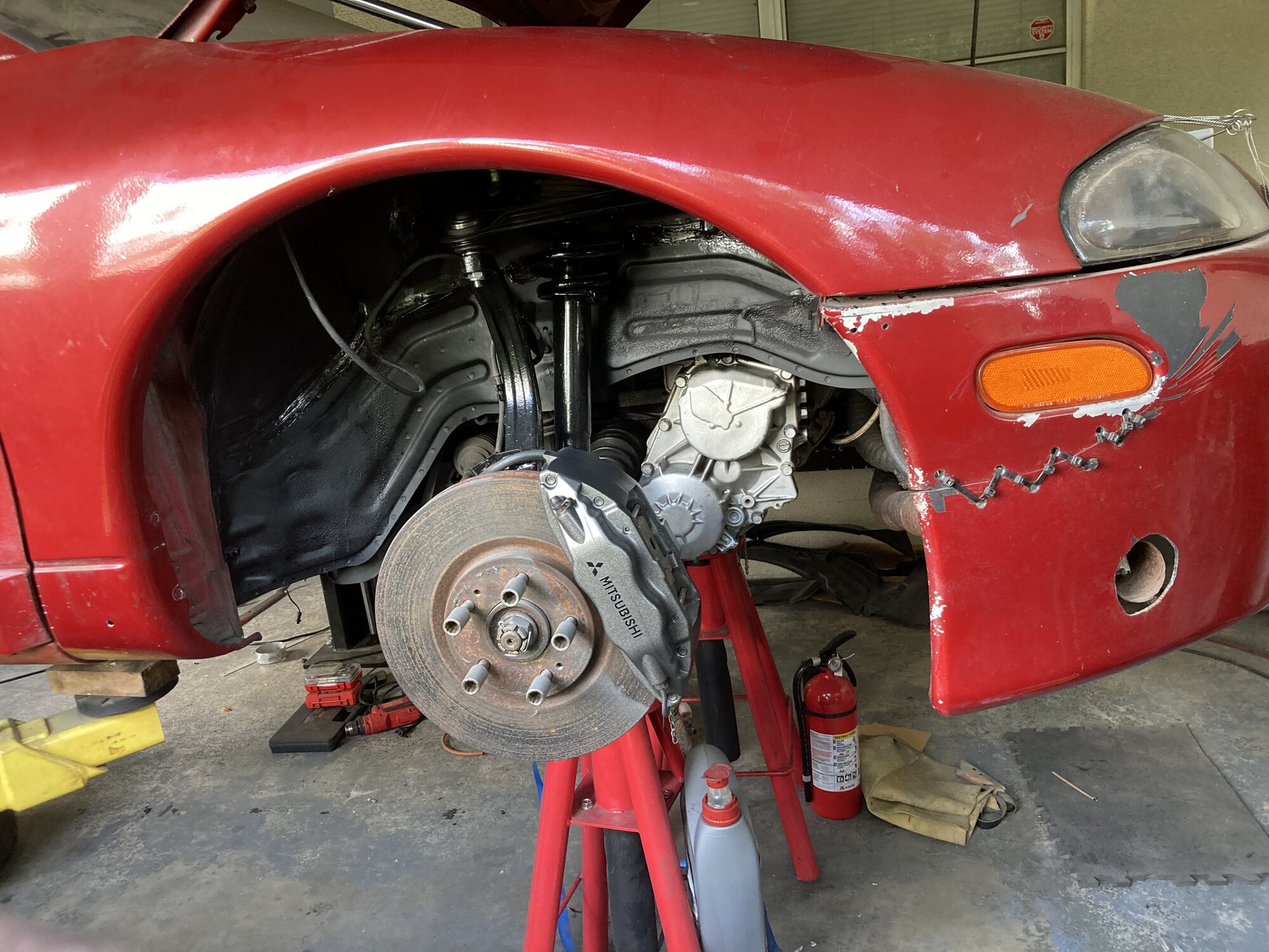

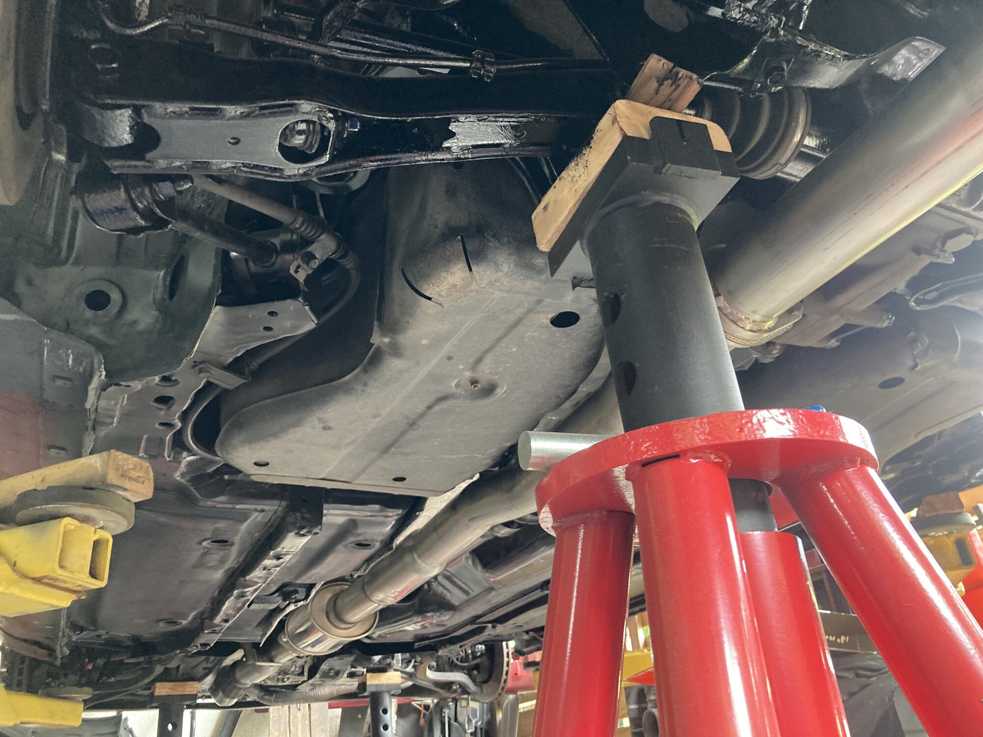

Now that I’m finally done working under the belly and the rear end, I’ve moved to the front
And unknowingly stood face height to a swarm of hornets 🐝 that made a home in my front bumper waste gate exit hole.
I was viciously attacked and it hurts in ways I haven’t experienced pain…. In some time.

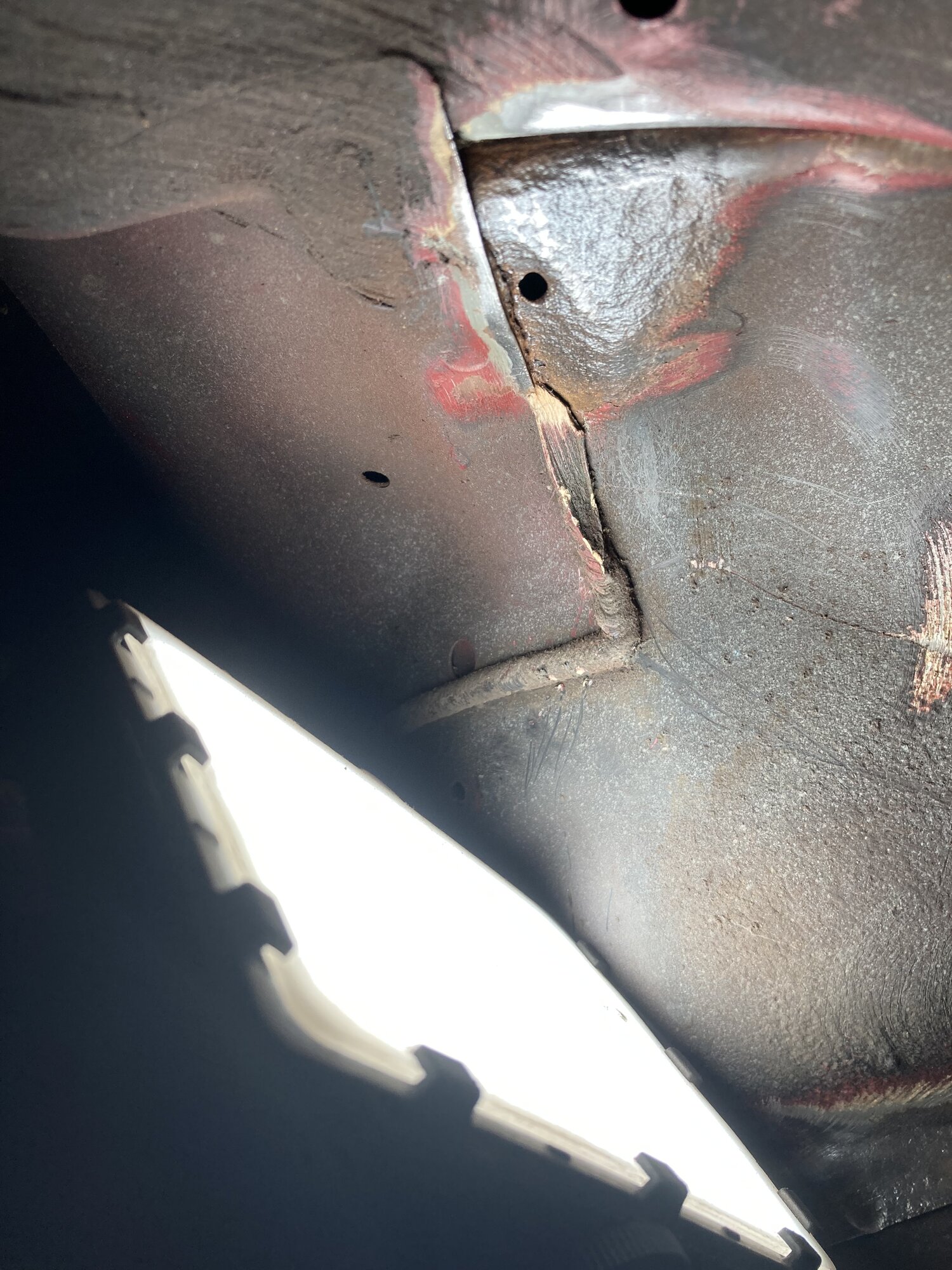

Anyway i notice the rust under the factory rubber coating appears to be only along the seem.
You can see the pitting is only an inch from that seem.

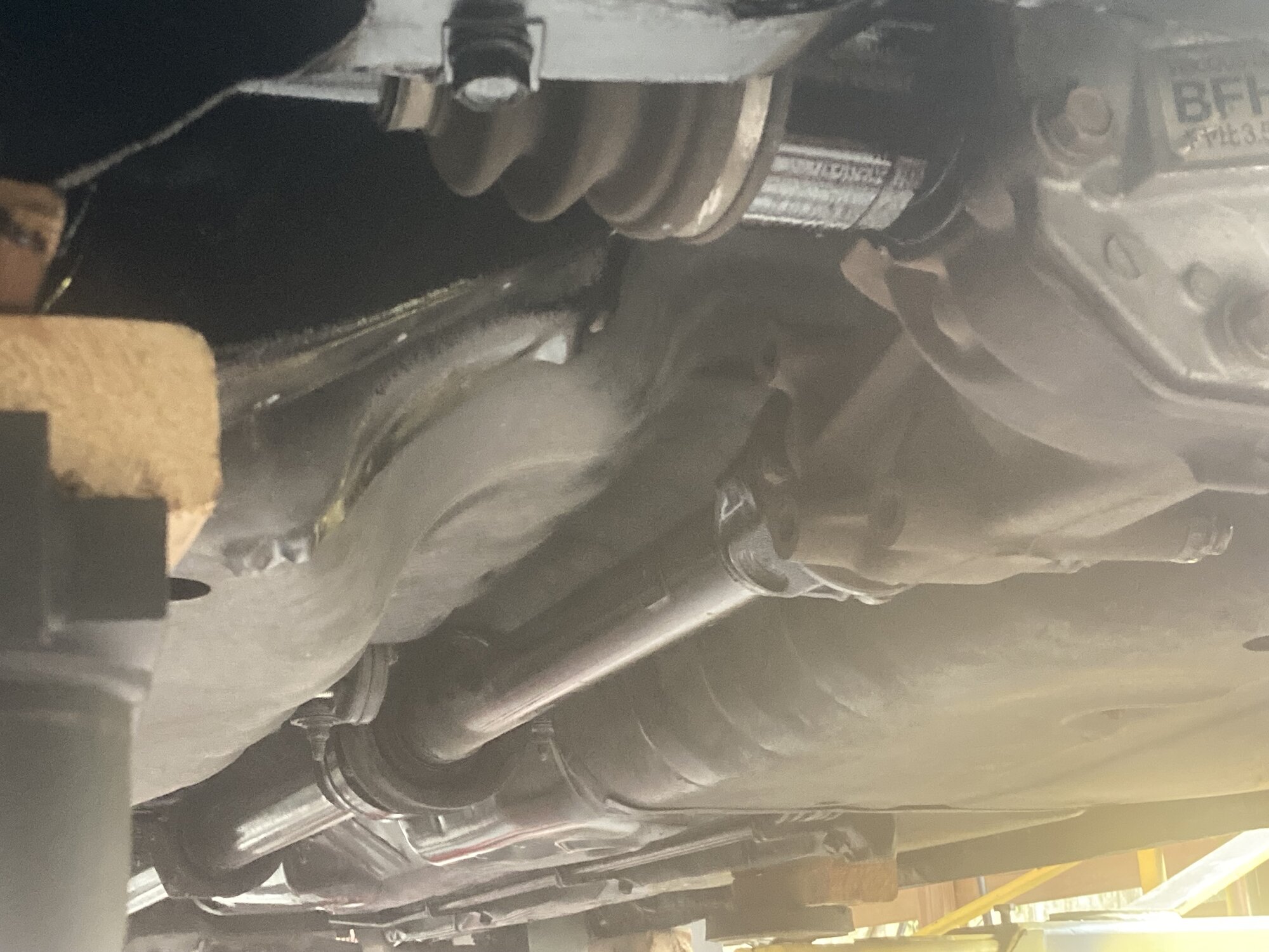

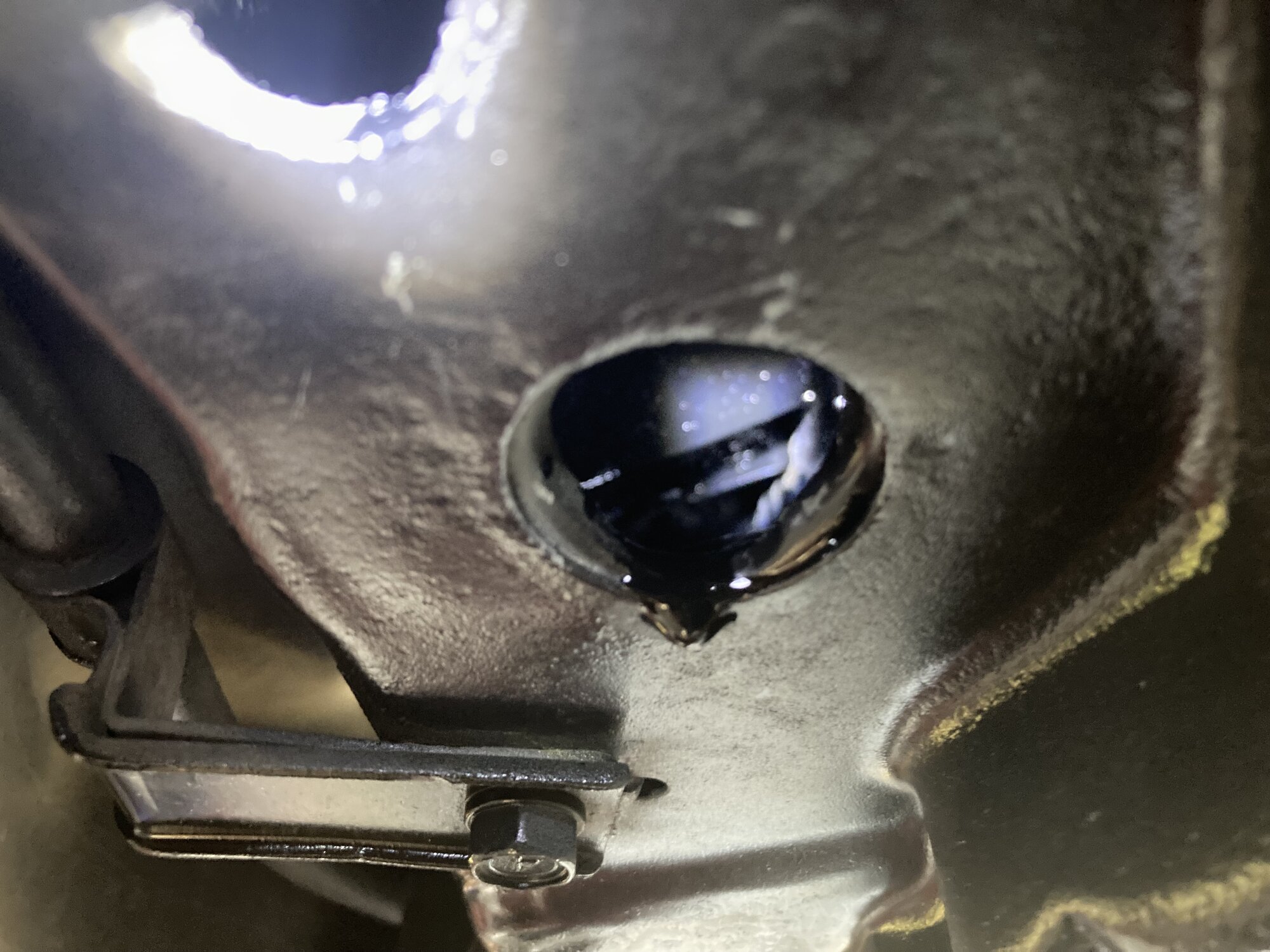

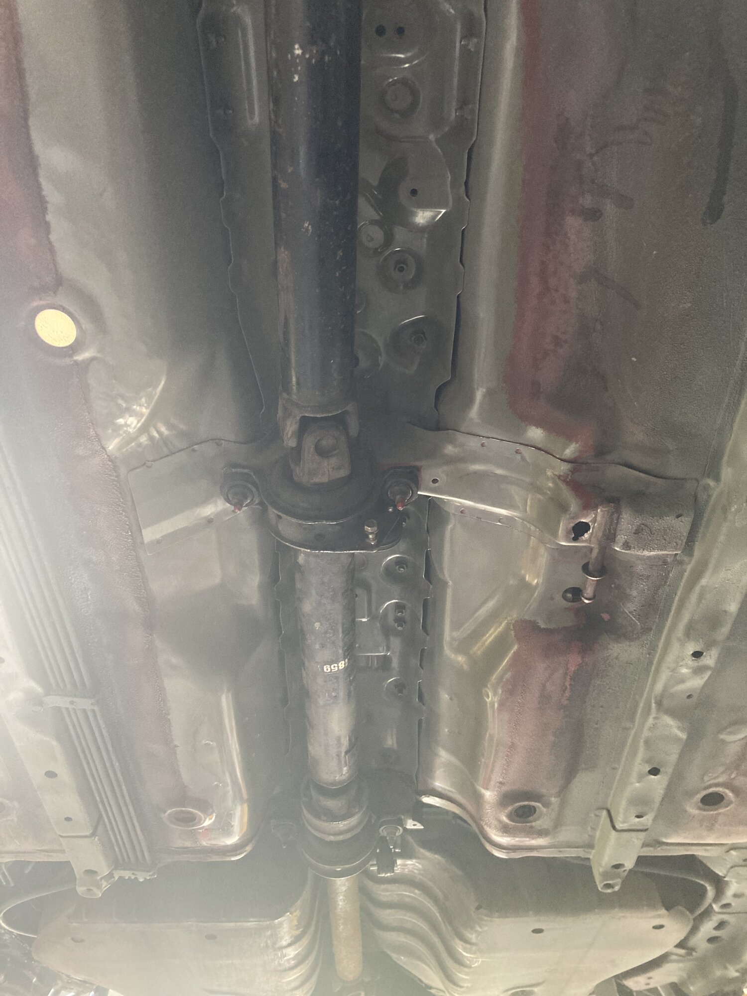

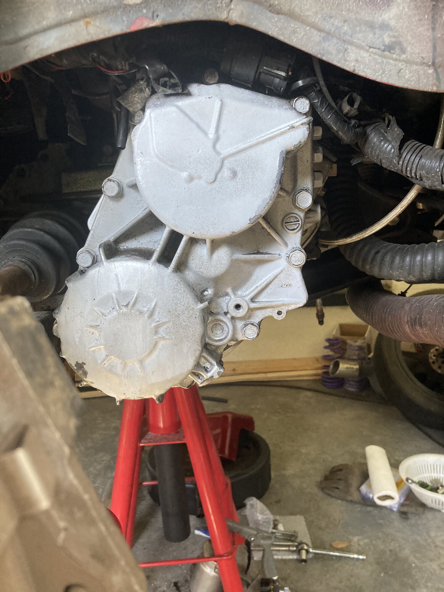

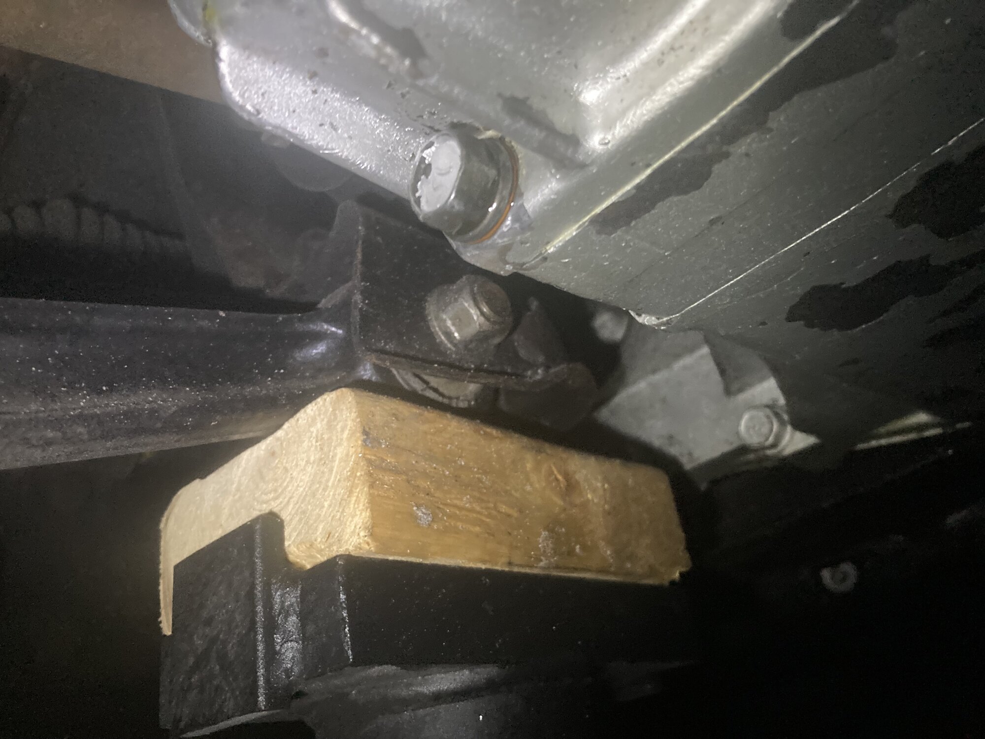

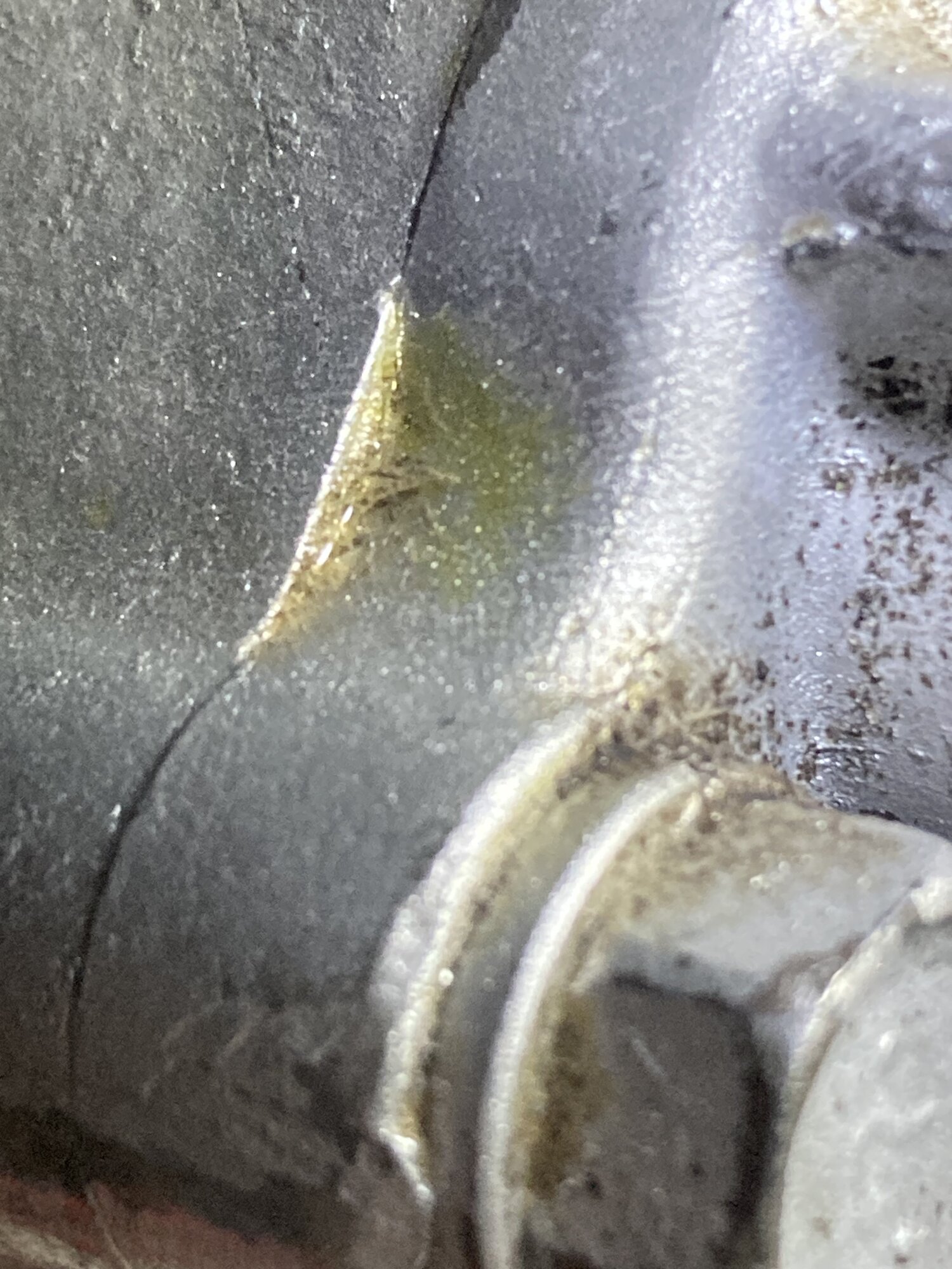

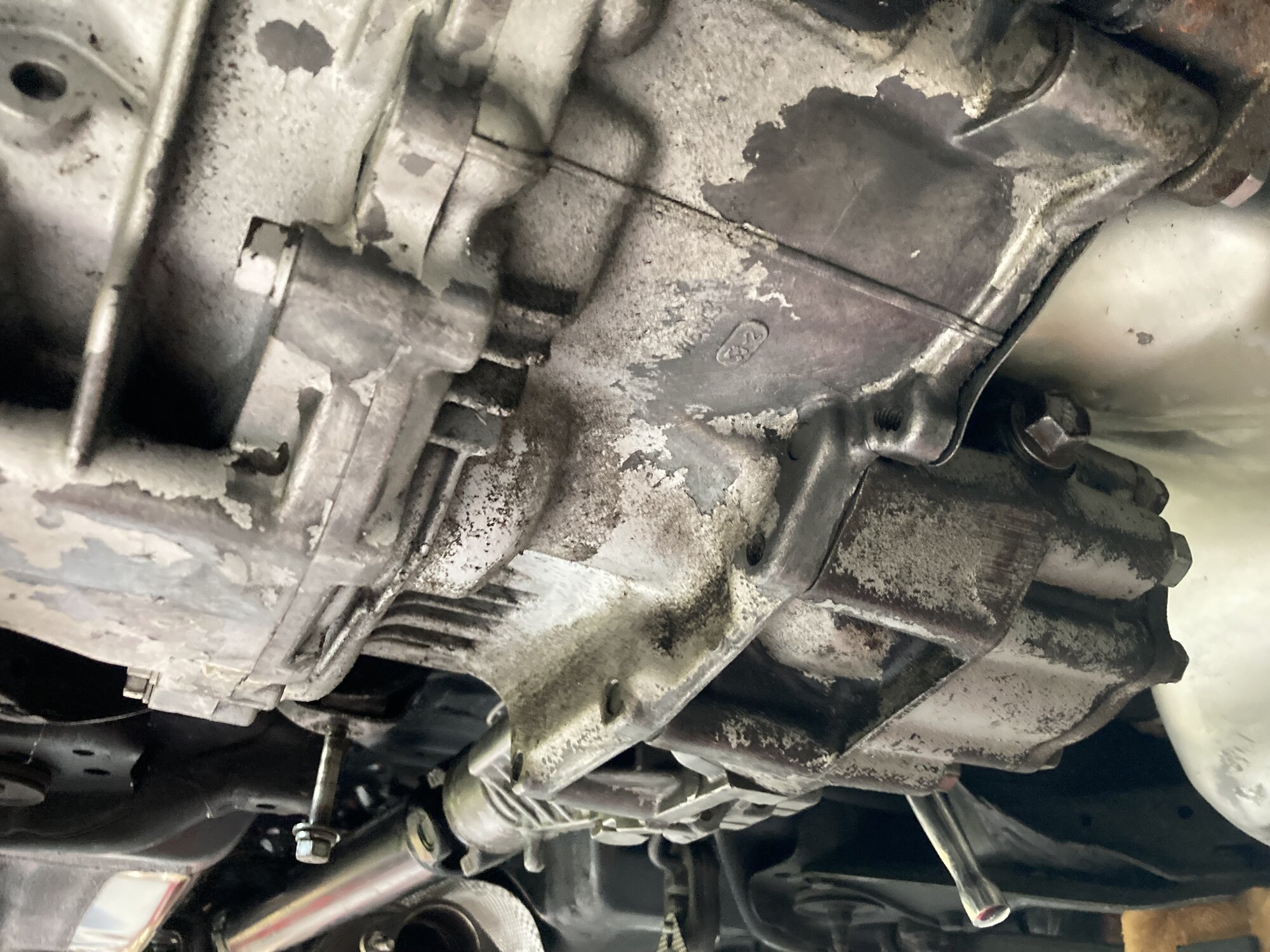

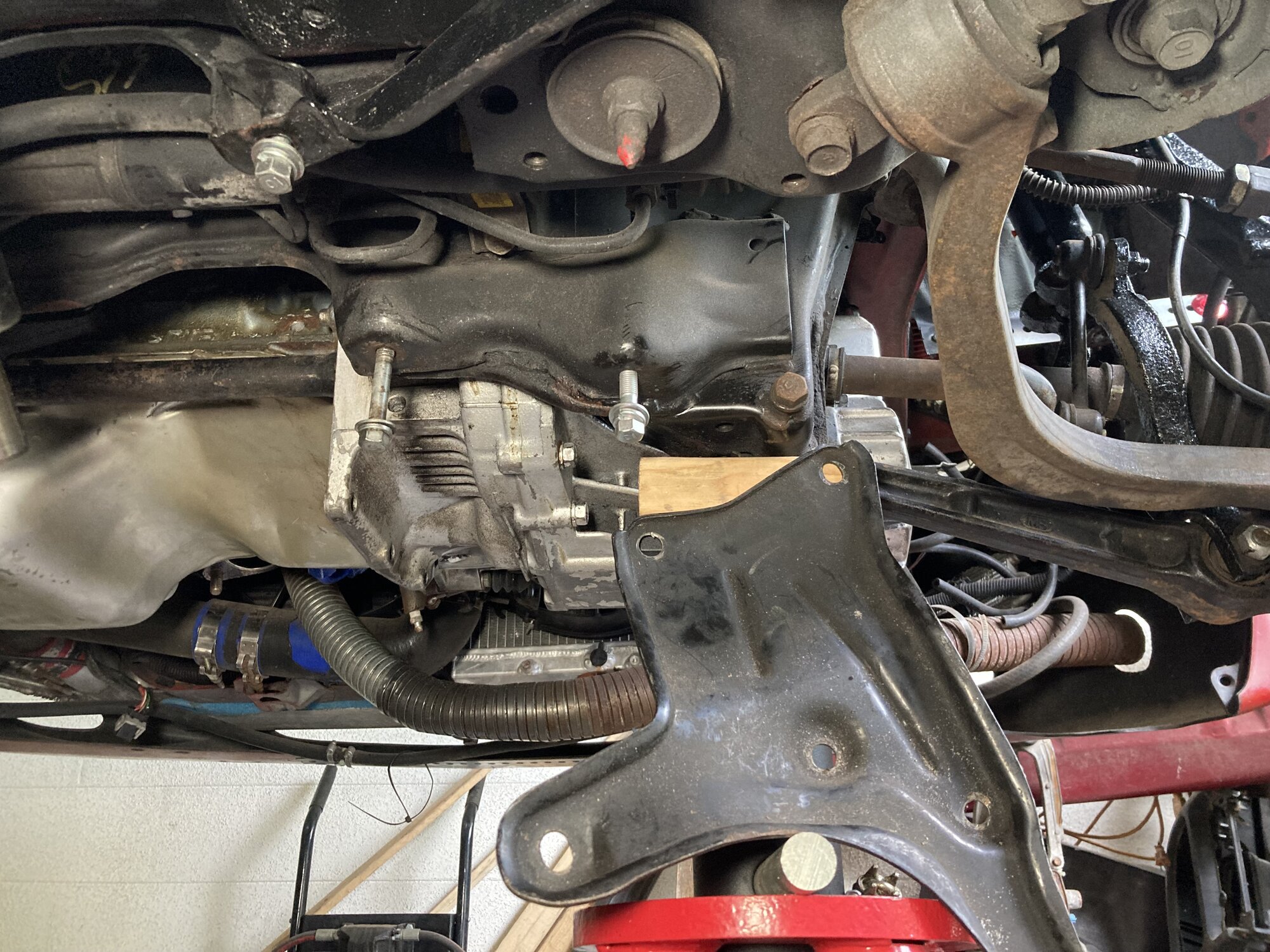

And additional I was able to confirm that am I am leaking bewteen the mating surface of the rear to middle case for the transfer case.
But wait : theres more - I also found that I am leaking from the mating surface of the transmissions rear case
previously i thought it was leaking from this one bolt, but I realized that’s just were the oil would pool.
If not for the lift/ tall jacks, i really would have never really been able to diagnose this.
I always had a sweaty 😓 drivetrain … 😢
My goal is to just address any and all issues related to being under the car- I hope to never have to come back so Im still looking for things to resolve.
Just a lill more and she can come back down.

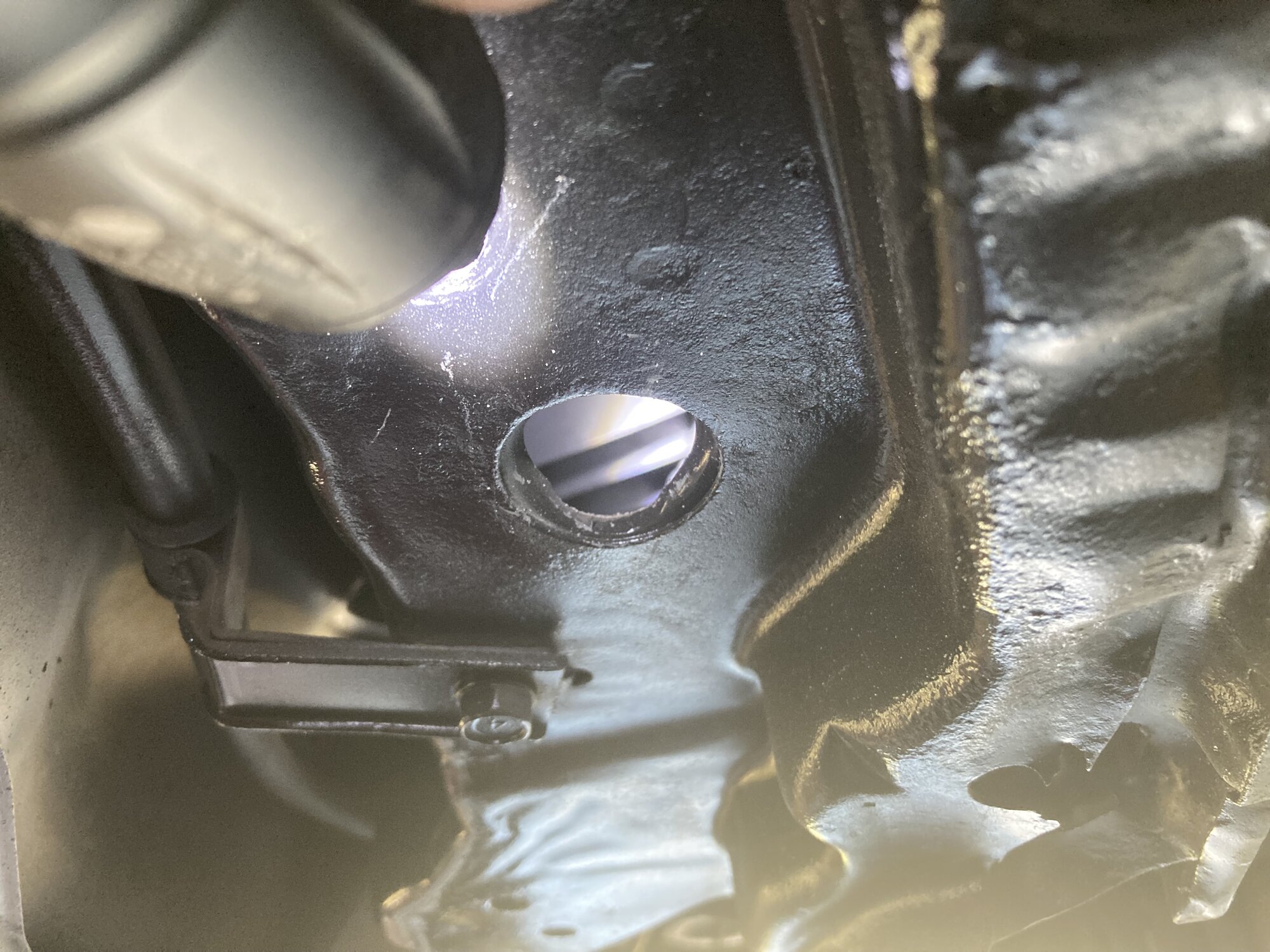

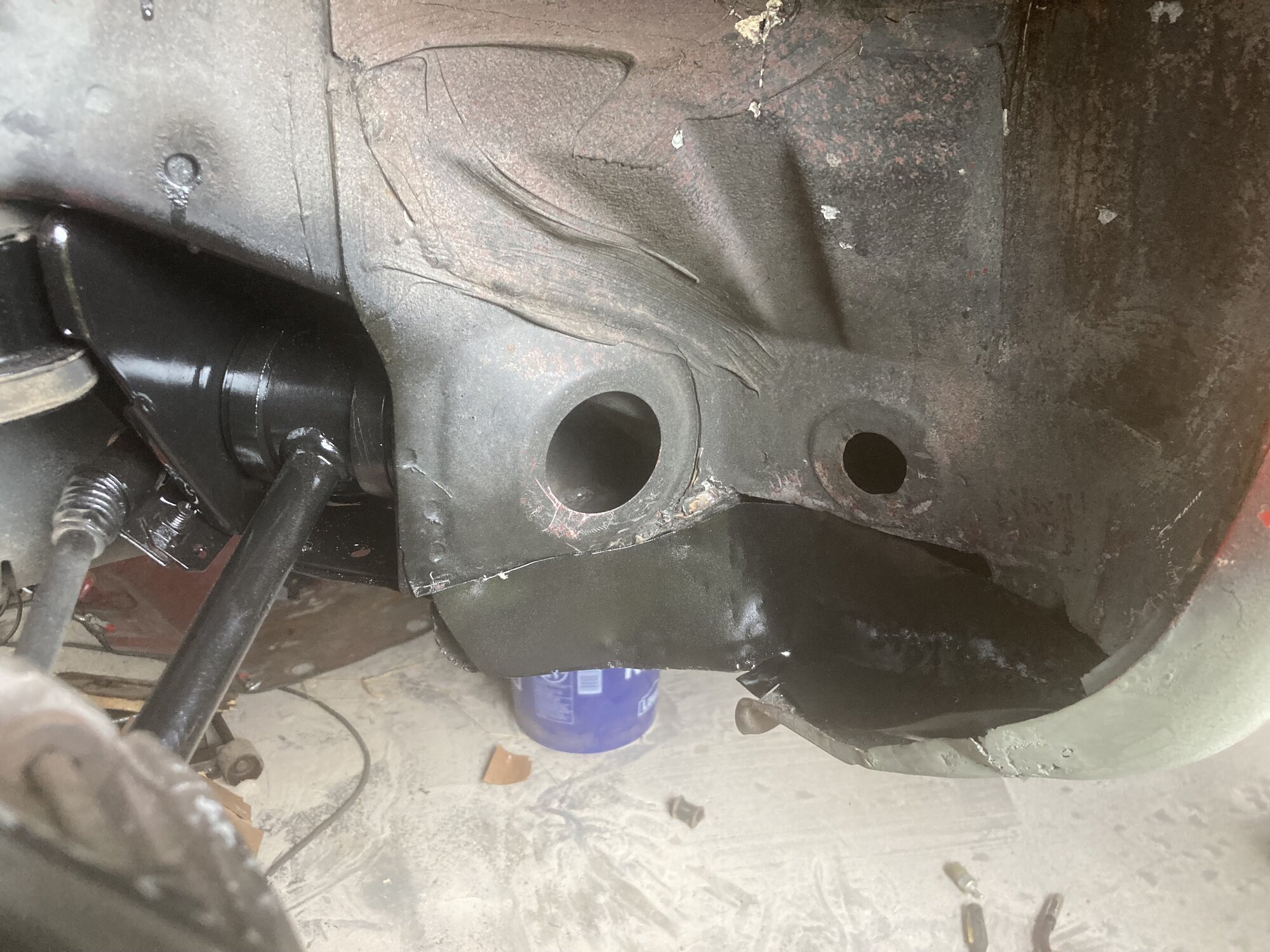

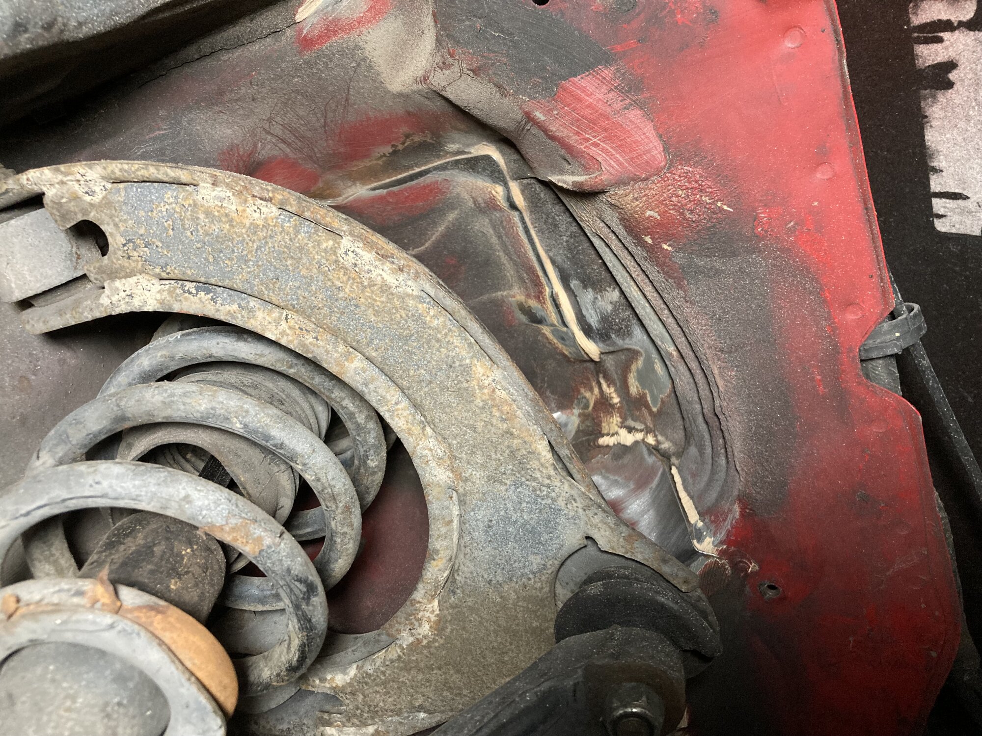

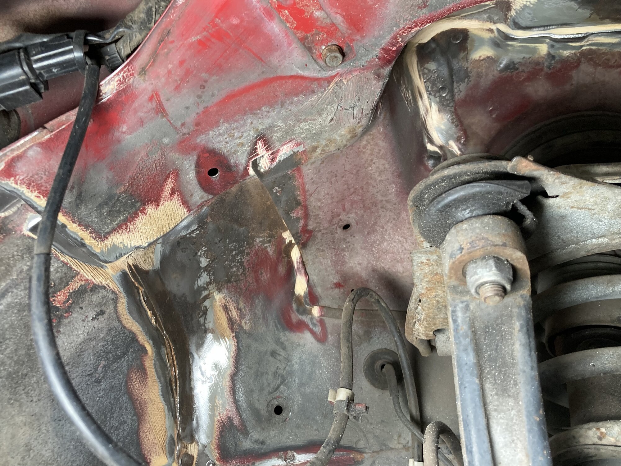

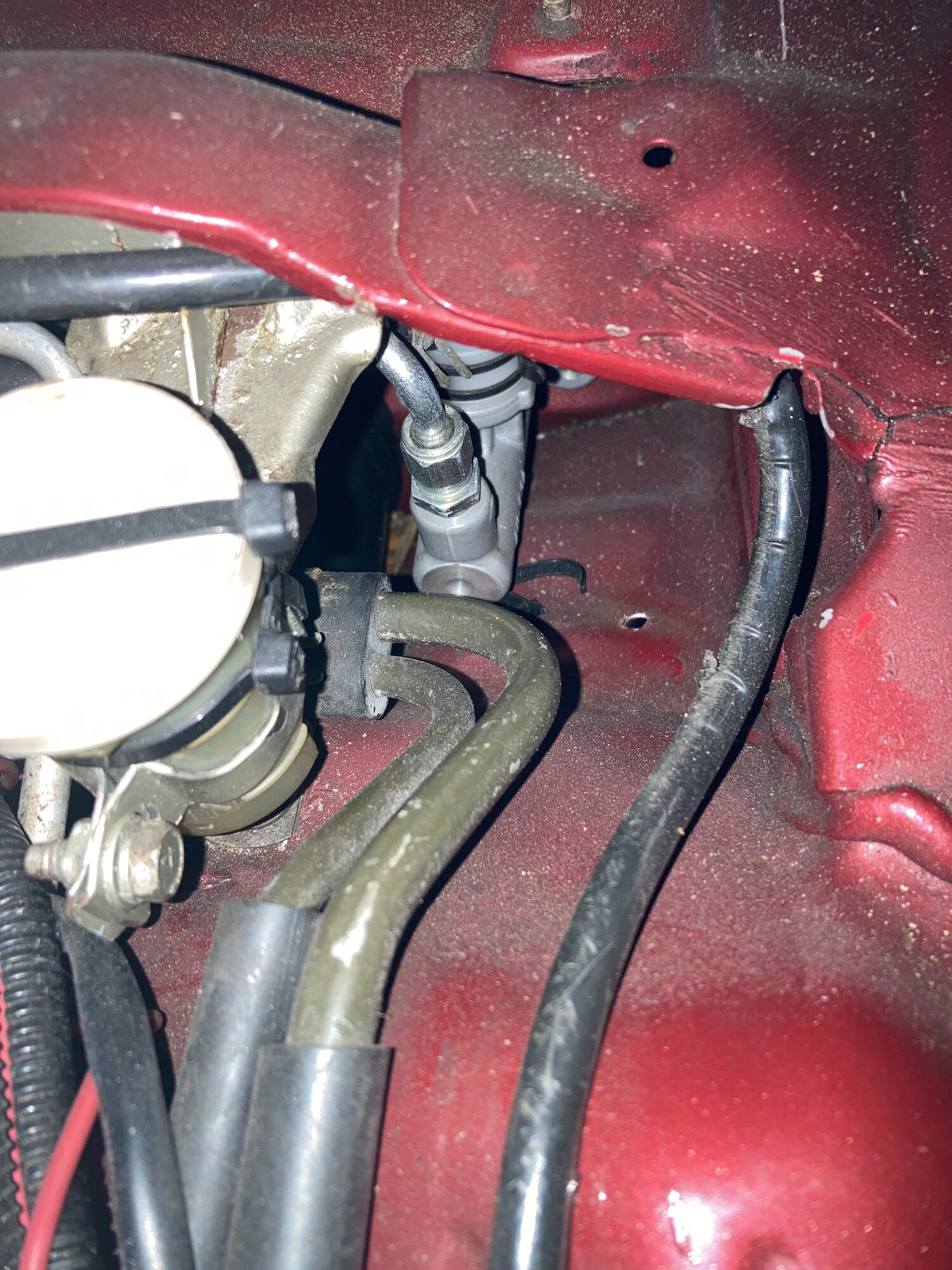

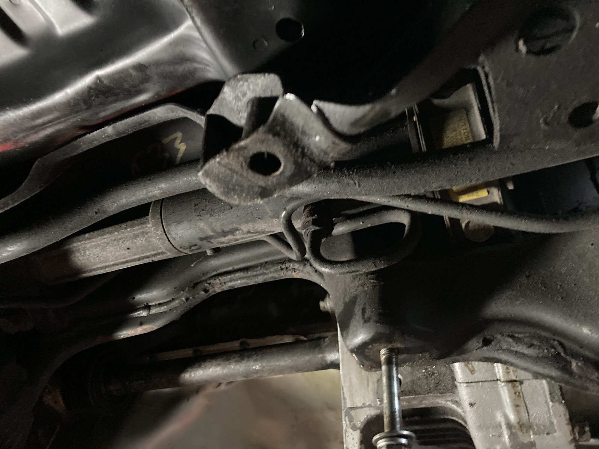

Other side - some areas look fine but theres subtle hints, some areas i just do at random , pays off sometimes.

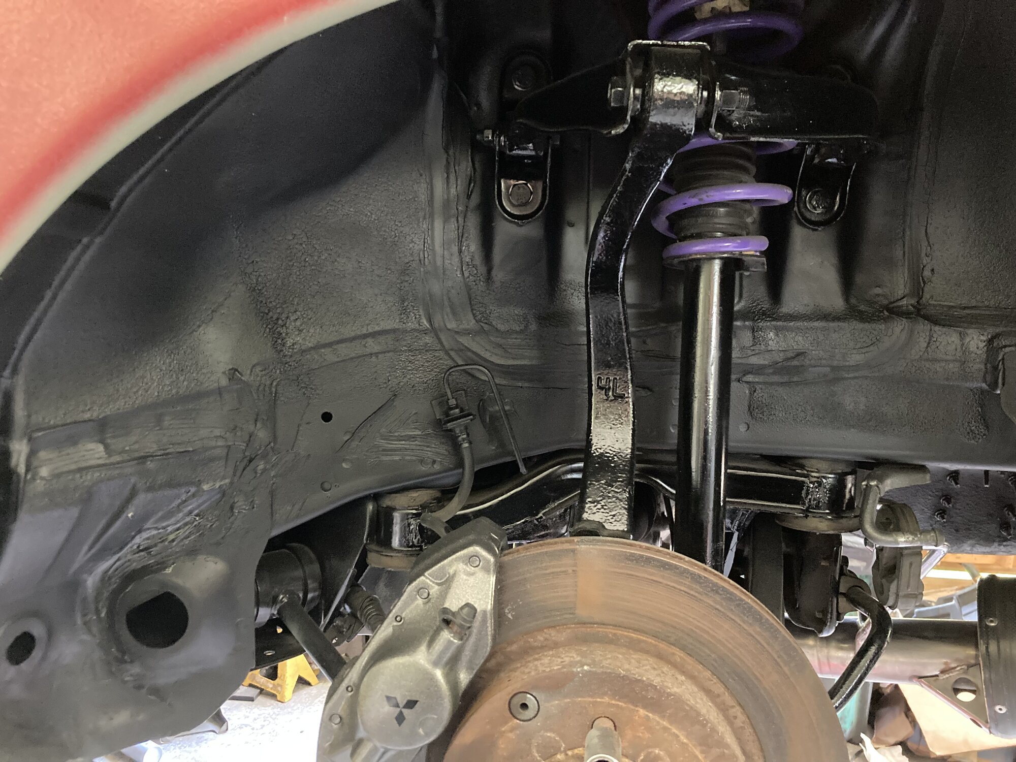

Im purdy sure this is how struct tower rust gets started, it has to be coming in from the wheel well.
The thing is all of this is hidden and looks perfectly normal with the factory coating / sealant…
Not bad though easy to primer- paint , reseal and …… idk 🤷 maybe re rubberize ????

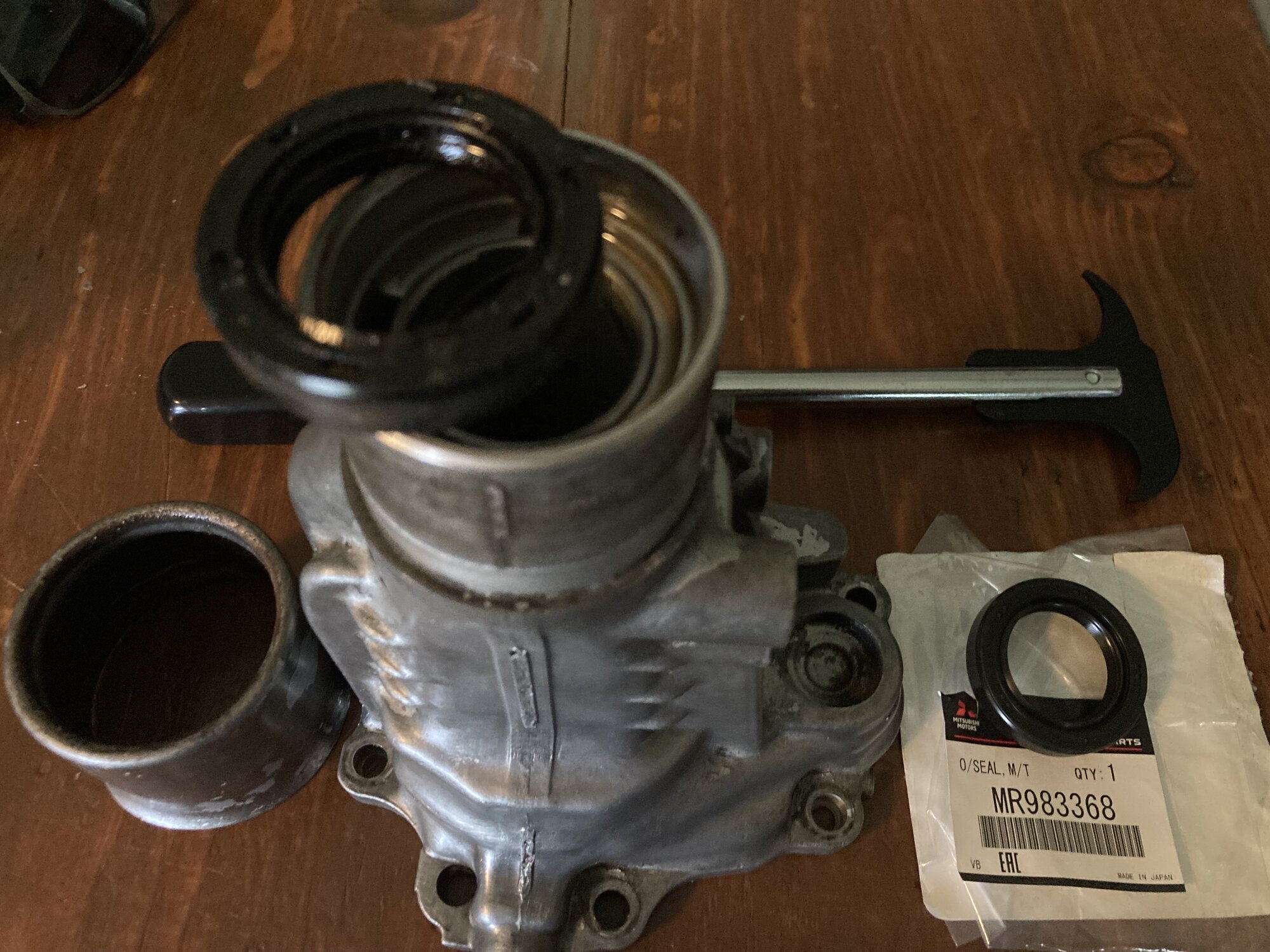

Split the Tcase up to add new RTV to prevent leak - no more leaks.
And added RTV around the AN fitting to finally stop the last tiny engine leak.

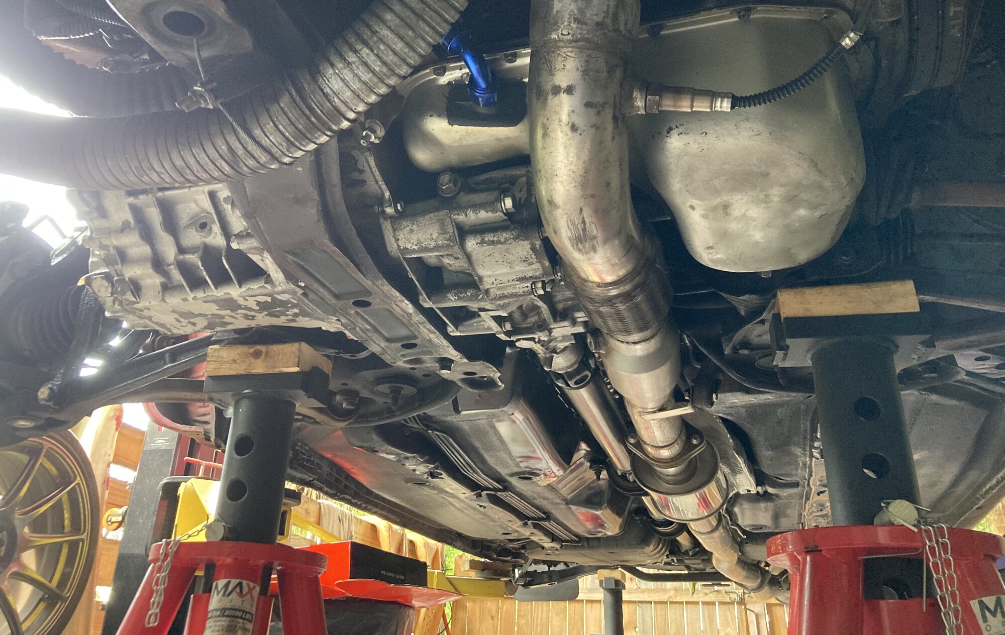

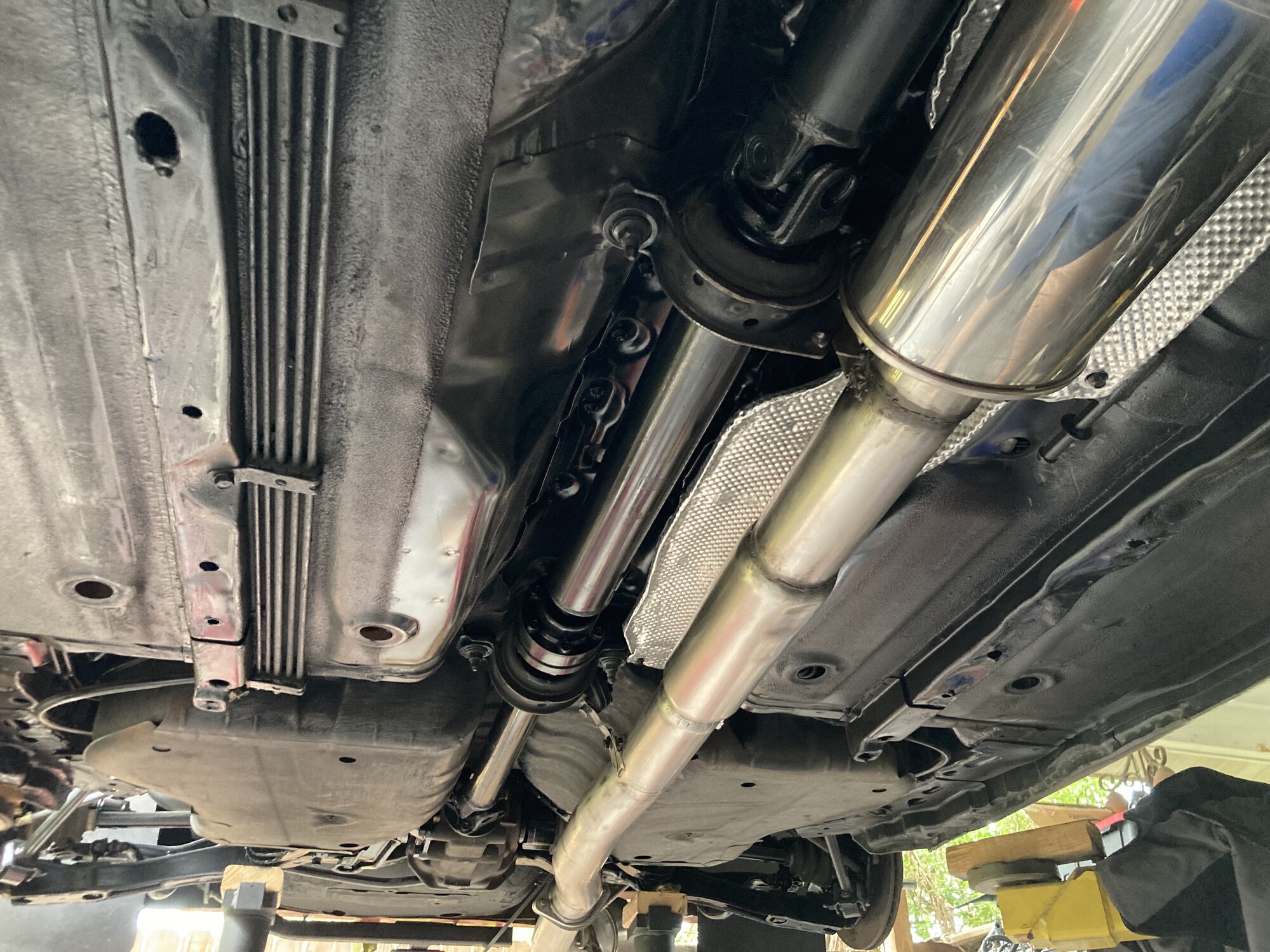

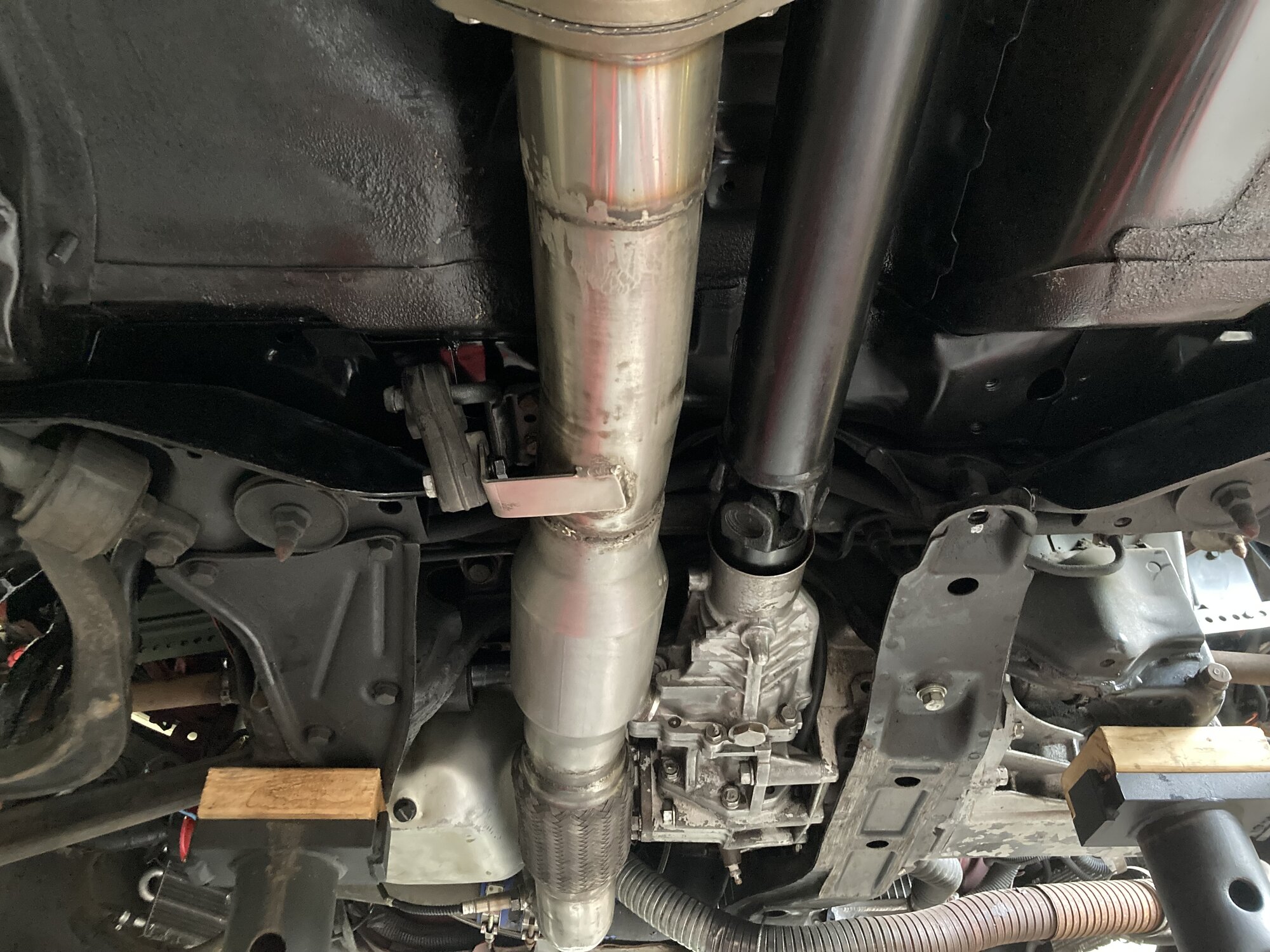

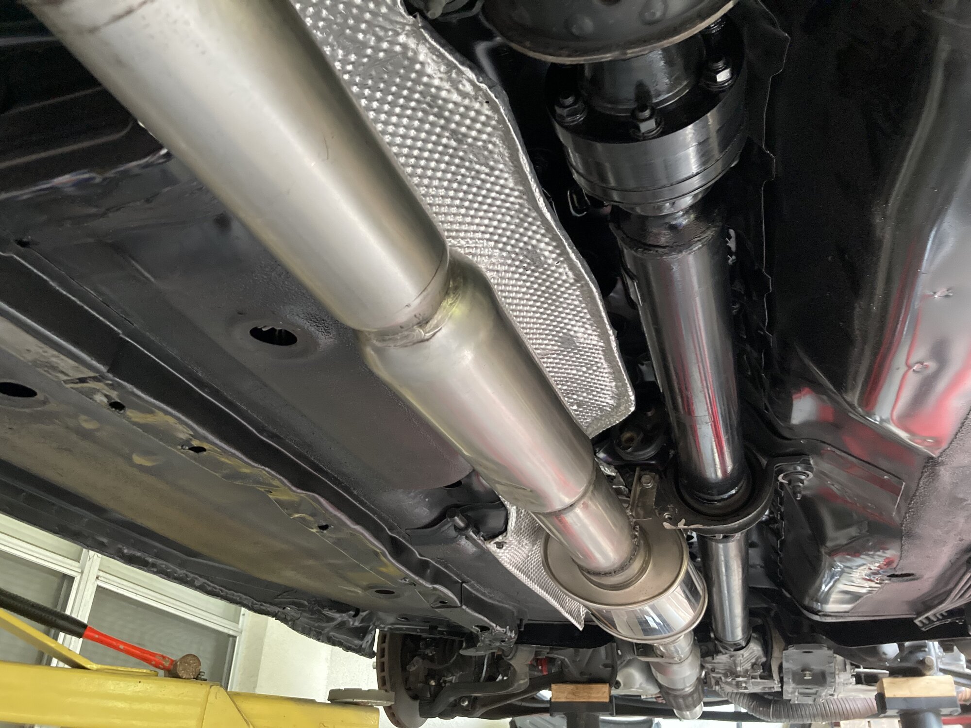

Exhaust finally back up - interested to hear how she shounds with the Cat 🐱 and Resonator

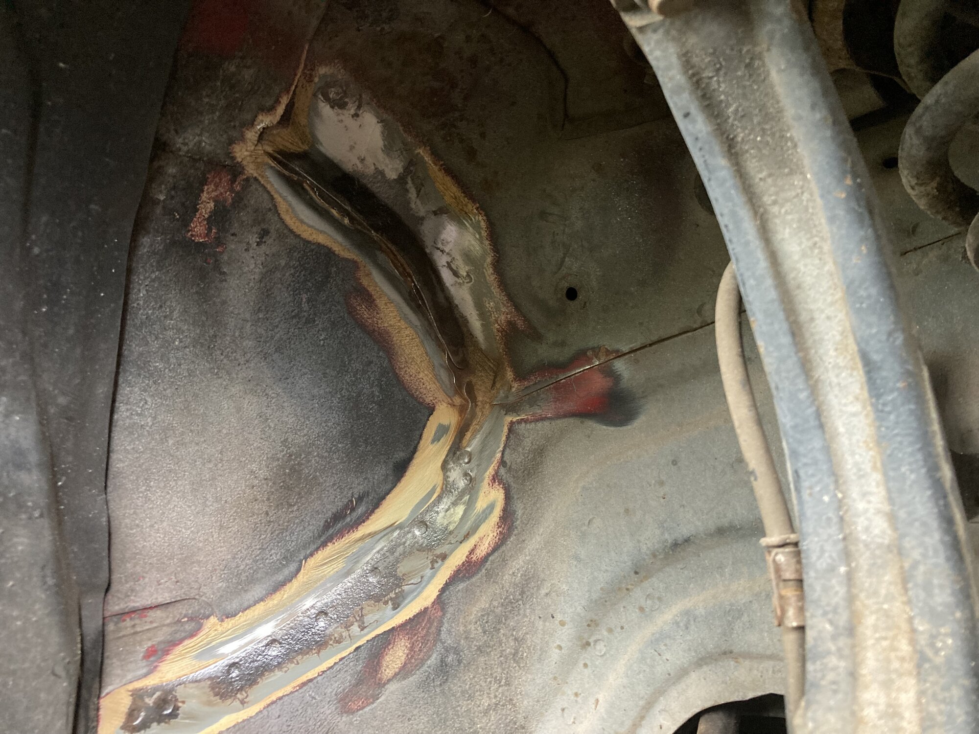

From this view we can see the rockers have been fully repaired and restored and all the rust has been removed- saving the chassis. You can’t even tell it was all gutted chopped and blended back.

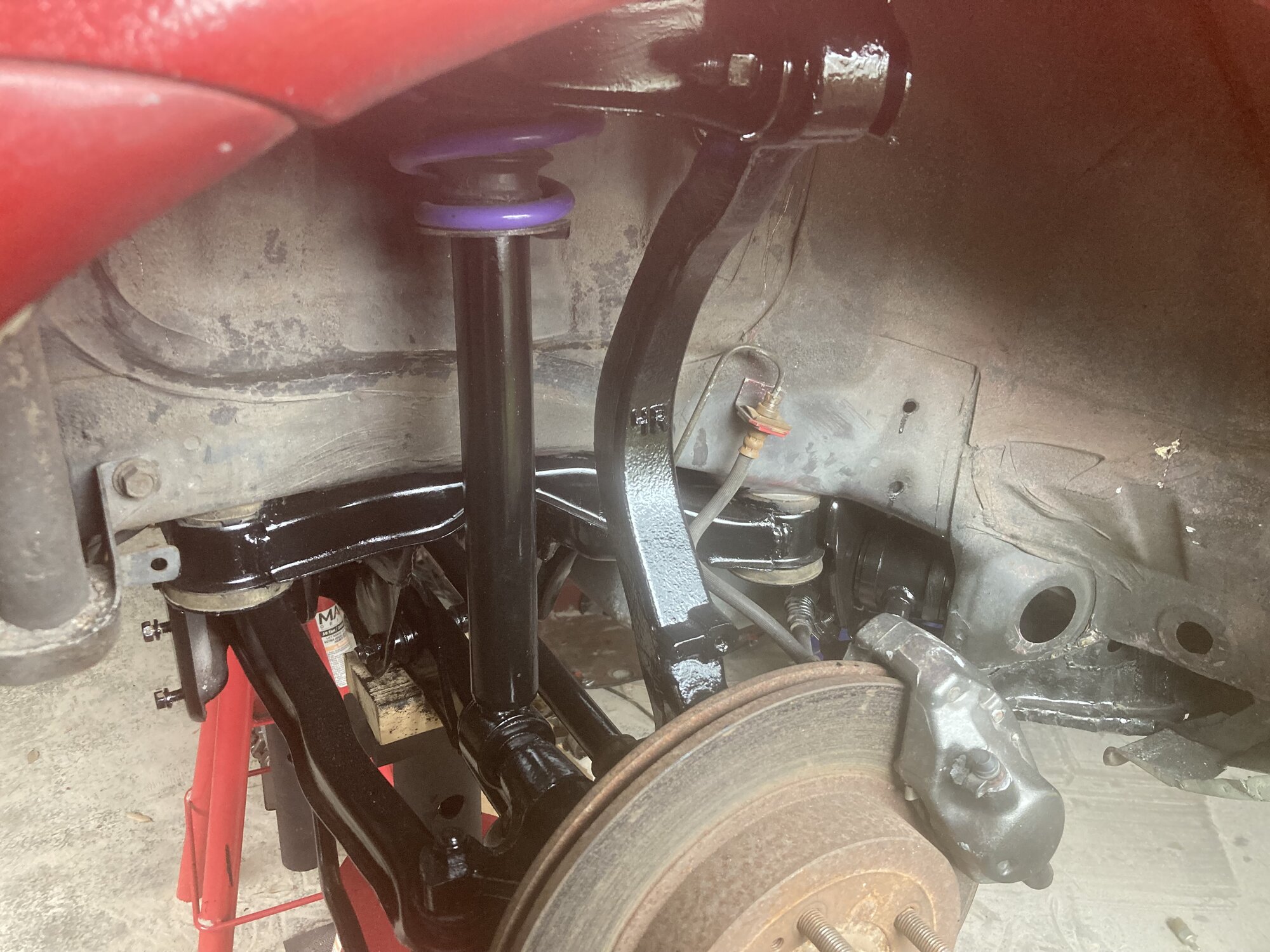

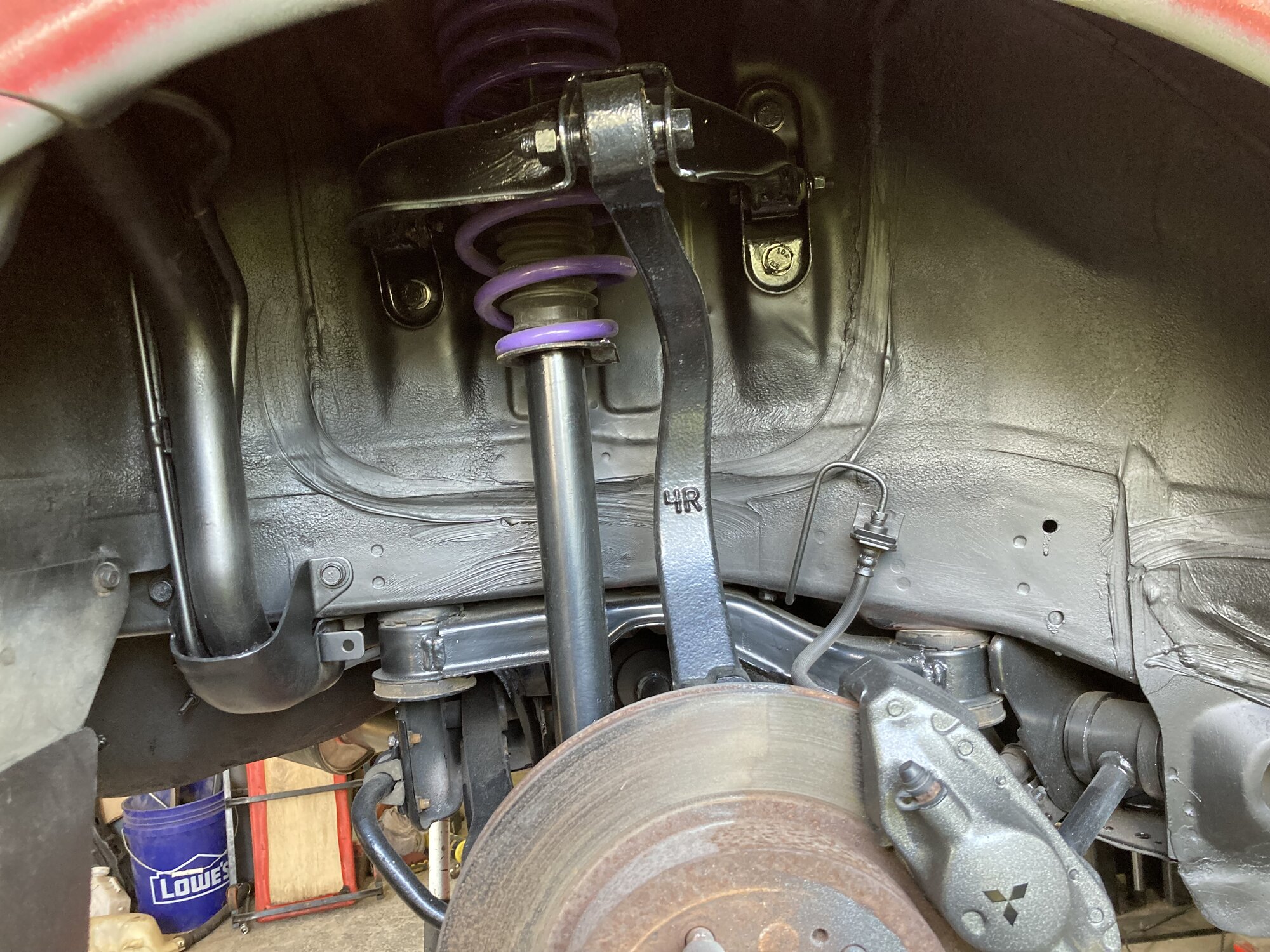

Finally the undercarriage is restored and the leaks in the Tcase and engine are fixed.

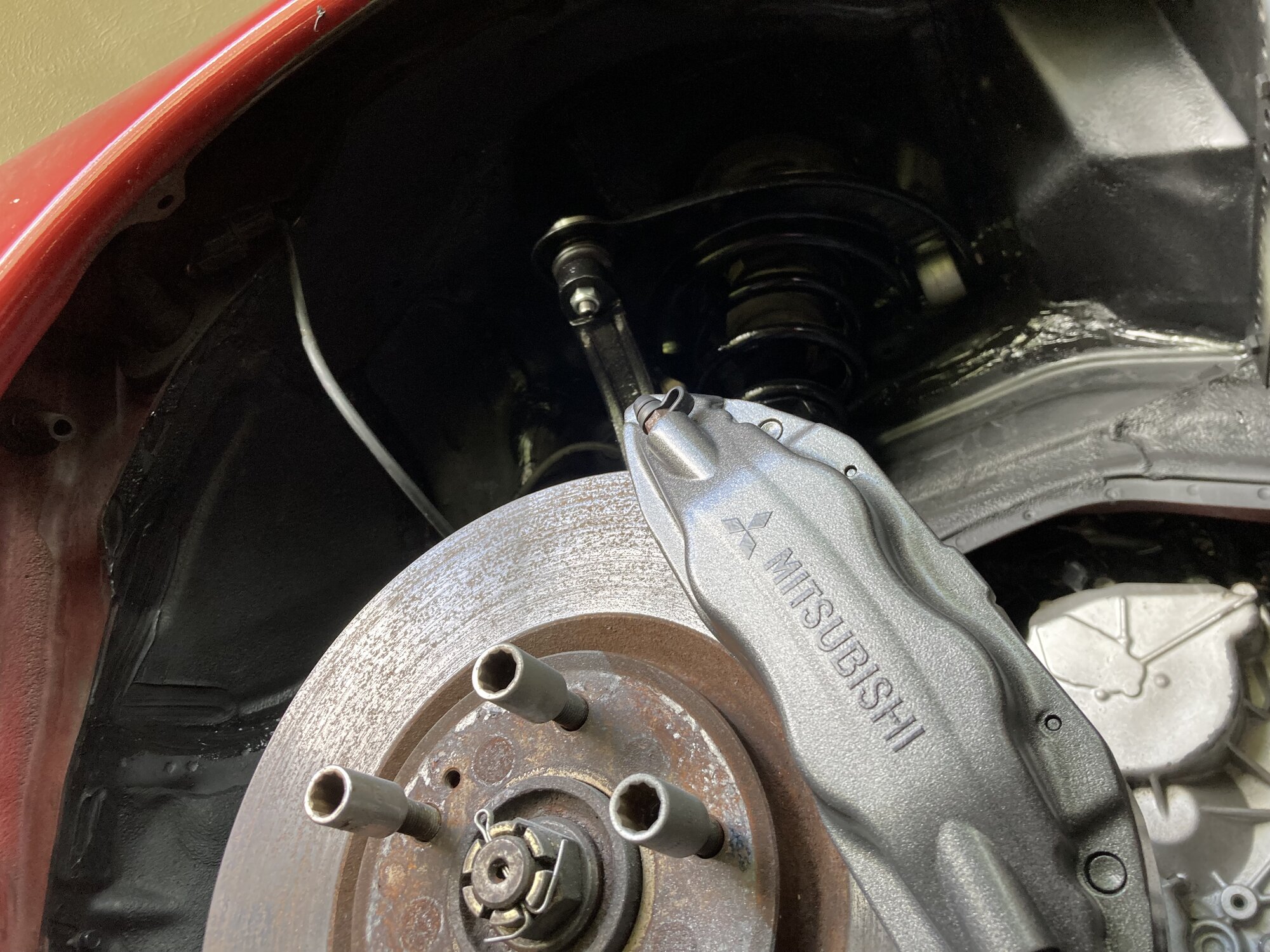

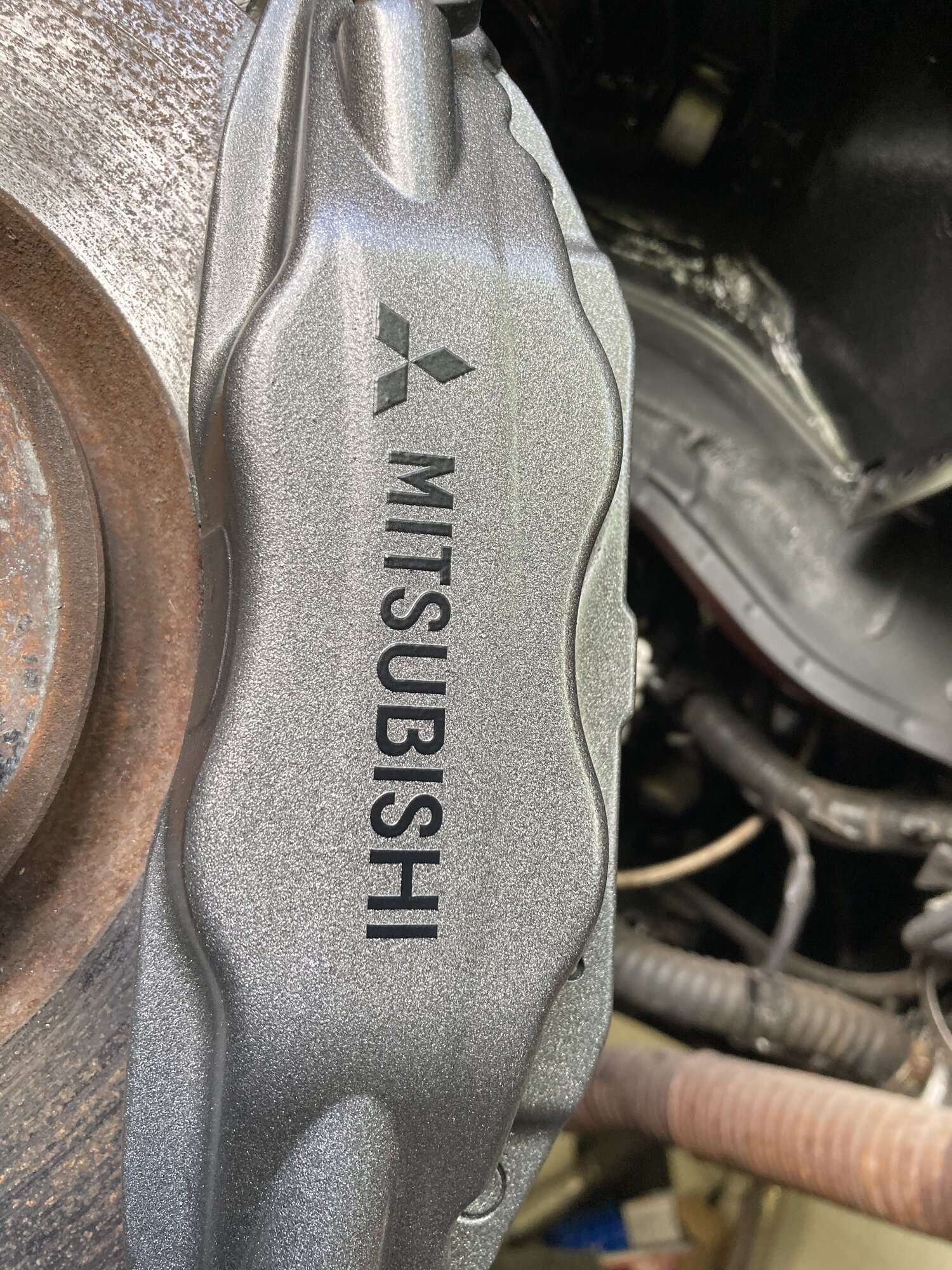

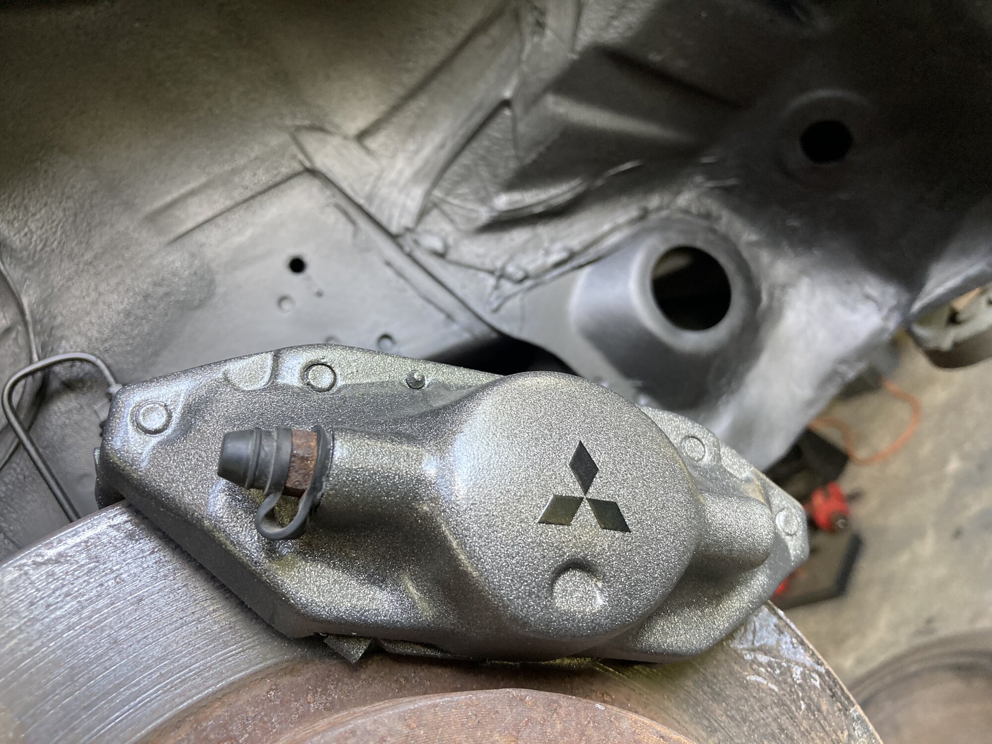

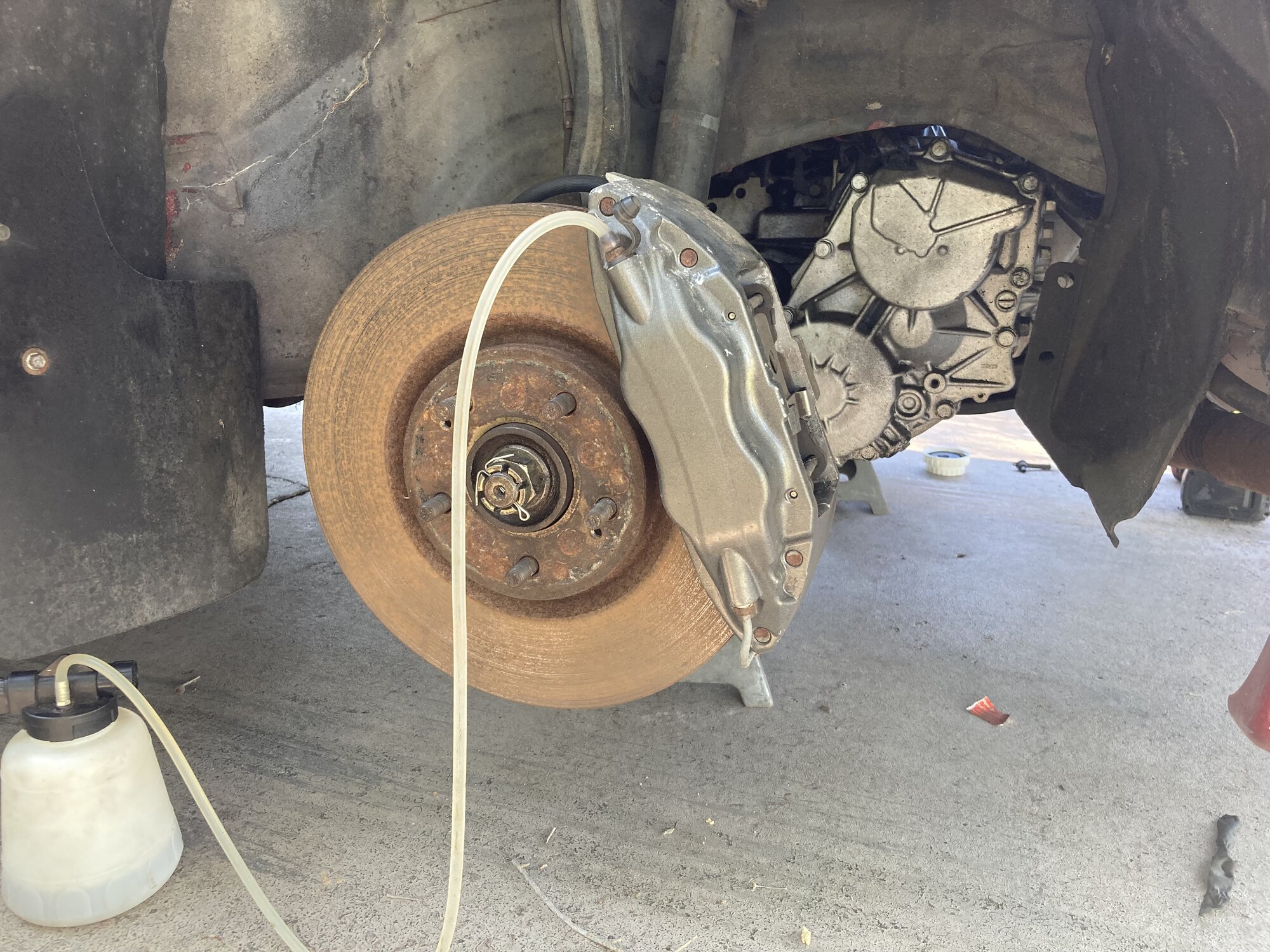

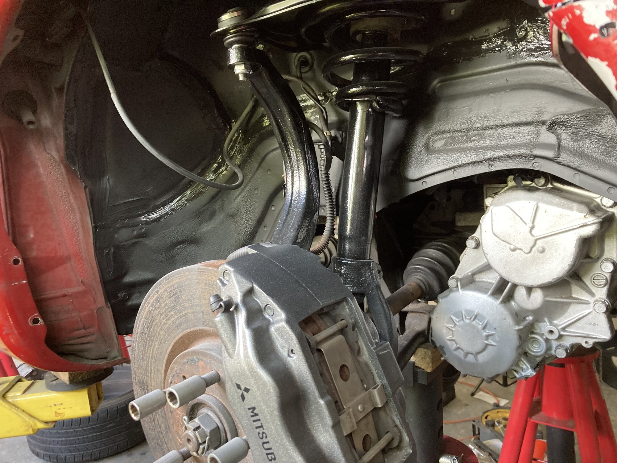

I finished up the wheel wells, painted and resealed . So I thought it might be a good time to freshen up the brakes a lill.
Rather then brembo stickers, I wanted something more unique so I got these.
This is what i thought as soon as I read the lill sticker on the bag full of stickers.
“ Hey guy “
But I really liked the way these look on the listing so I was willing to try
Before and after - went from a gun metal grey to a dark grey metallic.

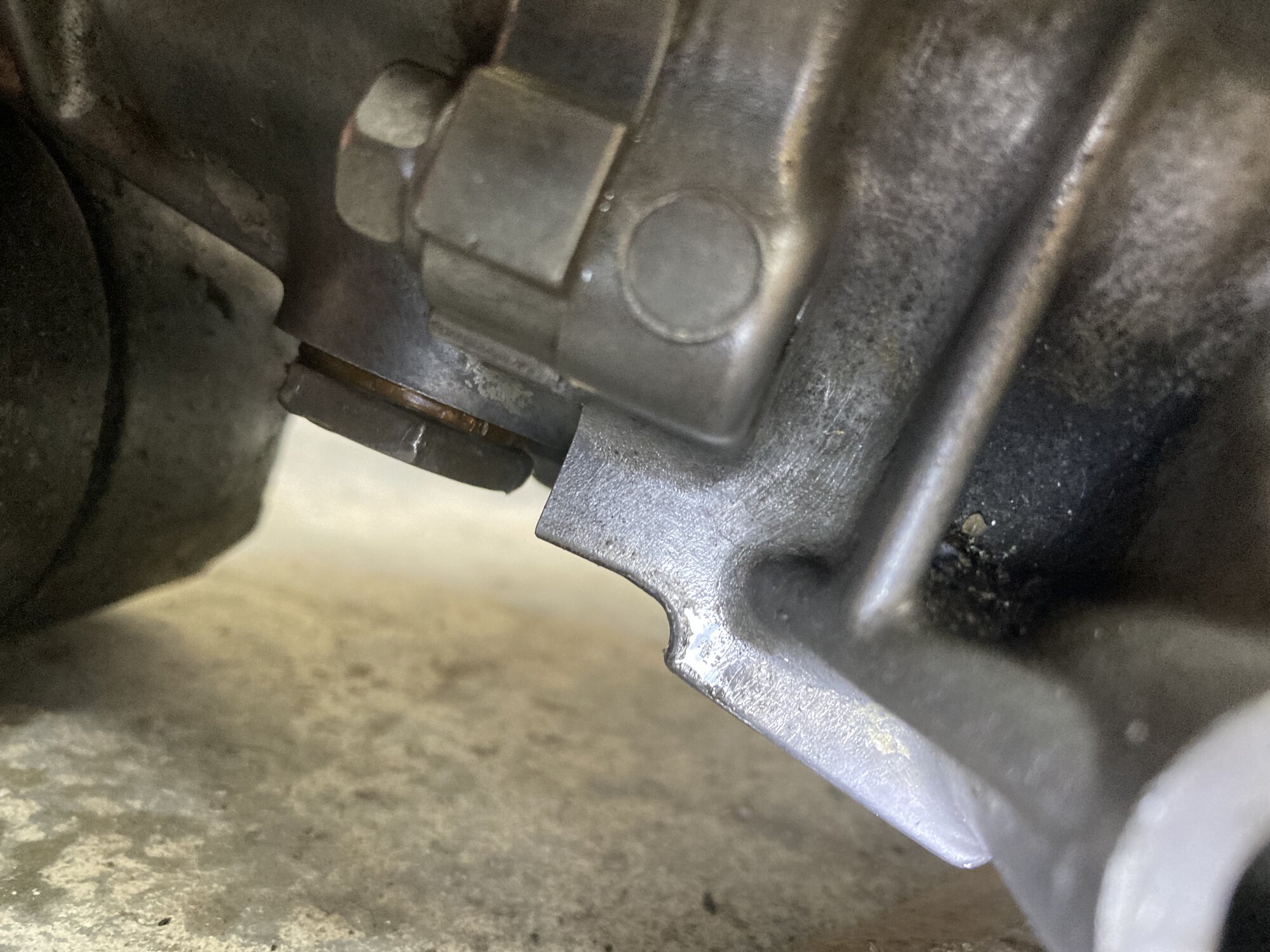

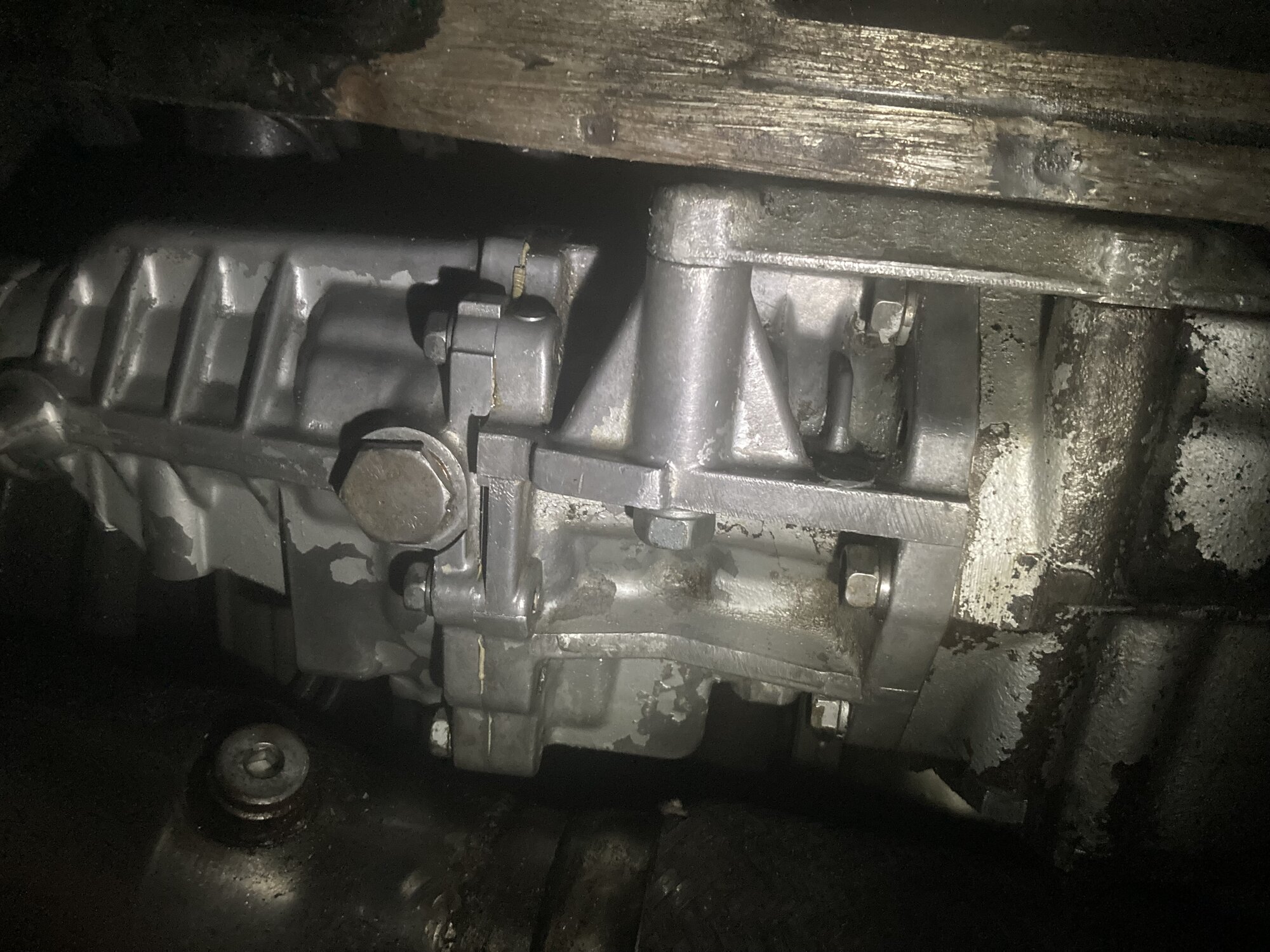

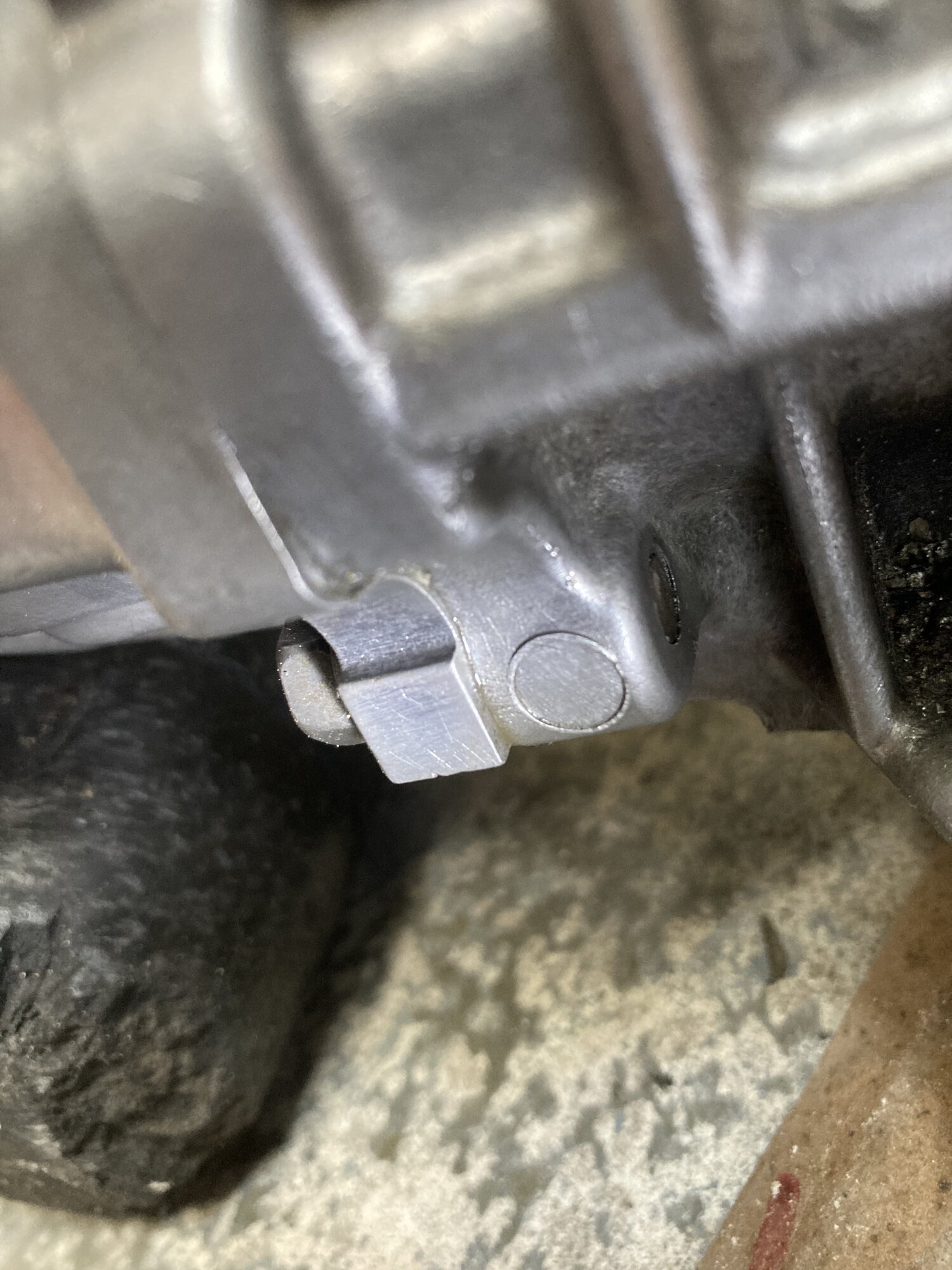

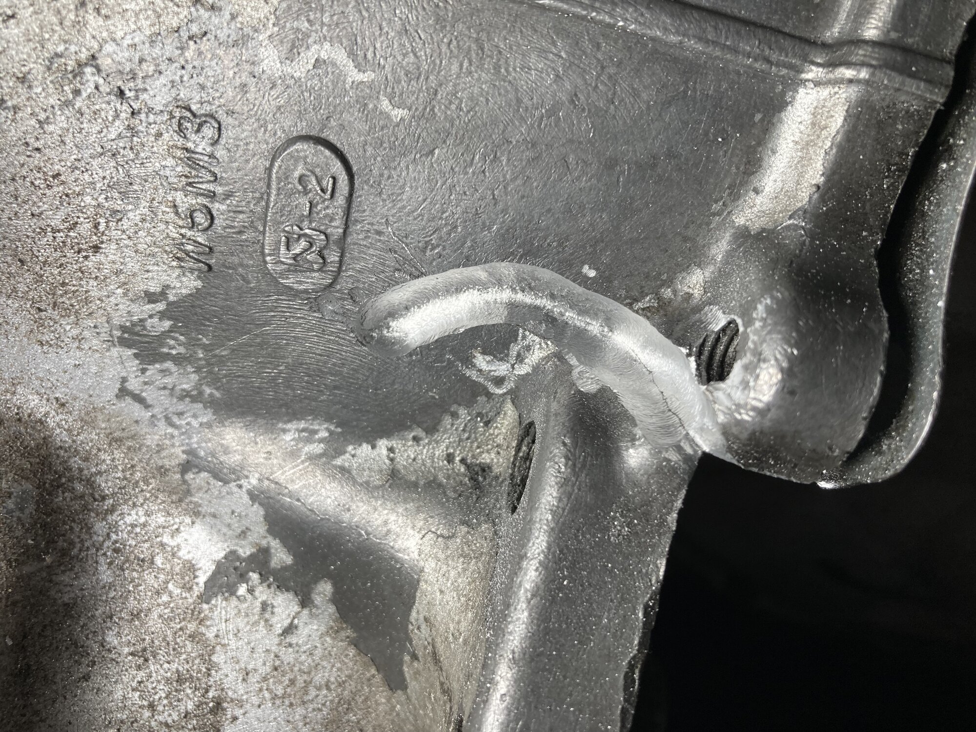

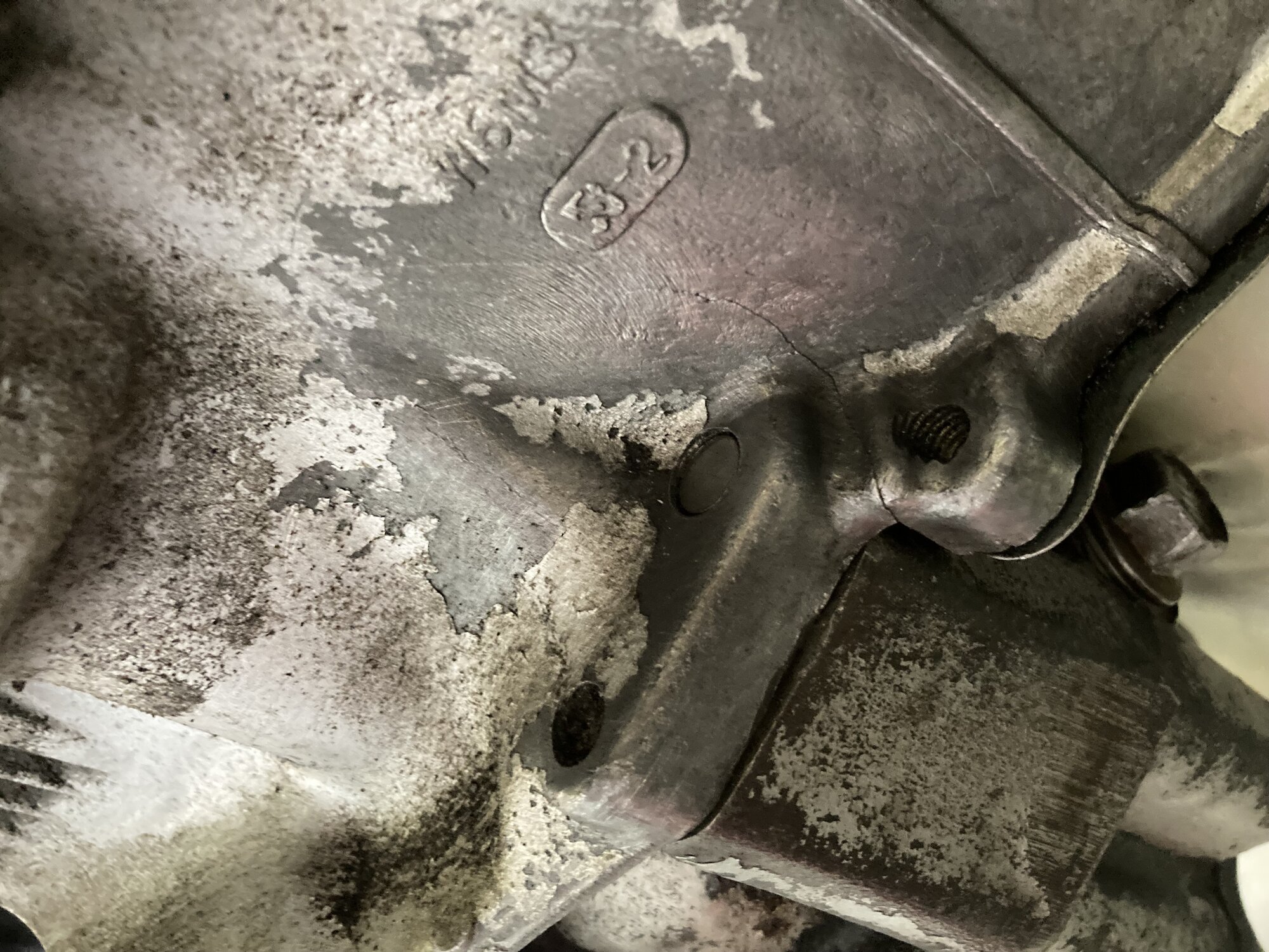

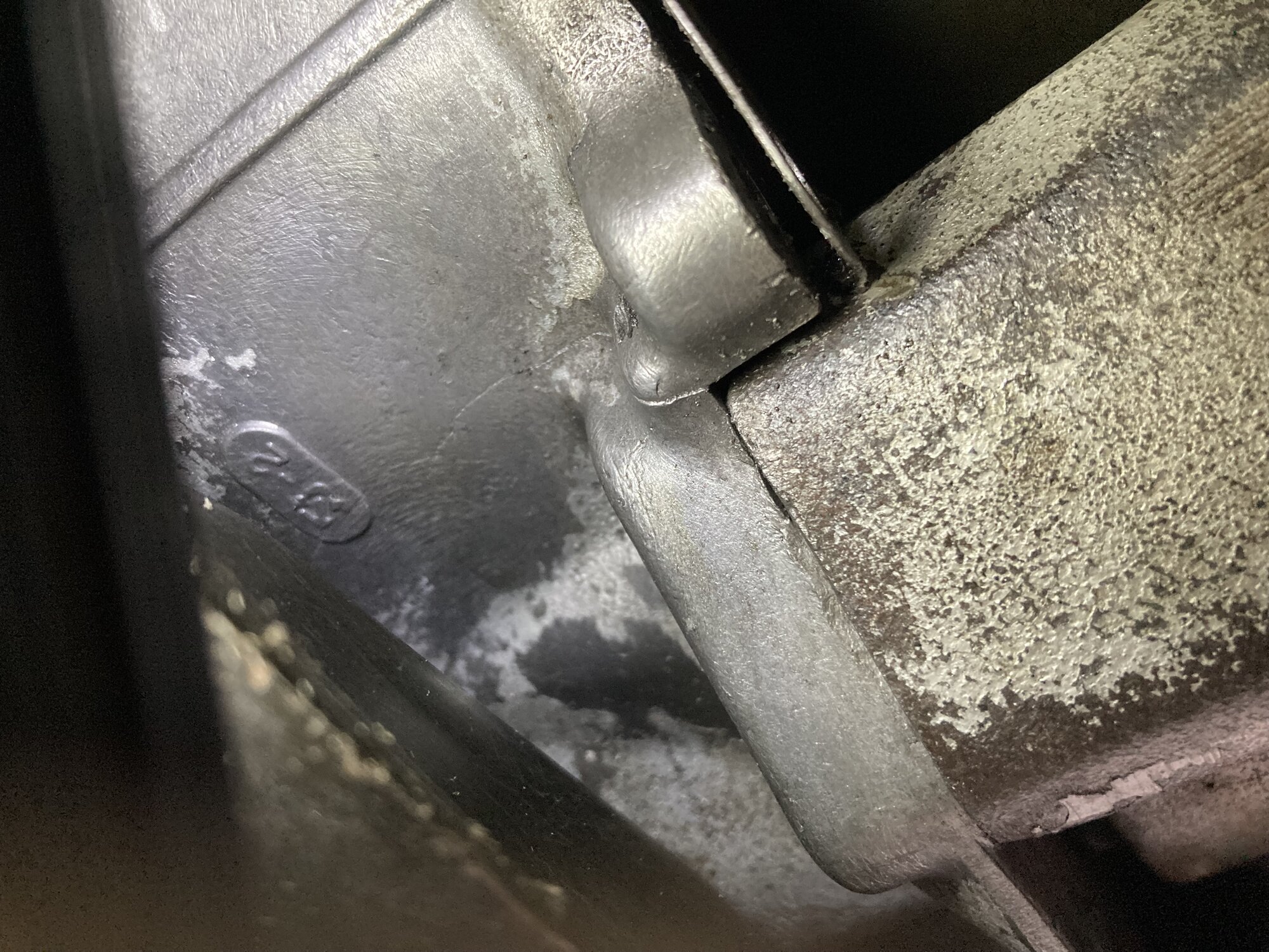

Right at the 90* bend on the bellhousing 🔔
Were cracks love to propagate ⚡️
So much for getting of the jacks……..
I was hoping this could be repaired in the car, seen so many successful videos on YT doing the same. But unfortunately I have to drop the tranny now.
Another thing that happened during the 8 years of sleeping 😴- idk maybe before that , maybe partly due to shot rear diff bushings, aiding in stress, maybe it’s the insane amount of torque. Does look like Tcase was tearing away from tranny.
I looked at images from 2010 the same crack, same length was visible then
