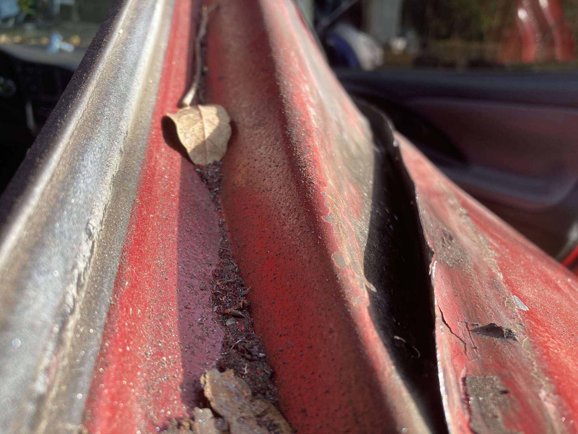

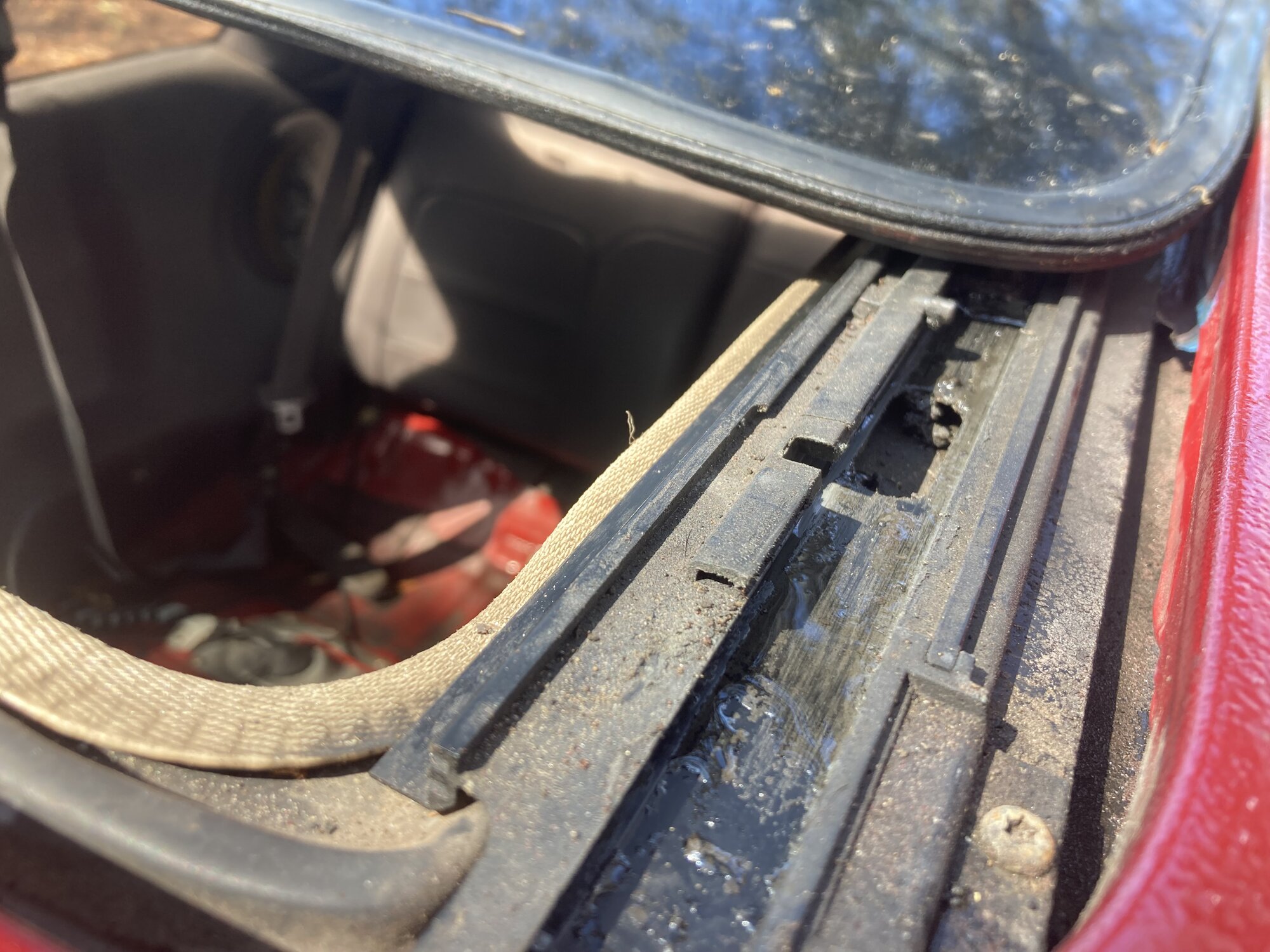

Maybe the drain tubes are clogged? Mine were really bad I had to blow them out with air. I hate messing with the sunroof. I can't even open mine without it giving me fits.
yeah - its a mechanical death trap. x2 on tubes. The seal on the glass to the hole in the roof is supposed to prevent this, and the tubes should drain when the seal fails.

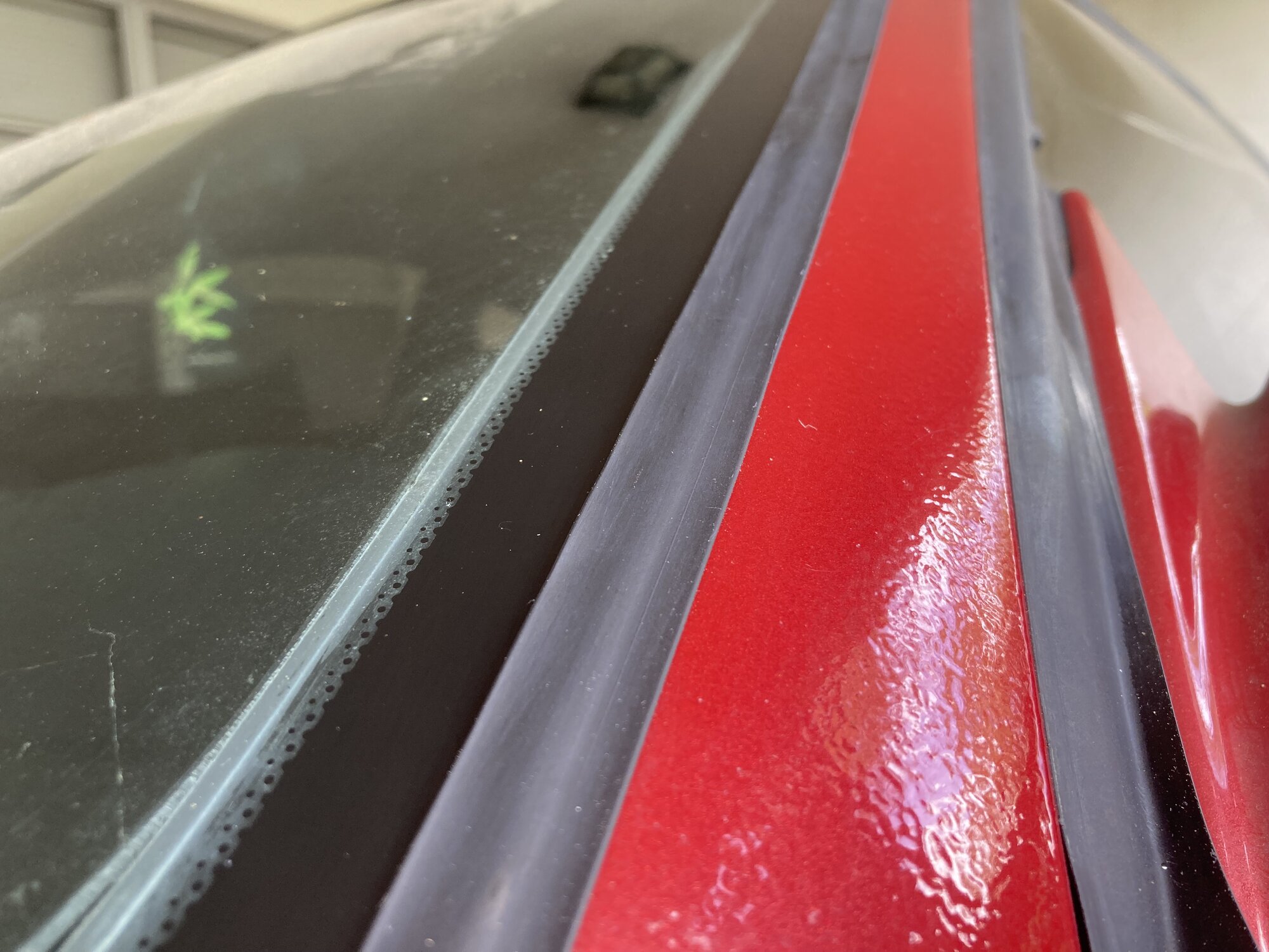

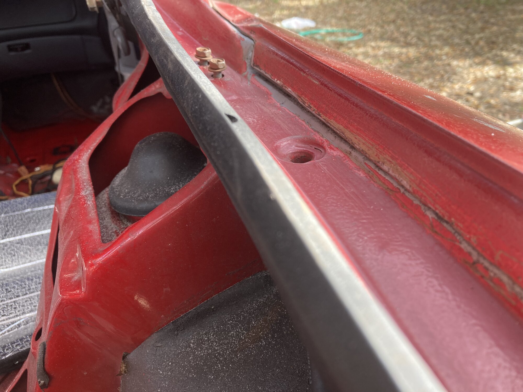

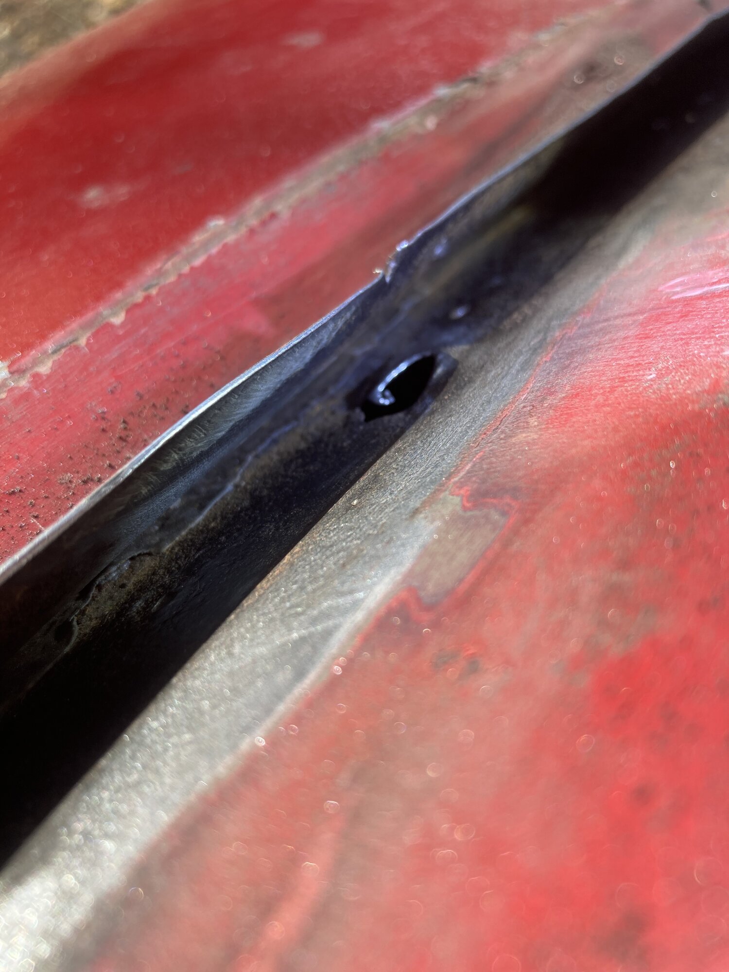

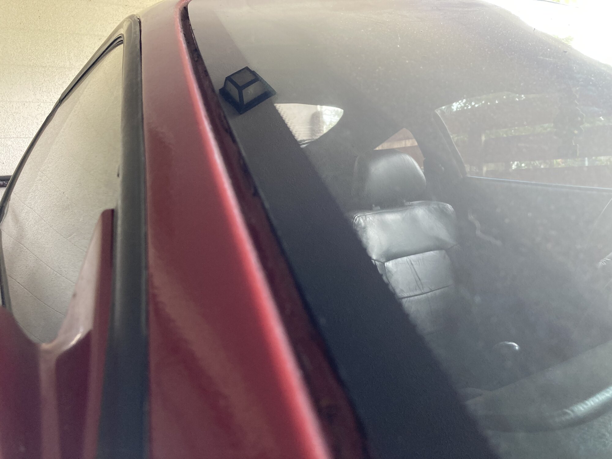

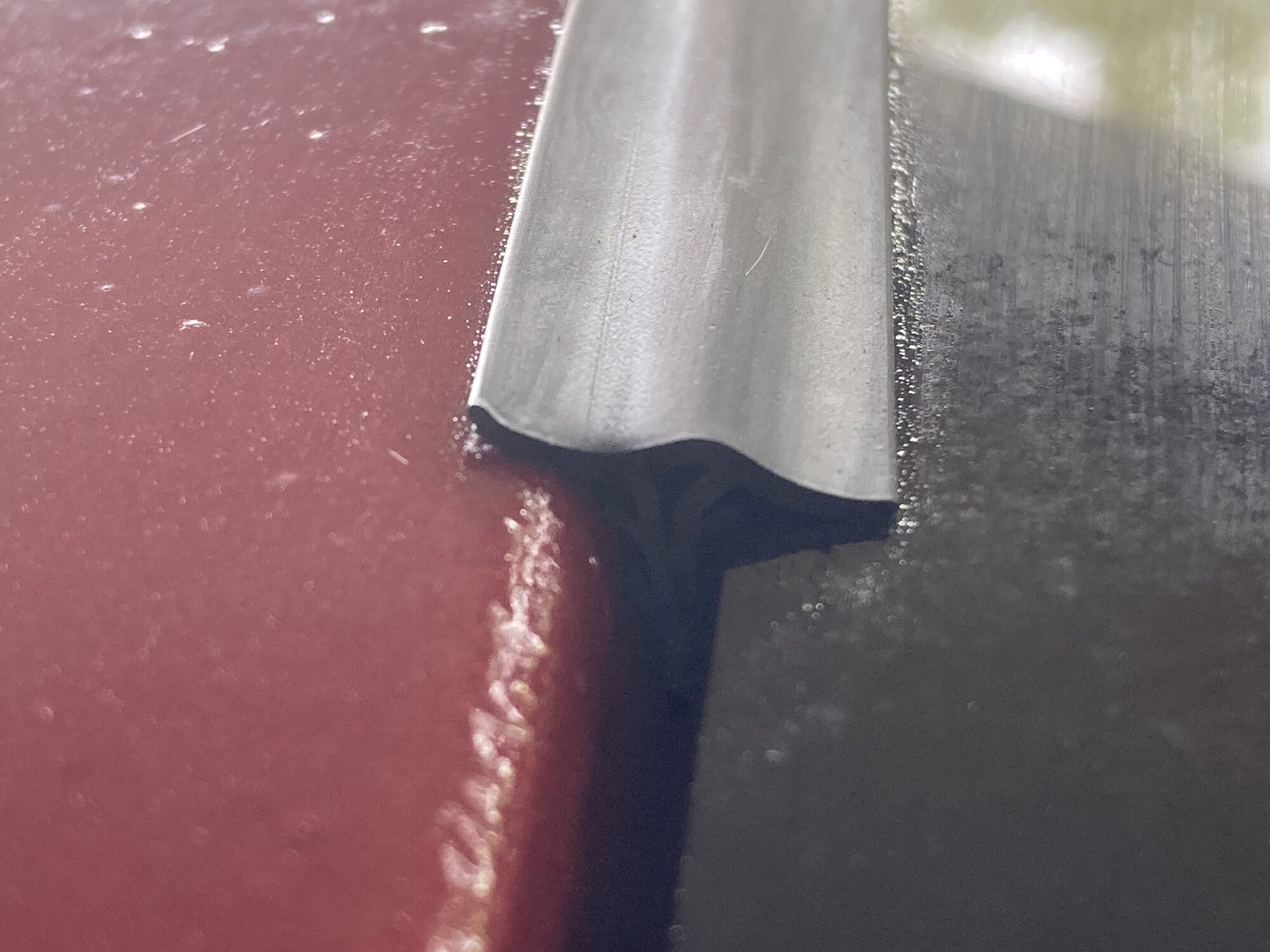

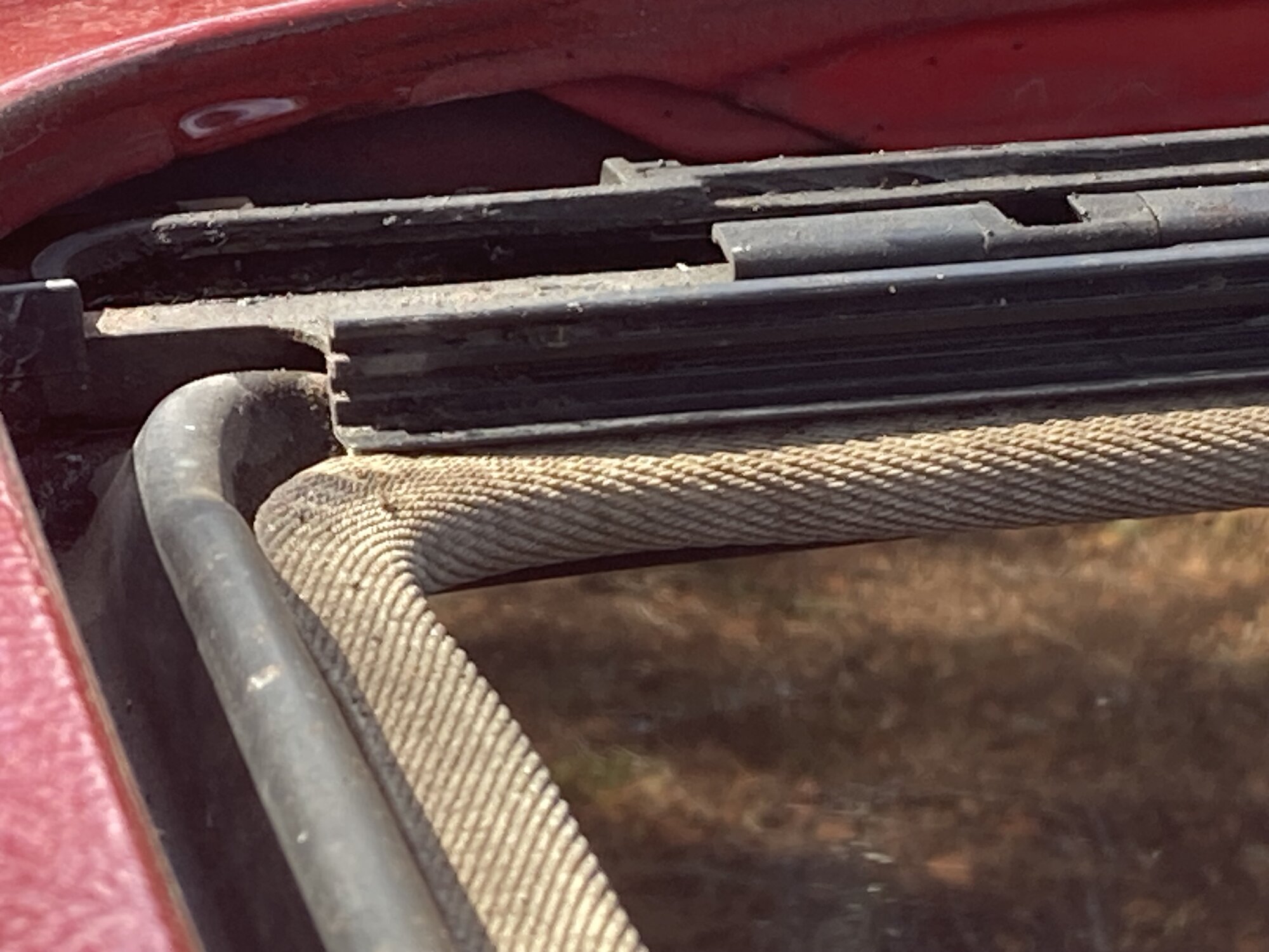

Yeah I can see the seal fails along the front corners…

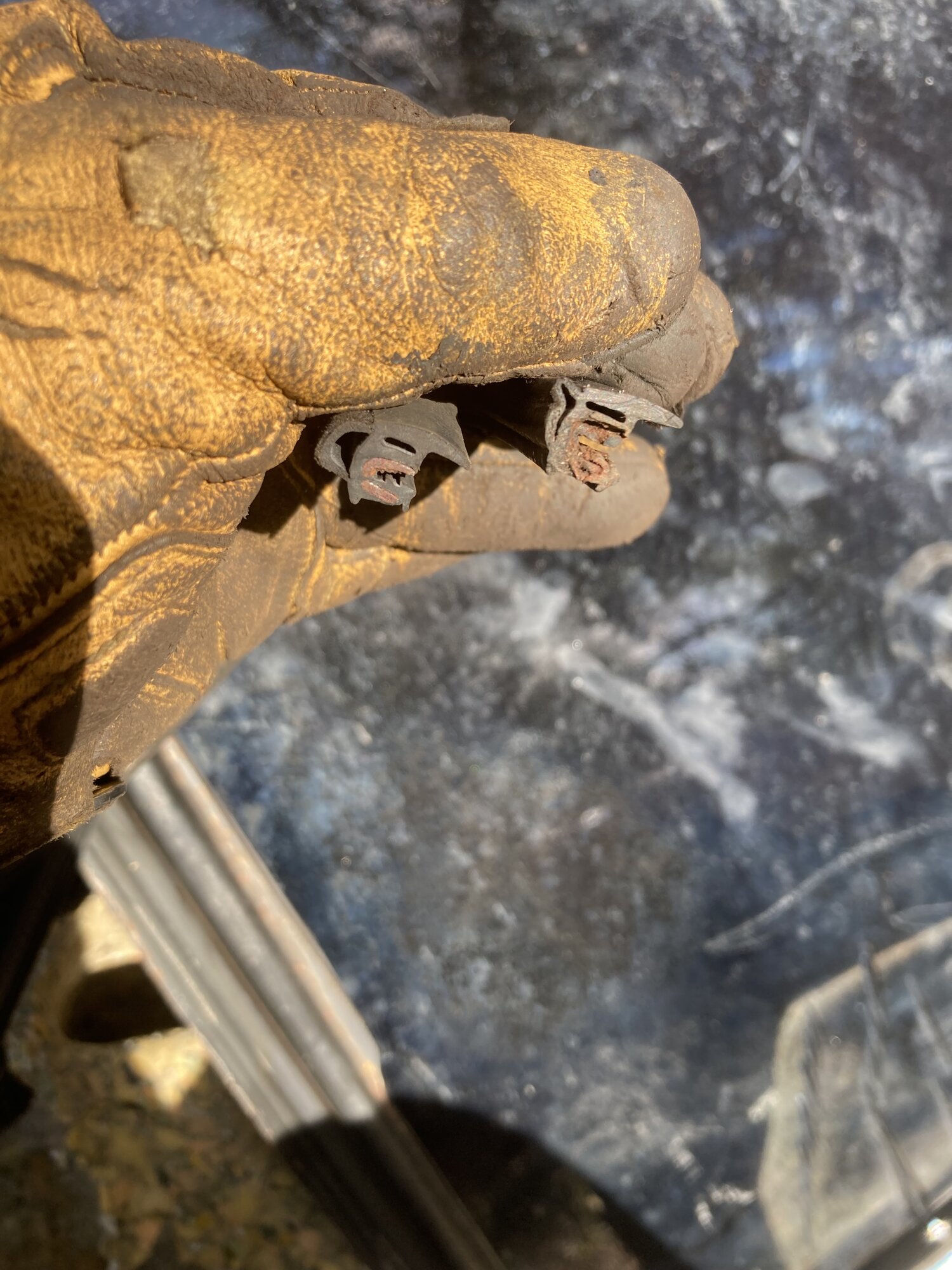

Started to peal it off to inspect and it’s ugly lots of water has made its way in, on the inside of the seal…… making the lip of the glass look 👀 terrible 😣 : In some spots.
215$ dollars with import fees Is what a new OEM seal cost just me, ordered it from Japan 🇯🇵
Glad I caught this when I did, time would have destroyed the car like this…

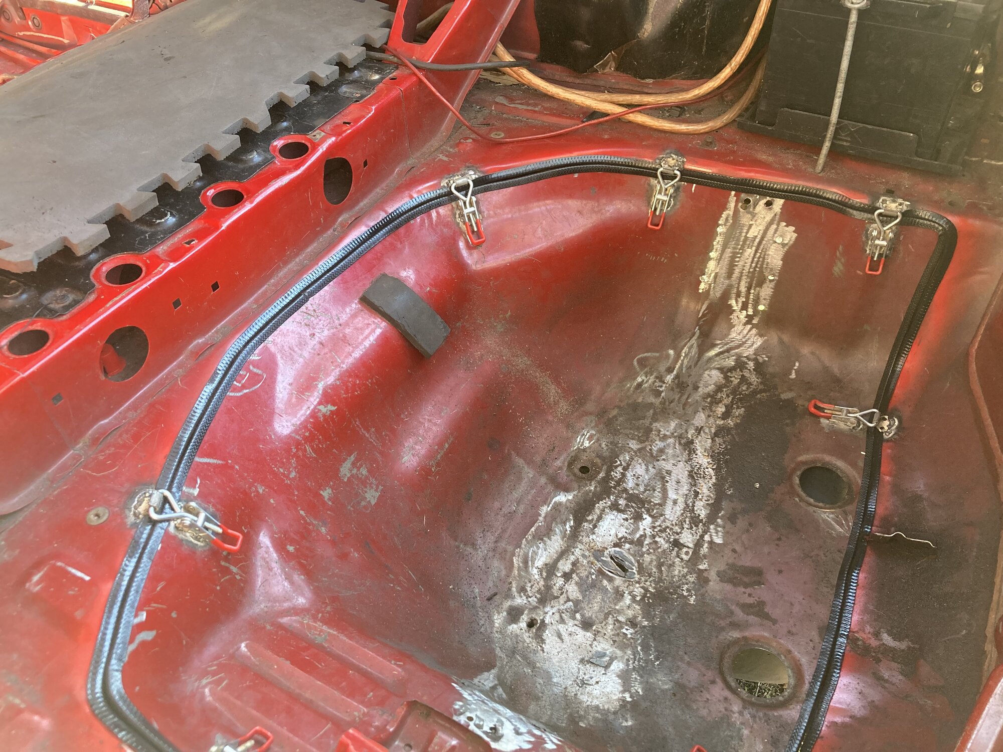

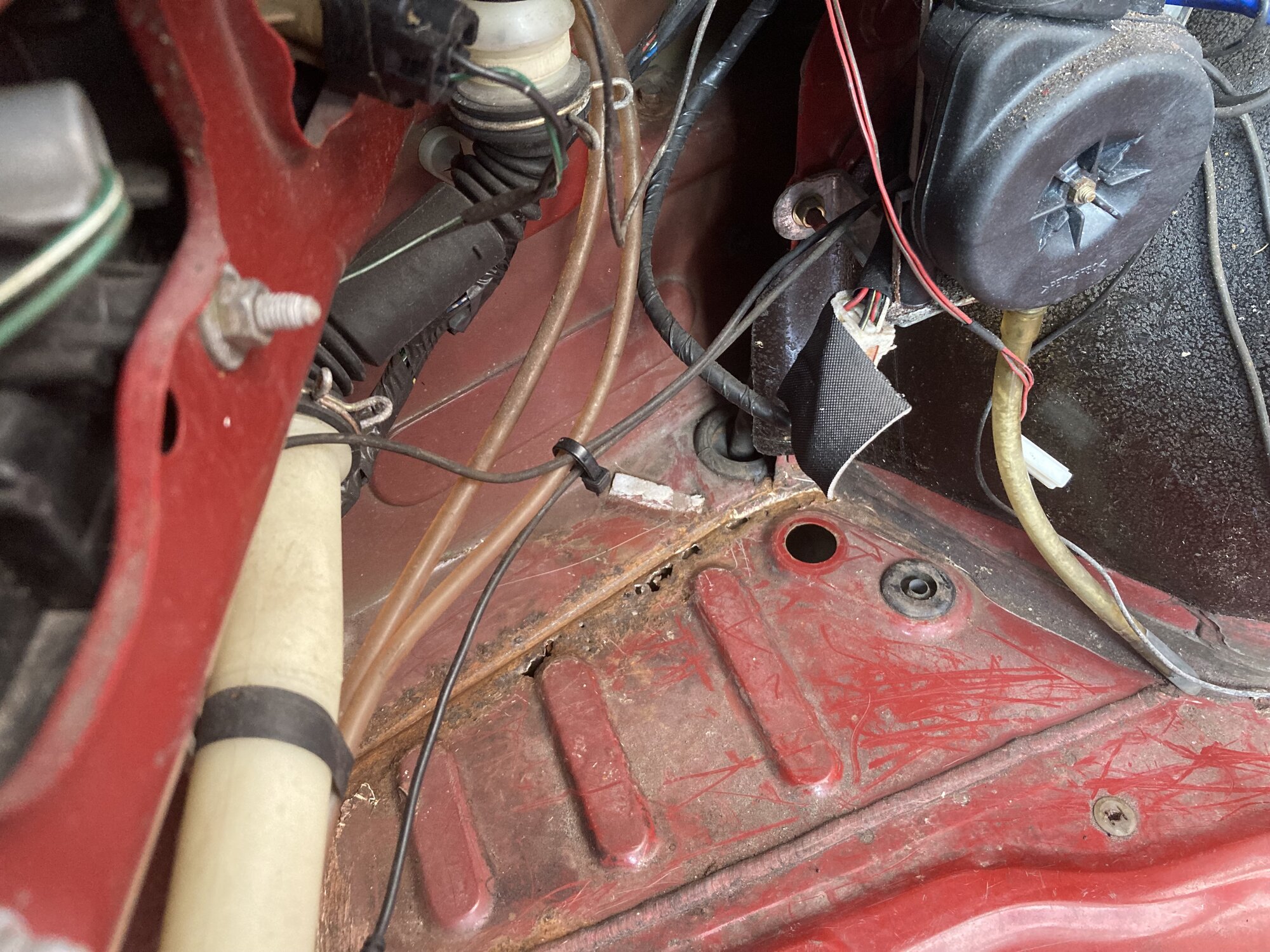

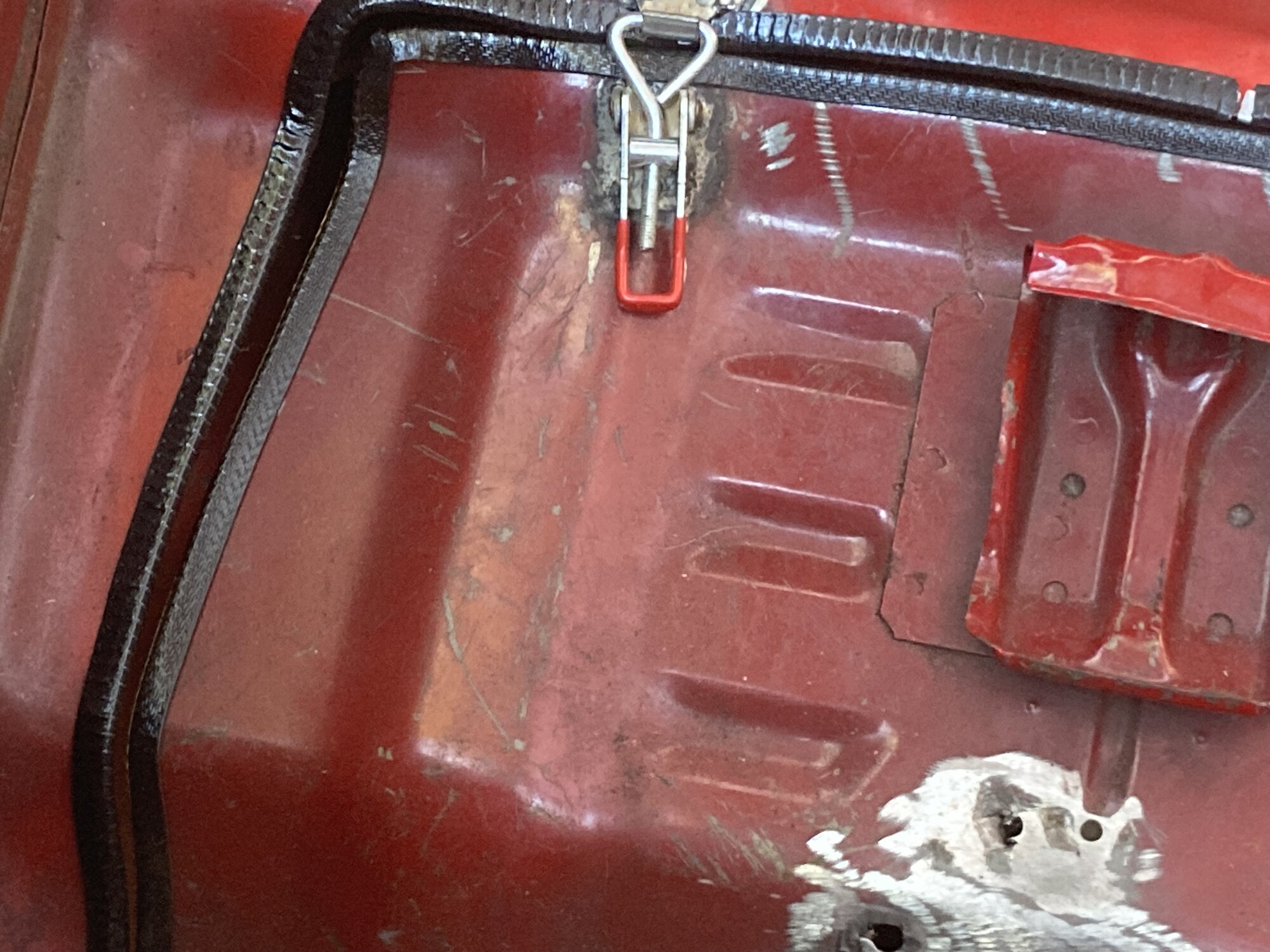

Removed all the rust/ pitting from the floors and tried to match the color some
Still working on the concept of having a removable trunk, need to get more latches and try to close the gap on one corner.
Also cutting up the center brace to remove the rusted metal so I can weld it back.
I don’t plan on putting a spare tire in here, but I would like to put the windshield wiper tank back in its place and also eliminate all the road noise from having an open hole 🕳️.
I also like the idea of using this open space to place a small modest subwoofer 🔊

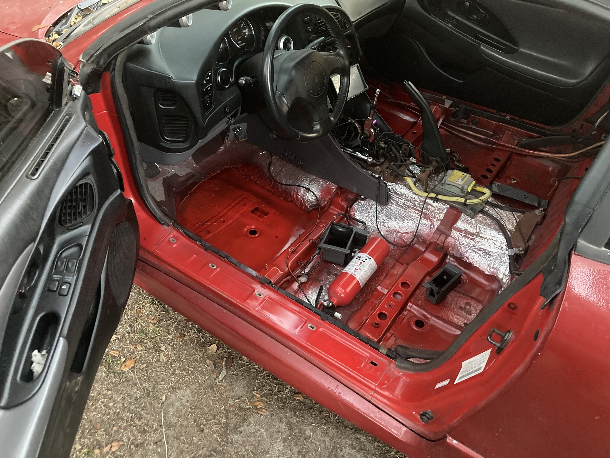

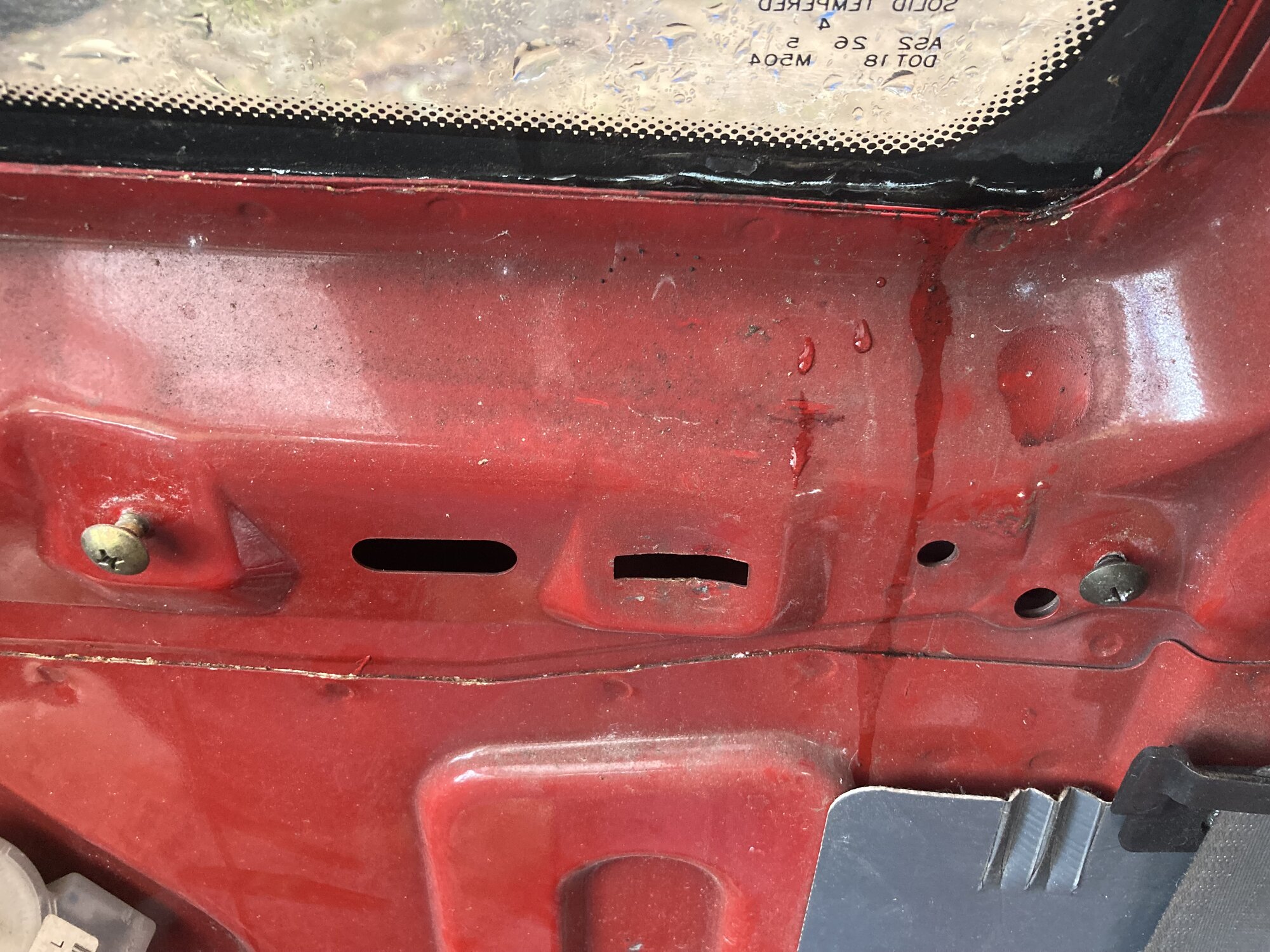

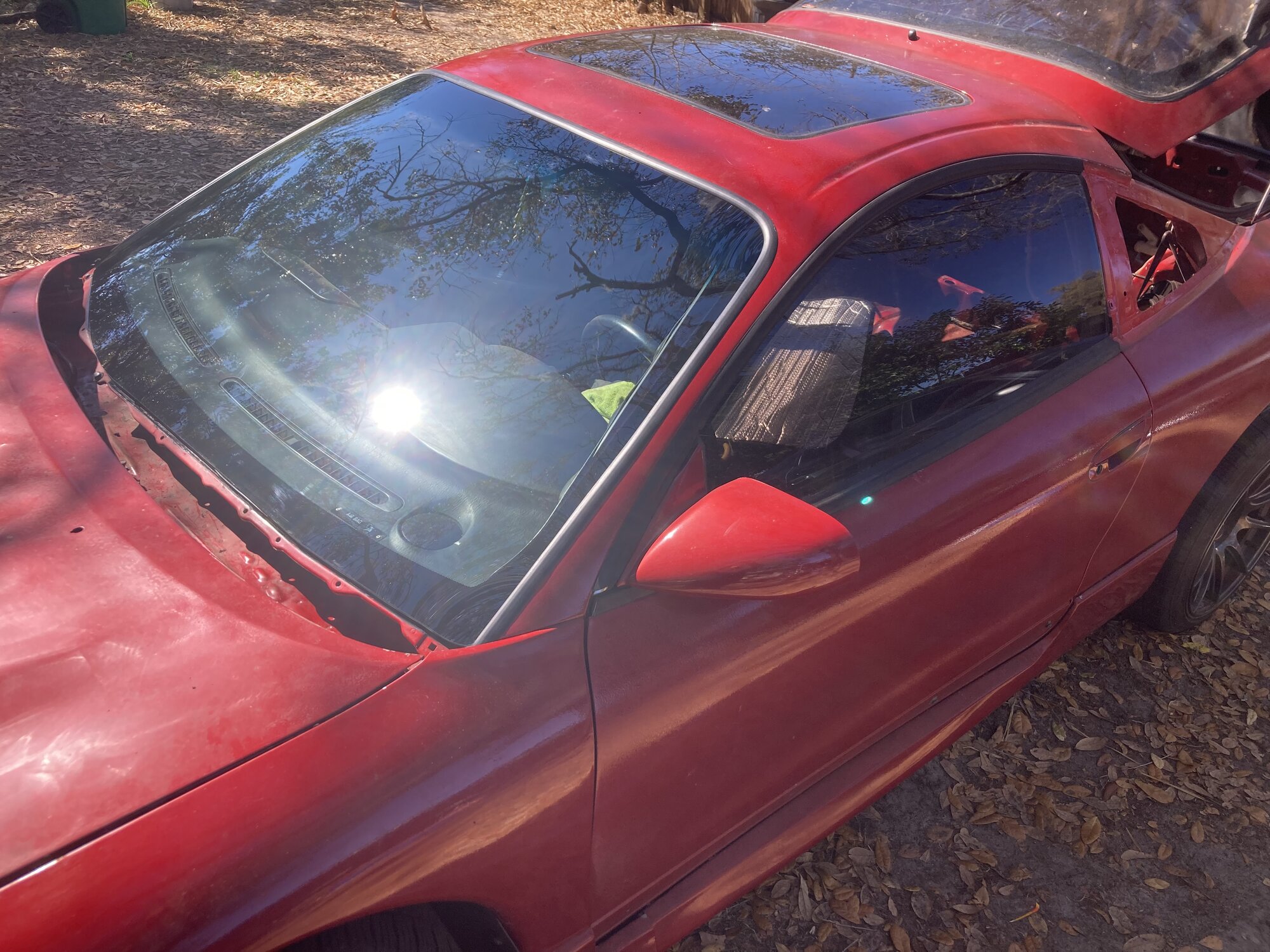

The sunroof seal arrived, but before changing it out I wanted to sit in the car with the bare interior to conduct a rain 🌧️ test, using a garden hose.
The results were not as expected.
I was not able to find any rust or water stains running from the roof, it was not until I was in car and realized the car is leaking from several locations.

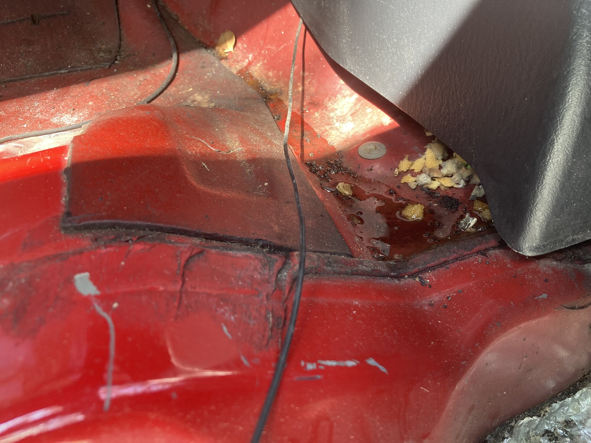

Roof does leak I could feel water and debris running across my fingers when I place then into the pan, and one corner was clogged but just moving my fingers around the drain in the pan unclogged it.

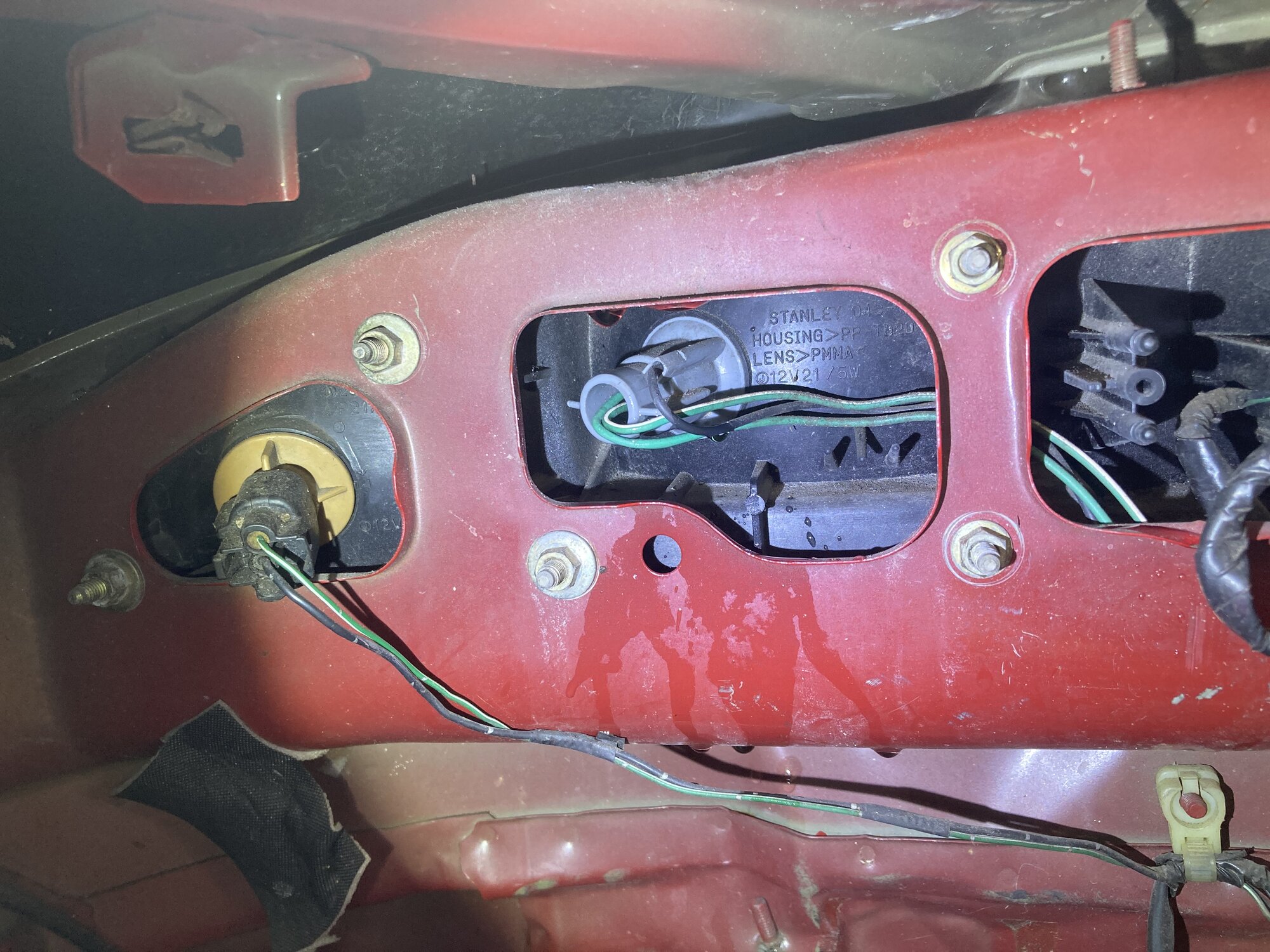

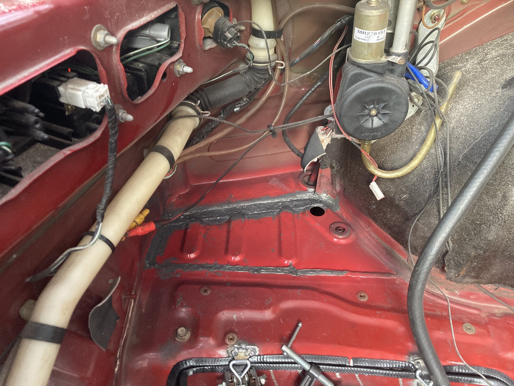

Water is getting into the trunk from the rear taillight assembly, and the body panels directly above that.
Water is getting into both sides by the corner windows 🪟

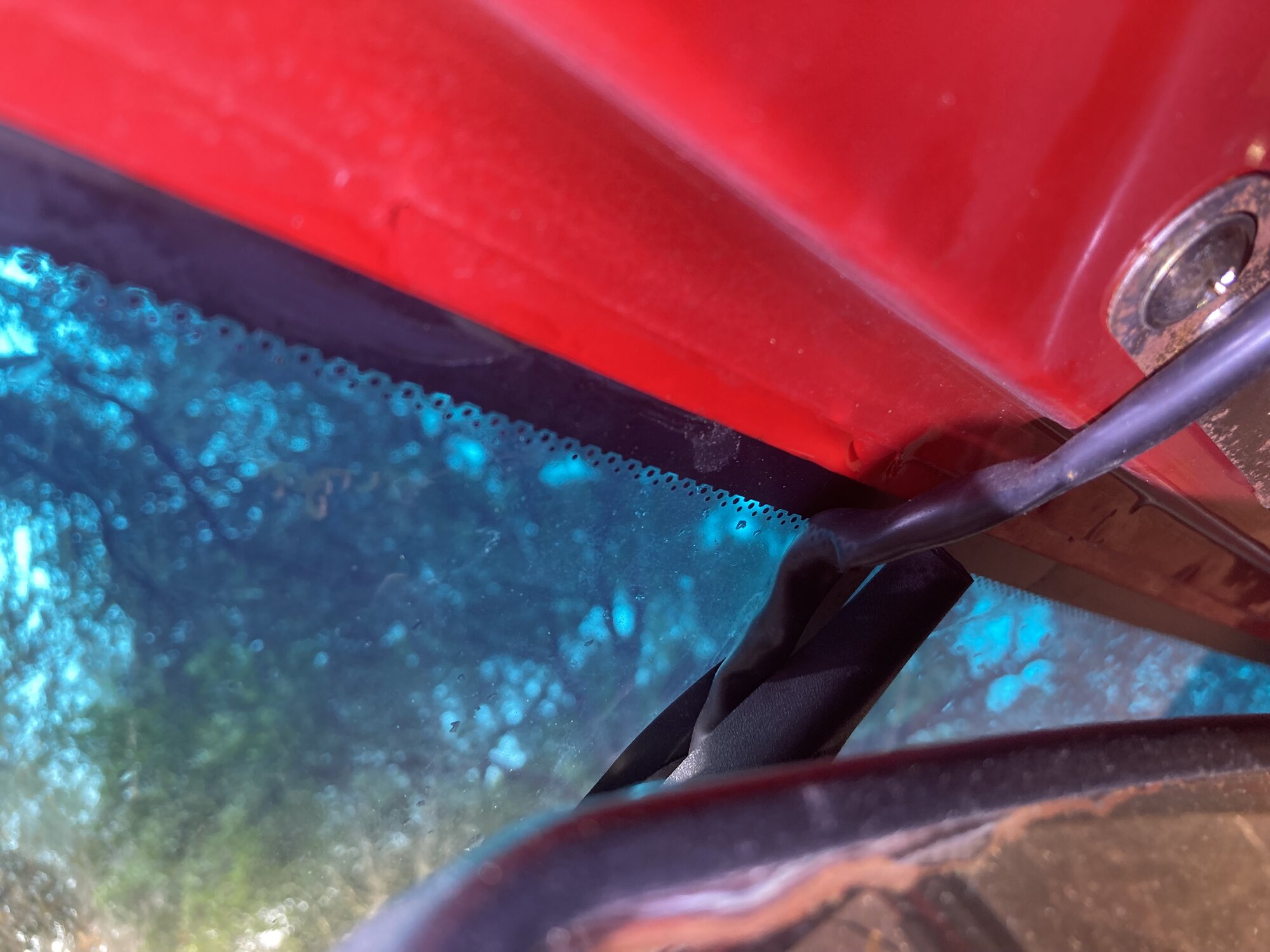

And In thru the windshield
This sucks but I’m glad I was able to identify all the issues, I’ll have to add some black RTV or window weld on the outer top region of windshield and the in/out of the corners, maybe the rear assembly too.
A long time ago when painting car I ripped the outer edge of the glass trim, I currently have this in its place, so it will be easy to address the windshield.

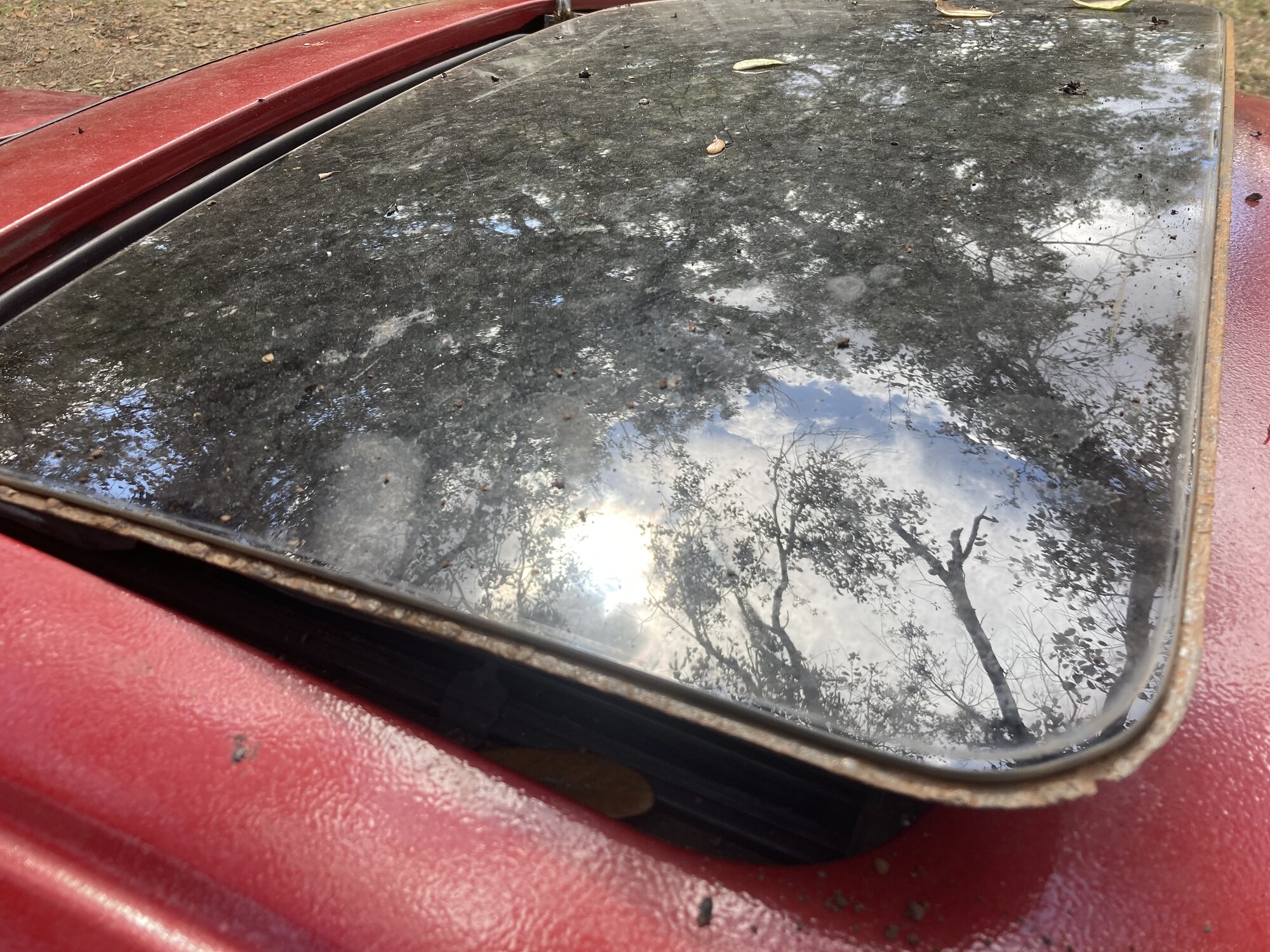

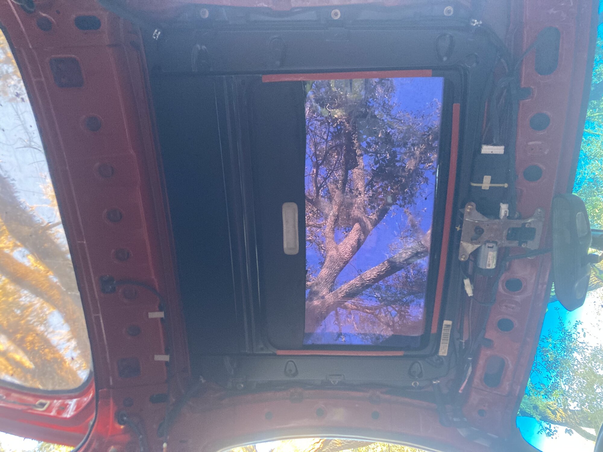

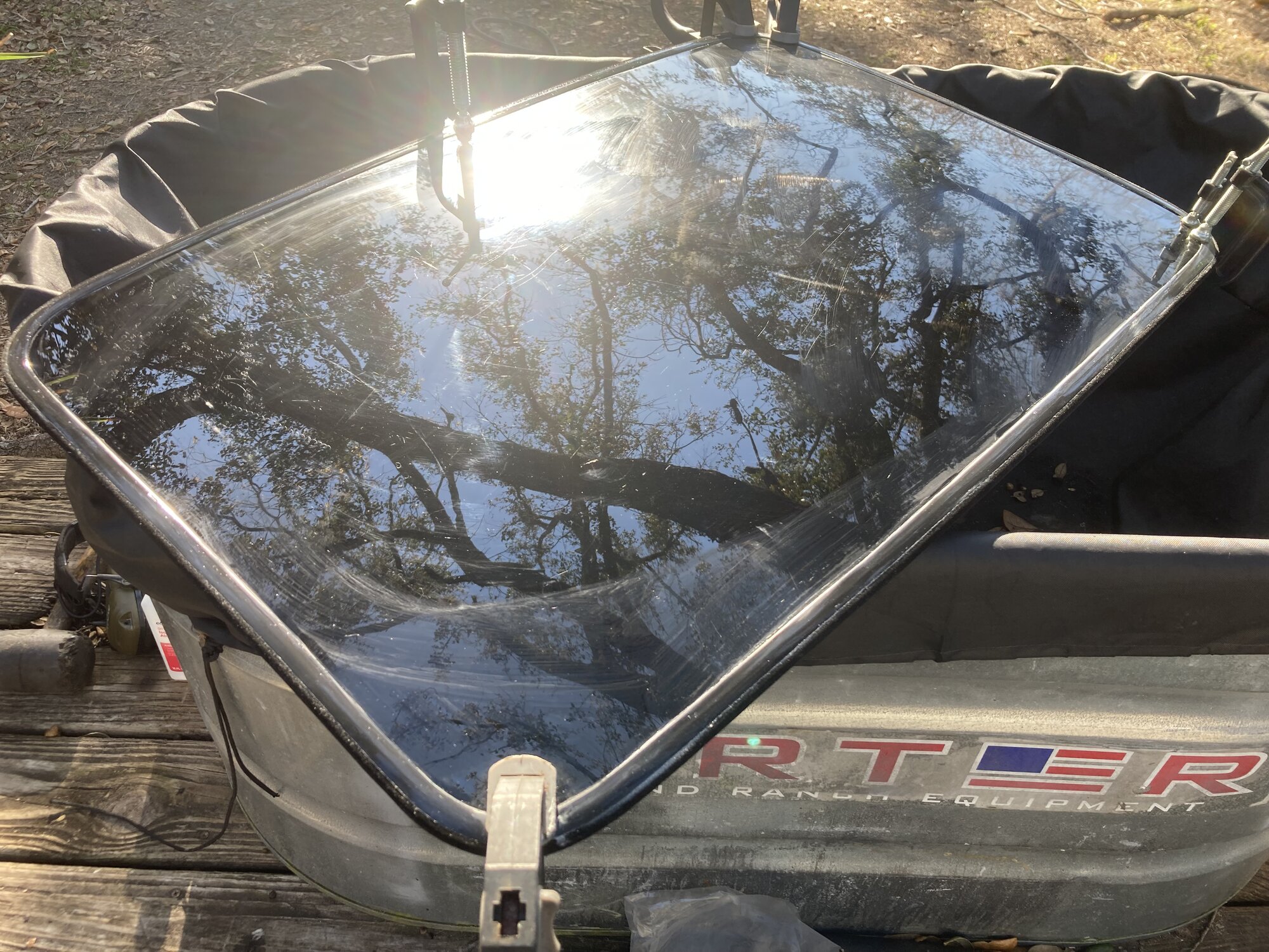

So I replaced the sun roof seal
Haven’t tested it against water yet.
I used RTV along the perimeter of the glass to fill in the air gap in the seal and to prevent water from leaking past again.
I have also been grinding/ sand blasting and repairing the rust on the corner of the trunk due to bad tail light seals.

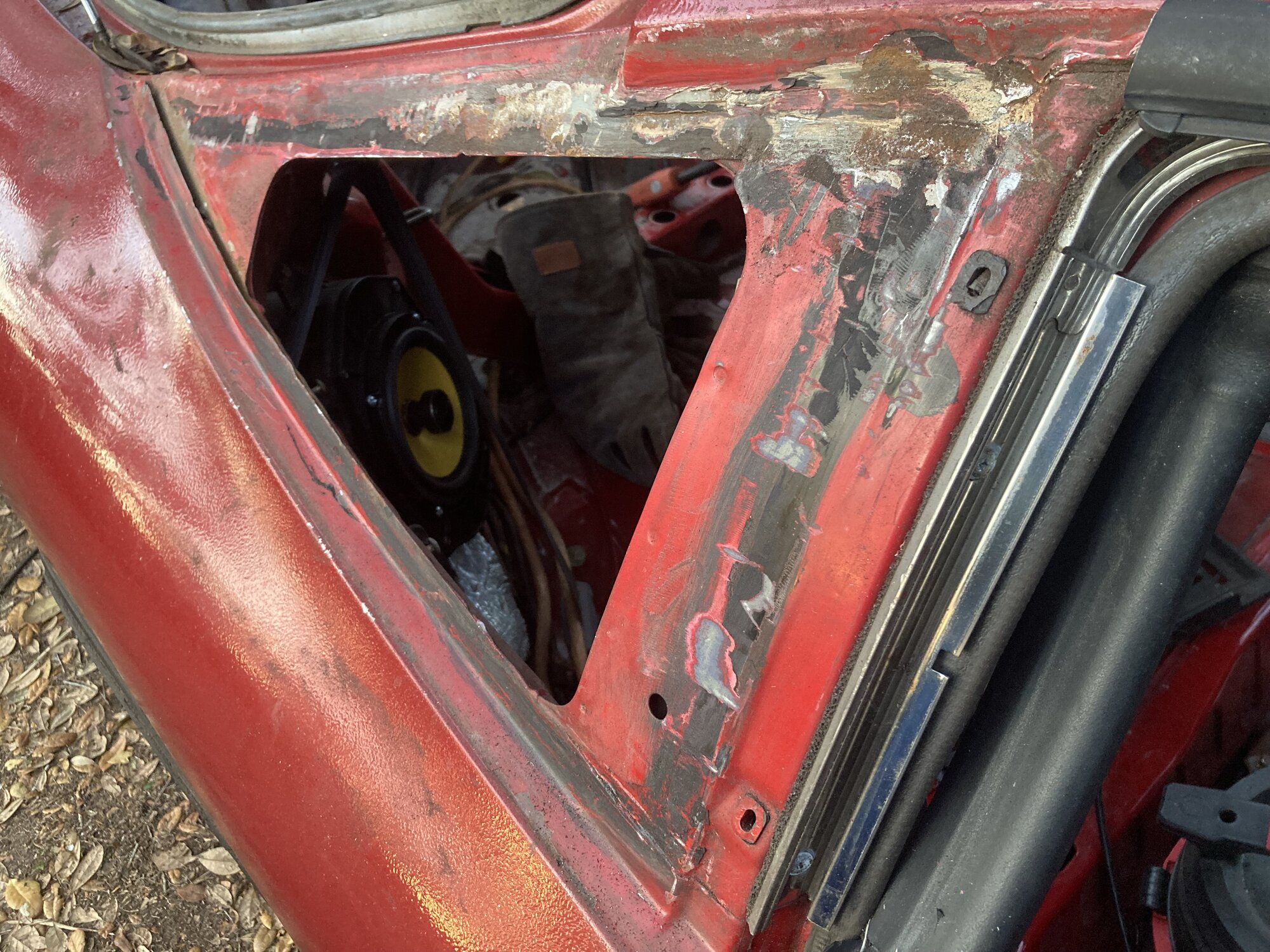

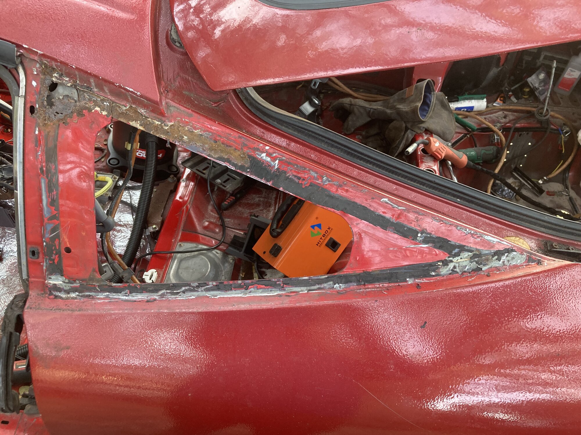

I also went bought some supplies to remove the two quarter glass

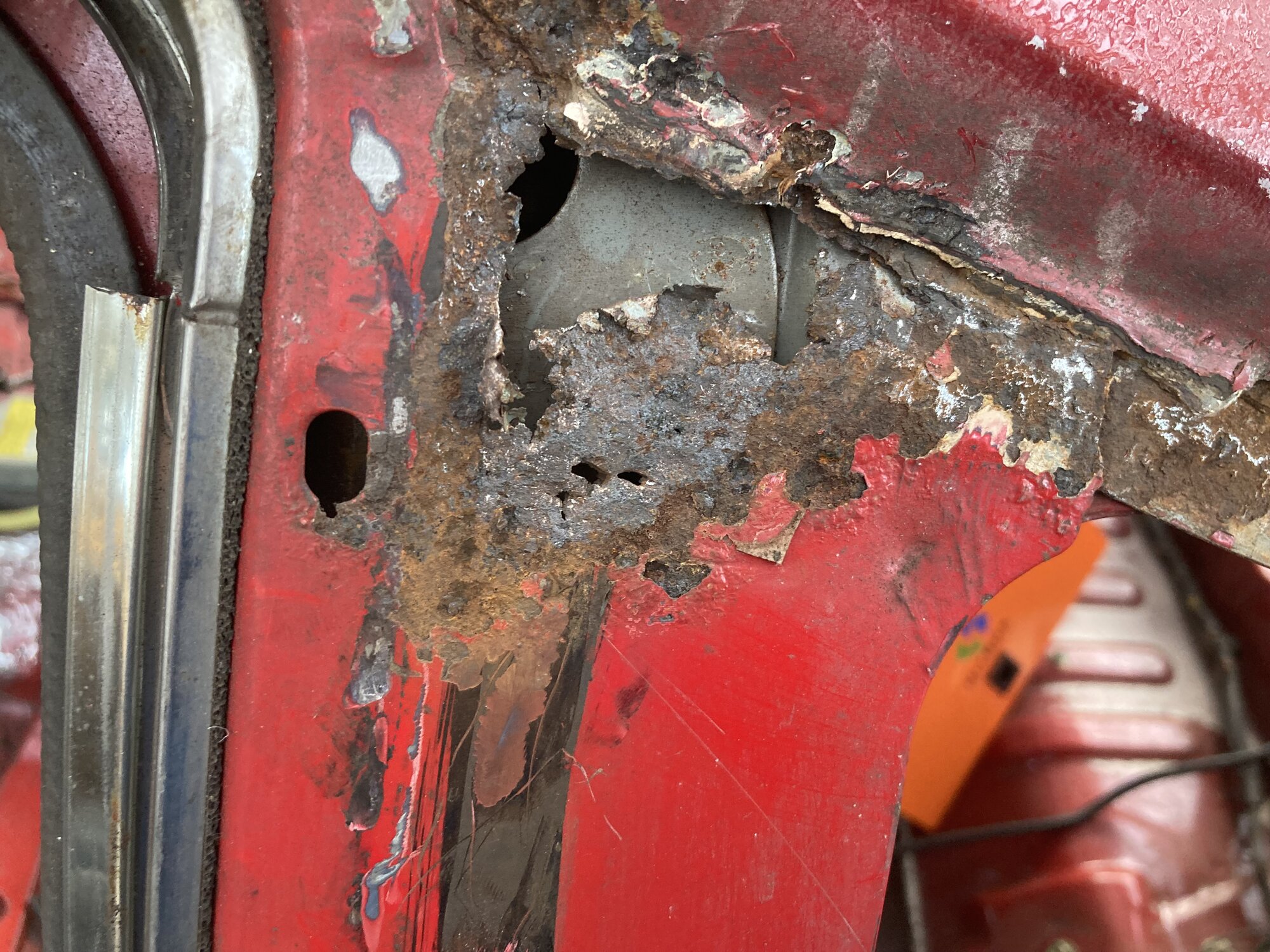

Got it off, only to find the surprise 😦
Yaiiiiiiiiiiiiiiiiiiiiiiiiiiiiiiiiiiiiiiiiiiiiiiiiiiiiiiiiiiii
Bro tell me how you got those rear quarters out?!? Mines half way out but I can't seem to get the back side out. I have everything to get them out. Its been fighting me so i gave up for awhile. I'm sorry to see all that rust, I never thought I'd see that on a Florida car. That will definitely leave water in the car.

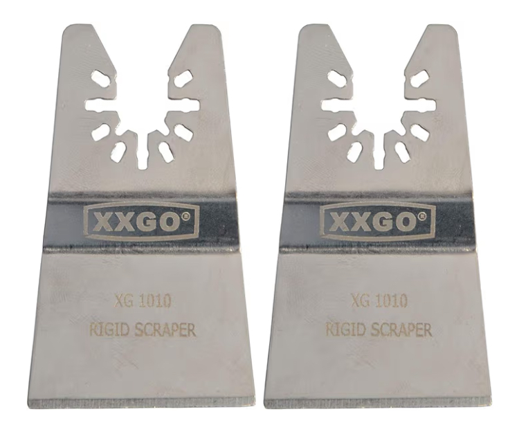

So I used an oscillating tool, with windshield removal blades and scrapers
Don’t use them from the inside of car, this will damage the seal. I caught this before I could do more damage.
And the real tool is a paint opener or metal scraper/ spatula along with a rubber mallet to force it between the body and glass, this is what seperates it.
I was able to remove the glass without any real damage to it or the seal.

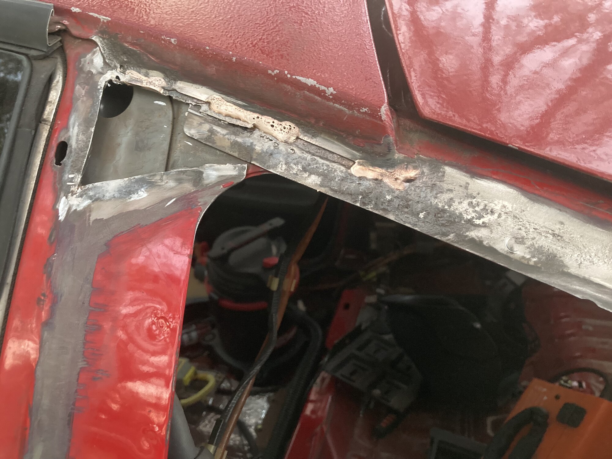

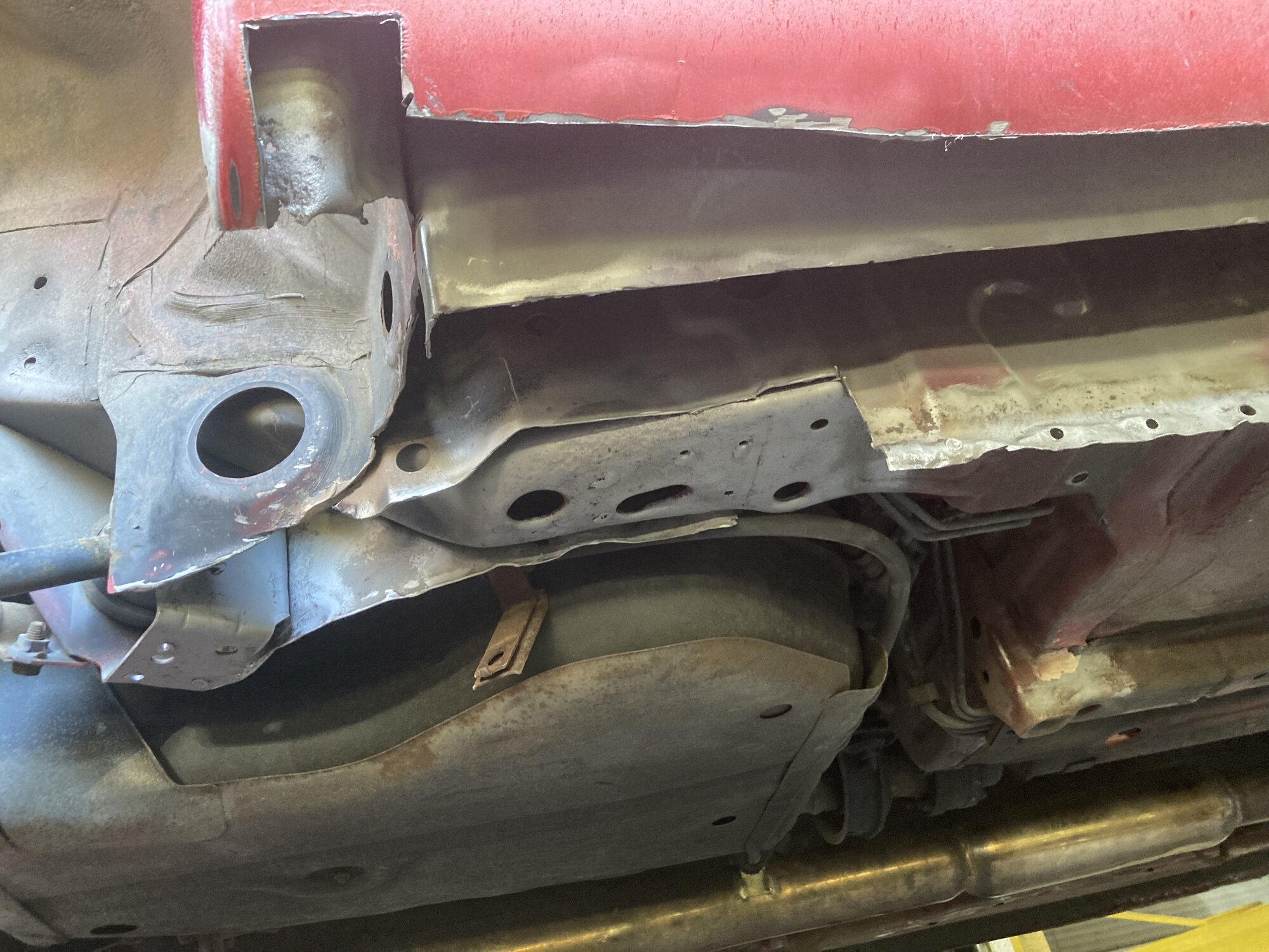

Cut/welded/grinded 22 gauge patch to match existing metal.
I keep finding small isolated spots were rust/ pitting occurs, obviously 🙄 from the leaks.

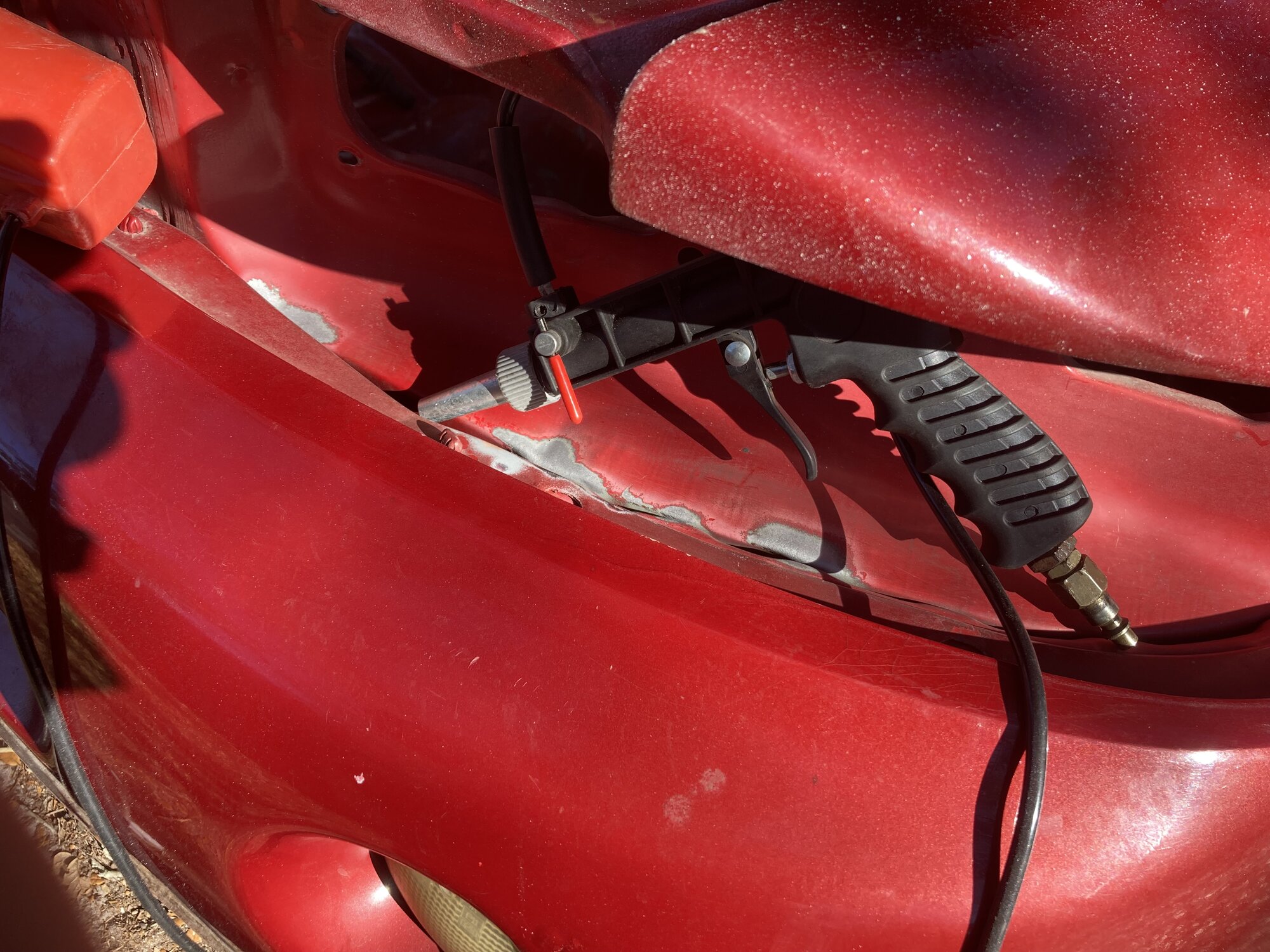

Under hatch had to peel metal back to get to all the rust. Sand blaster is a life safer for those hard to reach spots

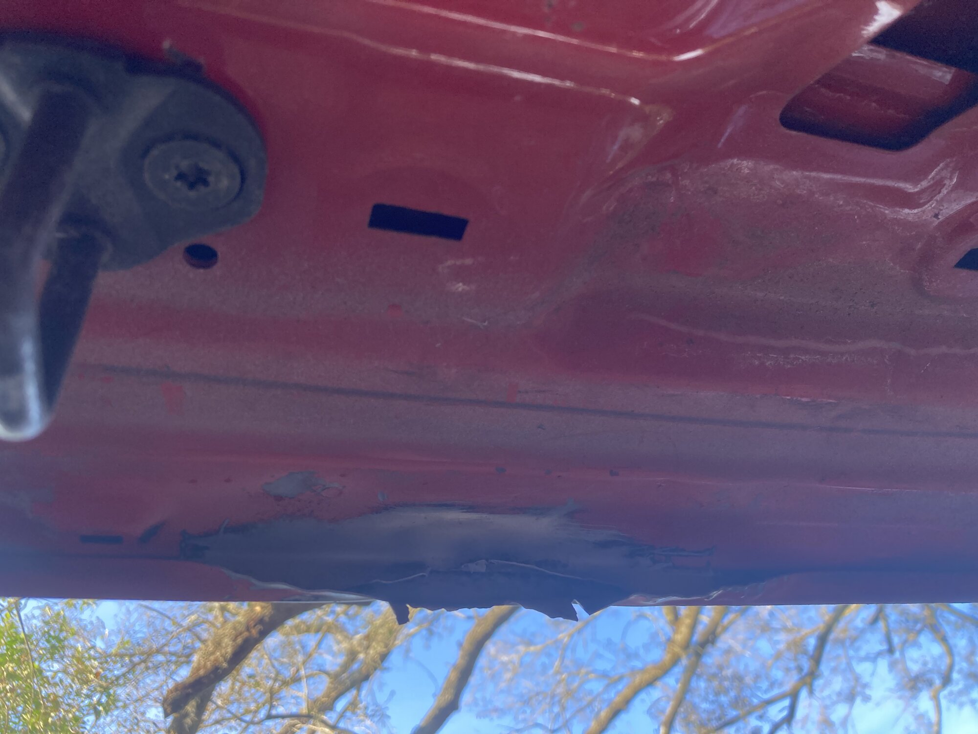

Also I noticed the right quarter panel looks slightly separated from the body so I pulled back the edges to clear out any rust and re- seal.
I suspect a previous accident, one side seems to have aftermarket seam sealer too. All fixed

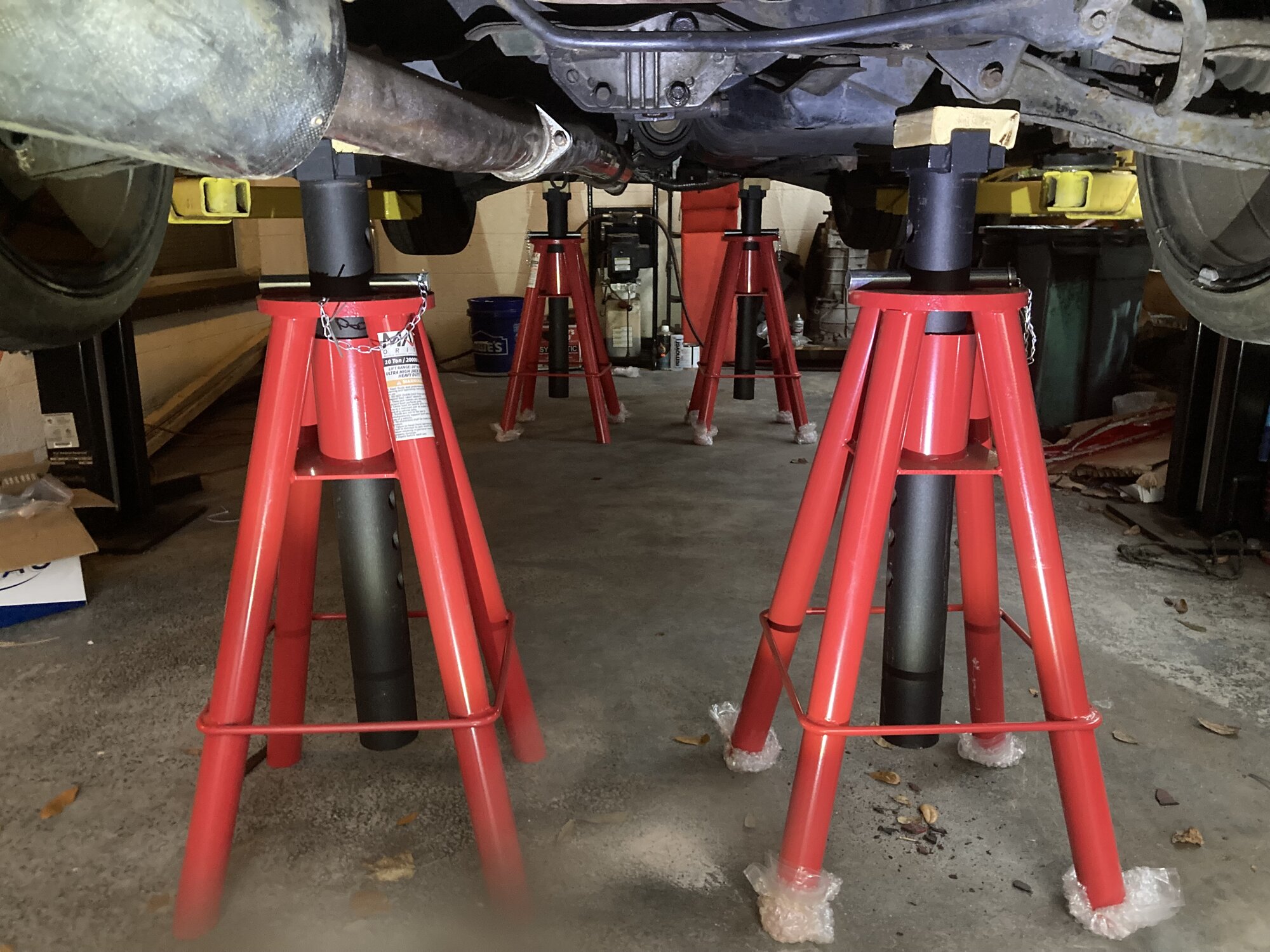

So I invested in 4x large heavy duty jack stands, these were the only way to use jack stands at this min height and still maintain good stability.
I bought these for 2 reasons:
1) I need this to lower lift so I can move the arms out of the way since I need to access the rust under the side skirts.
2) Even tho the lift is supposed to be enough to hold car up, I have trust issues.
And I’m not willing to take the risk. In fact all these years I’ve had the lift I refuse to really get under neath comfortably because I have internet access and I’ve seen the videos !!!

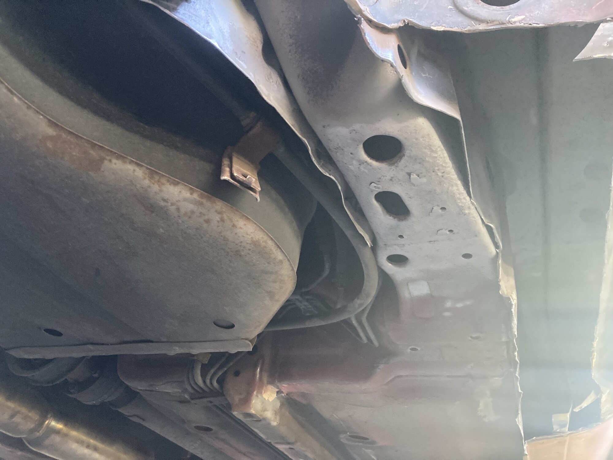

I can see the small surface rust clearly Now.
I really don’t want to do any of this at all, but here we are.

The blaster is a cheap one with the lill tank on top I use a hose to feed the top which I bored to allow more sand in

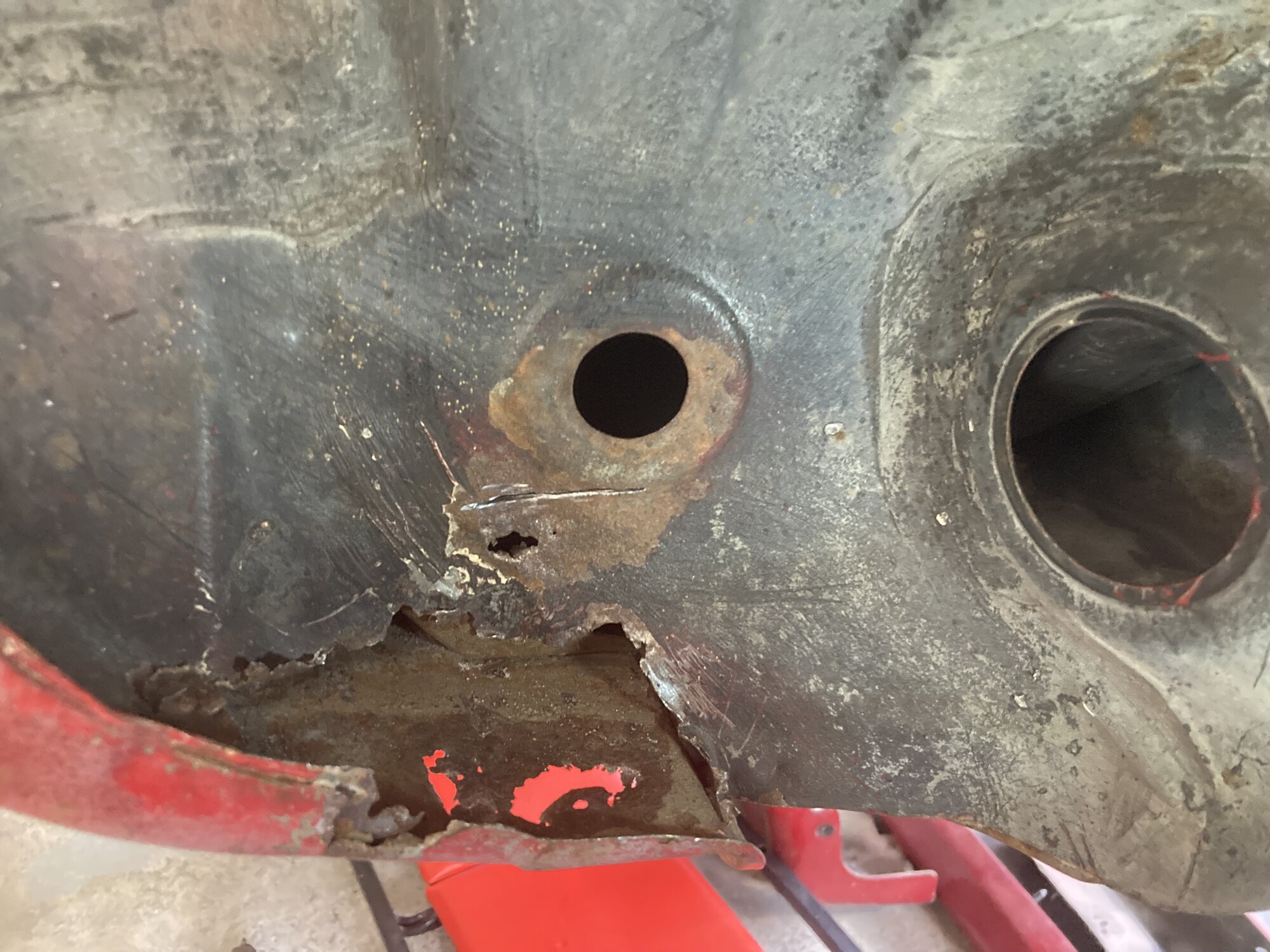

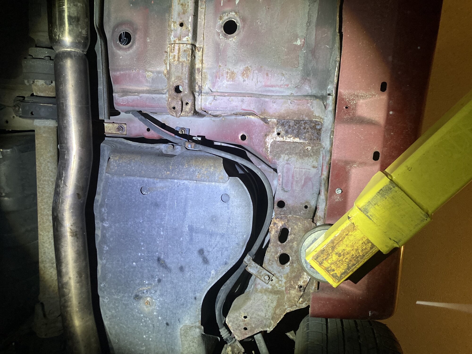

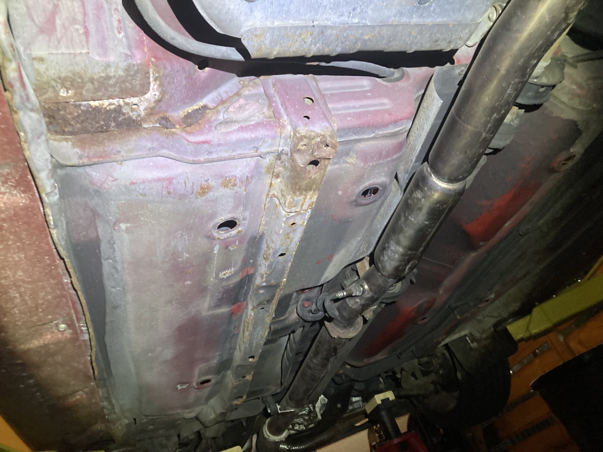

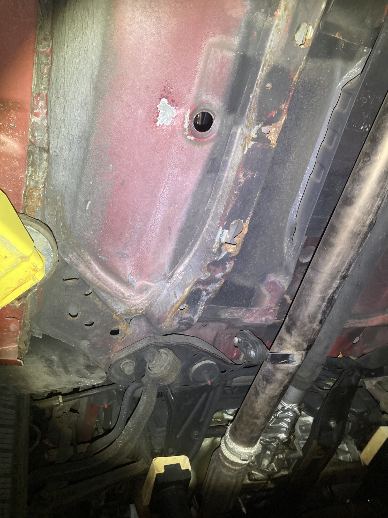

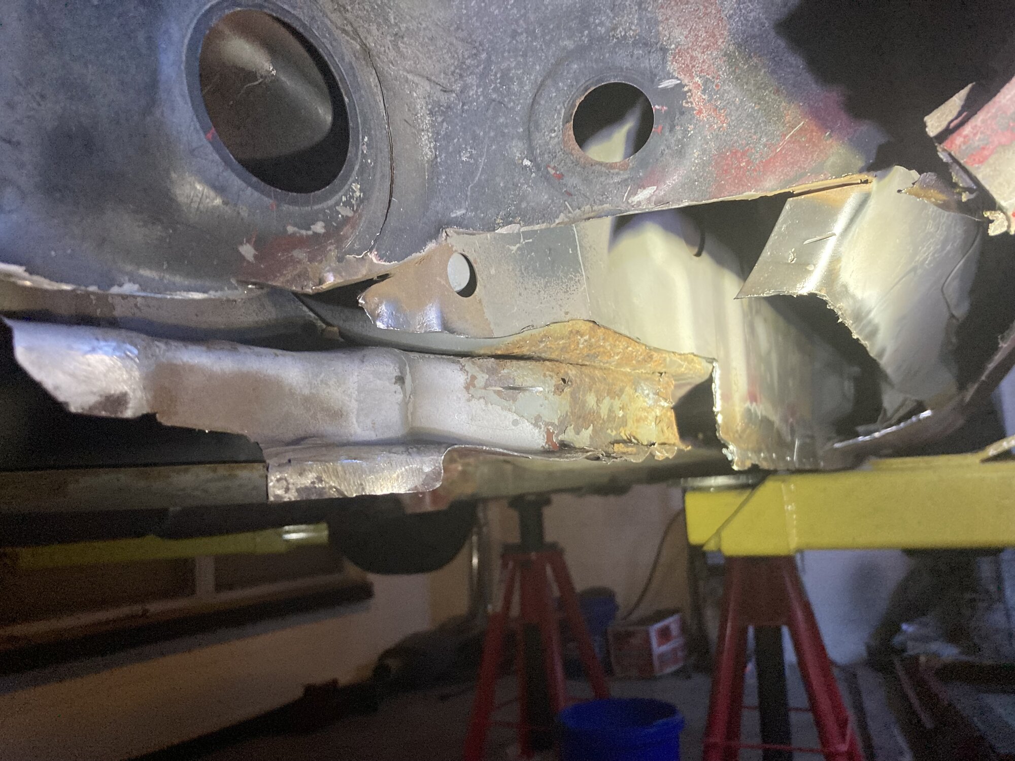

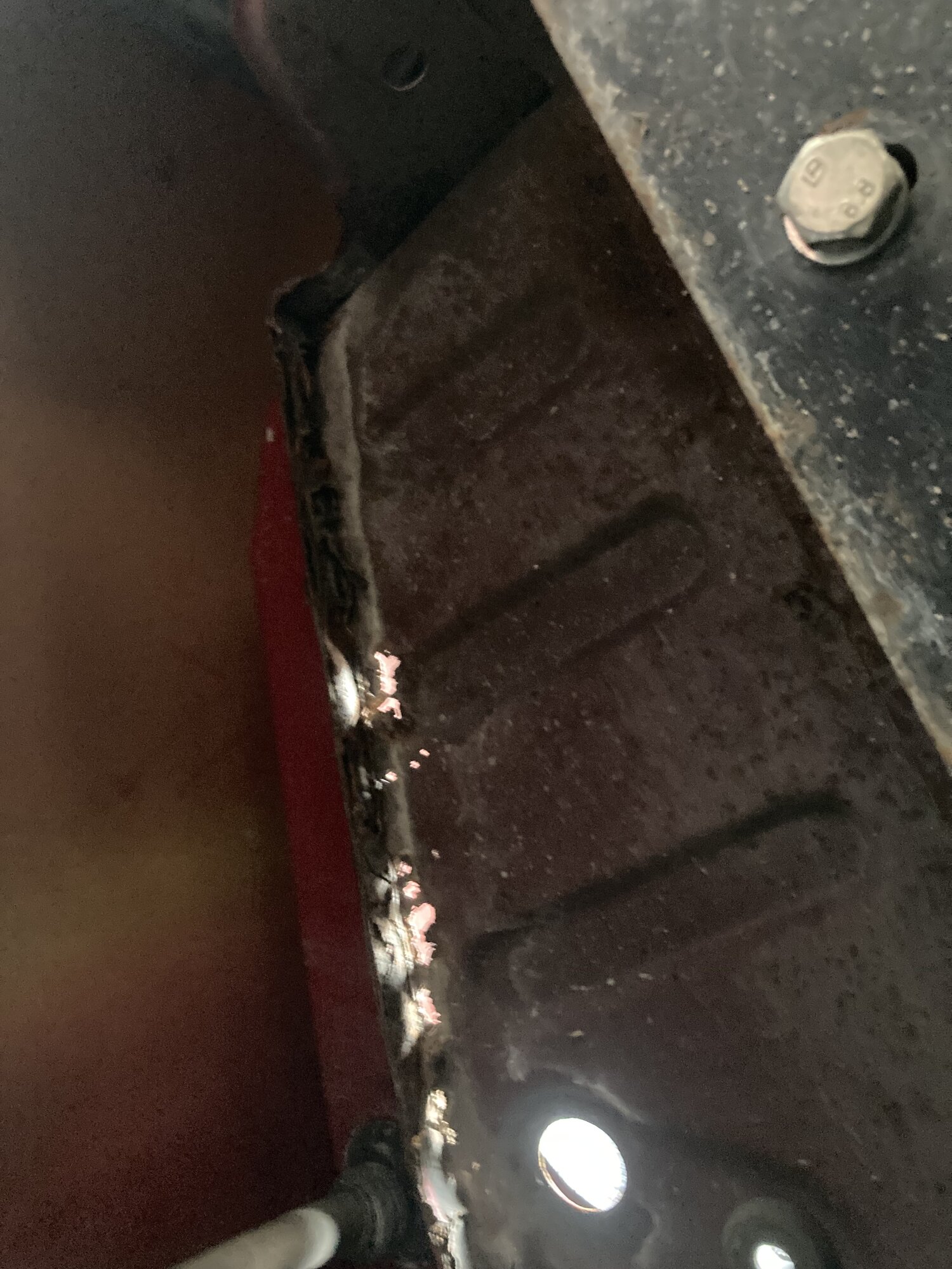

started tapping and poking around with a screwdriver 🪛 on the rockers which didn’t have any holes 🕳️ in them
And this was the result, looks like a small amount of rust…….
The driver side
Passenger side

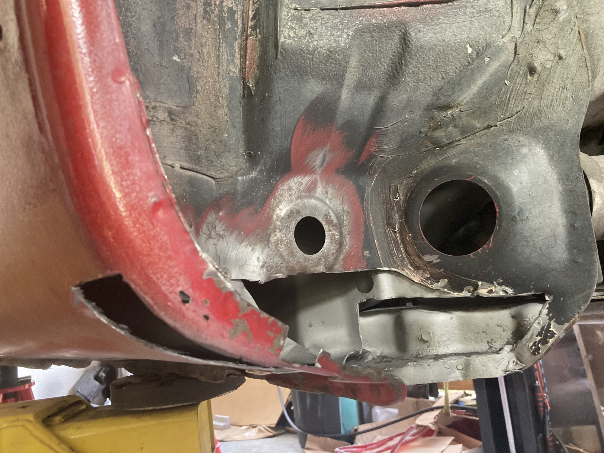

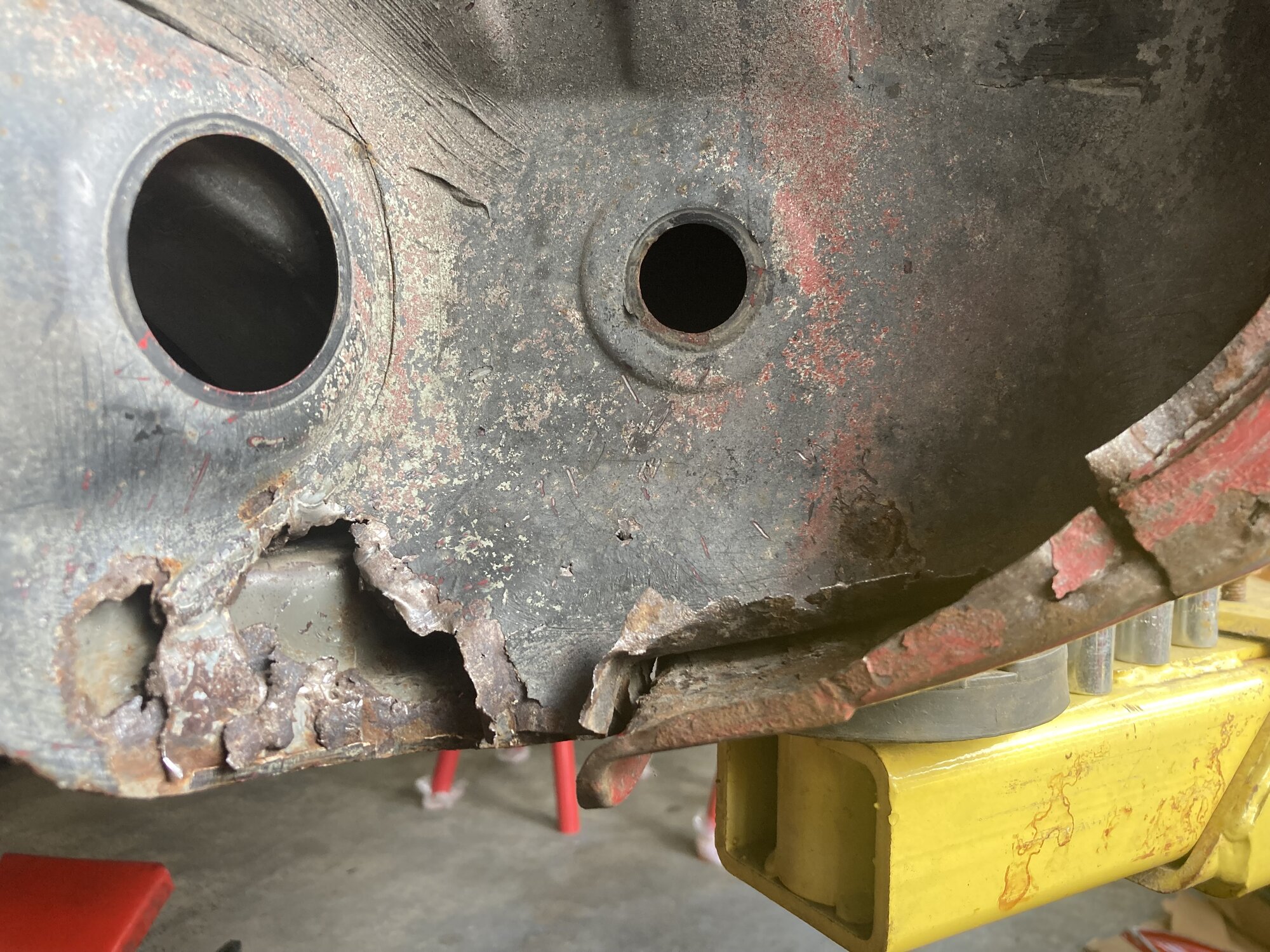

Once you start cutting you realize everything is a lie…….
Driver side looks ok, cut until all the rust is gone
But the passenger side ………

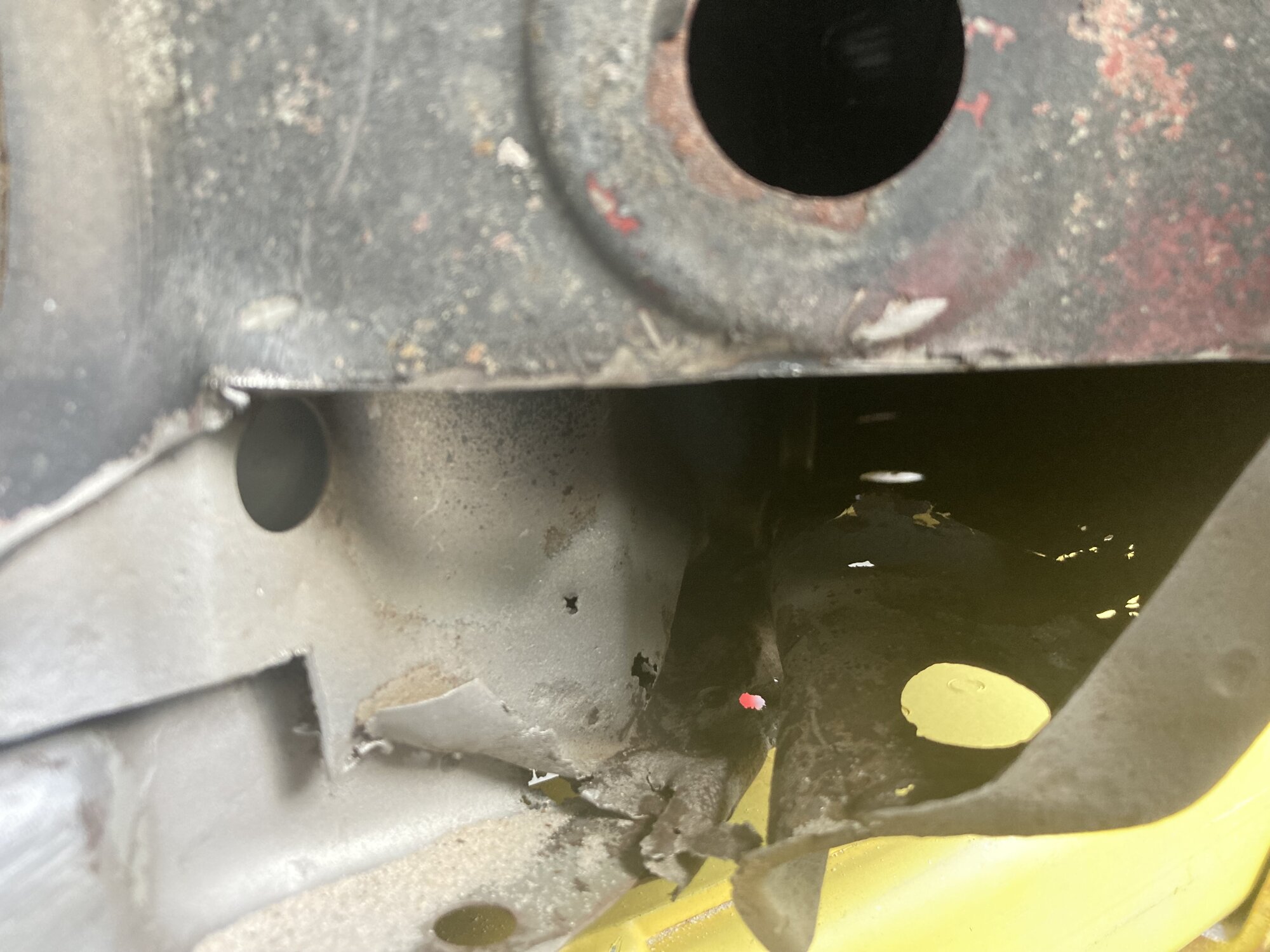

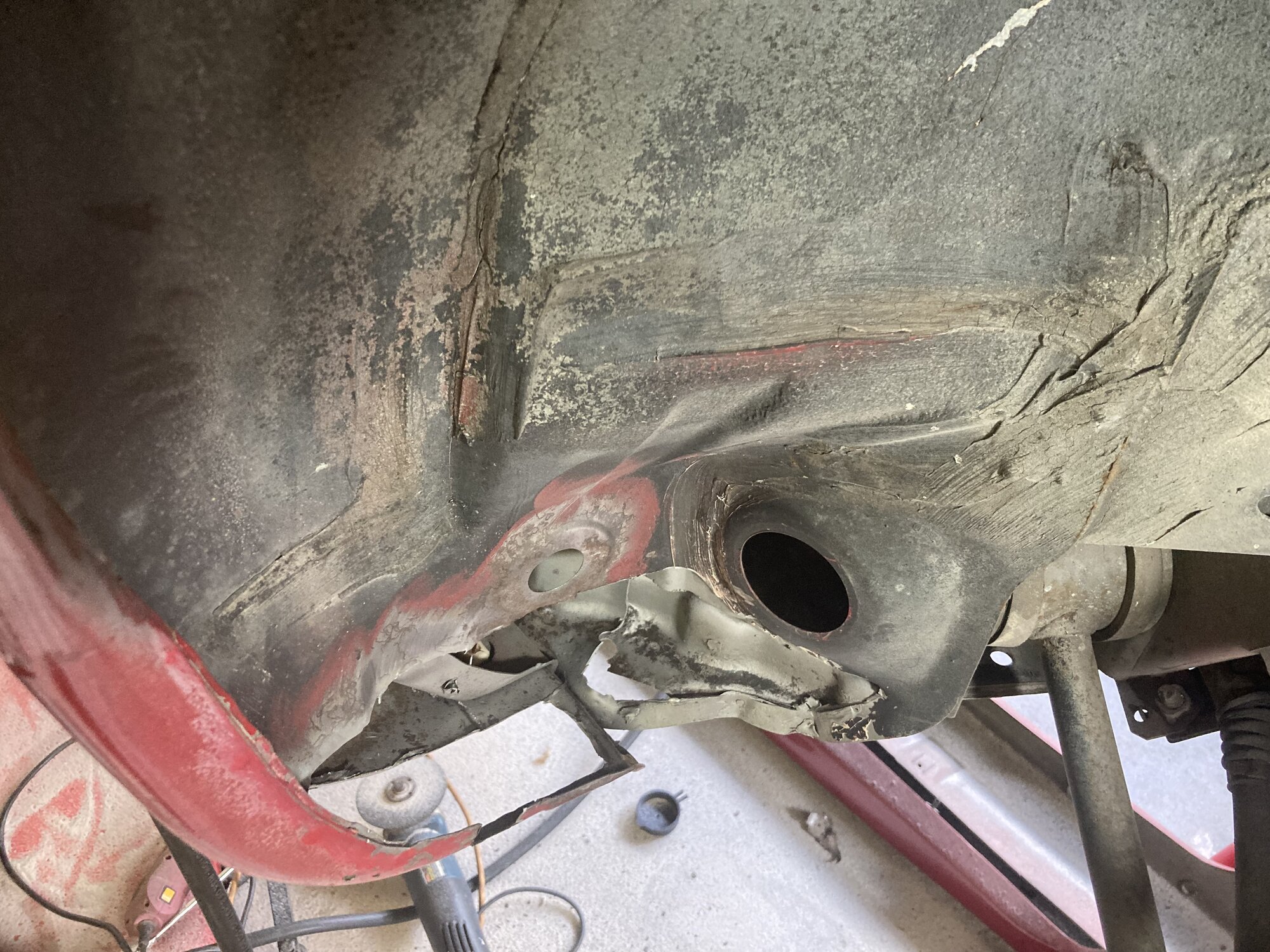

Unlike the driver side I could tell by looking in the cavity that rust had spread more
Which required a bit more cutting, fortunately the rust is on the surface of the 16 gauge structural frame rails. So far it’s just replacing the layers of 20-22 gauge.
I’ve been using this puller to pull down dents on the rockers and in the underbody rails that no will ever see.
Next is more sandblasting (got a new gun with extensions to work comfortably under car)
Primer/ paint and penetrating oil to reach all the secret 🤫 cavities.
