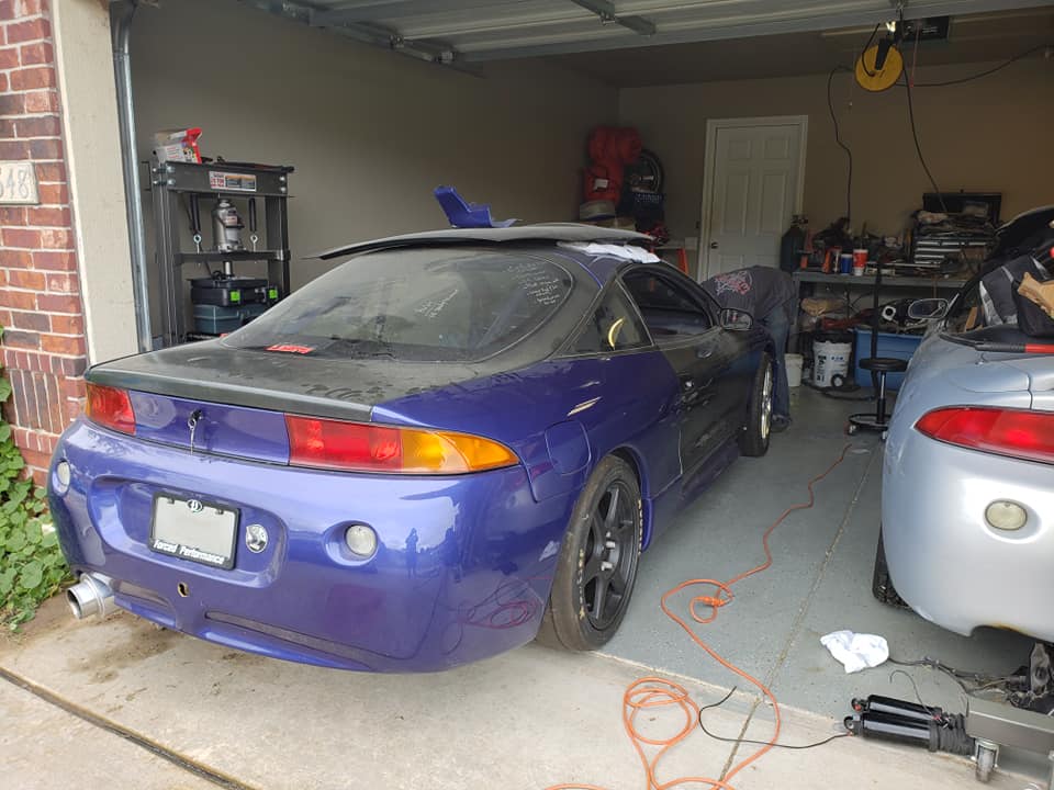

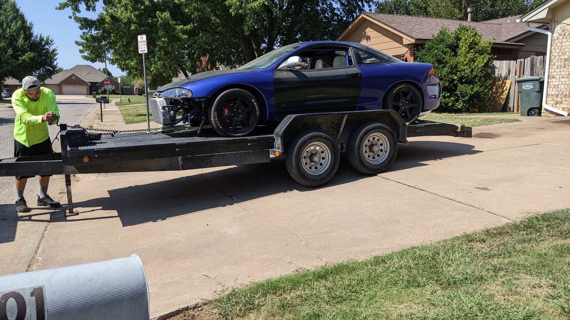

This is the Build Thread for 2G Auto Build. Reply below.

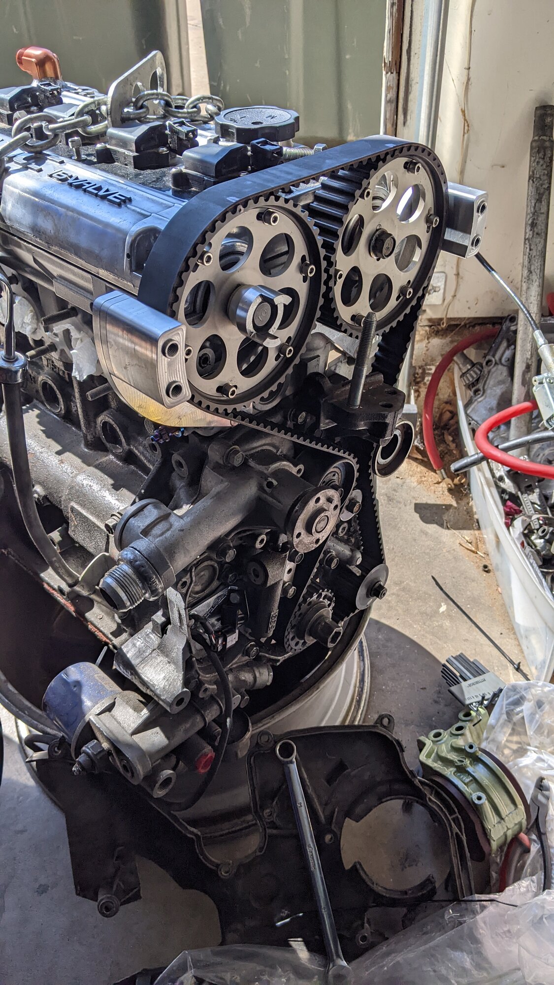

. I think I enjoyed the power application of the auto in my truck that I was very open to an auto build. It's also my first 2G...and an Eclipse! Was never a fan, but boy, I think this one is nice. Growing on me quickly but def lots to tie it up (time wise.)

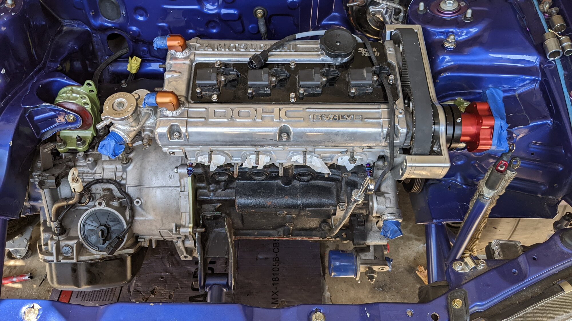

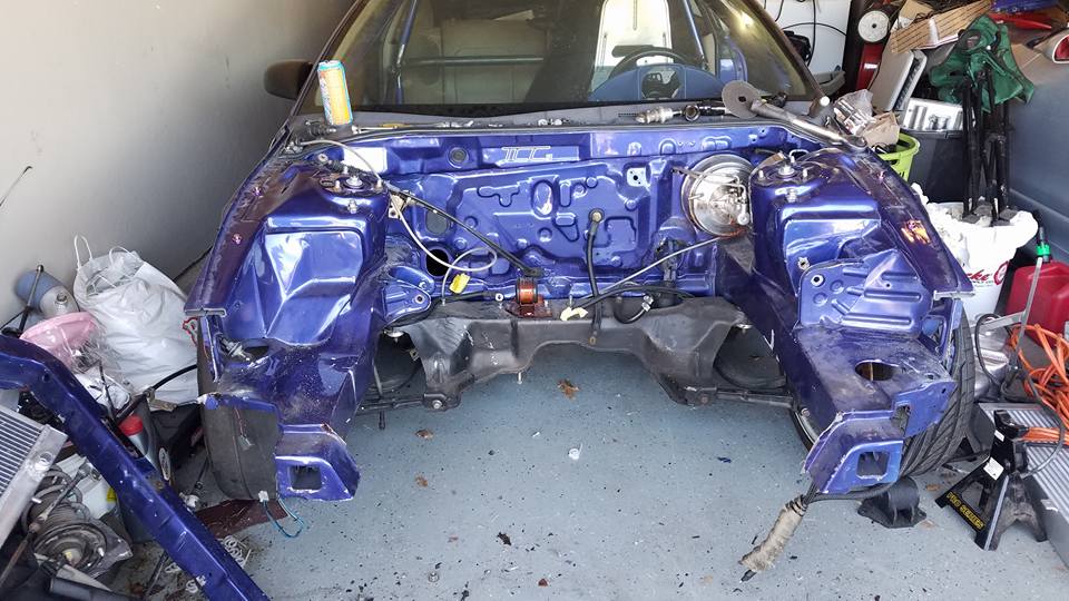

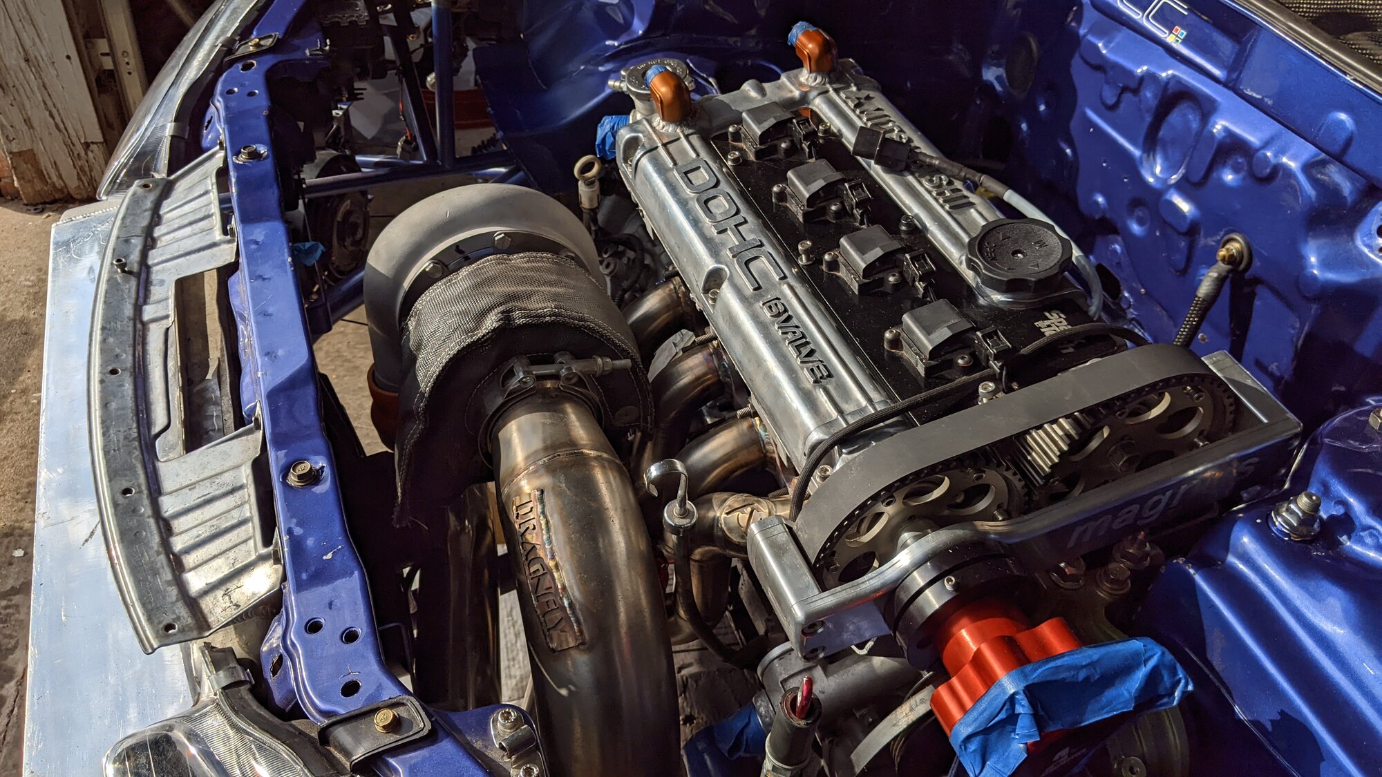

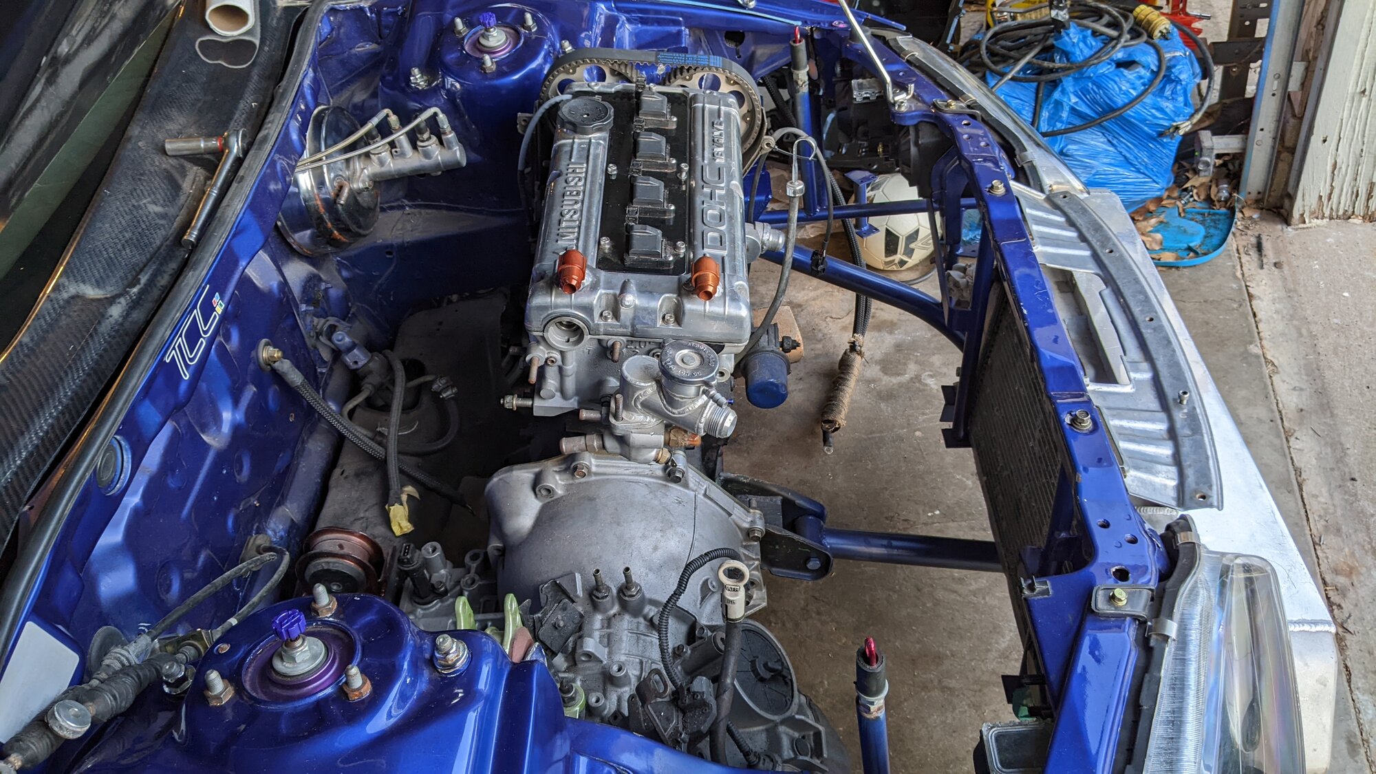

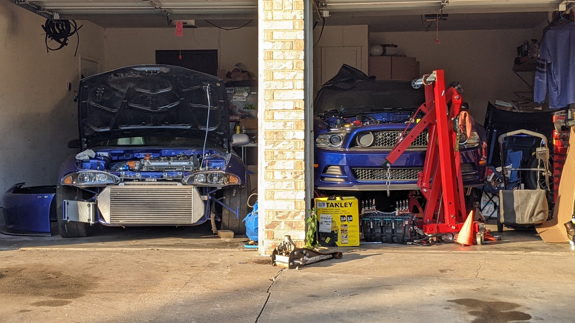

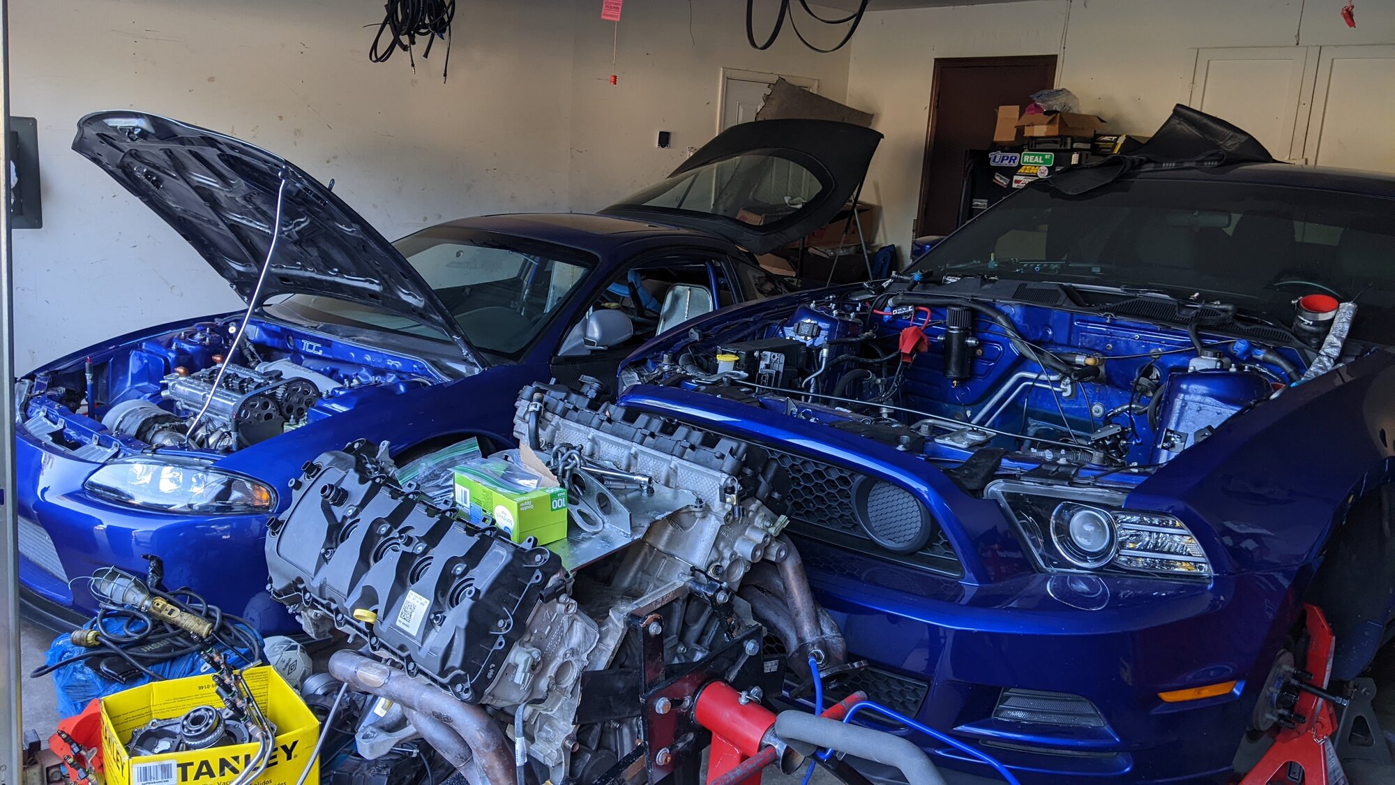

) and re-mount it in the engine bay. Once I do this I can start tackling the underside by installing the automatic differential, driveshaft, transfer case and then onto the suspension bits. Also, I need to install the exhaust that got ripped off during the tow..

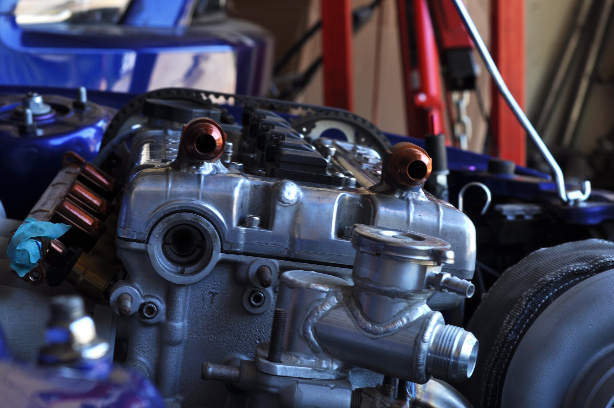

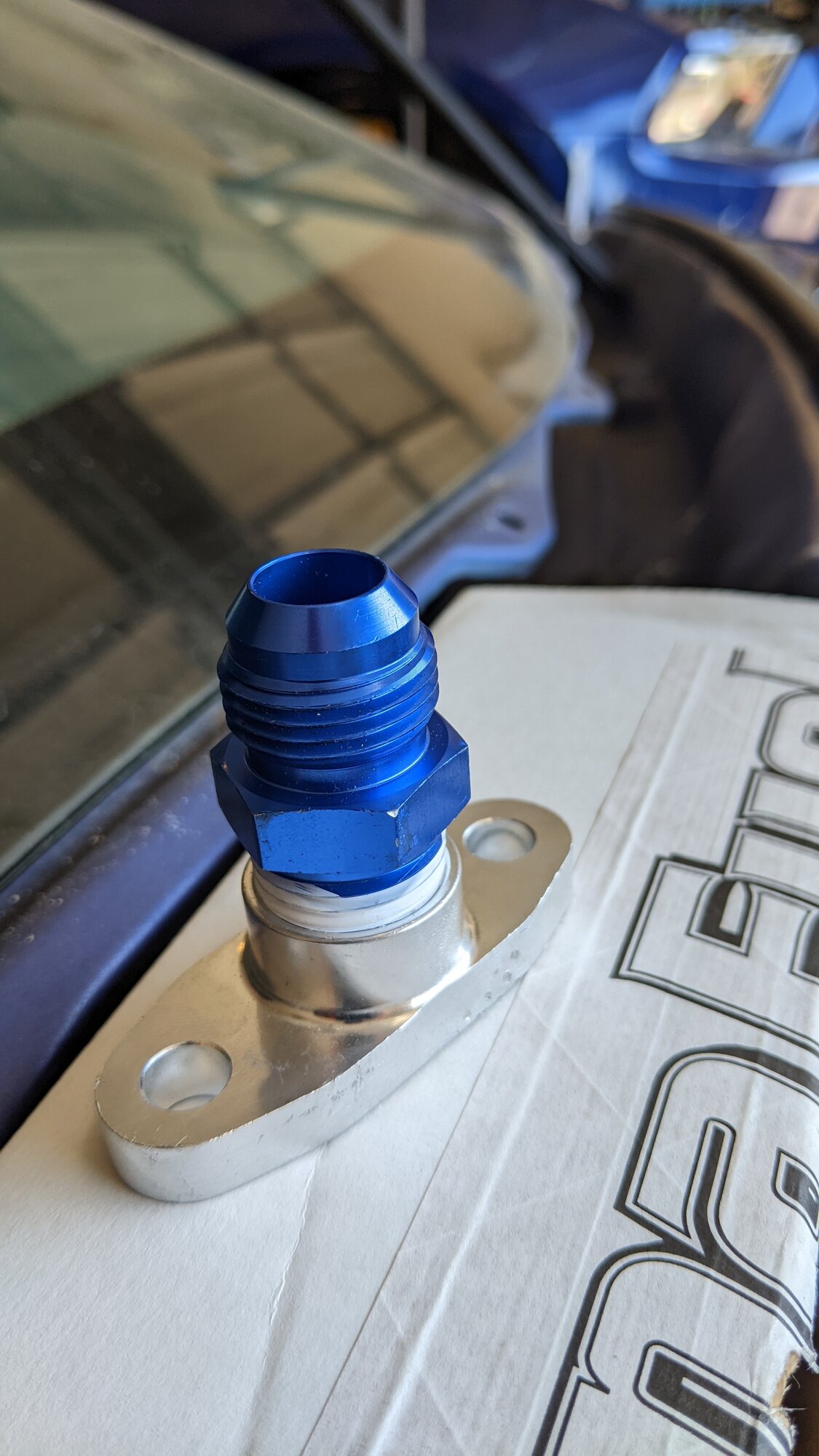

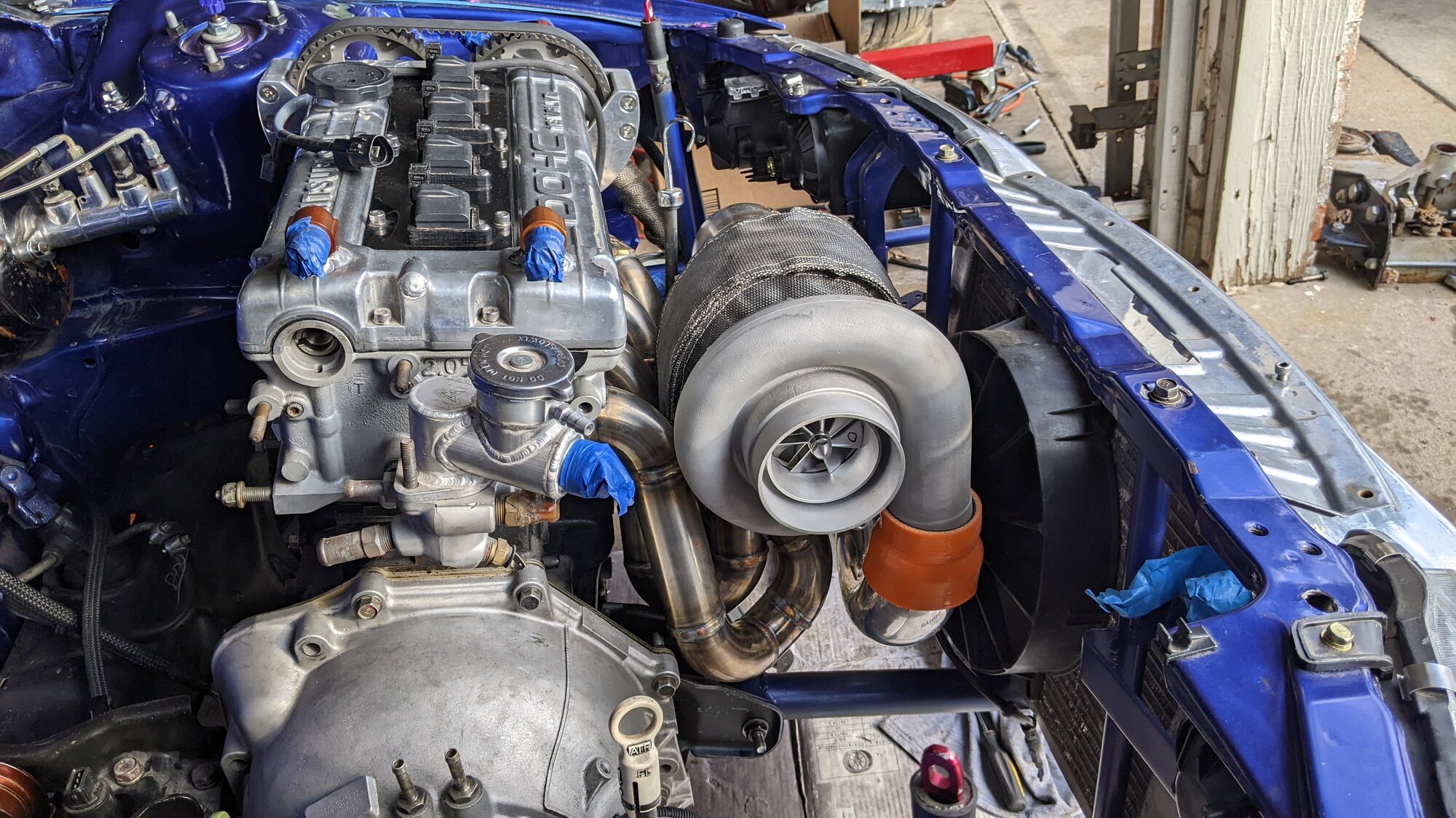

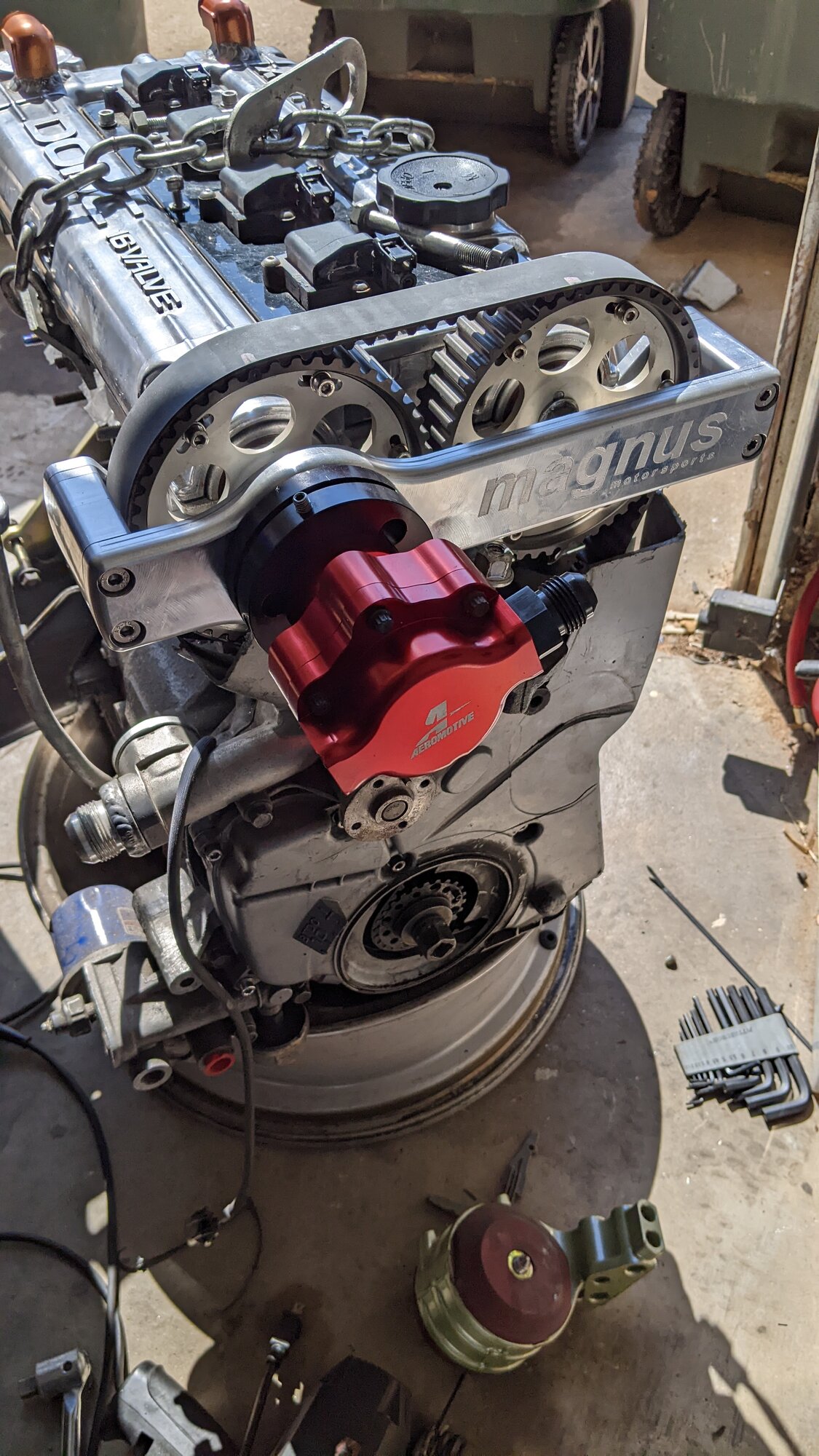

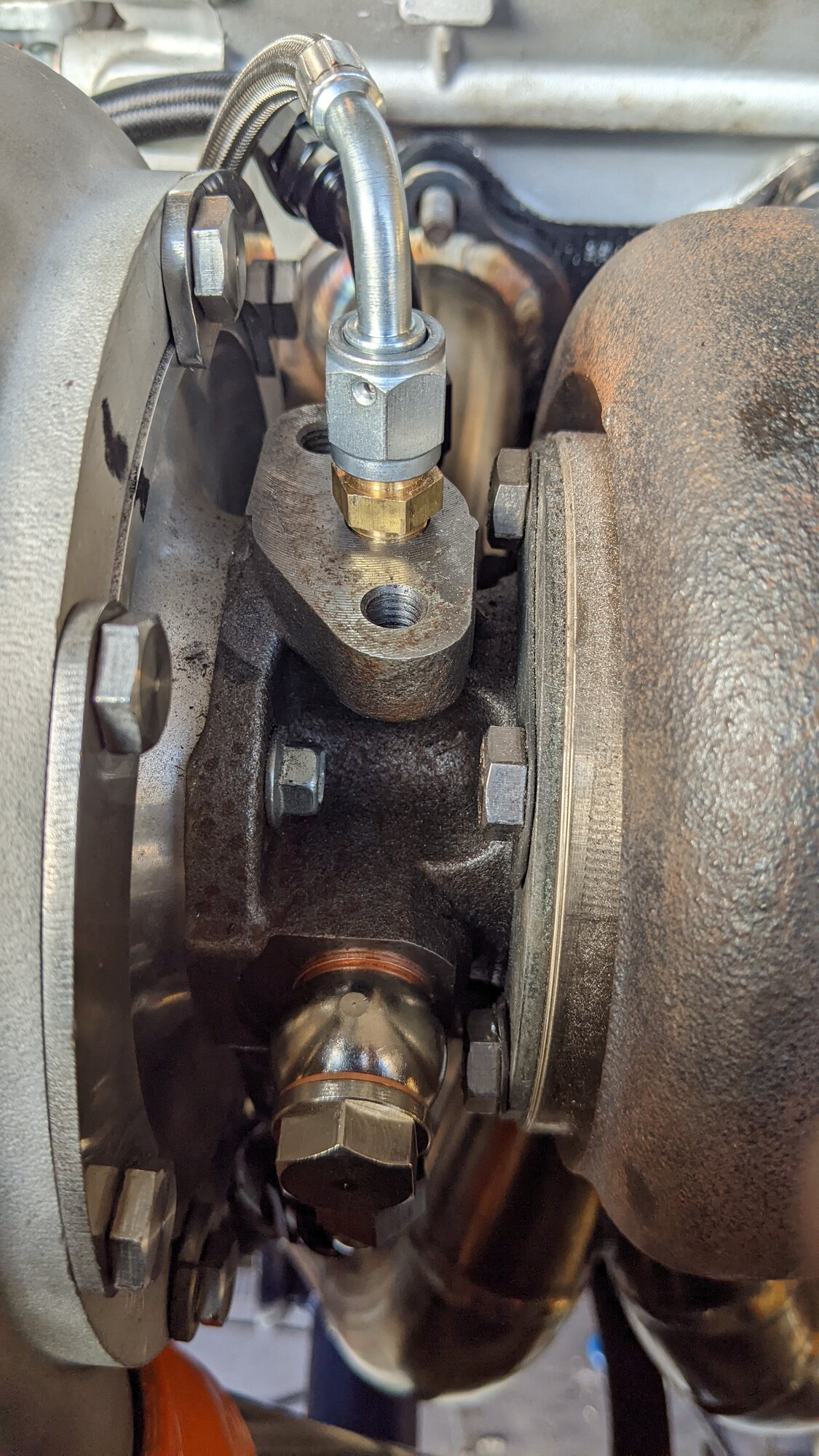

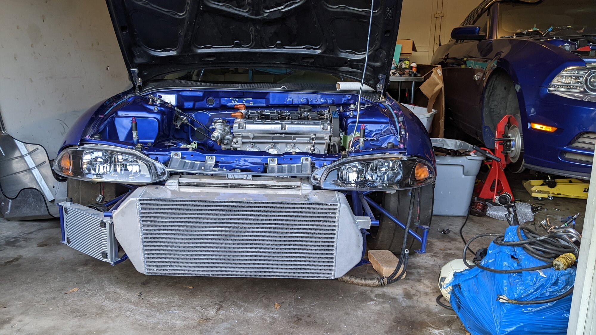

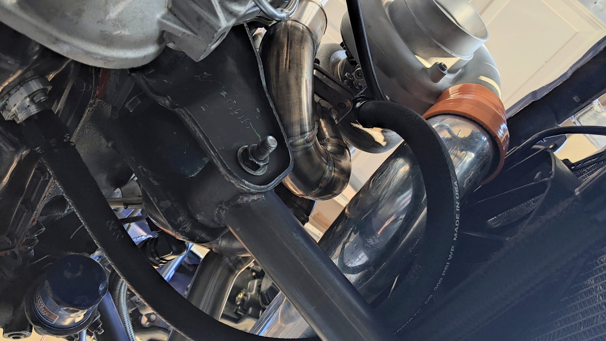

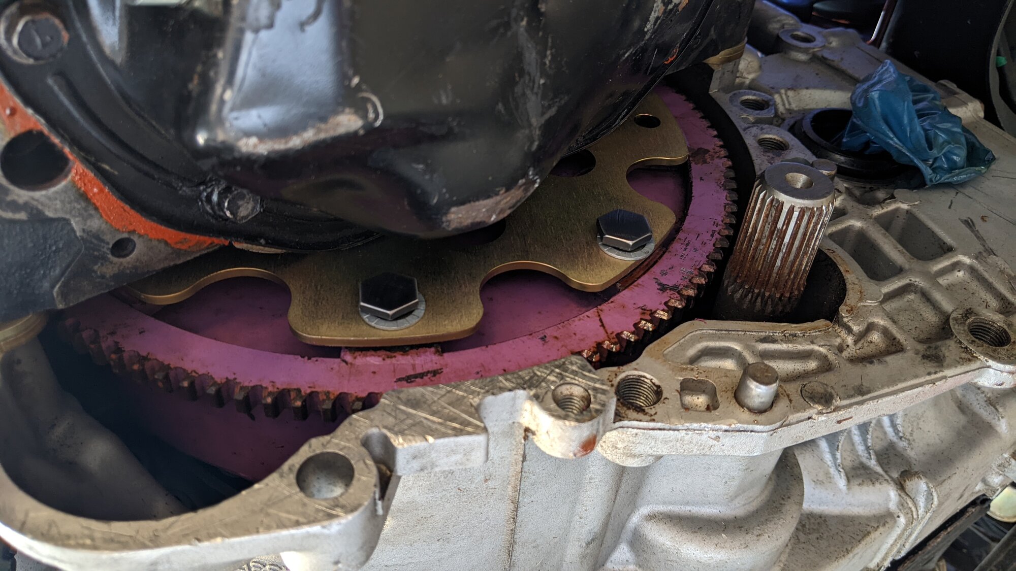

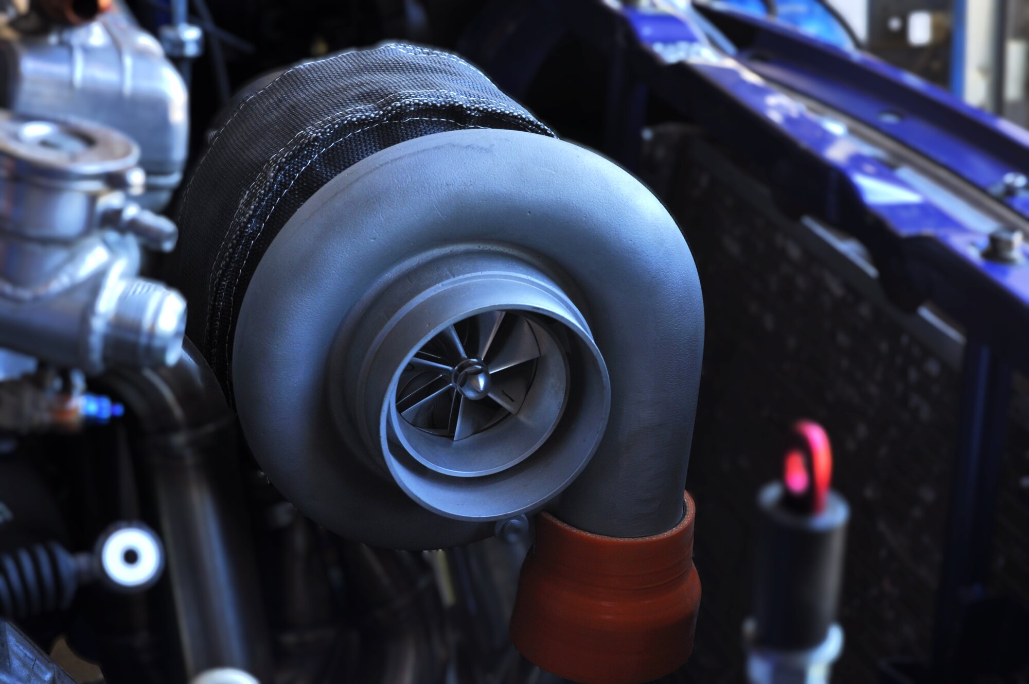

. Anyway, everything clears fine. I had issues getting the rear engine mount lined up but discovered in the process that the inserts were not clocked correctly. The hole is kinda offset in the mount. Just one of those weird things you catch when something that's being a pain doesn't make sense. I also temporarily mounted the turbo kit so I could measure the clearance I had with the SPAL radiator fan I wanted to use, and also, so I can measure and make the oil drain line and turbo coolant lines later in the week. I also removed the manual shifter cables and shifter assembly from the car. HMU if you want those. I still need to torque down the torque converter to the flex plate but everything looks good in that department. In the mean time, I installed the Jay alternator relocation kit. I am undecided whether I want to run the Mitsu alternator (that I already have) or source a Saturn unit which worked awesome in my old car. It was a productive weekend for sure. The next week plans are to run the lines to the trans cooler, do the turbo lines (feed/drain), install front axles and front suspension to keep this project moving forward. It's finally cooling down so this gets me very excited to actually work on projects.I don't weld bro but I have done all my research and we will see if I can get it to hang on. It's still a long ways to running...but it will get there. I am trying to work on it several times a week. Goal is to start and run...safely, I can pretty it up later.
