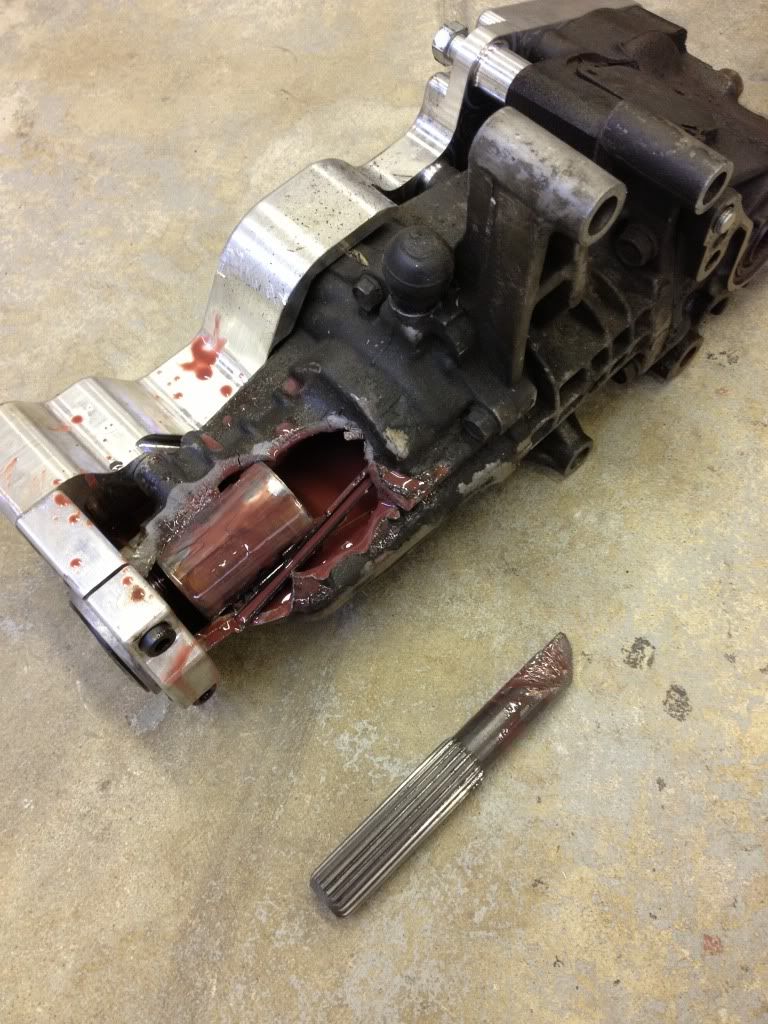

Took the car back to the track Friday, trying to dial in the new boost controller. The air was perfect to go fast, track was crap when we first got there. Turned the 2 step down, went 1.50 60' 5.84@127 on 38 lbs. Car was spinning bad in first once the power came in. Left the 2 step the same, 41 lbs this time. 1.41 5.85@122. Short shifted into third then let out early. Track was good by the third pass. Turned the 2 step back up, car hooked a little too good. Twisted the shaft on the tcase off and shot it through the tail shaft. Car should have been on 48-49 lbs for that pass so probably would have ran pretty good. Luckily the yoke was still useable. Threw another case in, going back Friday then ifo at the end of the month in Columbus Ohio. The frontline fab brace did great, it actually kept everything together for the most part. The gears in the case looked flawless, not much you can do about keeping that shaft in one piece without going to the 300m case. Just not sure I want to spend 1900-2300 on a transfer case LOL
Local 1/8 mile race we were going to run the mustang in got cancelled due to rain from the day before. So we decided last minute to head down to bg to run my car through the 1/4. Planned on trying to get the boost higher for next weekends ifo race, but the pressure regulator on the boost controller was having issues. So the car was only on 41 lbs. Also turned the 2step down to keep this tcase alive a bit longer LOL. Was hoping for a bit faster, but can't complain much for being last minute and the problems with the boost controller.
