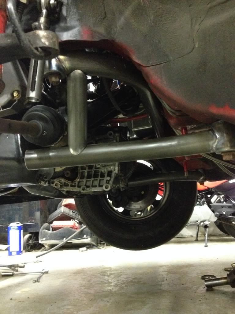

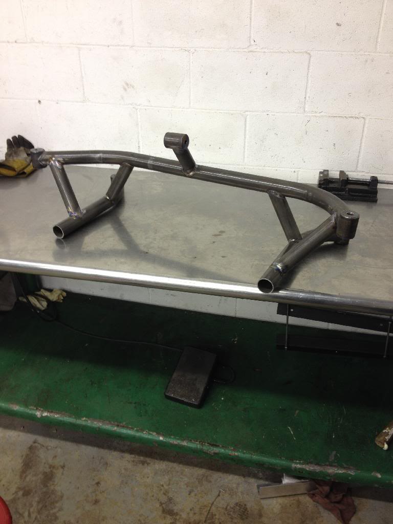

Making a little bit of progress on the K member. Once its all finished I plan on making a jig off of it to make a few more.

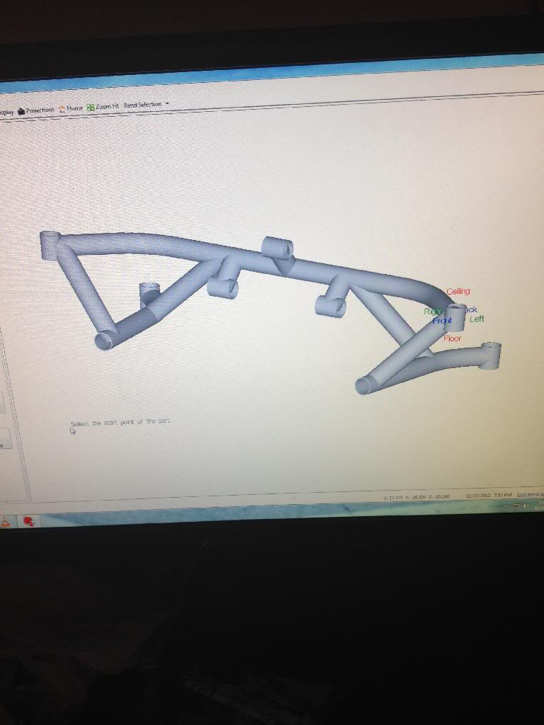

Got the rest of the k member drawn up, unfortunately I don't think it ll be done this weekend. A couple parts didn't show up in time. Hopefully next weekend though.
Making progress on the k member. Only weighs 12.8 lbs right now :) I'm expecting it to be under 25 when finished with the lca's bolted up.
Looking good, I'm interested to see the LCA design. Good job!

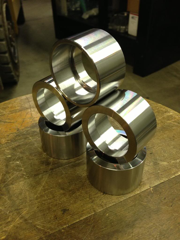

The lower ball joint sleeves showed up as well. So as soon as the weather warms up I'll be getting back on the k member. I believe I'll add a driveshaft loop to the k member also, to simplify things.

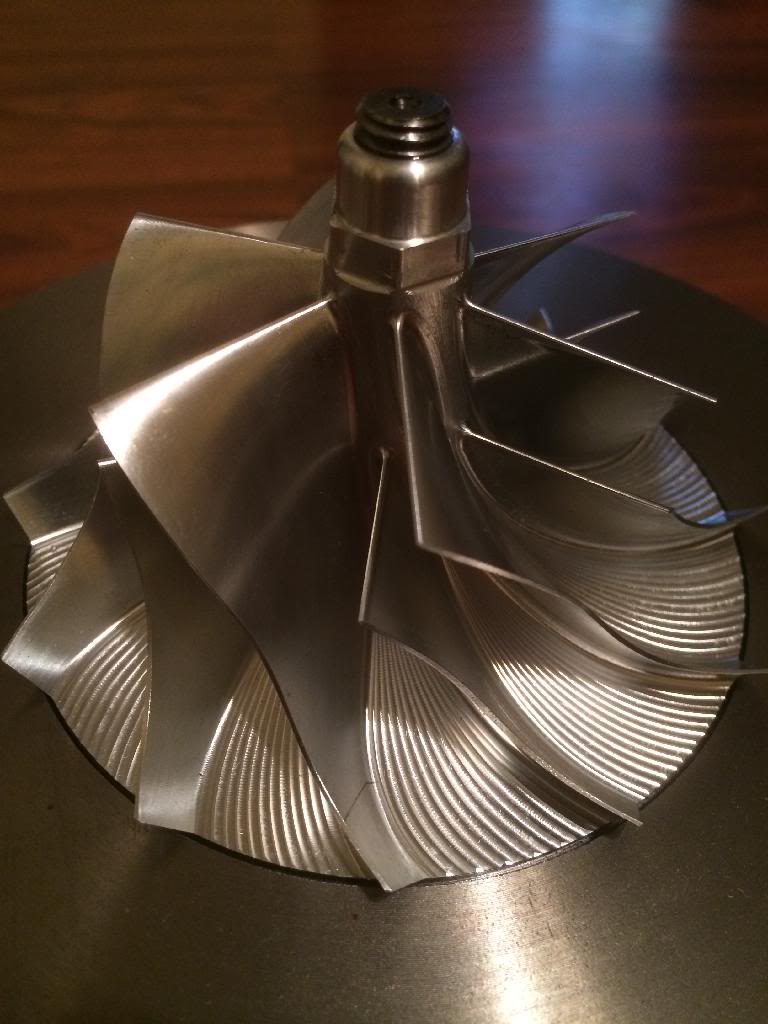

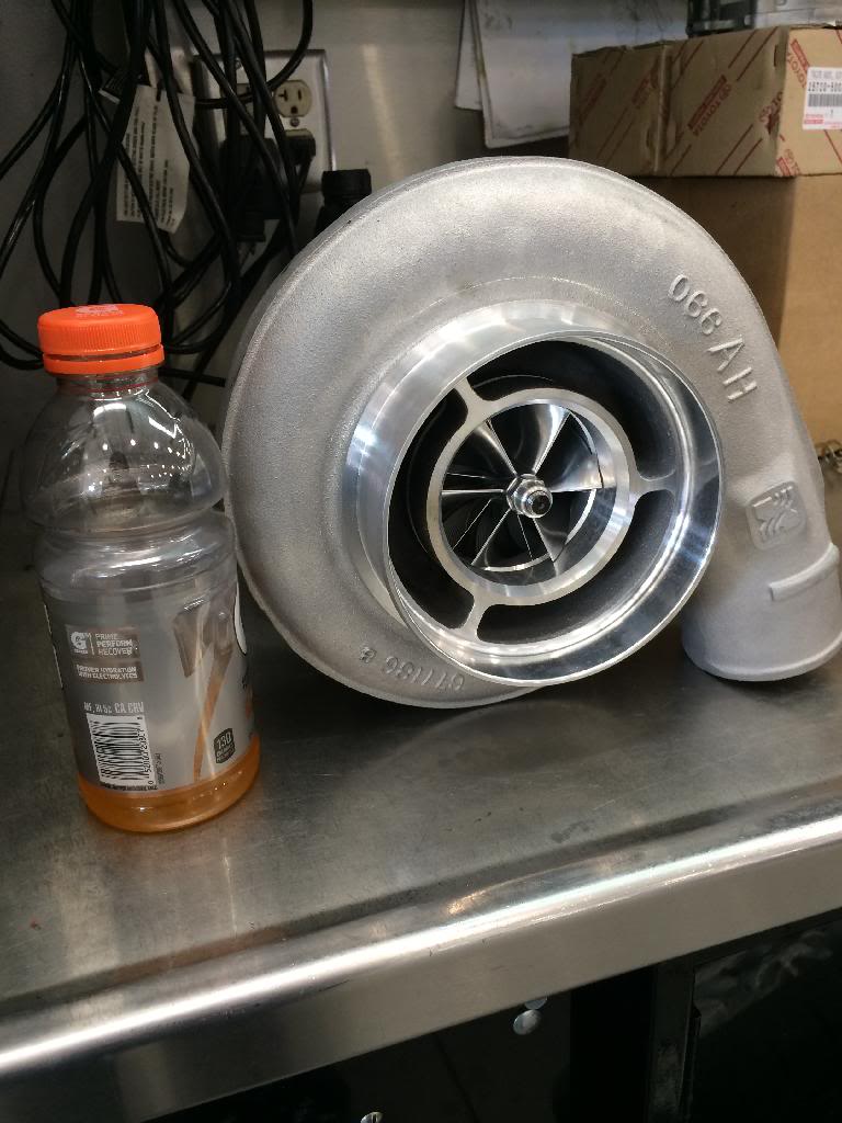

Also, ended up selling the super99, as well as the current setup off the car. After more thought I didn't really think the super99 was going to be able to make any more power then what I already had. Ended up ordering a billet 76mm with a slightly larger turbine wheel then the gt42. Should supply enough airflow to pickup 150-200 more hp then the setup I was running. Will also be switching to a twin scroll setup using dual mvs38's.

Small update on the car. The new turbo arrived Friday, after I get the K member out of the way I'll start on a new divided manifold using dual mvs 38's. Got the collector cut also while I was working on some other stuff.

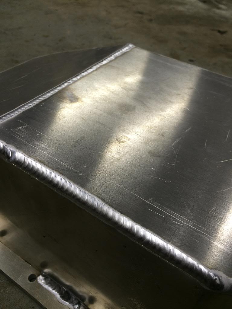

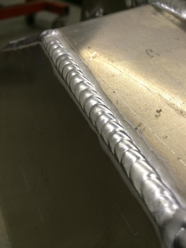

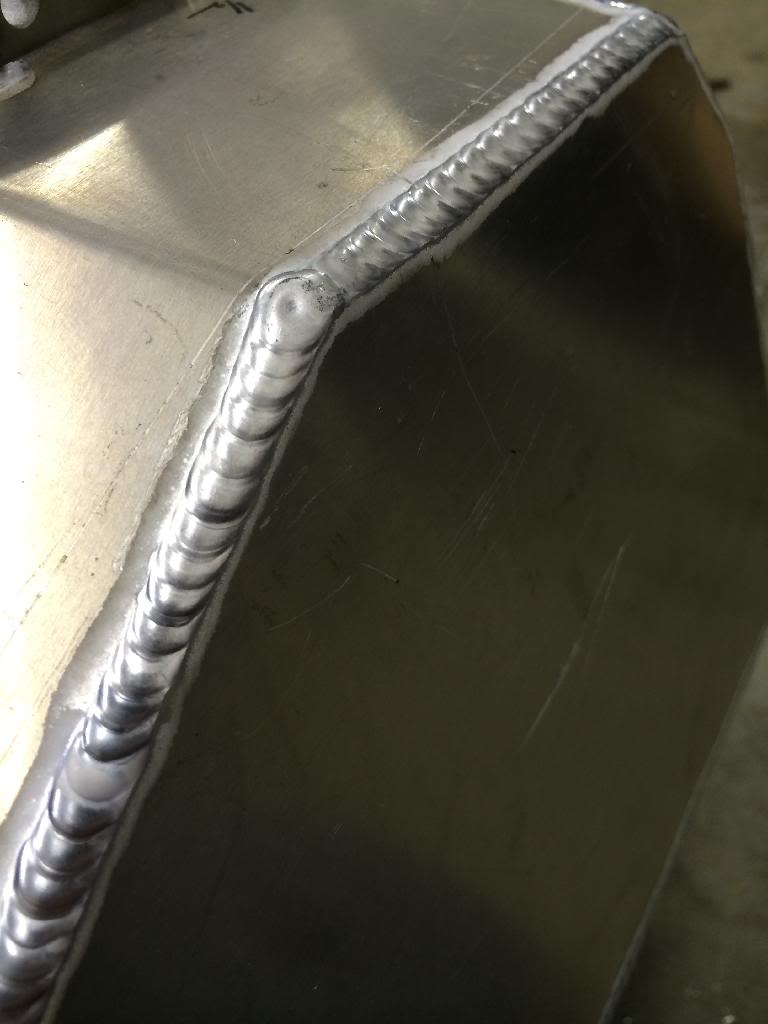

Also made another rwd 4g63 oil pan this weekend, were going out of town next week with the 4g mustang for a race and wanted to have a complete back up motor ready to drop in, just in case. Pan is made from 3/16" aluminum and is internally baffled. Had a local waterjet company cut the flange out.

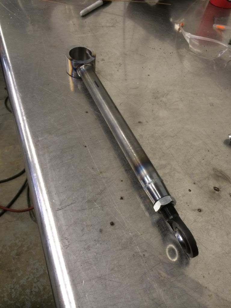

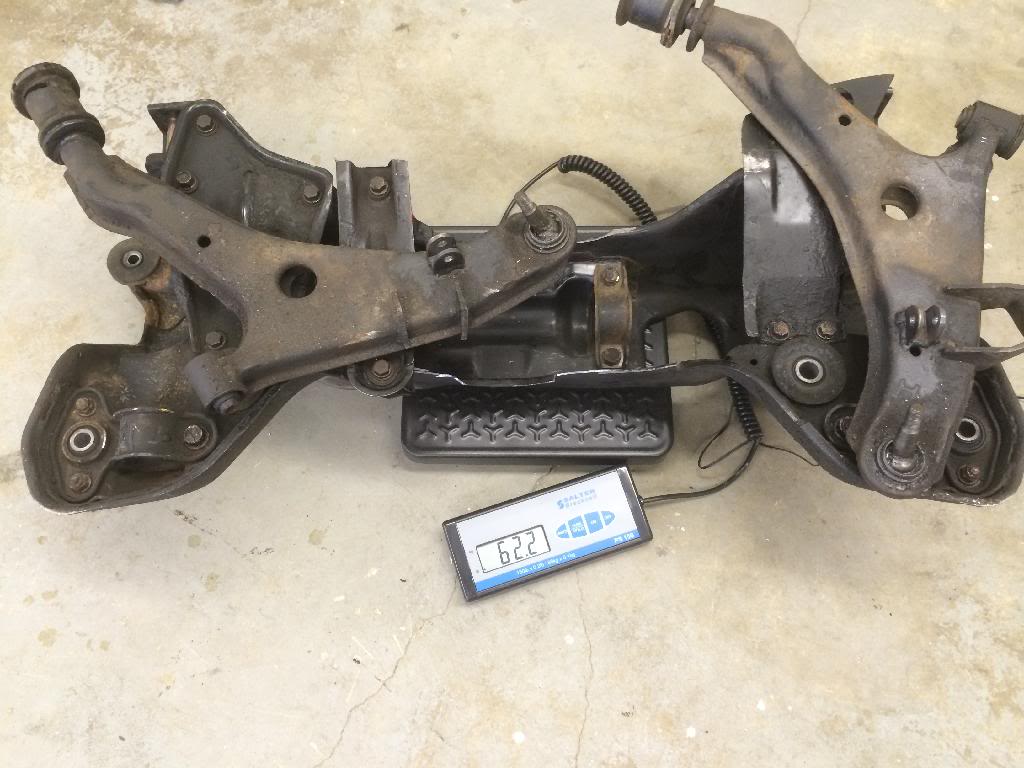

After that was out of the way got a little bit done on the control arms for the K member. Got the left side mounting tabs located and welded on and the control arm about 50 percent finished. Looks like it going to end up weighing 22 lbs all said and done with the tubular control arms. Ran out of propane for the garage, hopefully finish it up next weekend. The picture on the scale shows what all the stock stuff weighs, I forgot to include the rear motor mount so it all probably weighs closer to 65 lbs total.
Oh my.... OMG That is gonna be wicked Aaron! :hellyeah: Very nice and really nice work on the oil pan. :thumb: Good luck with the Stang! :D
