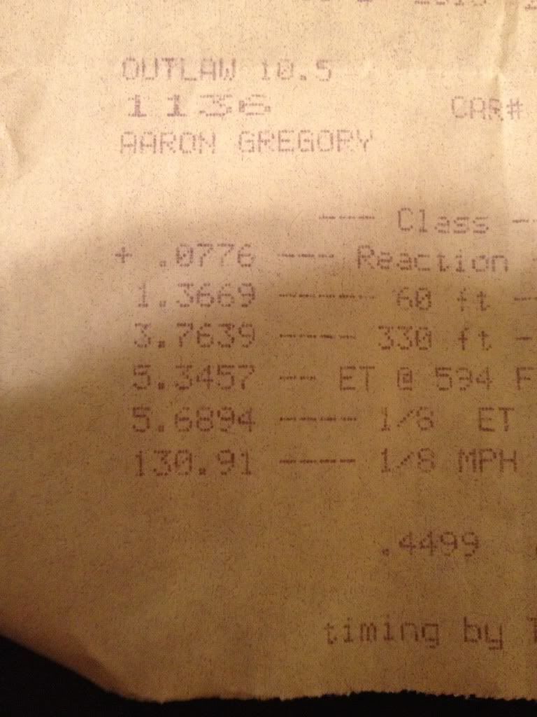

Got the car out to the track last night. Only made a few passes. First pass was turned all the way down just to be sure the car goes straight and drives like it should. Went like 63 mph on 14 psi and no launch haha. Turned the boost up to 40 for the second with the timing still real low. Still no launch, just checking the tune. Went 7.20@118 LOL. Tried to launch it the third pass but just pushed through the brakes. Going to wire the brake pump differently this week. Rolled trough the beams and went 7.50@121.
