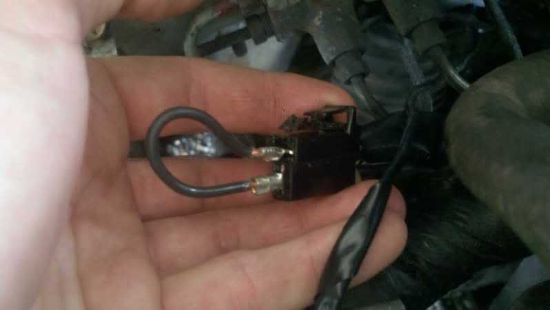

Keep in mind the year of your DSM will determine the proper solution as certain years might gave unique issues such as a 90 having a noise filter that can wipe out the Tachometer. A simple jump wire can fix that.

I see you have a 90! My favorite year but also the oddball for everything!

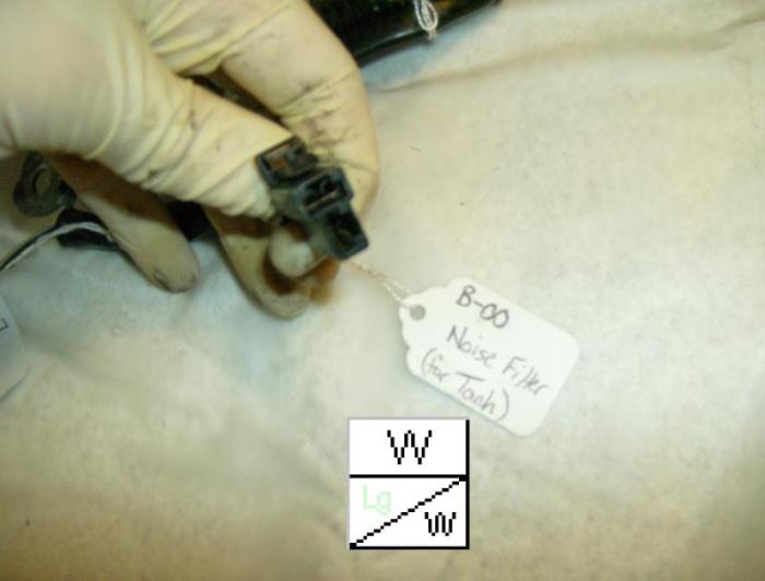

Check behind your intake manifold on the harness there is a pigtail for the noise filter. Sometimes the filter goes bad and it can not easily be replaced, however it’s possible to fix it with a jump wire.
Here is a link to a tech article on here with pictures and detailed instructions!
I have a feeling this will be part of your problem.
https://www.dsmtuners.com/threads/how-to-fix-a-1990-dsm-tach.414636/

There’s this guy just dangling around and I’ve looked but couldn’t find where it goes unfortunately I can’t get any more pics for a while
That one can remain unplugged. It goes to your ac compressor if it’s still there iirc.
The one your after will be two wire. One will be perpendicular to the other. Your coolant reservoir has the same style pigtail for reference. (If stock of course)
That link I shared above does show images of it and you’ll see how he does the wire jumper turning one 90 degrees of the other
https://www.dsmtuners.com/attachments/1316451255557-jpg.453941/ (pigtail you are after)
