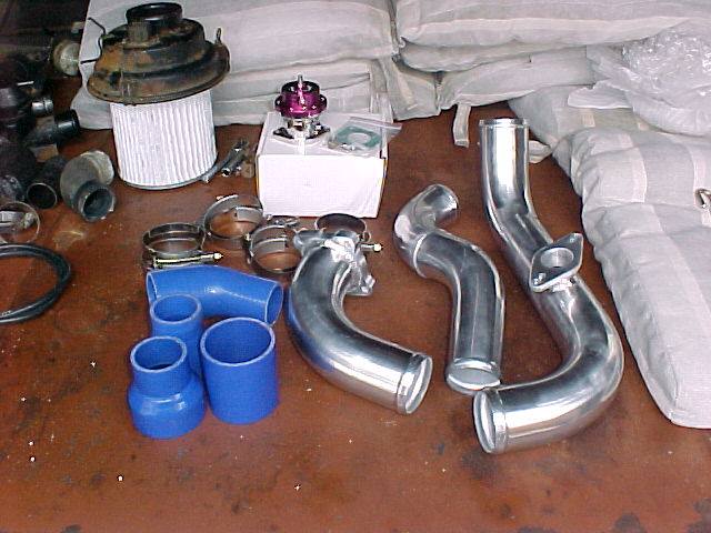

Any way thats not really alot BUT it was just enuff to get myself a CXRacing 1g bolt on hard line intercooler piping kit off eBay for my car iv been wanting one sins I got the car but just haven't had the money so im pretty happy and I can get rid of the half rotted out stock rubber ones

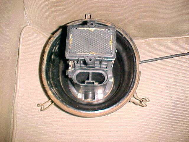

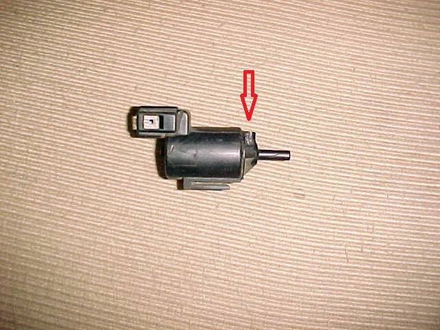

the 1st one I did was to the MAF to make it flow better you can see here iv already done it

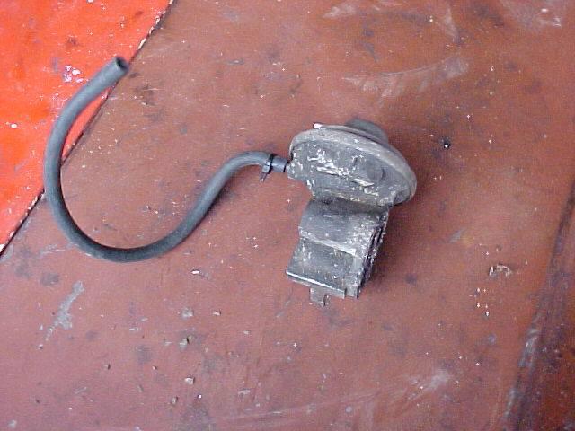

Iv also ordered a EGR block off plate the other day so I guess im ahead of the game the so as soon as that gets here all the emission vacuum lines will be removed and most of the other stuff has been done I also have a spare valve cover breather left over from my old 89 Probe GT

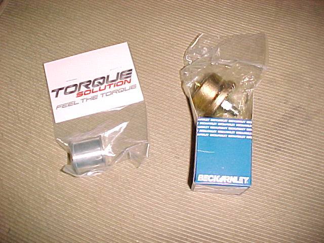

Some goodies come in today a Torque Solution BOV bypass plug and a Beck & Arnley oil psi sender switch for the oil gauge
Got the BOV bypass plug installed in the BOV return best $7 I spent so far on the car because I can now hear the BOV go SSSSSSSHHHHHHHhhhhhhhhh and I love it

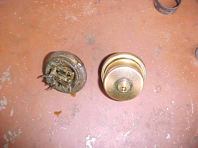

Here's the new oil psi sender next to the old and broken one any guess's why my oil gauge didn't work LOL

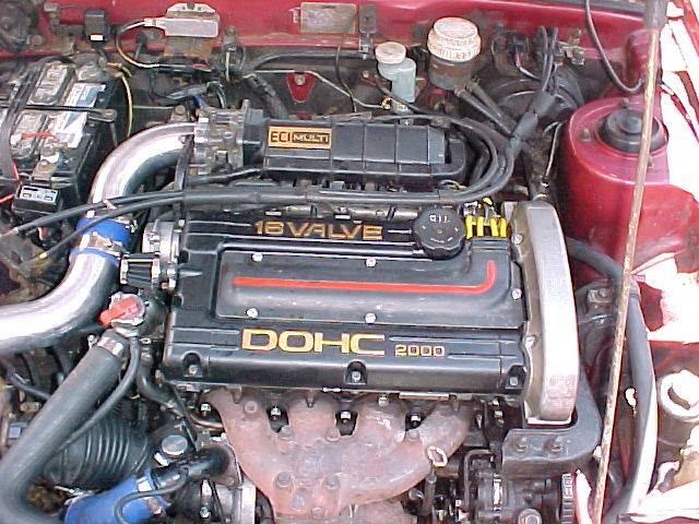

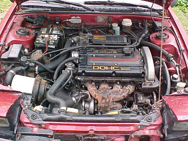

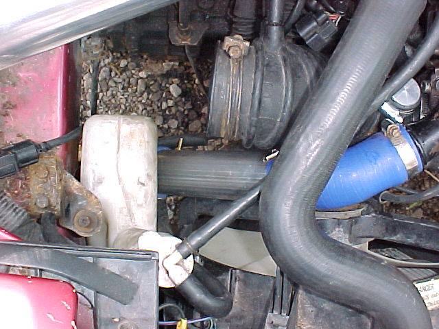

Getting cleaner you can also see that iv already removed the emission vacuum lines and hopefully the EGR block off comes soon

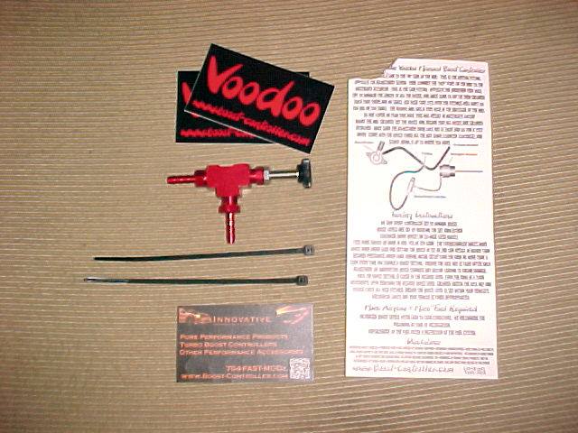

Ordered me a Voodoo 3 MBC today I heard there pretty good plus there cheap witch is good when your broke LOL I also got me a set of Accel spark plug wires coming that I got on sell

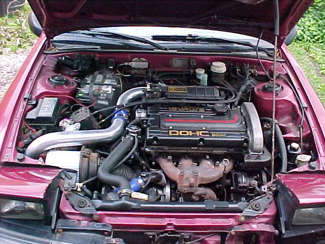

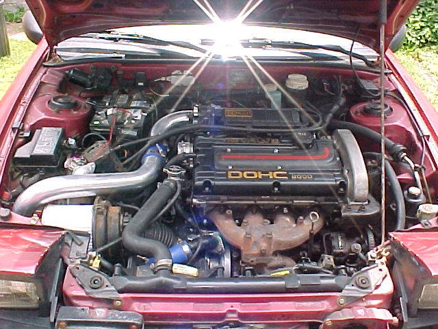

Yippy :D My CXRacing hardline kit come today

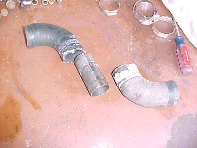

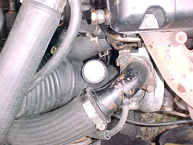

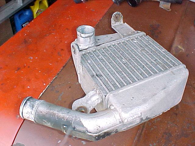

Just when you think you fixed all the stupid it shows up and bites you in the ass... You can see someone cut the top outlet instead of fixing it the right way :banghead
And this is how they fixed it 2 90*'s and a peace of pipe :banghead
Ya bolt on my ass if the top intercooler outlet was not cut I mite not of had the play to get the top piping on and still had to cut the hole in the fender well bigger to fit and the CXRacing bottom piping did not fit at all I think your sapost to cut the bottom intercooler inlet and shorten it a bit but f*ck that I found that if you turn the 2 fittings they line right up so I bought a peace of steel pipe 9 1/2" and it went right together :super

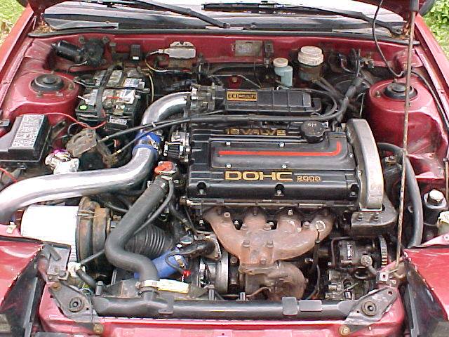

All done

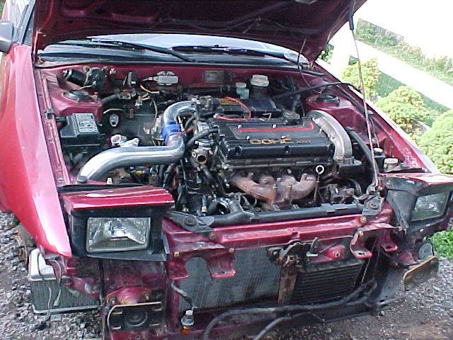

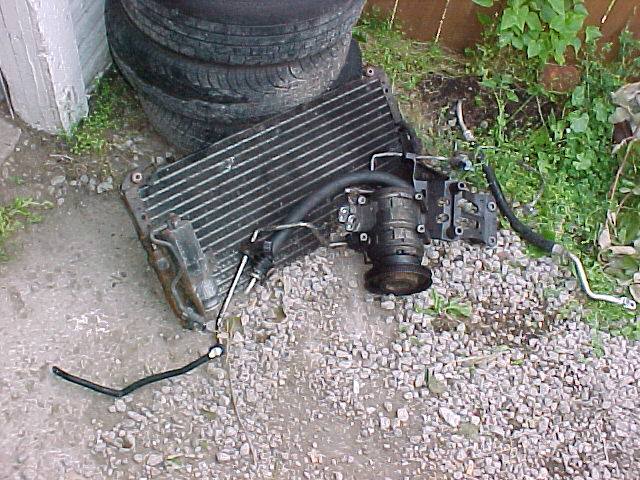

I decided sins I was already dirty to pull the AC system out... I should of gone to bed ### this turned into a cluster f*ck :banghead
To get to the AC crap I pretty much had to rip the car apart

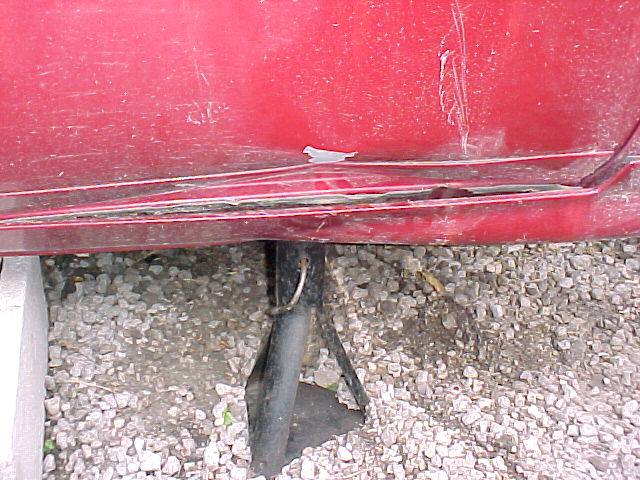

Yup fix 1 thing f*ck up 4 more the car fell off the jack and crushed the bottom of the door needless to say im pissed :evil: Iv NEVER NEVER EVER had a car fall off a jack not in dirt not on a hill not even with the jack a a bad angle but this makes the 3rd car this year to fall off a jack and all in this drive wall :quoi

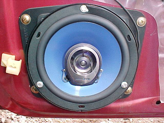

The only good thing to come out of the hole damn thing is when I pulled the door panel off to try to fix the door I found the car had new Alpine speakers :super

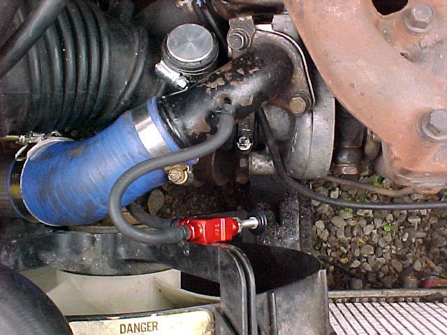

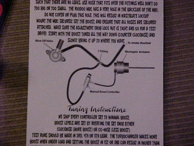

My new Voodoo MBC come today
The paper said to hook it up to the intake after the t.body but I was short on time and zip-ties so I just ran it like 99.999% of people do thin I tied it off to the fan for easy access ill try it out like this but if it acts up ill run it to the intake like it says

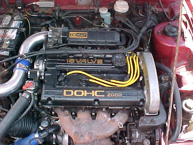

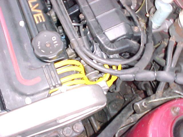

The new Accel wires finally showed up
There alittle thicker than the stock wires
All crammed in
Its one more step closer I guess
