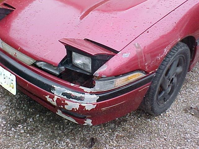

Now I'm back. I just picked up this 90 Eclipse GS-Turbo on the cheap. Except for some rust on the driver side door and some chipping paint on the front bumper its in pretty good shape but she does need work and lots of it, mostly just small stuff. It does need a new clutch and looks like 2 of the charge pipes need changed as well.

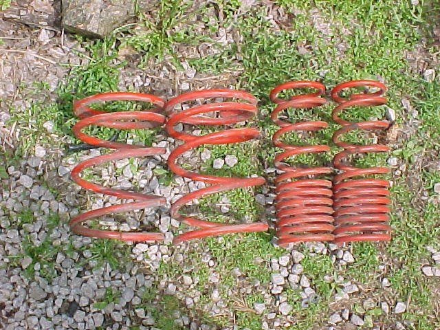

The car has already had a new master cylinder and slave cylinder installed before I got the car and the old owner threw in some Dropzone 2" drop springs which I'll install after I get the new clutch in. I've also ordered brass shifter bushings and a new short throw shifter.

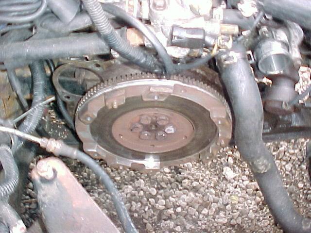

Just got done dropping the trans poor car someone has been in there before who should not of been its missing a bolt on the tranny mount its missing a bolt for the bellhousing 1 other bellhousing bolt was broke off so it only had 1 bellhousing bolt holding it on the metal shim was missing its bolts and every bolt was just hand tie't poor thing never had a chance :toobad: So I guess I get to spend my day drilling out bolts and cleaning up someone else's mess :mad:

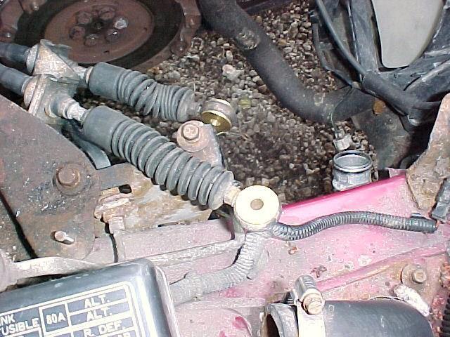

Well got the broke bolt out ok went and bought some bolts to replace the missing ones and got the shim bolted back up just waiting on clutch before I can go on also the slave cylinder is not holding PSI I can easily push it in by hand so it needs bled or something
Got the new clutch in replaced all the missing bolts my new brass shifter bushings come in today also so I put them on every thing seems to work ok but I can push the slave cylinder rod in by hand but it dont seem to leak ill half to keep an eye on it for now...

Also got the brass shifter bushings

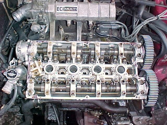

Got all new belts on the car today I found that the intake cam was 3 teeth off WTF some people should not be aloud to work on cars LOL got new spark plugs and a new air filter on as well and I also got a new oil PSI sensor now I just need a new oil PSI sender so my oil gauge will work but the car runs much better and will only keep getting better as I work on it

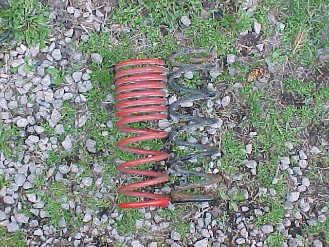

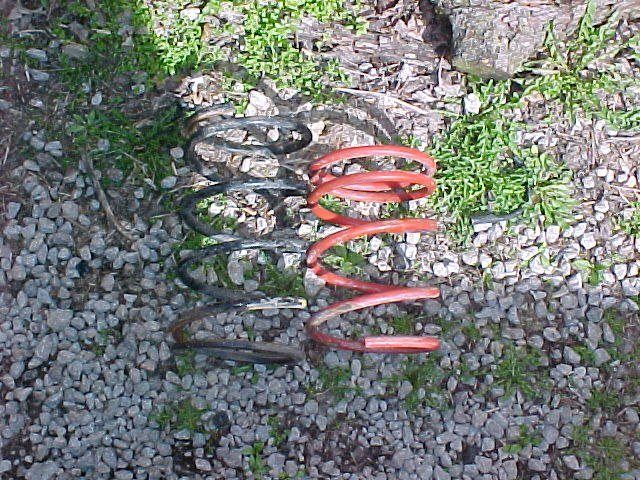

I spent most of the day putting the Dropzone springs that come with the car on man what a pain :banghead: got them all done what ya think
Front
Rear
All Done

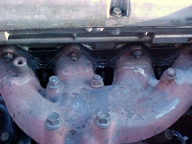

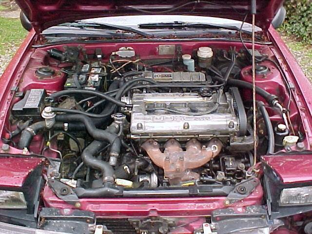

Fixed the wire for the temp gauge today so I let her run for about 20min and got it nice and warm after the 20min I started to smell something odd coming from the tail pipe so I started looking for the cause and found this :confused:
:banghead: If any one has a clue as to what in the hell would make oil boil out from the manifold like this please let me know????

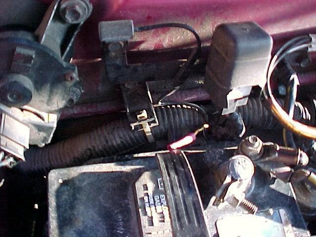

Also iv got this little yellow and red wire by the battery if any one can let me know were it goes also its coming out of the harness so it cant go very far

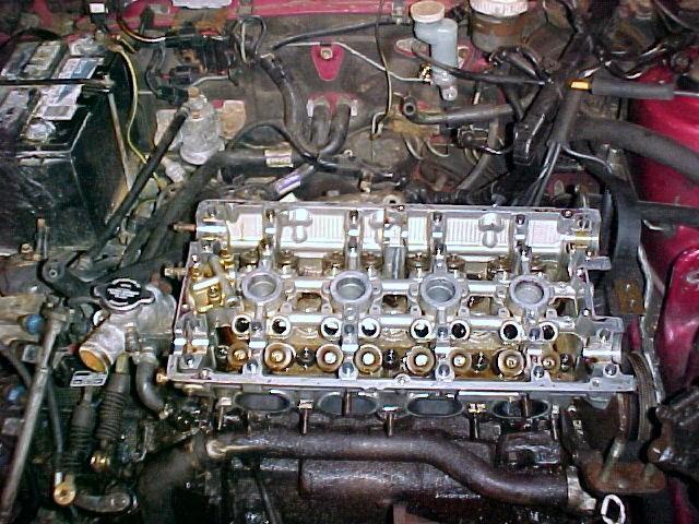

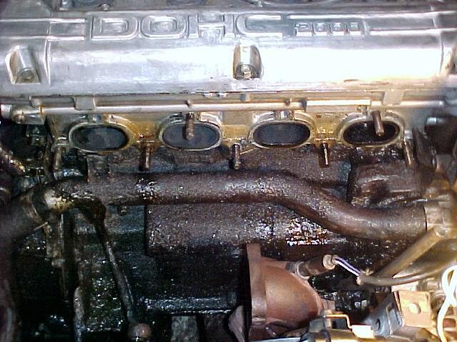

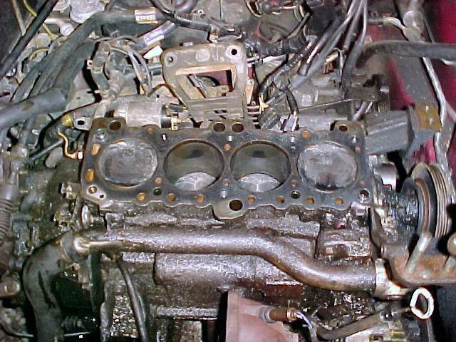

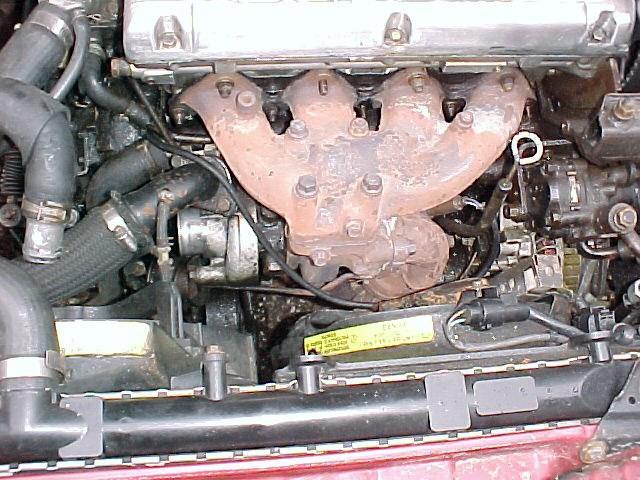

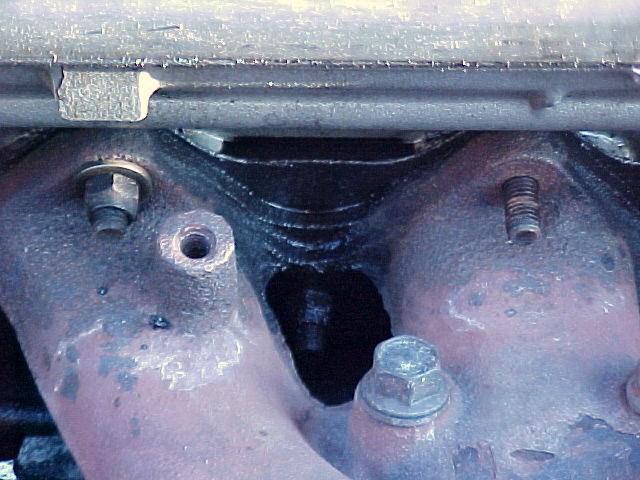

Got board and decided to find out what the hell is going on so I pulled the manifold and turbo off
Cant really see whats going on

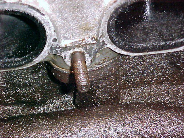

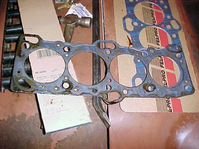

I cleaned it up a bit and im pretty sheer I found the problem I don't know if you can see it but that sheer as hell looks like a cheap ass eBay head gasket I get alot of stuff from eBay but never something so important as a head gasket the exst. manifold gasket is also a eBay gasket so im guessing the intake has one to who the hell would put a eBay head gasket on a turbo car???

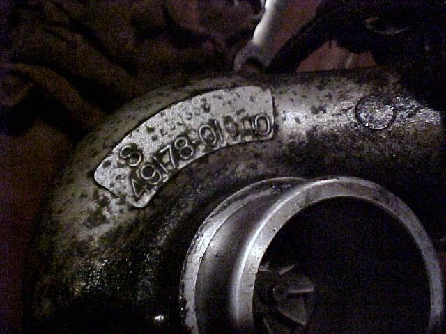

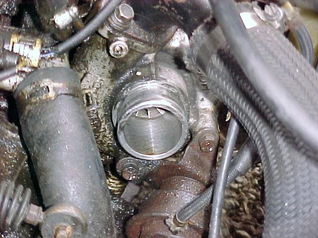

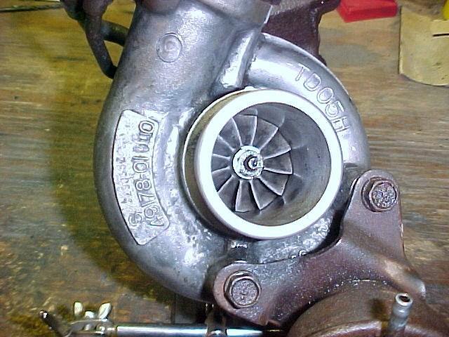

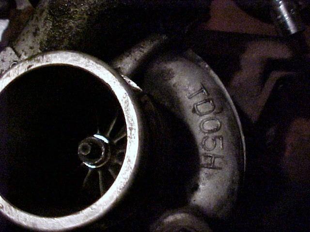

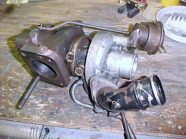

Heres a few shots of the turbo it looks like it was leaking from the dump pipe

Been working on the head all day you guys wont be leave all the BS im finding
Hose for the BOV was not clamped down in the intake
The fuel return line did not have a hose clamp
The vacuum line for the FPR had a big hole in it
Non of the injector plugs have clips
The cam caps were over TQ so the intake cam has some scaring
And my favorite the intake manifold had no bolts on the bottom
Some people should just not be allowed within 10 feet and a screw driver LOL
Also of course I did not know the factory head bolts are 10mm allon heads

Heads off and getting ready to be cleaned up I also ran the new vacuun at this point ### I could get to the harder ones pretty easy
Here you can see were the old one was leaking and I was wrong its a Fel-Pro not an ebay one

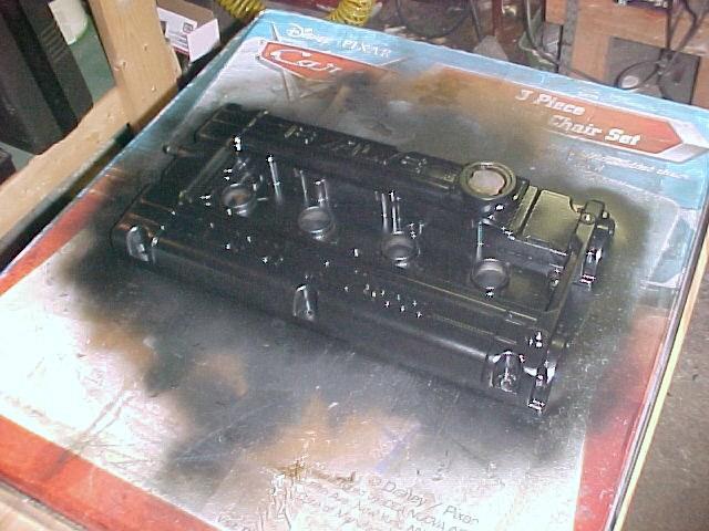

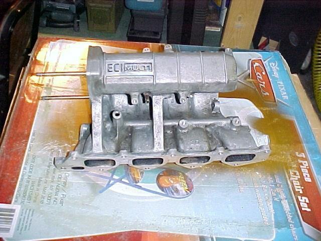

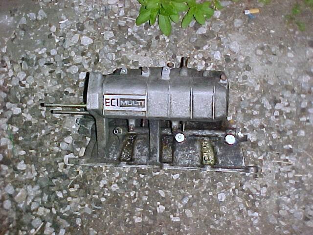

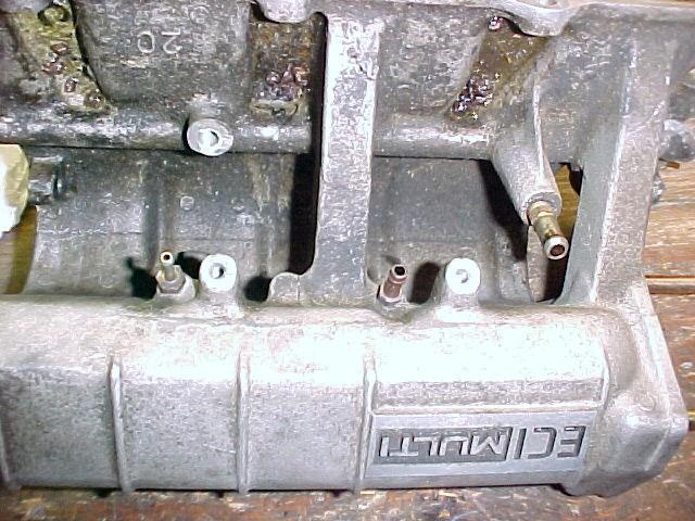

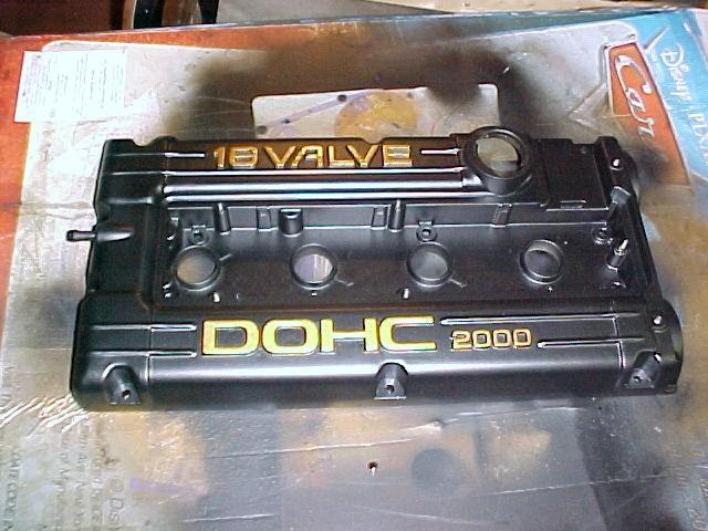

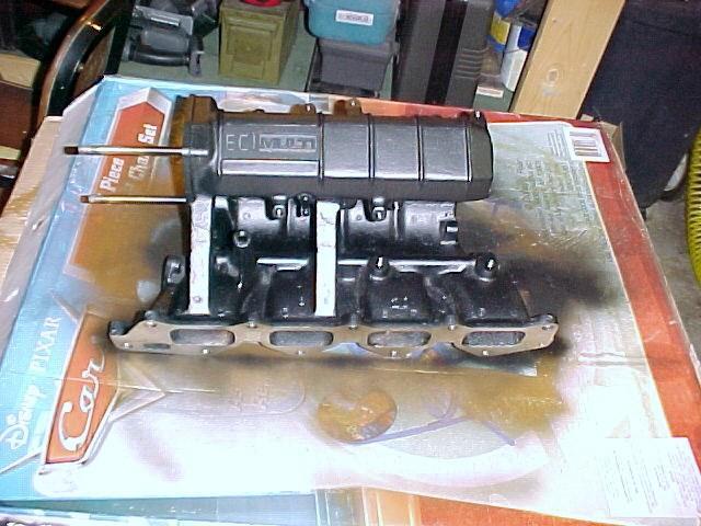

Getting ready to clean and paint the intake
Nice and pretty
Yup this to
Alittle left over gold from the Civic to brake up the black

did you check the valve stem seals inside the head when it was off? mine has bad exhaust stem seals and it leaks out of the exhaust manifold gasket, also it seems to be in the picture you're missing one of the top left exhaust studs?
valve stem seals are ok it was leaking from the head gasket judging from the crapy work the last guy did im guessing the head bolts were not TQ down right im also a bit worried that the head may be a bit warped :pray:
And that stud come out with the nut
Got it all back together last night running pretty much the same but its not leaking from the head any more :thumb: and as a bonus with all the new vacuum lines and every thing put back together right the turbo spools faster :hellyeah:

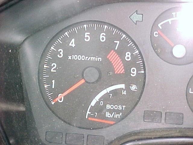

Every things working pretty good and its running pretty good I took it for a drive the other day I think the boost PSI is higher thin it should be but it didn't over boost it just smokes a bit here and there out the tail pipe so I put my compression tester on it and was shocked to see it had really good compression #1=140psi #2=140psi #3=150psi #4=145psi Iv never seen a 20 year old car with this mini miles test so good :thumb: so if its smoking I must have a leaky valve seal or something :hmm: but it doesn't smoke alot so im not worried

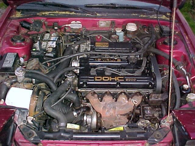

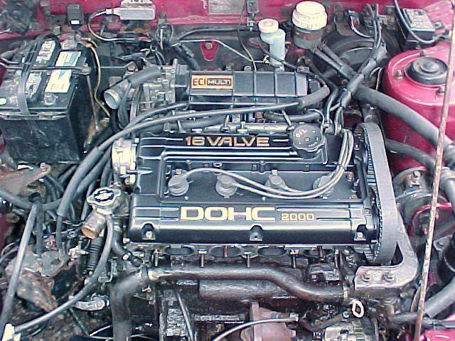

Picked up a timing cover and a spark plug cover a little bit ago I just got done cleaning them and I put the spark plug cover on and it looks so much better with just that one peace of plastic LOL Its raining right now so later this weekend ill see about putting the timing cover on... I also ordered the sensor to get the oil gauge to work

Judging by the oil around your exhaust manifold I would guess you have a bad valve stem seal. I had one as well and had that issue as well as blue smoke at idle, a little at take off but none while driving. Your turbo could the culprit.

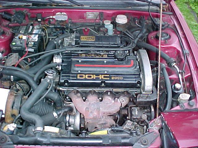

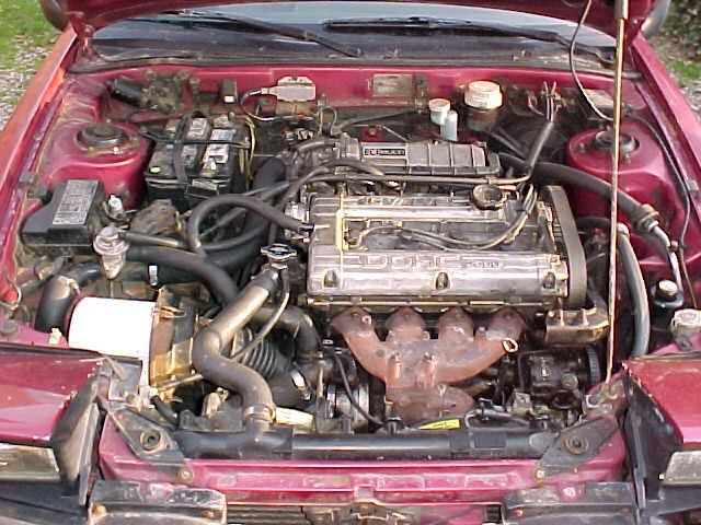

I got board last night and installed the timing cover its almost back to factory spec LOL

It is one of the two, oil or coolant but it really sounds like a valve stem seal. The oil around the exhaust manifold ports is a give away.

The oil on the manifolds is from the head gasket it was leaking when it was hot and oil bubbled out I put a new head gasket on and it has not did it sins
