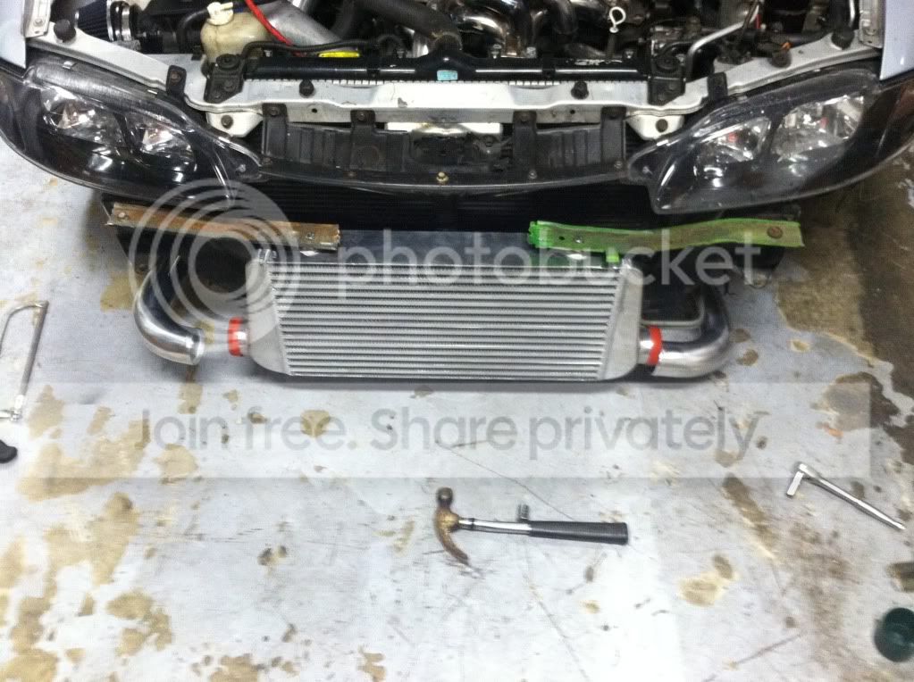

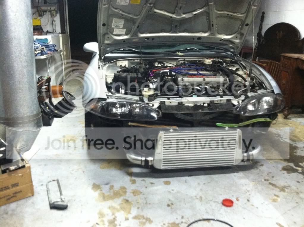

Next came the PR FMIC.
now before you say something about the mounts, the kit i got didn't come with mounting bar and these were the first stage and they ended up looking pretty good wish i would have snapped a pic of the after but forgot.

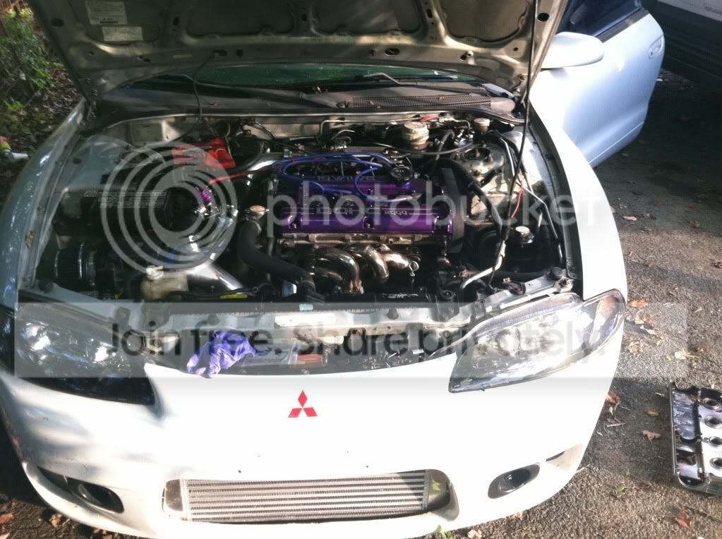

Next i really hate to run with no bumper, so i went ahead and finished the 2gb front end.

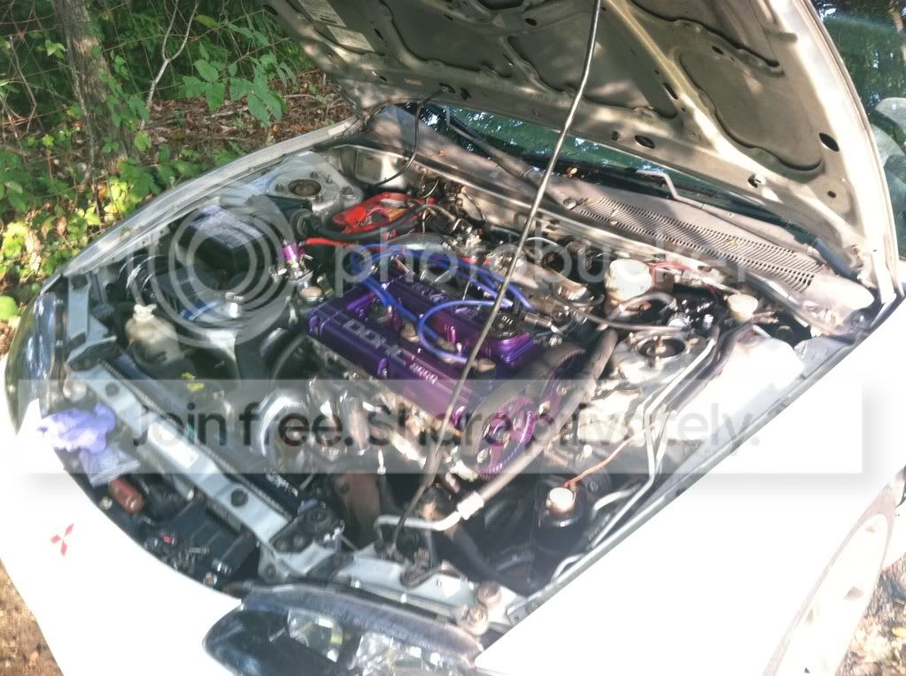

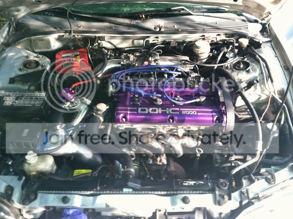

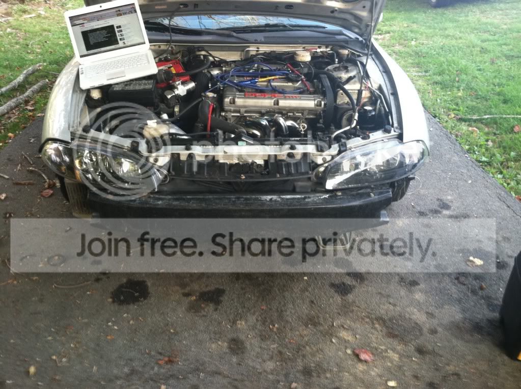

Then i did some easy stuff like painting up the valve cover "HKS" purple and cleared it and threw it on with some ss bolts.
That's how it sets as of right now hopefully i should have an update soon when i get link so i can put in my evo injectors.
