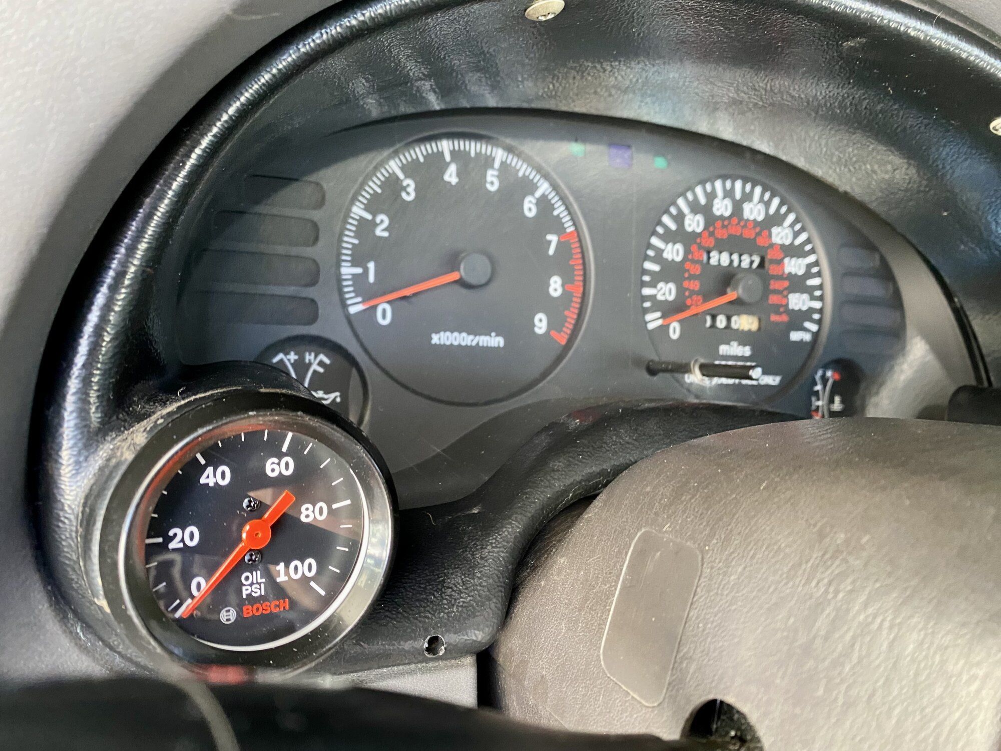

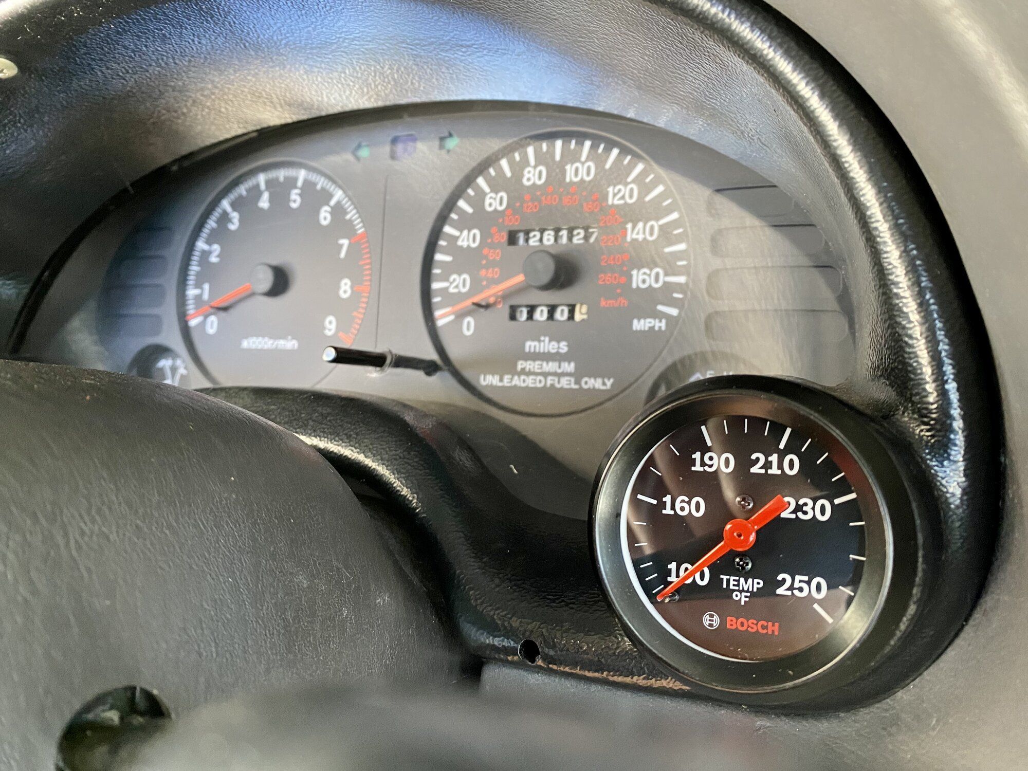

I like those gauges. Looks factory if not for the Bosch on them.

I really wanted to figure out a way to take apart the gauges to paint the center of the needles black and take off the Bosch lettering but said to myself “let me not screw these up somehow” LOL

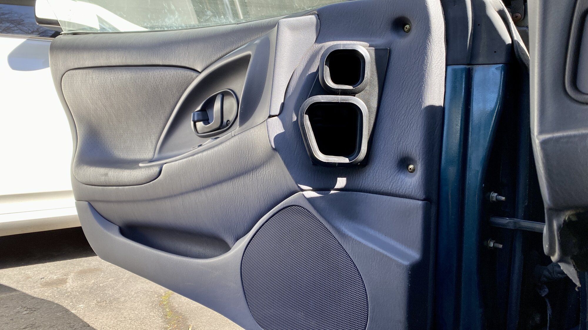

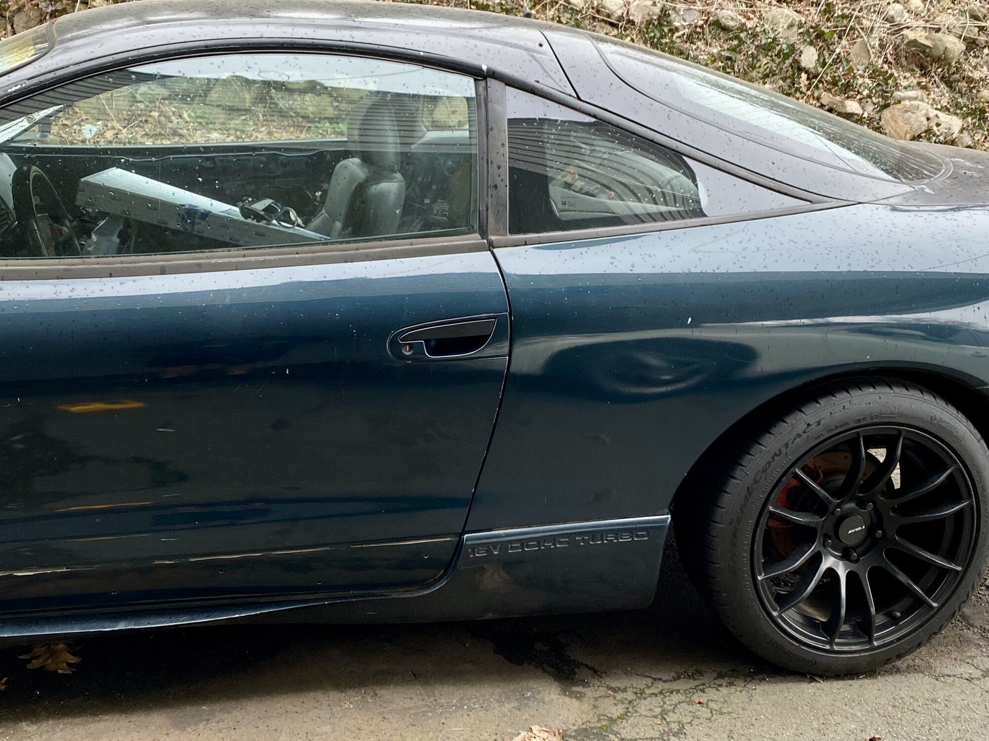

Thoroughly impressed with the aluminum handles. Fit and finish are spot on. The anodized black goes perfectly with the rest of the car. Don’t mind the missing door cap I’m waiting on replacement clips.
I was finally able to remove a wing nut and bolt someone put to make the door “easier” to open because the OEM handle was falling apart. It was really stuck in there I had to spray some PB Blaster and hit it with my torch too. That thing prevented me from using aftermarket handles because the door latch wouldn’t close completely but it worked out because I didn’t really like the fit and finish of them anyway.
Really wanted to put the vapor shields on the doors but can’t find the plastic I bought so on went the refreshed panels.

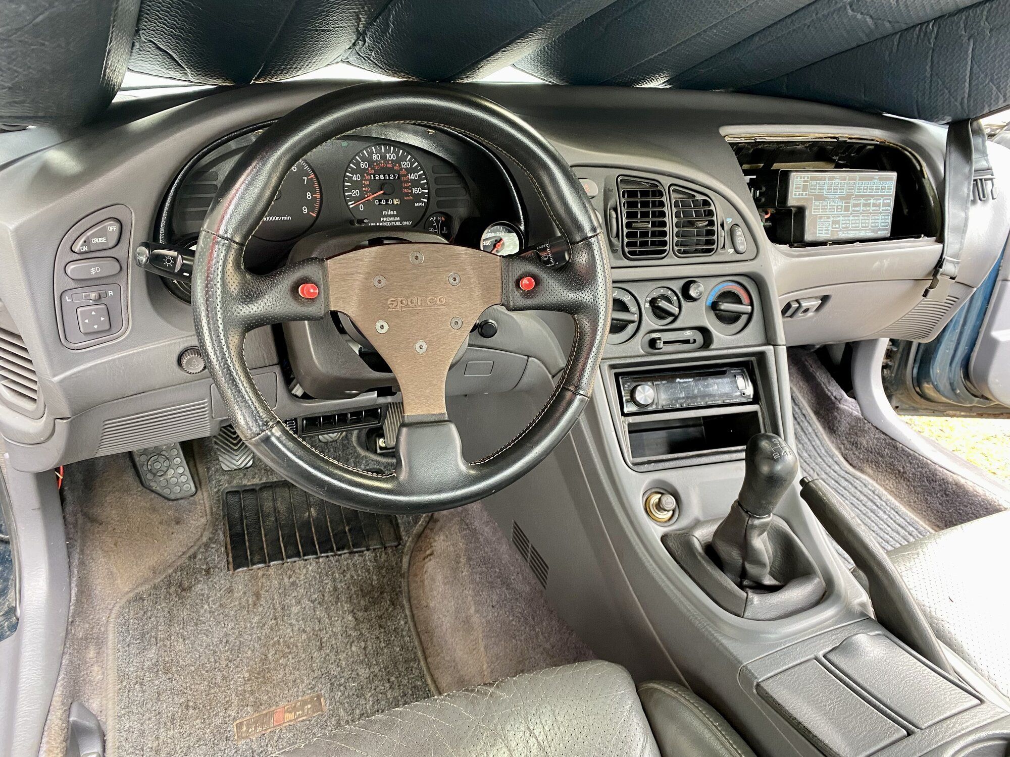

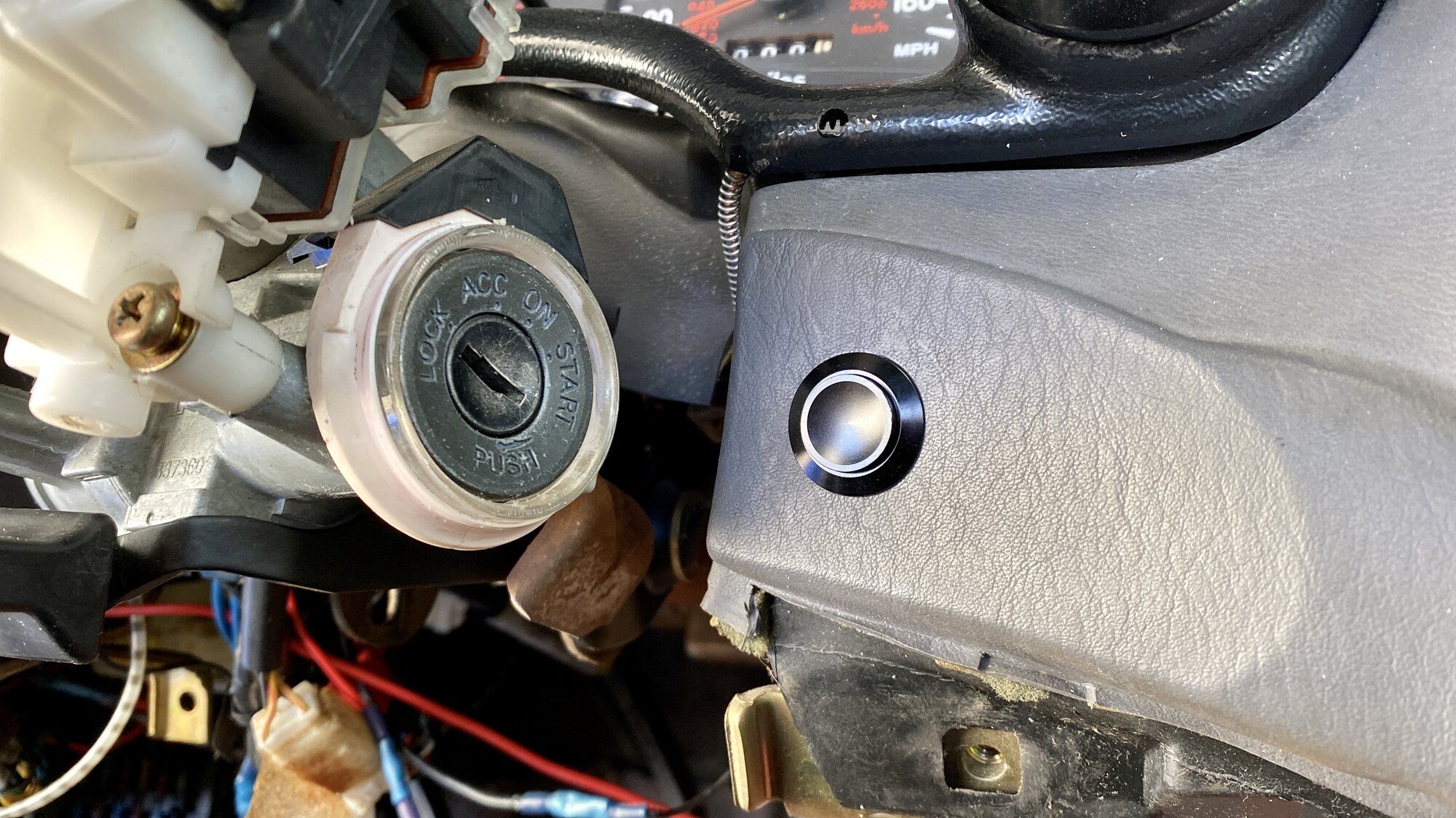

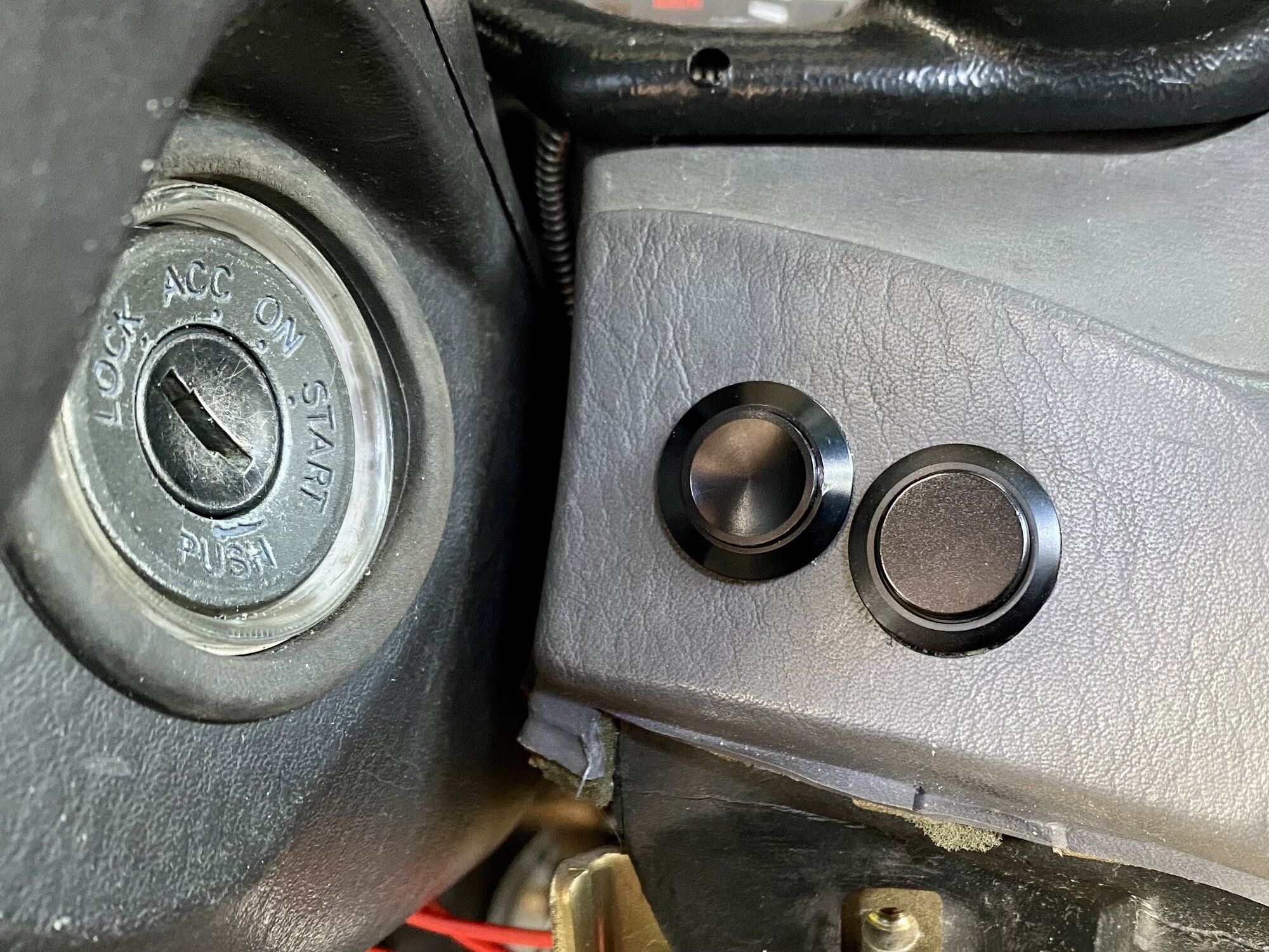

Also got rid of the toggle switch that was there to start the car. Installed a nice little momentary push button instead. I have one more to install that’ll go next to it for the fans.

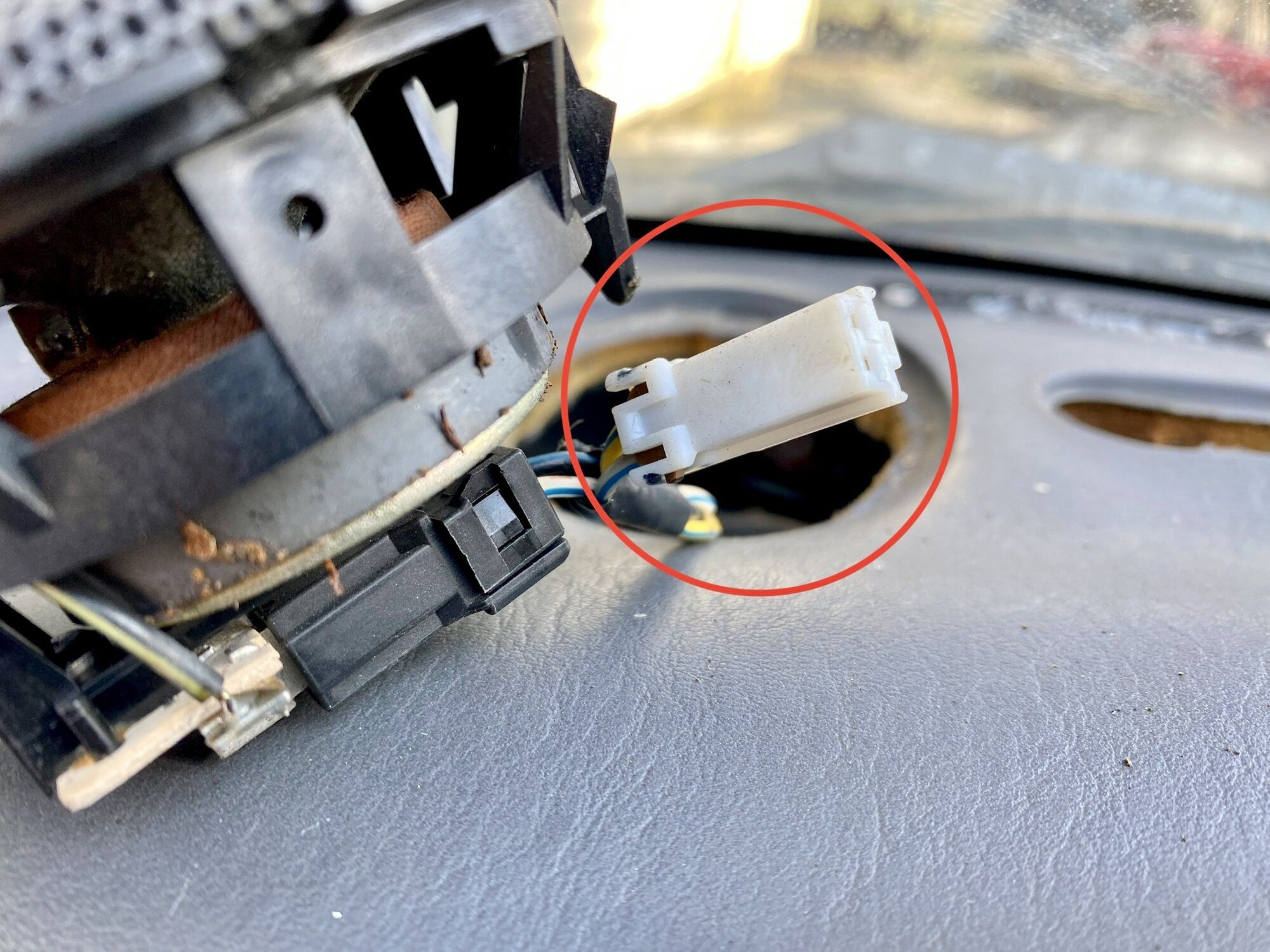

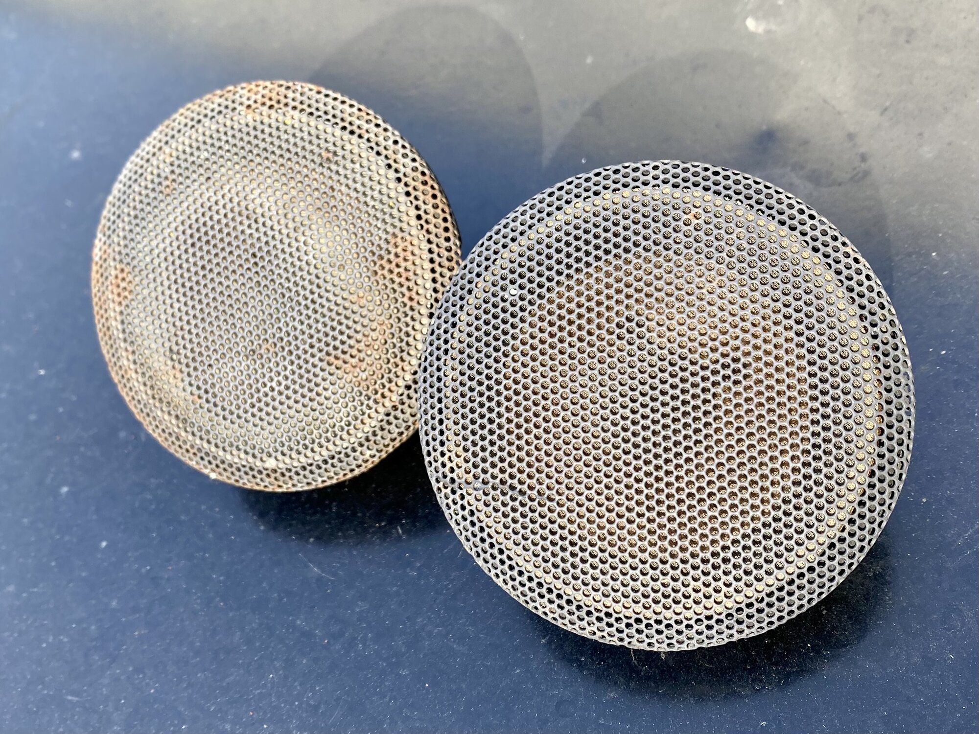

Installed the locking push button for the fans and swapped in some better condition dash speakers (old left new right) to get rid of the rusted ones. Anyone know what these little white pigtails are?
Finally starting to look complete in here. Just installed the center side panels. Still missing the kick panels I have but can’t find LOL

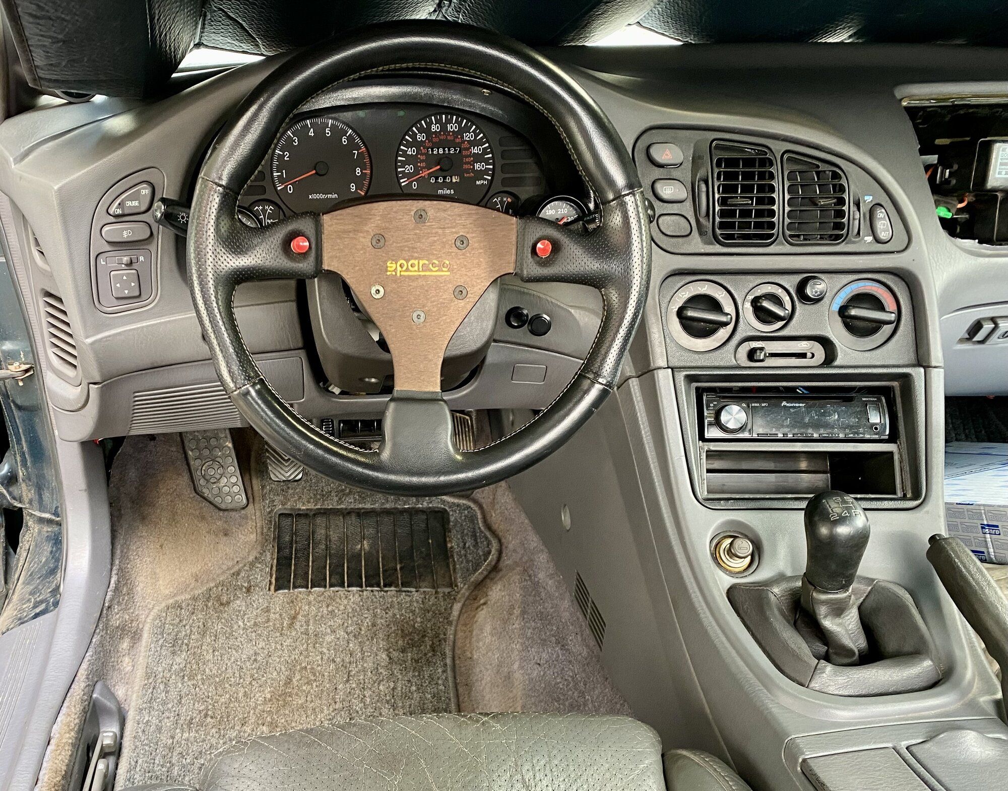

On the steering wheel I think I’m going to do the lettering in red the chipping yellow is throwing it off.

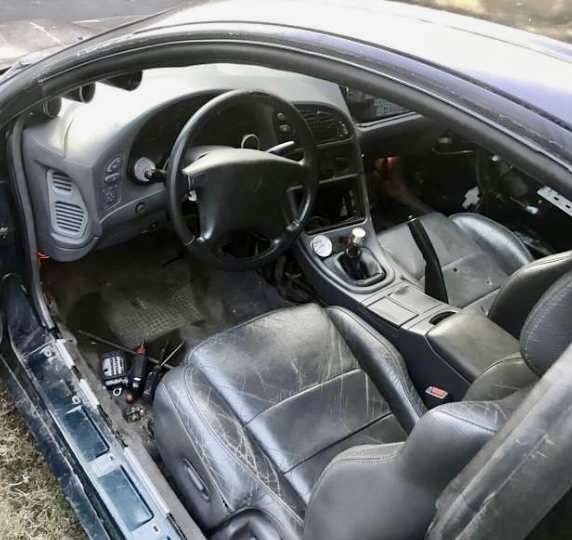

I only have one picture from the fb ad and it’s terrible quality but if you look closely you can see what a hot mess it was in there.

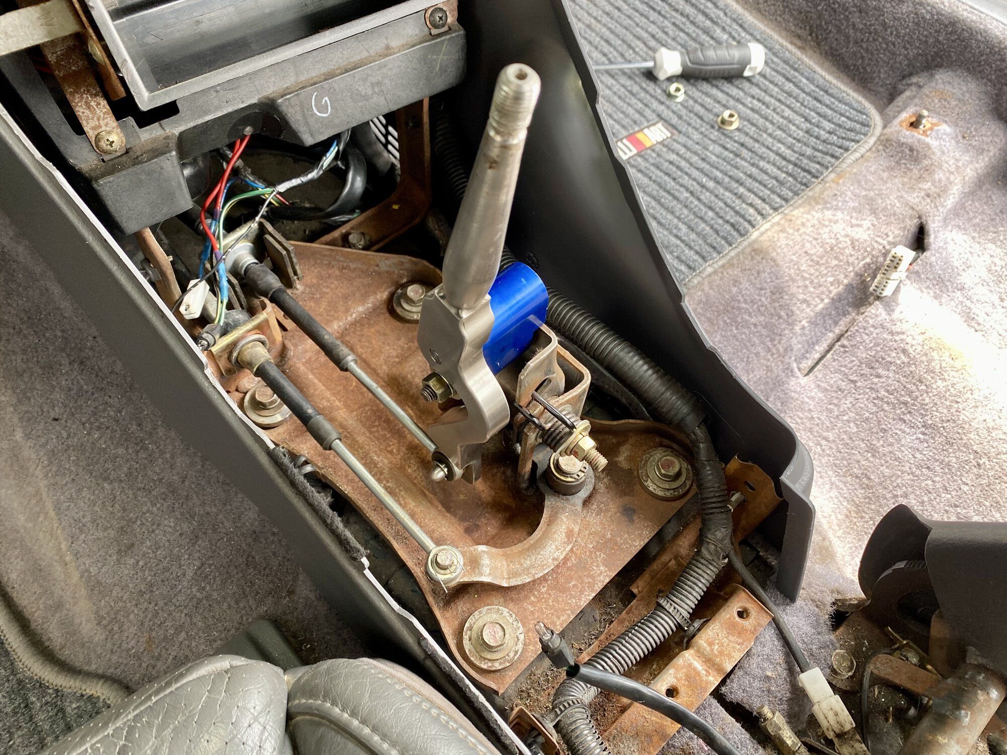

Installed a B&M shifter and solid shifter base bushings. Also used a pick to remove the yellow paint from the steering wheel. Figured that looked better until I decide to paint it.
Still have to figure out how to mount the airbag cover. I tried command strips and that was a no go. Gonna have to get creative.
Have you thought about changing out the allen screws in the steering wheel also? Might look good matching the color of the lettering or another color to tie it into other parts of the car
Does your car have the ignition switch disabled? I am looking at a car that the owner can't find the key to and am trying to figure out how to just move it to get it on a trailer.
Thanks for any insight!
Not something I considered! Not a bad idea. I’ll see if I can find some examples online to see if I like how it looks.
My ignition switch isn’t disabled. I still use the key and the push button is only for the starter.
You should be able to remove the switch from the back of the cylinder and use a flathead screwdriver to start it.
That's what I was needing to have some reassurance on! Can I drop the bottom of the column and get to the switch....it's a 1g auto car? The "no keys" thing is about all that is holding me up from the purchase (and a few trees that have grown up where this car has been hiding for at least 10 years, in a hedgerow in a field). I could put it in neutral from the engine bay (after I remove all of the pack rats nest) but I need to turn the steering wheel.
I have no experience with 1G cars unfortunately. This is the only DSM I’ve ever played with.
You should be able to just remove the column trim, drop it down and remove the screws with a small screwdriver. You may have to remove the lower dash panel also.

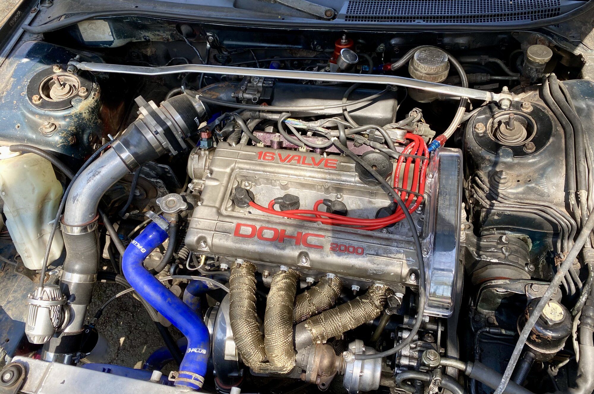

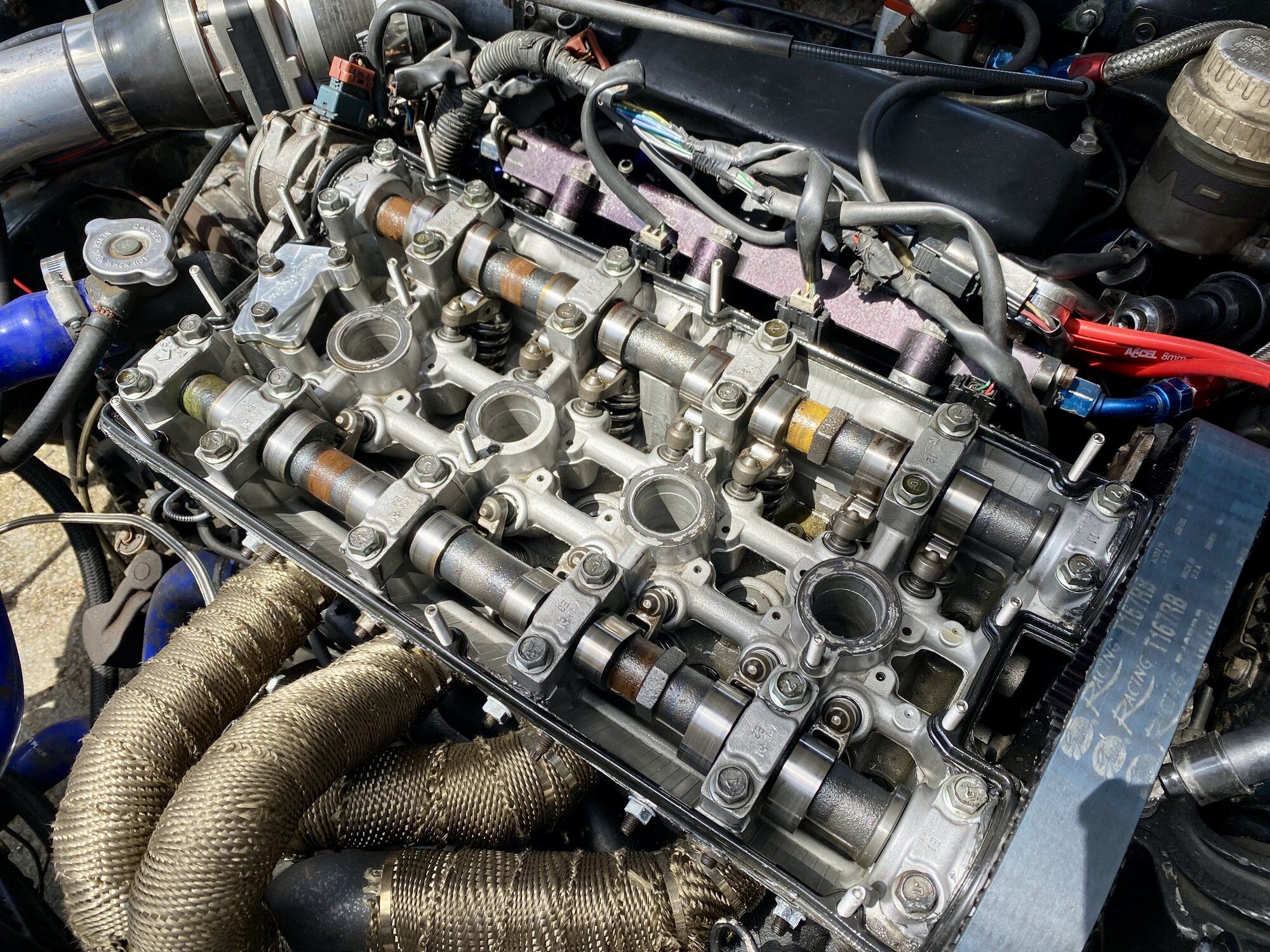

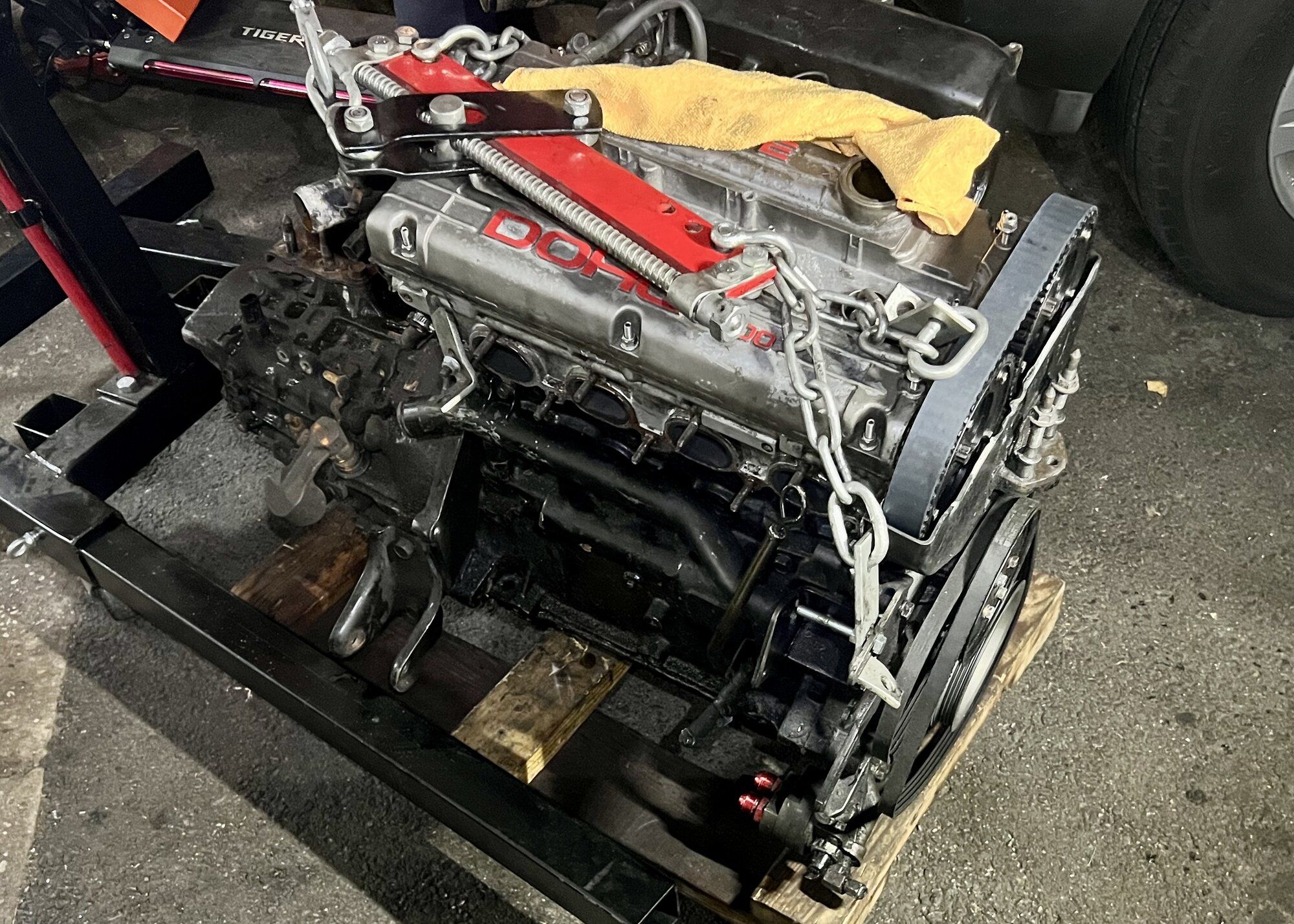

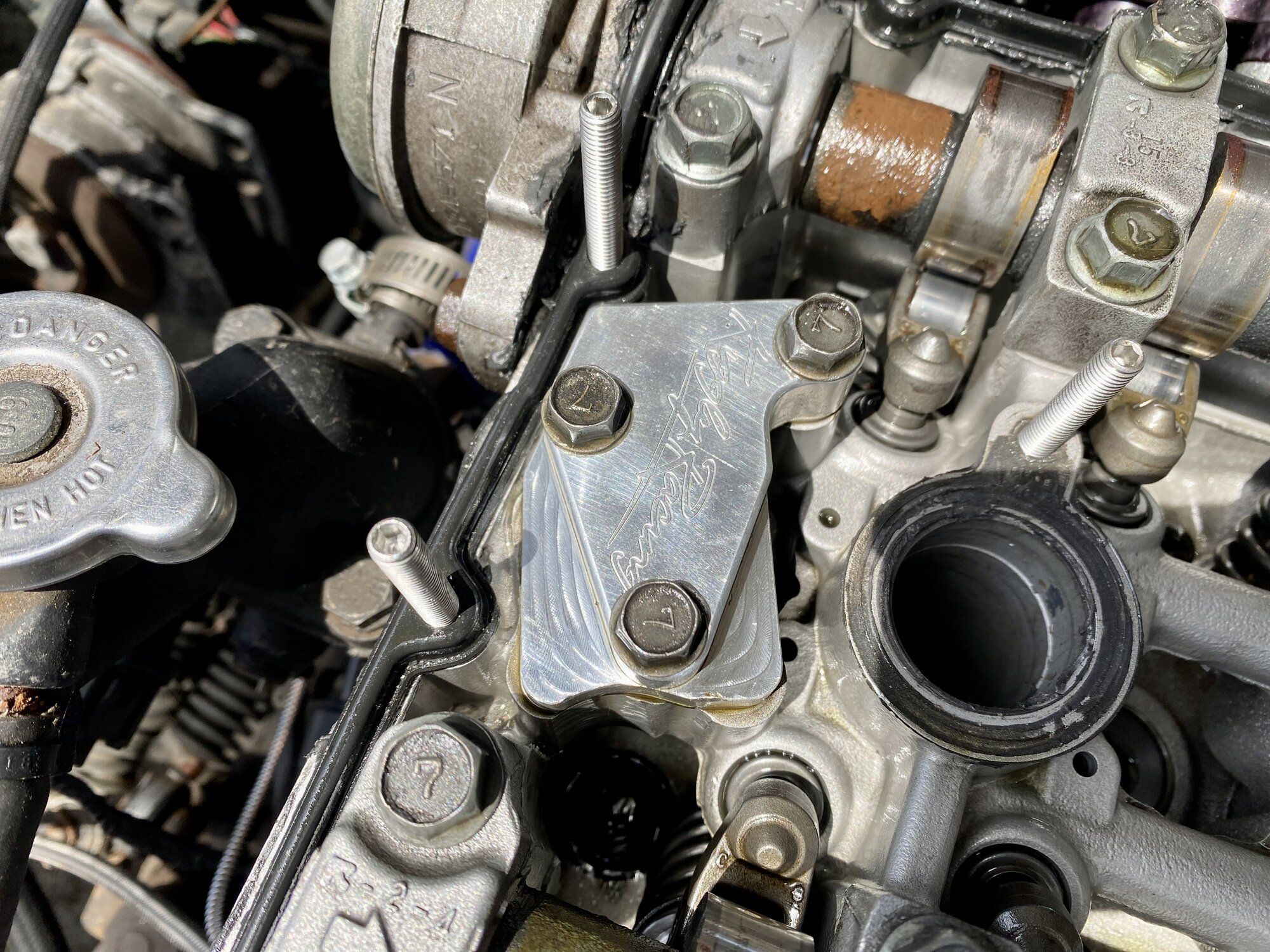

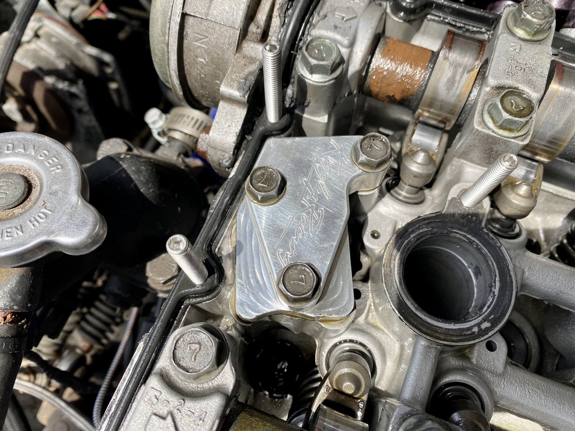

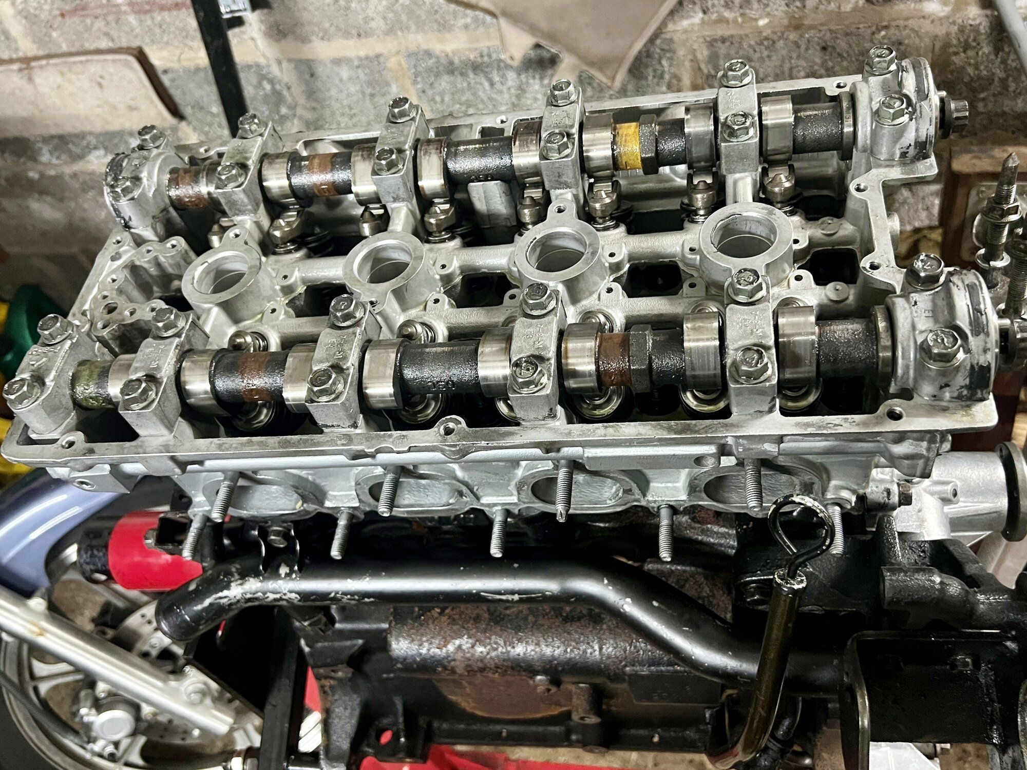

Decided to install longer studs for the valve cover. They were a little on the short side and now they’re a little on the long side LOL While I was in there I threw on the Kiggly HLA

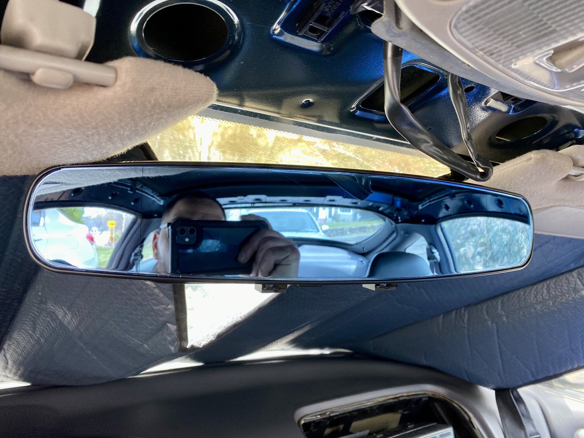

Also installed an aspheric clip on mirror. It’s 13” long and tinted blue to help with glare. Last time I was working inside the car I noticed how terrible the rear view was

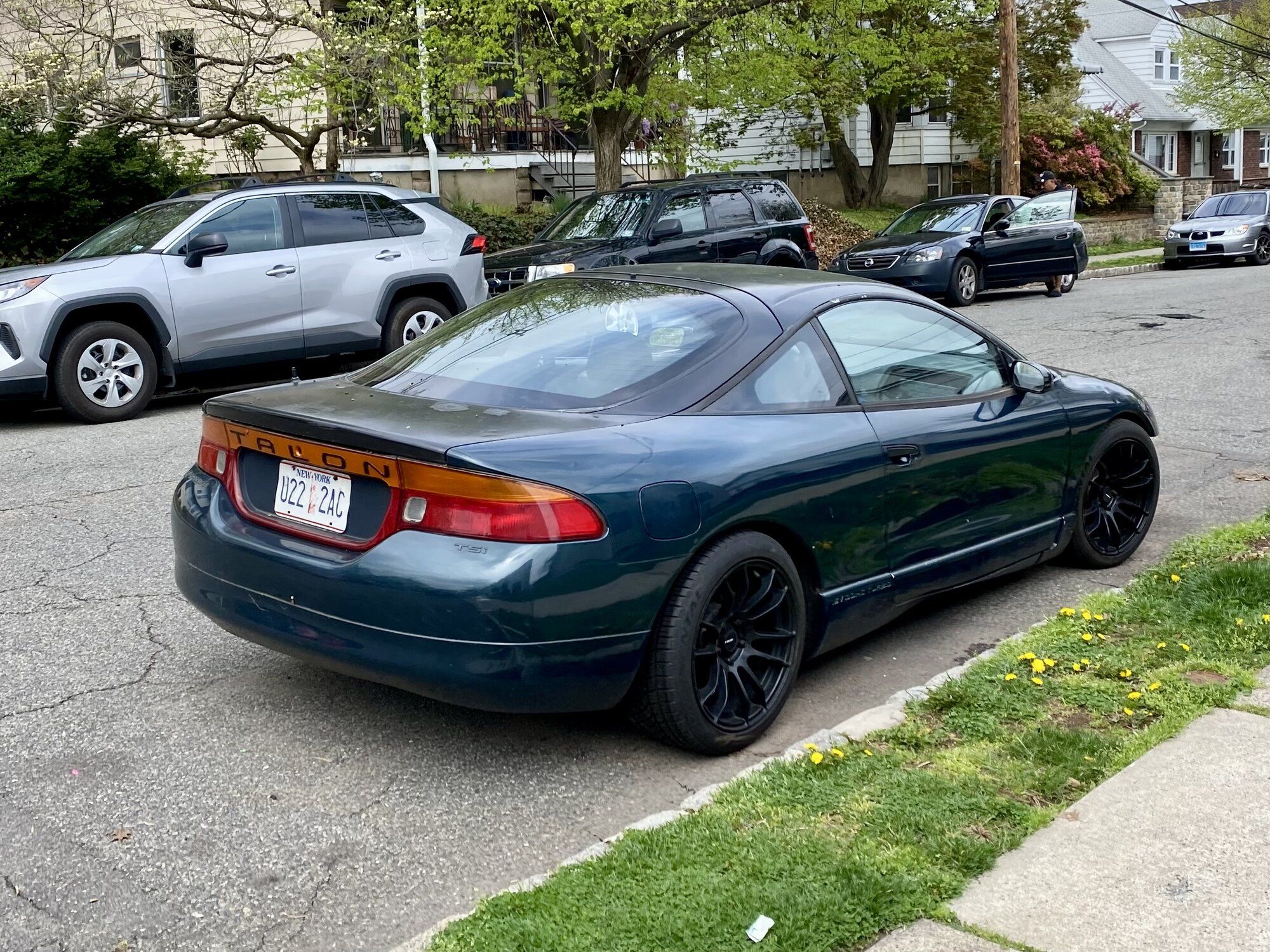

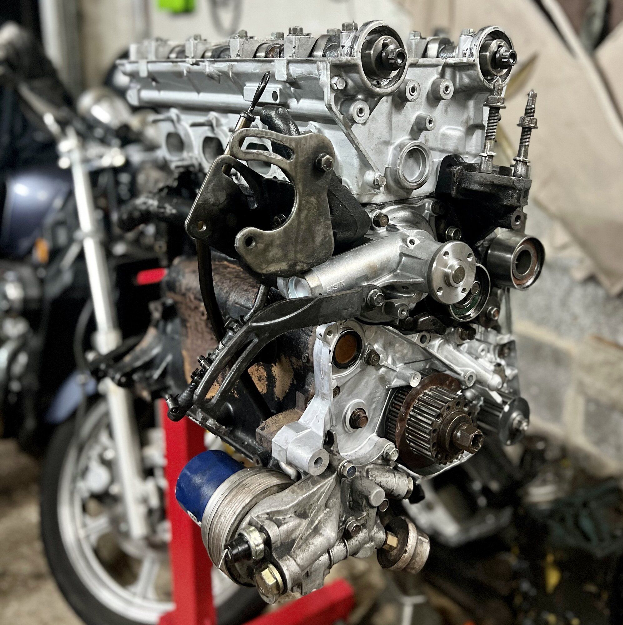

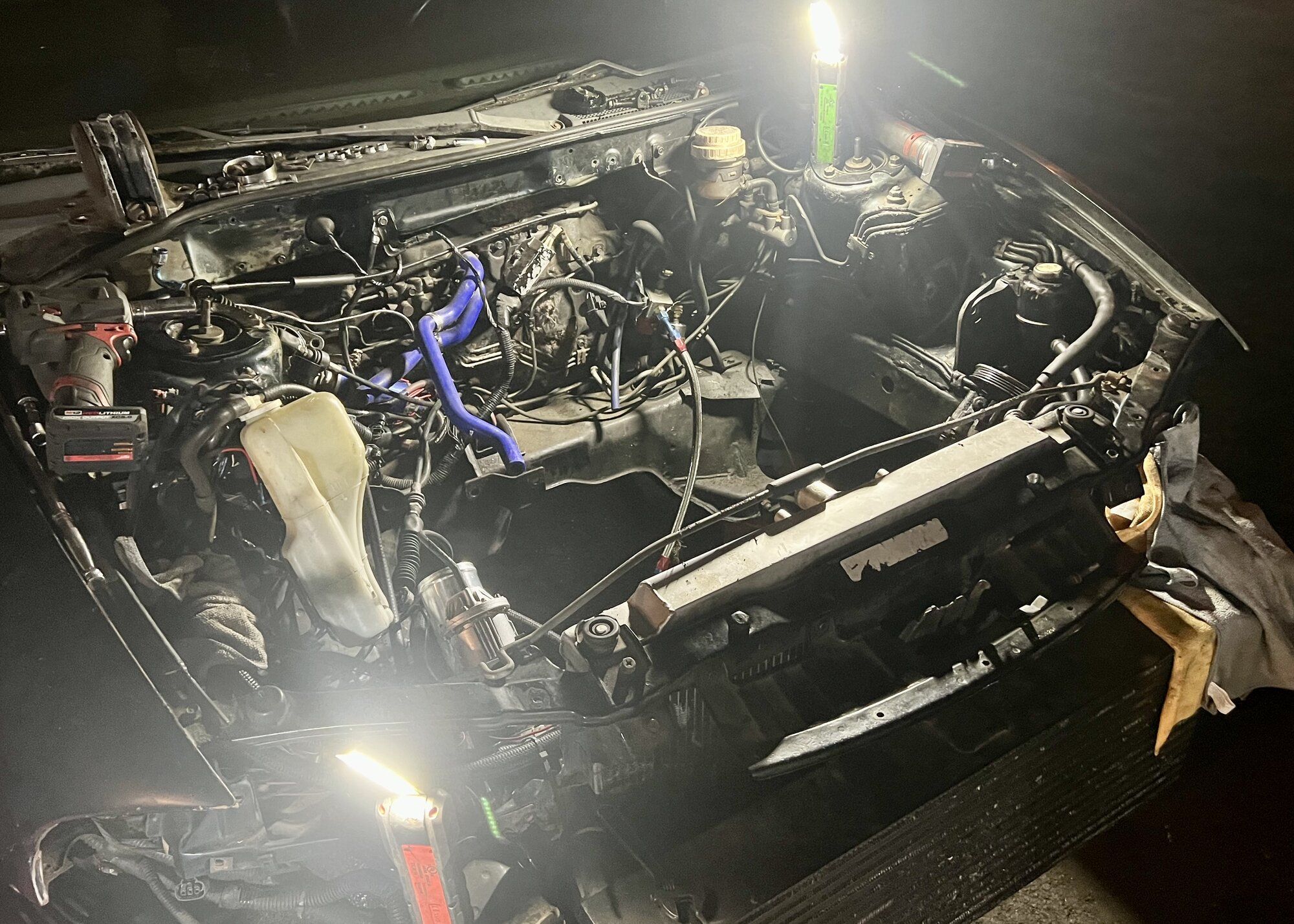

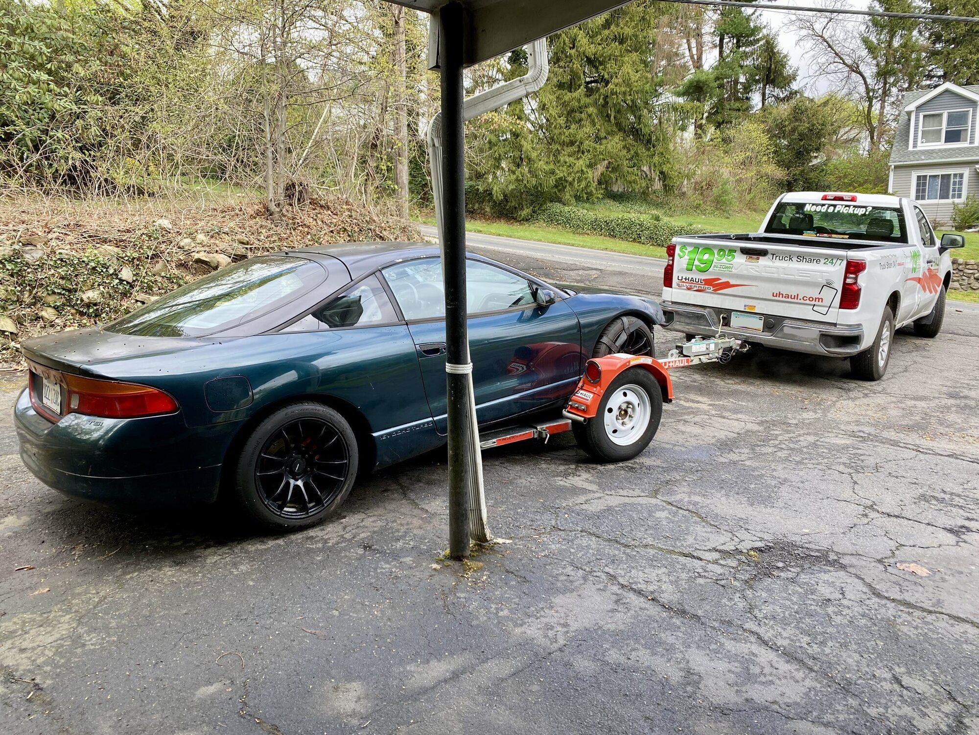

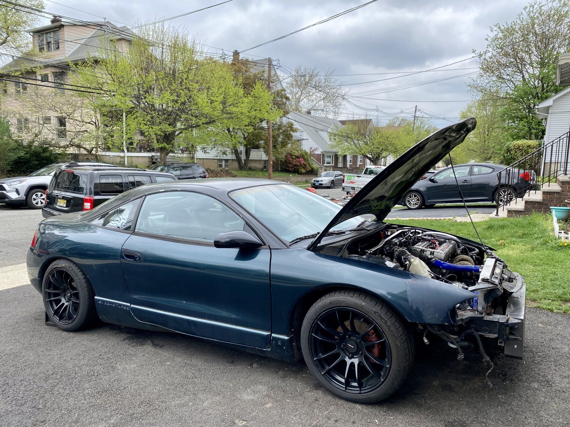

Towed the car to a friend who is going to help me swap the short block along with that entire laundry list of stuff I had in another post.
Was good to see it on the road for once LOL Trying to find a fender for it since the clear is shot
