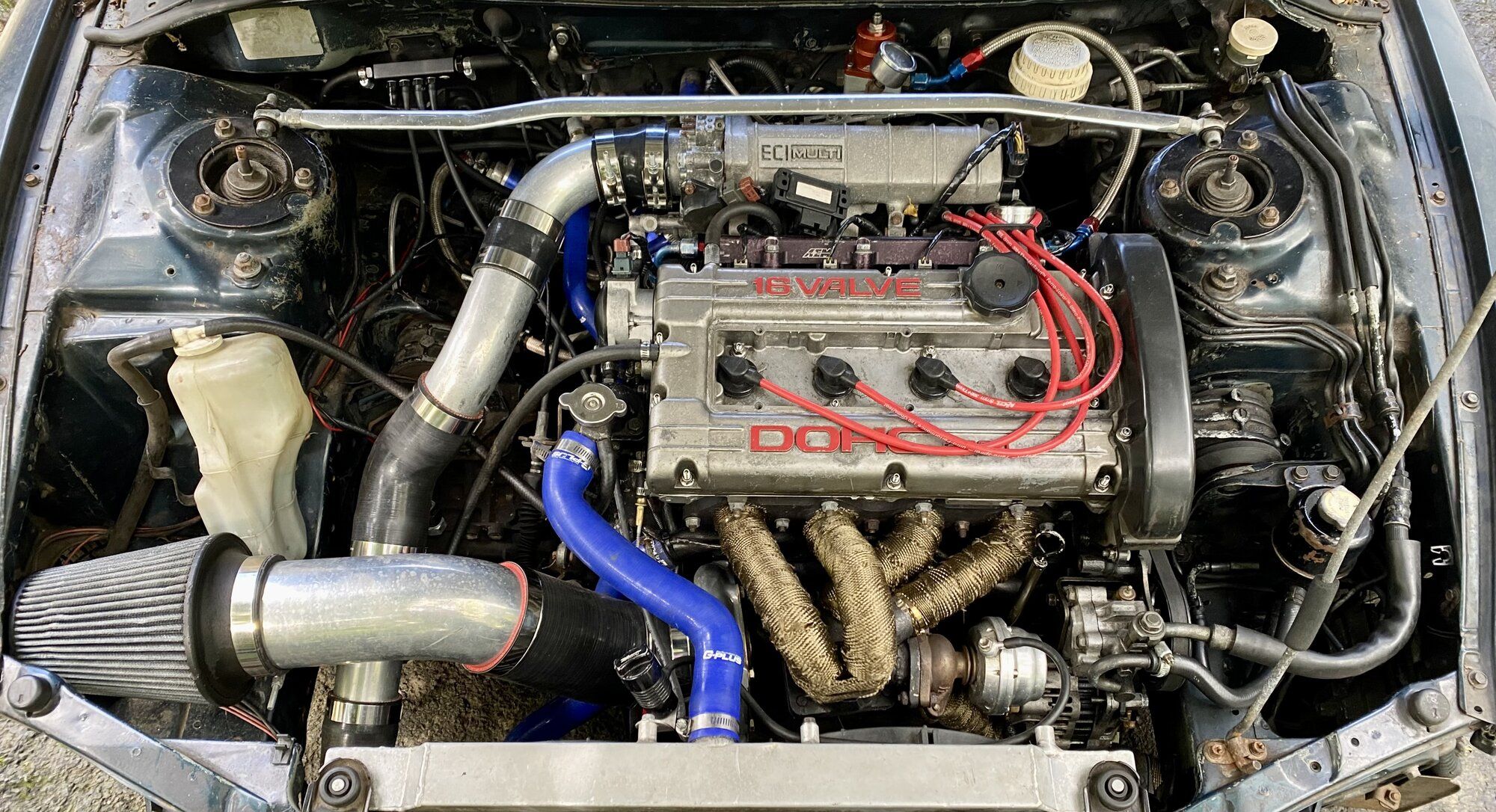

New OFH kept me from mounting the bumper exit due to the oil cooler and the large 1G filter. I got rid of the oil filter relocation kit it was leaking and unnecessary.
Ended up getting a FF OFH which gave me the clearance I needed. It’s tight still but it’ll do. I intend on making some sort of cheap oil filter heat shield and am going to add a tee so I can run the oil feed line, OEM pressure sensor (just got a new one the old one was leaking) and my Bosch oil pressure gauge.

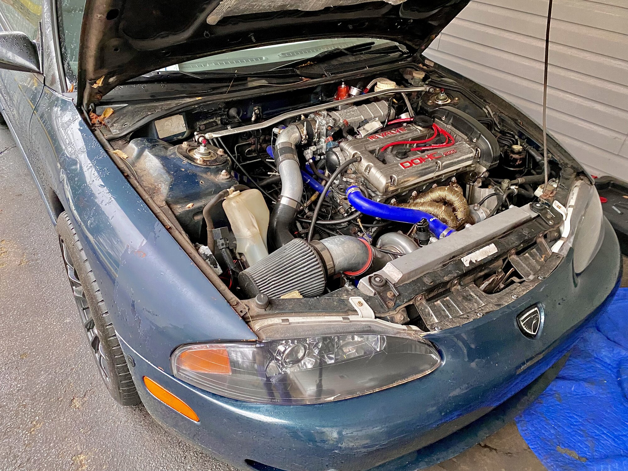

Big turbo problems. Where do the Air/Oil cooler lines go on that OFH?
What about that almost kink in the upper coolant hose from the water neck? Can you trim one end 1/2" to 1" to straighten that out some?
I thought the turbo was a 5858 but apparently it’s a Garret T04E. Is that still considered big? Seems small compared to my BW S366.
I’ll have to take a closer look at the upper coolant hose. Always thought it was just how the silicone hose is molded and not actually a kink. I can definitely trim the hose and stretch it out a bit to make that bend smoother. I may install a 180° thermostat switch kit for the fans so will likely tackle both at the same time.
You got any oil cooling planned? Your roasting that poor filter
To me, anything outside the stock Mitsubishi form factor is “big” turbo 🤪

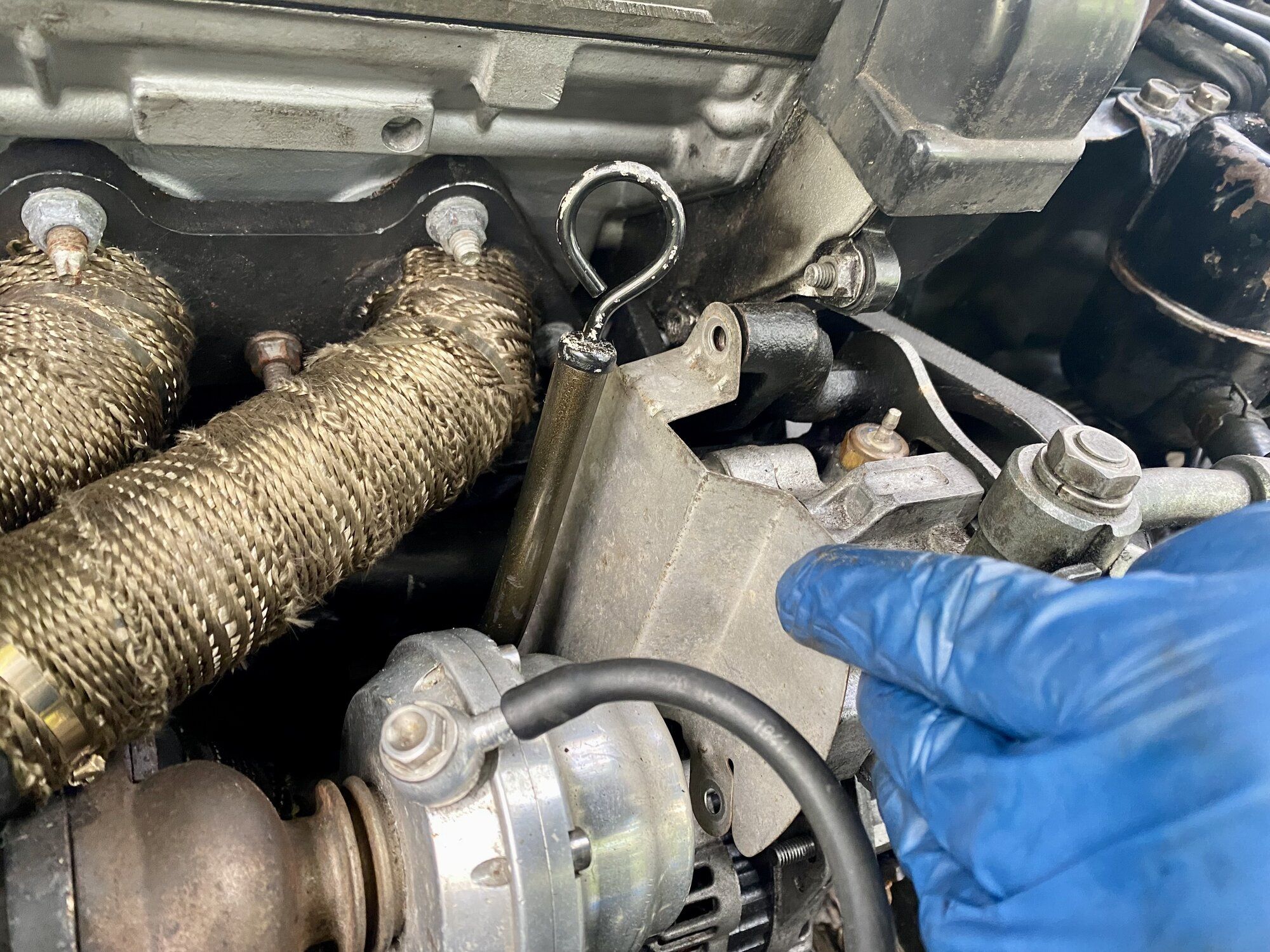

I’m not sure how I can cool the oil which is why I plan on making heat shields for everything in that area (oil filter, alternator and power steering pump). I’ll put a layer of DEI reflect a gold on the outside and maybe some fiberglass on the inside. Maybe throw the tape on the lower charge pipe and on the block too.
I have a thermal zero turbo blanket on the way also. Used this brand on my other car that had a HX40 and it worked really well.

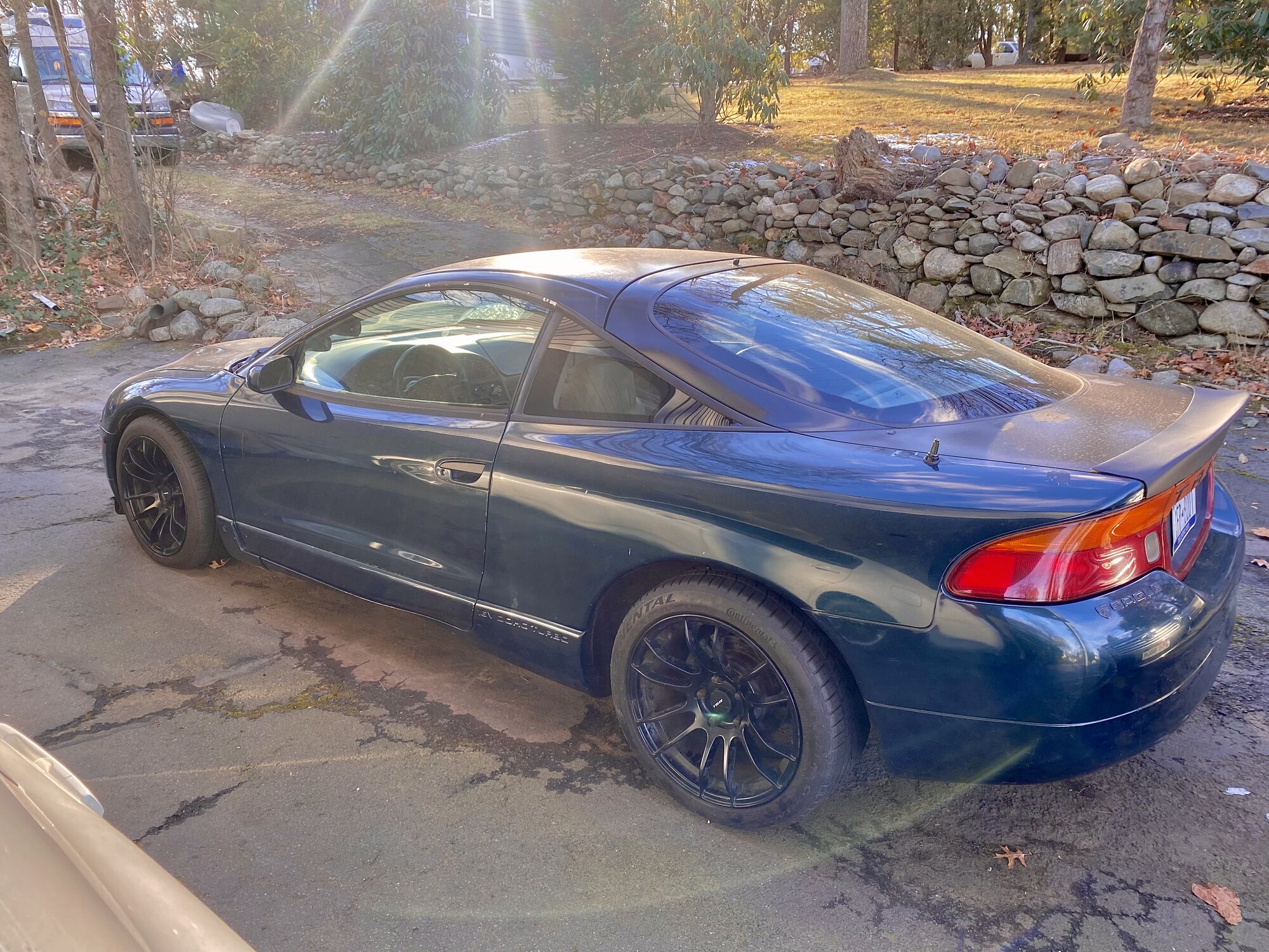

My car is FWD. The title says the same but it’s been through many hands so who knows if it was ever AWD. Pretty sure it’s got burnt rubber on the back bumper arches LOL
Took the car for its first drive!! The welded diff is annoying but man, it felt good to finally get it out on the road. Only drove it up the block to get gas and check for leaks.

I’m trying to address some of the heat issues that will arise once I start driving the car more.

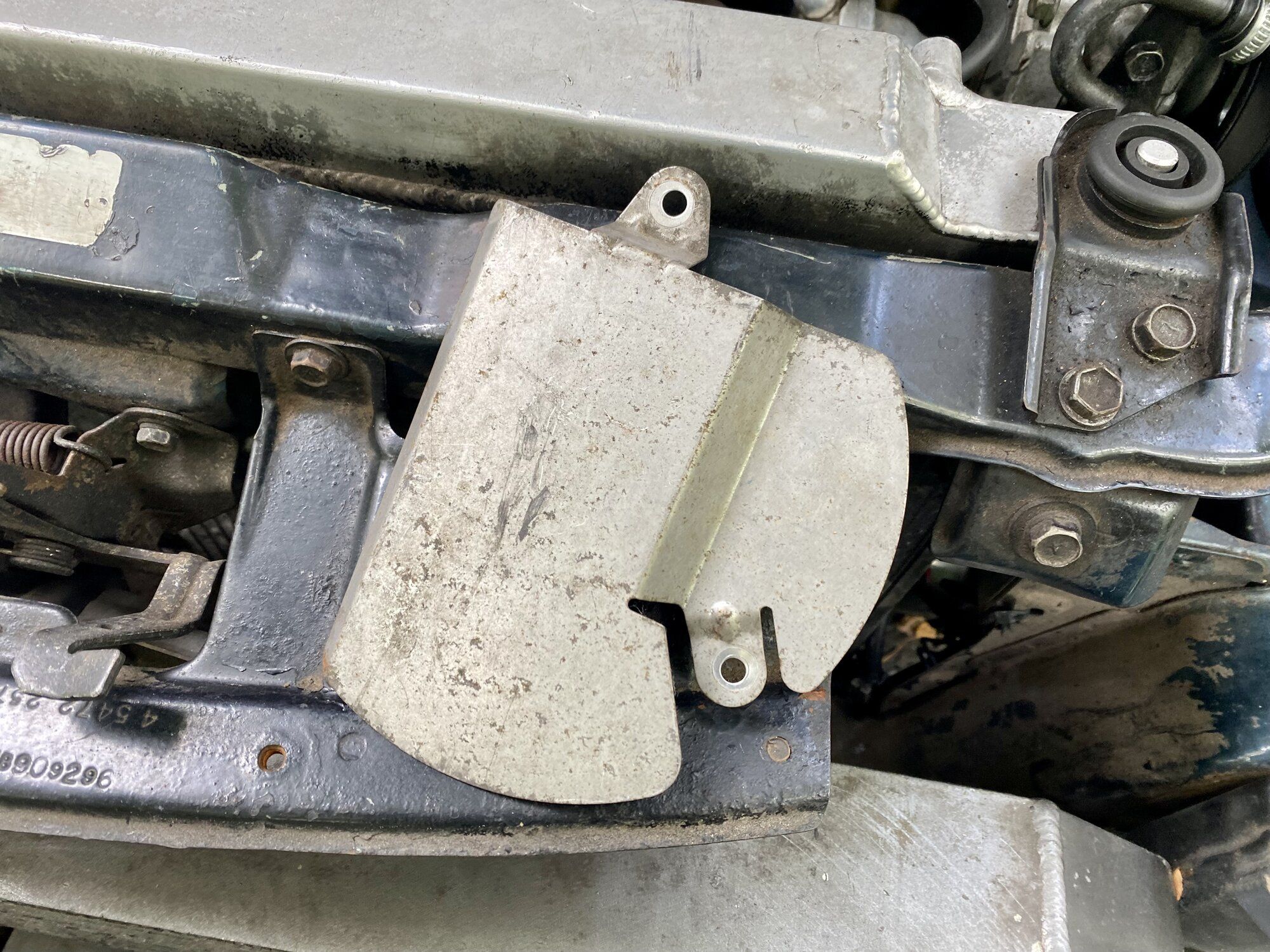

I have these radiator fan heat shields off an old Nissan. Mocked one up to block the power steering pump. Hopefully I can figure out how to get the other one to block the alternator.

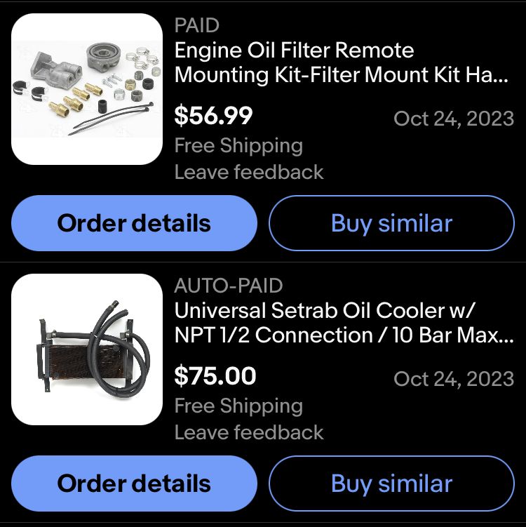

Also ordered an oil filter relocation kit and an oil cooler.

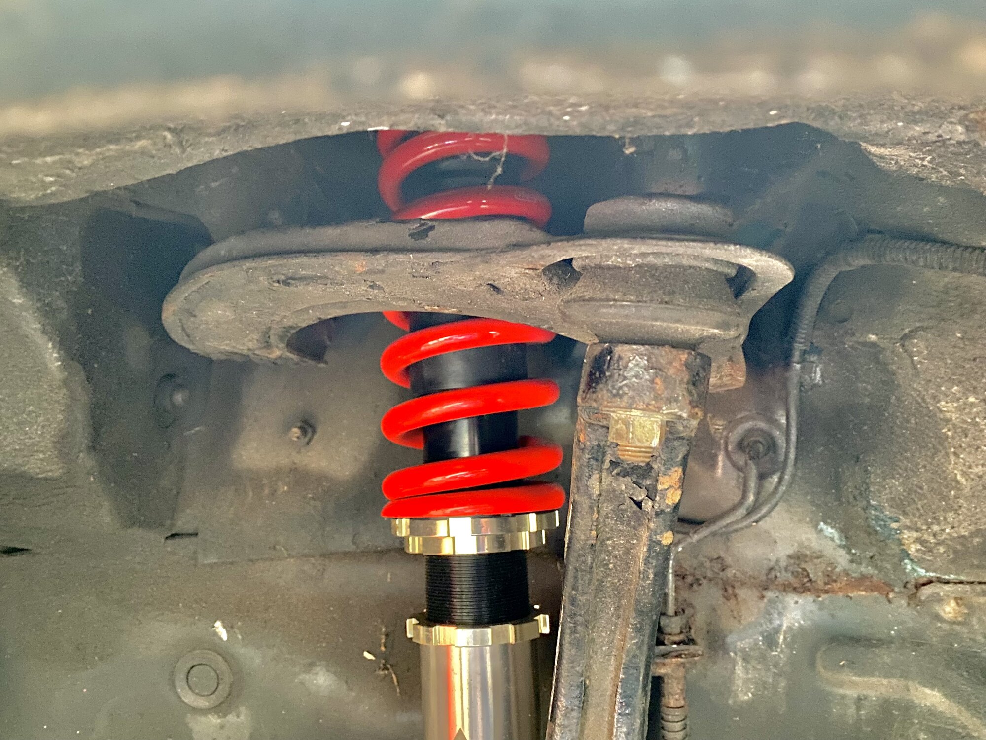

It’s been a long time since I’ve updated this thread. I’ve made a few small changes to the car that needed to be done.

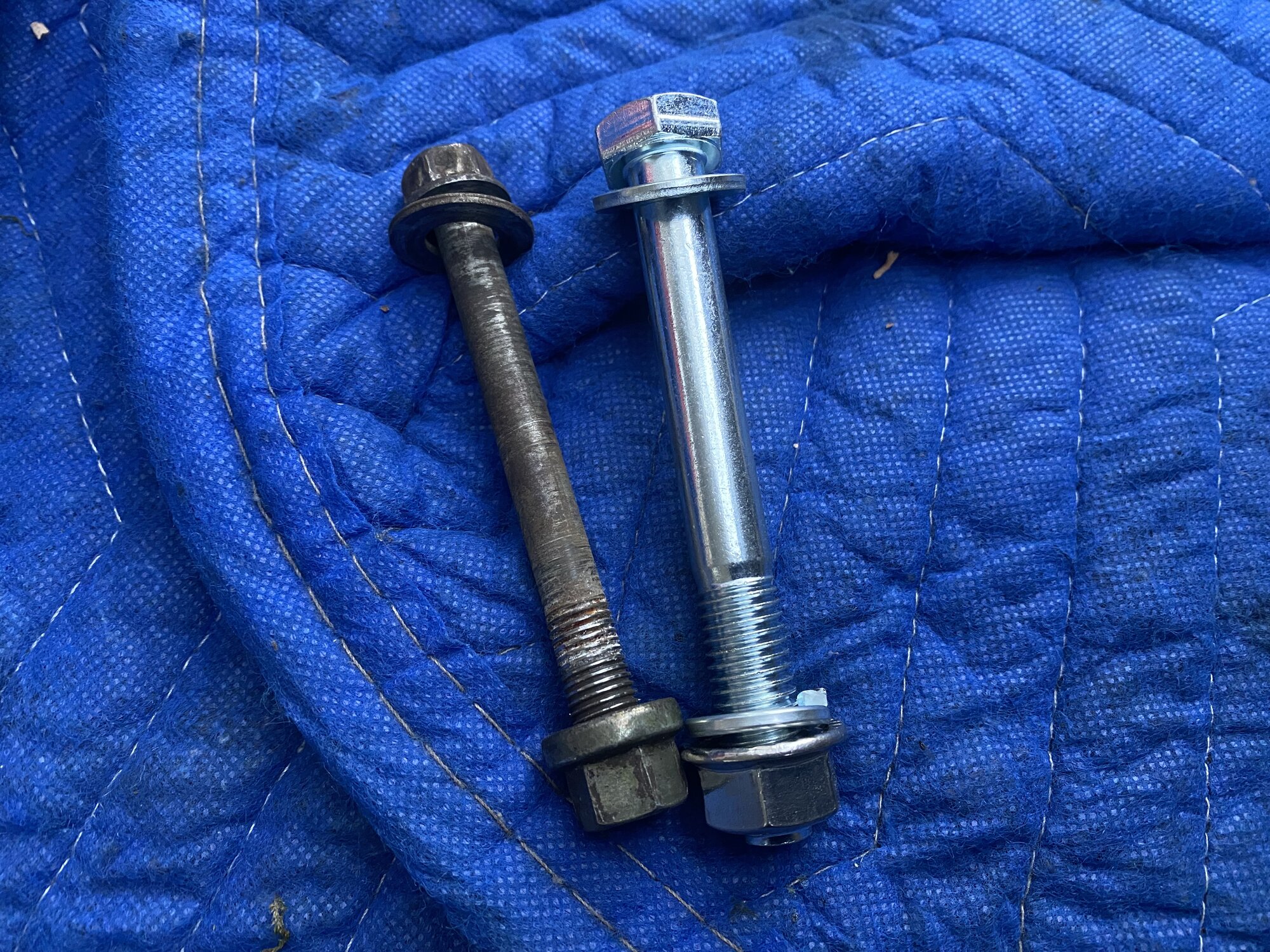

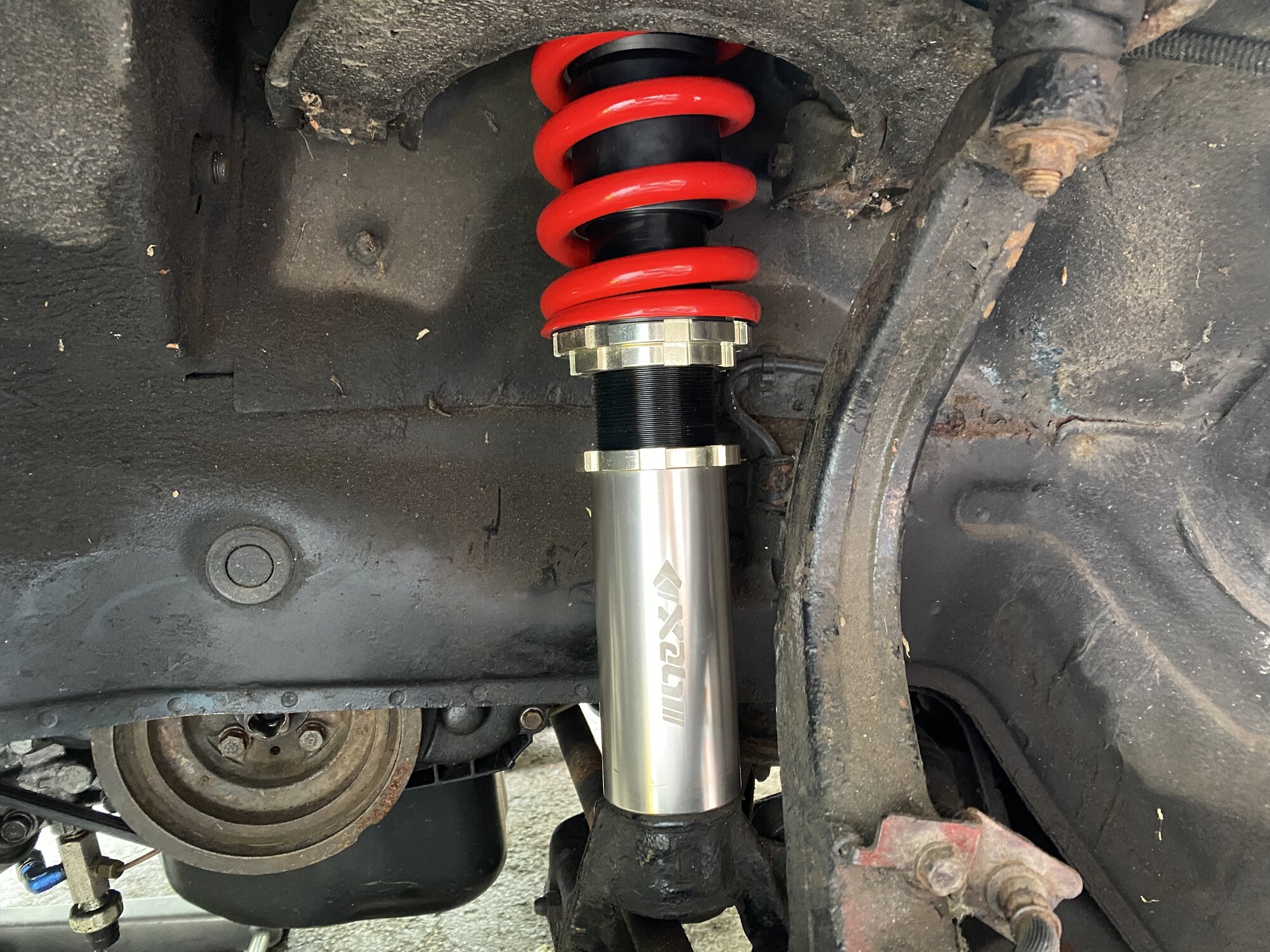

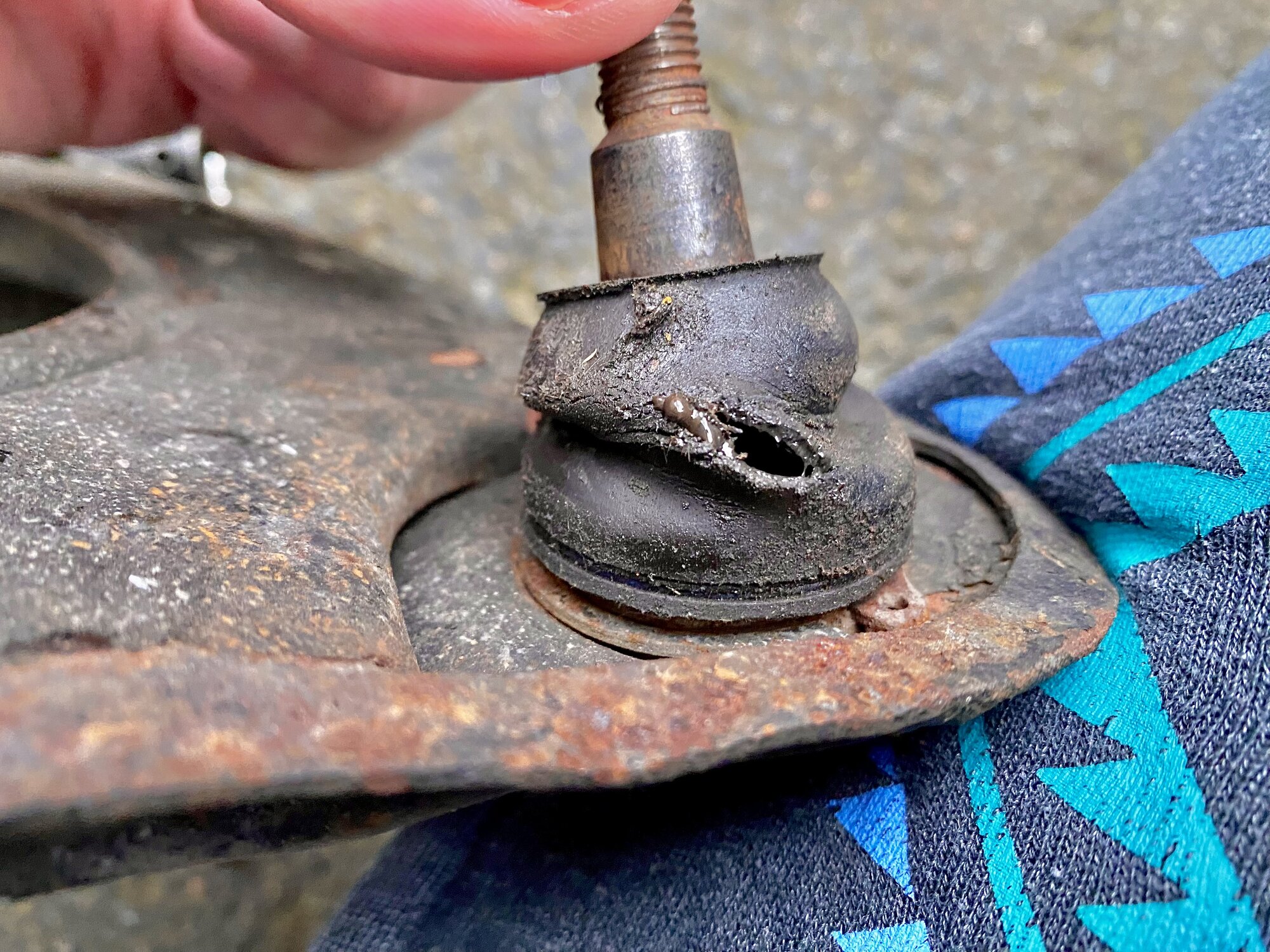

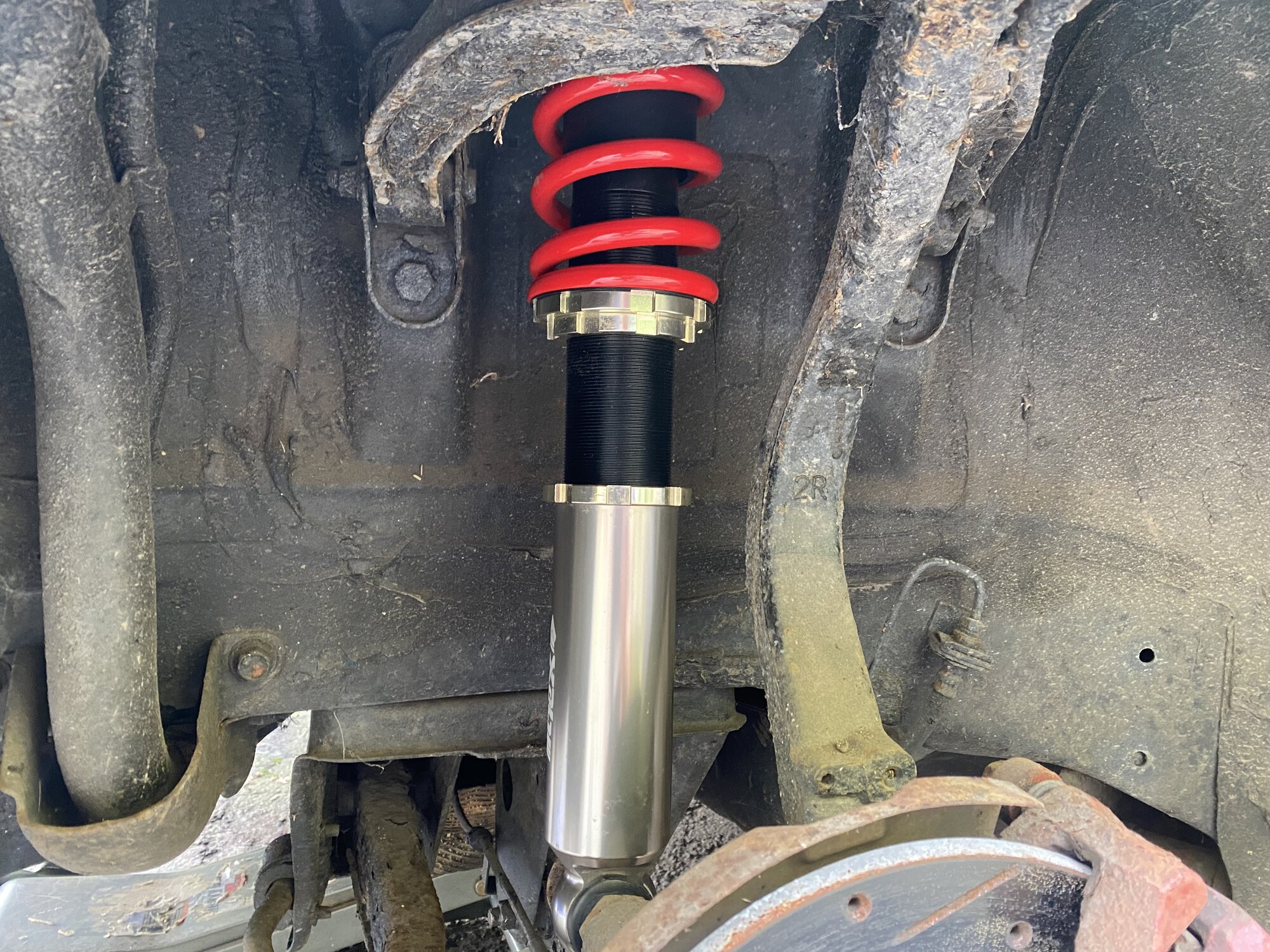

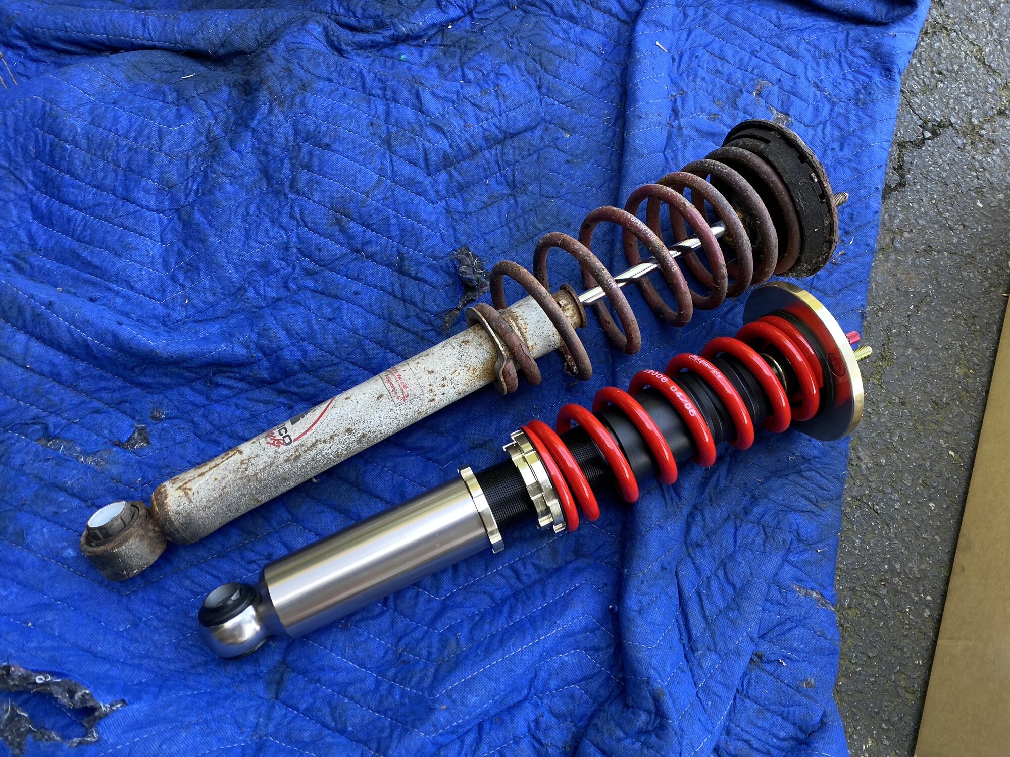

First on the list was getting rid of the tired suspension. The car rode decent but sat way too low for my liking. I got some new Nex coilovers for super cheap and replaced the incorrect bolts. Recently put a better set of front upper control arms. Ended up raising the car about an inch and half all around and cut the rear fender arches. Removed the wheels spacers also

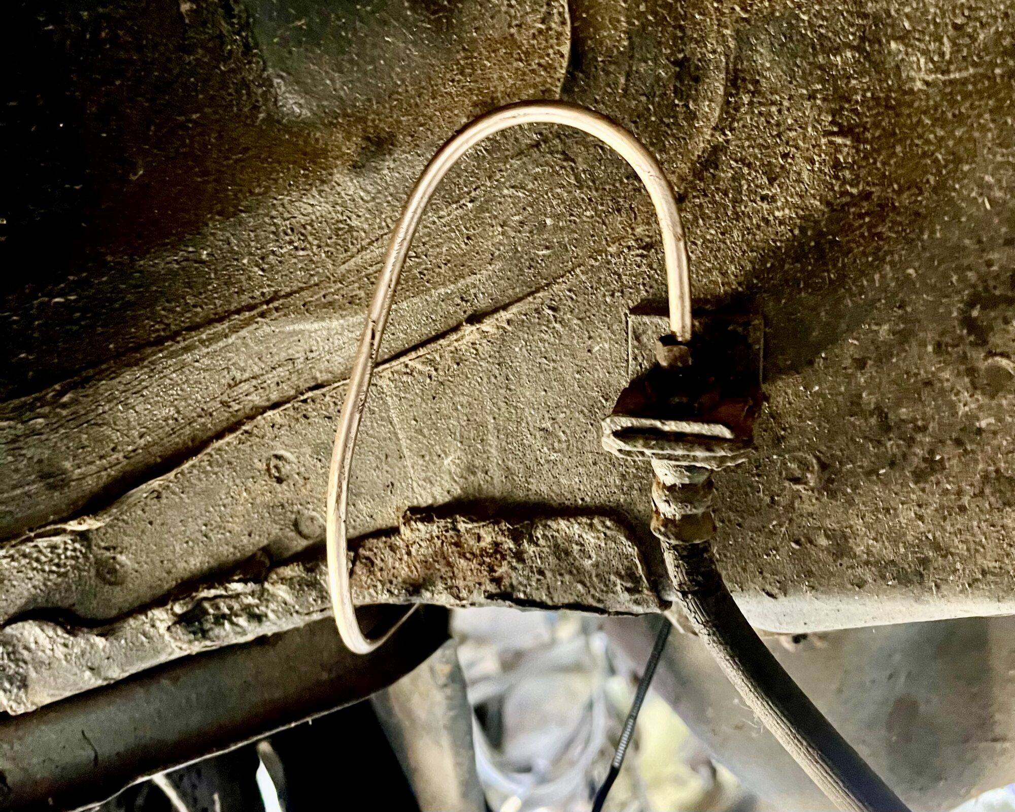

Took the car out for a drive around the block right after the coilover install and while it rode much better, I lost the brakes halfway through the drive. I was able to pull over and come to a stop with that little brake pressure I had left and realized that my master was super low but couldn’t find the leak on the spot. Limped the car home and found the leak at the rear right corner.
Ended up having new rear lines made, put new ebrake shoes (my ebrake never worked), new rear calipers and axle seals.

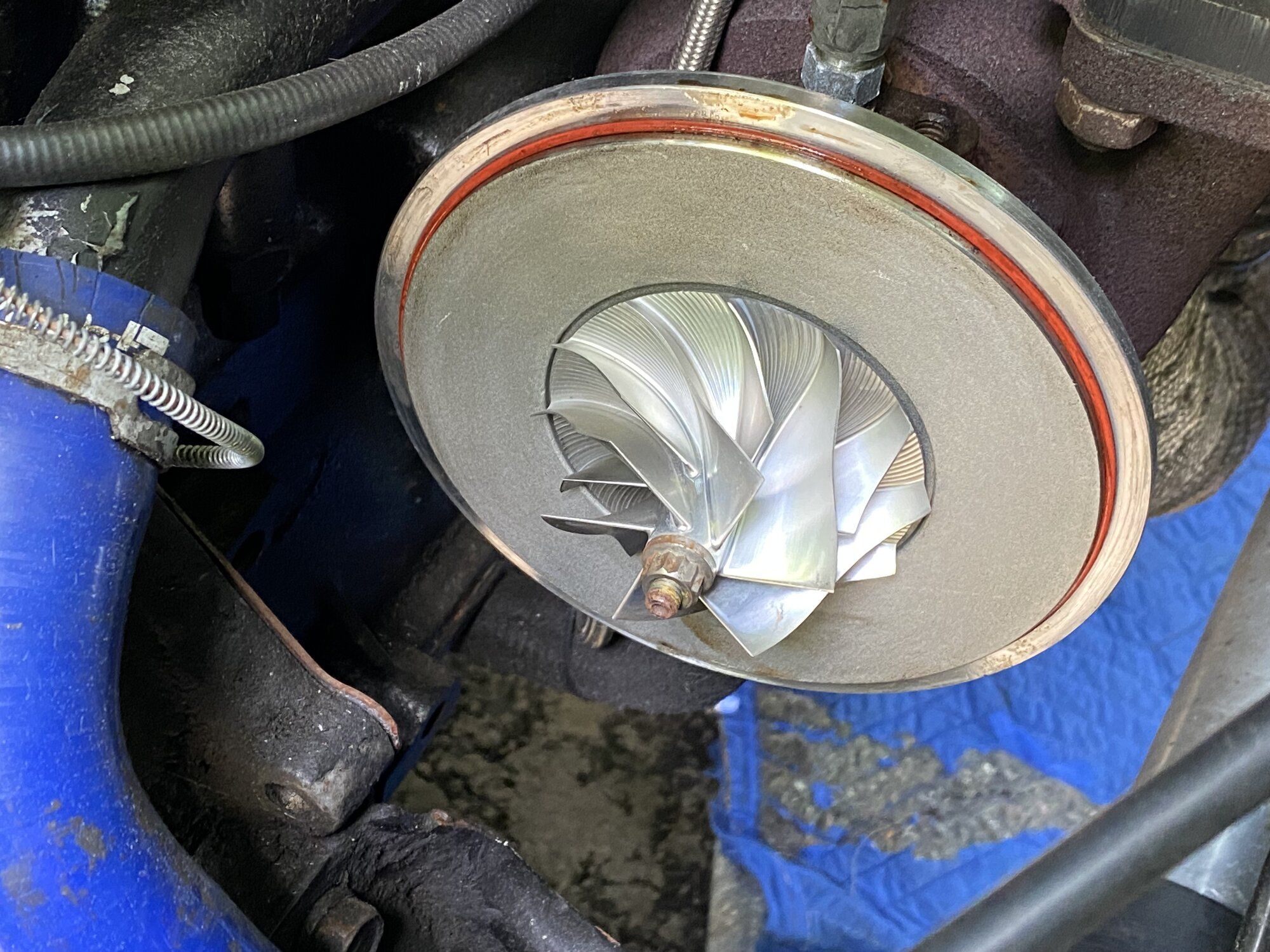

Car wouldn’t make more than 5psi of boost and felt super slow on the Evo 8 maps. I switched to 1g maps and while the car felt better, it still wouldn’t build boost. I borrowed a compressor from a friend and did a boost leak test. I found that the compressor housing o-ring was completely missing!

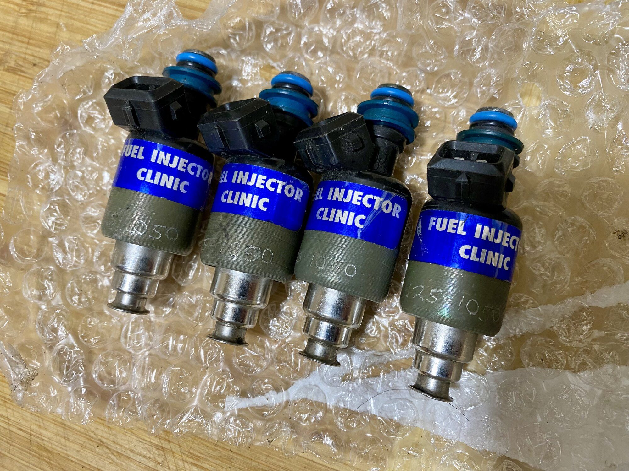

Car started running as it should! But when going WOT I saw around 30psi and 50lb/min which maxed out the 780s. Stepped up to some 1050s, shortened the spark plug wires, wrapped the map sensor in DEI tape and swapped in a used OEM Galant 90 amp alternator.
