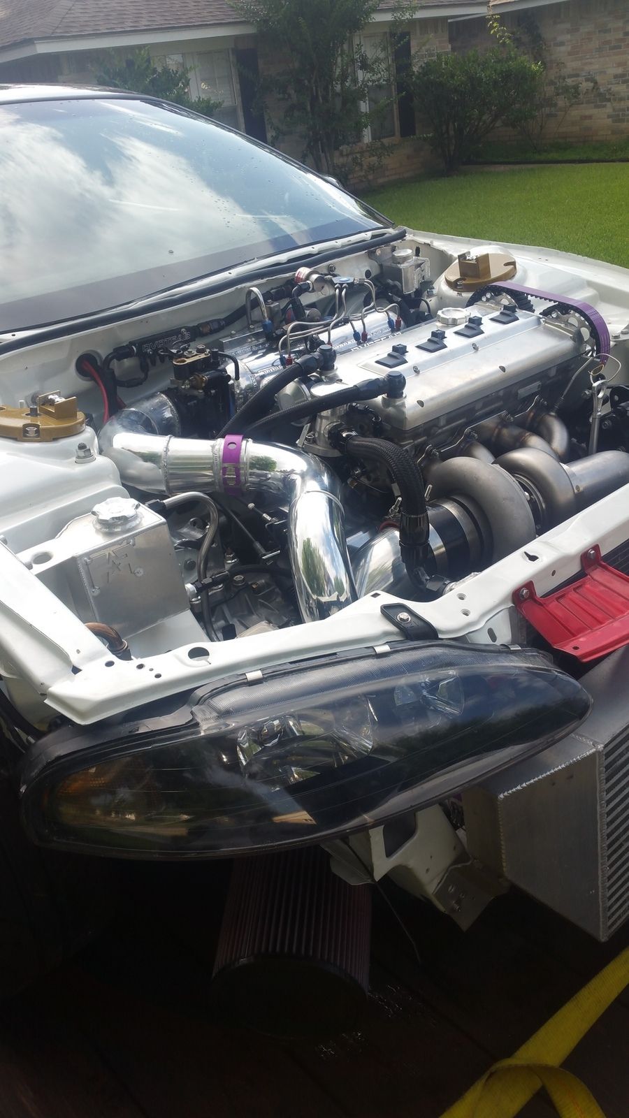

Still on it. I have been working on getting the piping done. I will have pics soon.

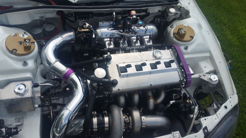

Hats off to you my friend, this is amazing!!
I can tell from your parts you have seriously invested in her!!
Looking forward to see more!!
I'm not sure, I just stumbled across this thread today as well. Excellent work, she is looking beautiful!

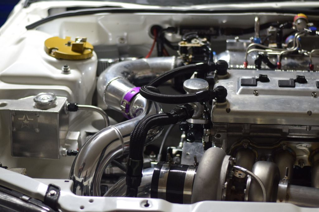

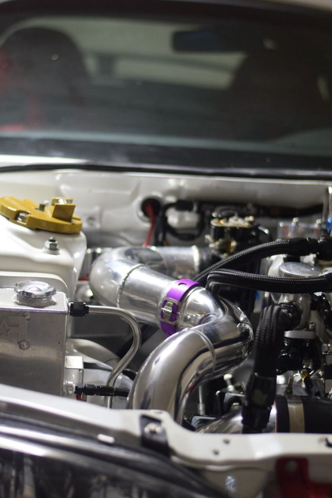

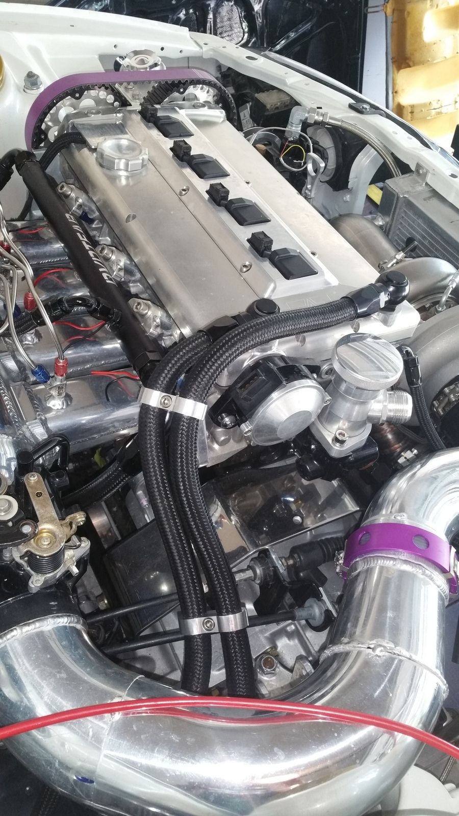

Where did you get that thermostat housing? I've never seen one like that...
I'm wondering the same thing. Would you mind giving us some more information about that thermostat housing? It looks great!
A Friend of mine made it for me. It is awsome. It also rotates.

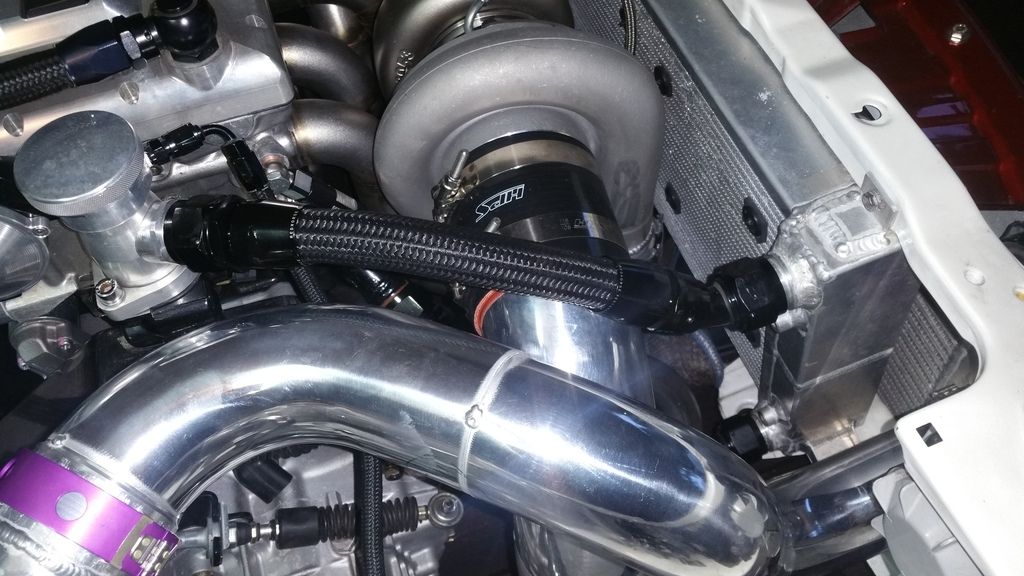

I know I have to fix that water hose. Just wanted to wait until every thing was done.

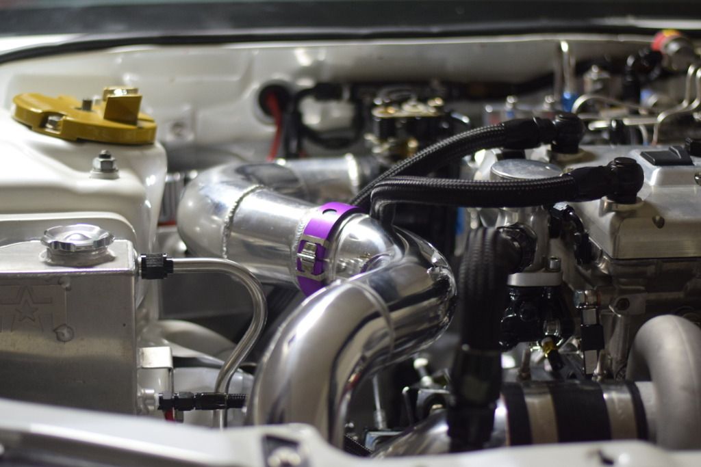

Beautiful!!!!
I'm liking the wave you made with the IC piping.
Thank you. It had to be done like that to avoid things in the bay. It will look nicer once it's Finnished. Still have to install the Bov, as well as the methanol injectors.

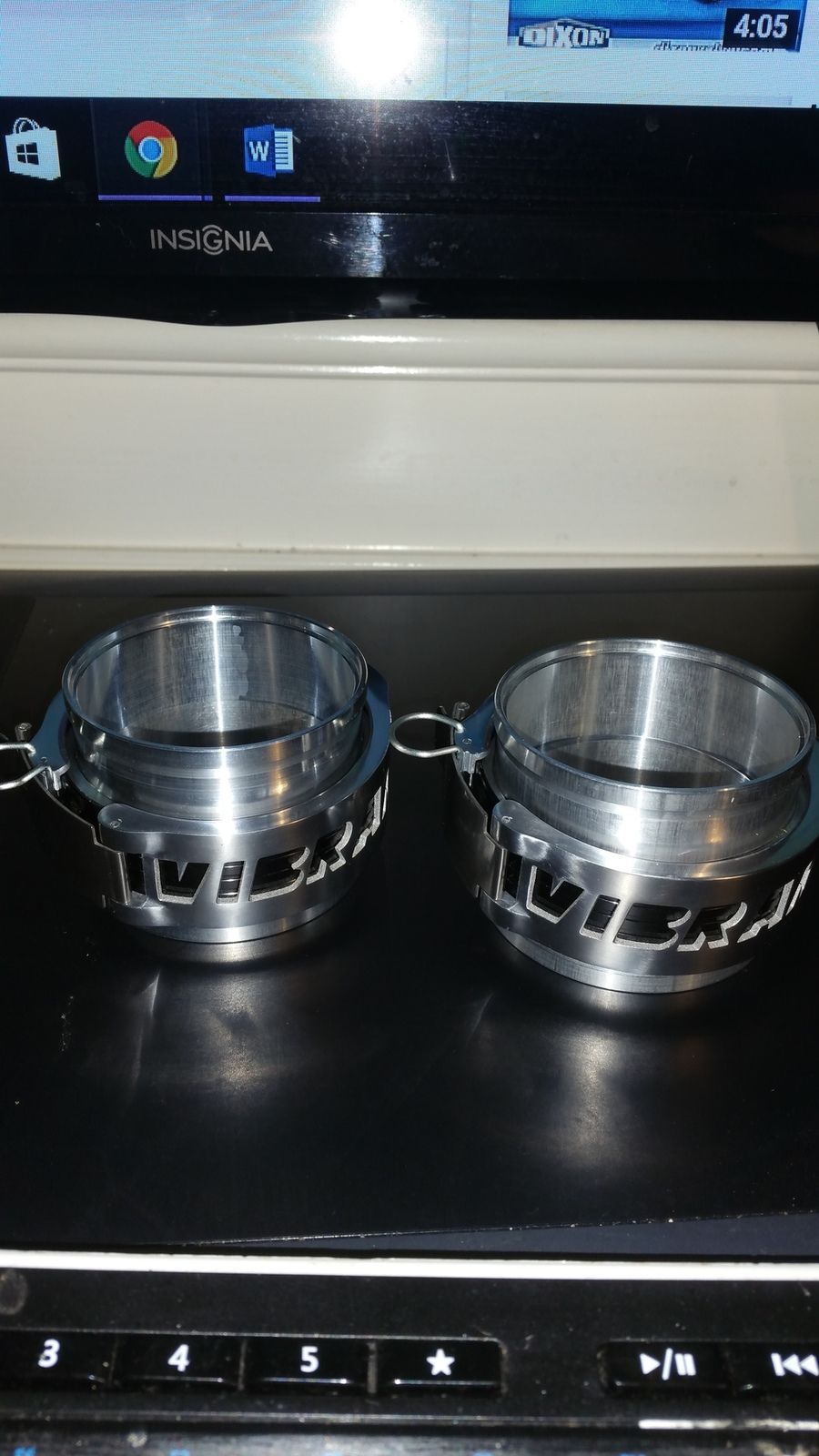

So there is so much going on with the car. Got the down pipe finished and we will be finishing up the 3.5 oval exhaust system this week. Then on to the wiring. But in the mean time, I got a couple trinkets that made me smile. Billet hose brackets. Its the little things, the attention to detail.
