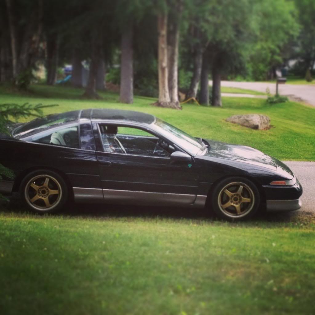

It all started last summer. I was doing my usual search through Craigslist when I came across an ad for a particular 1g listed as "built 91' talon". The price was more than fair, and this picture was in the description.
So after work I went and checked it out. The moment I saw it I knew I had to have it. The motor had 30k on a complete overhaul with the eagle rods and wiseco .020 over pistons, arp head studs, and many other goodies. Also had tein coilovers, 6 piston willwoods, and real gram light 57 pro's! With a 16g on 20 pounds it pulled hard, and was perfect for the streets.

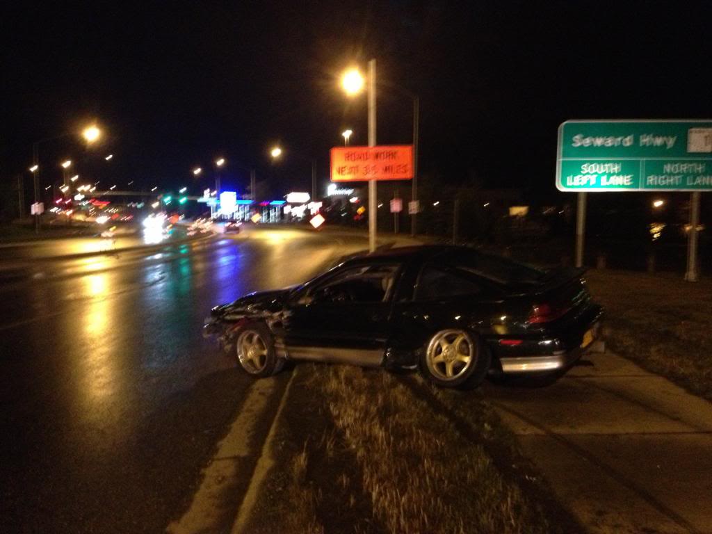

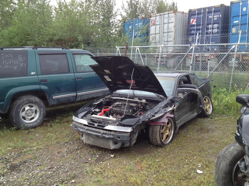

Then on august 9th, I went to grab some coolant after I got off work and this happened
I was going straight and a driver pulled out in front of me to turn left. I swerved to avoid her but she made contact with my fender. I was pushed over a median and flew about 100 feet to where I stopped on the sidewalk. My car was completely destroyed. Soon after I found out she was drunk.

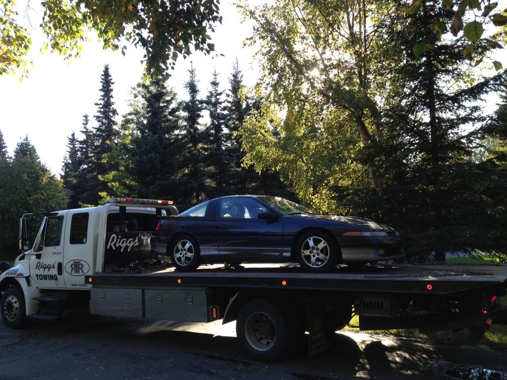

I was devastated. After a brief trip to the hospital, I spent the next few days sulking around. I knew I needed another dsm, but in Alaska clean 1g's are in short supply. For the next month I searched craigslist until finally, my persistence prevailed.
For 1500 bucks it was mine

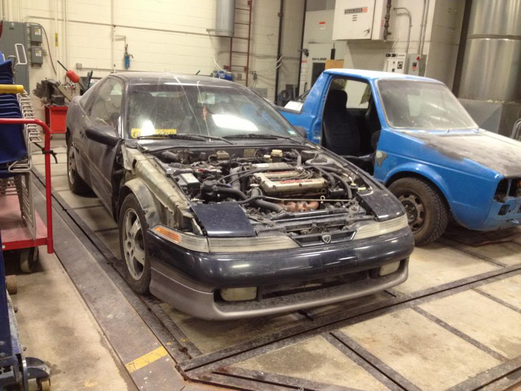

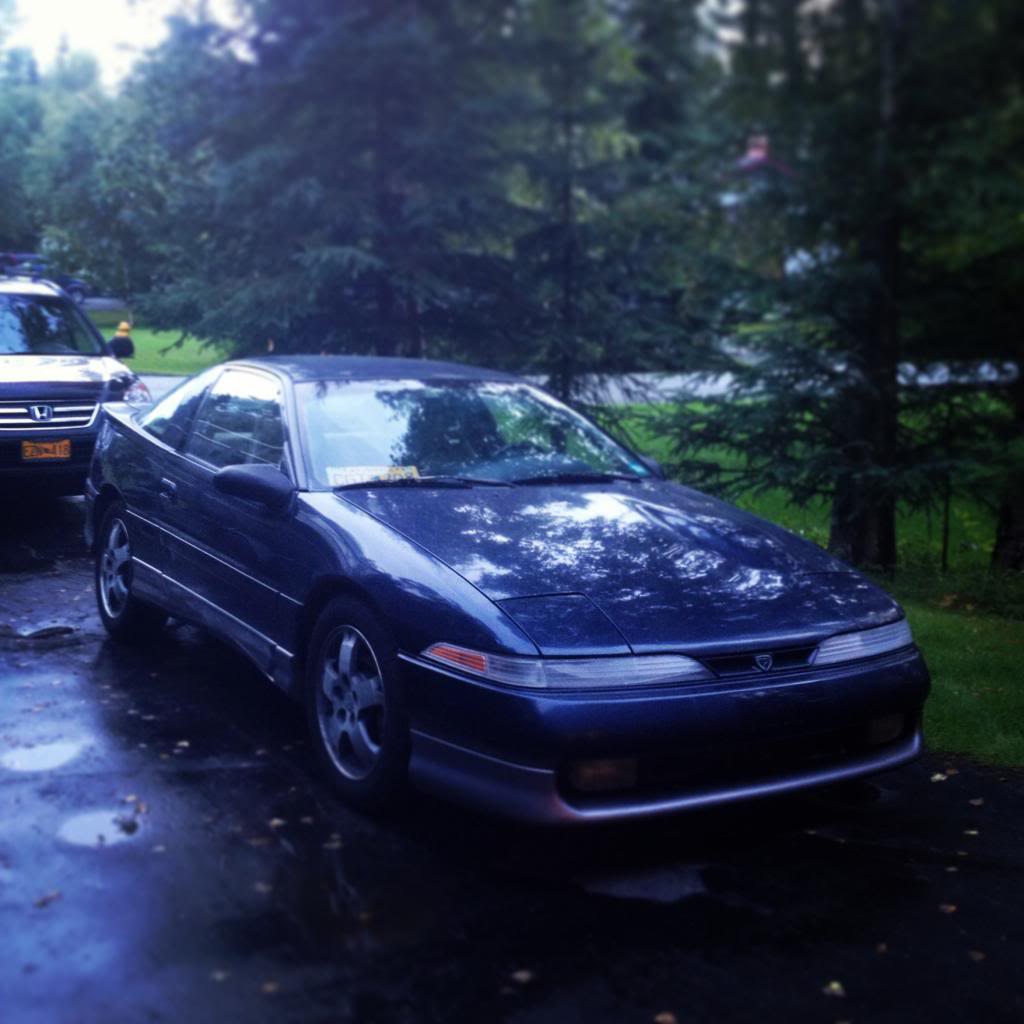

The 90' talon was the polar opposite of my 91'. It was almost bone stock with 98000 miles and a leather interior. Although it had not been driven hard, it had spent a large portion of its life sitting. It was clean and ran decent, but it was in desperate need of some tlc. I got the car home and started to figure out my plan.
I wanted to build a cleaner, and meaner version of my old car. I would get to the "mean" later but first I had to take care of the "clean". Conveniently, I was taking (well I still am..) a collision repair class with a full shop equipped with pneumatic tools and a down draft paint booth. So a fresh paintjob was in the near future. But first thing's first, the car was I desperate need of a new clutch, and soon the inevitable happened.
So in went an act 2100 clutch kit. This would hold me over just fine for the meantime, and was perfect for a stock car. This car was my main form of transportation, so I drove it around in this form for a few months while I waited on insurance money. And I have to say, its a balst to drive in the winter!:hellyeah:

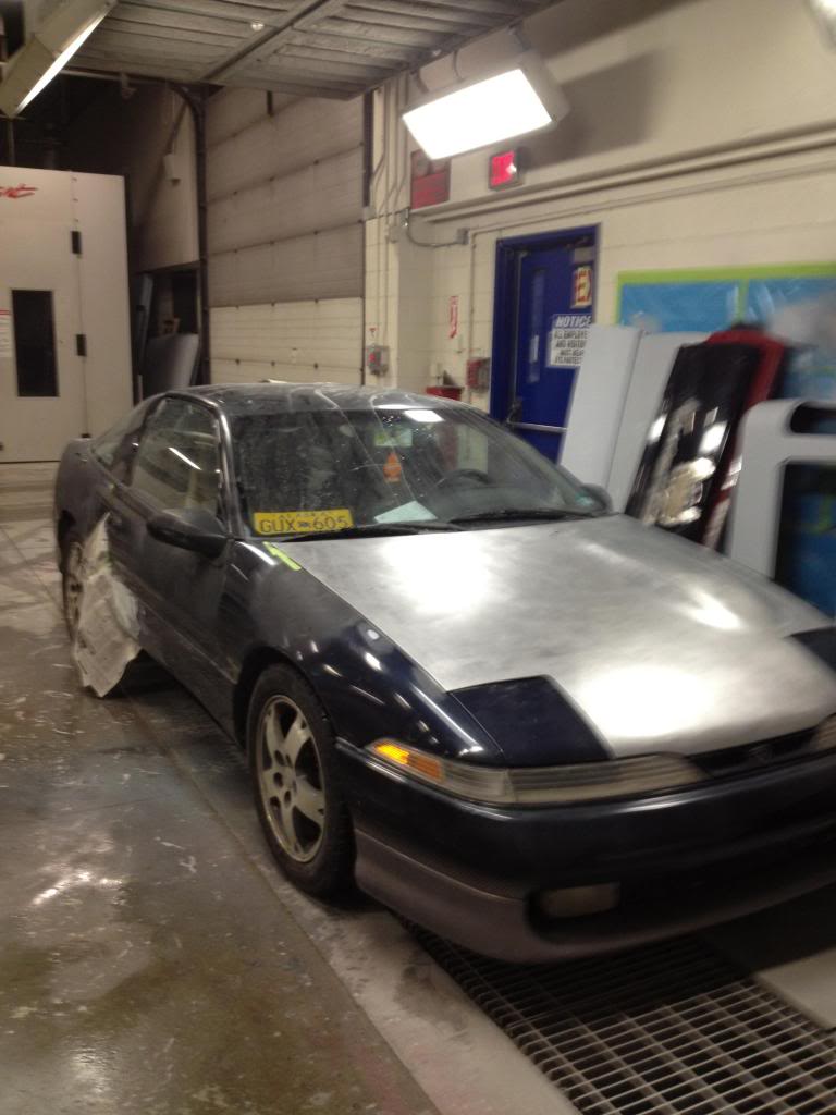

Finally, it was my turn in the shop. Let the bodywork begin!
hood had to be stripped due to rock chips

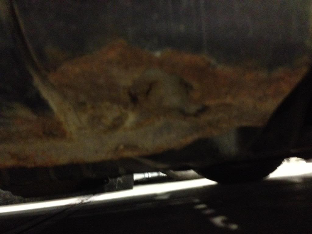

More rust than I was hoping for.. But either way, its gotta go.

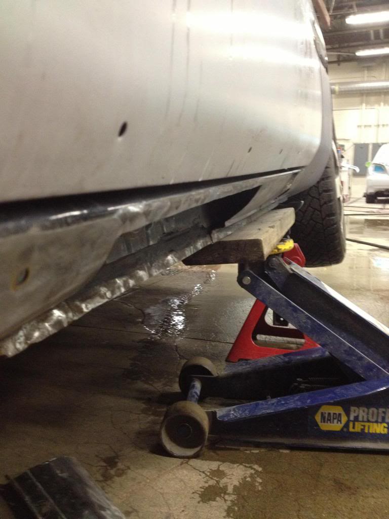

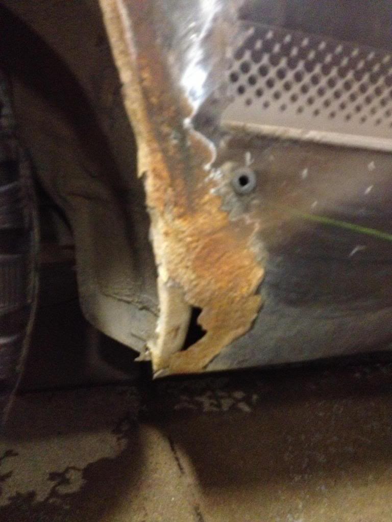

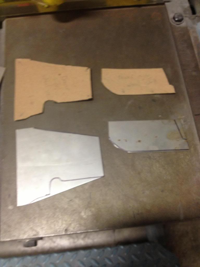

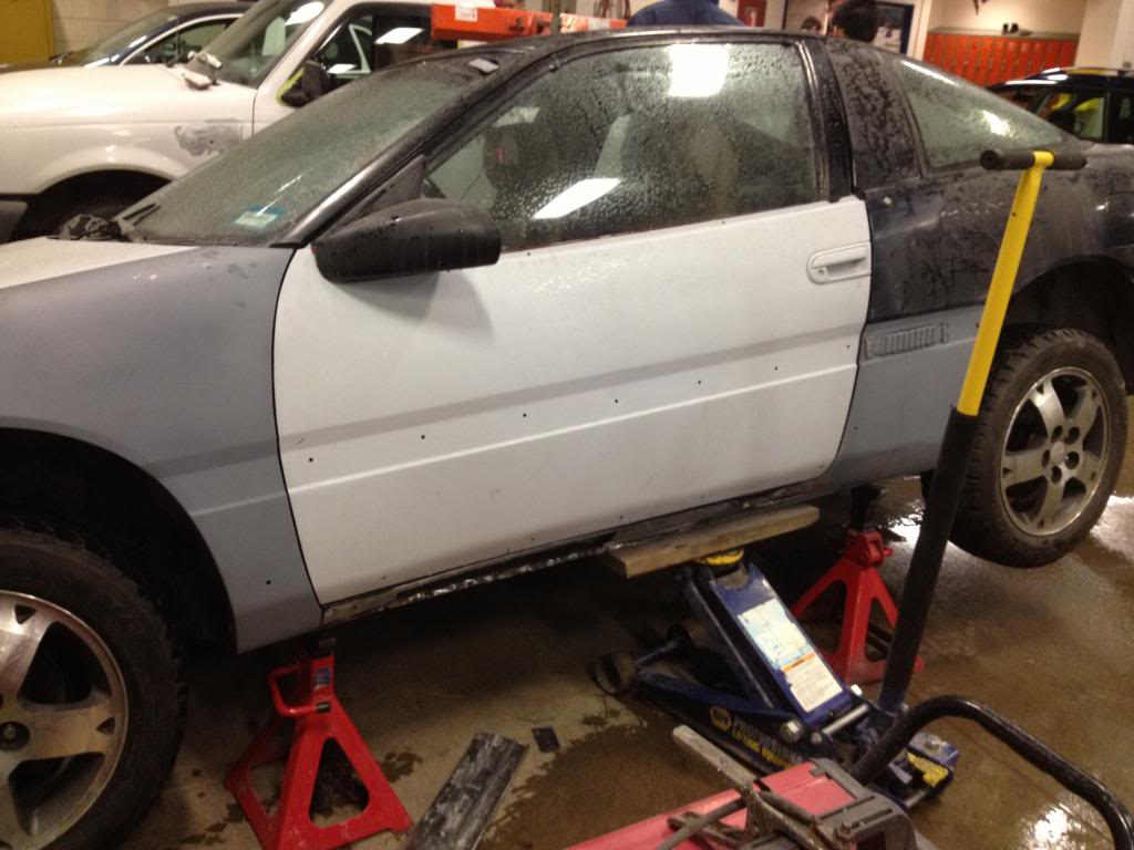

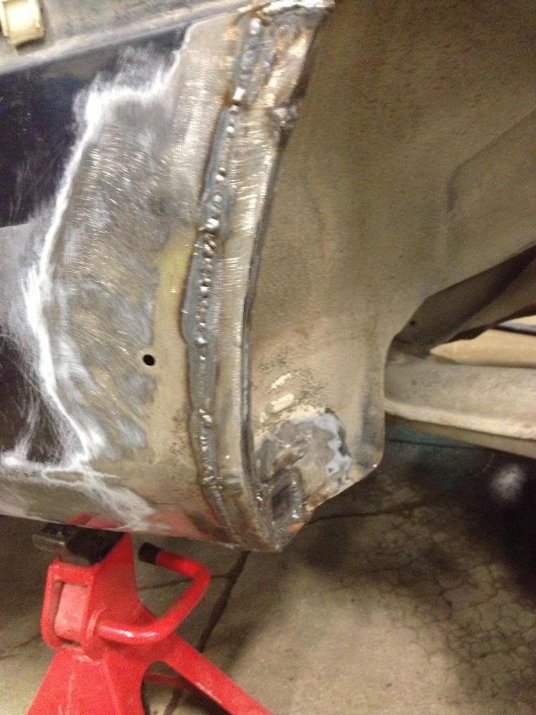

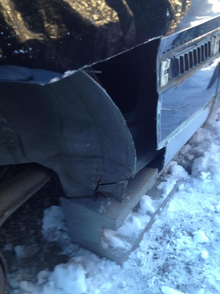

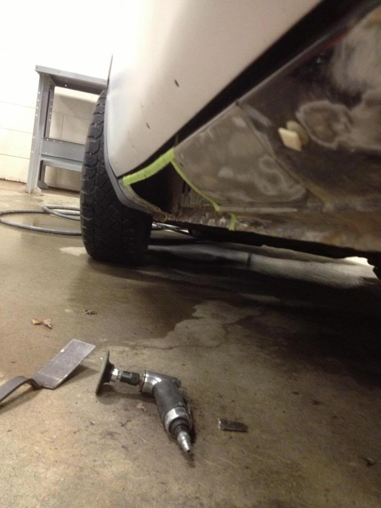

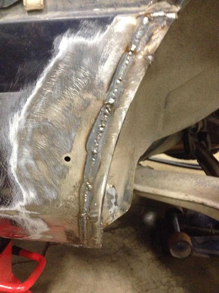

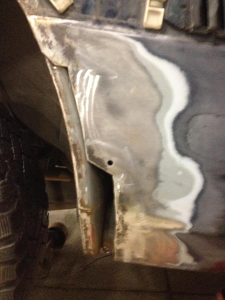

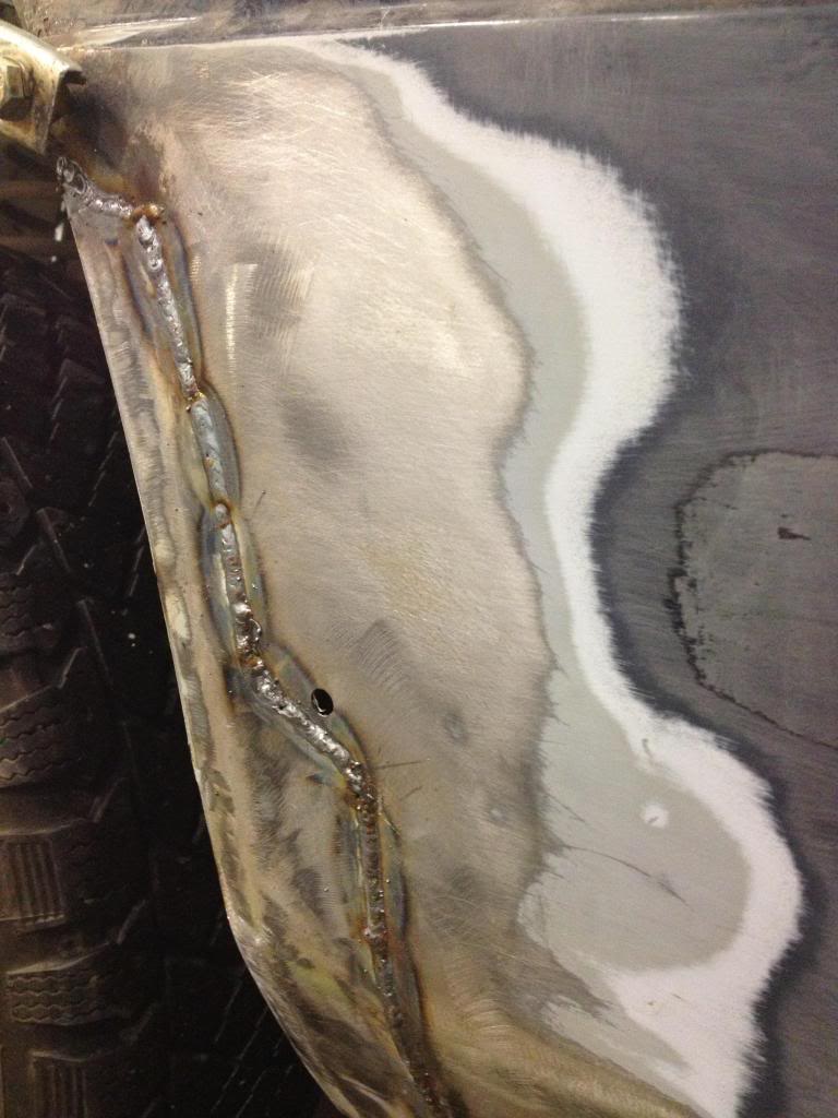

Small update, ive hit a little snag in my build. My car has far more rust than I would have thought in my optimistic stupidity :ohdamn:.. I have been hacking out all of the rust for the last week or so and I think I have gotten it all. Thankfully, my old car was 100% rust free, so it will be donating its rear wheel wells and a good portion of its rocker panels.

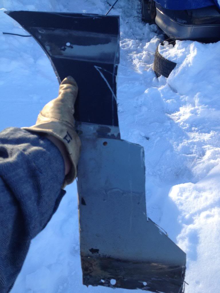

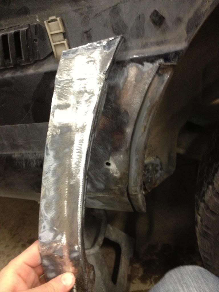

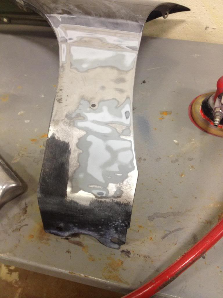

Cutting up an old fender to use as a patch panel on one of the rear wheel wells.
Sorry for the blurriness, but this id the bottom of the fender.

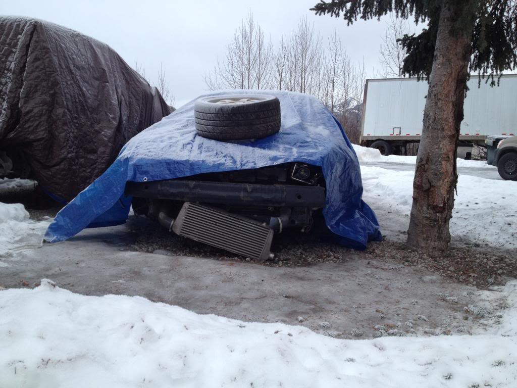

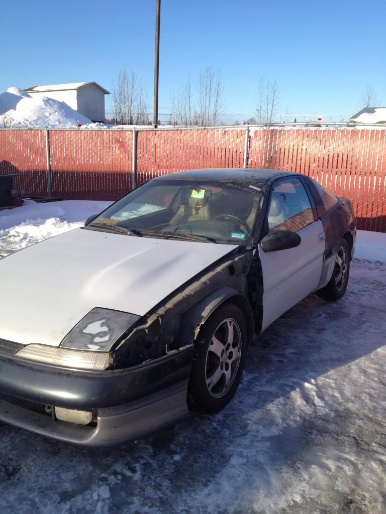

Taking parts off when it's 5 degrees outside SUCKS :cry:. Have you ever seen such a sad sight?

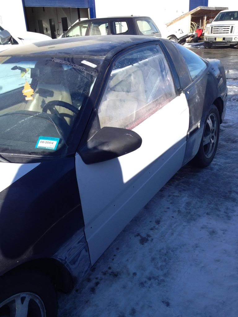

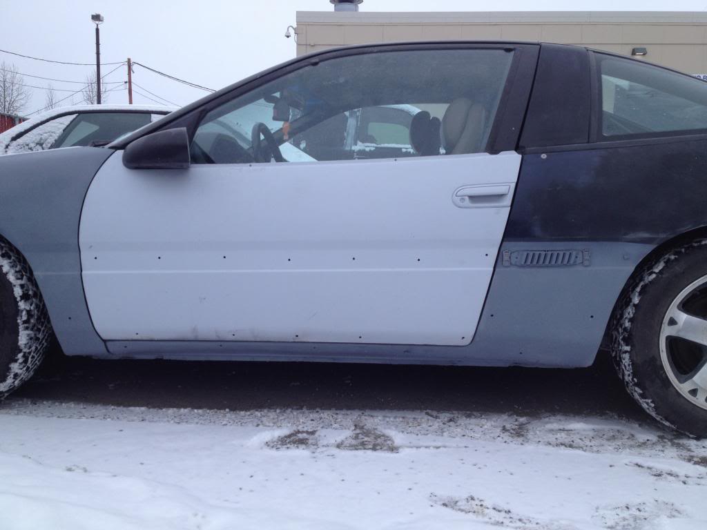

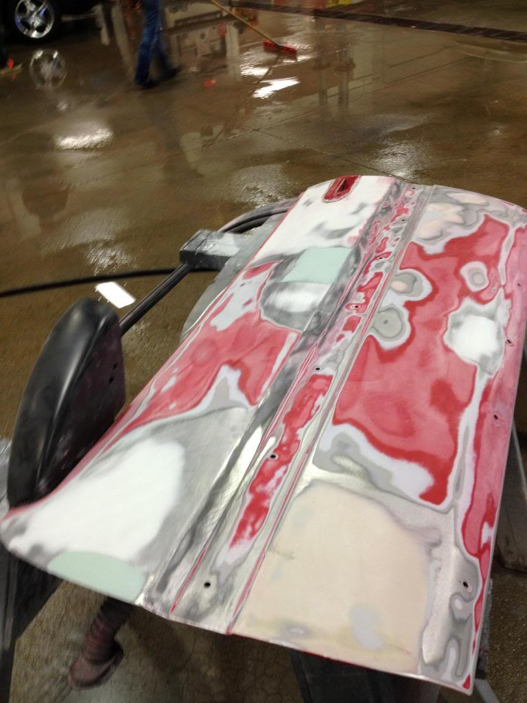

I also found a replacement drivers side door, which I soon found out was full of bondo.

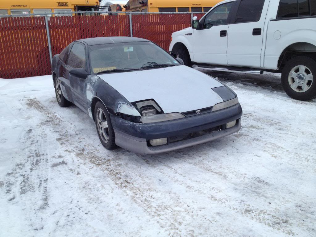

That's all I have for now really. Fortunately, when I finish with the rust my car will be ready to go into primer. So believe it or not i'm getting kind of close, as long as all goes as planned.

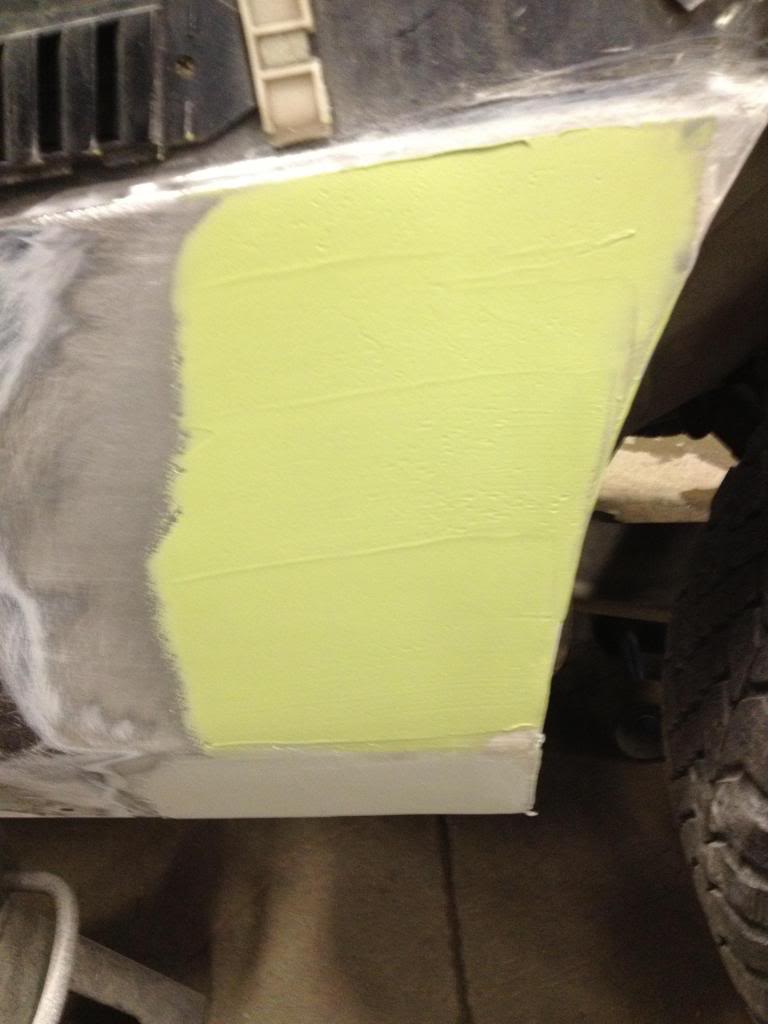

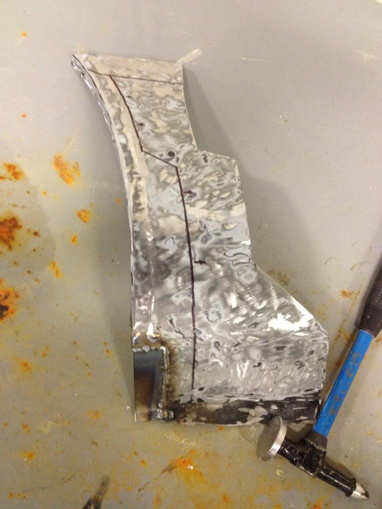

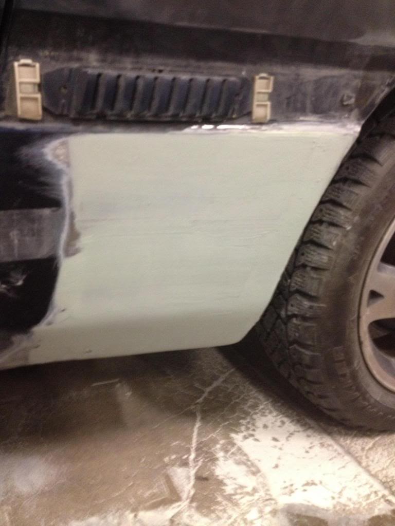

Ok, I finally have a pretty substantial update on the body work. Ill just let the pics do most of the talking.

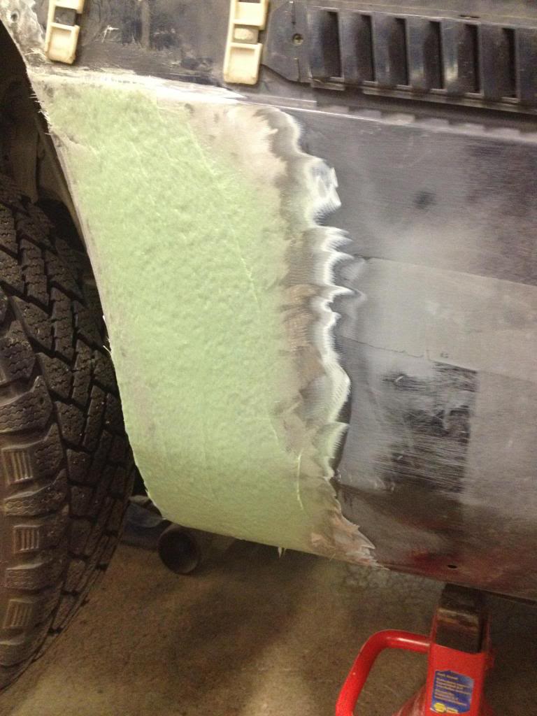

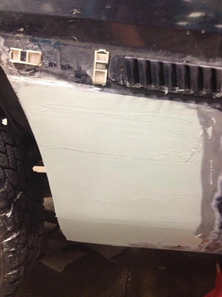

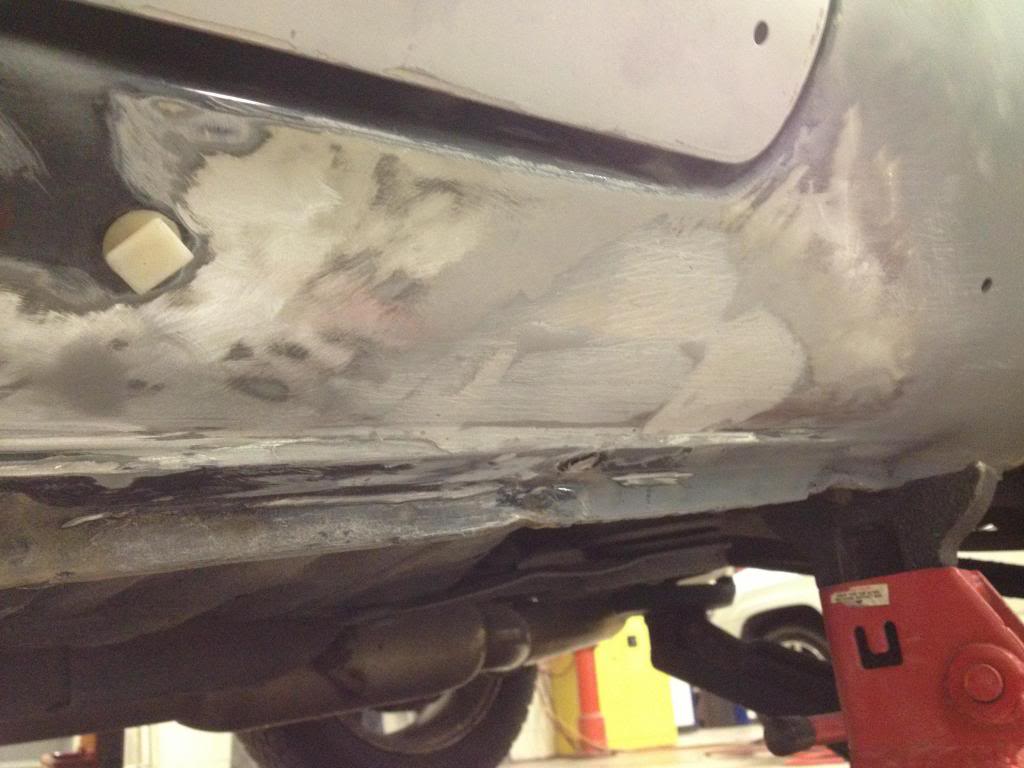

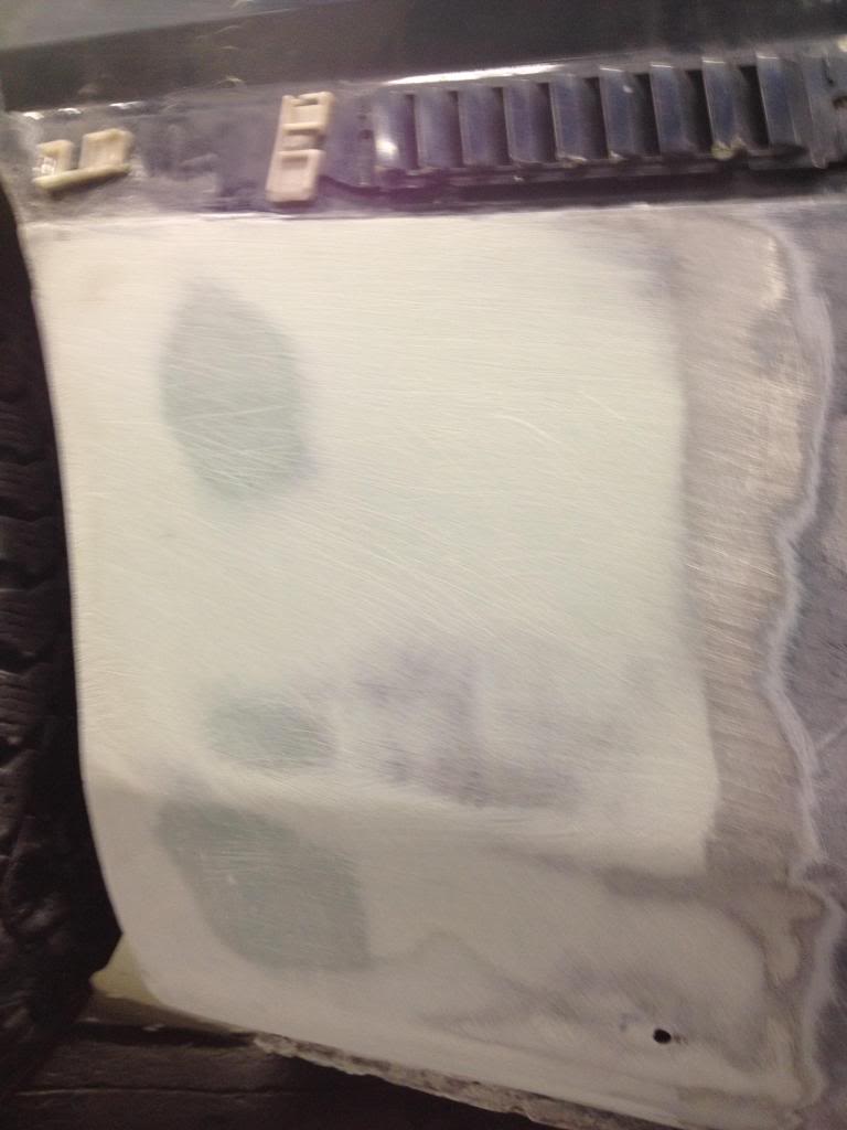

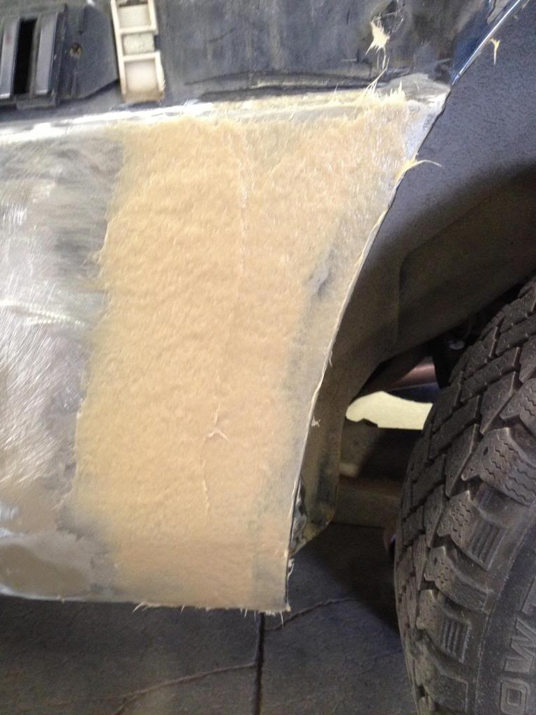

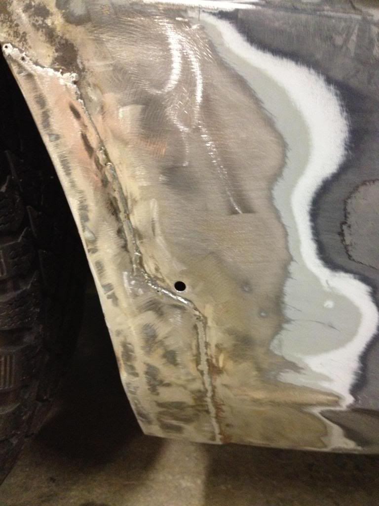

It took me a few passes with the bondo to get just perfect, but all of the filler (including the fiberglass) is only about 1.5mm thick.
Yep, even my patch panel has a patch panel:hmm:
And yes, I did grind the rest of the pitted areas down before spreading the kitty hair.

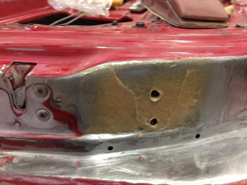

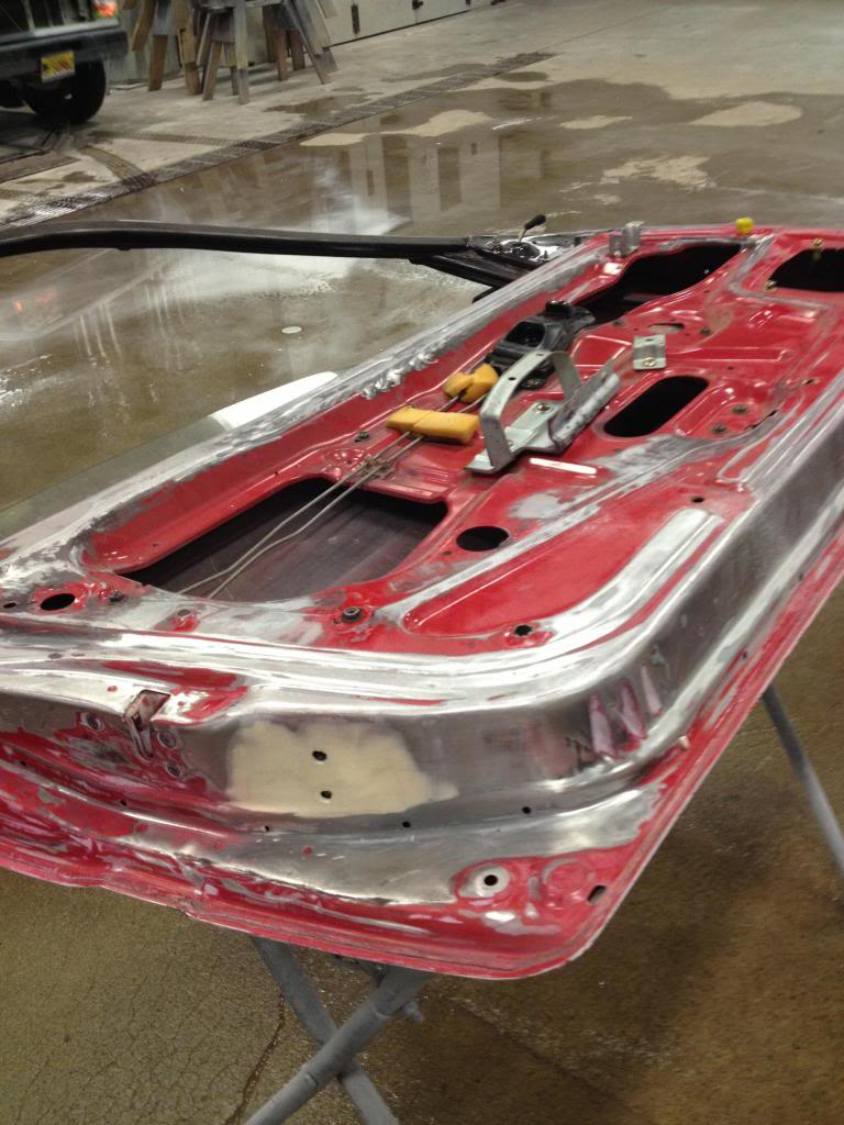

The door had a crack here so I welded it then fiberglassed it in. This is why you never buy used parts in the dark..

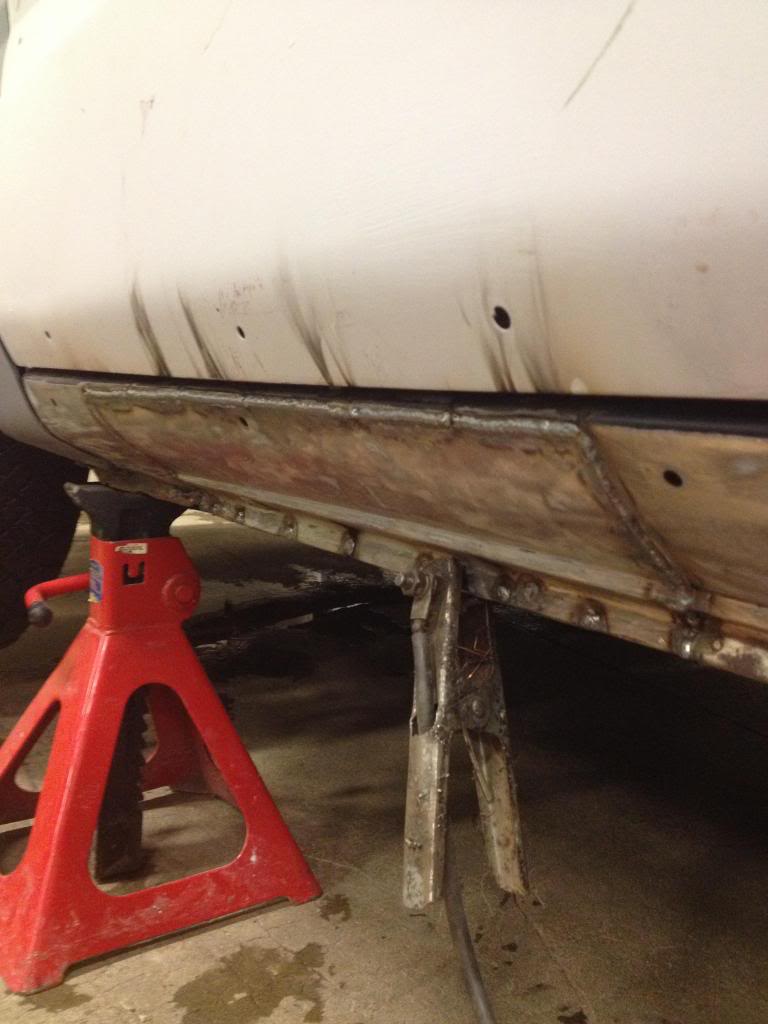

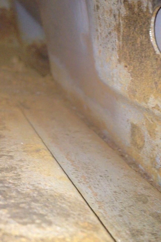

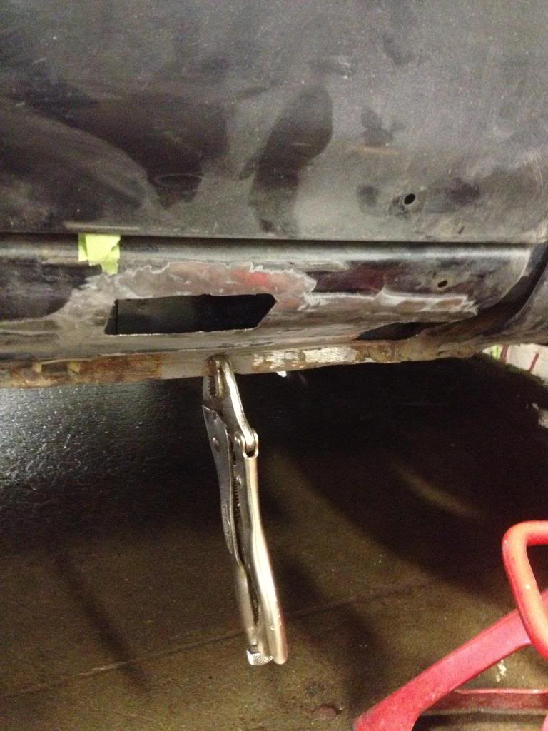

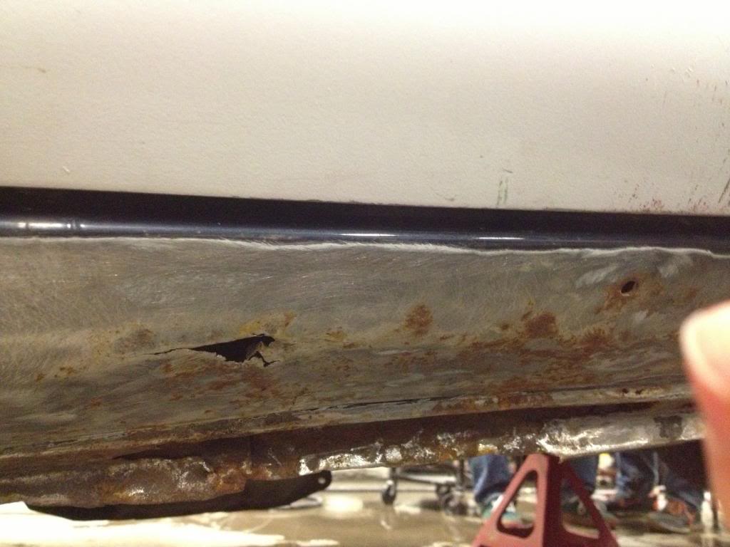

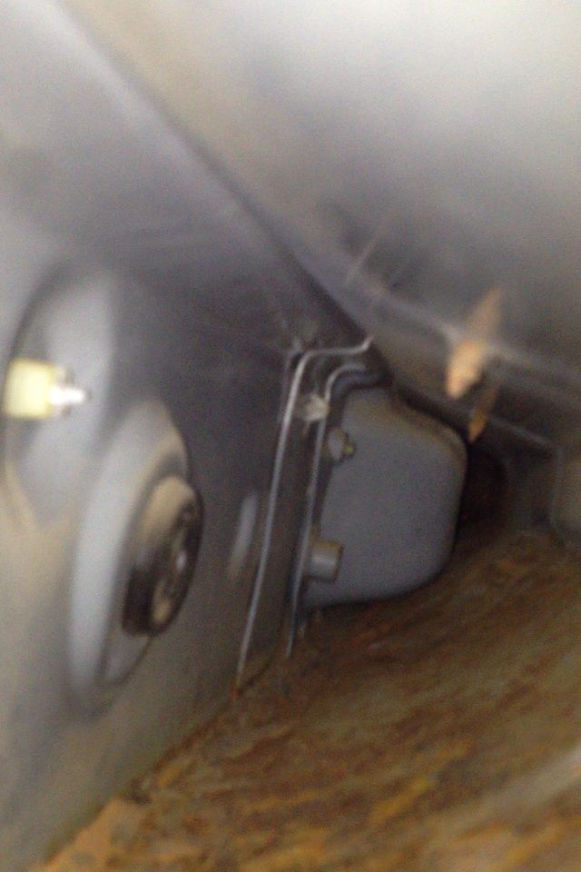

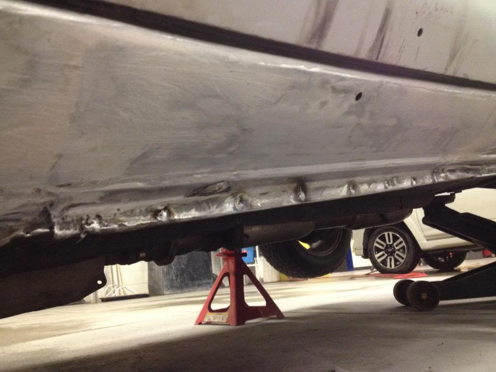

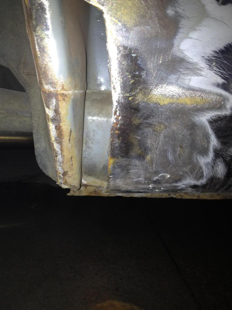

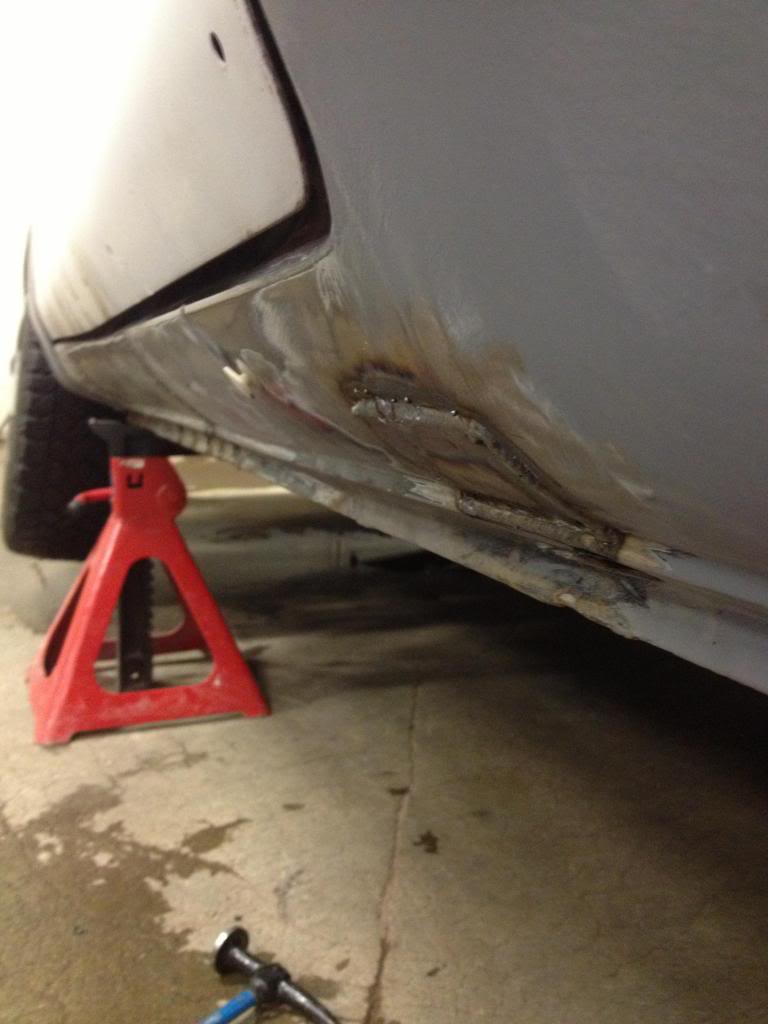

Im glad I caught this when I did, because surface rust was beginning to form on the inside of the rocker. Should be savable if I go at it with a wire brush.
That's all for now. Once I get the new patch for the rocker welded in it should be ready for primer. On a side note, here's a talon ad my buddy found in an old magazine:hellyeah:

Thanks guys. Yea it always sucks to lose a good dsm...especially a rust free one haha. I'm bummed I didn't find out about por 15 earlier because I could've sprayed it before I put body filler on. Oh well, ill still spray it along the rockers and pinch welds before I primer them.

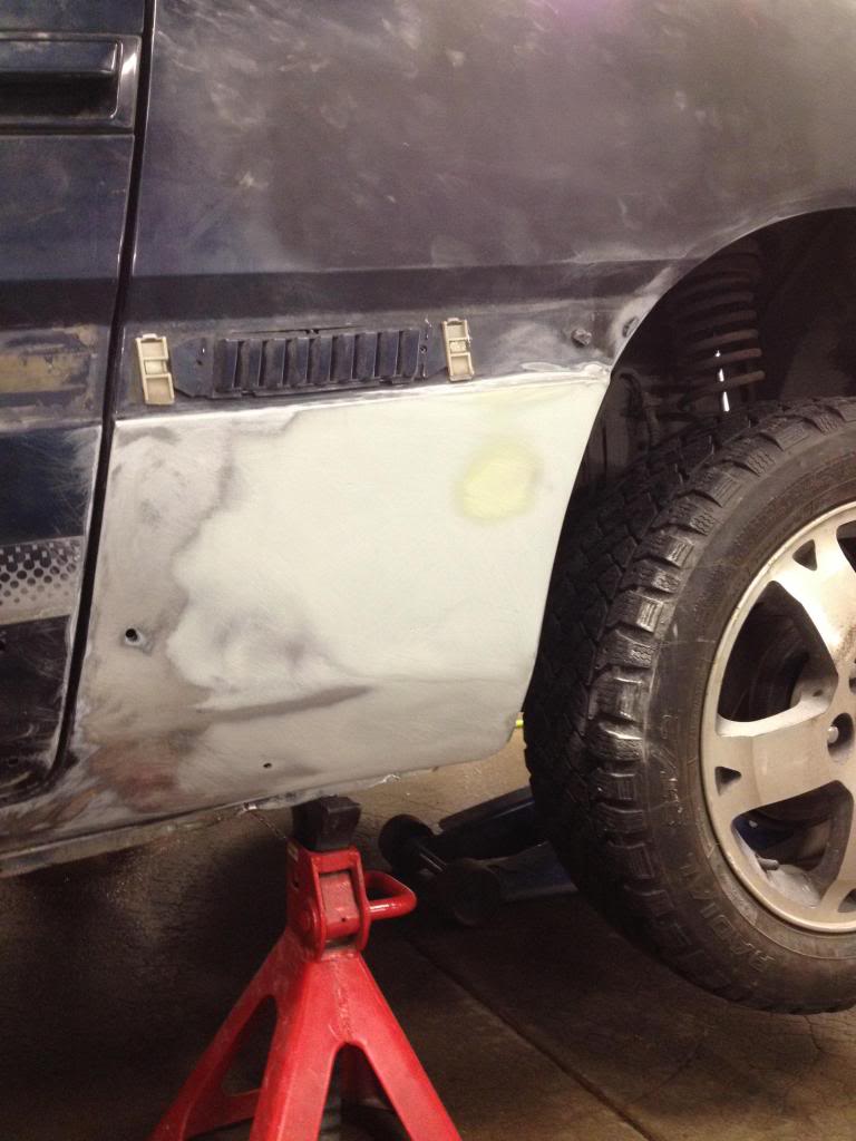

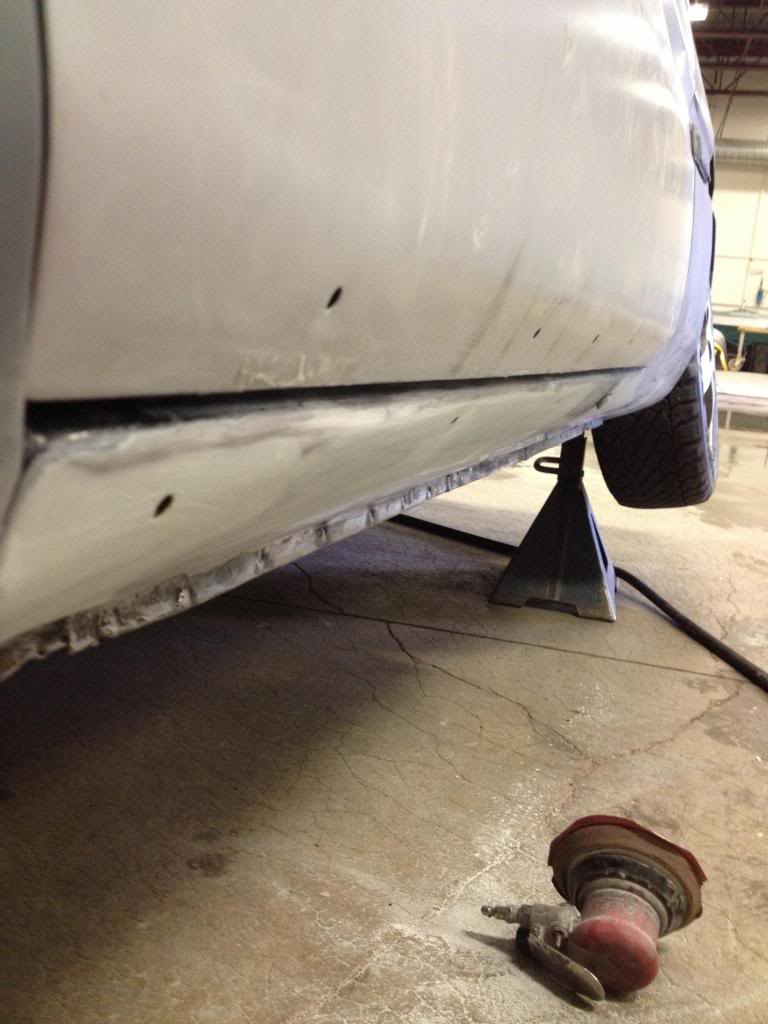

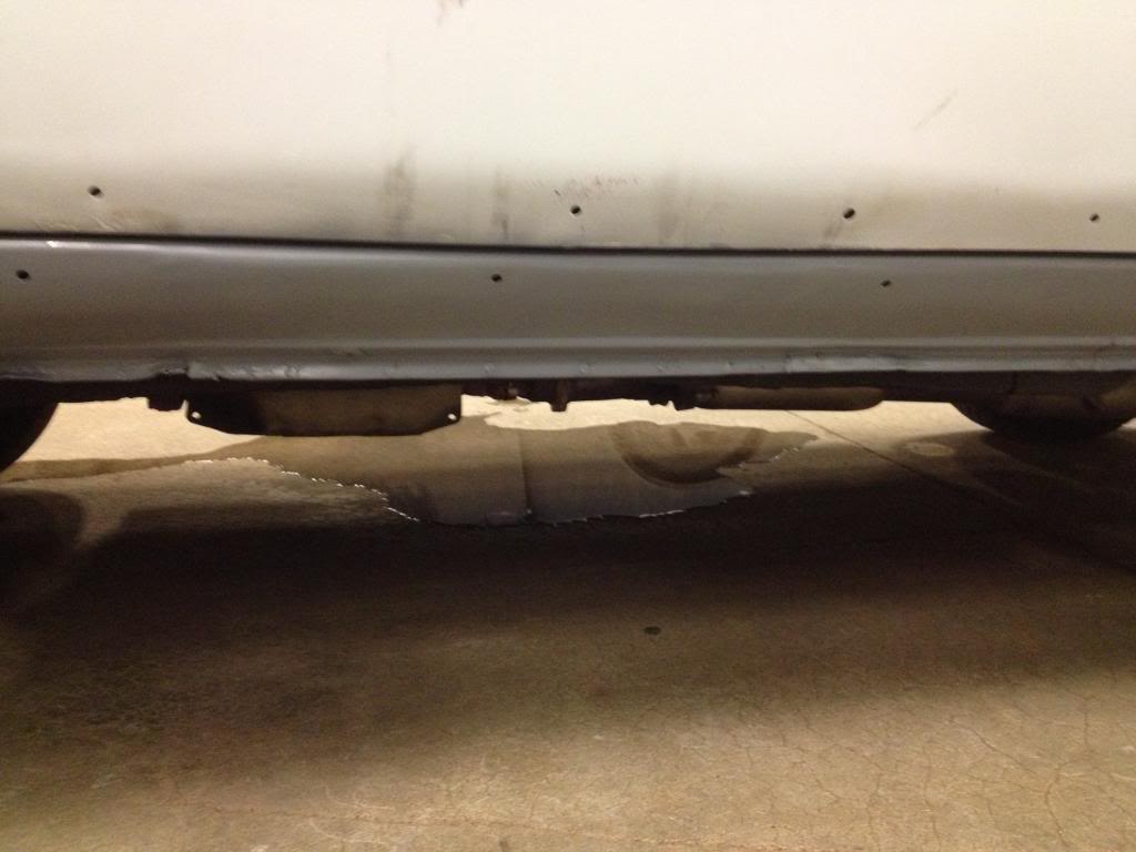

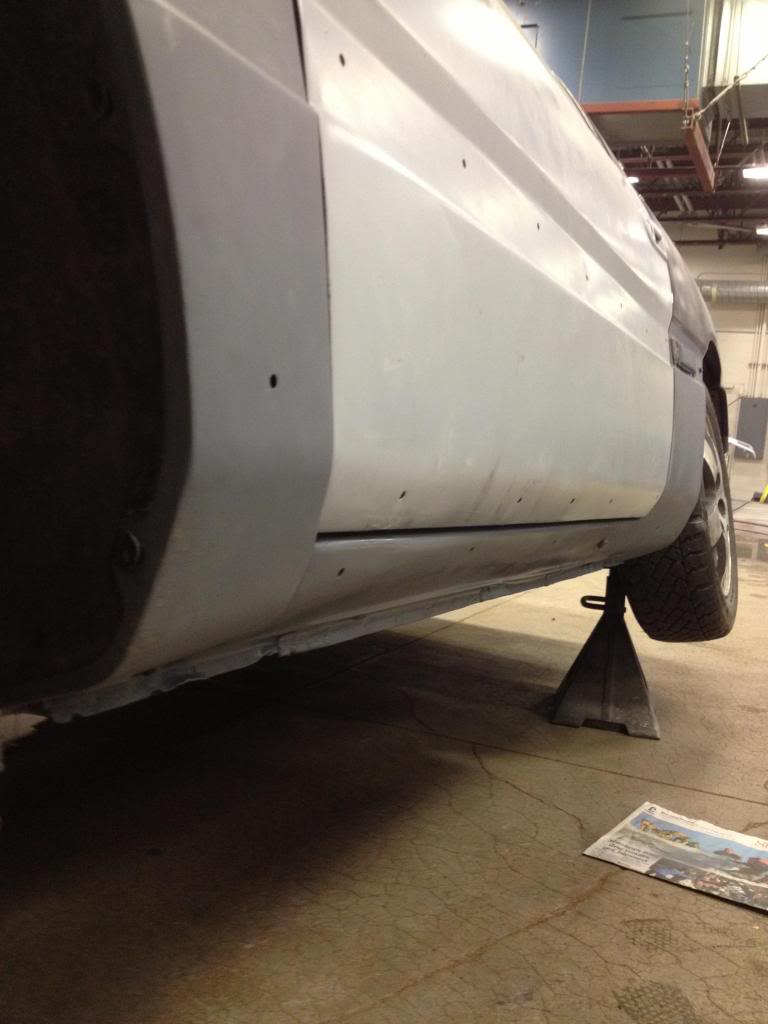

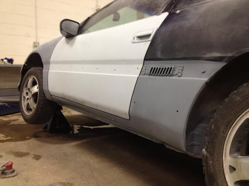

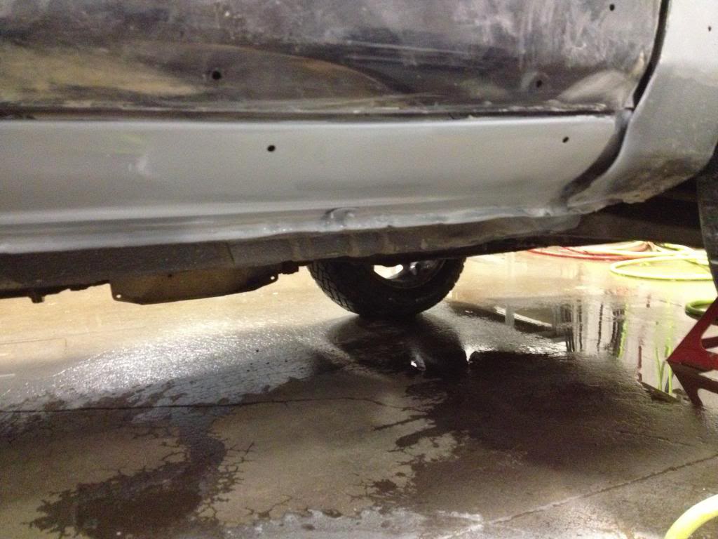

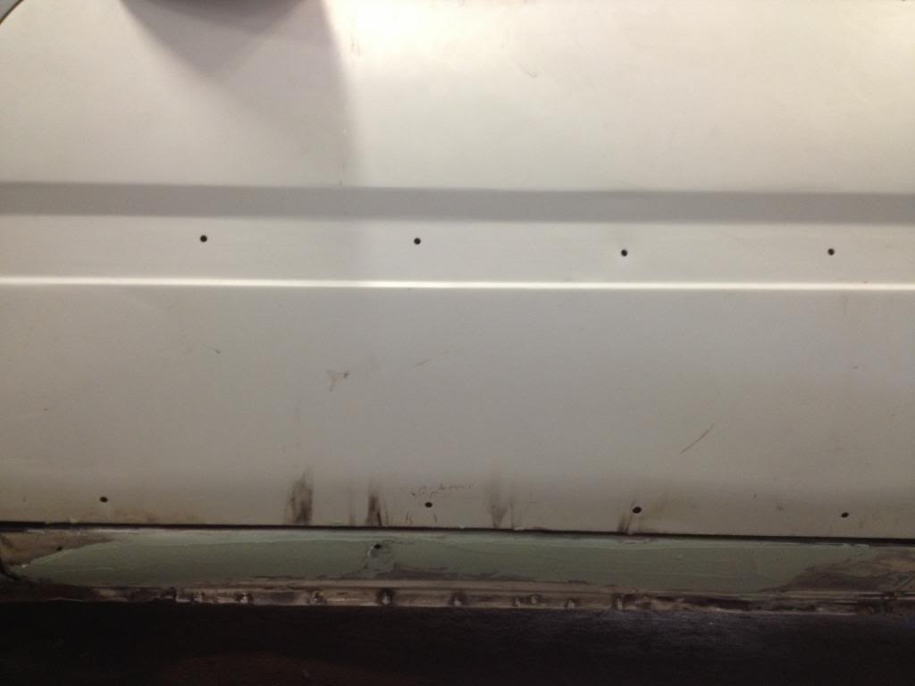

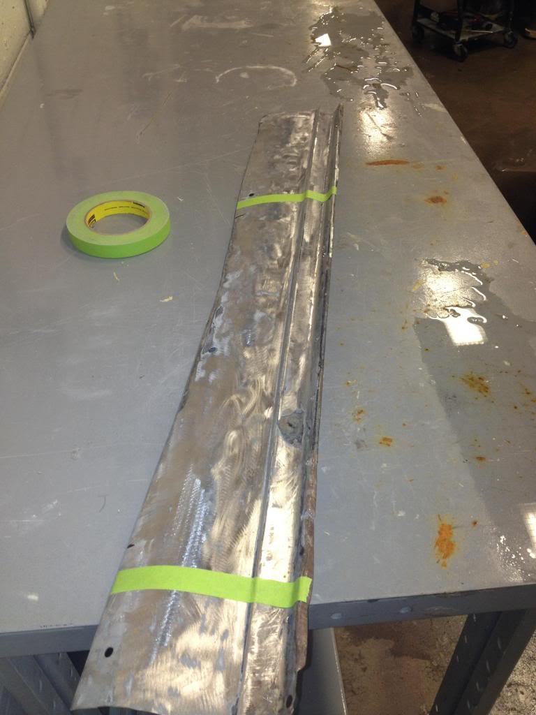

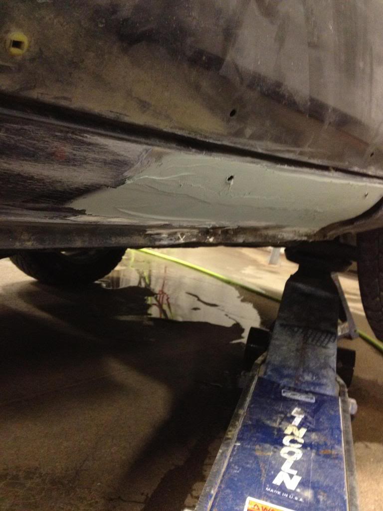

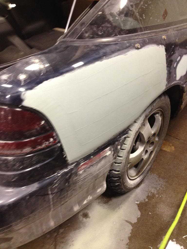

Well I finished up on the rockers this week. All my repairs are sealed and ready for primer. Feels sooo good to be done with rust!
I did spread and sand a layer of fiberglass before bondo here, just forgot to take a pic.
One last pic of the driver side for good measure:sneaky:
