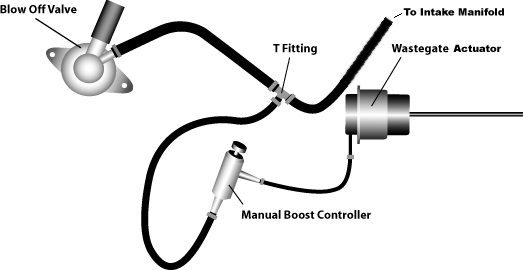

Then where should you tap your boost gauge if tapping into BOV line is bad. that is where I have my Gauge tapped into. The picture shows the J Pipe only has 1 nipple. what if you don't have the nipple.
The boost gauge should be tapped from the vacuum line between the Fuel Pressure Solenoid and the Intake Manifold.
The MBC should use the one nipple on the J-pipe/L-pipe.
nightracer91: Buy a new hose to go between the intake mani and the BOV. Use the compressor housing/J-pipe nipple for a boost pressure source for your MBC.

Hey guys, Thanx. I got a new hose for the BOV and I will be installing the MBC this weekend. So let me make sure I got this right. The end of the MBC that has the ball connects to the the turbo side, and the other end that is 90 degrees to the body of the MBC connects to the wastegate side.

Actually that's a wrong (older) way to go it. More info here - http://www.dsmtuners.com/forums/showthread.php?t=237982
The best way to install a boost controller to prevent boost spike is to have the wastegate at one end and a boost pressure source (j-pipe) or nipple on the compressor as a boost source. You disconnect all vac lines from the boost control seloniod, you don't have to disconnect it.
Yea DGajre777, thats the instructions I used, but I wasn't sure because I've done quite a bit of turning of the knob but I guess I just haven't turned it enough LOL. Could you look at my vac lines for the mbc and see if thats correct? With the 10psi that bleeds to 7psi is what kinda concerns me about the install of it.
Take it off, if it comes apart, and see what side of the spring the ball is on. It should be on the wastegate side of the spring. It should go from spring > ball > nipple on MBC > wastegate.

You might not have noticed any difference in "boost spike" but I'm almost positive that your BOV is open under boost. Do not tap the BOV line!!
