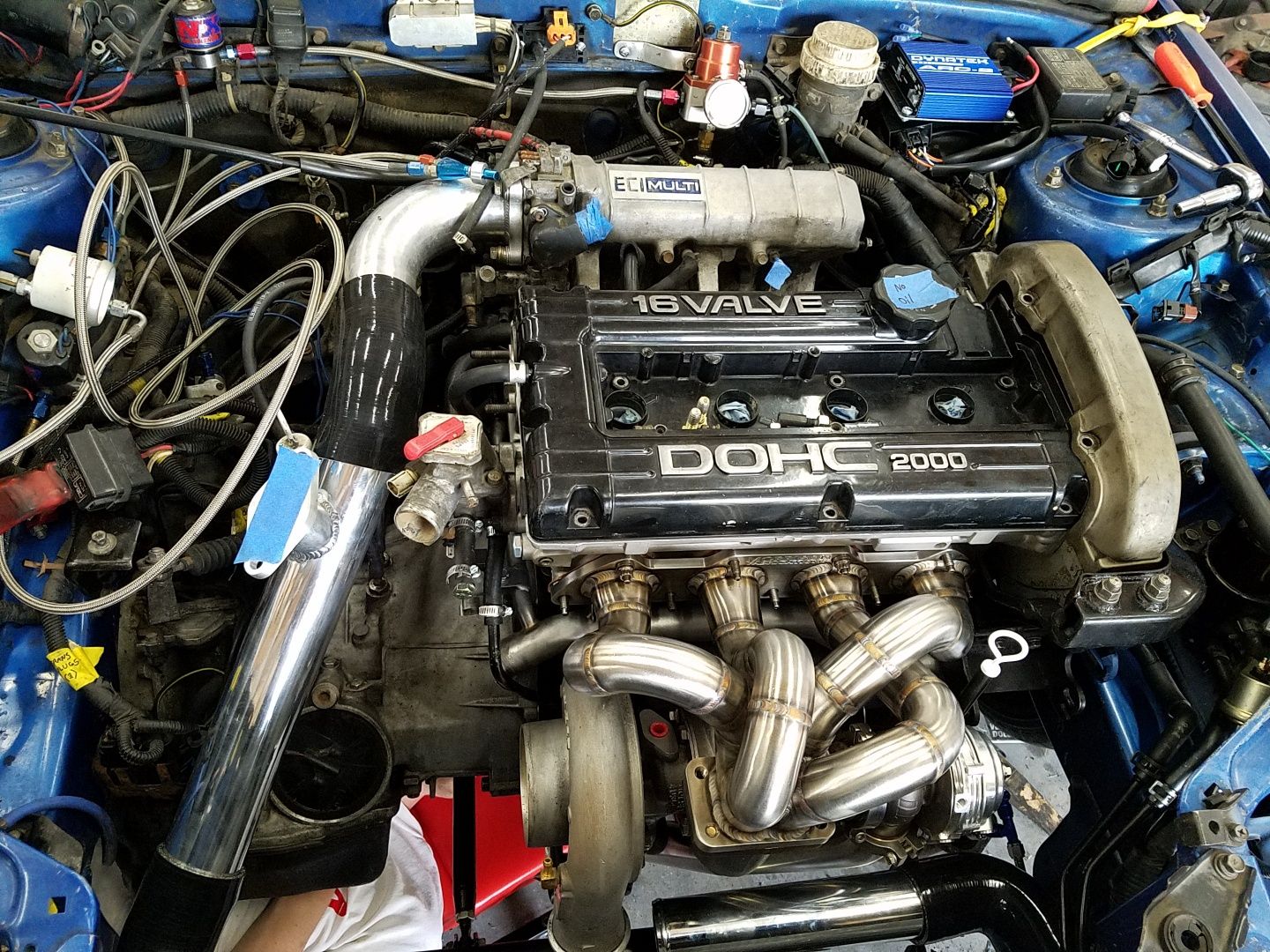

No problem, I'm learning as I go also. Only other thing I may change soon is the addition of a Arc-2 ignition box for the 2 step instead of using link. Everyone says it will leave more consistantly with the Arc-2 bc it is ignition cut, and not fuel cut. But for now, I'm going to just use ecmlink to make a few test passes.
ARC-2 is the way to go, it’s far more consistent and will help you dial in the launch.

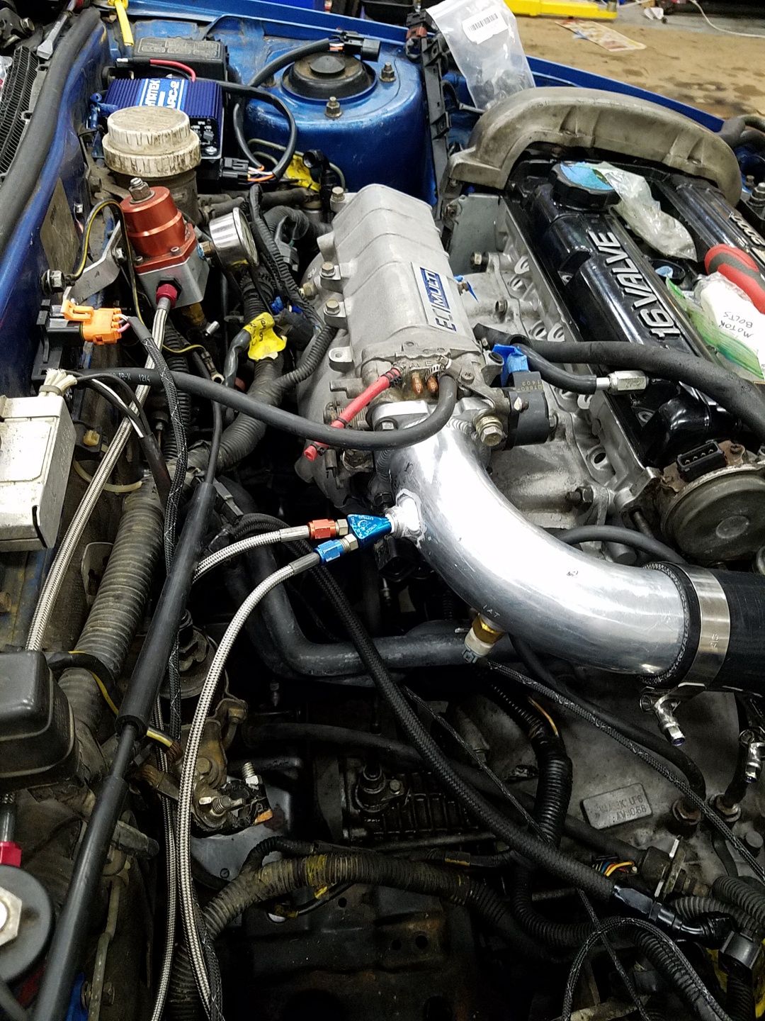

Well, since the stock converter wouldn't stall up to @ 2200-2300 rpm and @ 2 psi, I figured I better try to solve that problem. After playing with timing and different air/fuel ratios and not seeing good results, I installed the nitrous kit I had laying around.
I started with a 35 shot, and 3500 rpm 2 step. The nitrous got it there, but took longer than I wanted it to. Car still bogged after it started moving, so I raised 2 step up to 4k. Reached @ 10 psi, but still fell on its face after it started moving. So, I decided to let the car cool off and throw the 50 shot jets in, and raise 2 step to 4500 rpm. Seems to work a lot better. Leaves on @ 18-19 psi, and just chirps the tires. Few more tries to get everything right and should be ready to turn the boost back up to 30-32psi. These pulls were @ 22 psi, and shifting early....

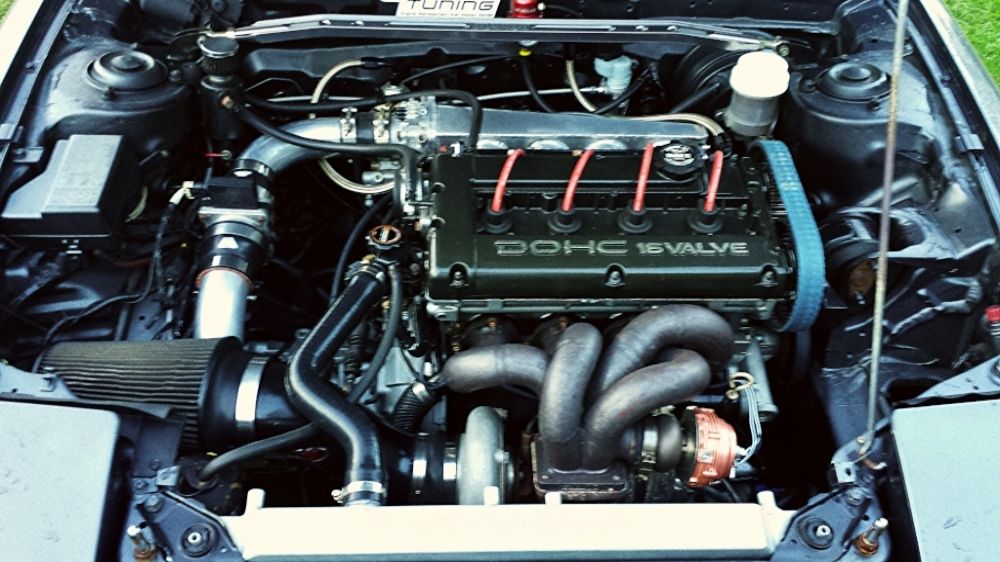

Been awhile since I've updated, so I'll post a quick catch up post. Ended up swapping to a 2g head/Evo 3 intake manifold, and added some L19's in place of the old standard arp's. After getting all that done, I was finally able to get the nitrous stall up right with some help. So.... Now it's time to hit the track.

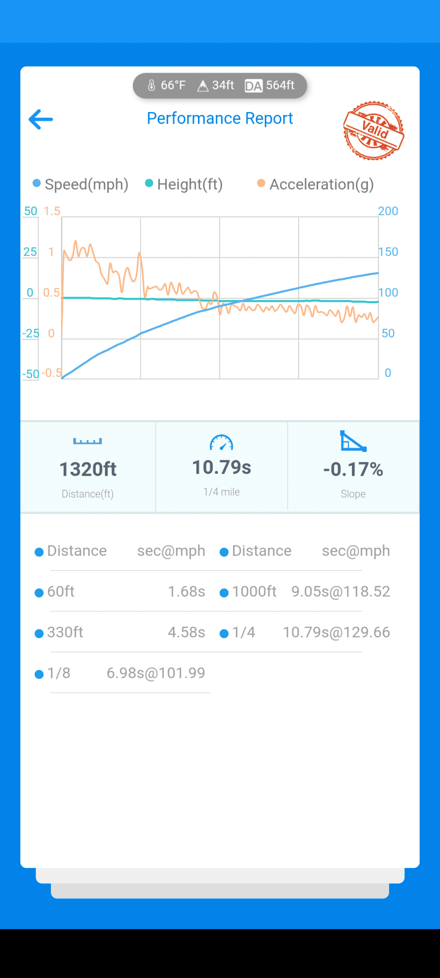

First pass I pull up and stage the car, but instead of sitting on the 2 step for a second... I just left soon as it hit the 2 step. Ended up rolling out the 60ft with a 1.78 and the 1/4 at 11.0 @ 126mph. I was still happy because the launch was turned down to where I launch on the street with my street tires, and I was only at 28psi. Let the car cool off for a while and added a little duty cycle to the boost controller and went back into the lanes. Well, it started raining. Rained just enough to get the track wet where they couldn't dry it, so they cancelled the rest of the day. Since I was so close to my goal (10.99 in full weight/street car) I was frustrated.
So... I ended up bringing the car home, took it off the trailer, and took a short drive to Mexico with the Dragy. Same settings I had at the track, I just sat on the 2 step a little longer to build a little more boost. Ended up going a 10.7 @ almost 130 in the street. Took a look at the log and boost only went up to 29psi, so there is still plenty left in the car. I think at the track it may have went a 1/10 or 2 faster.
