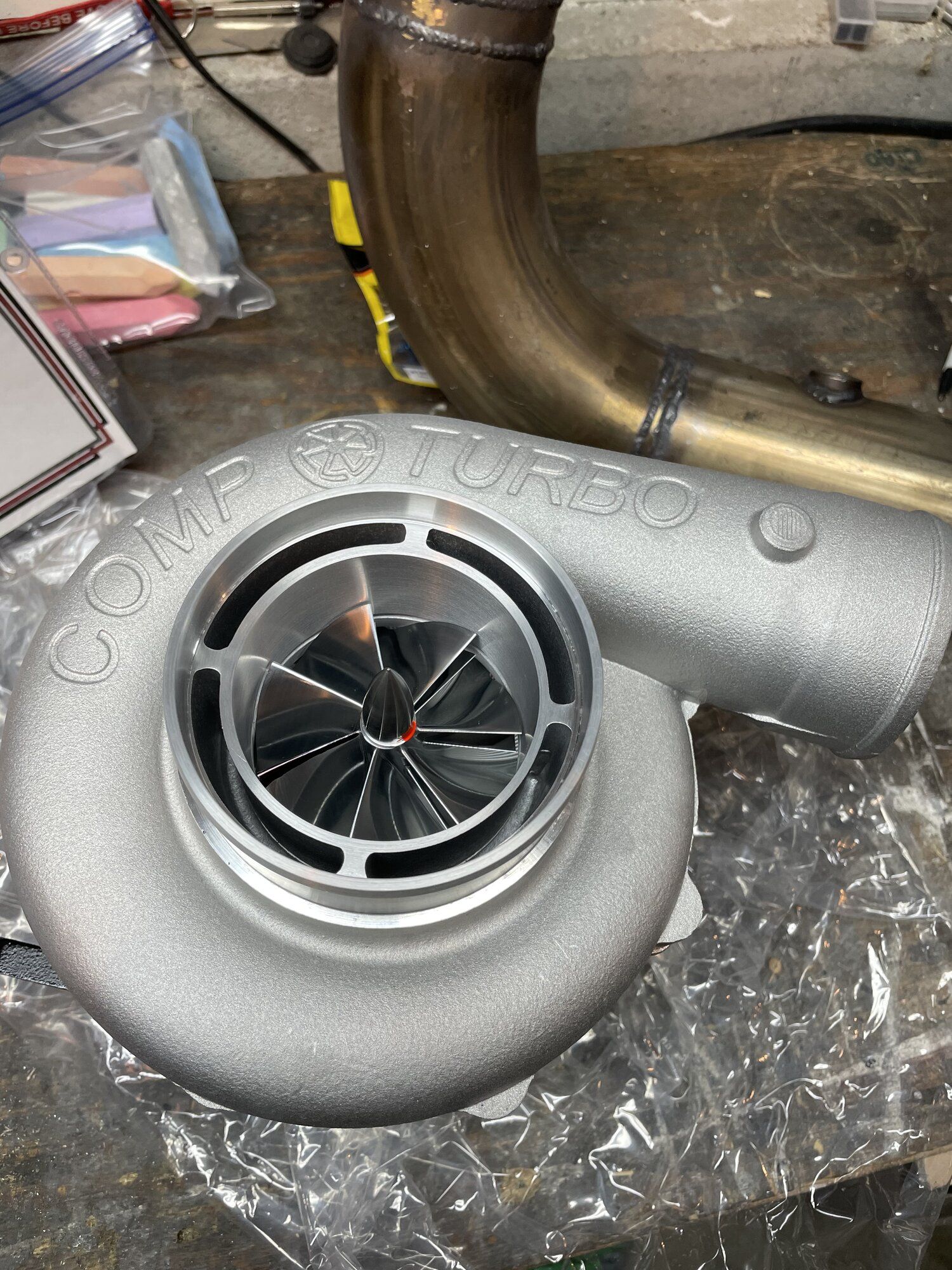

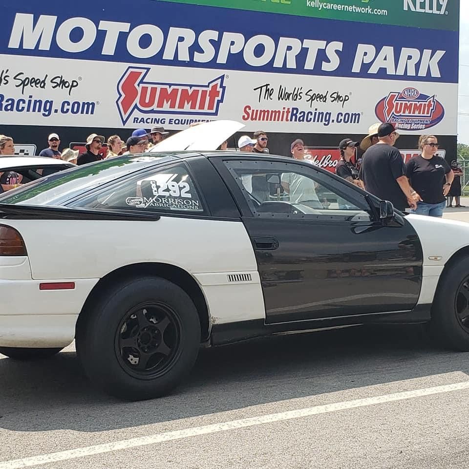

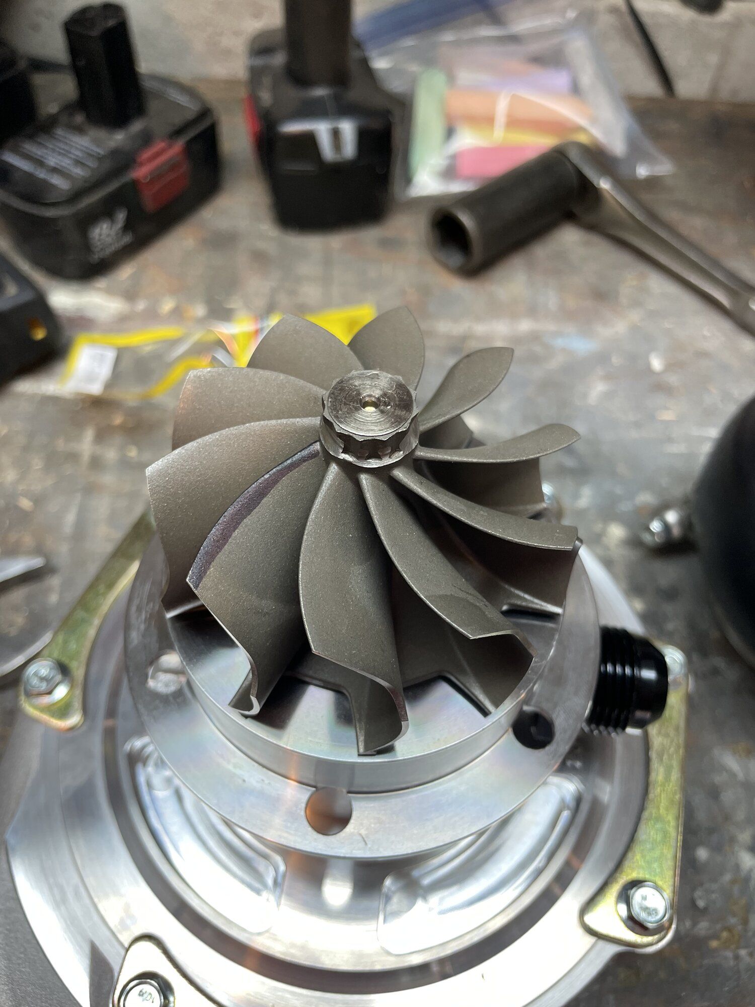

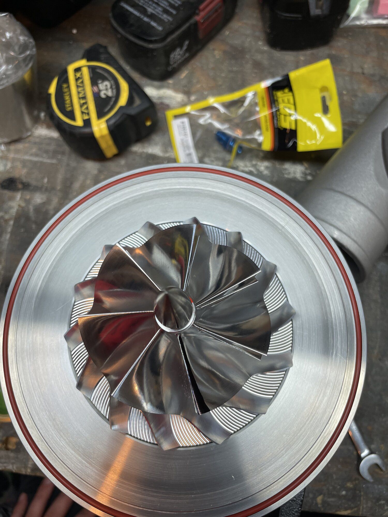

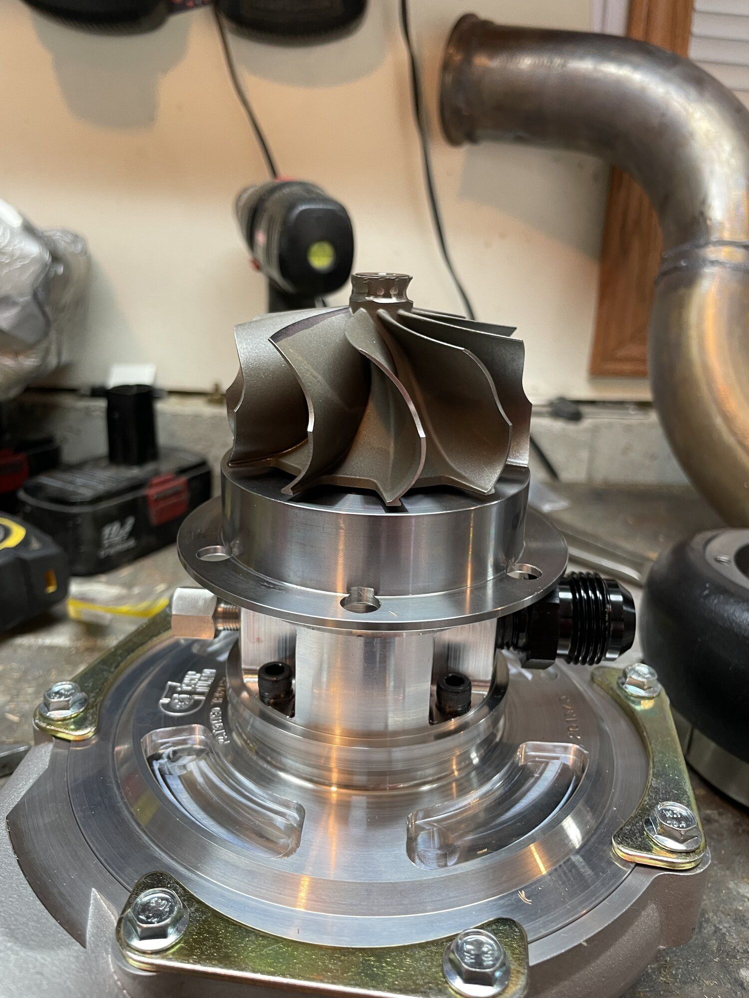

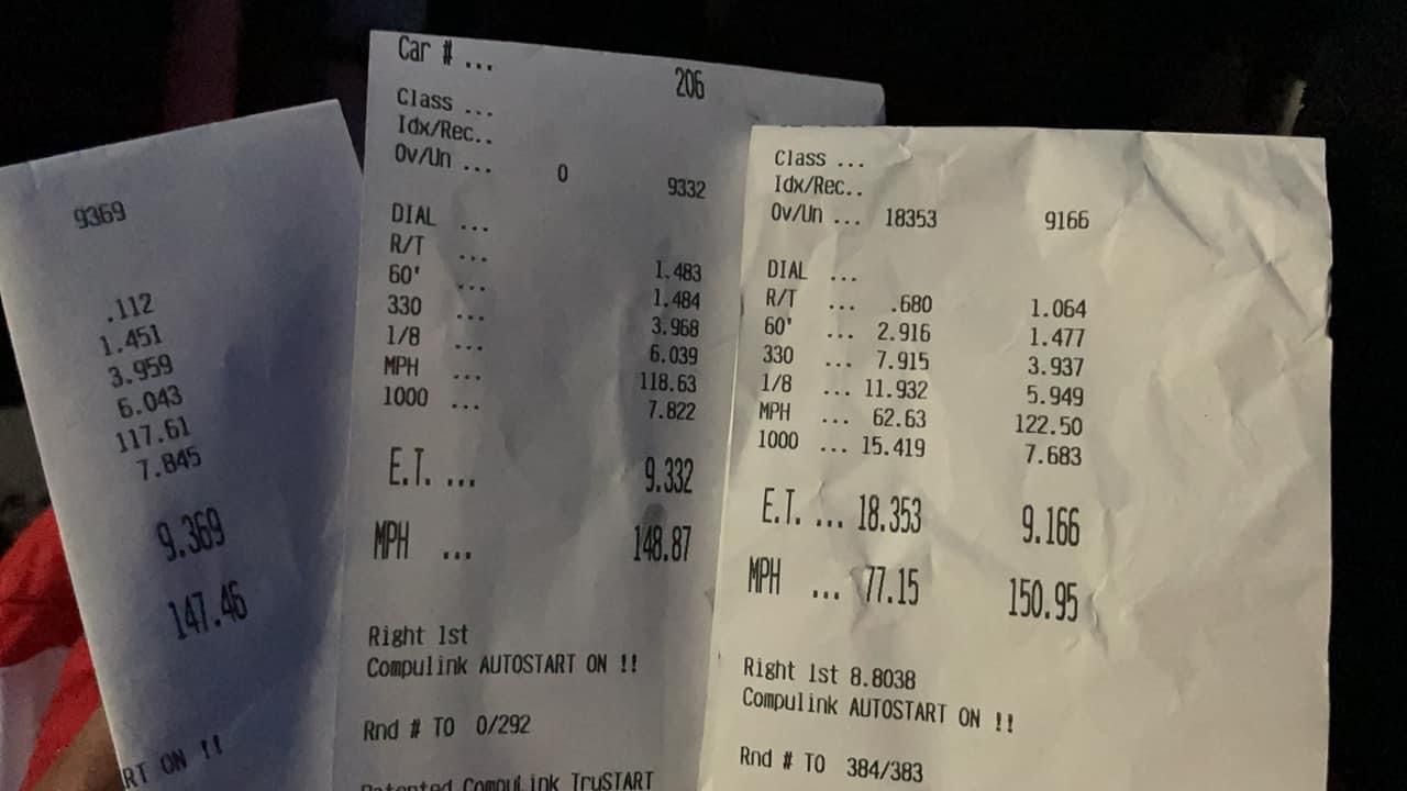

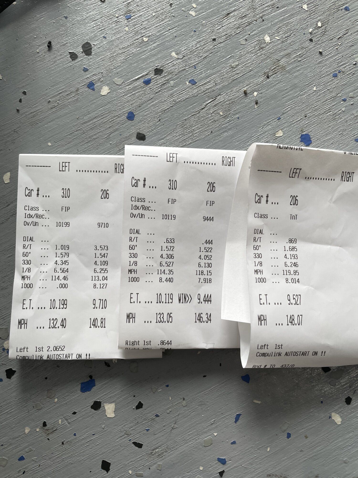

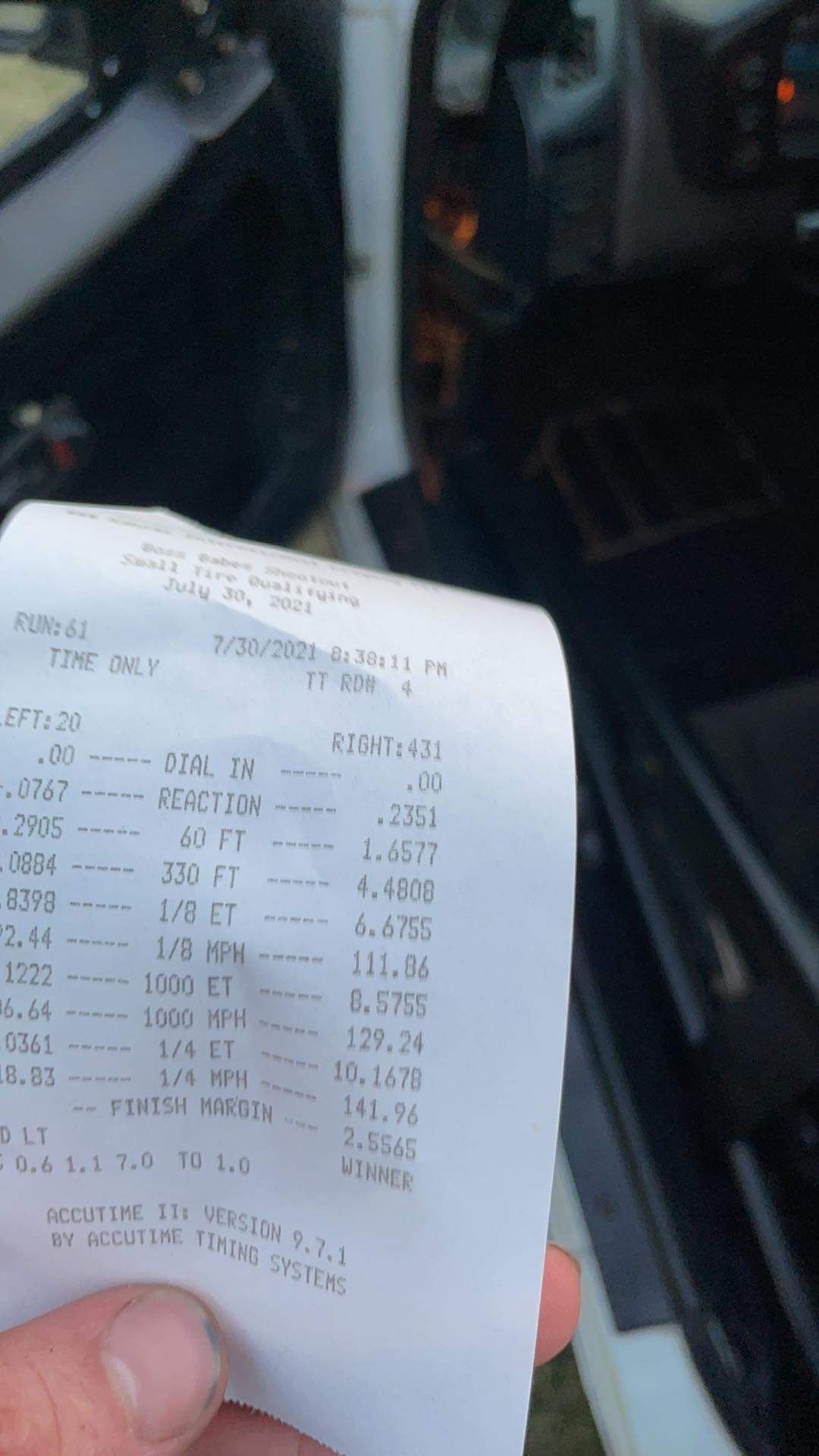

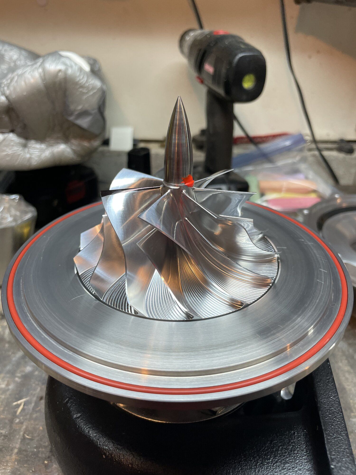

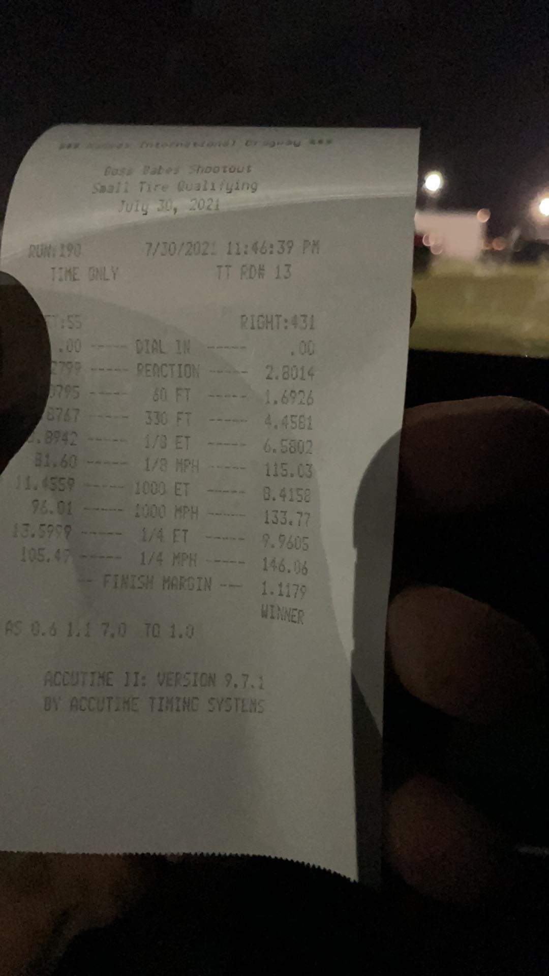

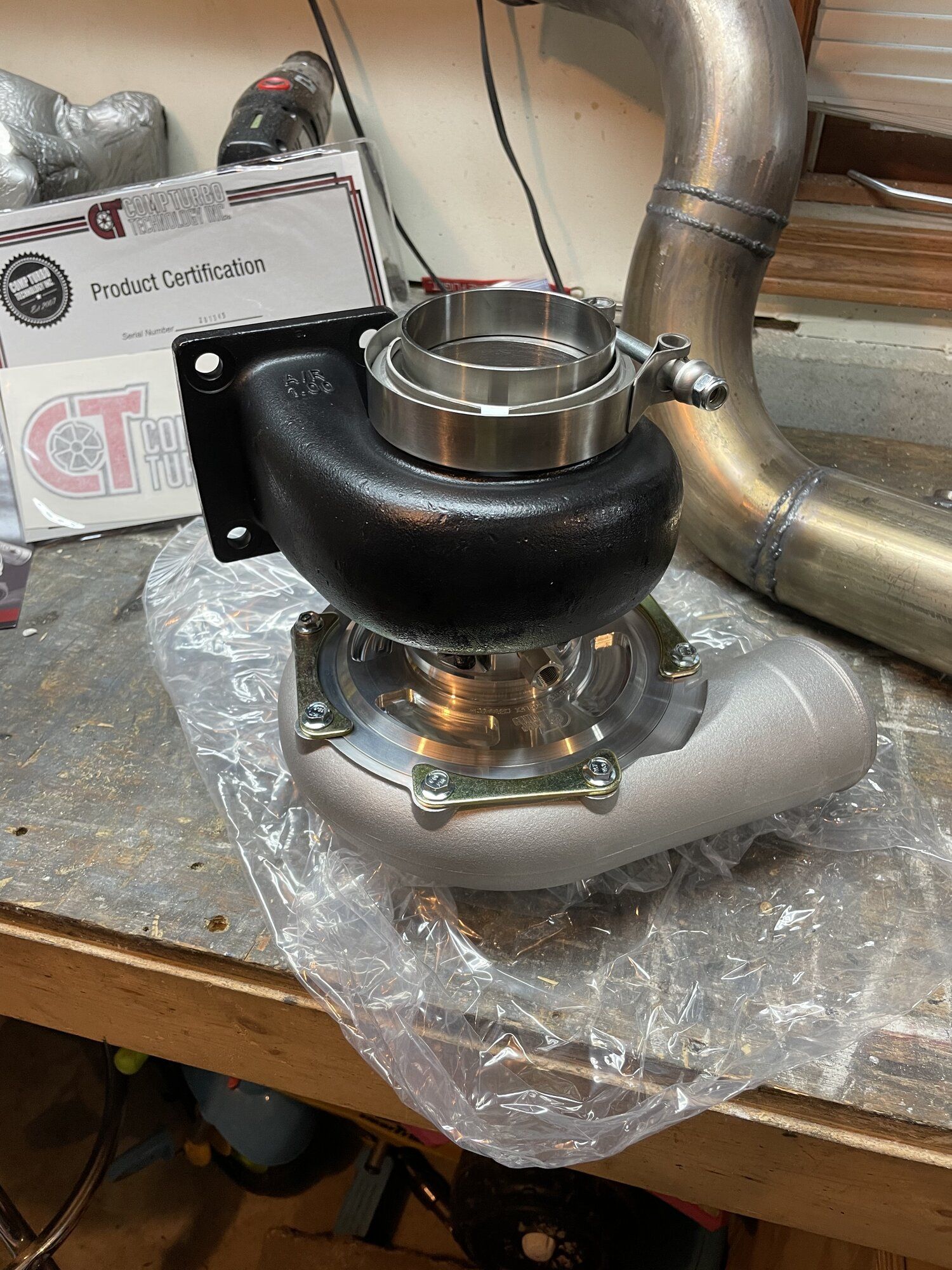

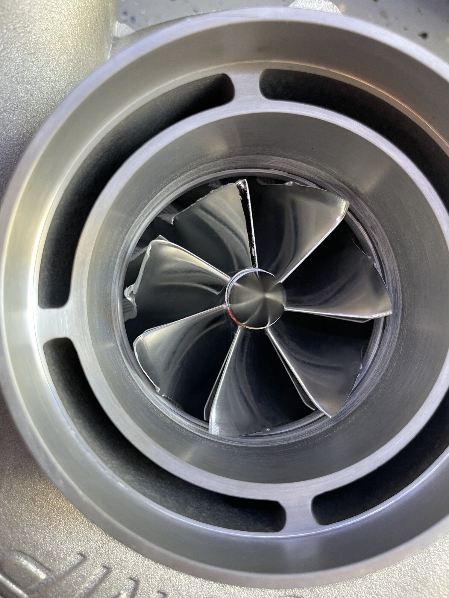

I part of me wanted to go with the 1.15 but the guys at comp advised me to go with the 1.0 so I’m giving it a shot. Made a last minute decision to drive down to Wichita and make a few test hits before the shootout. It was 100* no lie and da was 4500ft insane. I made 2 hits the turbo survived. 1st pass was 10.16@141, 2nd hit 9.96@146. I took out 2* of timing from the entire map and had to add 13% of fuel from 6k up so it is definitely flowing more. The crap times were because my super weak 1.6s 60ft. Wastegate duty cycle is 45% compared to the super 99 at 100% with 100 shot of now. I had the nitro 50 shot shut off at 20mph and let the turbo do the work. The 146mph pass was on 49 psi keep in mind insane temps and da compared to 1500 2 months ago on the 8.9 pass. I bought a vacuum canister I need to hook up so I can raise this launch rpm to at least 4500 to get me out of the hole. Turbo is still alive and tight, no oil blowing etc.I’m curious why you didn’t go with the bigger turbine housing (1.15 divided)?
Any feedback on the new turbo yet?
I’ll be there for sure. The biggest change was going to 7% transfer gears. It was a huge gamble and only one way to find out by trying it. I would say that’s the biggest hurdle on short track. It’s gaining 30mph + on the back half so making some jam. Hopefully raising the launch rpm will get me back to where I need to be.The deadly combinations is killing your ET/MPH.
I would guess mid 8s with your current boost level no problem. Hope you make it to the SO.

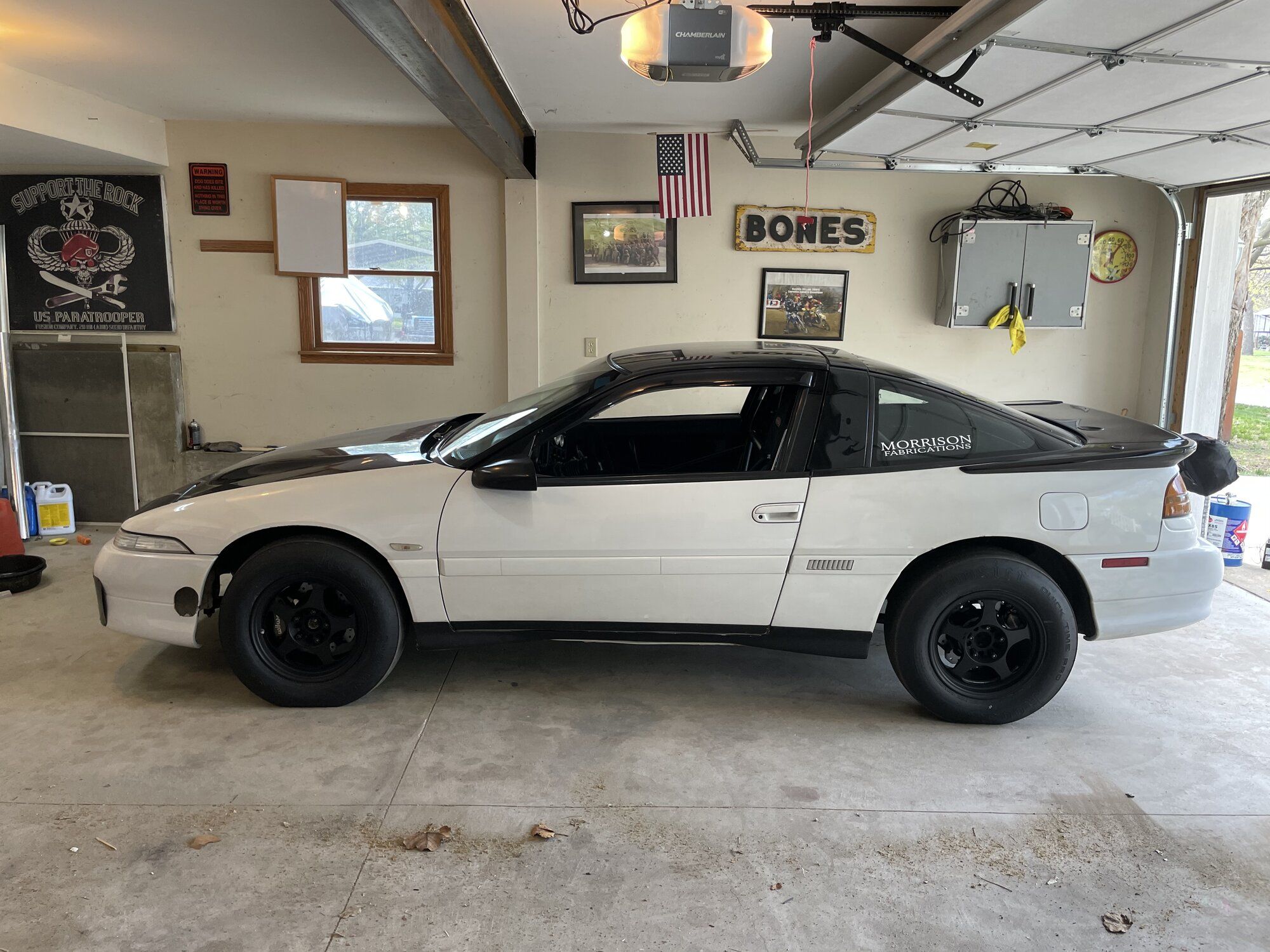

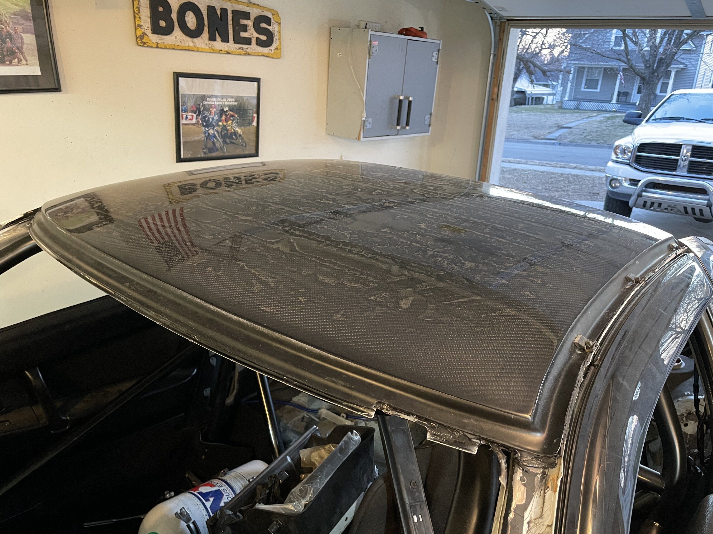

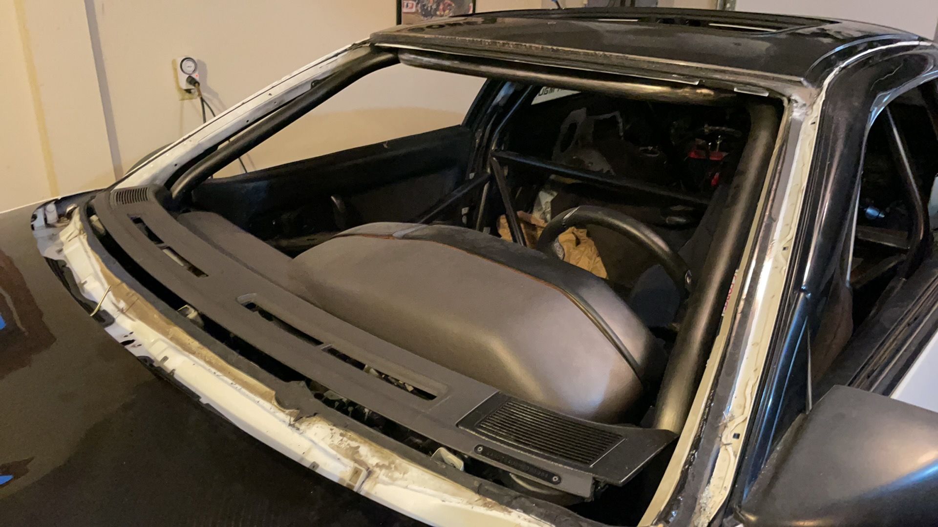

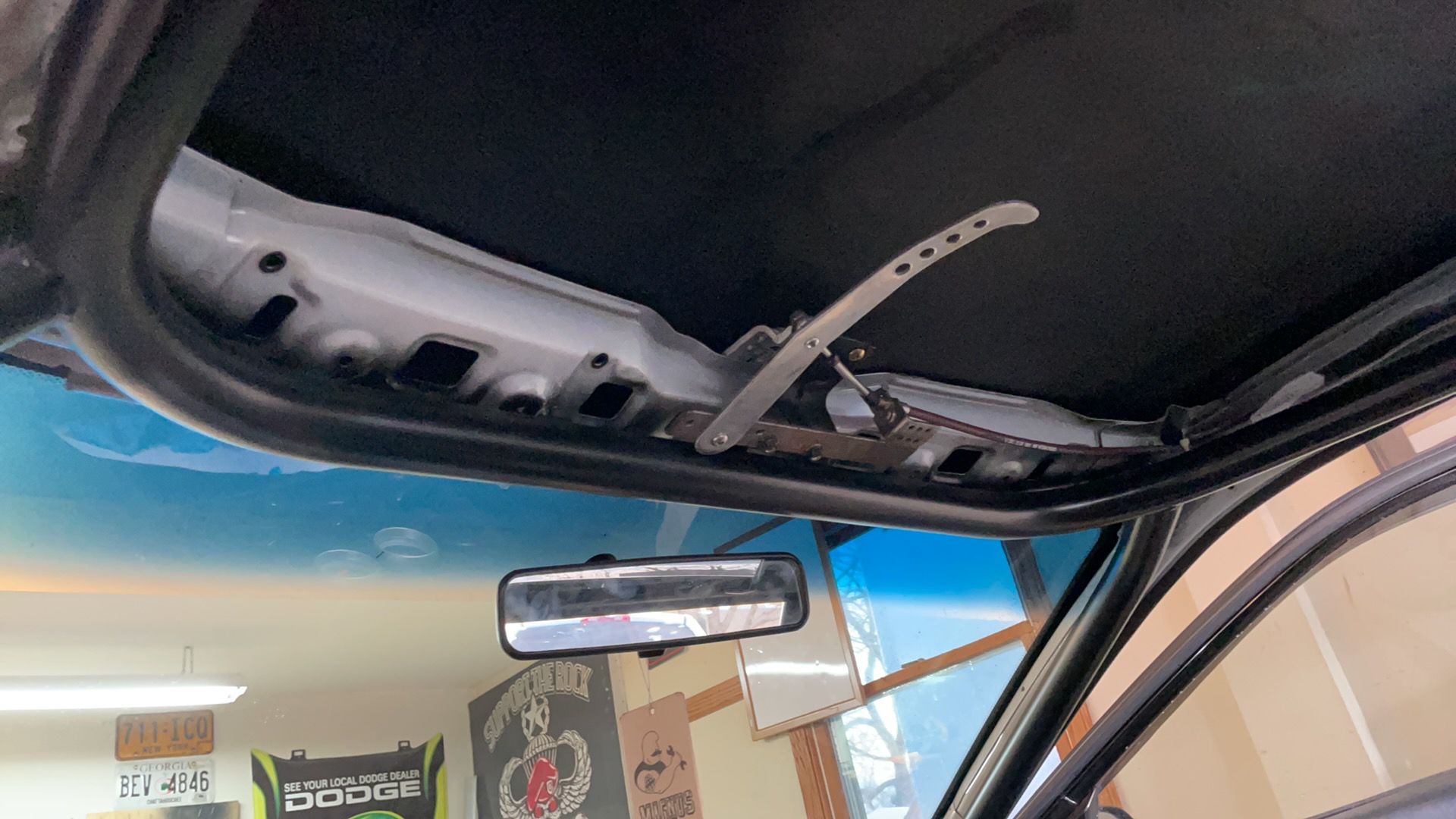

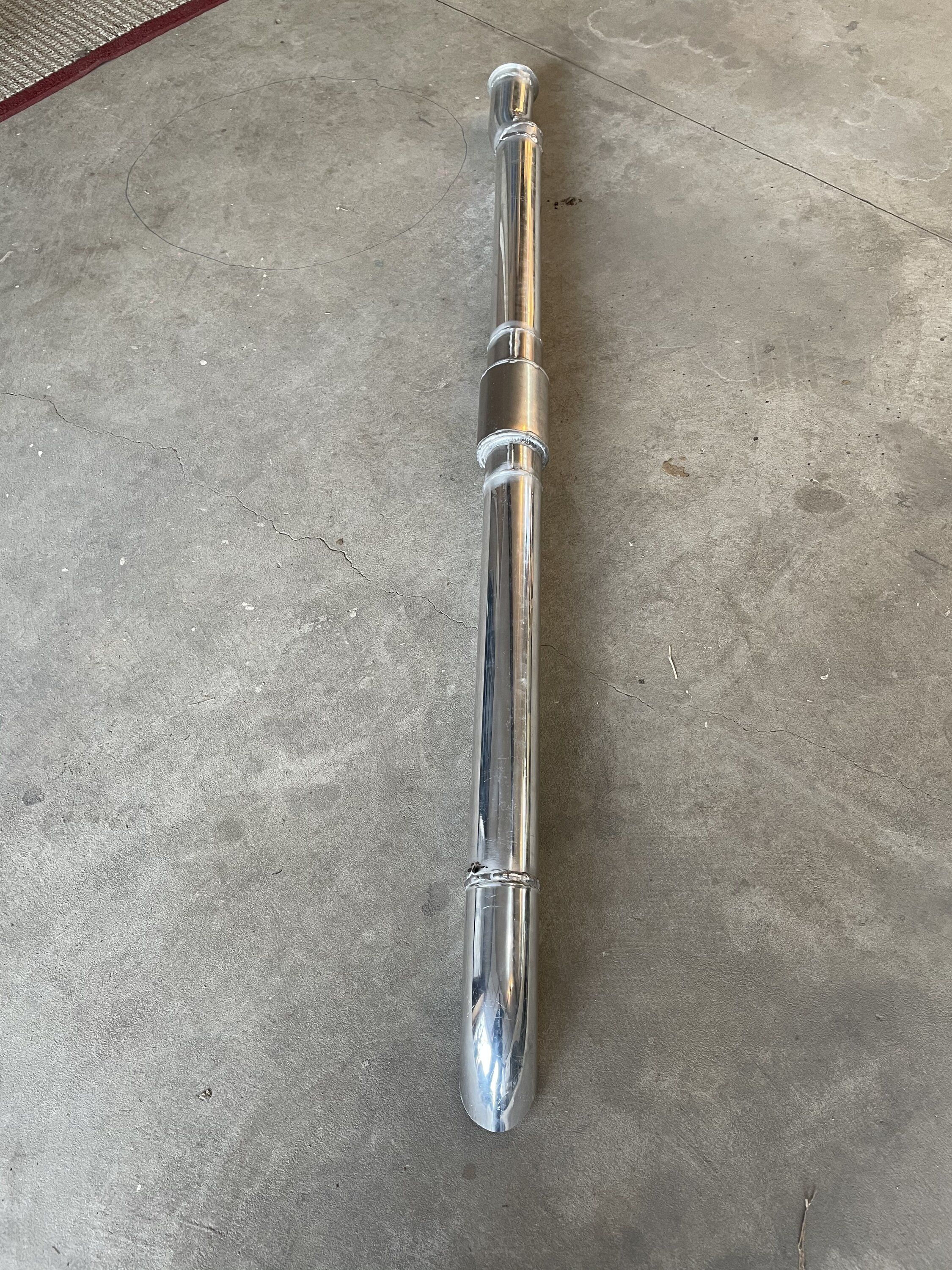

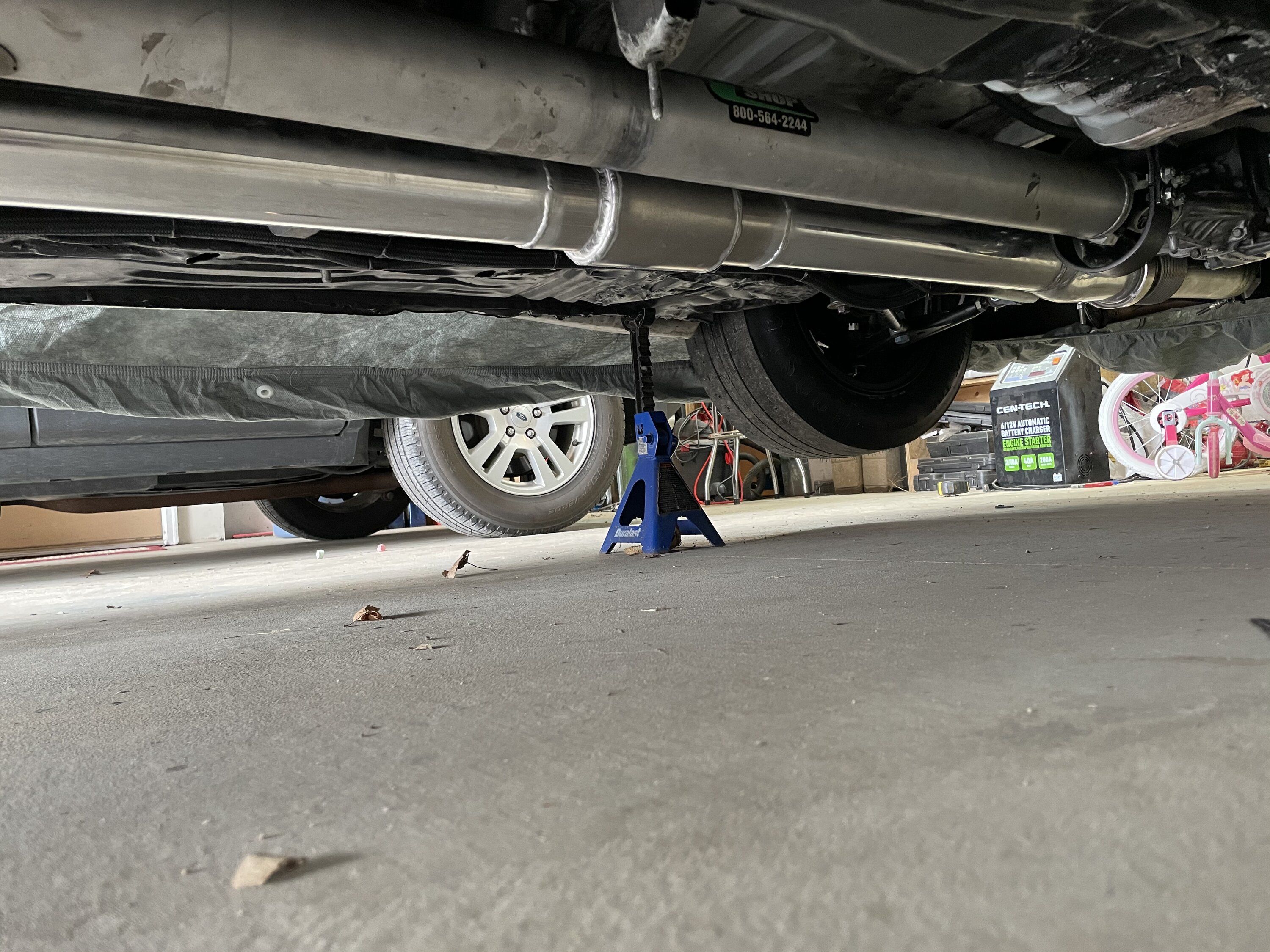

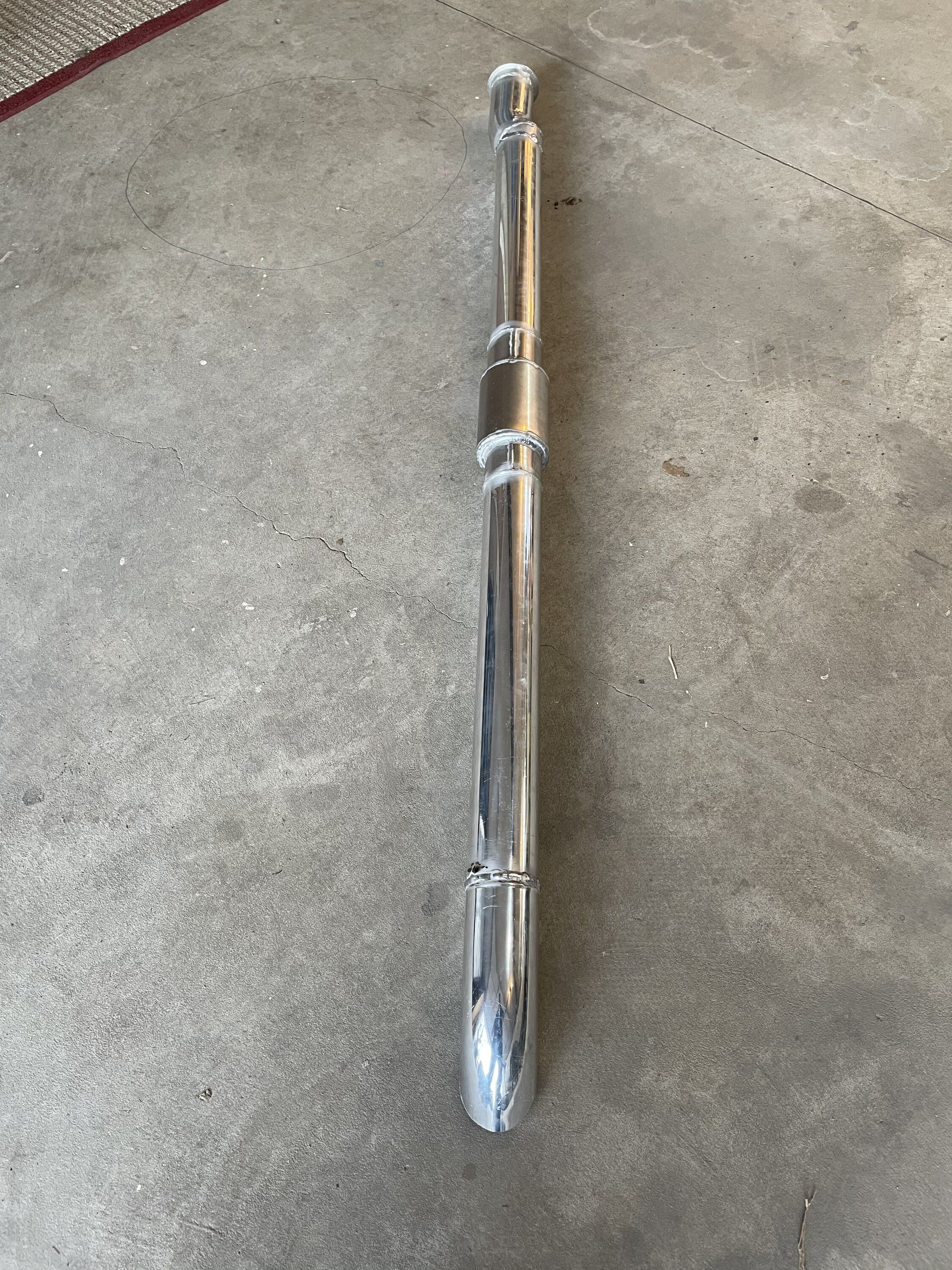

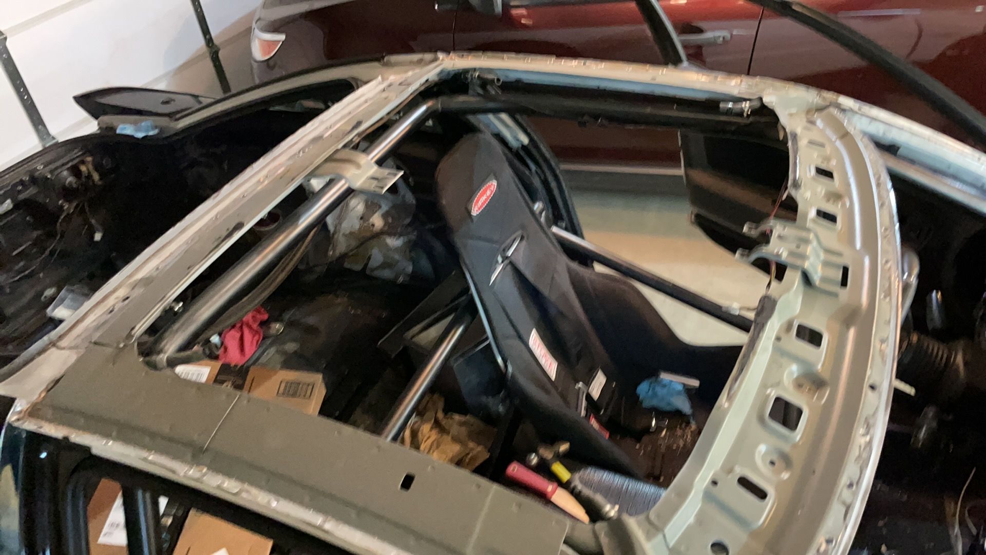

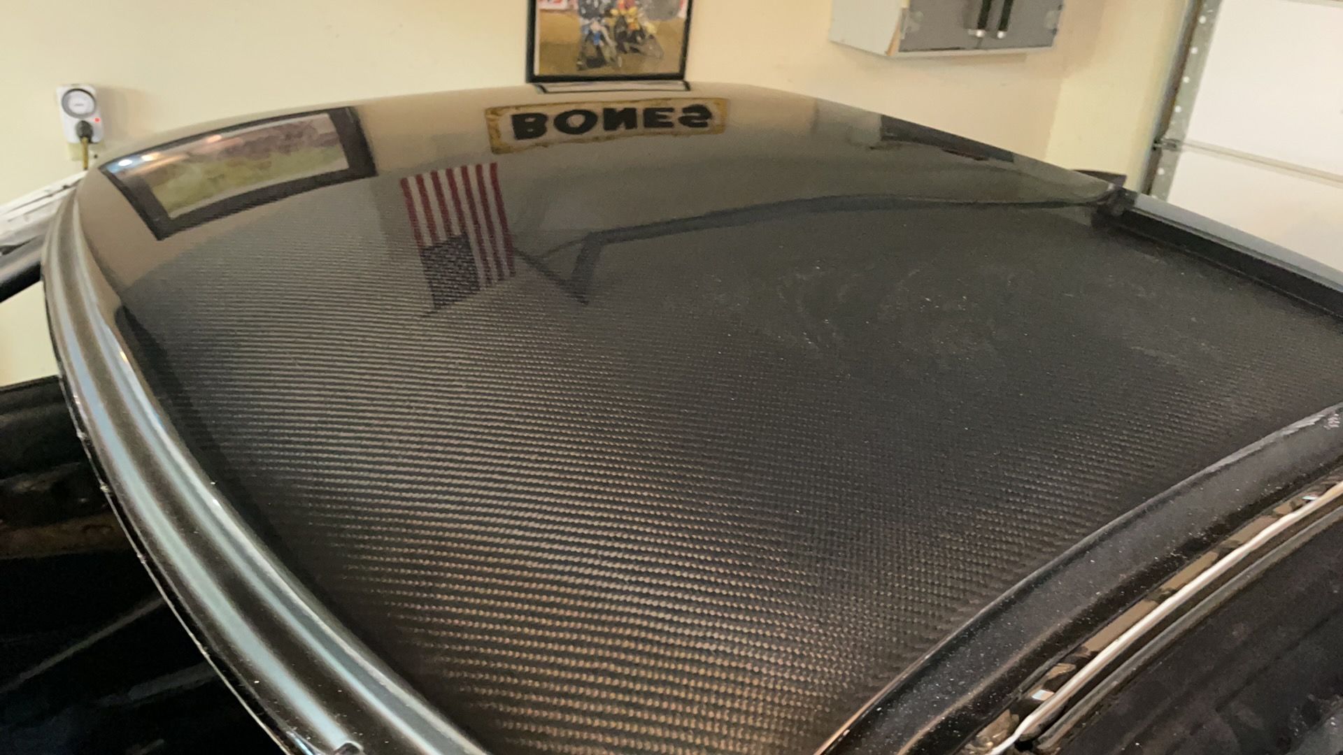

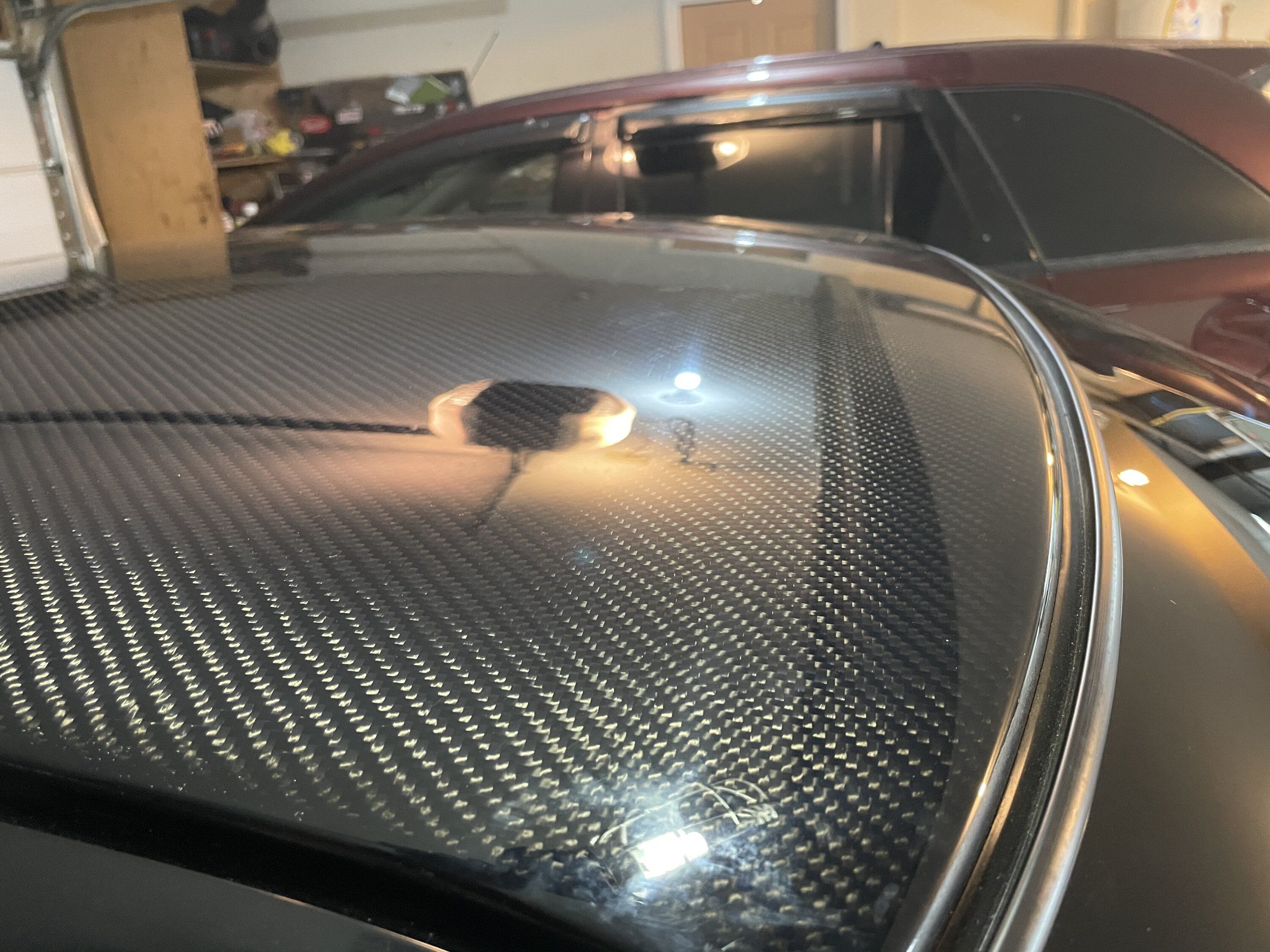

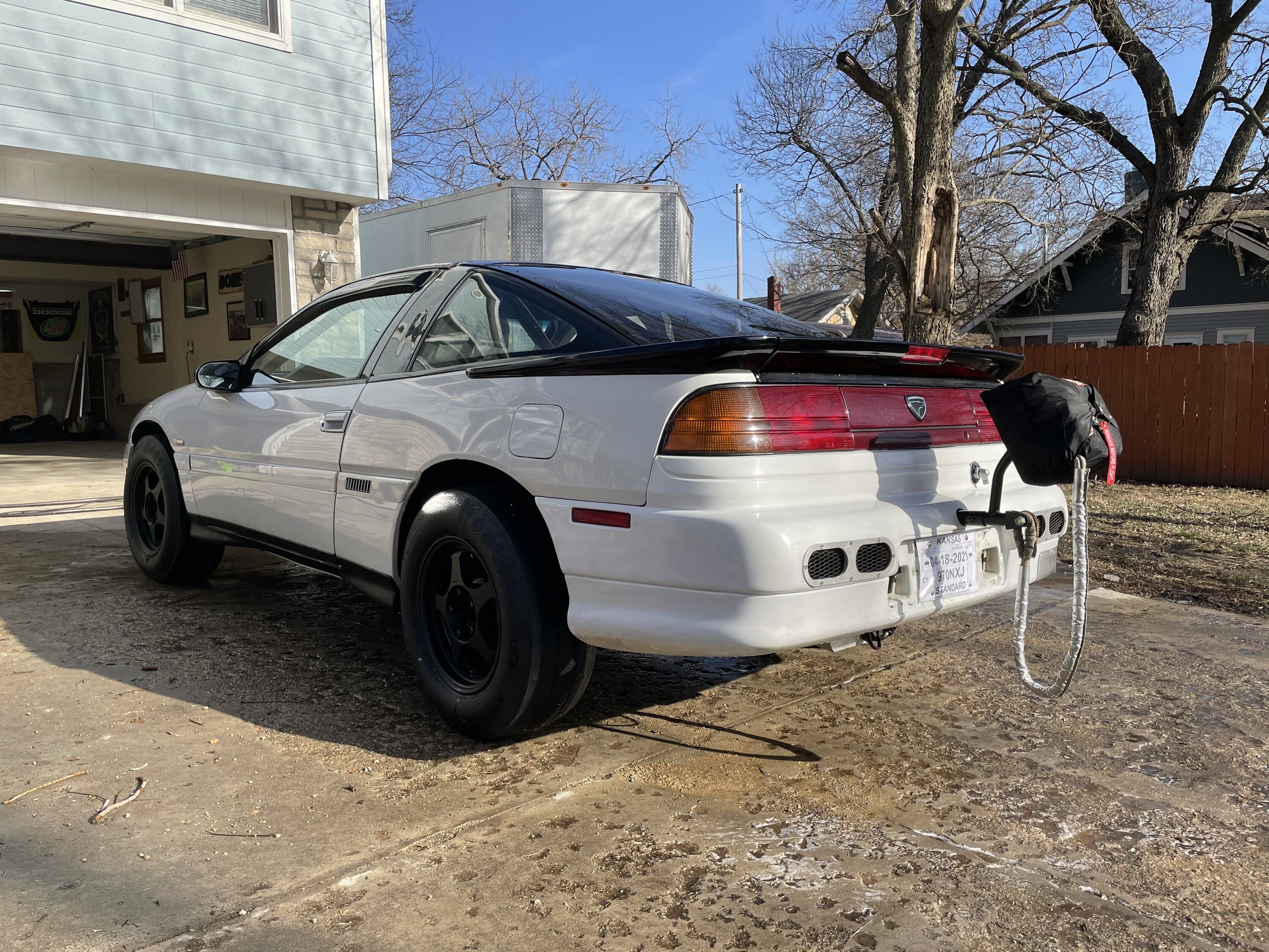

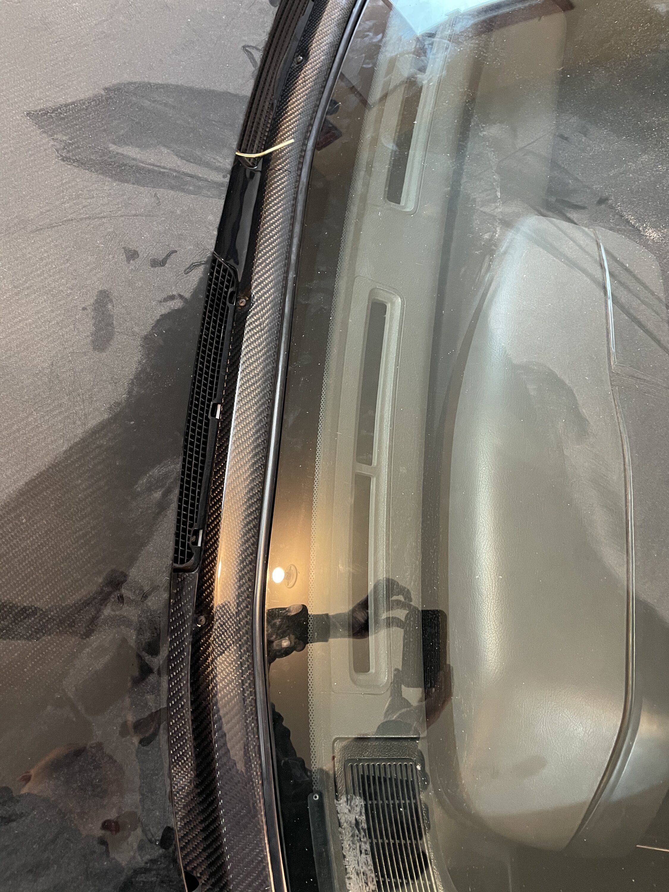

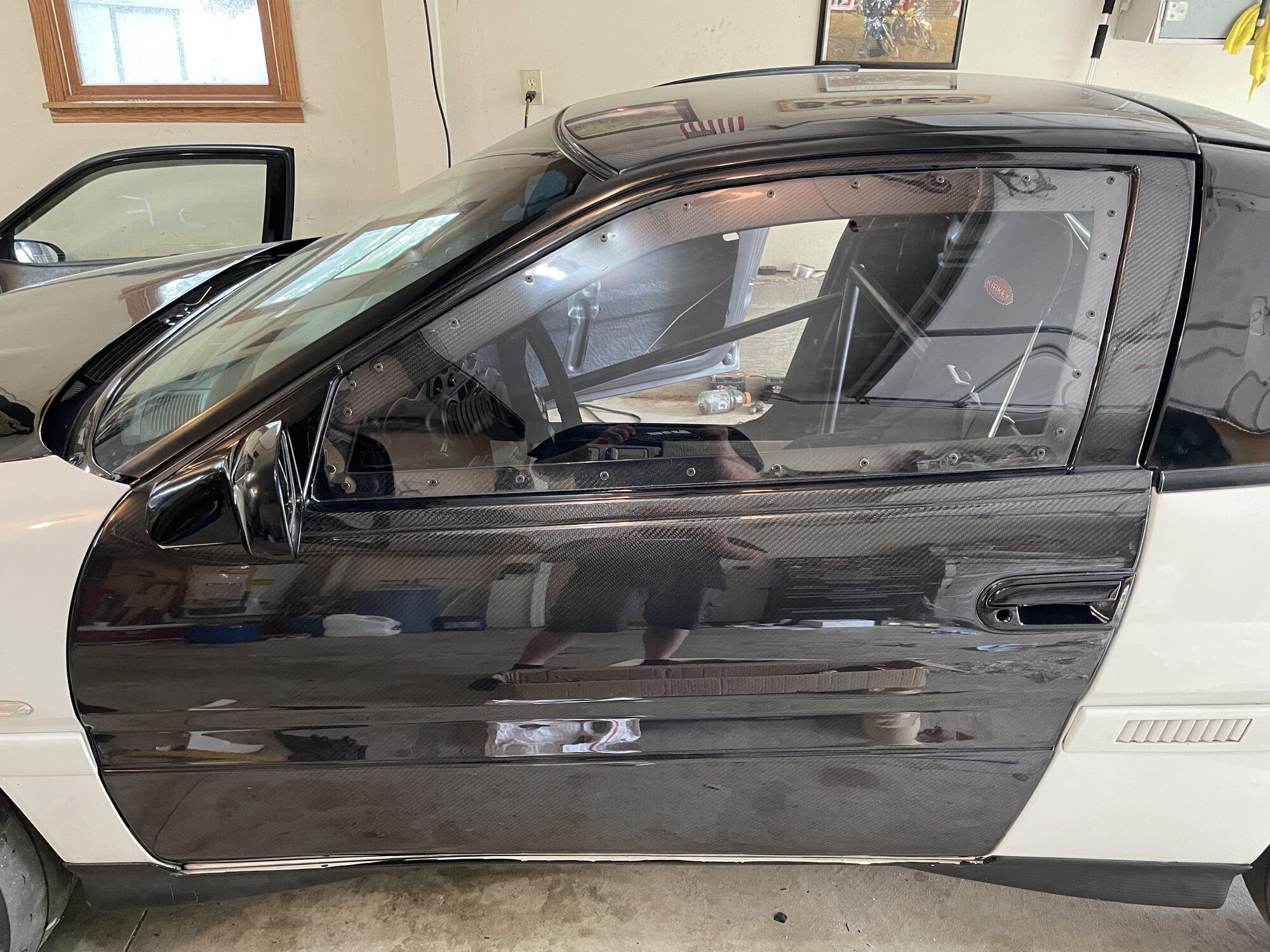

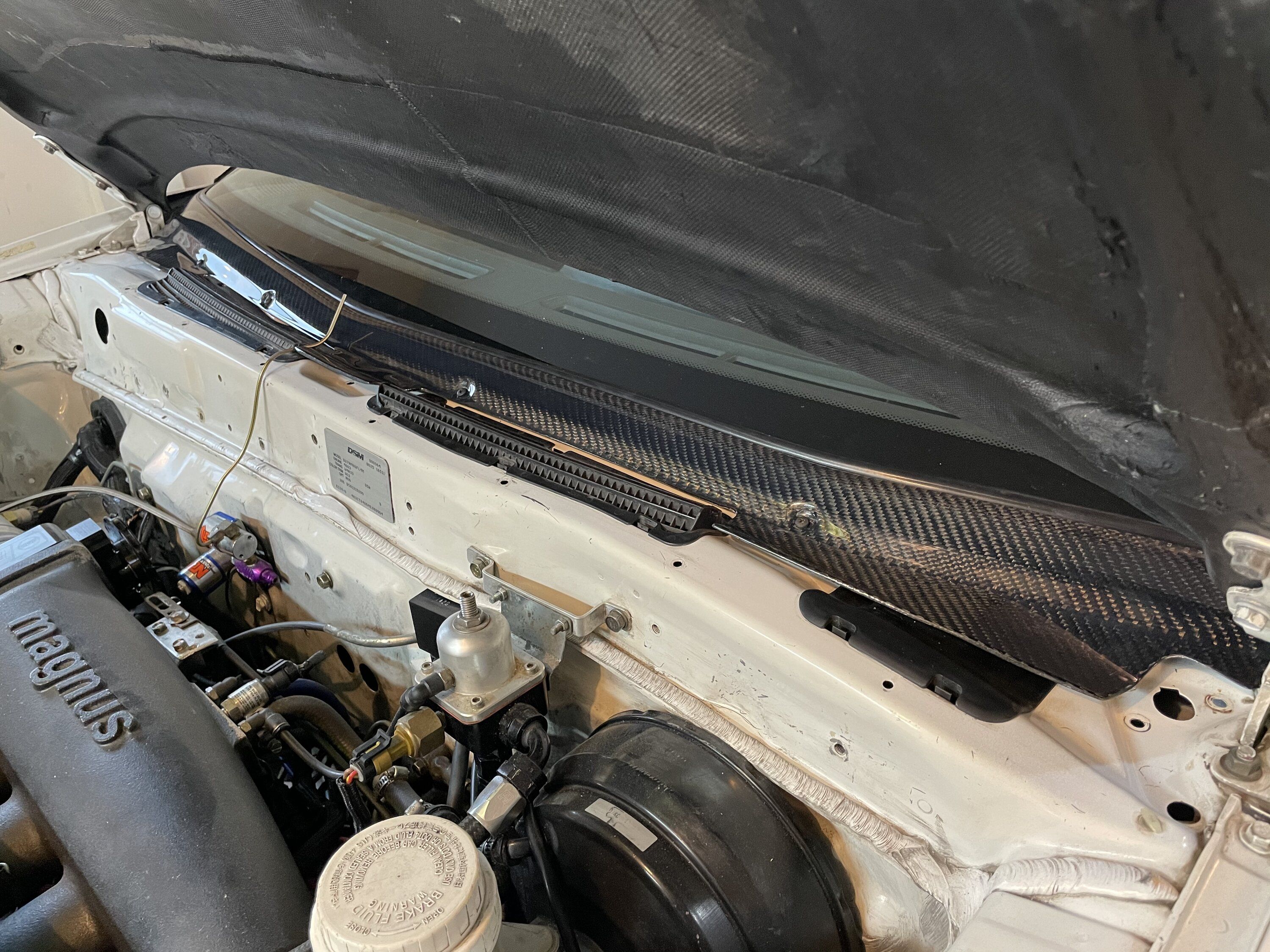

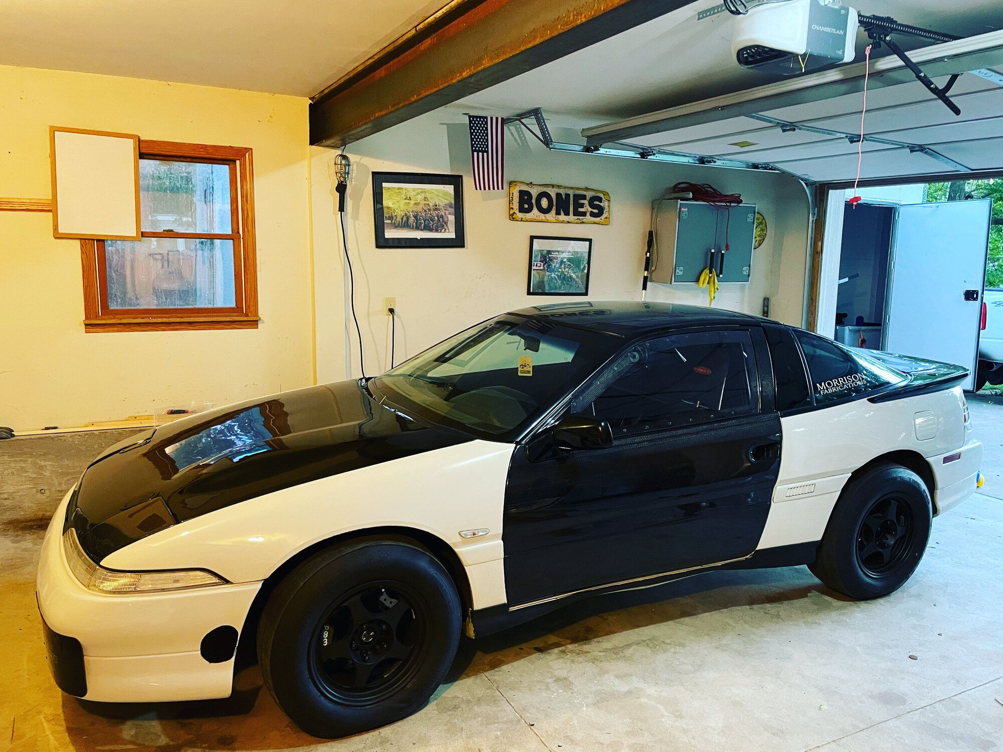

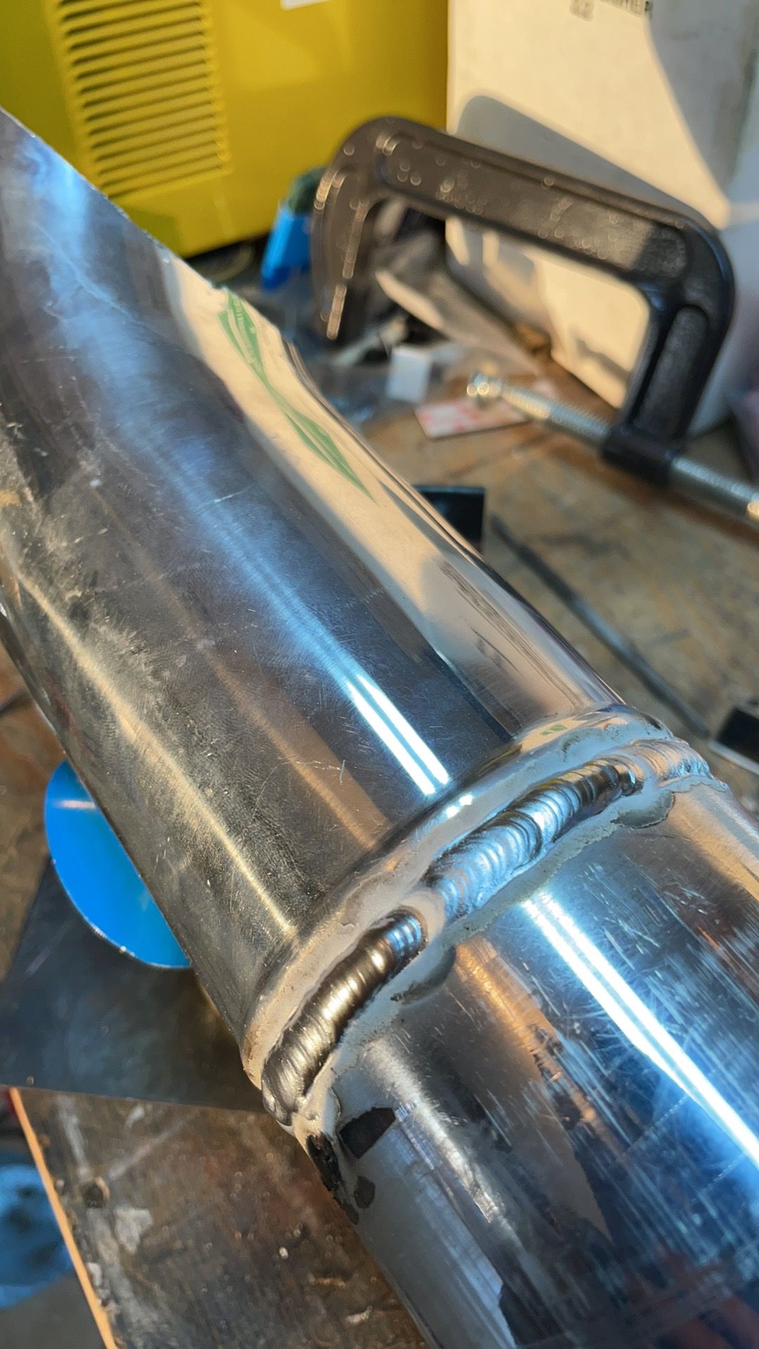

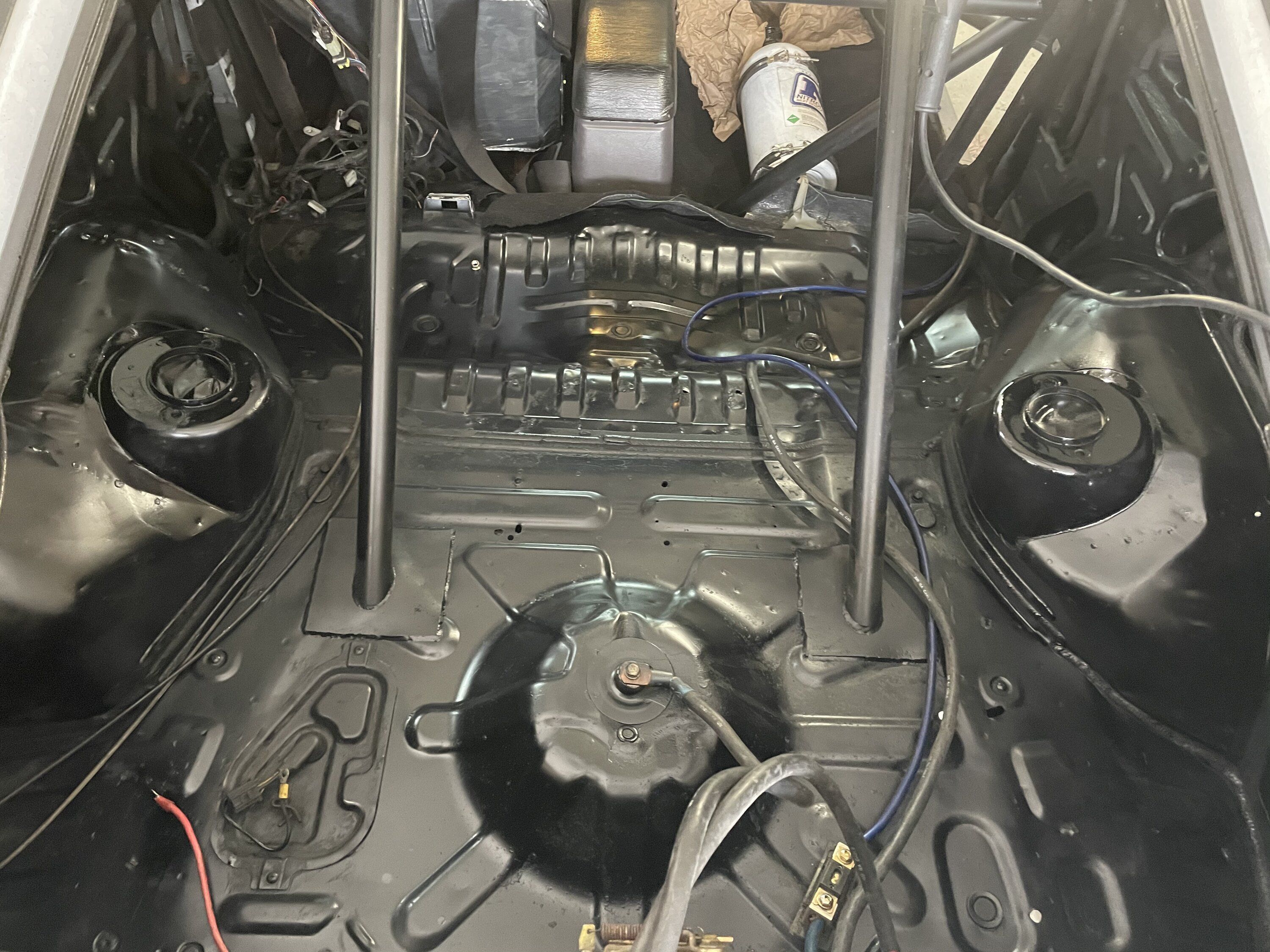

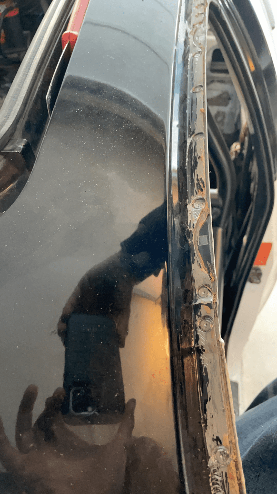

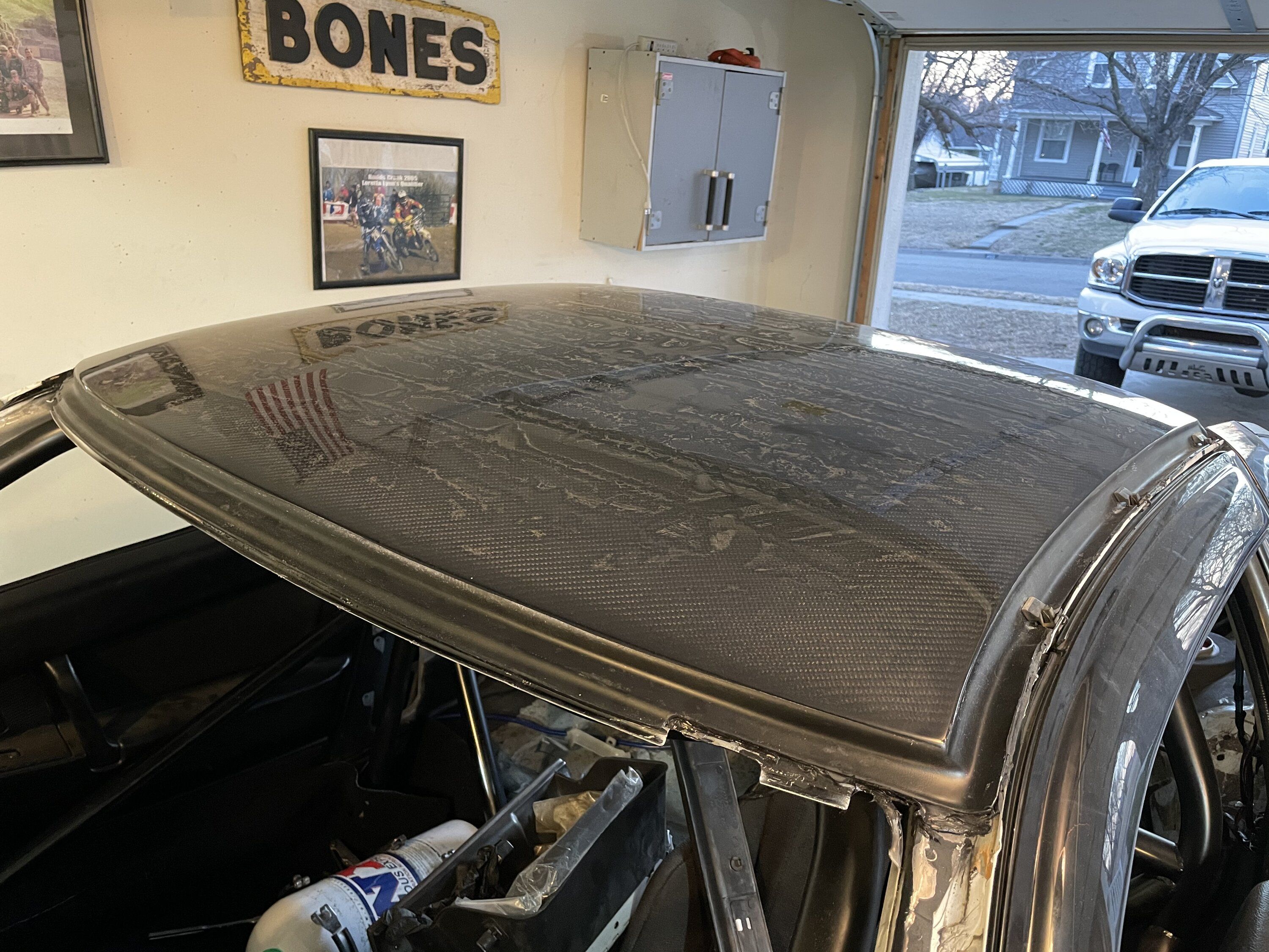

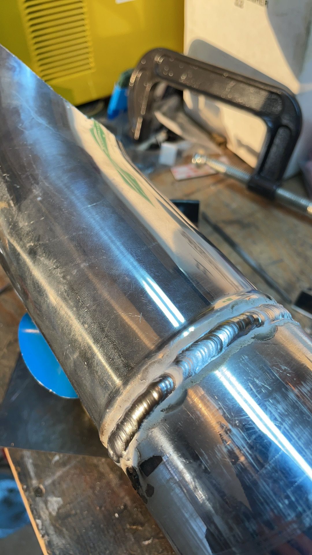

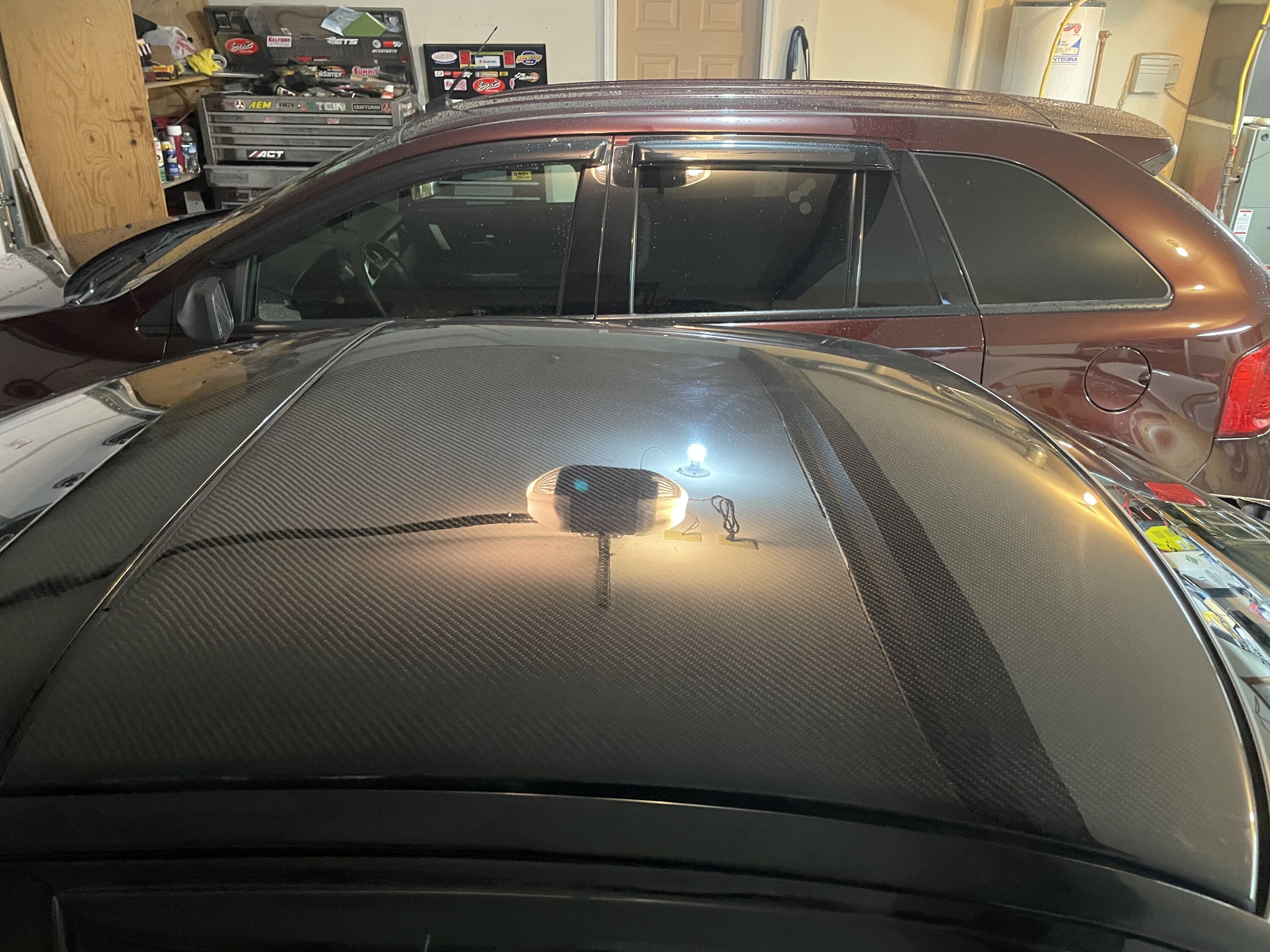

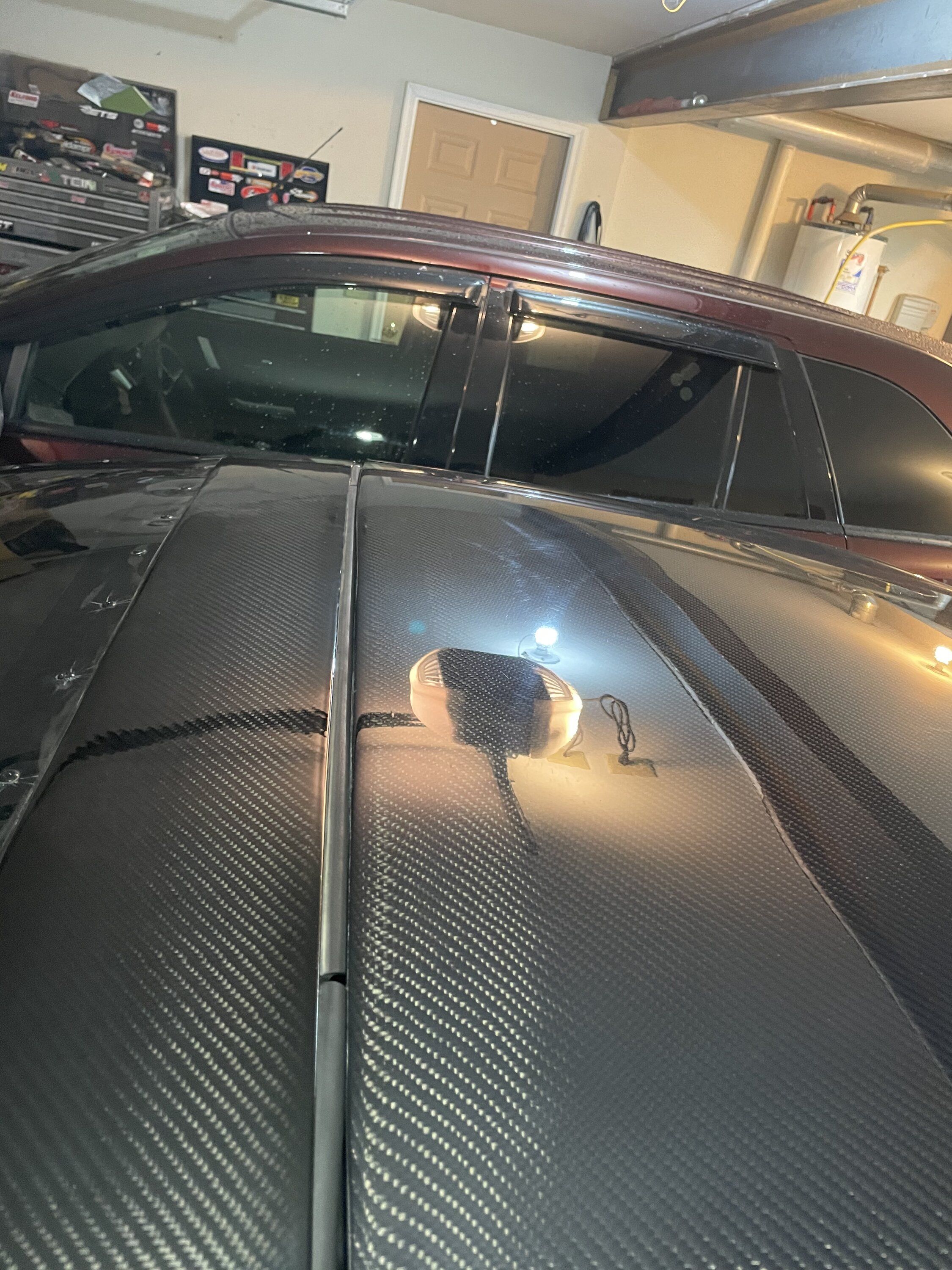

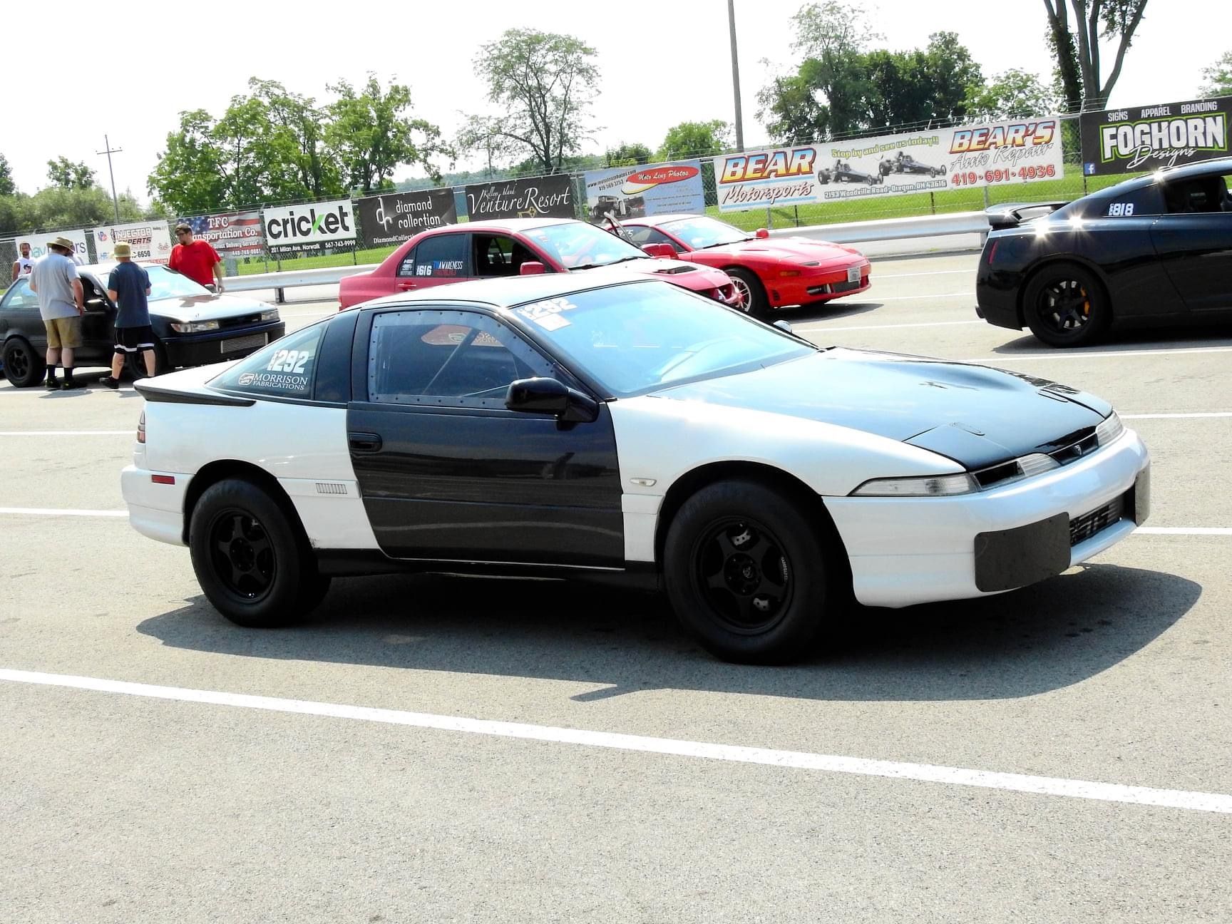

View attachment 623981 View attachment 623982 View attachment 623983 I originally wanted to run the exhaust all the to the rear bumper but after thinking some more on it I decided to end it right before the rear differential. More of a weight thing but after I test it on the road I’ll decide if I need to take it all the way back later on. I’m happy with how it turned out and so much quieter than the side exit at idle. It’s nice to actually hear the engine again. I will end up fabbing another side exit for the strip only. I also finished the roof installation not a hard job just time consuming. I didn’t realize how hard it was to find a 1G windshield but safelite is coming to install that on Wednesday. Feels good to be closing in on driving it again.
