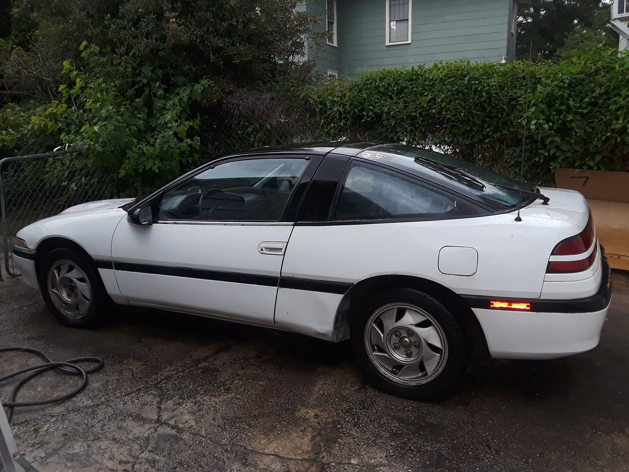

So, I've had this car for a little bit and just really haven't came up with a plan on what I want to do with it. Well, after reading 9!'clipseDOHC's build journal and story, I want to semi-emulate what he's done, except not so extreme. I live within 10 miles of a dragstrip, I know it's fwd, but I'd like to do more of a drag build on it. I want to use a 16g turbo setup, nothing too insane until I really learn how to work on and drive this car. Goals would be to hit 12s, primary focus for now is dropping weight, adding a little power, and driving experience. I have never driven on a dragstrip before, and everyone here is into American muscle. Hopefully I don't embarrass myself too badly!

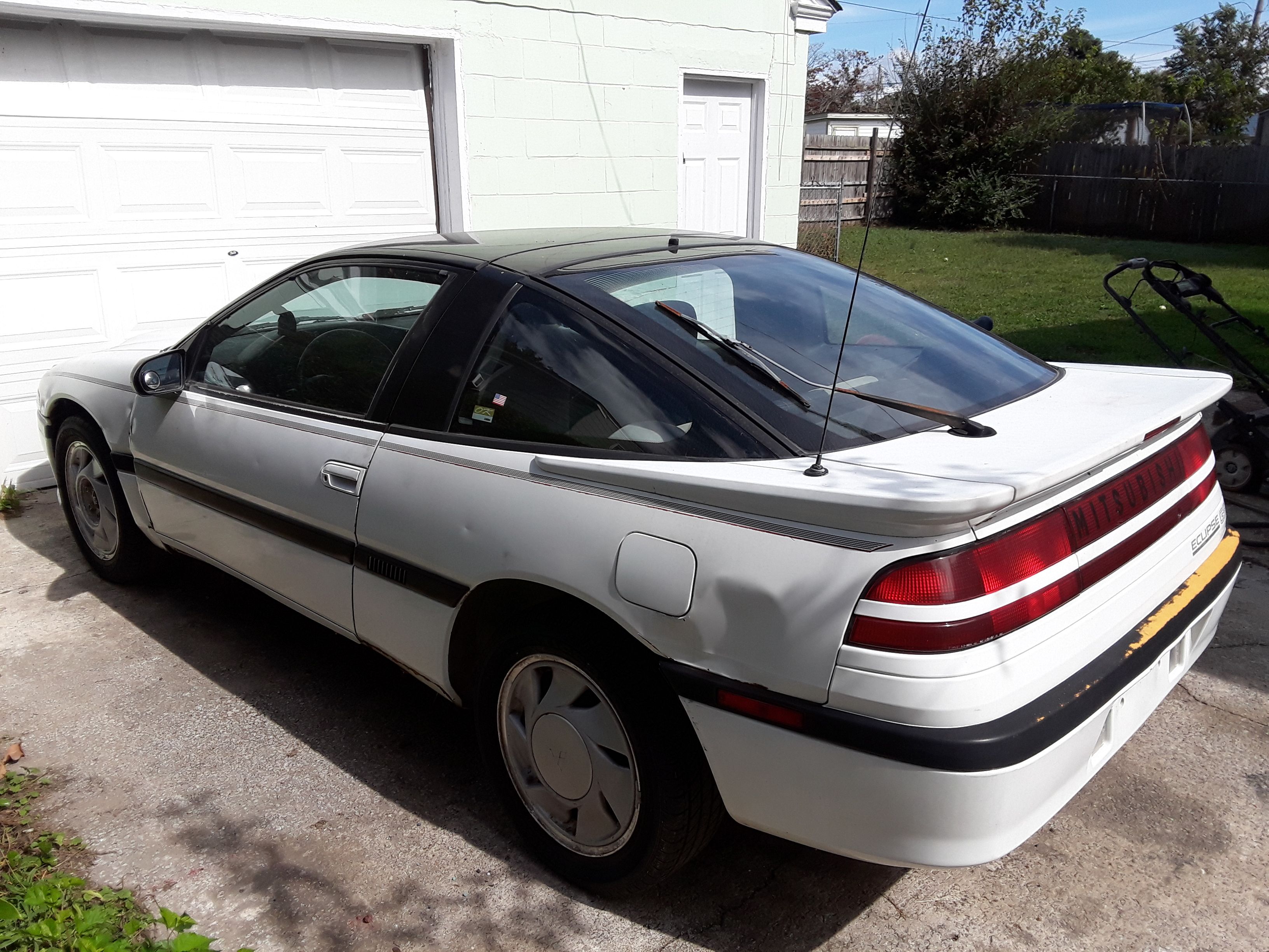

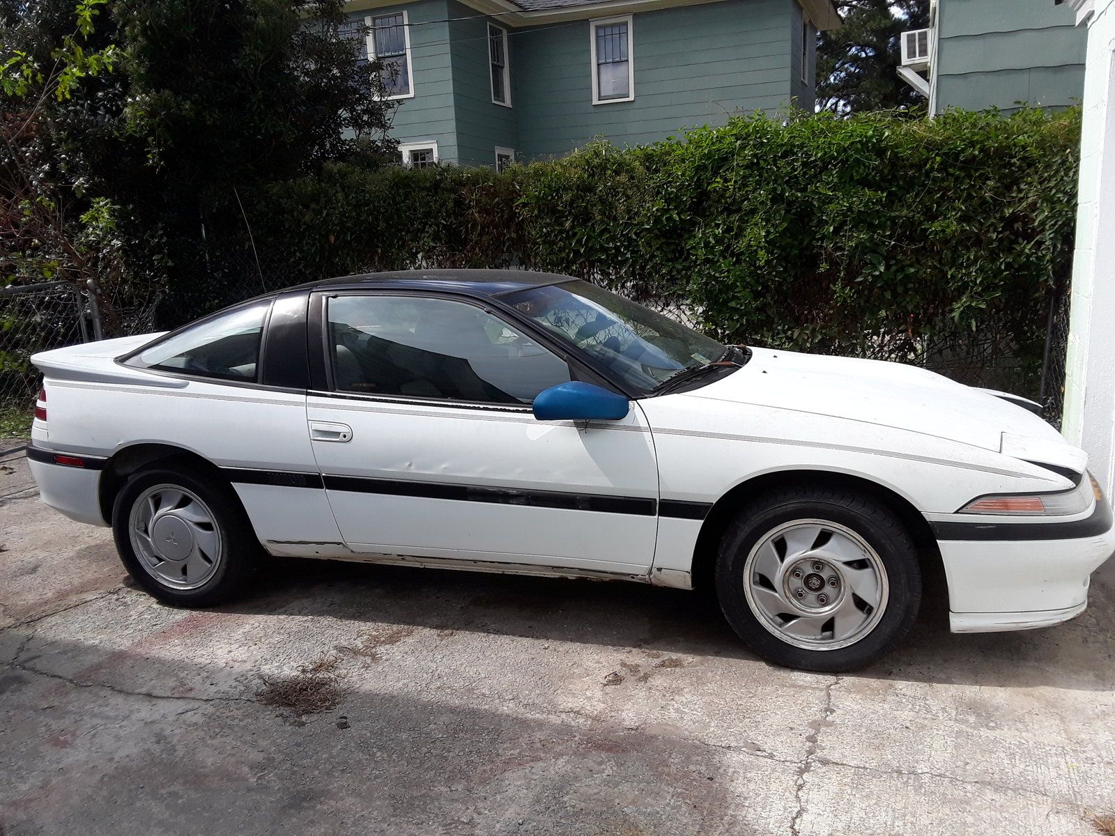

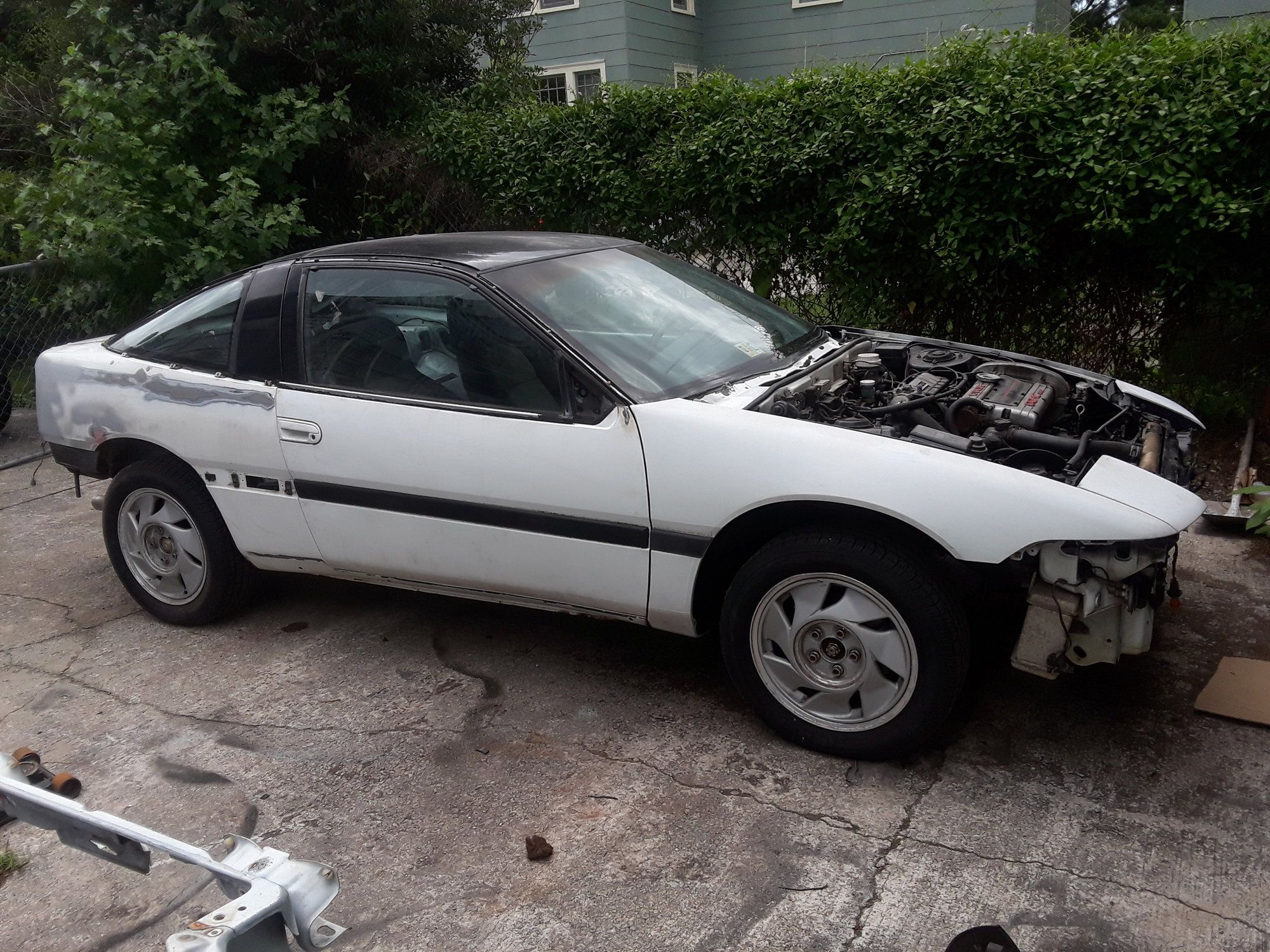

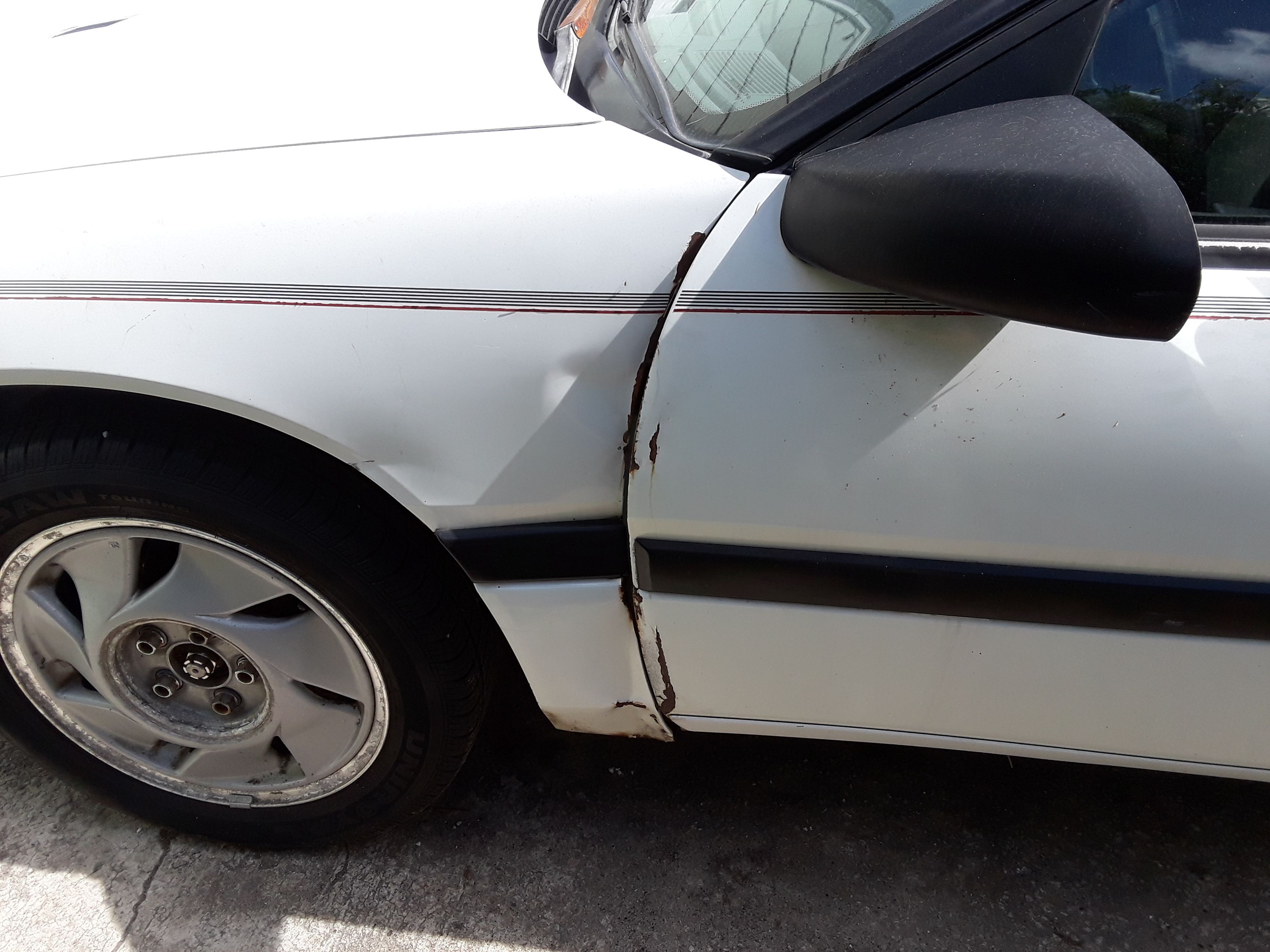

A little about the car. I traded a Yamaha Tri-Z 3 wheeler for this car, I've always wanted a turbo 1st gen dsm. It was a 1 owner car, some older couple bought it brand new and it had a book of maintenance receipts. However, it has been sitting for awhile, some branches fell on it during a storm causing the body damage you see in the pictures, and it has 195k miles. It starts and idles great, although it does not drive. The clutch will not disengage for me to put it in gear. The hydraulic system is fine, I'm thinking it's a combination of the cutch fork being bent, pivot ball a bit worn, and it needs a new TOB, and clutch. I am currently saving up for a clutch, while I'm at it, I'll be getting a lightweight flywheel as well. Little things I already have done, I've dropped the subframe and replaced all the bushings. Front LCA's have all new bushings and Moog lower ball joints. The wheel bearings had some slop, so I found a set of front hubs from a 1990 Talon that had good wheel bearings. AC and power steering have been eliminated. For right now until I can source a manual steering rack, I looped the lines on my power steering rack. I eliminated the emissions, although I messed that up, I'll get into that later, need some advice. I don't really have much for aftermarket parts. I do have a 2g exhaust manifold waiting for installation, as well as a Walbro 255. Aftermarket stuff is going to wait until at least I have a new clutch. Anyways, sorry for the long post. I'll be asking a lot of questions. Progress may be slow due to money, but I try to at least get 1 thing done a week. Thanks guys!

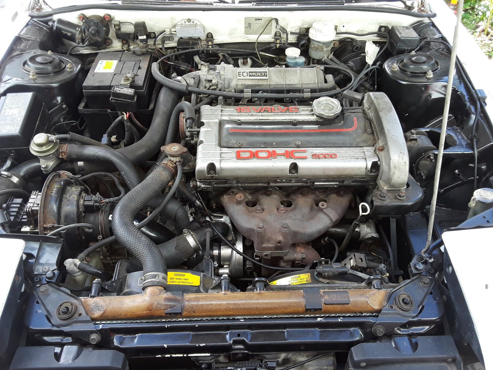

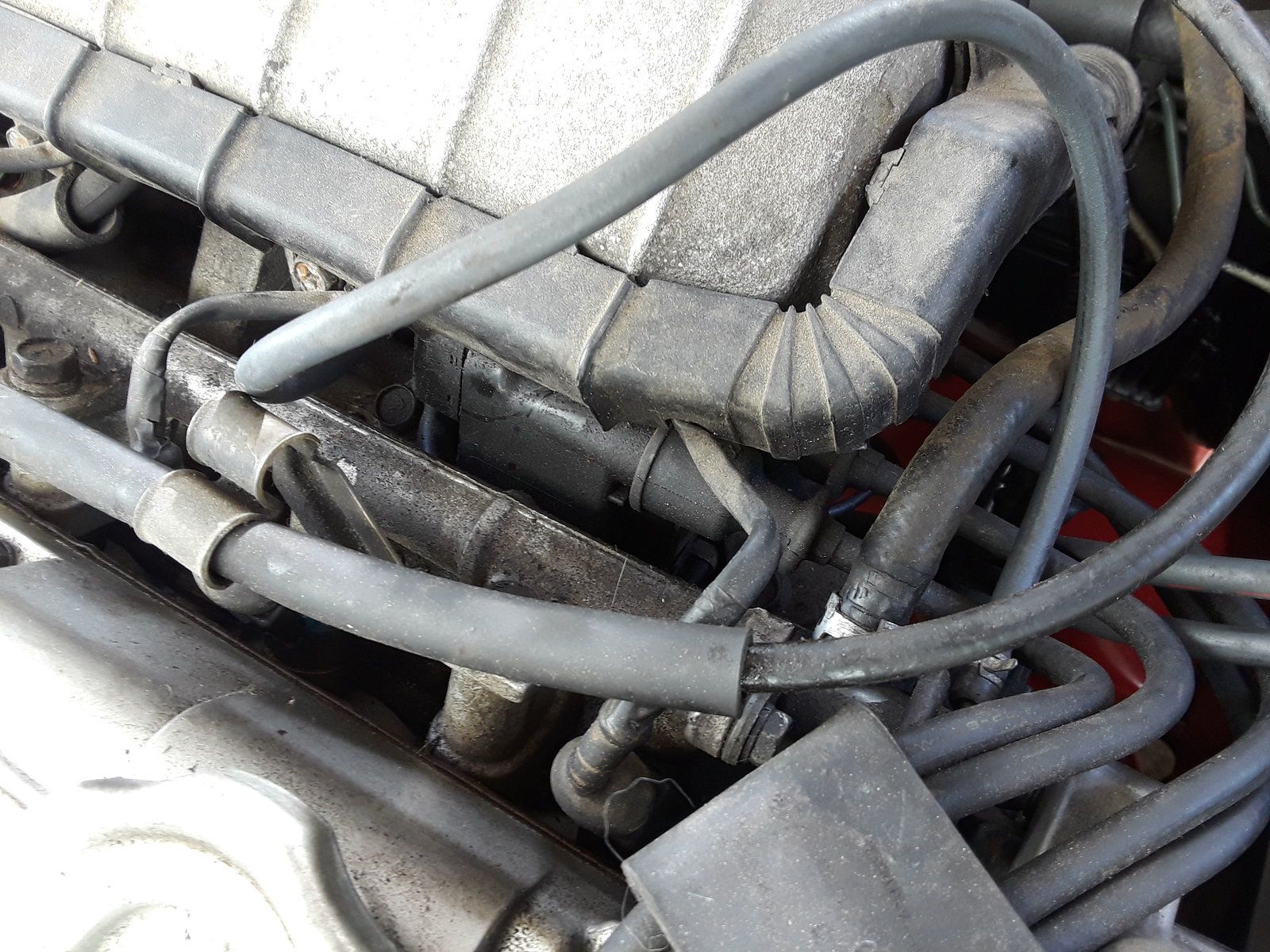

Alright. So, for my first "I'm a dummy", post on this car. Before I even did any research, I removed all of the emissions from the car, charcoal canister, the sensors, the only thing I did was to leave the vacuum lines in place. Now, after actually reading on how to properly remove emissions on the taboo speed shop diagrams, I need the fuel pressure solenoid. Of course, I threw that away like a dummy. So. After doing some reading on the forums, I noticed how some people just looped the vacuum line from the fpr to the intake manifold. I did the same to try it out, and while it does start and idle fine, what does that sensor do? Is that something I need to put back? My lines are currently looped like this. Yes, everything is capped off in the throttle body.

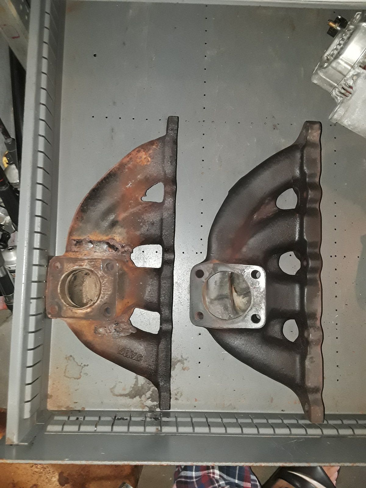

And, this is why I have a terrible time saving up for a clutch! This SBR manifold came up for sale on the classifieds, and of course, I had to dip into my clutch money to buy it! Although, I am excited to see how much of a difference this manifold will make. The stock 1g manifold is on the left, SBR on the right.

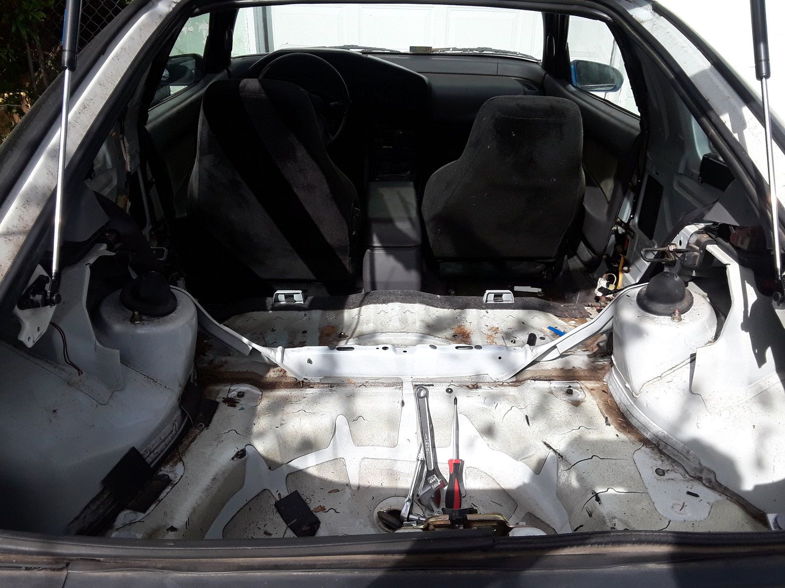

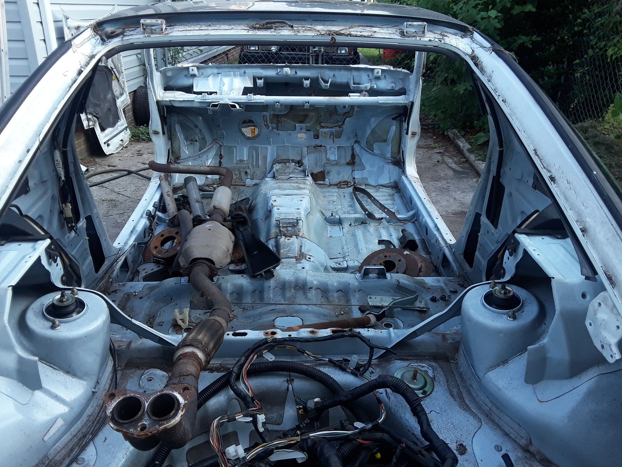

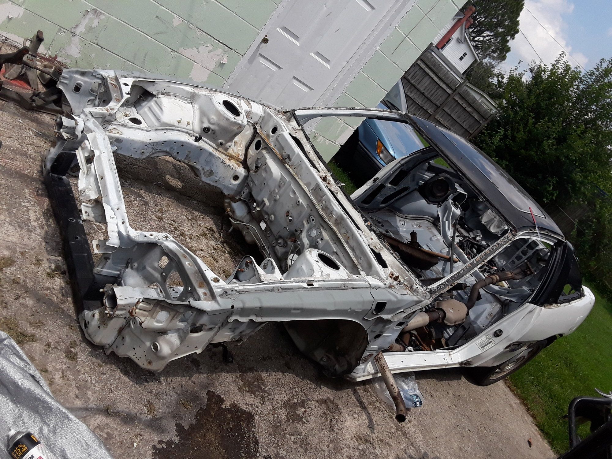

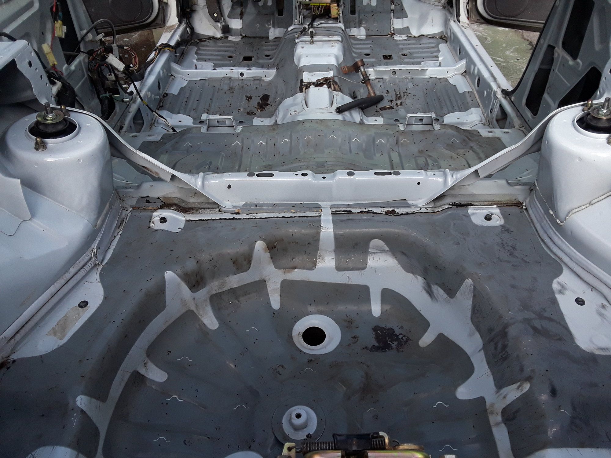

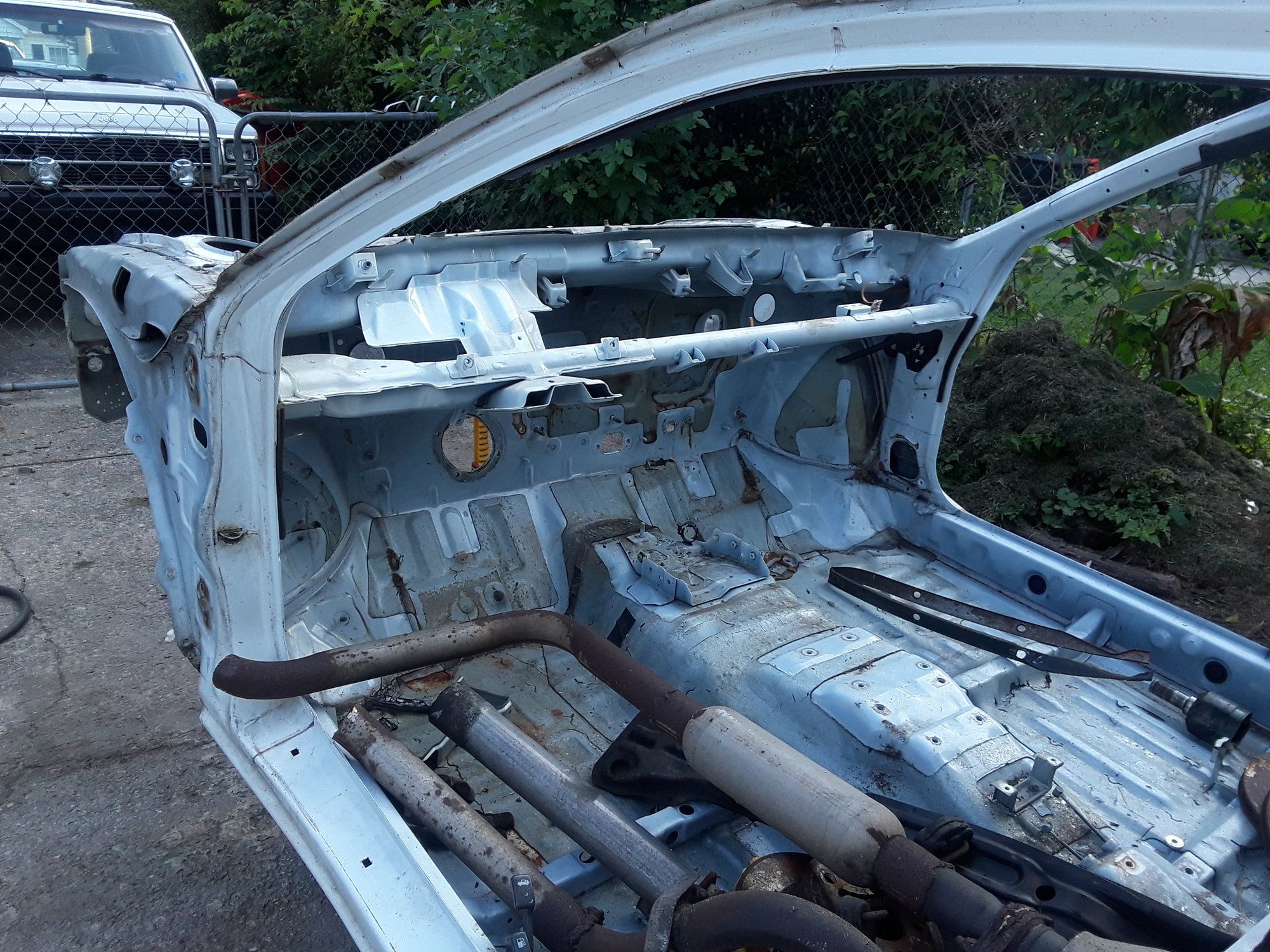

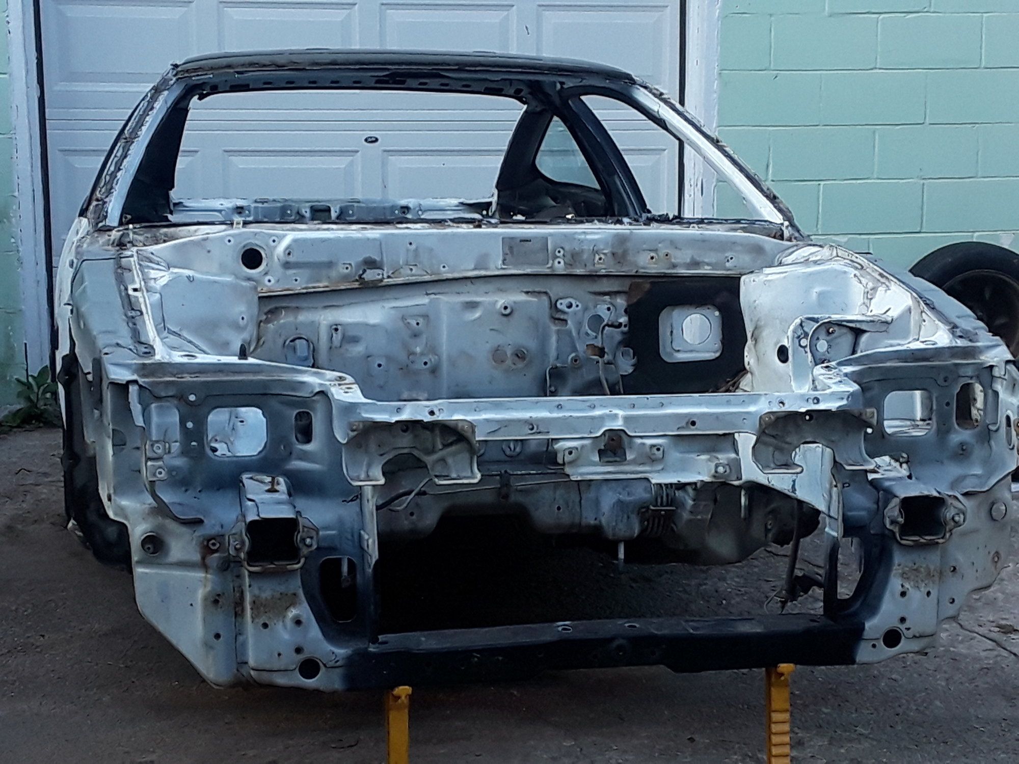

And yes. Most updates for awhile will be pretty boring on this car. But, for right now I am working on "weight reduction". This is the current progress. I will be working on removing the sound deadening, looking for advice on the best way of removing it.
ing material as well, looking for advice on how to remove it.
The part that you have pictured is the fuel pressure regulator. That is an important part and does need a vacuum source to function. The port on the intake manifold will work perfect.
When I removed my sound deadening material I just used a hammer and a chisel and worked my along the entire bottom of the car. I didn't use dry ice or anything else and it all came off just fine.

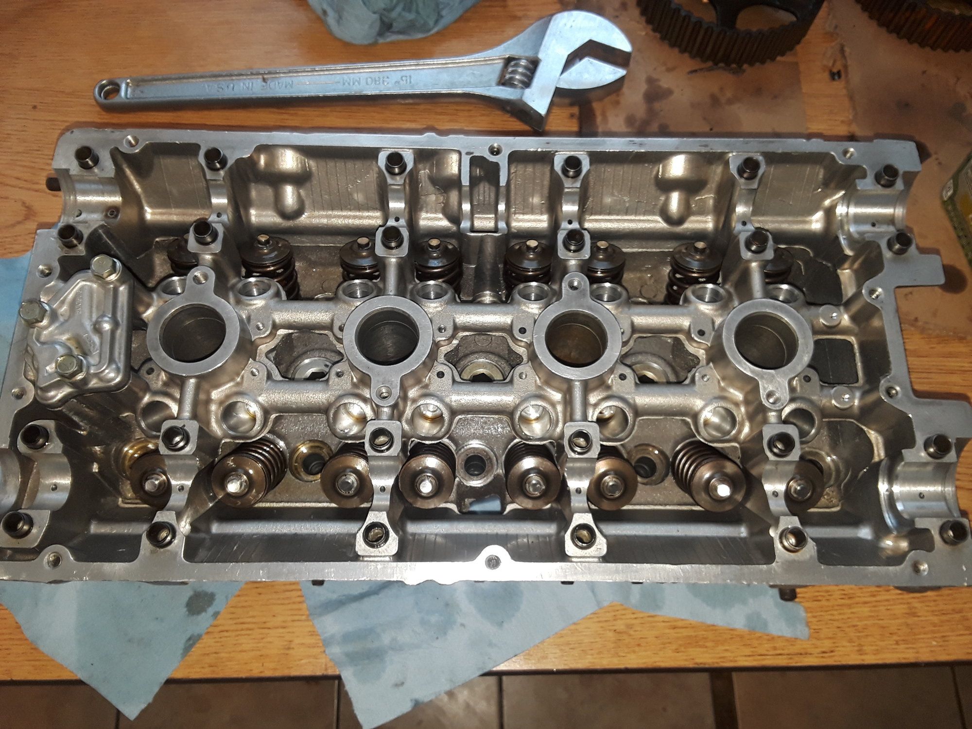

Haha, man, it almost sucks looking back at this and seeing how little I've accomplished. My biggest update is I finally finished putting my cylinder head back together. I had torn it to clean it up, replace valve seals, clean up the casting in the combustion chambers, etc.

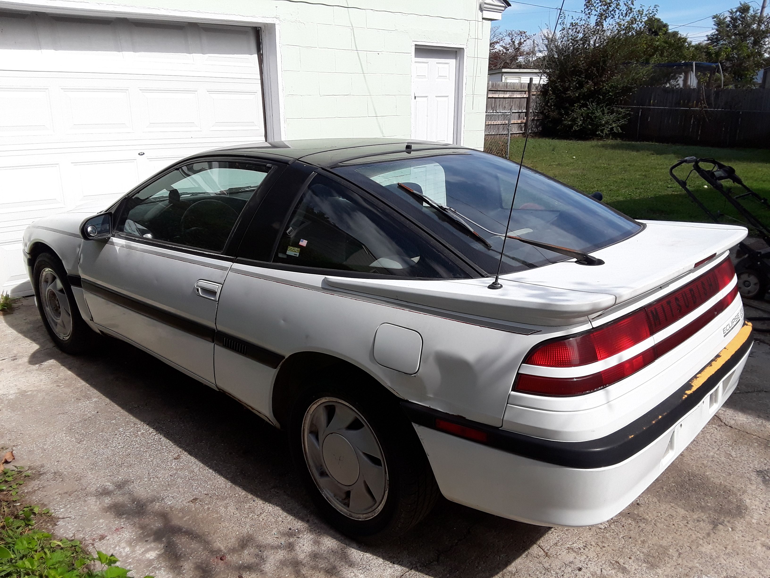

I did make a nice score this past summer, I found a white 1990 eclipse gs for 100 bucks someone was selling as a parts car. My doors and fenders were a bit beat up, I was able to replace those with ones in far better condition. This car is also serving as my first car that I'm attempting body work. I've really been going slow and taking my time, unfortunately, it's too cold for bondo and paint now, so I'll have to wait until spring for much more progress.

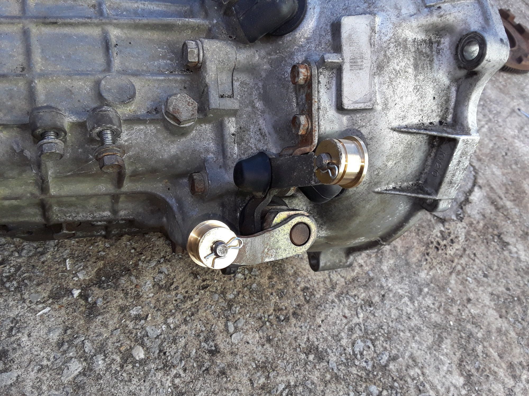

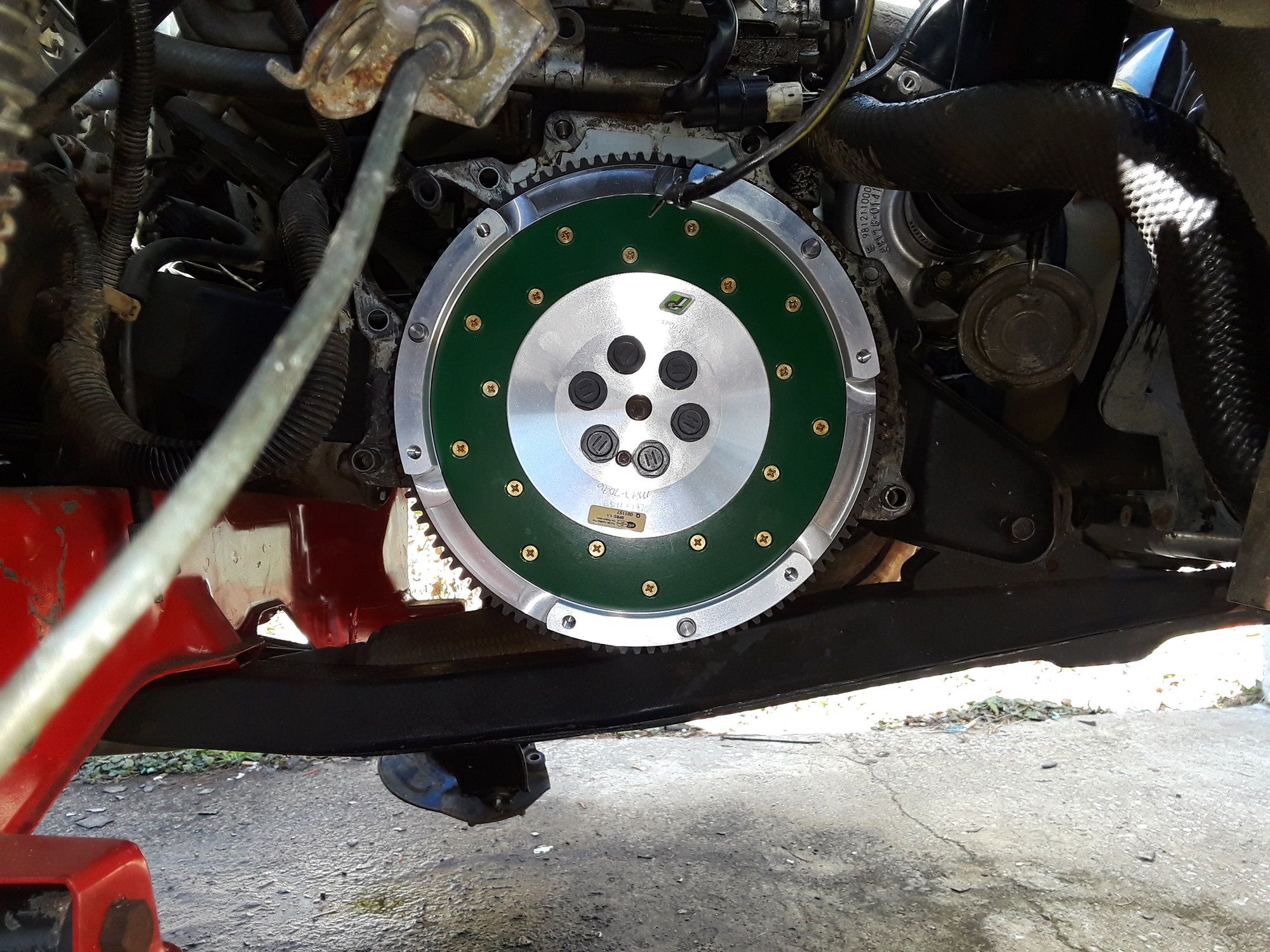

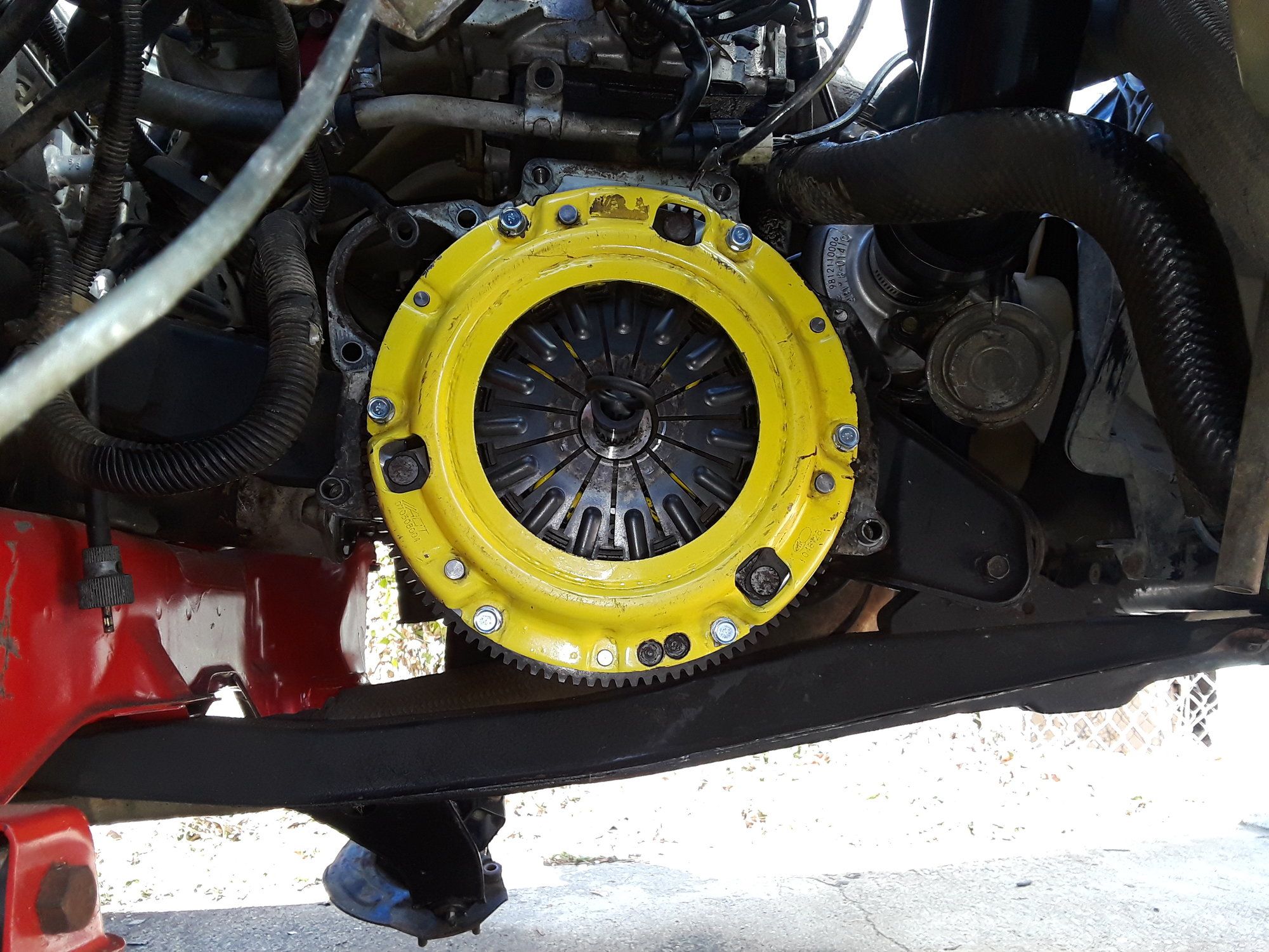

Actually, nope. I lied. Looking through pictures from the past year, I got alot more done than I thought. I was having clutch issues, I used that as an excuse to get a new clutch and flywheel, and new shift bushings.
Turns out though, my clutch "issues" were due to an improperly welded clutch pedal. Whoever did it, didn't pull the pedal all the way forward before welding it haha. I dont have pictures of that, but I replaced the whole clutch pedal assembly. That fixed my issues, I had hoped to at least know it was running and driving before I broke it down for bodywork and paint, and after a test drive to verify everything worked, started the bodywork process.
This had to be some of the most tedious work I had done in awhile, although, in my opinion, a good way the shed some needless lbs. I dont remember how much it all weighed after I bagged it up, but i want to say it was in the 20 lbs range

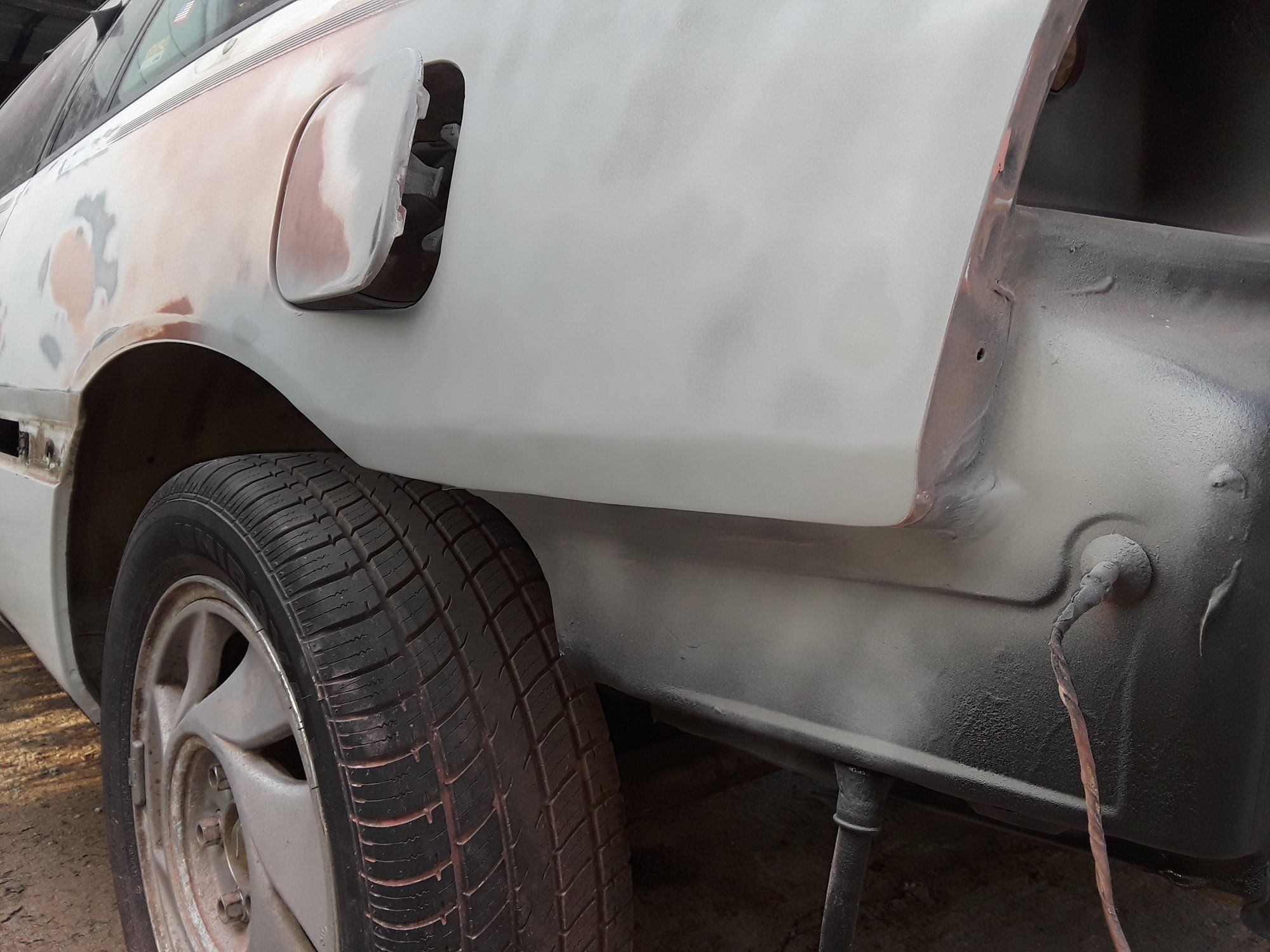

Here's the worst spot on the rear quarter panel that I've been working on
Somewhat recent pic of where I'm at with it. I need to get my line straightened up more, and smoothed out a bit. I've been moving pretty slow since I've never messed with bodywork before.
