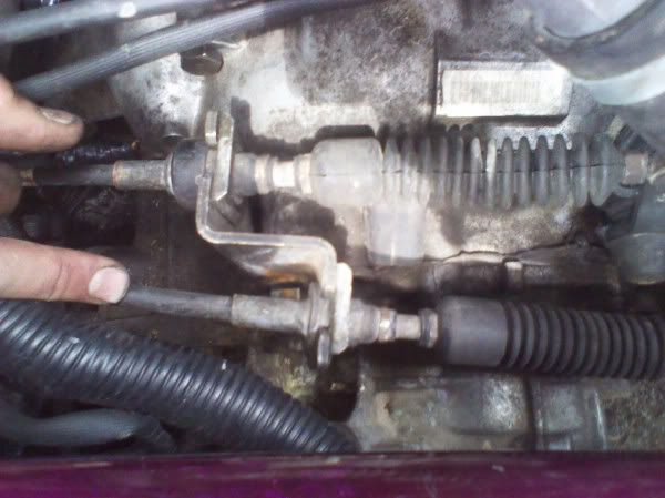

Sorry to hear man. The shifter linkage that bolts to the transmission that braces both shift cables may be canted too much forward or backwards/unless you already checked that.
Loosen the two 12MM bolts, move forwards of backwards, re-tighten. I can't tell you exactly where it should be, but there should be equal left and right neutral play when correct. Let me know if you find the proper spot LOL/I go by feel on that one.
The transmission will shift very notchy and the "gates" will feel like they are out of place if that is off.
Good luck!
When you say "move forwards of backwards". Do you mean the linkage? or shift into 3rd/4th?
Nothing will save it exernally. Why are you driving another month? Drop it now and find out what's wrong before it's completely destroyed if it isn't already. Something aluminum is ground up. You can wait until is grenades or maybe save it.
That loose bracket is an issue & not helping anything. Regardless on the tranny that should be corrected.
