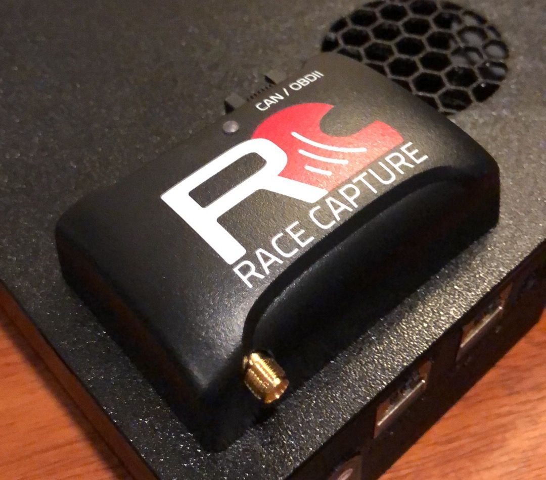

And if you need to send/receive CAN bus data with RaceCapture, you need an adaptor

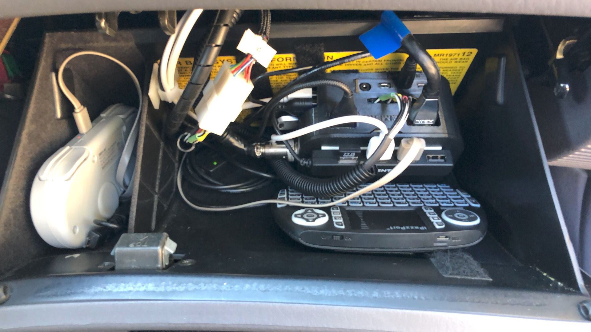

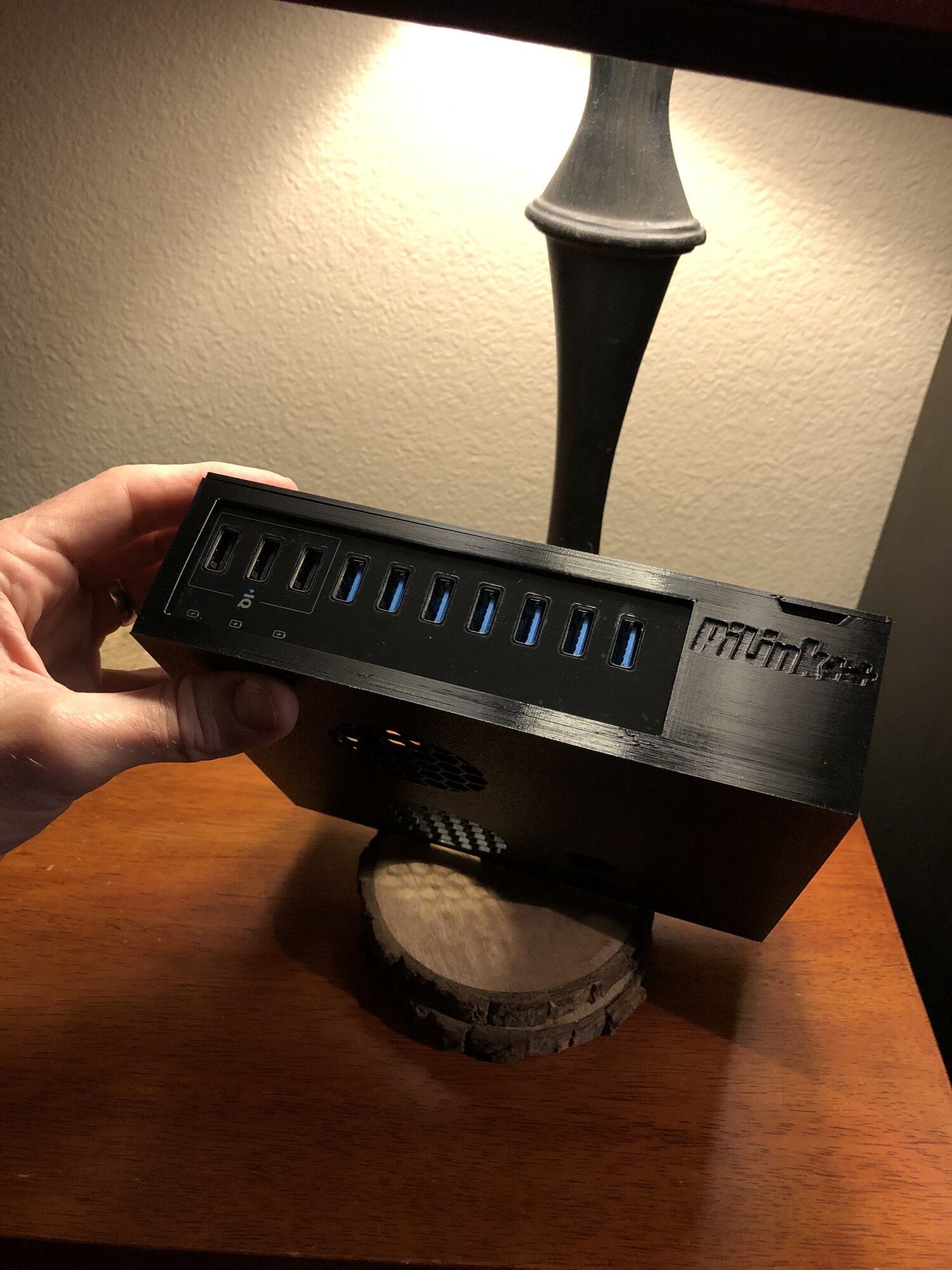

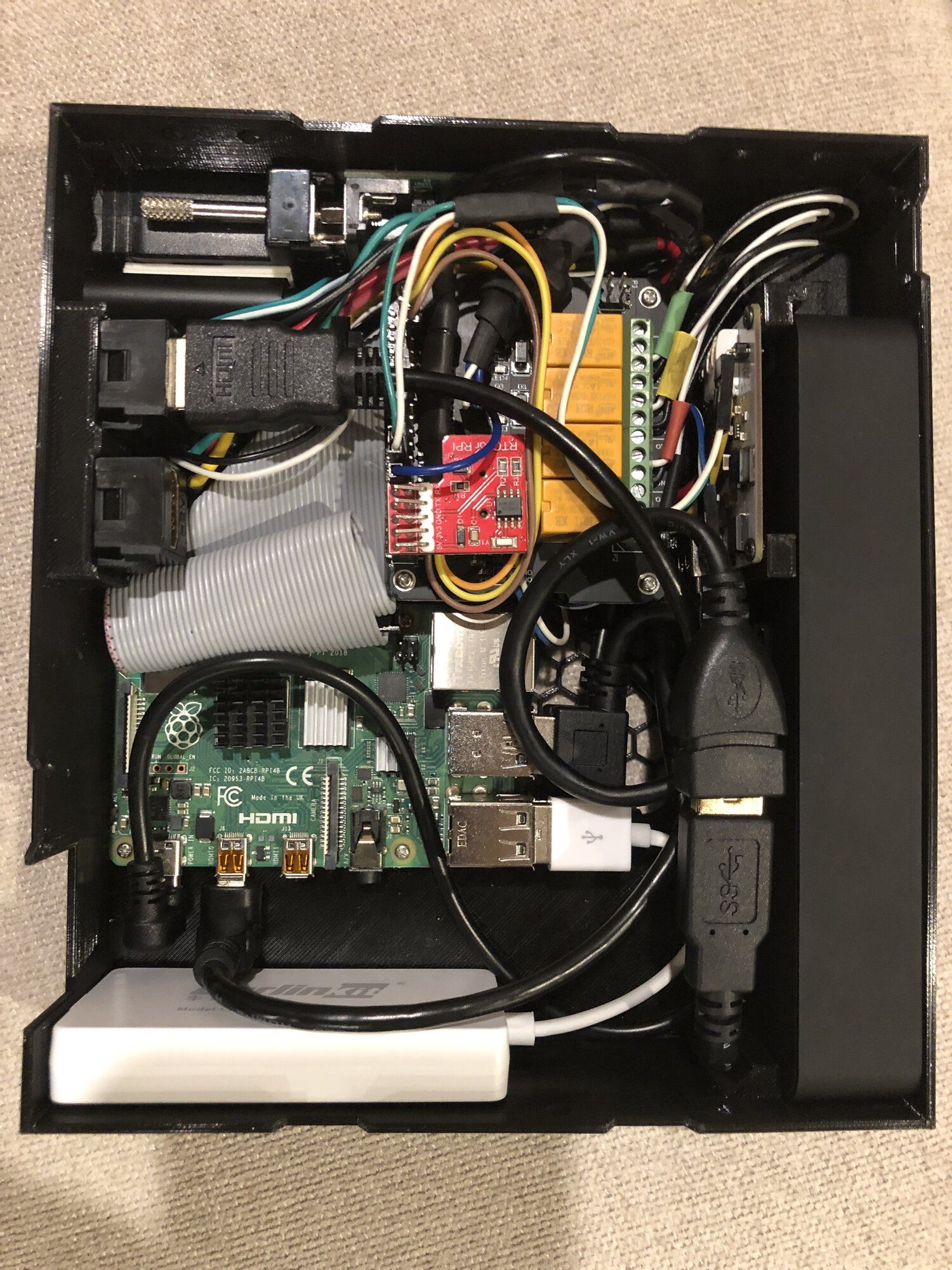

To ensure a robust configuration with all these options, I picked up a 12v powered usb3 hub that includes 3 - 2.1a power only charging ports. These are great for charging the keyboard and phone, and I’ll try one to power the 7” display.
When I plug BT and Keyboard dongals directly into the 3.0 ports, I get bad keyboard and joy controller response, noisy. The internet seems to think 2.4ghz devices interfere with USB 3.0 data ports so short extensions to increase the distance between the hub and dongals seem to be working.

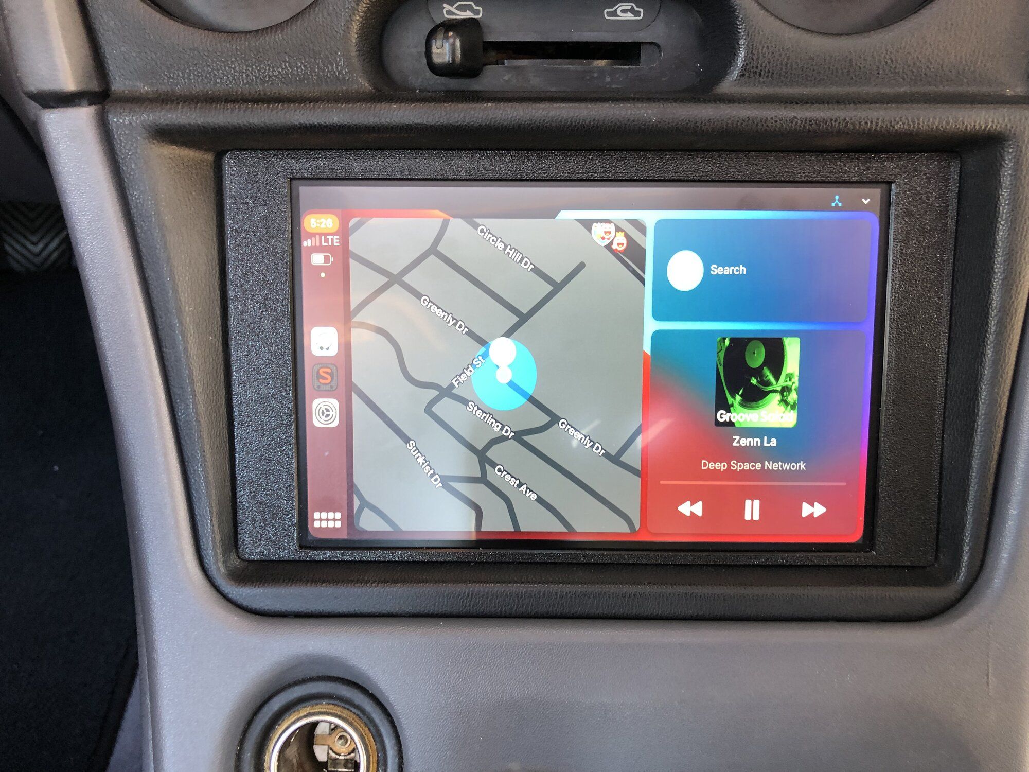

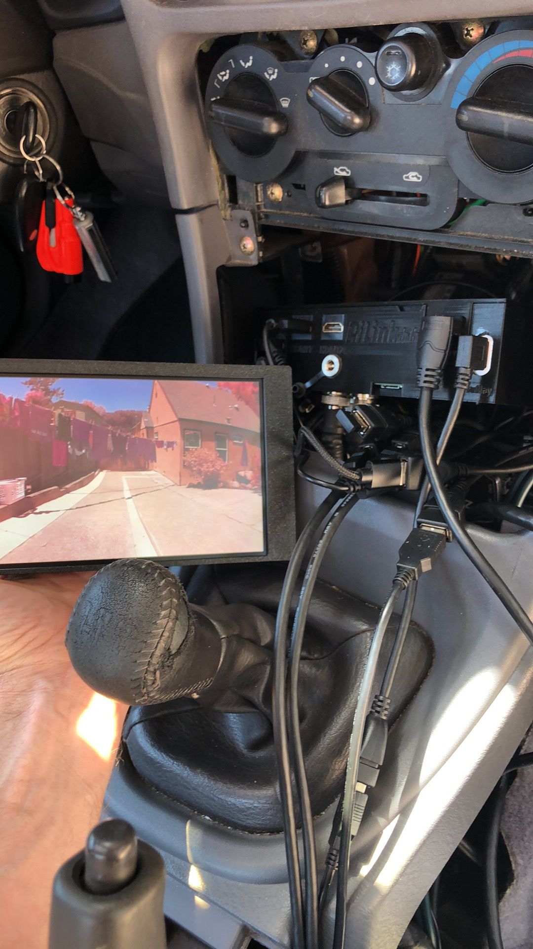

I just tried CarPlay with an iPhone 5 with iOS12. This is and old phone. (What is current now? iPhone12 with iOS14? yeah) Old phone. but, its free, and I can mount it in the car forever. It has a camera, that records HD1080, 30hz. Hmmmm (she may yet be of some use to us)

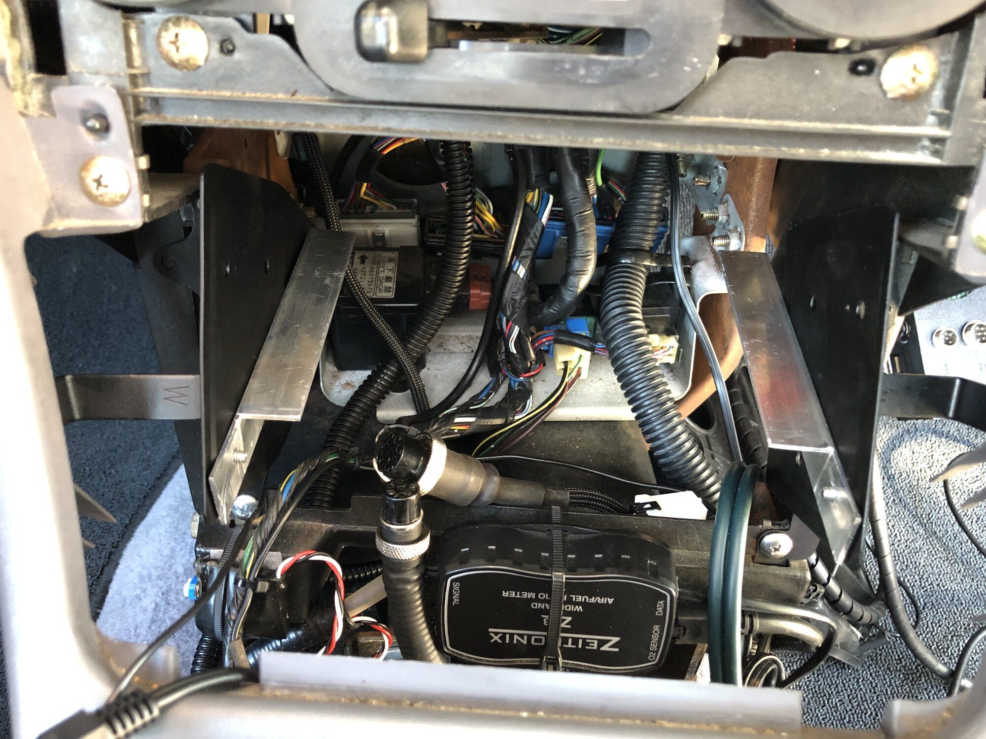

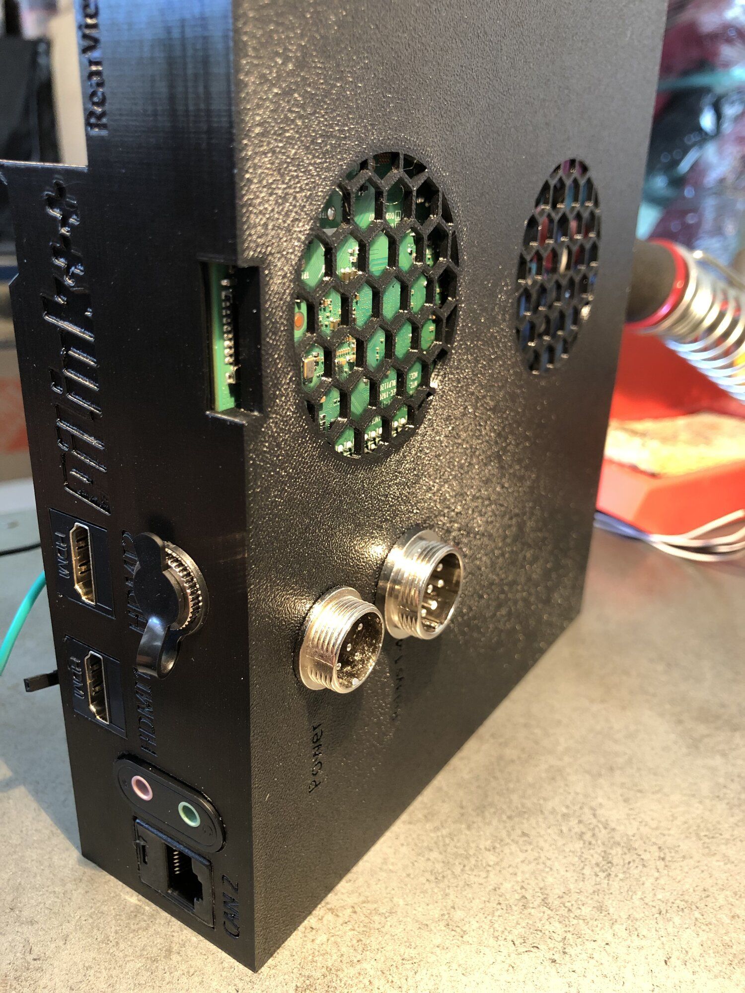

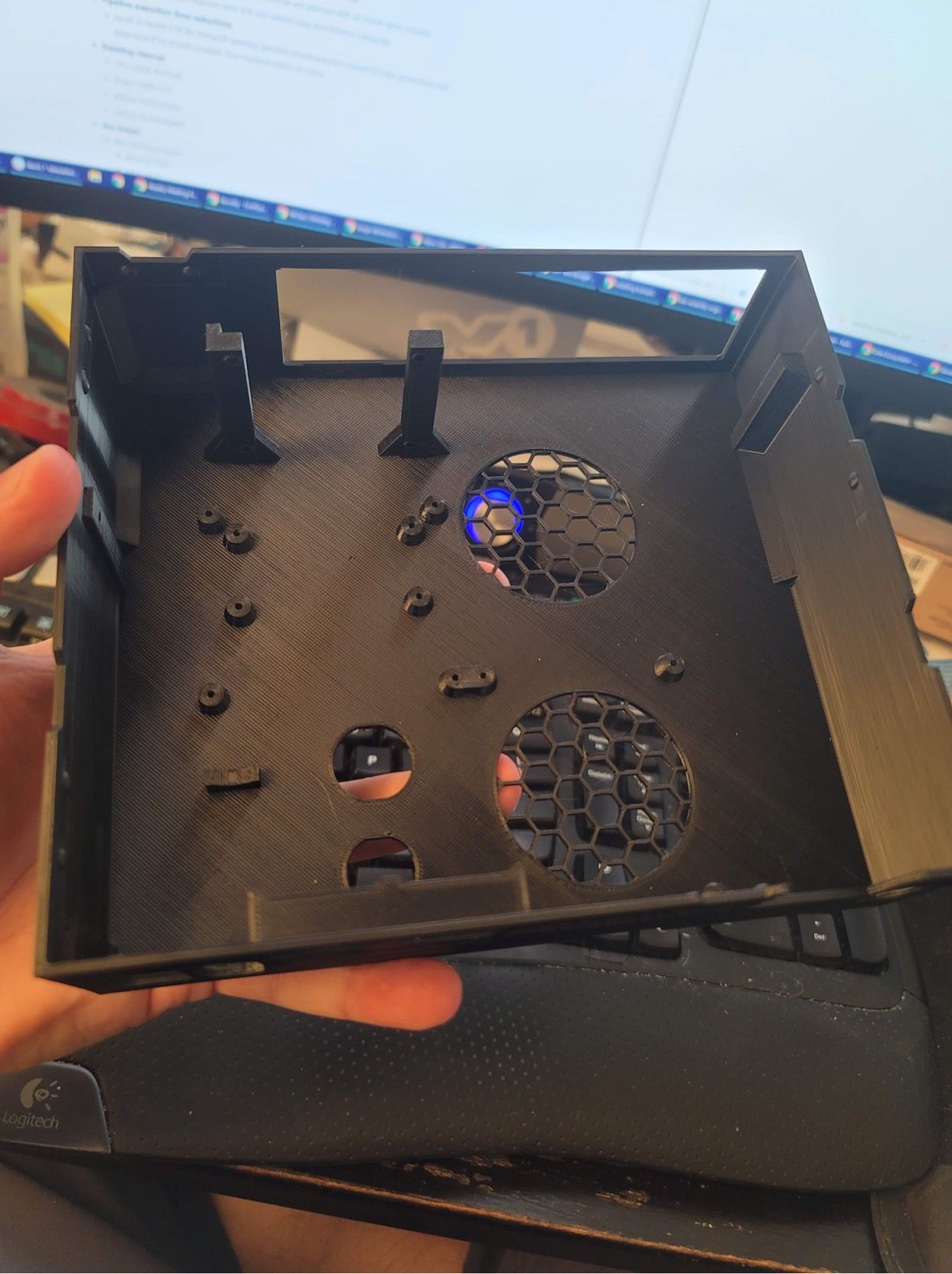

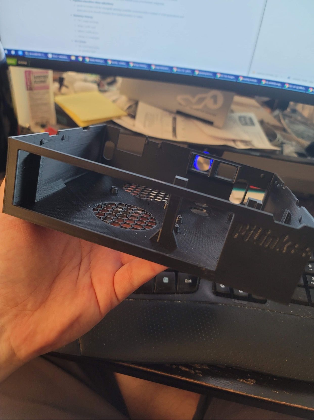

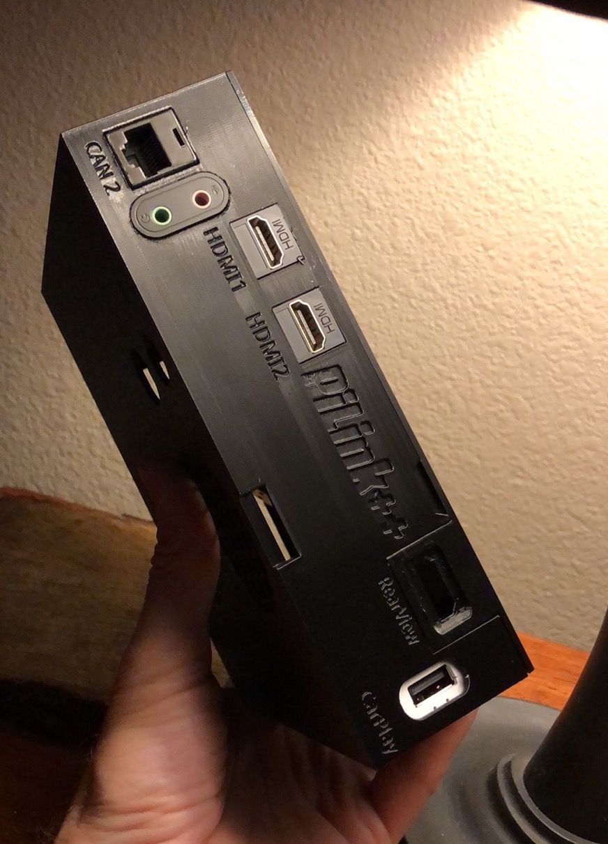

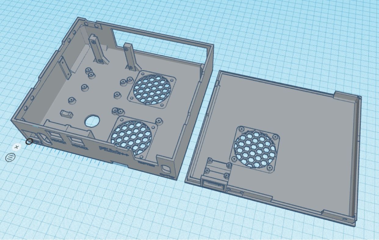

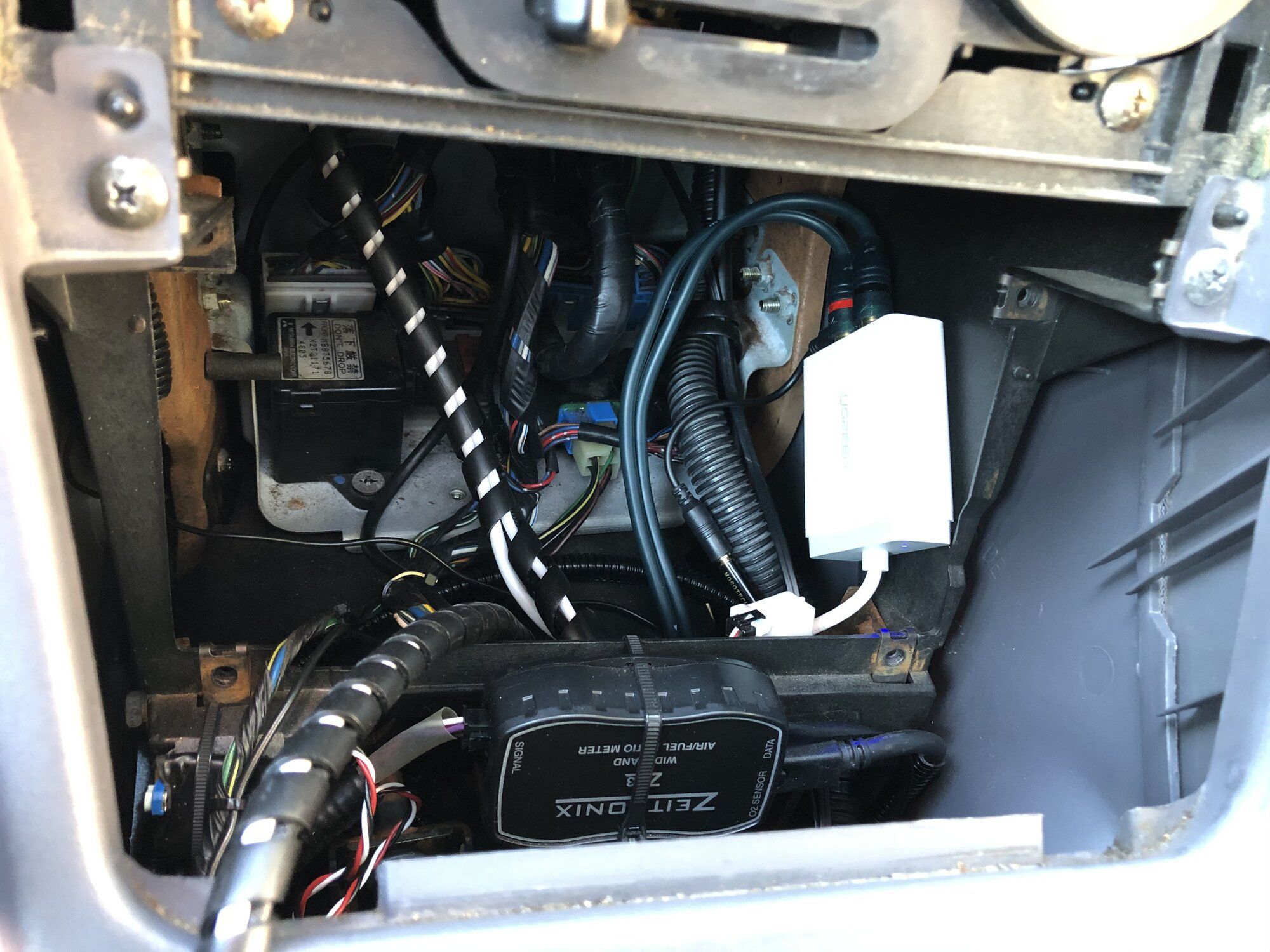

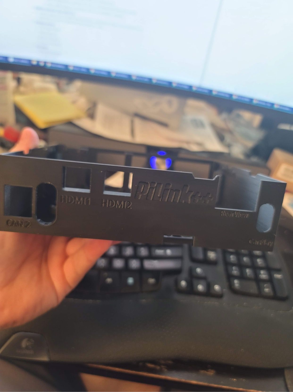

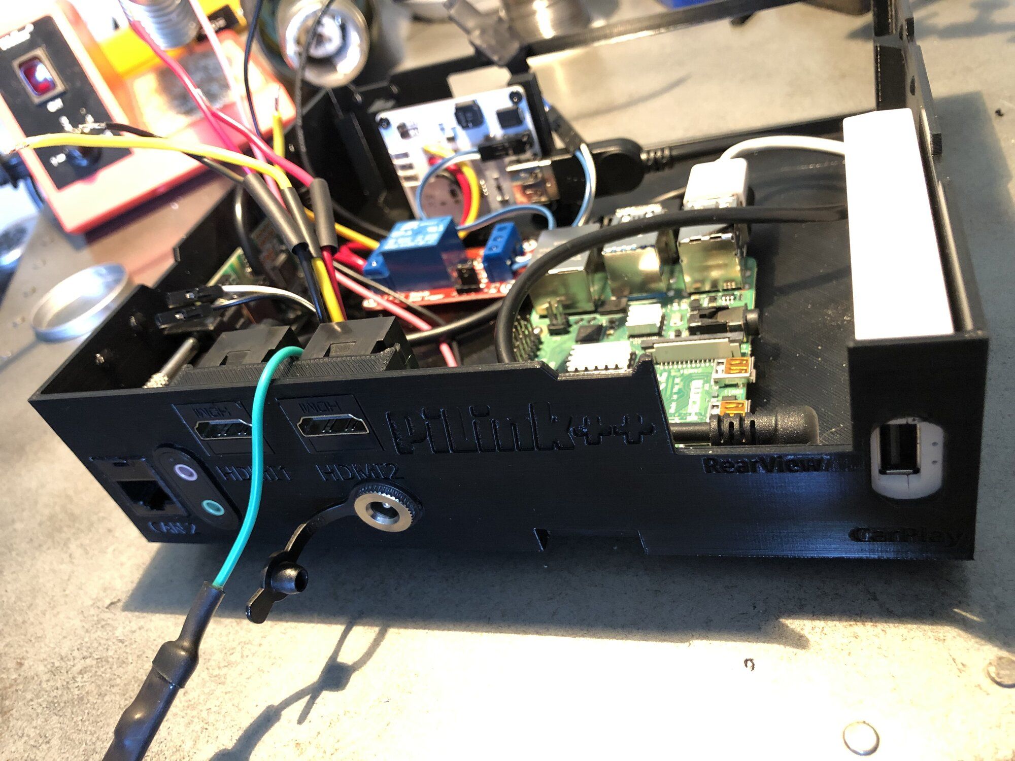

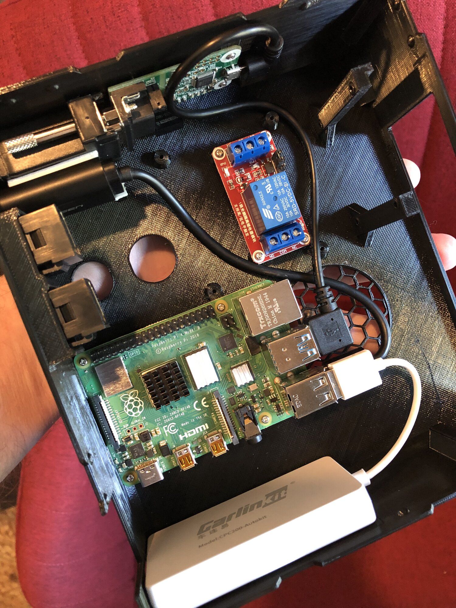

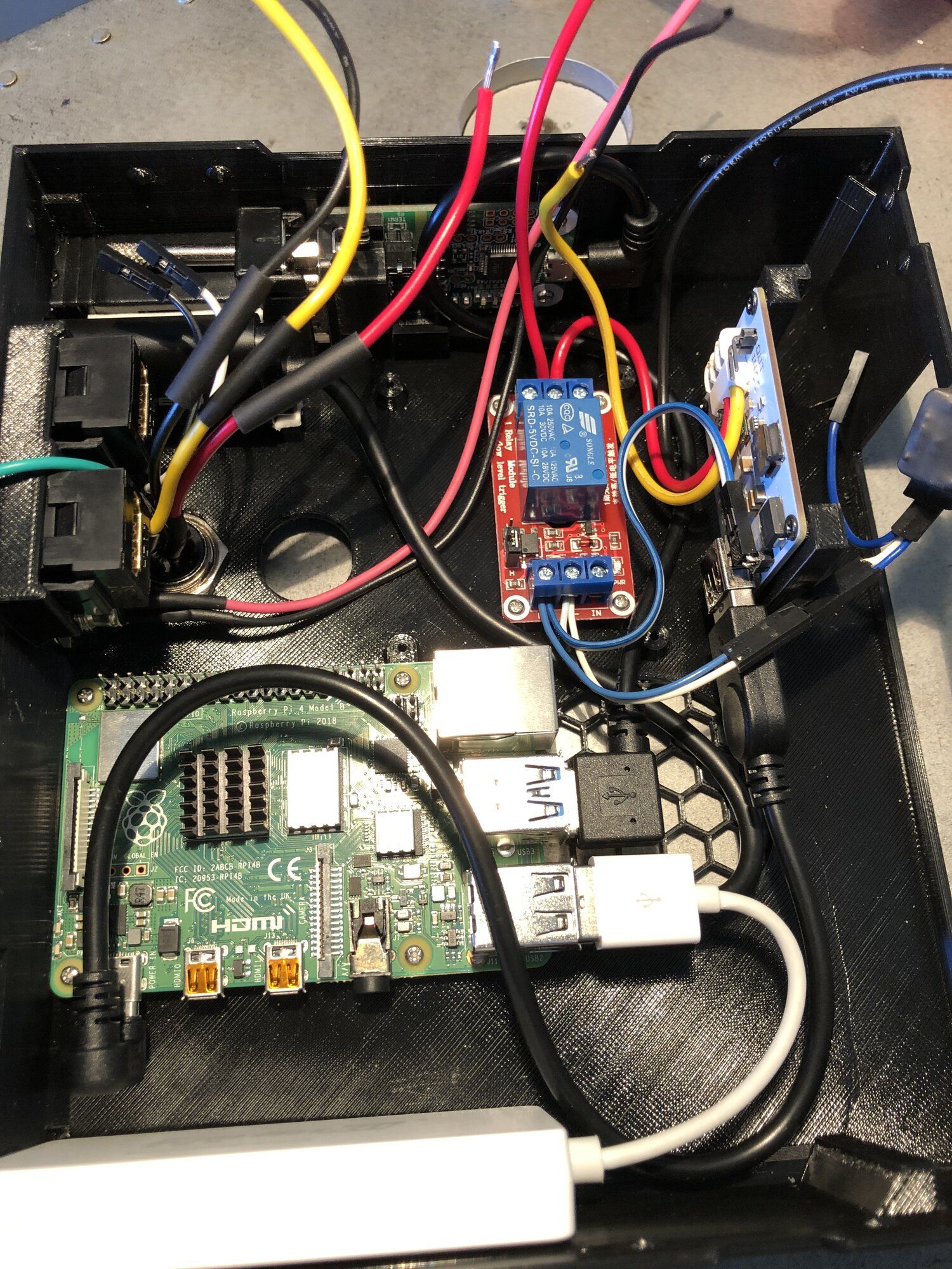

My glove box is kinda overflowing with all the PiLink options added, and now with CAN bus and CarPlay - its time to try re-packing all the components into a single box. Not sure the connections are all going to fit in the radio void behind the screen, but I'll post progress here.

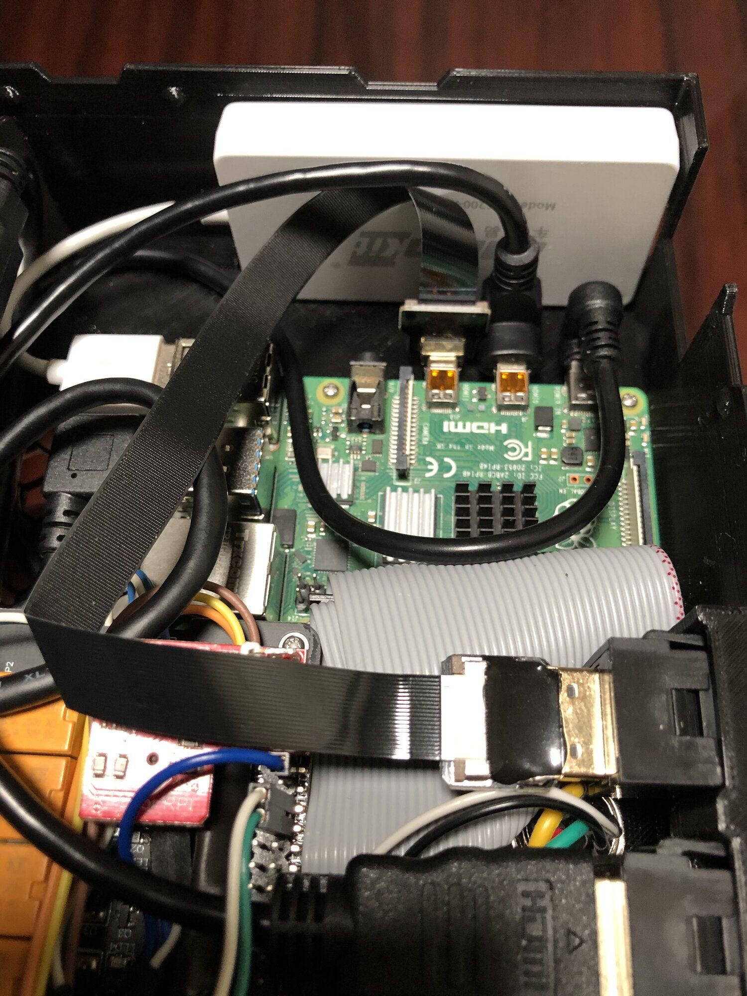

This ribbon cable fits for HDMI-2
And... The in car testing is working. John helped with a iPhone specific Pitunnel issue, and I figured out I stupidly forgot that I had disabled the backup camera in the pilink.cfg file.

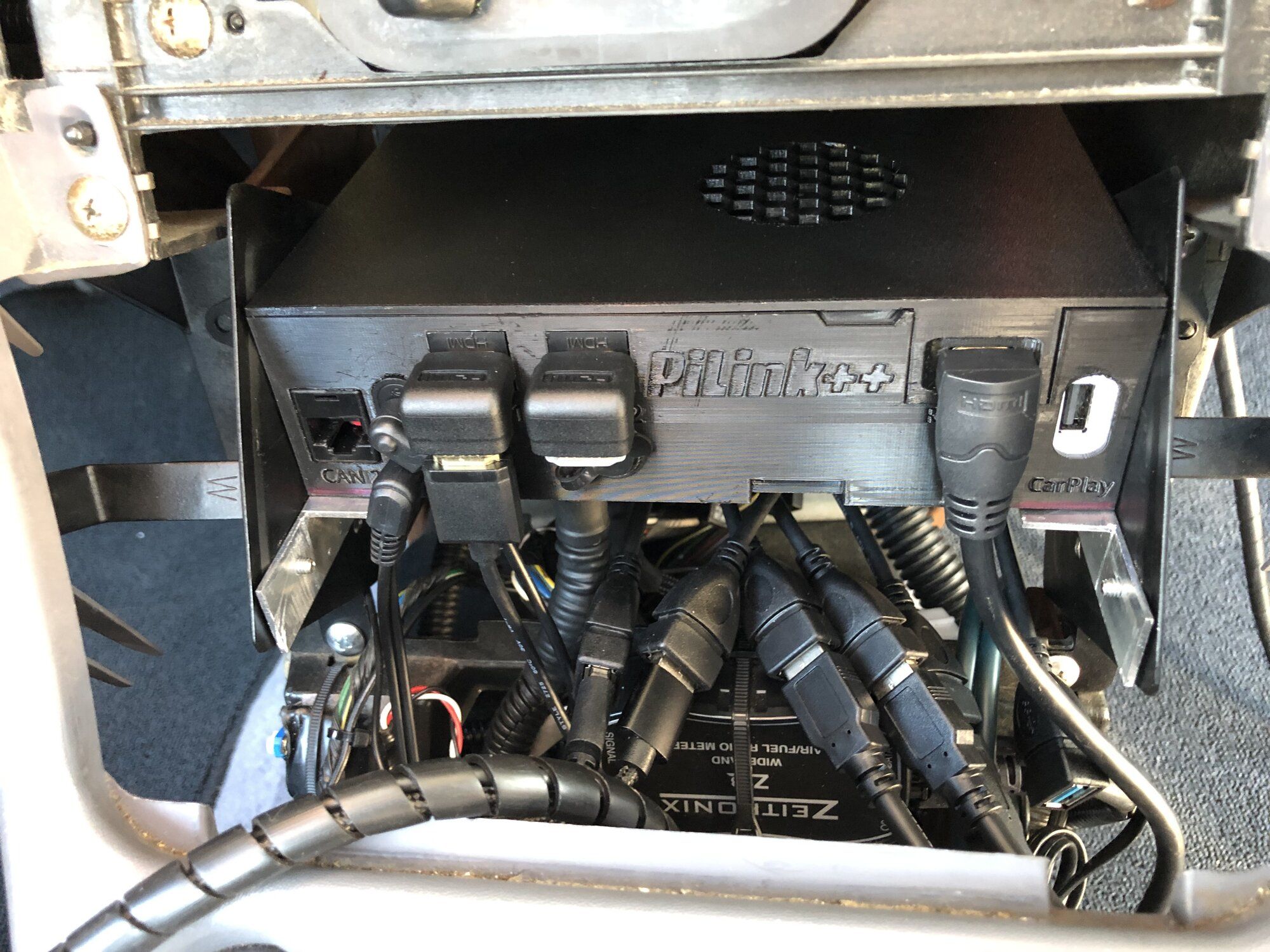

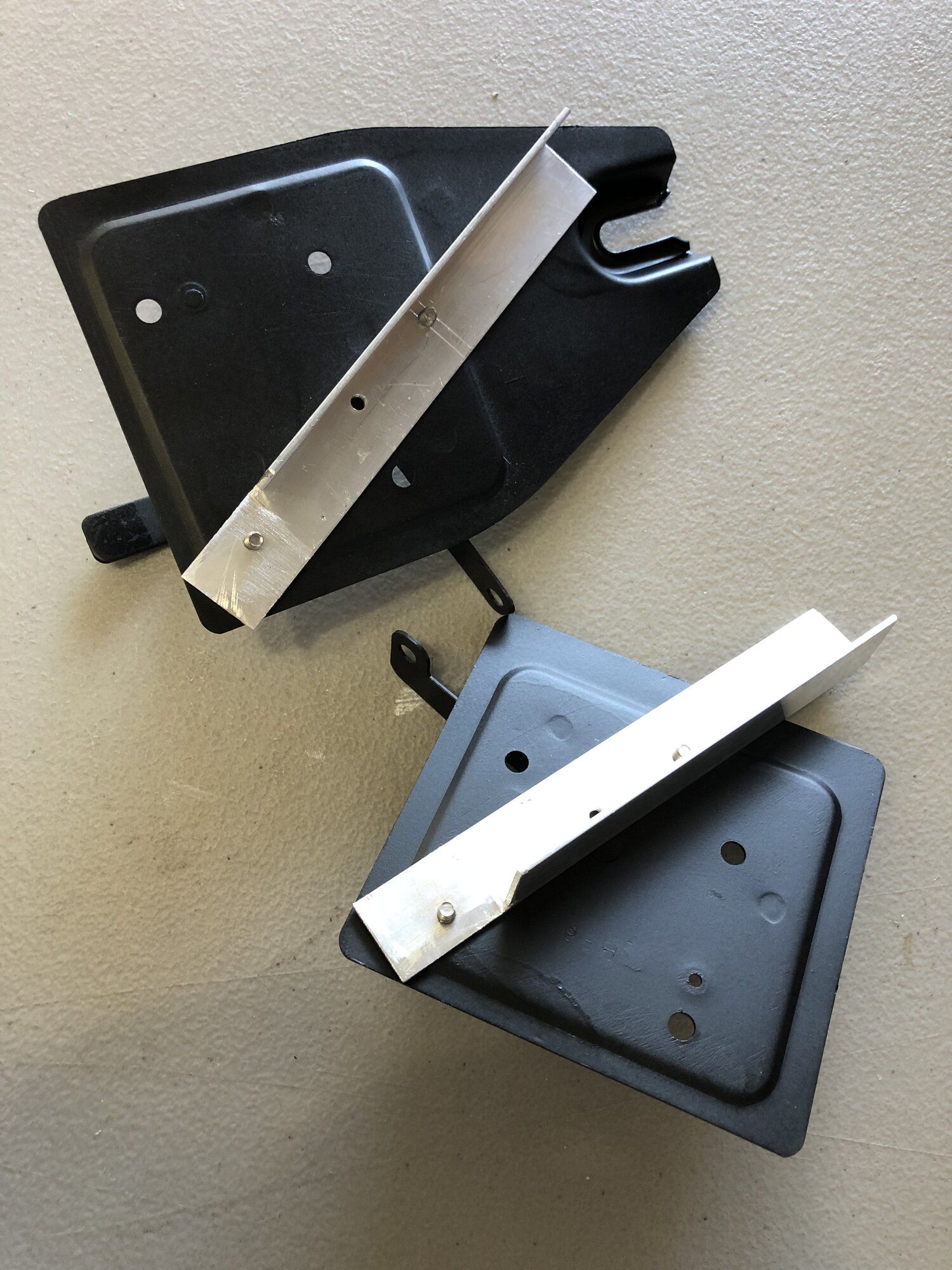

I'm calling the box build done. Everything I can test is working. I need to drive around with everytihing logging in order to determine if there is anything left to work out. Right now, I'm tweaking the stereo mounting brackets. I will have enough room , but I needed to find the sweet spot towards the back so the box is deep enough in the hole in order to provide clearance for the flat screen and cables.

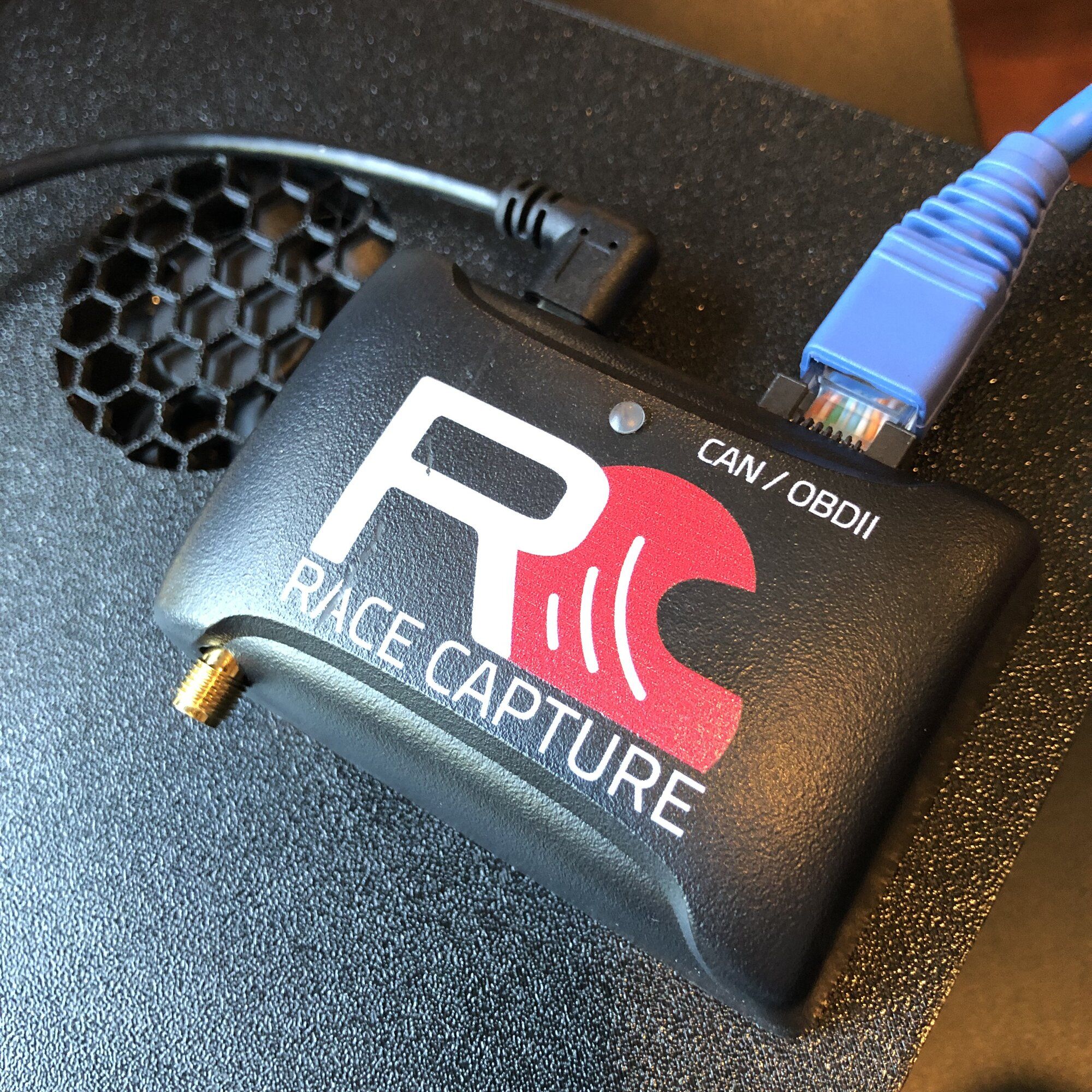

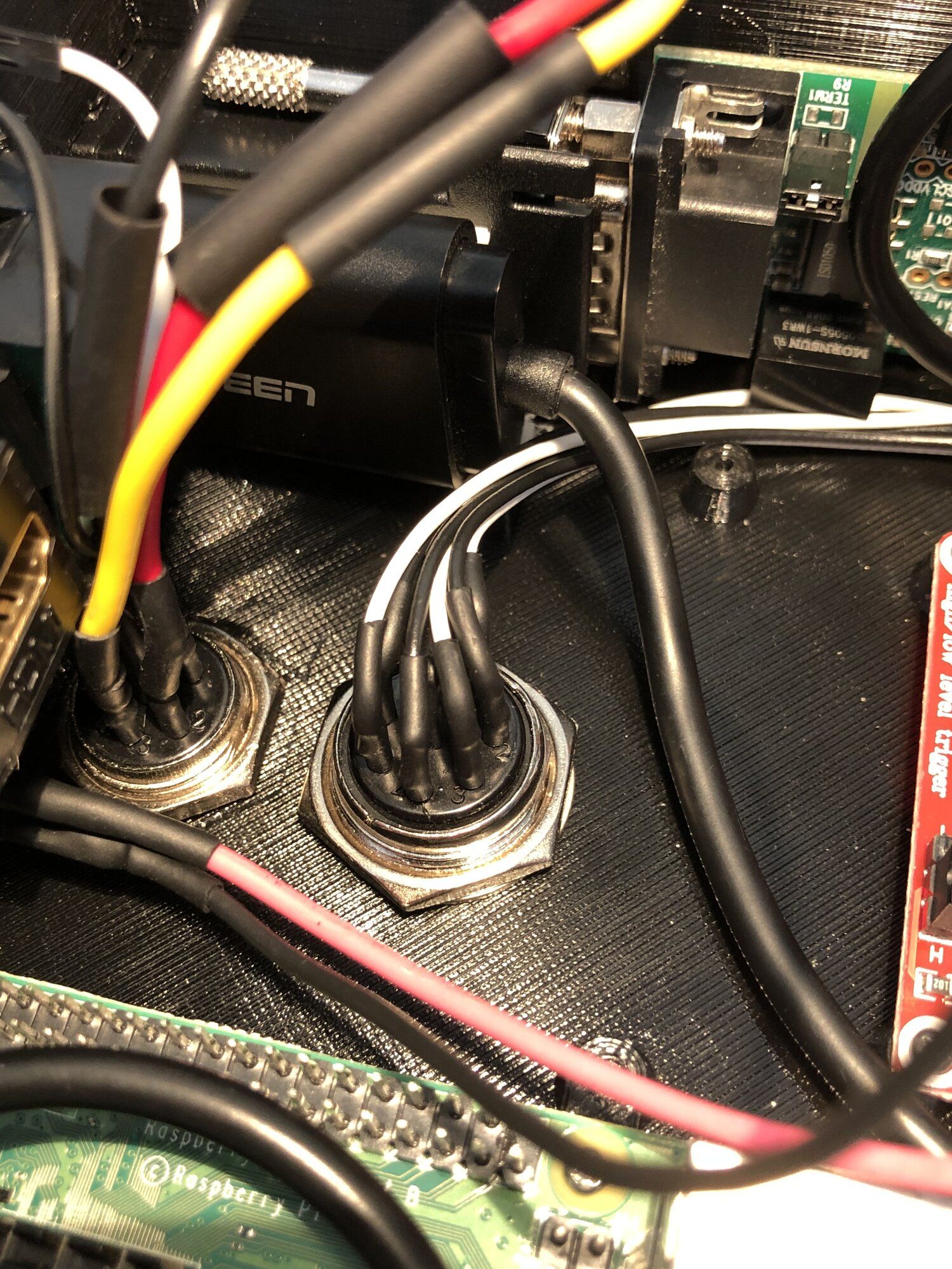

Been struggling with the CAN bus connection and Lua script on RC. Figured out I had incorrect color coding in the wiring connecting the Pi CAN bus DB9 to RJ45 adapter. After creating a temporary cable to make the correct connections, I ordered a replacement RJ45 adaptor to set it up so standard CAT5 cables will work. The Lua script is another thing - finally got the relay clicking from a RC txCAN() command, so now working to get a test track setup with a real start/finish zone so I can ensure the whole setup works before going to a real track day.

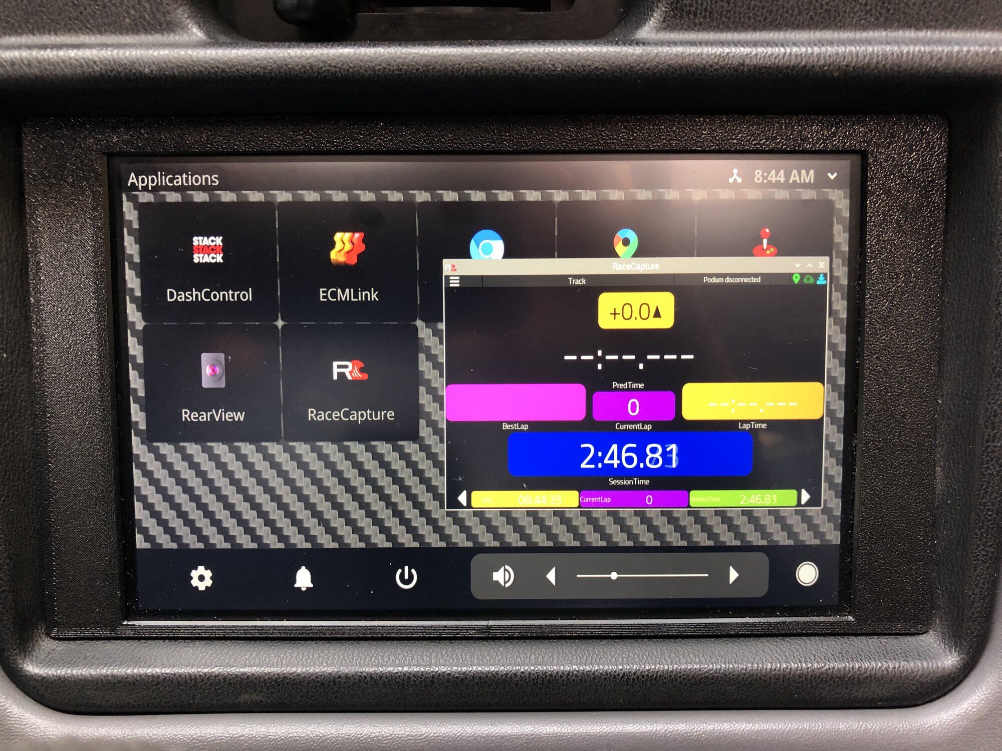

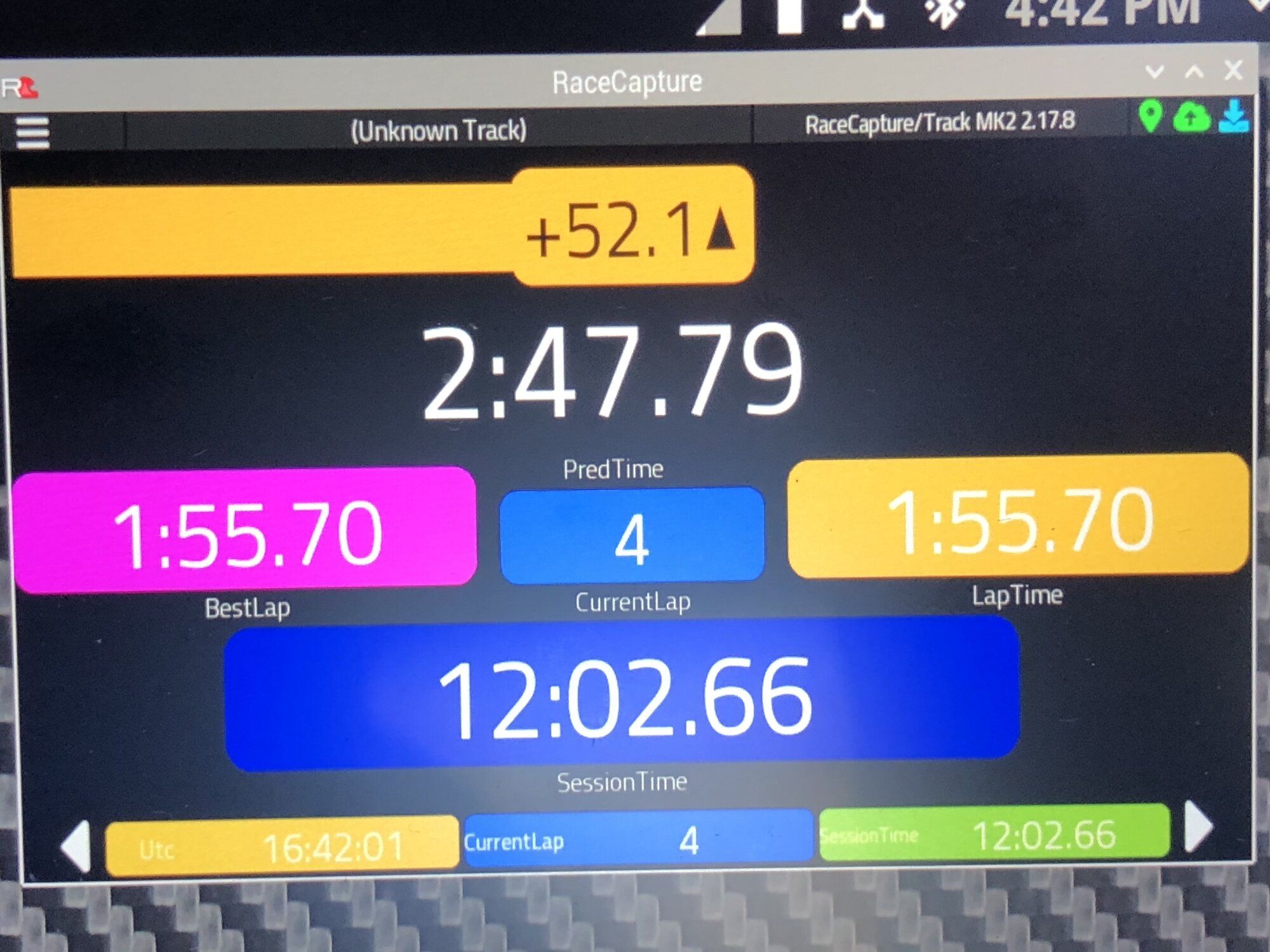

Running RC on a high resolution display introduces lag due to the video driver that the app is designed for. The developers are focused on running RC on devices or Pi3 run from command line as a dedicated setup (which is not what I'm doing). Shrinking the window size (or if connected to HDMI2) projecting onto a 2nd lower resolution display makes RC work much better. I also want to see if RC can "background" so I can put other controls on the flat screen while on track.
Here is a pic of my preferred way to launch on a single screen setup:

Anyway - It worked with the custom cat5 cable, and after I installed the corrected DB9 to RJ45 adaptor, it worked with a standard CAT5 cable. Sweet! Now why Race Capture podium put my "race track" in the ocean off the cost of Africa is weird.

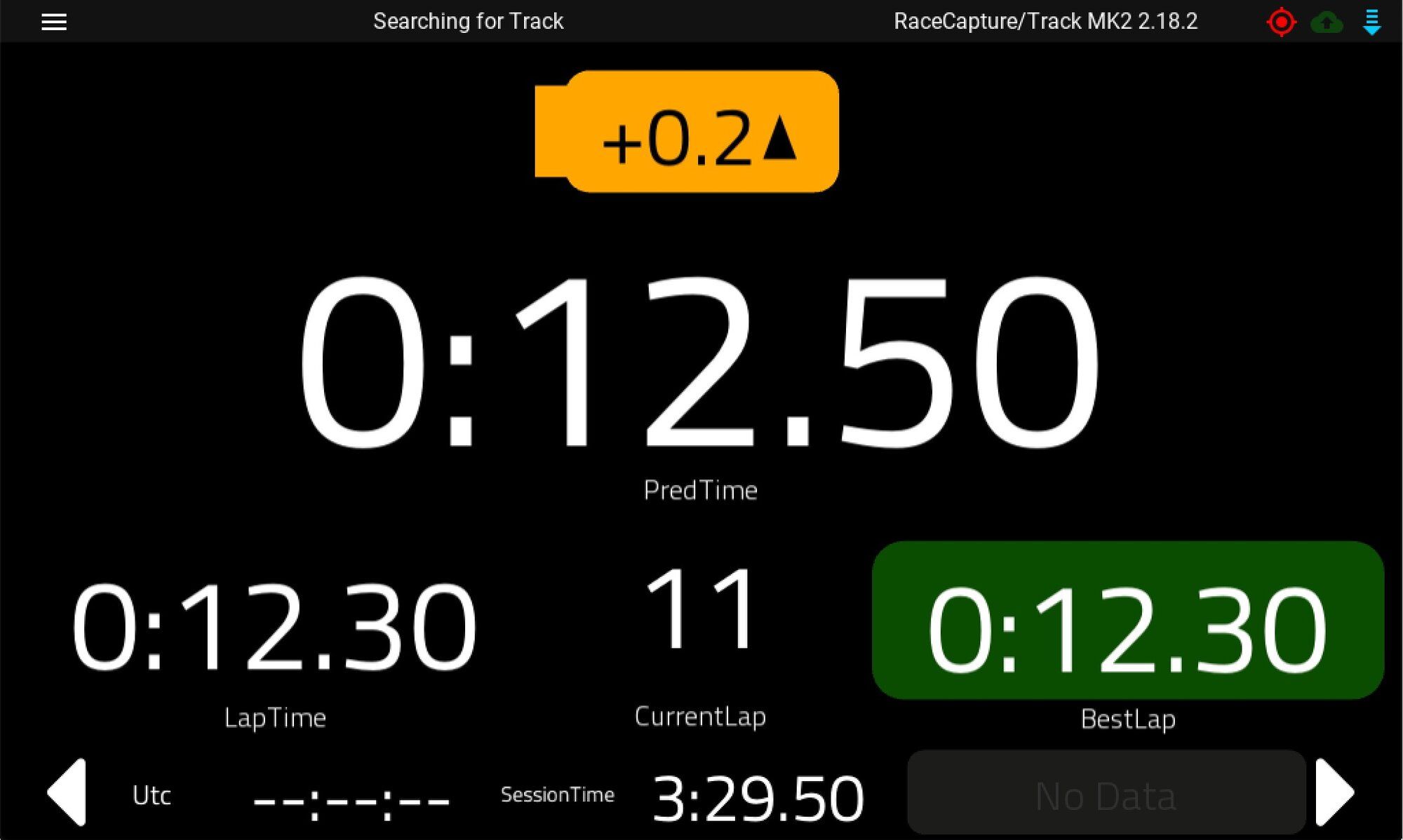

Being able to share a dashboard via uplink to podium is an awesome new feature of Beta v2. Here is my homage to the classic look from v1 Race Capture predictive lap timer.

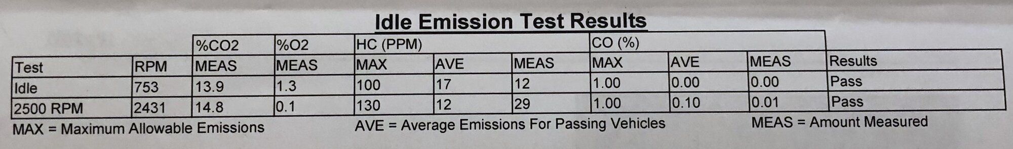

As a condition of its "non-op" to "regesterd for the street" rehabilitation - ITFLYS had to pass an annual SMOG (drug) test: Success on the first try.
This is California and anyone will tell you it takes attention to detail to make this happen.
Although - I do feel that an AWD 95' does have a little bit easier time than 2WD and later years. No dyno test (just a 2 speed no load test) It might be interesting to note, the test facility didn't want to connect to the OBD2 port as 95 is exempted from the ECU tests (news to me!)
