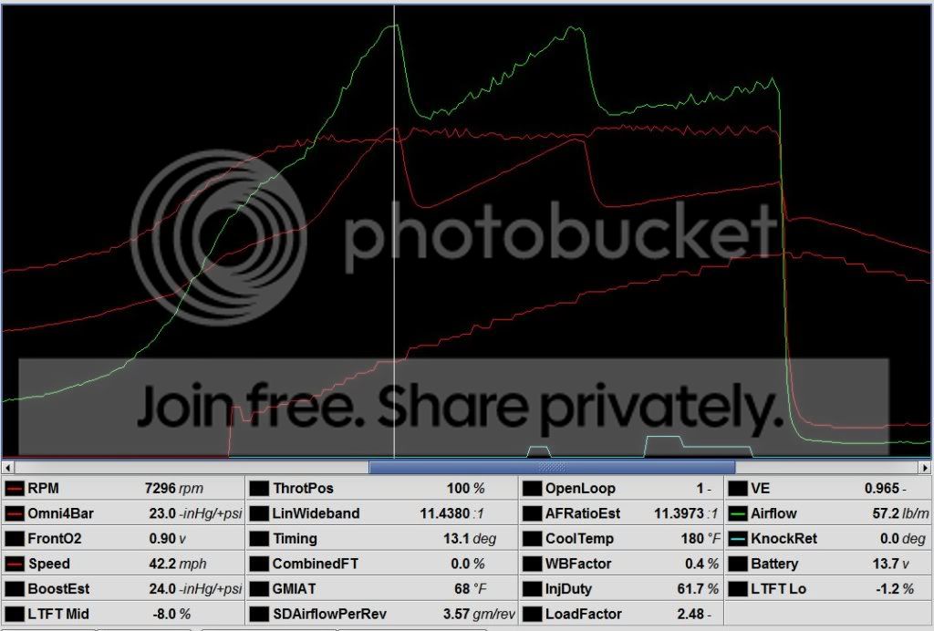

Here is the last pull before pulling the head (attached):
It was running really well at 25-26psi, ~58lb/min. It scratched it way to ~3.2s 0-60 spinning, full weight, full tank of gas and a passenger. It launches pretty well and doesn’t squat too much, I can’t wait to get it to the track on a sticky surface.
I never ran excessive timing. Timing near the torque-peak range of 4500-5500rpm timing was below 10* on the "high" timing map and ~5-6* on the low timing map. I never registered more than 1.8* of knock retard but it still lifted.

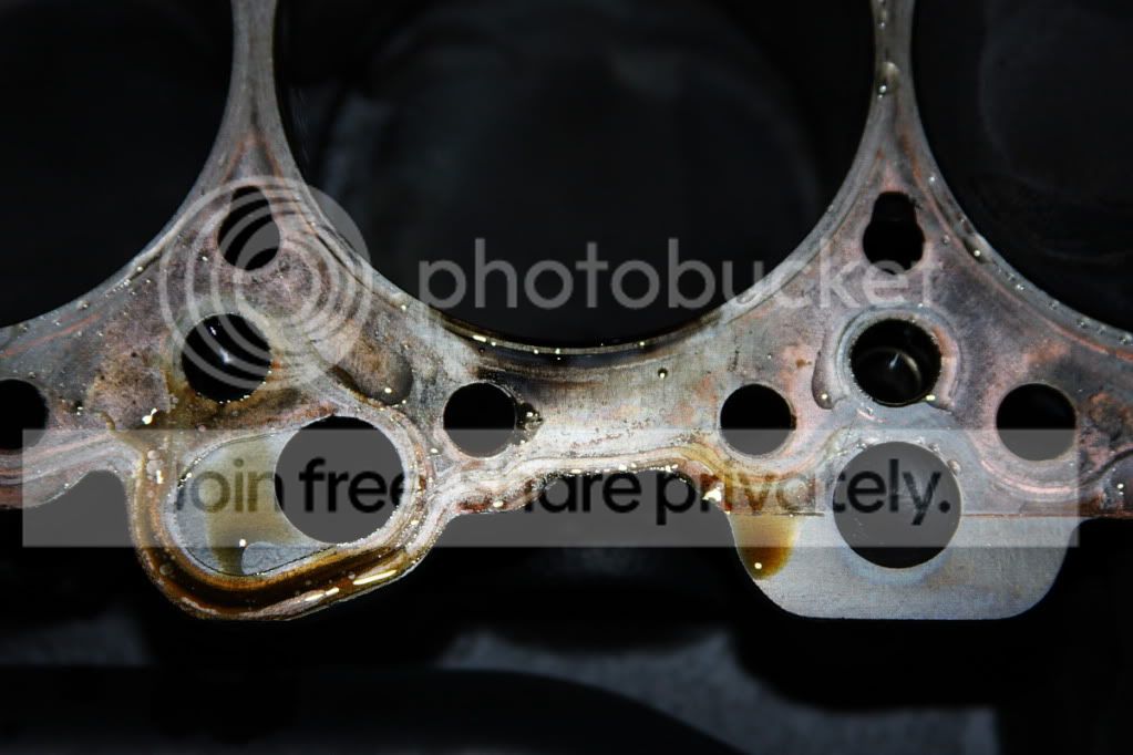

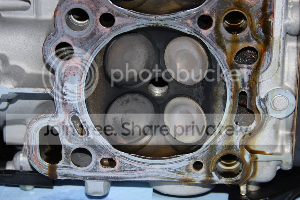

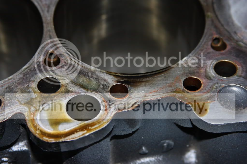

The #2 cylinder leaked on the block side of the gasket. Upon disassembly we noticed an issue with how the valves were un-shrouded: there is an overhang of the gasket that creates a hot spot, which would explain its low tolerance for timing (6* peak) on pump gas. I am looking for a gasket solution but unfortunately the chamfer in the combustion chamber comes very close to the fire ring. Cometic cannot move the fire ring and I am waiting to hear back from Fel Pro about the fire ring starting diameter. If neither of those will work a copper gasket is a possible solution, but not one I want to try very much. Another option would be to weld the chambers and re-machine it but that will be a last resort.
All of the cylinders looked good, perfect cross hatch and minor scuffing from the skirts but no gouges or signs of material in the cylinders. The ethanol was just starting to clean all the carbon up from the piss gas it was running on low boost.
