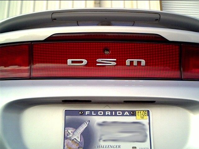

This is what it looks like if you don't try hard enough to disperse the light. This was an INCREDIBLY cheap attempt to do something like azdave's Eclipse. Something like 150 5mm LEDs in a plexiglas mount. I no longer have the car, but I will be trying again on my GSX paying a little more attention to dispersing the light and using better LEDs. I will have to keep the name LumiLEDs in mind.
