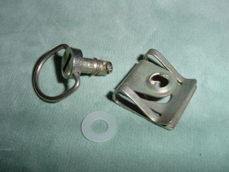

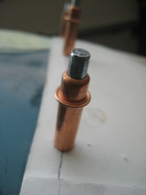

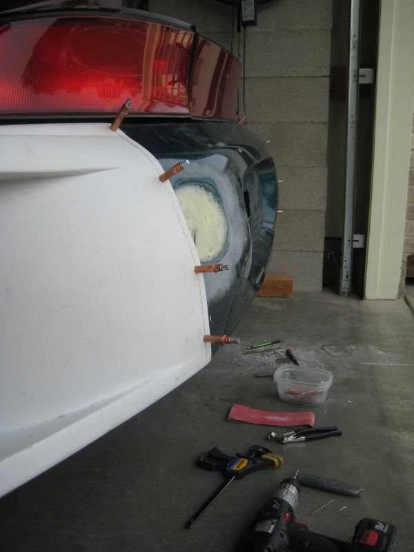

One rear fender is done. I used less fasteners to cut down on weight since I'm using Dzus clips and not rivets to hold them on. Also took a pic to show what the back side of of the dzus fasteners look like when they are locked down.

What do you mean by you used clips instead of fasteners? I am new to the concept of Dzus and like what I see so far. How do the clips differ from the rivets/spring type you used on the front fenders? You have photos?
This is what I see when I google images, so I am just having a hard time seeing how you used those on the unibody rear.
Sorry that was not worded that very well.
The kit was originally designed to be held in place with large head rivets. It has pre placed holes(indents) for the placement of them. Since I'm using Dzus fasteners I decided to make my hole in different place and use less to help cut down on the overall weight. Rivets would be lighter but removing the fender with easy seems more important to me.
You can look here and see I used the same type of dzus fasteners.

A few post down you can see a pic of th backside of them mounted on the car.

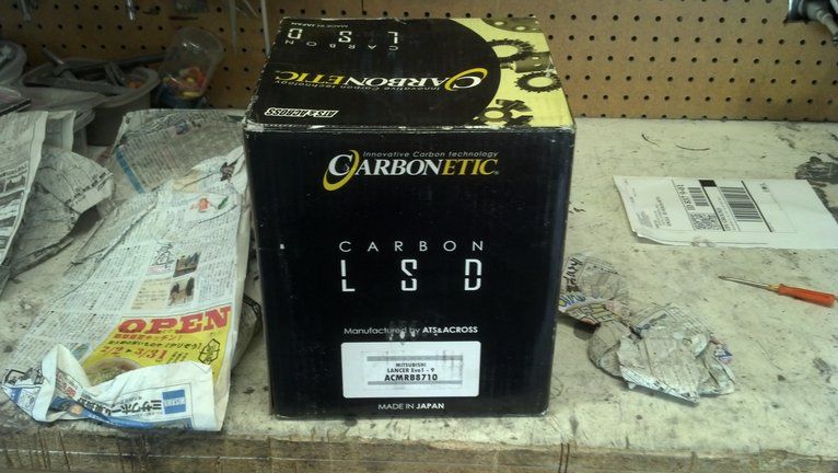

I did pick up a killer deal. It was way down on the list but for the price and BNIB, it could not be passed up.
Now I need some Evo 8 inner axle cups.
Big thanks to John for letting me know about the for sale ad!

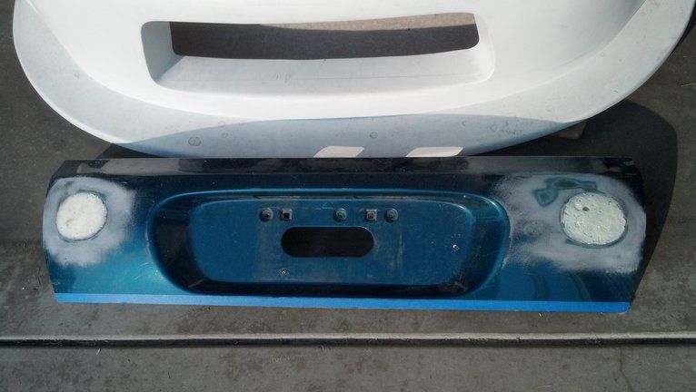

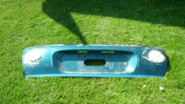

Working on filling the reverse light holes in preparation for building the fiberglass version.

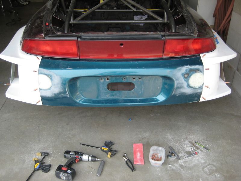

Cleaned up the over fender edges and layed out the holes for the Dzus fasteners.

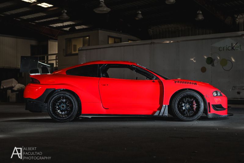

We have been playing Virtual dress up with my car thanks to the help of Brain Loose (snowboarder714) . He went above and beyond and did my car in three colors and three style. Then an email was sent to 12 of my very good friend whom I trust and value to give their honest opinions on the colors. Out of all twelve everyone picked the red combo in some form. It should be noted few if any knew what the others voted for. What really rocks though is it is the color scheme I had picked before from the very beginning of the project. Paint is a long ways off but I'm pumped so I thought I'd share the pic he did with you guys.

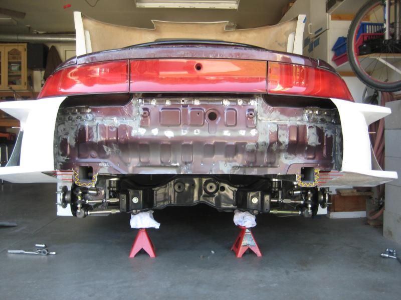

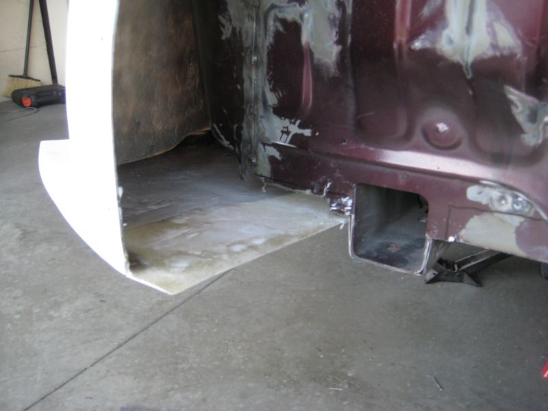

The fate of the rear center section has been decided. This area is a bit of the kit I have never liked. Andrew's car has a large vent in the center to reduce drag. With the help of Brain I played around with a few vent designs and hated them all in the end. In an attempt to clean up the look a bit the indent for the license plate will be filled completely along with the reverse lights.
To reduce drag custom wheel wells liners will be built to seal off that. The area directly behind the wheel wells will be extended to meet the frame rails.(marked in red on the pic) The center section will be sealed against the sheet metal across the back. The area marked in yellow will be removed just leaving the metal tube.
A few pic to show what I'm talking about and the problem areas. This will be about 100x more work that just cutting a vent but the end result will be better. Should be fun too. Custom sway bar end links for the rear are being built too.

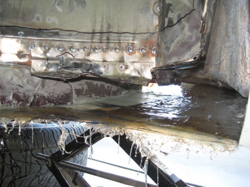

The rough stuff most don't show.

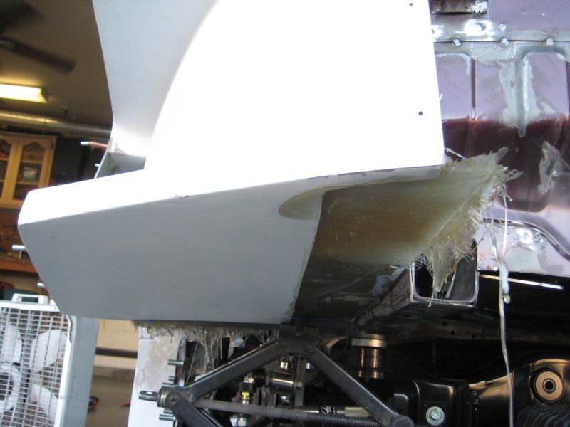

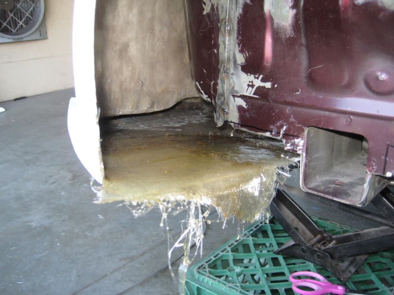

I started doing some of the glass work. Adding on to existing glass work is a pain. Every existing piece has to be dewaxed then sanded (36 grit) and the wiped down with acetone before you even start.
The area I had to work in was darn tight. You can see the on the fly adjustment (noticed bent to hell flap on metal) had to be made to even get the glass and resin in toward the back. I also played with a chopped strand mat and can tell you I hate it. woven fabric is much easier to work with.
A piece of waxed plexi glass was used to make the underside smooth and easy to release. I also used painters in the transition area where the angle need to flatten out near the wheel well. I'll take better pics of the set up when I do the other side. Next up is shaping and smoothing. Remember I'm making this stuff up as I go. :p

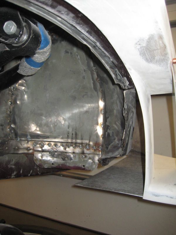

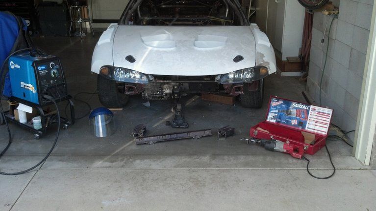

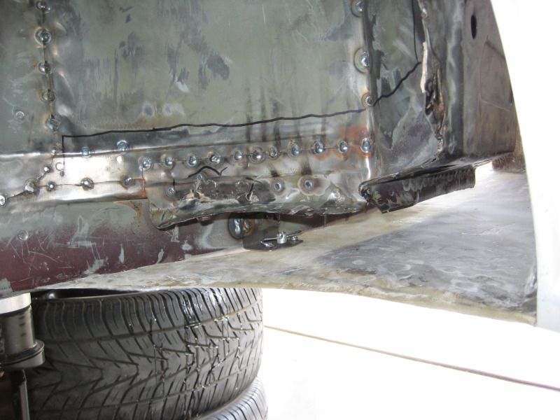

Cleaned up a bit. mounting bracket fabricated and welded in place. Welding could be better. My gas ran out and I had to re weld. Blah. It's on and it's not coming off. Next is more trimming and then build the first wheel well liner. Should be fun.
