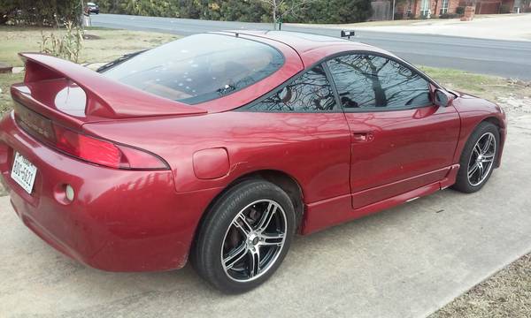

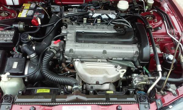

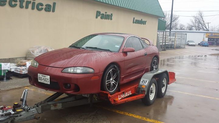

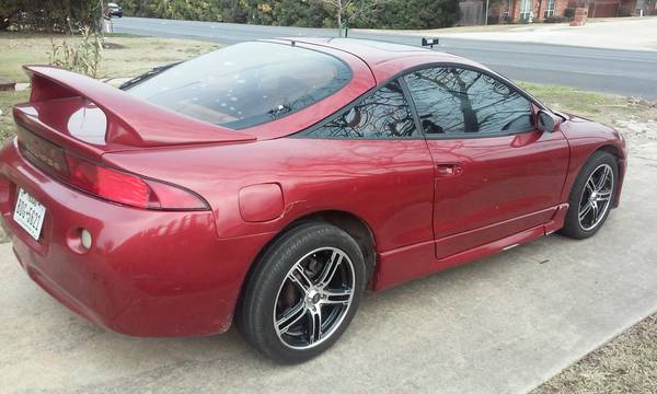

I found a 97 Eclipse for $700 bucks and went and picked it up. Guy didn't even know it was a GST! Only thing that had even been done to it was fender well was cut out on the pass side for the intercooler, and rims other than that bone stock with all factory parts.
The bad: leaking rack and pinion, clutch kinda works, shifter was sloppy, broken tail light, broken BOV, small oil leak from filter housing and a few other nit picky things on my end.

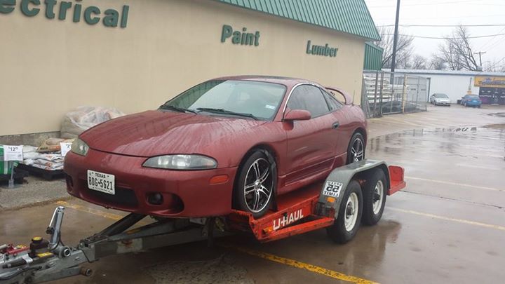

Bringing it home.

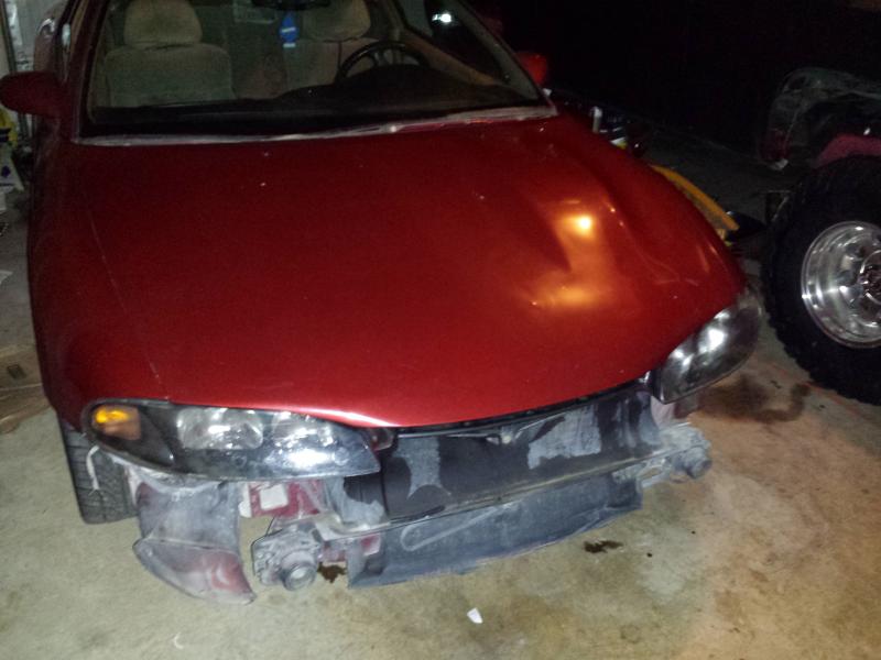

Can see the broken tail light in this pic

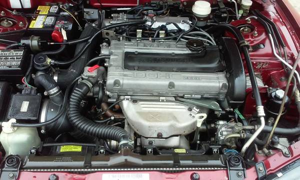

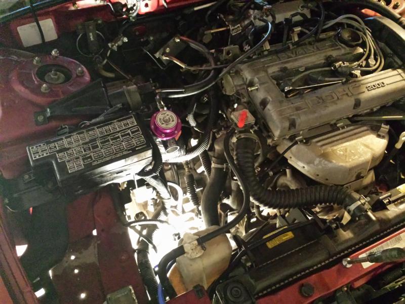

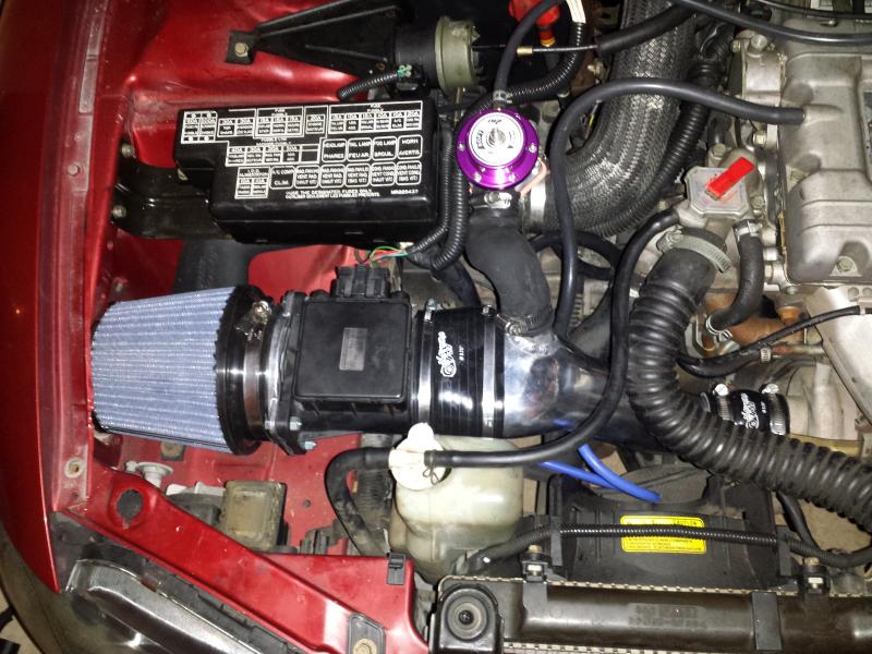

And the stock engine bay complete with shotty BOV fixed with JB Weld or something

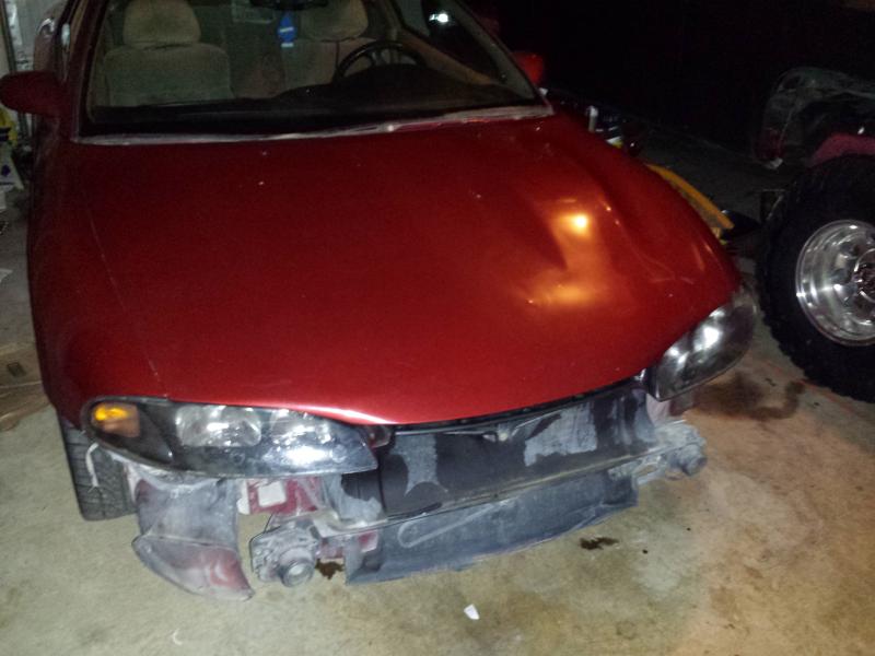

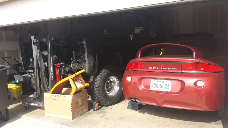

Got it in the garage and got the tail light fixed first thing on it the next day. Also have another set of stock tail lights I bought for 15 bucks and just waiting to get them in to try some things out with them.

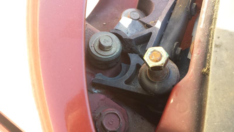

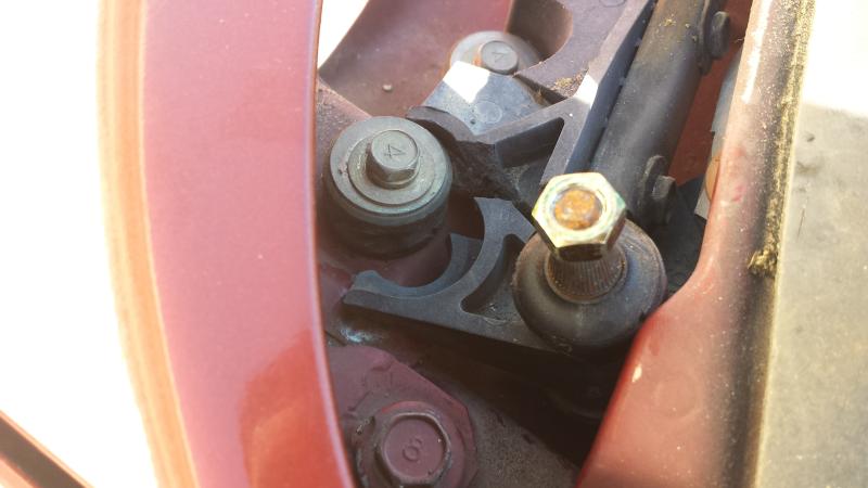

Got the new NGK 7131 plugs in it and took out some shotty e3 plugs and noticed my wipers were all sorts of jacked up and found this, got one on the way from cali as its cheaper than any local yard could match

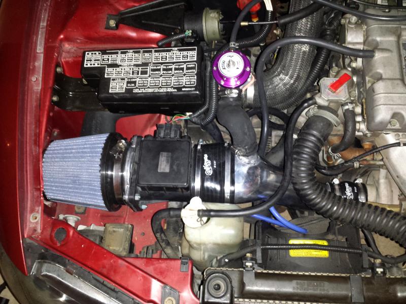

Ordered a extremepsi intake kit and NGR BOV to fix the broken stocker and keep it recirculated instead of to atmosphere and did the BCS mod while I was at it.

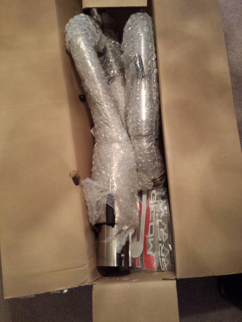

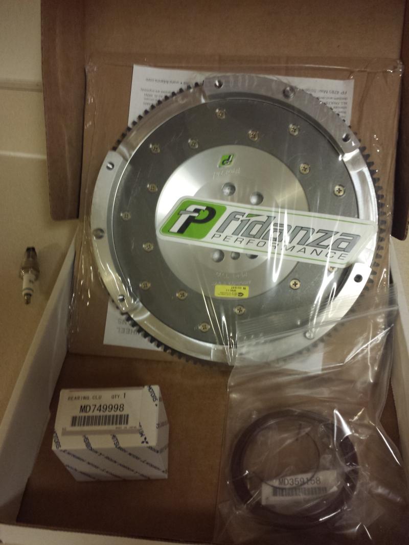

Still waiting on my SRS cat back exhaust to get shipped will be a week on Monday since it was paid for. Decided to not use the stock flywheel and ordered a Fidanza aluminum flywheel from extremepsi along with the OEM release bearing, bearing clip, and OEM rear main seal (might as well do it while its apart) which all those parts will be in this week. and how it sits currently waiting on the above mentioned parts.

well fidanza and oem parts will be here tomorrow, gauges and pod will be here friday. and the exhaust who knows when since fedup fedex has lost it twice in a week.

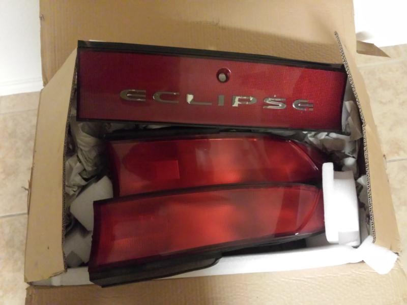

got some more parts in, another set of tail lights for some custom touches, the ones on the car will be staying oem and no mods,

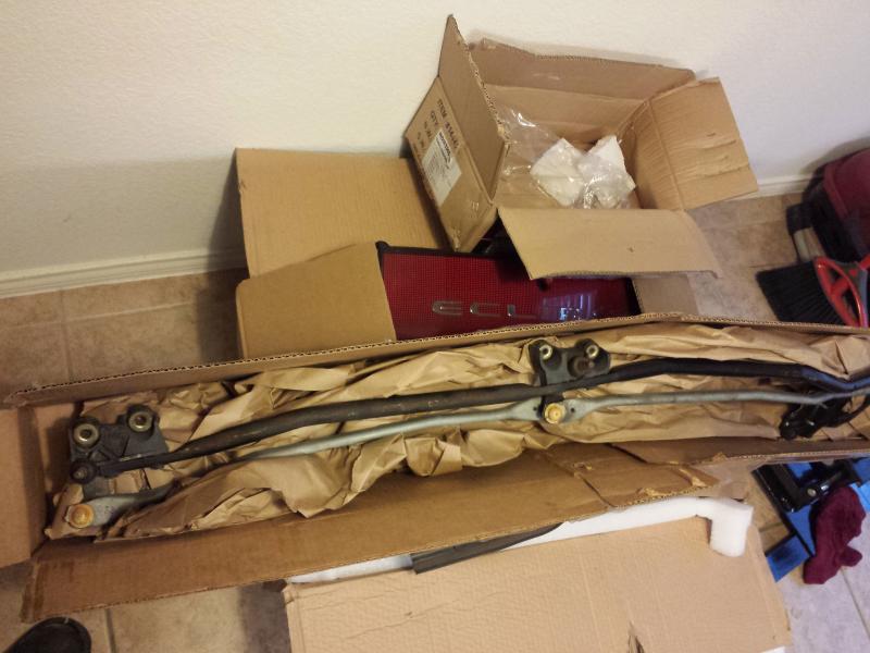

wiper linkage
exhaust

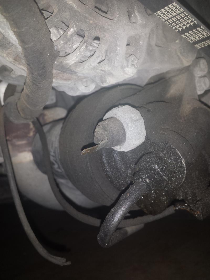

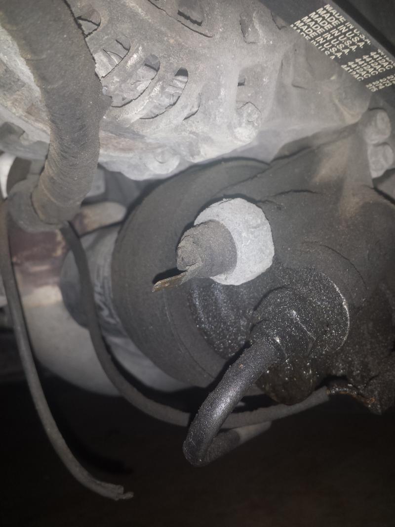

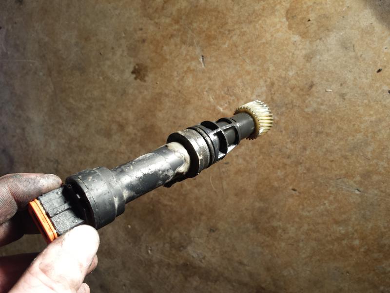

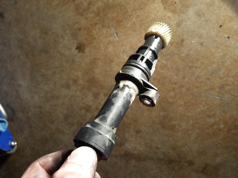

Figured out why the speedo wasn't working somehow somewhere they broke the speed sensor and thought jb weld would fix it like they did with the bov.

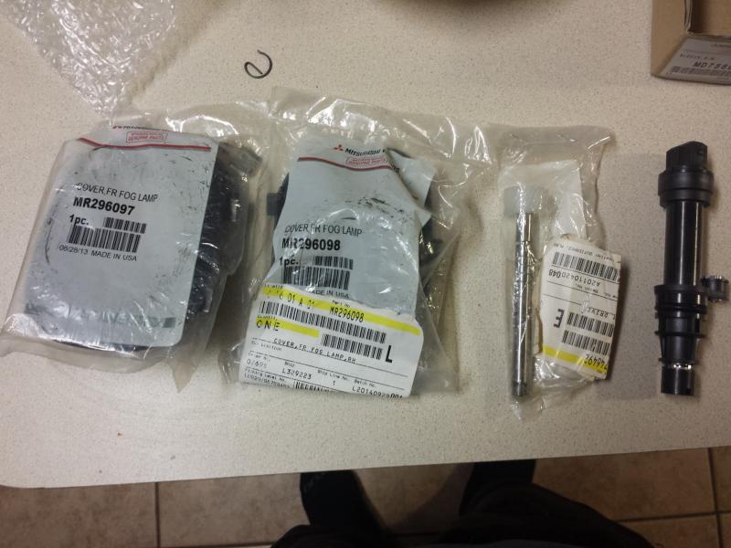

Well finally got some work done on the gst today after getting off work, sway bar yanked out, new wiper linkage installed, fender light installed and wired. then another few boxes showed up past week. Oem parts two from extremepsi and other two from a discount Mitsubishi dealer in dallas.

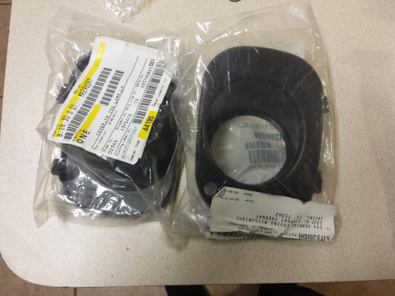

Oem bnip fog lights!!!
will be keeping them off the car and fabricating some replacments out of aluminum to keep the oems nice and shiney.

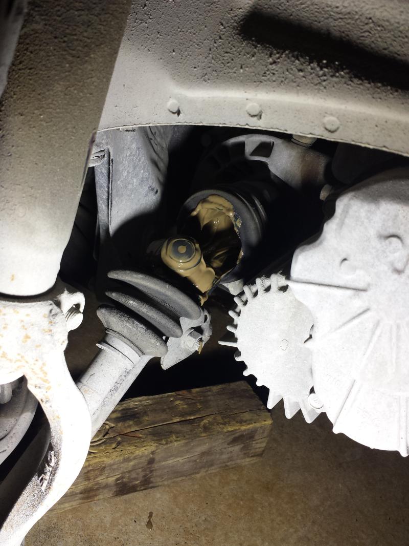

and room mate came out and helped for about two minutes and the aftermath is two broken cv shafts which i need to order now.

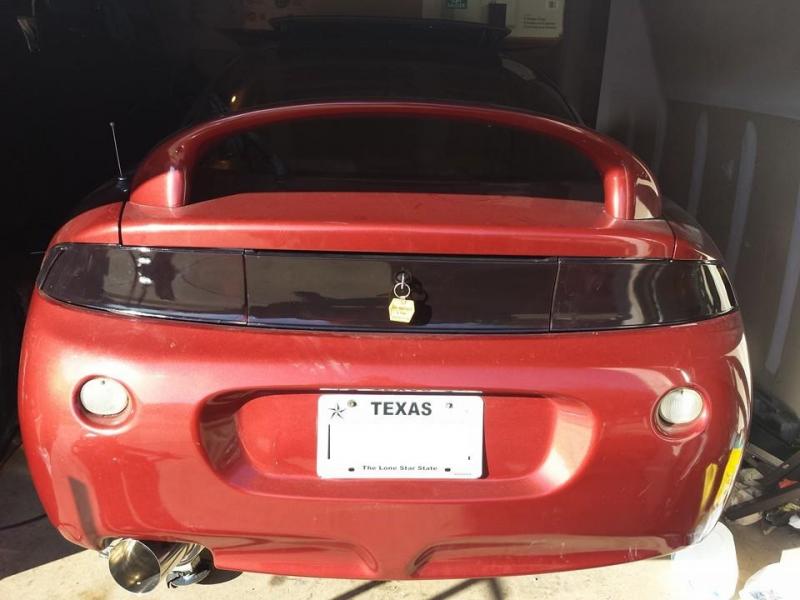

then tinted a set of the tails i have for it still debating if i like it or not.

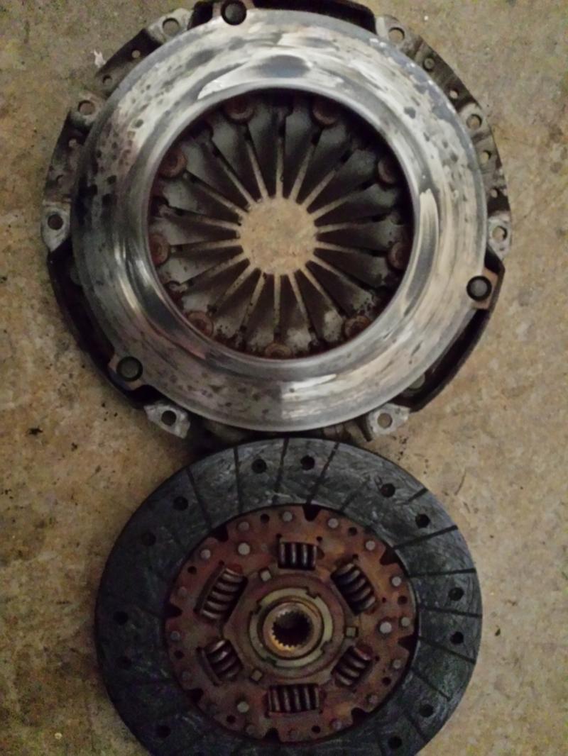

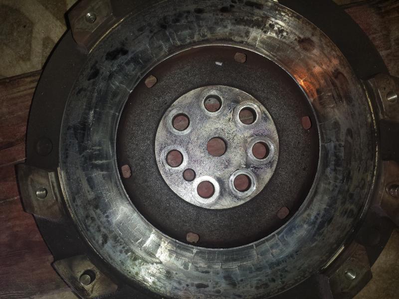

Was finally able to get the trans off and so on just waiting for my gf to bring me my tube of gray rtv for the rear main seal housing. And glad i bought a new fly wheel as this one is a goner.
some of the cracks go all the way through.
and pressure plate and clutch.

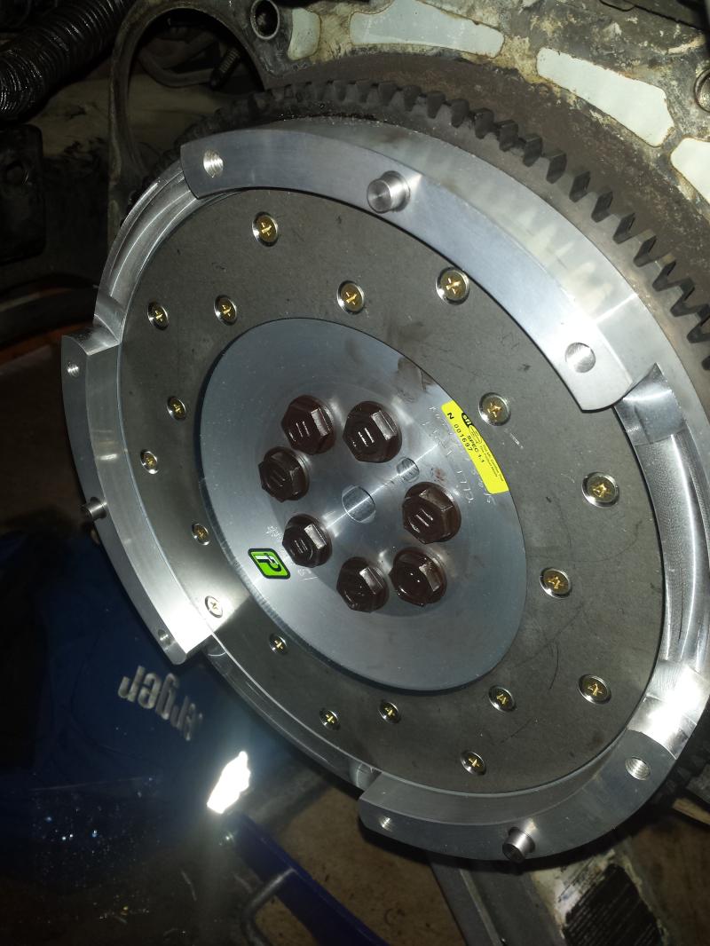

Well finally got it all back together, took it for a spin and was fun even not being able to get into boost to much due to the new clutch. took a few hours for the rack and pinion due to having huge hands and small areas to get into. Liking the aluminum flywheel and the srs exhaust sounds great, just have to get it to pass smog and inspection after that the catless downpipe will be going in along with the gauges and waiting for my truck to sell to get some xxr wheels for it to replace the enkeis.

bringing it home.

and the stock engine bay complete with shotty bov fixed with jb weld or something

Got the new ngk 7131 plugs in it and took out some shotty e3 plugs and noticed my wipers were all sorts of jacked up and found this, got one on the way from cali as its cheaper than any local yard could match

ordered a extremepsi intake kit and ngr bov to fix the broken stocker and keep it recirculated instead of to atmosphere and did the bcv mod while i was at it.

put a few more miles on it yesterday along with another oil change, went to put the wiper arms on and bolts got lost before i started the clutch work and have to order a new wiper arm as when the linkage broke it rounded out the inside of the driver side arm.

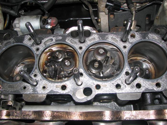

Great job and $700 was a steal for sure! Did you check the timing belt? If you're not sure when timing belt or the tensioner was replaced then you should definitely put that next on the to-do list. I recommend using OEM belt & tensioner. Be sure to replace the balance shaft belt as well. Yeah I learned the hard way about 7 years ago. Failed timing belt tensioner = bent or destroyed valves
It all looks fairly new, But once its fully legal back on the road I might tackle it myself or take it over to alamo motorsports and have them do it, will be doing new lifters at the same time.
got the wiper arm installed, installed a different set of fog light bezels to keep the others in the package (gonna hold on to them bnip) and also got the passenger door handle replaced only took about 15 minutes and two zip ties to make it actually allow the door to unlatch
