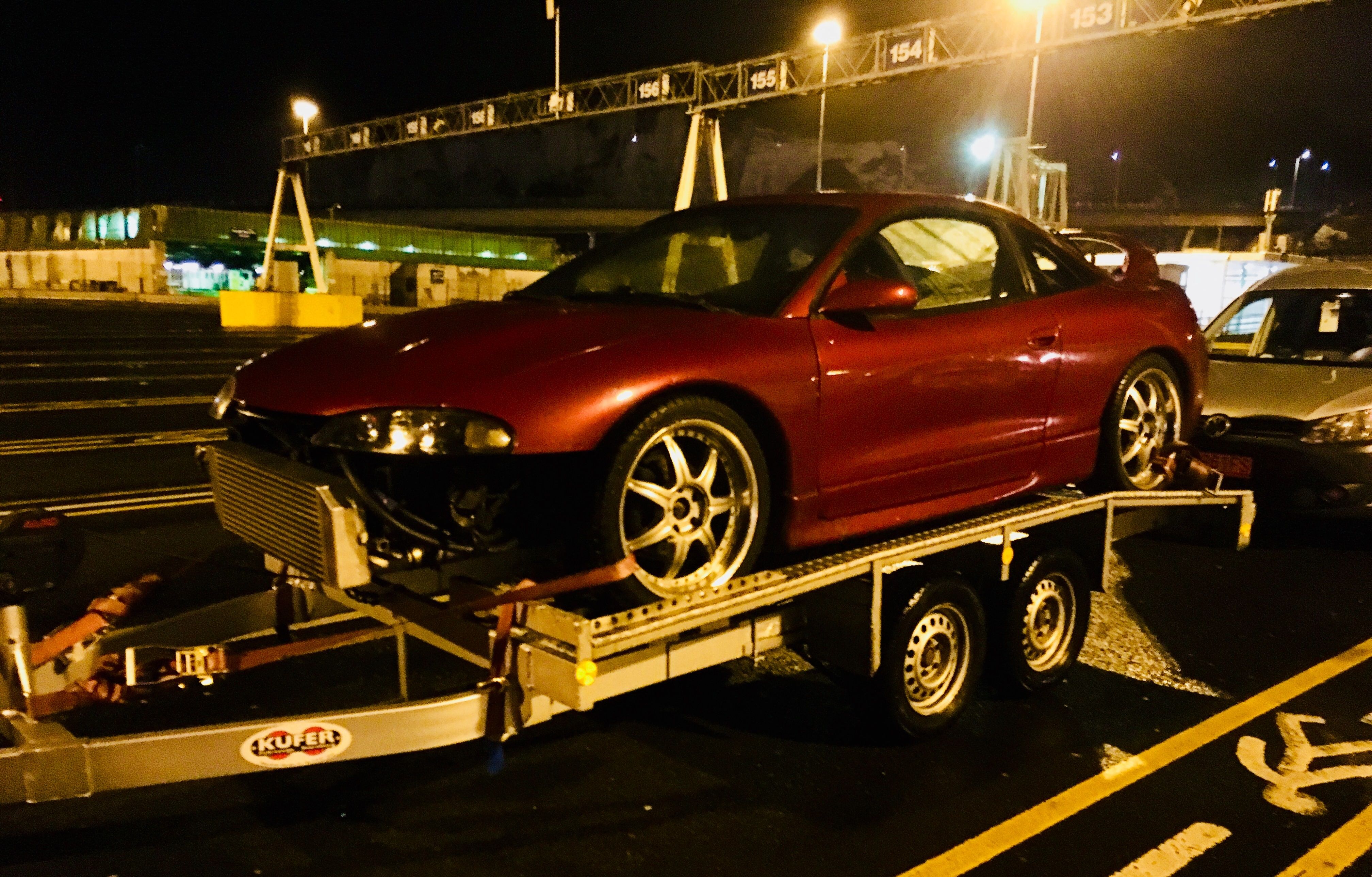

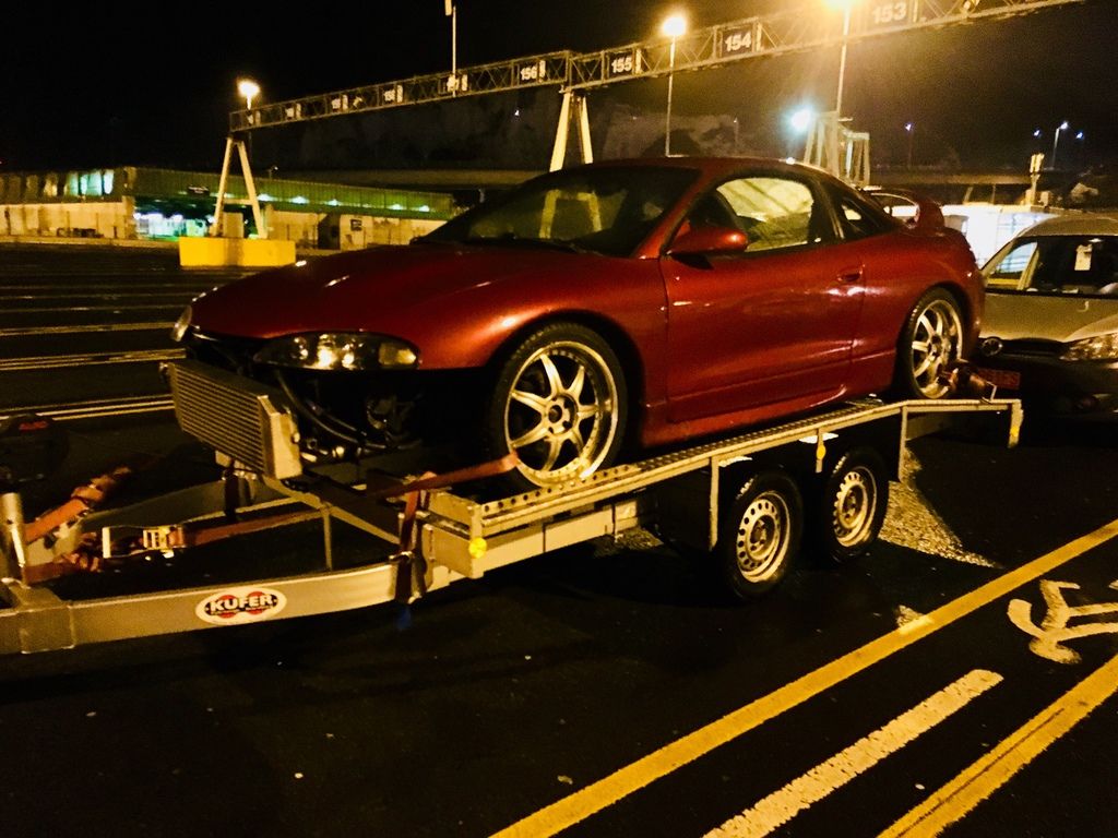

Hello folks, I'd like to introduce my 97 GSX.
It is altogether my 3rd 2g but my first GSX. Mitsubishi never officially sold the GSX outside the USA, so they are extremely rare in Europe.
I picked up the car in January 2018 in England and restore it so far to get a road registration here.

Dude, jes I got it from Alex. Than you know that the car was in really bad shape... but no chance to find a better in Europe for that price

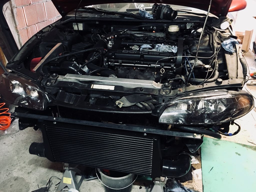

Ebay turbo with external wastegate exchanged for OEM EVO III turbo with EVO manifold. New intercooler is inside, black powdered but so that the mesh is not coated inside.
Stealth optic with minimal heat transfer losses.
New piping, and vacuum hoses are all new and pressure test up to 2bar successfully passed.

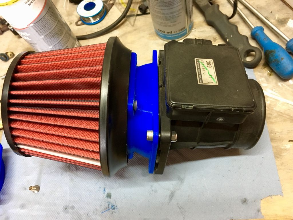

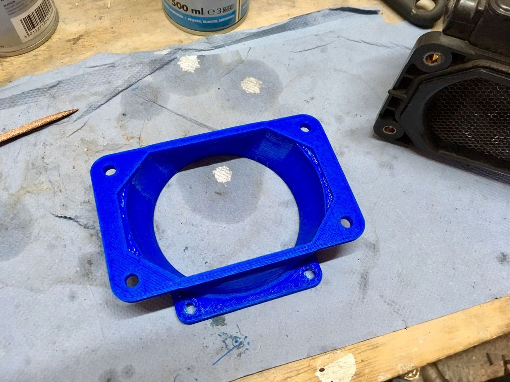

Then I designed an adapter to adapt an Apexi air filter to the EVO VIII maf. I don’t like SD.
A colleague of mine has a 3D printer...

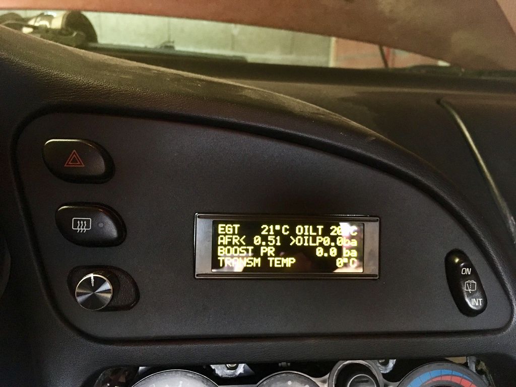

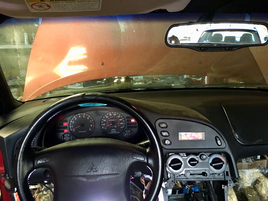

The highlight of the interior is now the digital multi display with OLED.
Now I can display 6 values at the same time. Furthermore, the controller box loops the signal of the whideband lambda into the ECU, so I can log the signal in parallel with ecmlink.

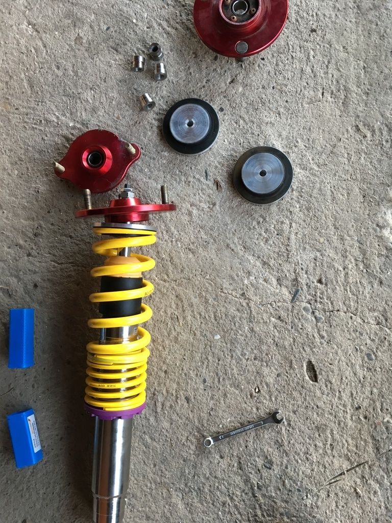

I ordered KW V3 coilovers with stronger springs directly from KW.
The problem is, they don't supply upper dome mounts and if you take OEM, the spring is always normal(90°) to the bearing surface, which is very bad. But I think all of you know this article from farnorthracing ;)
So I used upper spherical bearings from an Megan Racing coilover set and added an spring seat disc on it. Last thing, I needed some sleeves to adjust the diameter from the uniball to the piston rod.

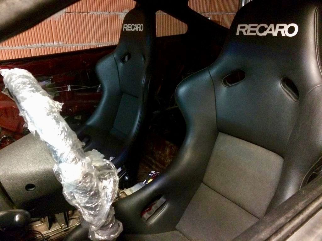

The interior carpet is inside again and the seats too. Unfortunately I had to screw these rigidly with the body, because otherwise with sliding rails I does not have enough headroom with a helmet on.

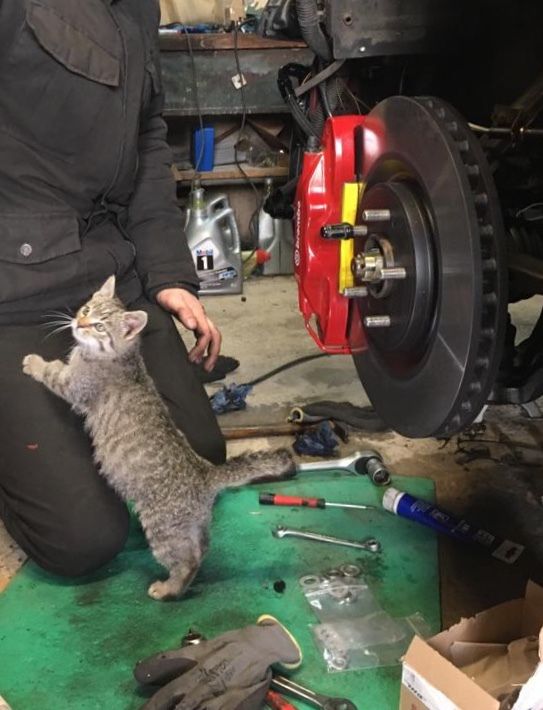

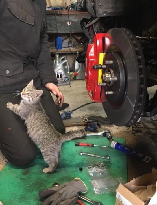

The last thing I did was to upgrade the brake:
Front: Brembo from EVO X with dba discs and Pagid pads
Rear: Brembo from EVO 8 with dba discs and Pagid pads

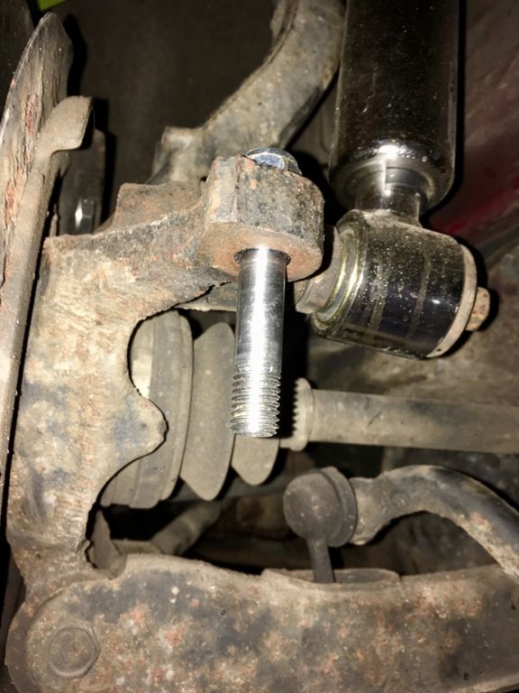

For this I had to drill the JDM knuckles out to fit the M14 bolts and ordered some custom brake lines.
Cat for scale

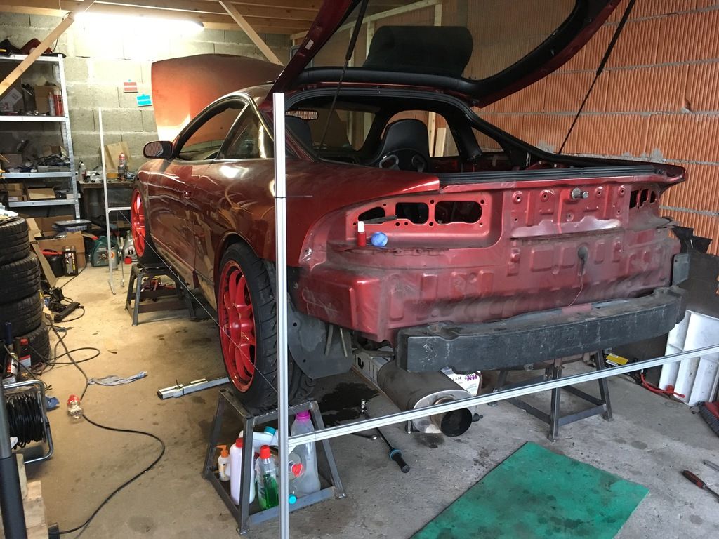

Unfortunately I can't get into the area where I want to go with the OEM eccentric bolts.
Therefore I still have to build myself adjustable wishbones and toe arms...

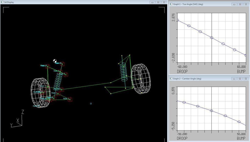

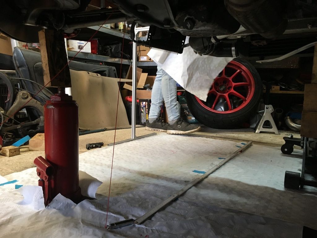

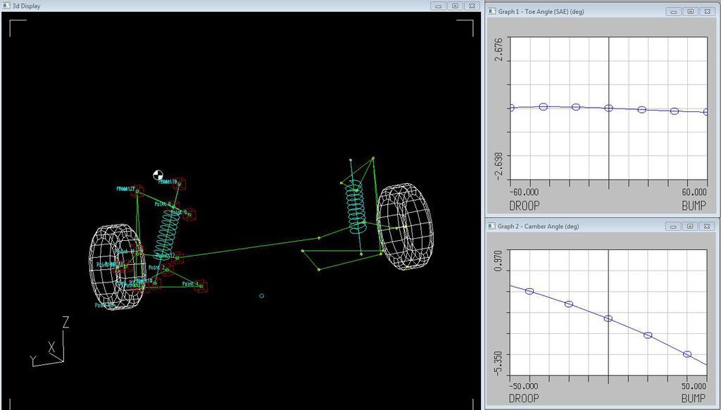

Now that I had a wheel alignment that fits at least halfway, I started to measure all suspension points of the car. Therefore I created a coordinate system under the car and measured ALL points of the chassis with plummet, laser and ruler.
Now I can simulate my suspension and calculate where I have to move the toe rod head to minimize the bump steer for example.
before:
after:

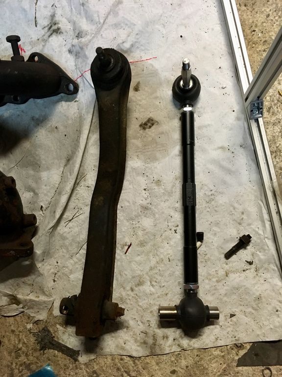

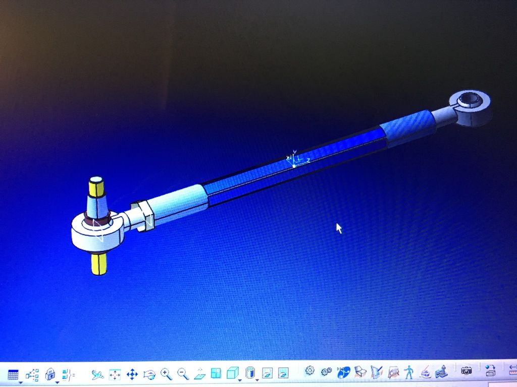

With the calculation results I could now construct the rear toe arm.
Fascinating. I think we all agree this car has finally ended up in the right place! I'm curious as to why you're making your own toe arms instead of just buying aftermarket arms?

There are several reasons why I build the suspension arms myself:
- I come from europe, there are NO parts for the GSX here and shipping from the US is relatively expensive.
- I come from europe, we have the metric system and I do not want to buy imperial screws
- Some aftermarket parts are made of aluminuim and I personally think it is too dangerous to use aluminium parts as suspension arms because of the fatigue strength
- If a part should break, I can simply build me a new one and also the uniball joints with metric thread I can simply get here

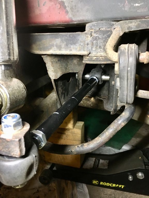

So the rear toe arms are ready!
It was most complicated to adapt to the outer knuckle, because here you need a cone that has to fit exactly.
The cylindrical part serves as a guide for the outer joint and is calculatingly made longer so that the height of the steering head can be adjusted using washers. Depending on the lowering and what the suspension analyser calculates.
The rest is done quickly, a few bushes and a tube with one right and one left thread (metric of course ;) ) each for the uniball joints.
So you can change the length of the arm simply by turning it and adjust the height with the washers.
I also save 600g per side! Although everything is made of high-strength steel.
If some one is interested I could do some parts more ;)

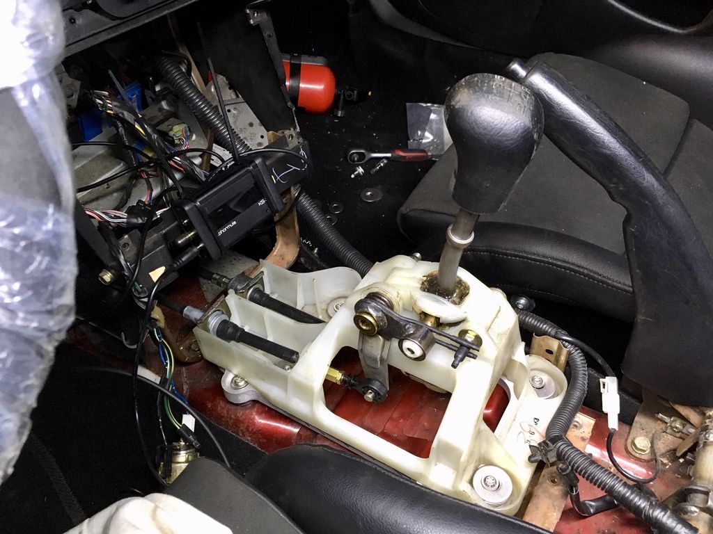

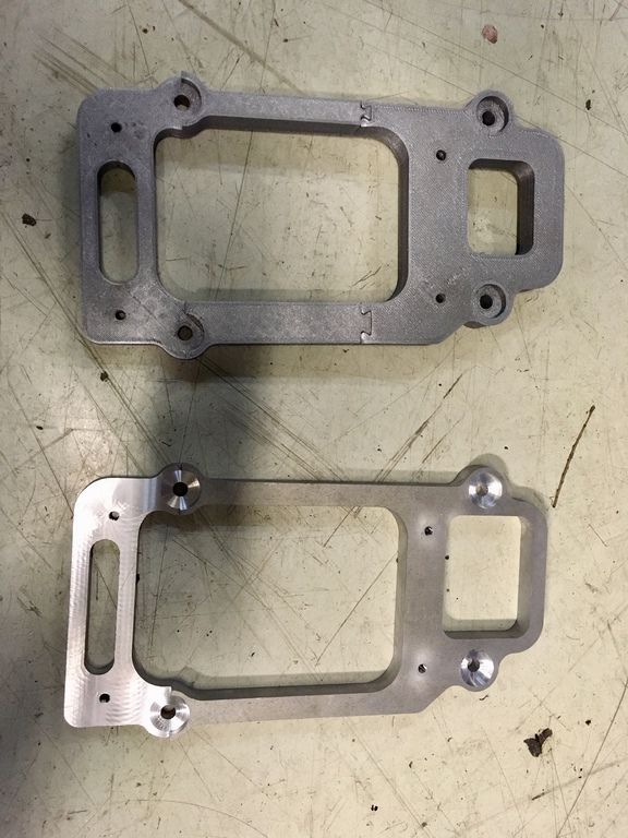

What always bothered me about the Eclipse was the terrible shifting feeling, which didn't get any better with short shifters.
That's why I modified a shifter out of the EVO 8 and mounted it in the car with an adapter plate.
Here is a picture of the adapter: first prototype made of PLA at the top and final part of aluminum at the bottom. The gearshift cables are also custom made and offer the possibility for fine adjustments on the gearshift lever. That was with one of the best mods for the car ever! Feels 10 years younger... really precise now!

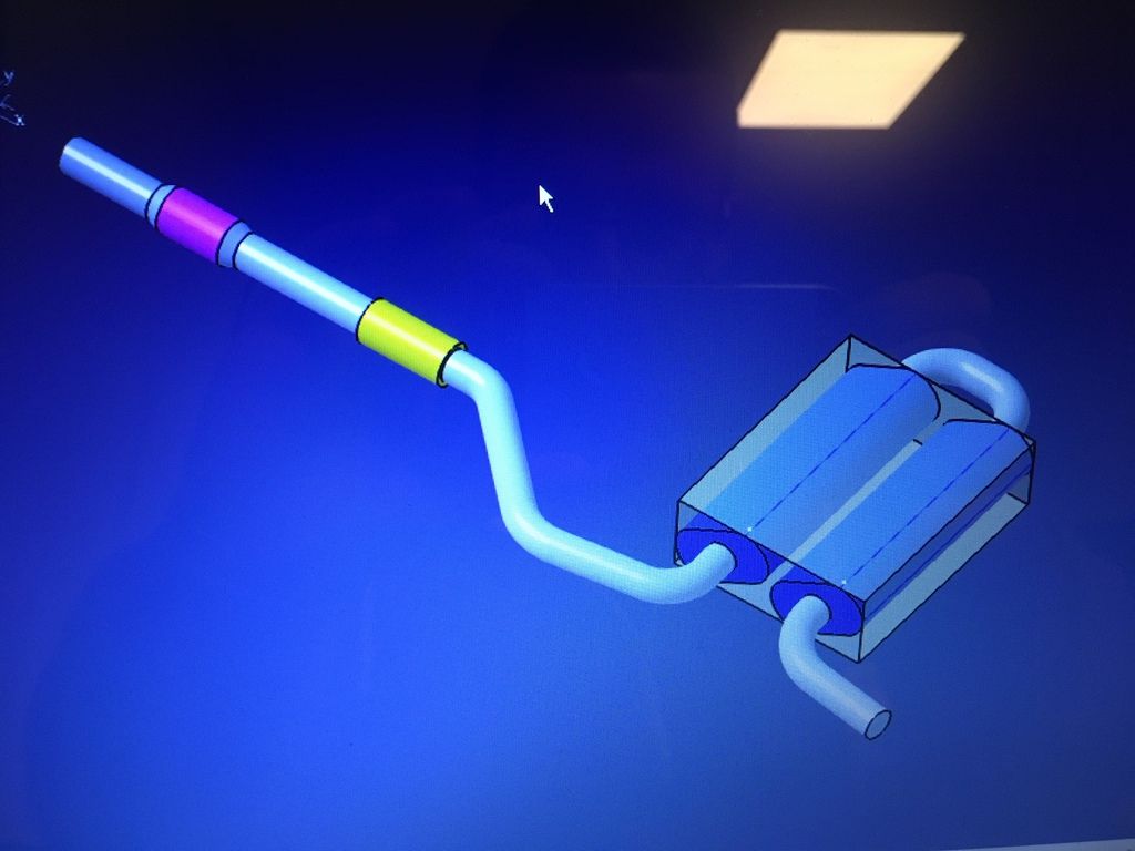

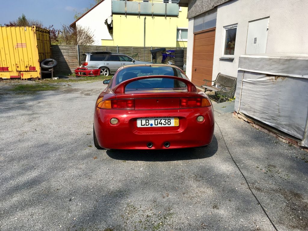

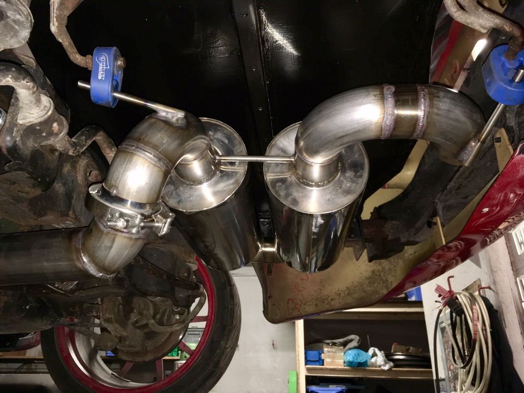

Since I wanted a road legal car in Germany I had to something with something with the exhaust. It was straight pipe with Magnaflow muffler, which was abnormally loud. So I designed something new, which is quiet but not too restrictive to be able to drive 500HP.
In the same step I satisfied my symmetry love and design the new exhaust as a central exhaust.

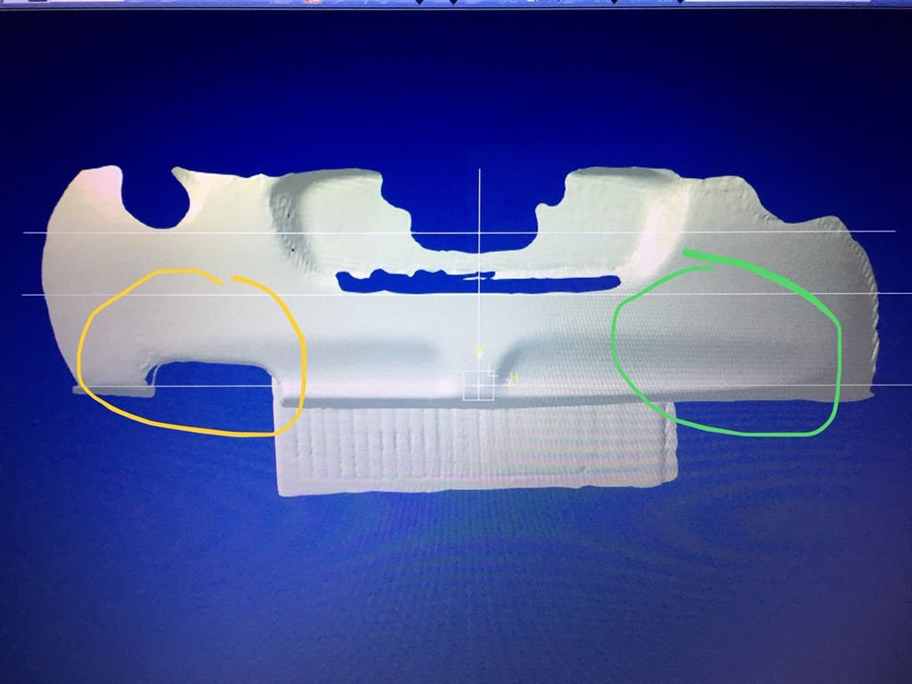

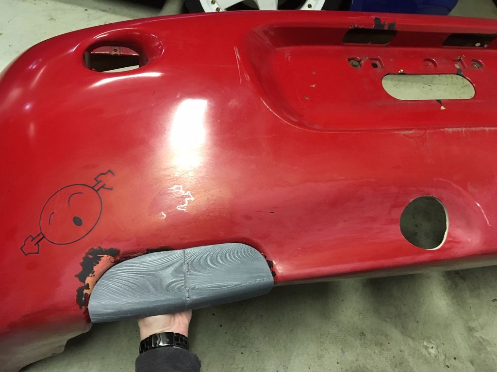

The problem was how to get rid of the original exhaust cutout?
The bumper was scanned in 3D so I was able to print a cover which closes the hole. After three tries I had a matching cover made of ABS which I glued and riveted onto the rear bumper. After the painting there is nothing more to see of the hole and the bumper is perfectly symmetrical.
Finally a GSX more on German roads!
