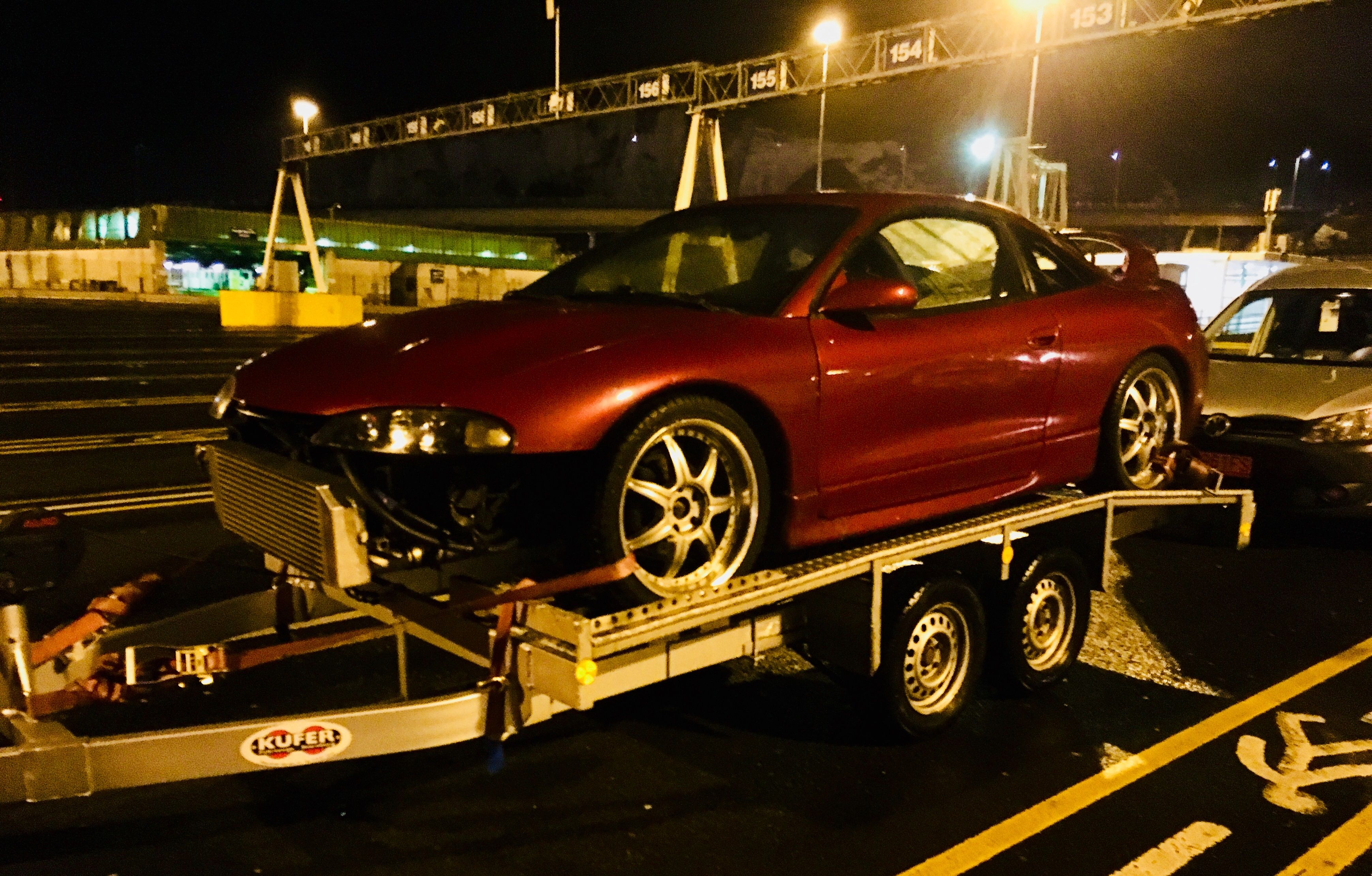

The front wheel is standing and the rear one turns?!
Correct: I now have a RWD Eclipse :cool:

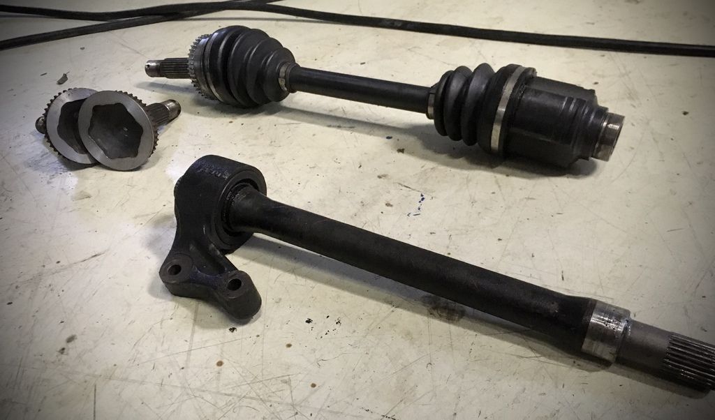

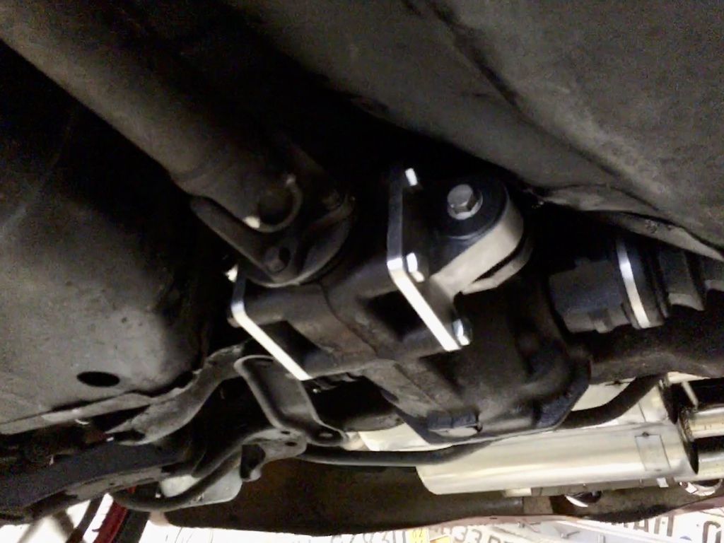

I welded the center diff of my spare EVO III transmission and upgraded to an 300M output shaft.
I also milled some FWD axles to preload the front bearings and plug the transmission exits.
It is amazing how much weight you safe without the front axles :D

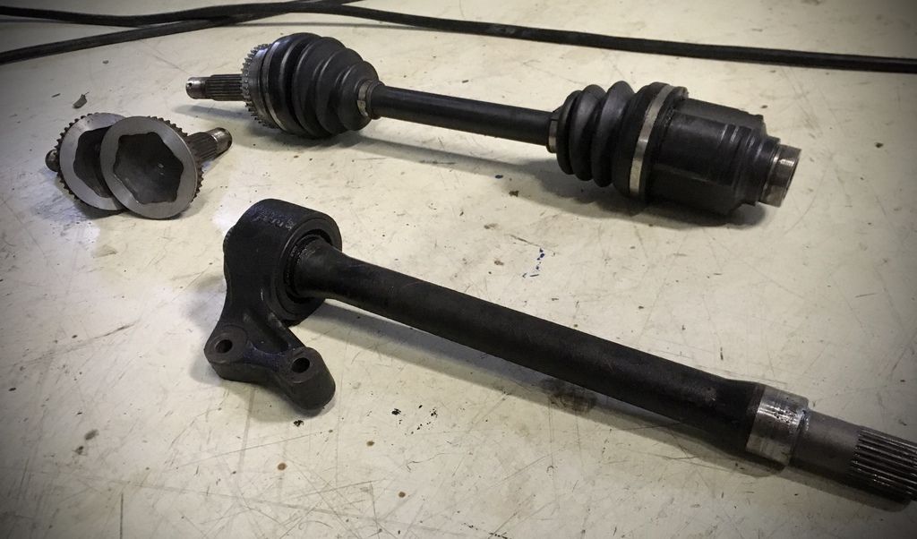

Also, be careful the rear diff is pretty fragile when people do this rwd mod.
RWD??!! That's awesome man! I love all of the custom parts you are making. Super cool build. There may be less GSXs in
Germany, but that thing would stand out in the US! Great job man!
