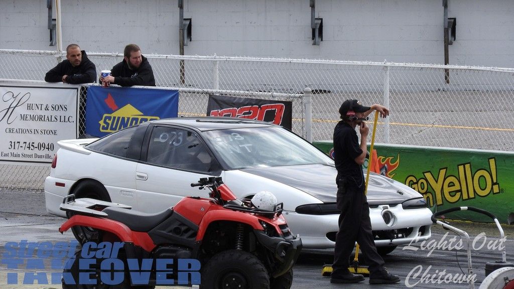

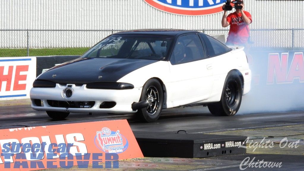

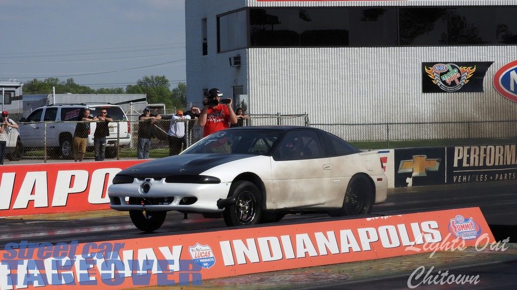

Looks like a nice drag build, good job! Whats the weight & balance now?
Thanks, the weight is around 2200 with out driver and the balance was not great when I scaled it so i will likely have to shift some things around.
As for the issues with the AWD setup the most common breakages were transmission gears and transfer cases. The chassis did work very well AWD with the solid rear end, it would go consistent low 1.2x 60'. The main reason I switched to RWD is to get more reliability. The cost was less to do it with a 2 speed PG than it was to switch to a 2G auto trans and use the Hollands performance aftermarket gears and new converter plus the cost of spare 300m transfer cases. On top of that I have dropped around 200lb from when the car was AWD.
